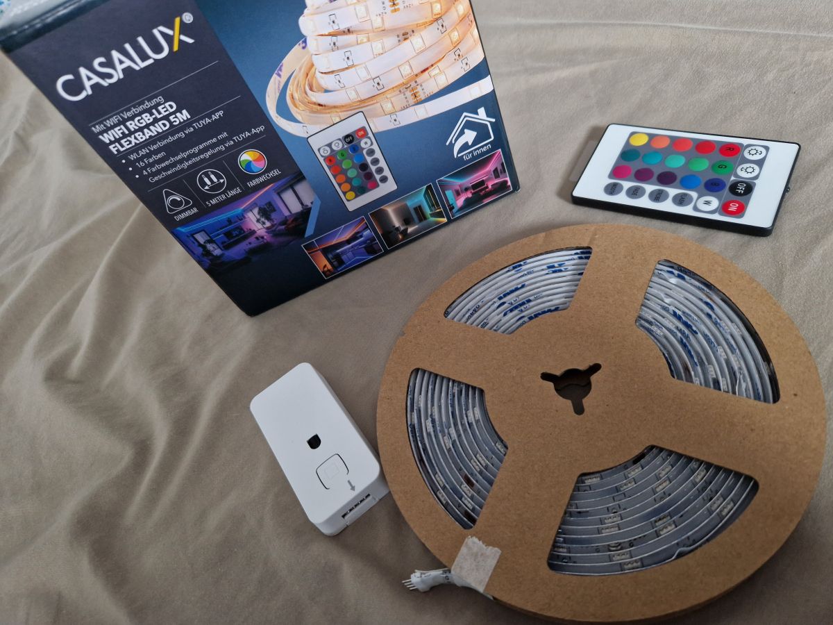

I just bought a bunch of LED stripes from our local supermarket and flashed them with OpenBK. My goal was to be able to control the device via MQTT in my iobroker instance as well as an Alexa Integration.
Casalux LED RGB strip box with remote and lighting effects.
If you're from germany, you can get the stripe at "Aldi Süd" for 7,99€ this week, and as you see in the following, you can also use it with OpenBK.
The stripe itself is pretty cheap but it's not that bad. It comes with a small power adapter, a remote control and some stuff to mount the stripe. Also some cables to go around corners are included. The stripe itself is secured with IP20, so it has this type of glue on the top.
Casalux RGB LED strip with remote and controller against the box background.

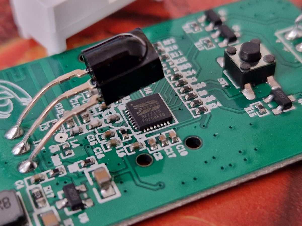

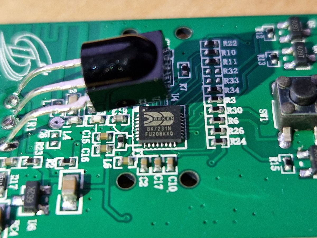

So first of all after buying the stripe I had to take a deeper look to the chipset used in the controller. A screwdriver is a helpful friend to open the case.
Close-up of BK7231N LED controller board with electronic components.

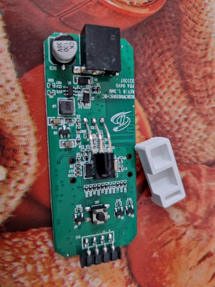

After removing the mainboard, i had to remove the white plasic part under the ir-sensor to see the chipset
Close-up of a circuit board featuring the BK7231N chip and various electronic components.
Close-up of a circuit board featuring the BK7231N chip.
So there it is, the BK7231N.

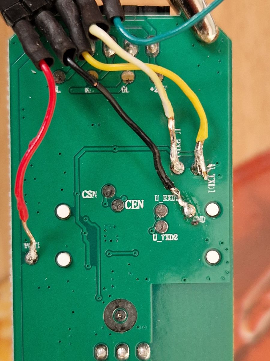

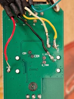

The next step is to connect the controller to your pc with using your UART USB Converter.
To do so, connect as following:
- VCC from Controller to VCC of Converter
- GND from Controller to GND of Converter
- RX1 from Controller to TX of Converter
- TX1 from Controller to RX of Converter
Make sure to use 3.3V on your Converter and attach the usb cable of your converter to your pc.
Close-up shot of a circuit board with soldered wires.

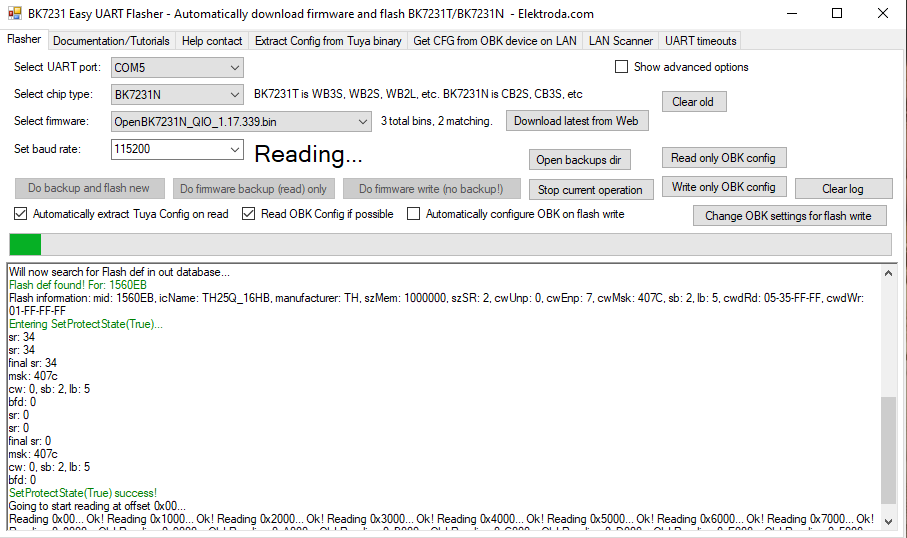

Then download the FlashTool under the following URL:
https://github.com/openshwprojects/BK7231GUIFlashTool/releases/tag/v1.1.5

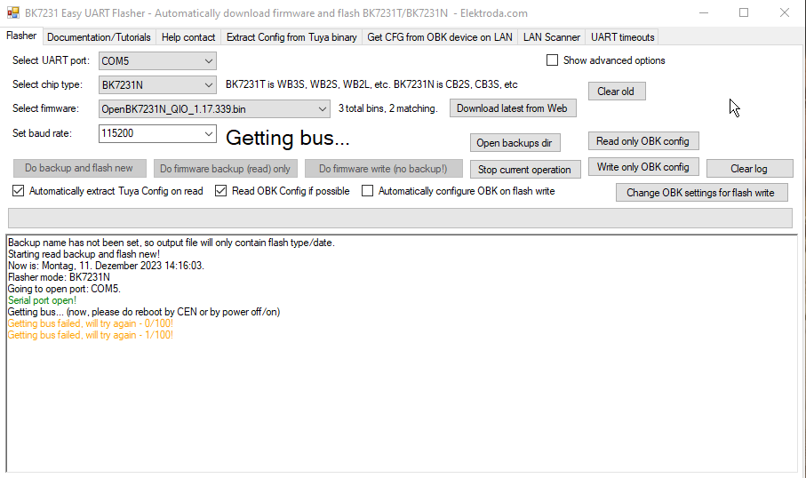

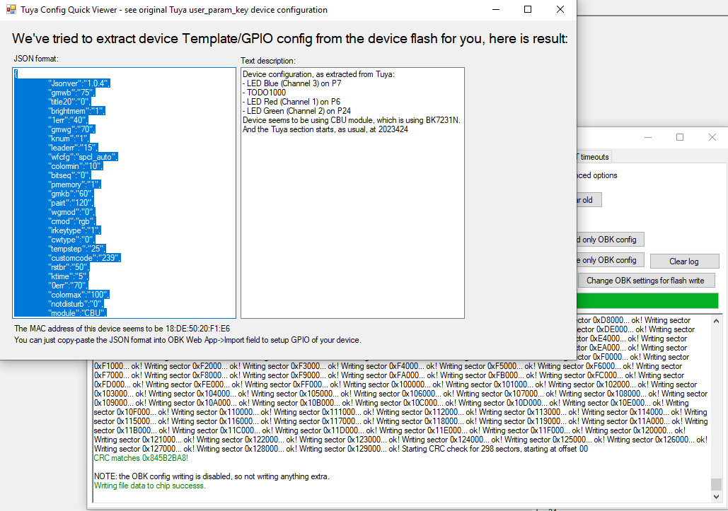

After starting the tool, i've chosen my com port "COM5", which my converter is using, chosen "BK7231N" as chip type and downloaded the newest version with the button next to the drop down where to select the firmware.
Also i had to choose 115200 as baud rate, as i got errors with the suggested default rate.
Then click in "Do backup and flash new" to start the firmware update.
Screen of the BK7231 Easy UART Flasher program with COM5 port open and BK7231N chip set.
Now you'll see the yellow lines that indicates that the device needs to be rebooted.
In my case powering off the device did not help. Instead i just hold a cable from the GND pin to the CEN pin for a very short time and the flashing process continued ...
BK7231 Easy UART Flasher interface with firmware loading

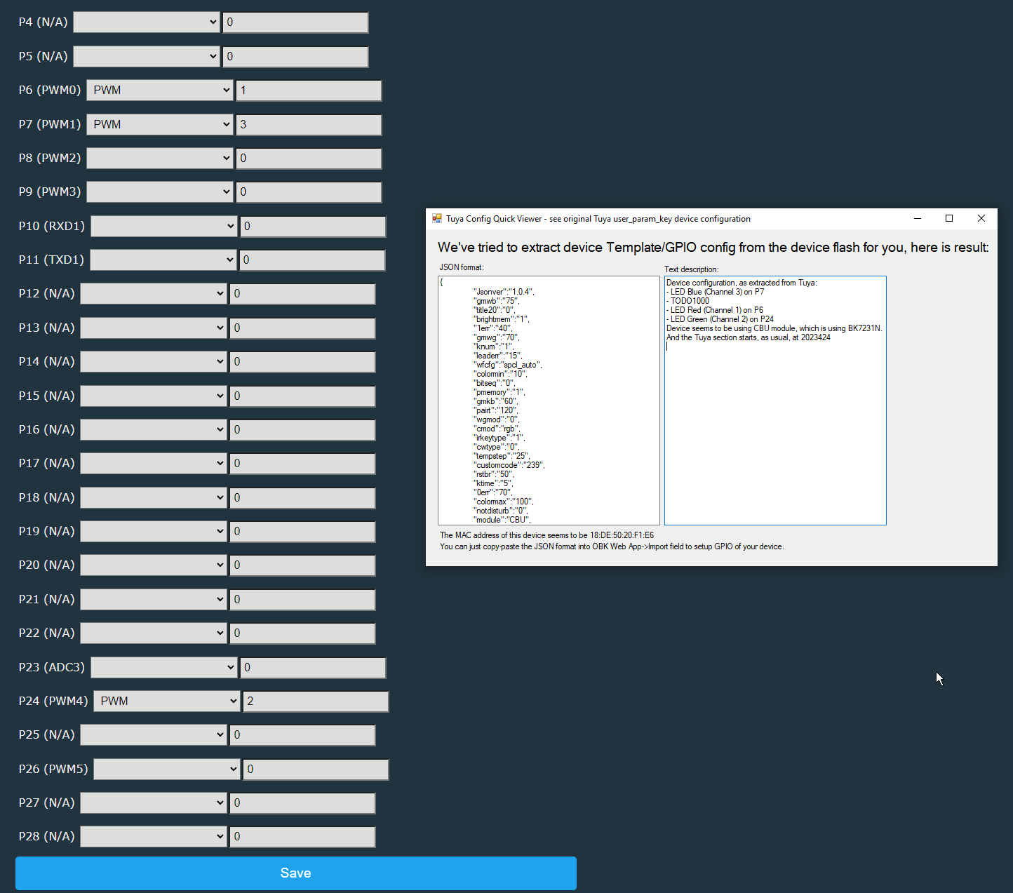

The tool will create a backup of the firmware first. After that, the firmware is written to your device.
When this is done, you will see the tuya config, which is helpful afterwards as it contains informations about which channel is located on which pin of the controller. So it's a good idea to save that information for later use.
Screenshot of Tuya device configuration results after flashing.
My Tuya Configuration:
- LED Blue (Channel 3) on P7
- TODO1000
- LED Red (Channel 1) on P6
- LED Green (Channel 2) on P24
Device seems to be using CBU module, which is using BK7231N.

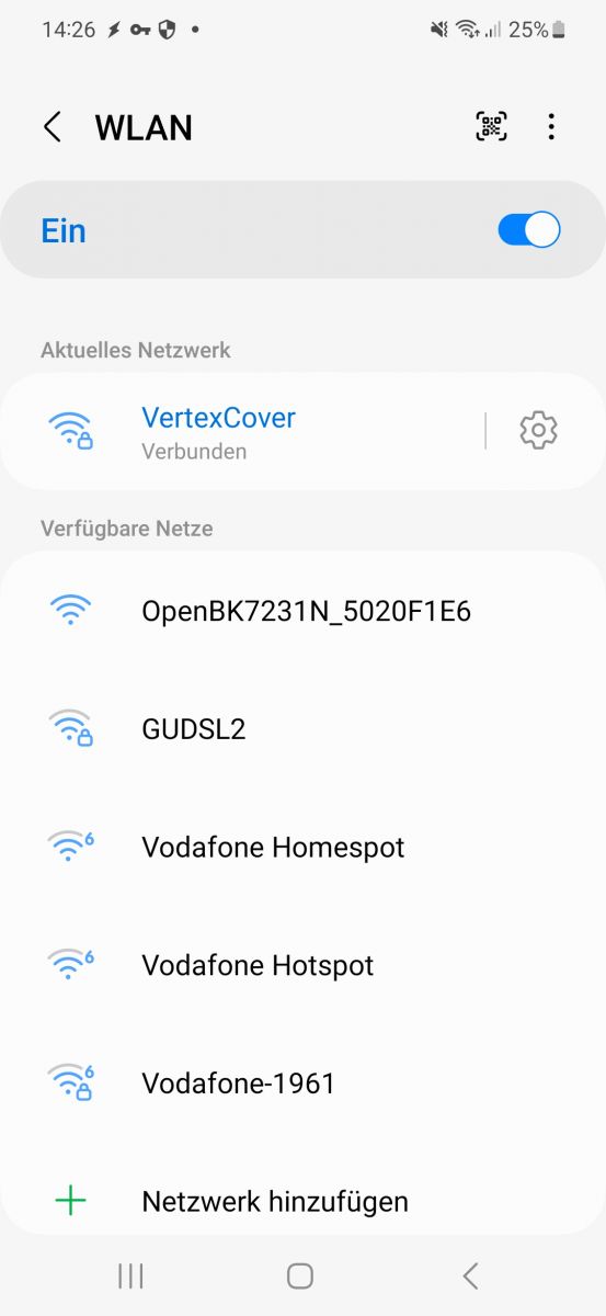

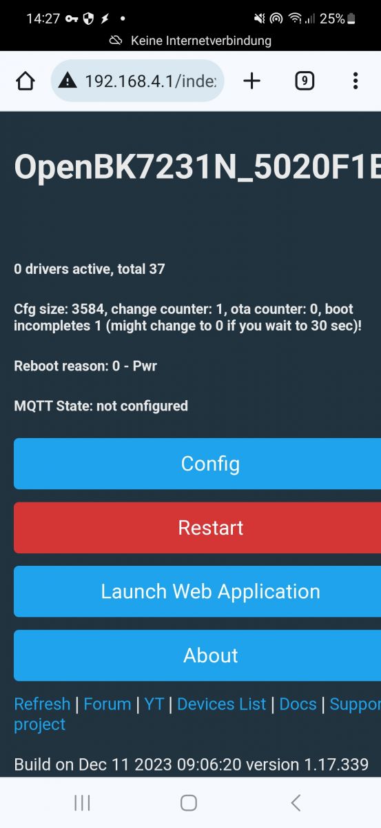

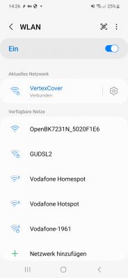

On my smartphone i've then searched for the wifi called "OpenBK..." of the controller and connected to it.
Screenshot of available Wi-Fi networks on a smartphone.

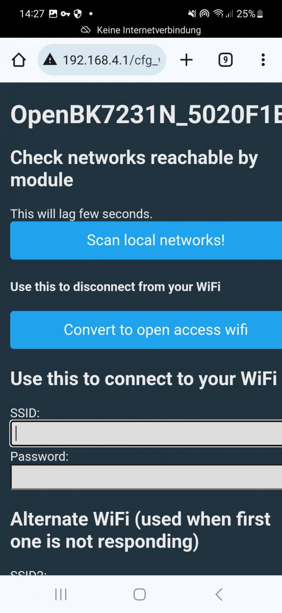

Open the browser on your smartphone and enter the following uri to access the OpenBK firmware of your device.
http://192.168.4.1
OpenBK8231N configuration screen on a smartphone.
First of all, you should go to "config - Configure WiFi" and configure the access to your local wifi here.
OpenBK web interface on a smartphone for WiFi configuration.
After that you can lookup the newly assigned ip adress on your local router and connect to this ip adress to continue the configuration.
Go to "config - Configure Module". Here you'll need the information of the tuya config mentioned above and set the module as following:
- P6 (PWM0) : PWM : 1
- P7 (PWM1) : PWM : 3
- P24 (PWM4) : PWM : 2
Screenshot of a LED device GPIO configuration tool.

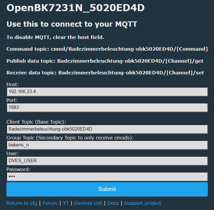

For access with iobroker, goto "config - Configure MQTT" and enter the ip adress where your iobroker is running and the authentication details of the running sonoff adapter.
OpenBK user interface for configuring MQTT.
Under "config - Configure General/Flags" i also had to enable the following flag to get data into my iobroker instance:
Flag 30 - [MQTT] Enable Tasmota TELE etc publishes (for ioBroker etc)

p.kaczmarek2 13 Dec 2023 19:10
Thank you, I can see now, it was pwmhz . The PWM frequency of this device is 1000Hz. Okay, I will fix it in my decryptor, by basically replacing "TODO" string with "PWM Frequency". Thanks [Read more]
