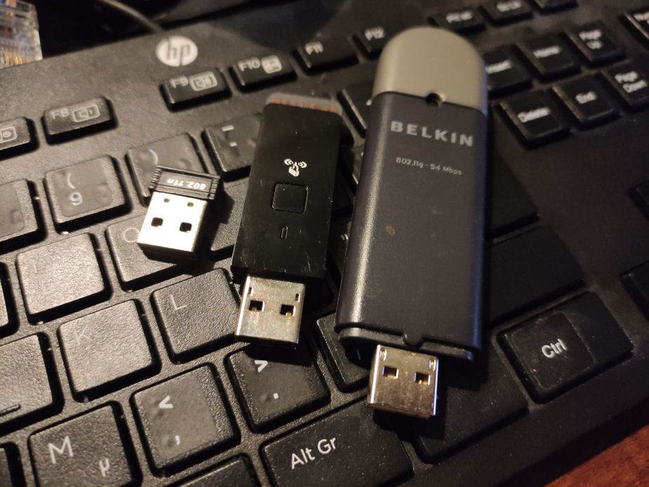

Cloudcutter is best run on a clean Linux system, you can also use a RaspberryPi 3 or newer computer. The author recommends Ubuntu, I used Debian. Additionally, a WiFi card is required because the script creates a HotSpot during operation to which the programmed device connects. You can use the built-in card if you use e.g. a laptop or a USB card. And here`s a small note: not every card will work. Initially, I tried cards based on the Realtek chipset. However, on them the script screamed that it was unable to handle HotSpot mode. Finally I used an Atheros based card, this one worked fine.
Various-sized USB WiFi adapters on a keyboard.

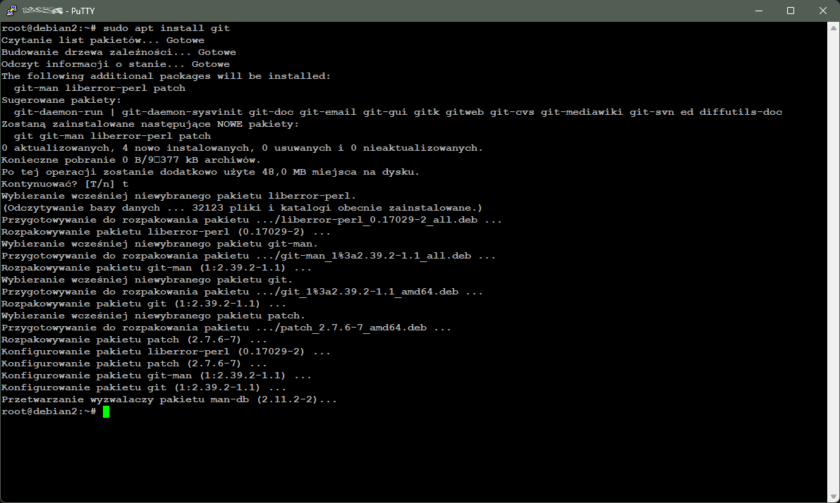

So, having a clean system with a WiFi card installed, we install Docker, which Cloudcutter requires to work.
It`s very well described step by step on the Docker website, so I`ll just post the link:
https://docs.docker.com/engine/install/debian/
After correctly installing Docker, we install subsequent packages. For handling Git repositories and WiFi management. To do this, launch the console and enter:
sudo apt install git network-manager

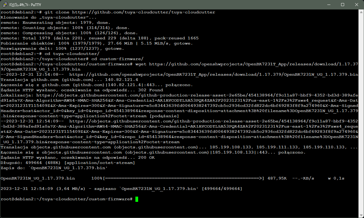

In the next step, we clone the Cloudcutter repository from Github:
git clone https://github.com/tuya-cloudcutter/tuya-cloudcutter
After cloning, we enter the directory ./tuya-cloudcutter/custom-firmware and there we download the OpenBK firmware in the appropriate version needed to reprogram the thermometer.
To do this, go to the website:
https://github.com/openshwprojects/OpenBK7231T_App/releases
Our thermometer is on a chip BK7231N . Therefore, we must choose the firmware for this system and the version that works with Cloudcutter, i.e. described as CCtr Flash .
We download with the wget command:
(this is an example link, with the current fw version at the time of writing, I recommend replacing it with the current version)
wget https://github.com/openshwprojects/OpenBK7231T_App/releases/download/1.17.379/OpenBK7231N_UG_1.17.379.bin
Linux terminal window with firmware download process.

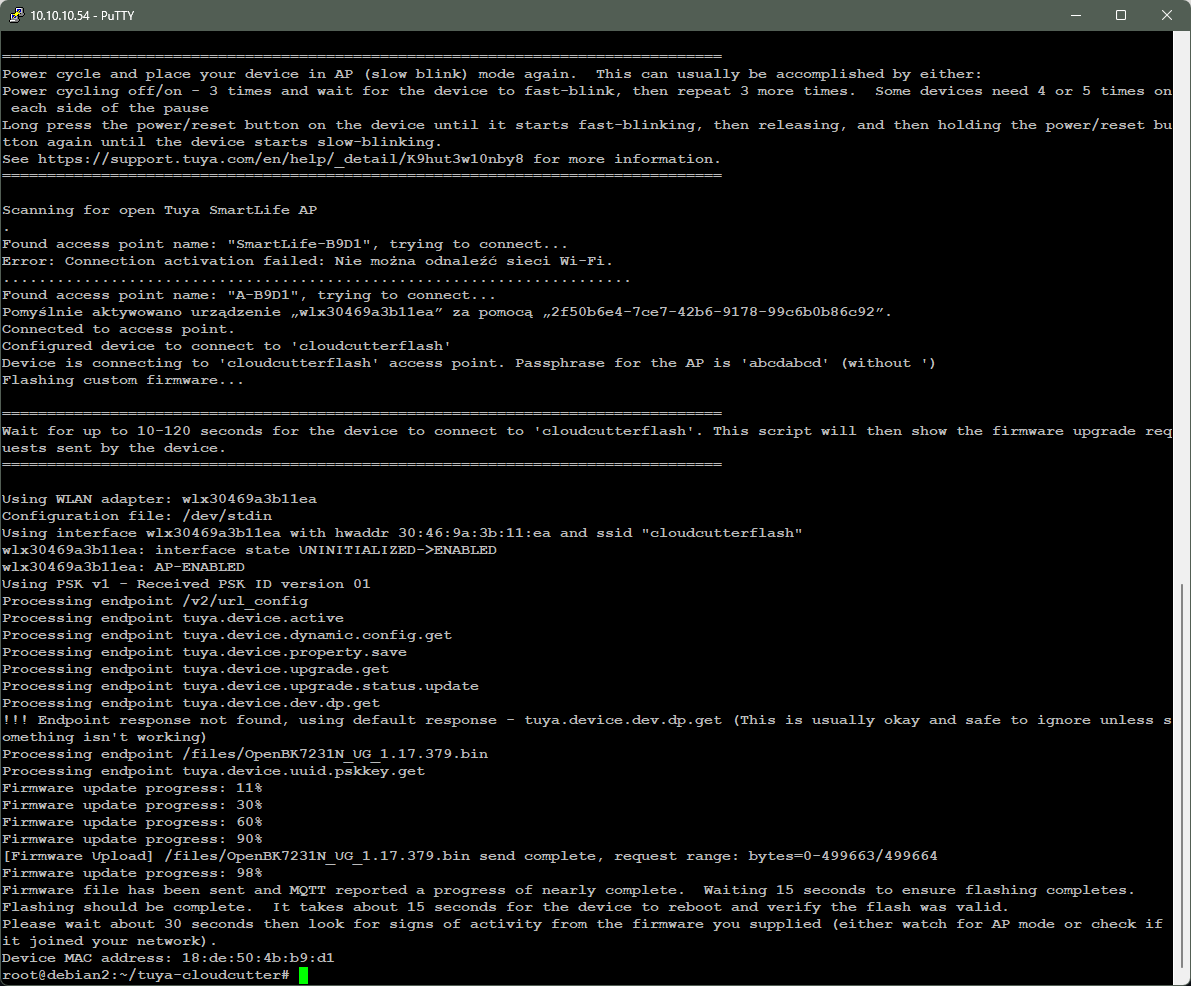

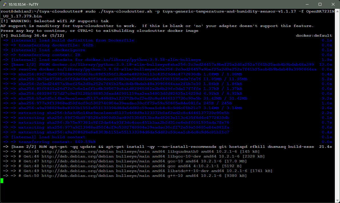

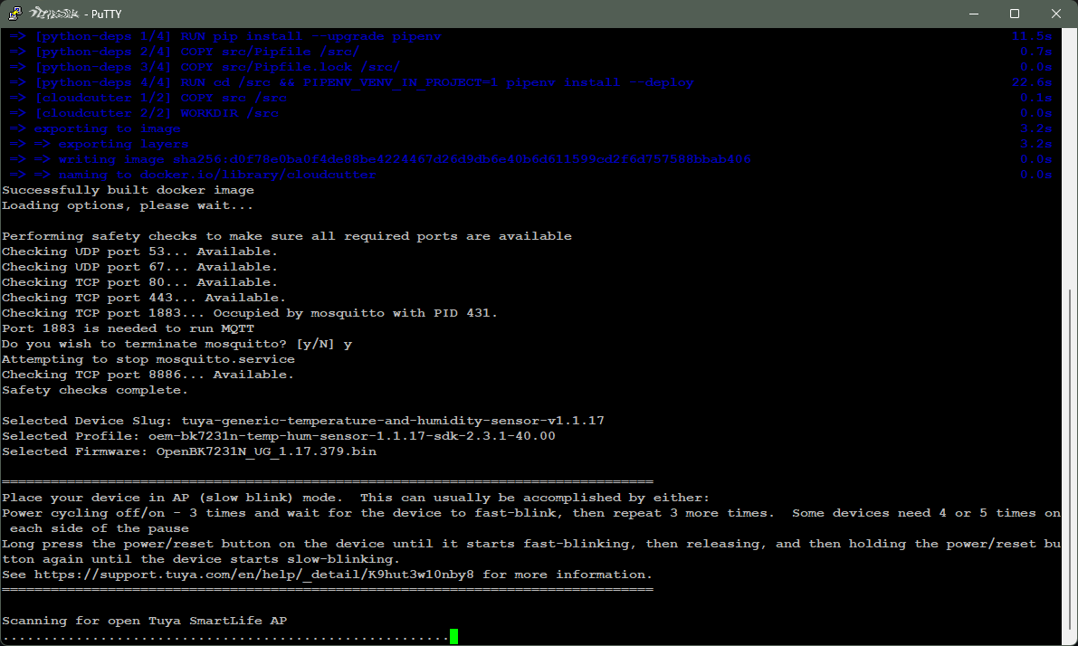

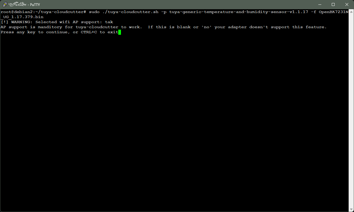

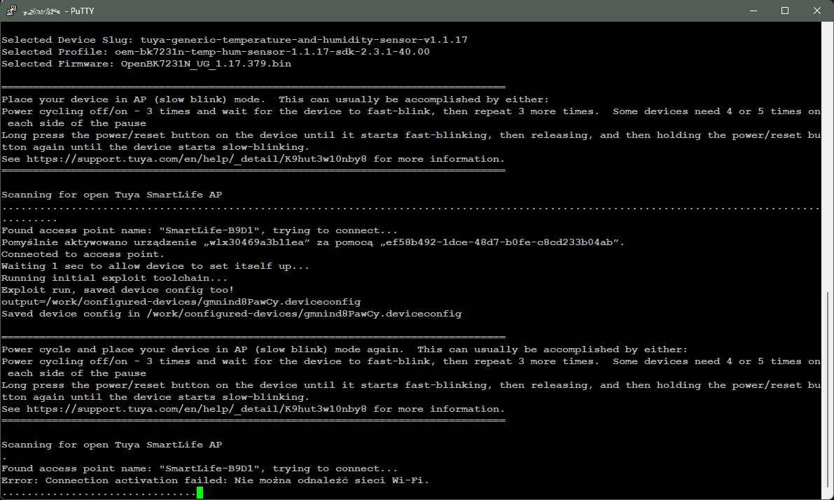

Once we have everything downloaded, we go back to the directory above and run the tuya-cloudcutter.sh script with the appropriate parameters. The first launch may take quite a long time as additional elements needed for operation are downloaded and Docker containers are created.
So we run the script with variables, where -p is the profile of our device. The current list of supported devices can be found here:
https://github.com/tuya-cloudcutter/tuya-cloudcutter.github.io/tree/master/devices
The -f variable is the name of the firmware file that we downloaded earlier. So the full syntax:
sudo ./tuya-cloudcutter.sh -p tuya-generic-temperature-and-humidity-sensor-v1.1.17 -f OpenBK7231N_UG_1.17.379.bin
At the very beginning, the script will display important information, "WARNING: Selected wifi AP support: yes" if it does not say "yes" or "yes" at the end, stop the operation by pressing Ctrl+C because the WiFi card does not support HotSpot mode and the script will not work properly. If we continue, the necessary elements will be downloaded first:
Terminal window displaying WiFi support information. Terminal window with Tuya Cloudcutter script running on Debian.
At this point, all instructions will be described on the screen. We insert the batteries into the thermometer and we need to put it in the slow blinking mode (HotSpot mode). To do this, hold down the RESET button. First, the LED will start flashing quickly and this is not this mode yet. We press the button again and hold it for a while, only then will the LED start blinking slowly and the script will immediately detect the thermometer and start working.
Screenshot from PuTTY console showing the process of changing the firmware of a Tuya thermometer using Cloudcutter.
At this point, the script will make a copy of the device configuration, and the thermometer itself will reset and the LED will turn off. We have to repeat the procedure of pressing RESET again until it flashes slowly. Now the script will start working properly. The thermometer will be detected again and the OpenBK firmware upload will start.
Screenshot of PuTTY with WiFi thermometer configuration logs. Terminal with firmware update instructions

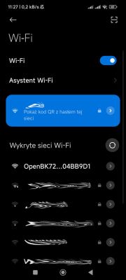

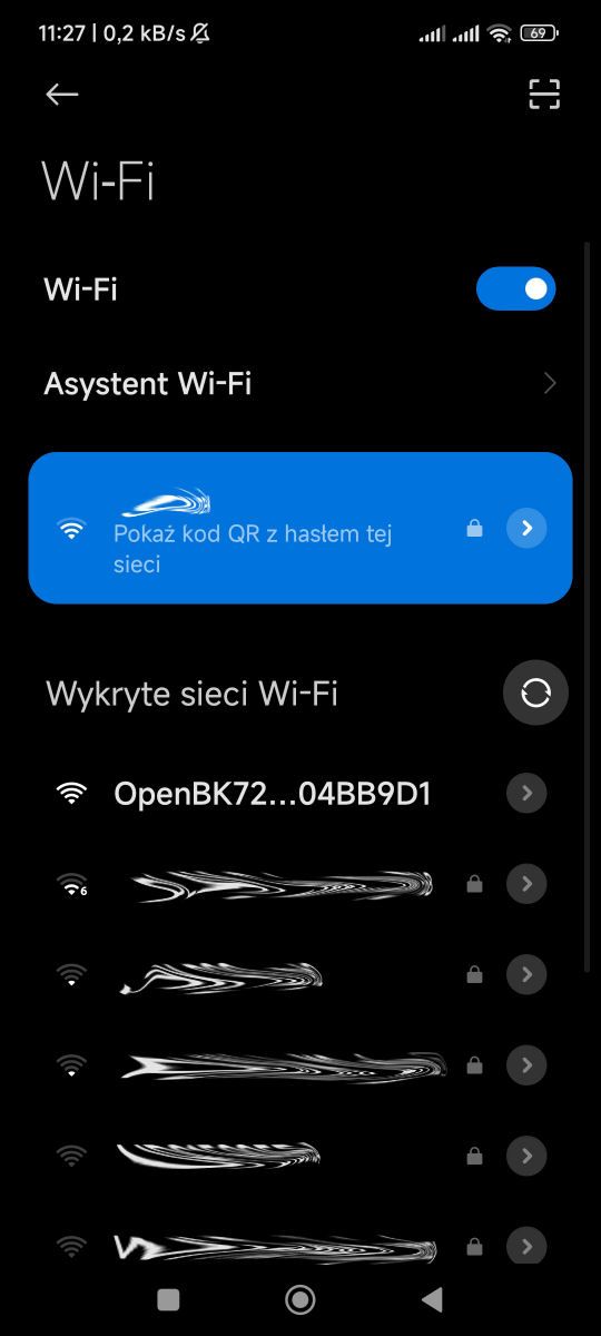

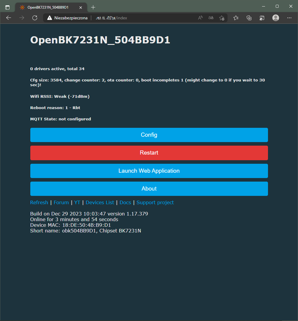

2. Configuration and connection to Home Assistant

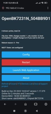

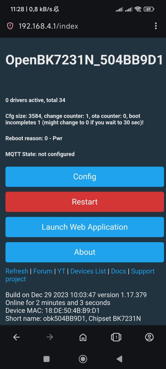

If everything above went correctly, we already have OpenBK loaded. And the thermometer itself works in HotSpot mode, which you need to connect to to start configuration.
This can be done using a smartphone, tablet or laptop. The network will start with a name OpenBK… and it will be unsecured.
List of detected Wi-Fi networks on a smartphone screen with the OpenBK72 network highlighted.
The next step after connecting is to launch a web browser and enter the address
http://192.168.4.1
OpenBK7231N configuration interface screen with device control buttons.

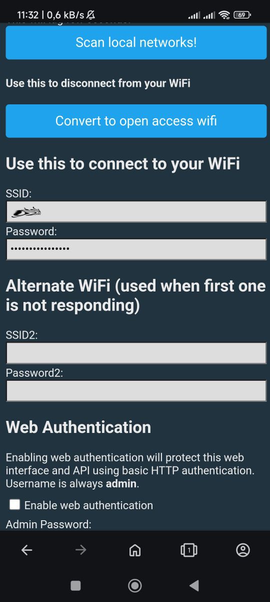

We can now start the configuration, I suggest first connecting to our WiFi network. To do this, we enter "Config" "Configure WiFi & Web" . In the fields below "Use this to connect to your WiFi" enter the name of our network - SSID and the key – Password and confirm with the button Submit at the bottom of the page.
Screenshot of a mobile app for WiFi configuration.
The device will restart and connect to our WiFi. By default, it is configured to receive an IP address from a DHCP server. Therefore, we need to check what address it received, e.g. in the router logs. Once it is known, enter it in the browser again and the same page as before will be displayed. The most convenient way to do this is from your computer`s browser.

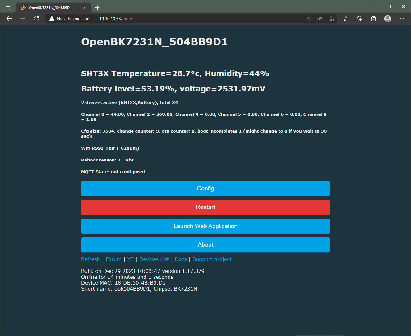

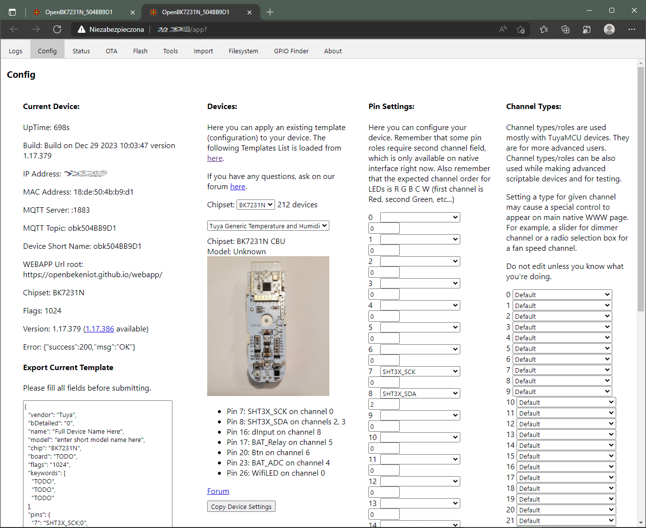

Now you need to assign the pin configuration so that the firmware knows which pin of the Beken chip is connected to. This can be done manually, but a ready-made configuration is available for this thermometer.
That`s why we click on "Launch Web Application" , on the page that opens in a column "Devices:" we choose ours "Chipset" That is BK7231N , and in the list below "Tuya Generic Temperature and Humidity Sensor Battery Powered SHT30" . A photo of the board will be displayed and the pin configuration will be listed. We clickon "Copy device settings" . The configuration will appear in the column on the right, scroll to the bottom of the page and click on "Save" . At this point, the LED on the thermometer housing should light up. We can close this page for now and return to the main page.
Screenshot of the OpenBK WiFi thermometer configuration.

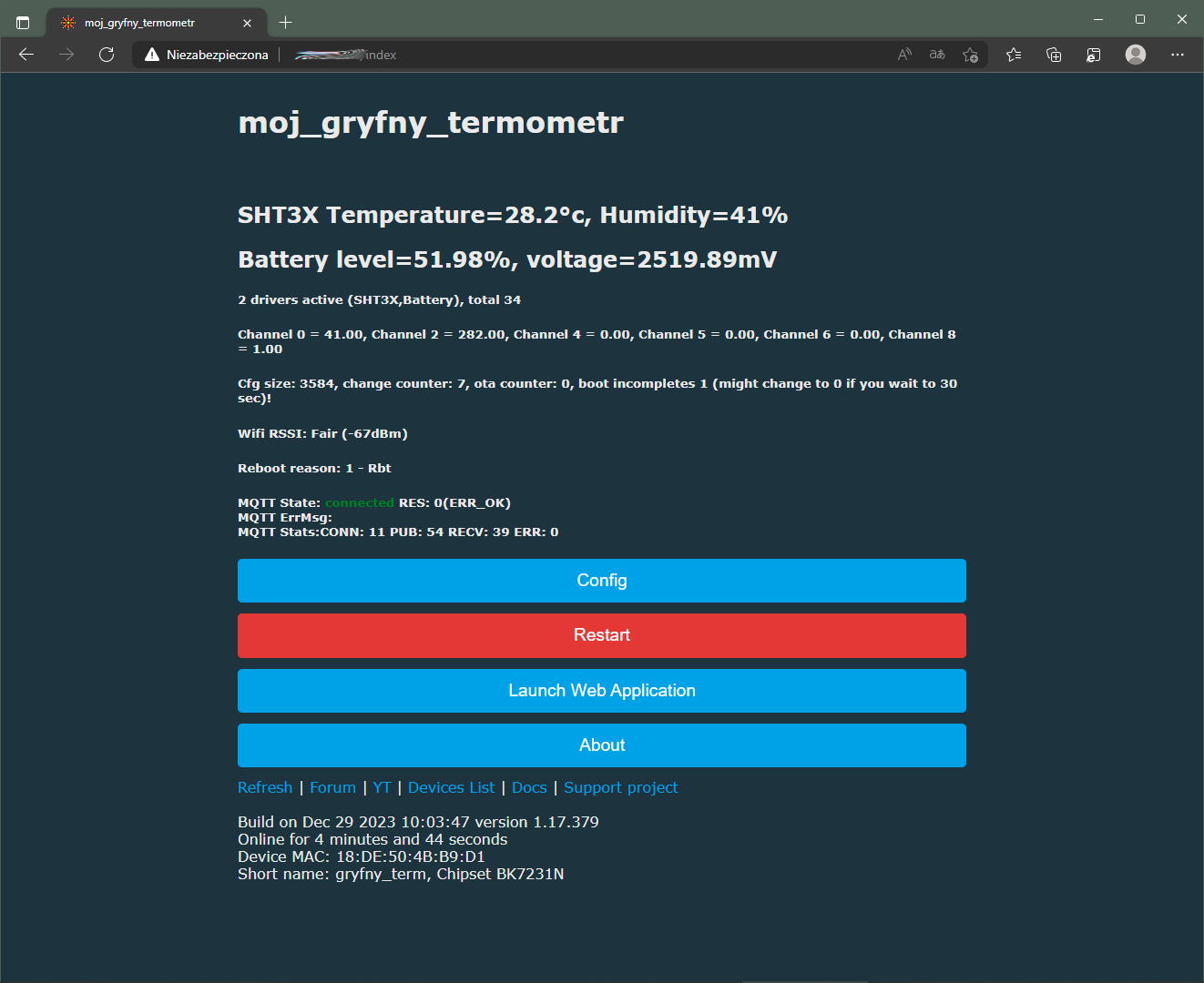

We click on "Reboot" . After restarting, this page will display the SHT30 sensor readings and battery voltage.
OpenBK7231N user interface displaying temperature, humidity, and battery level information

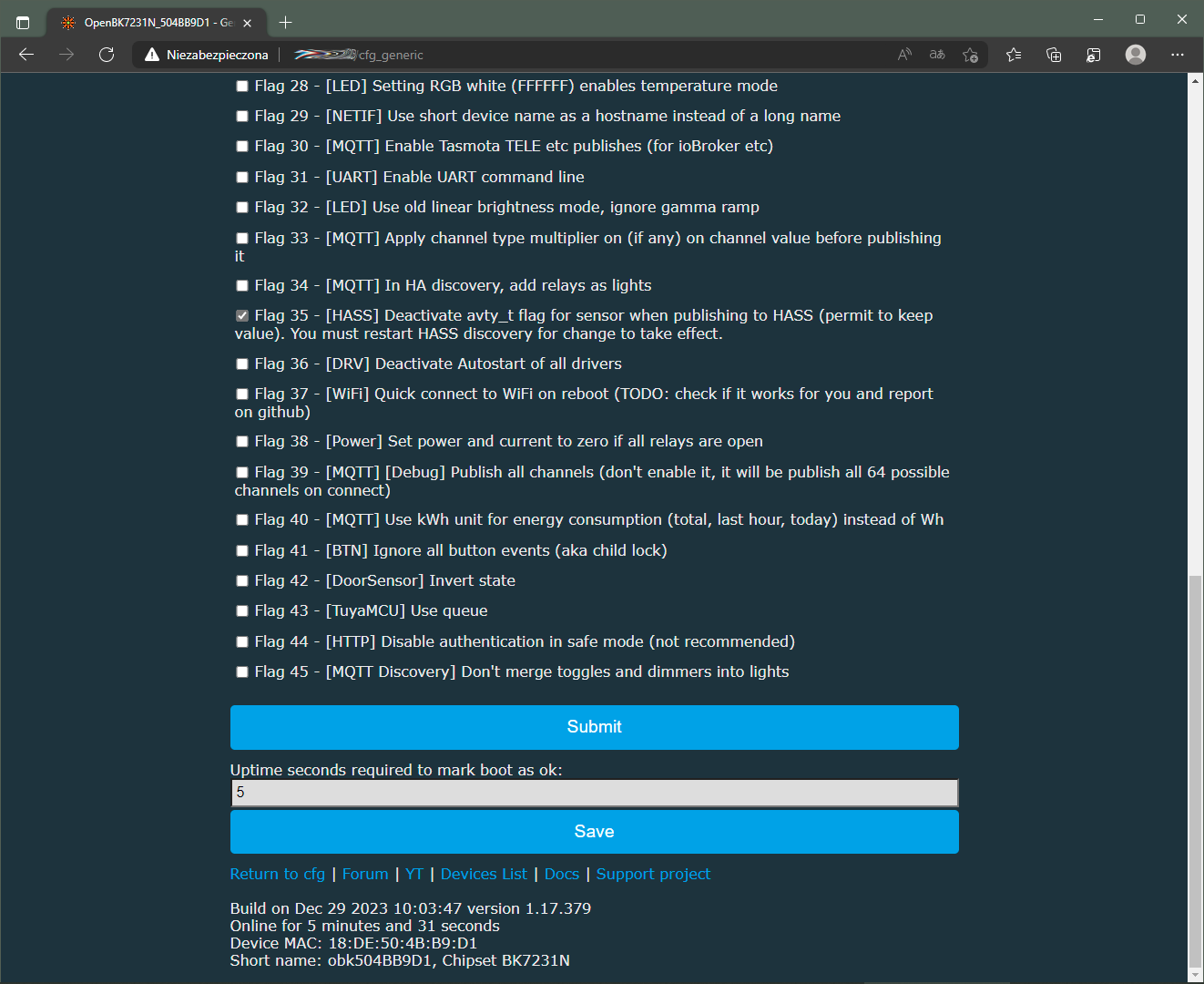

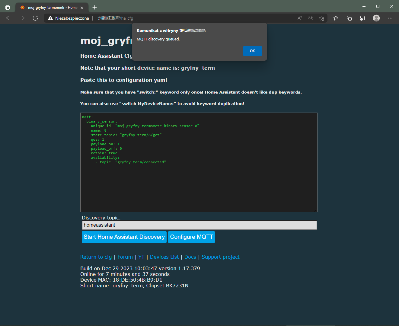

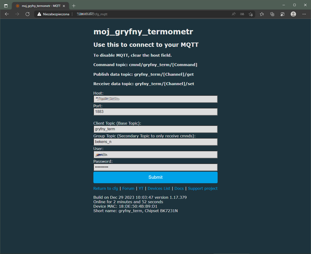

It`s time to connect to Home Assistant. We must have an MQTT broker running in it (or a separate one) with which the thermometer will connect. First things first…
Click again "Config" , and then "Configure General/Flag" and we mark the flags there 2 and 35 , and then click on "Submit" and "Save" . And we go back to the main configuration page.
Screenshot of OpenBK configuration for SHT30 sensor
I recommend entering "Configure IP" and enter there the IP address that the thermometer should use. This will speed up the connection a bit after waking up, which will save the battery. However, this is not necessary.

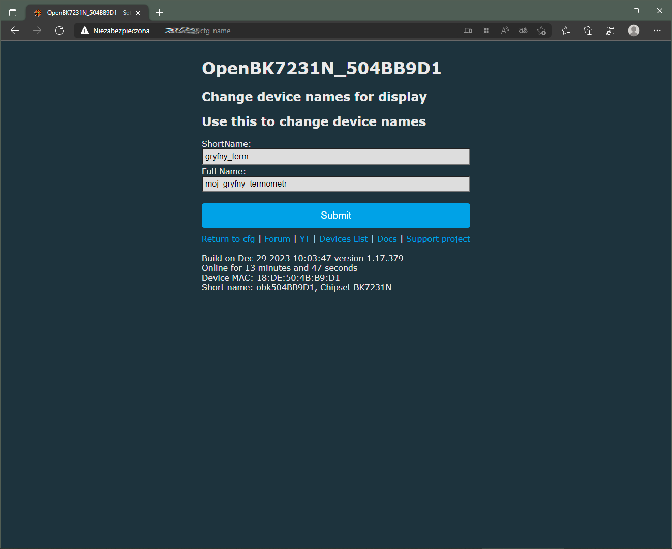

The next option that is worth changing is the name of the thermometer. This is also not necessary, but having several of them makes it easier to figure out which one it is. To do this, click on "Configure Names" .
OpenBK7231N device name change interface.
Now I recommend clicking on the main page again "Reboot" so that the thermometer starts up with the new settings. And we continue to configure, we will connect to MQTT. We go in "Config" "Configure MQTT" and enter the parameters of our broker, address, port and login. Here we also change the name under which the thermometer is to be reported to a more user-friendly one.
Screenshot of MQTT configuration for WiFi thermometer
We return to the home page, if the MQTT configuration is correct, new information will appear on it "MQTT State: connected" .
App screen of WiFi thermometer moj_gryfny_termometr with temperature and humidity readings

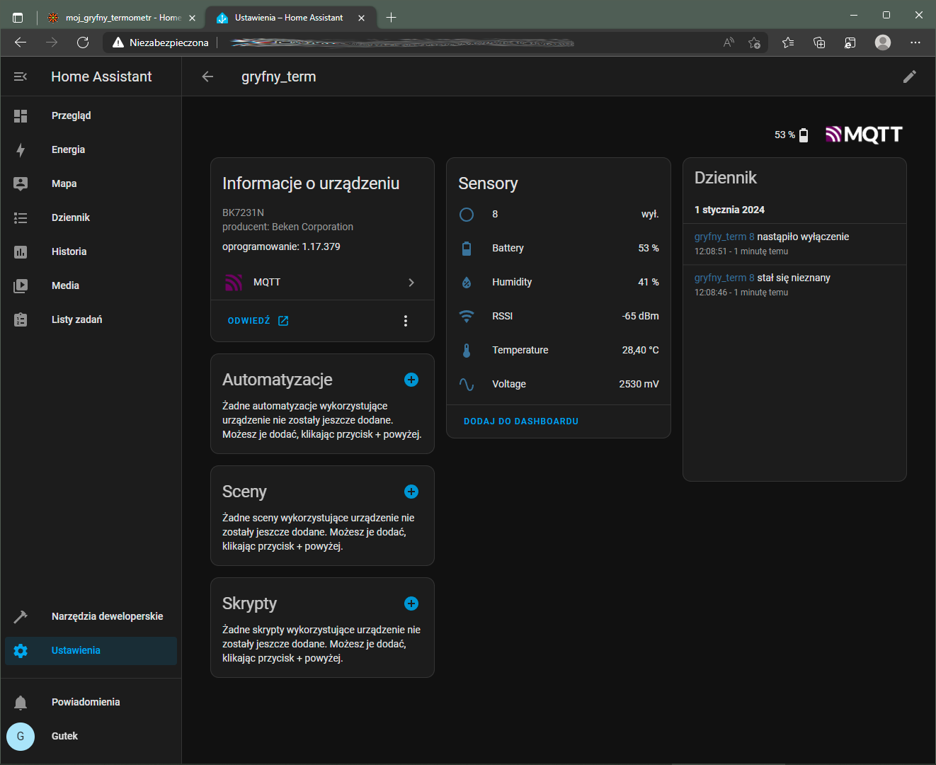

All that`s left is to add the thermometer to Home Assistant. Then we enter the configuration again "Home Assistant Configuration" and click on "Start Home Assistant Discovery" .
Home Assistant configuration window for WiFi thermometer with SHT30 sensor
The device should be detected and displayed in Home Assistant.
Screenshot of Home Assistant interface showing device information.

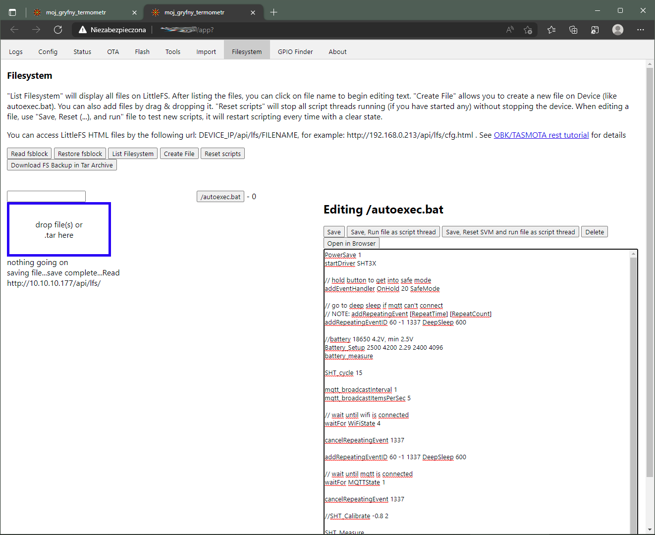

This could be the end of setting up the thermometer, but having the thermometer on all the time will drain the batteries even within a day. Therefore, it is very important to put it to sleep and wake it up only at certain times to send data. I wake mine up about every 15 minutes. For this you need an appropriate script, which I provide below.
If we have closed the thermometer page, we must enter it again. And we click again "Launch Web Application" .
Let`s go to the card "File System" . Where we will create the autoexec.bat startup file.
Click on "Create file" and in the window that appears, enter the name "autoexec.bat" . Then click on the name of this file to launch the editor. Paste the script below into it and confirm "Save" . Now, after restarting the thermometer, it will be executed in a loop every time.
Screen of autoexec.bat file editor in thermometer management system.
//wlaczenie oszczedzania energii
PowerSave 1
//wlaczenie sterownika do obslugi SHT30
startDriver SHT3X
// przytrzymanie przycisku wymusi tryb serwisowy
addEventHandler OnHold 20 SafeMode
// wlaczenie licznika ktory uspi modul w przypadku braku lacznosci wifi
addRepeatingEventID 60 -1 1337 DeepSleep 600
//kalibracja i pomiar 18650 4.2V, min 2.5V
Battery_Setup 2500 4200 2.29 2400 4096
battery_measure
SHT_cycle 15
mqtt_broadcastInterval 1
mqtt_broadcastItemsPerSec 5
// oczekiwanie na polaczenie z wifi
waitFor WiFiState 4
cancelRepeatingEvent 1337
//to samo co wyzej tylko teraz uspienie przy braku polaczenia mqtt
addRepeatingEventID 30 -1 1337 DeepSleep 600
// oczekiwanie na polaczenie z mqtt
waitFor MQTTState 1
//jesli SHT przeklamuje mozna wprowadzic korekty
//SHT_Calibrate -0.8 2
SHT_Measure
delay_s 1
publishChannels
delay_s 5
//glebokie uspienie na 15min
DeepSleep 875

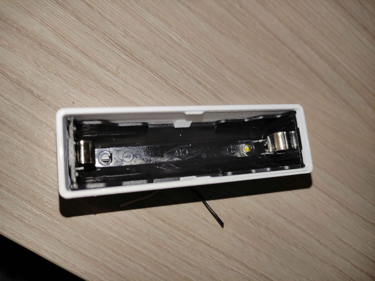

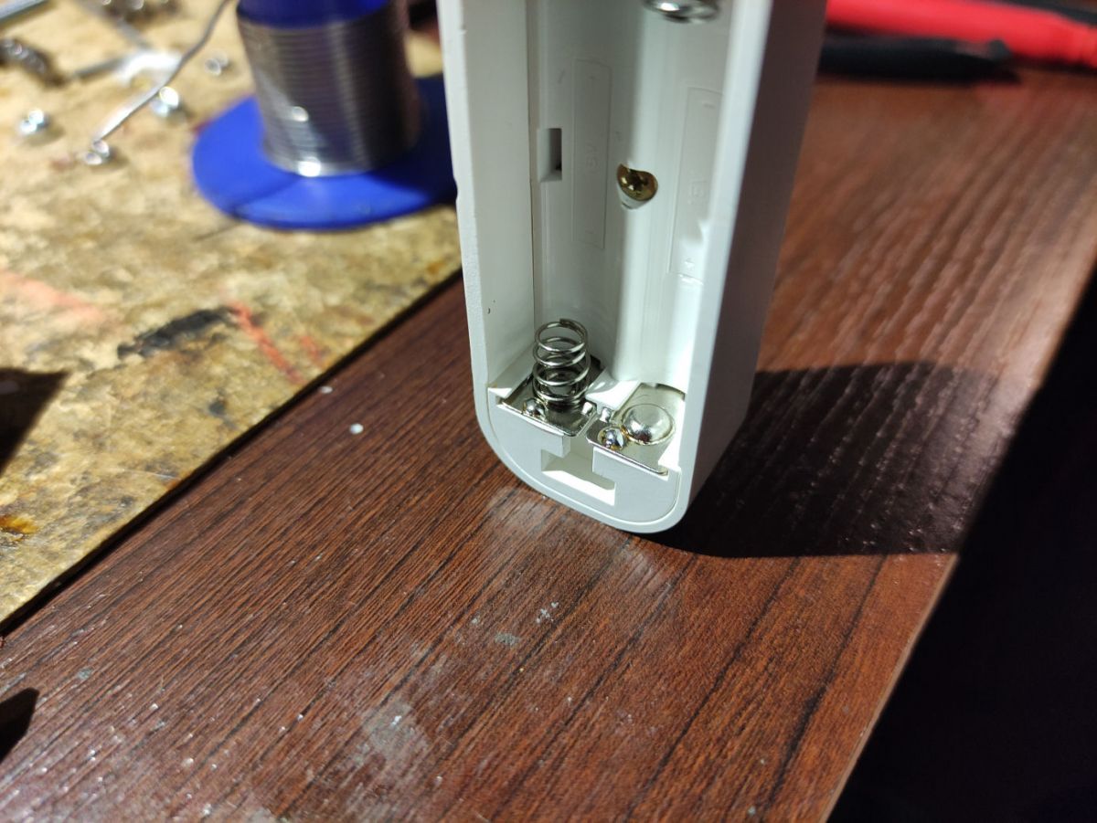

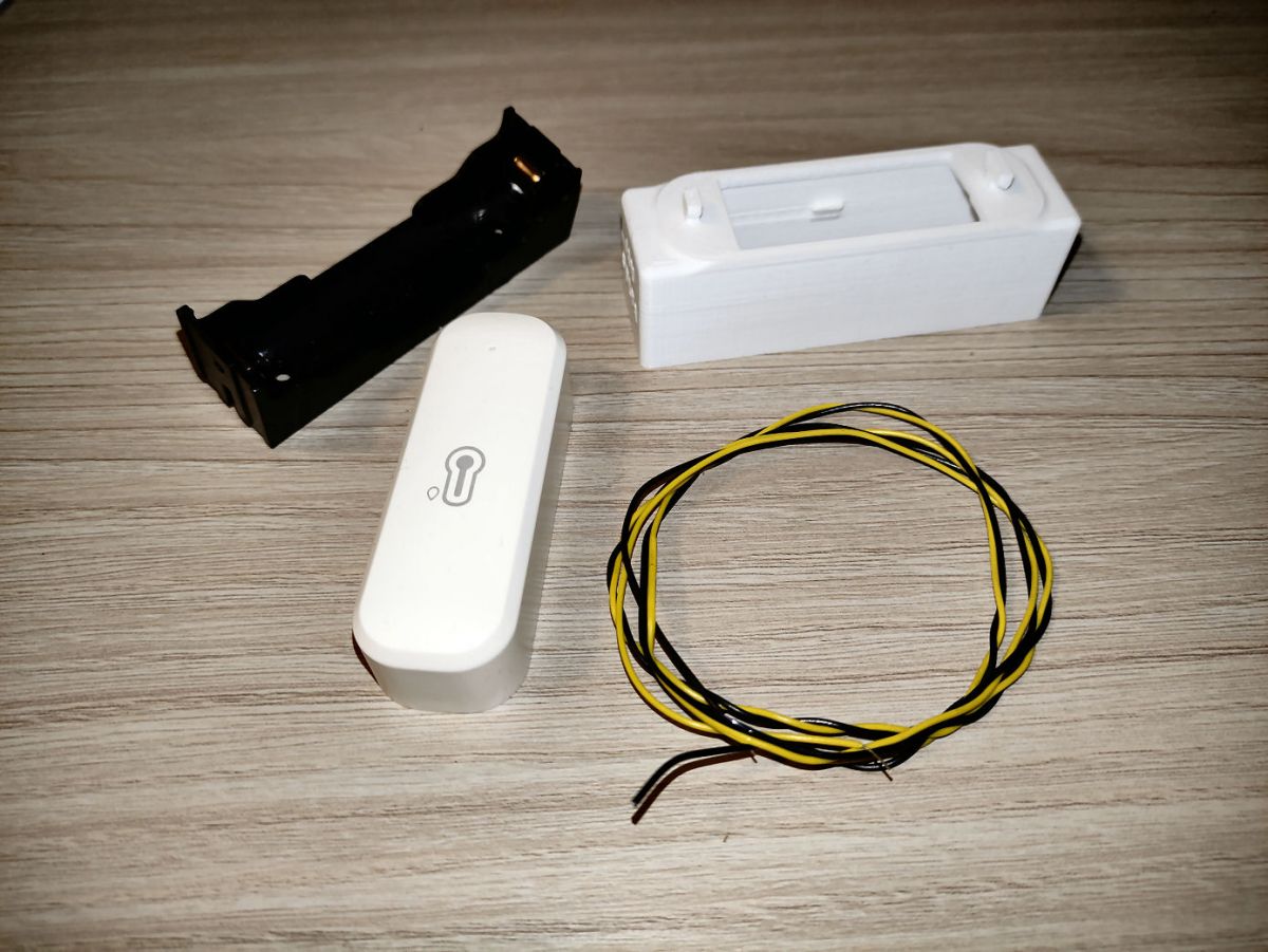

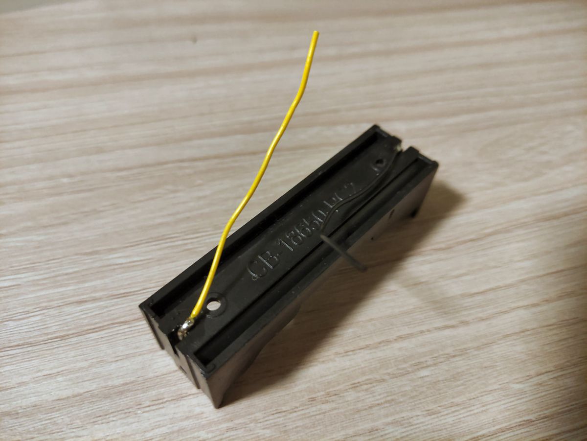

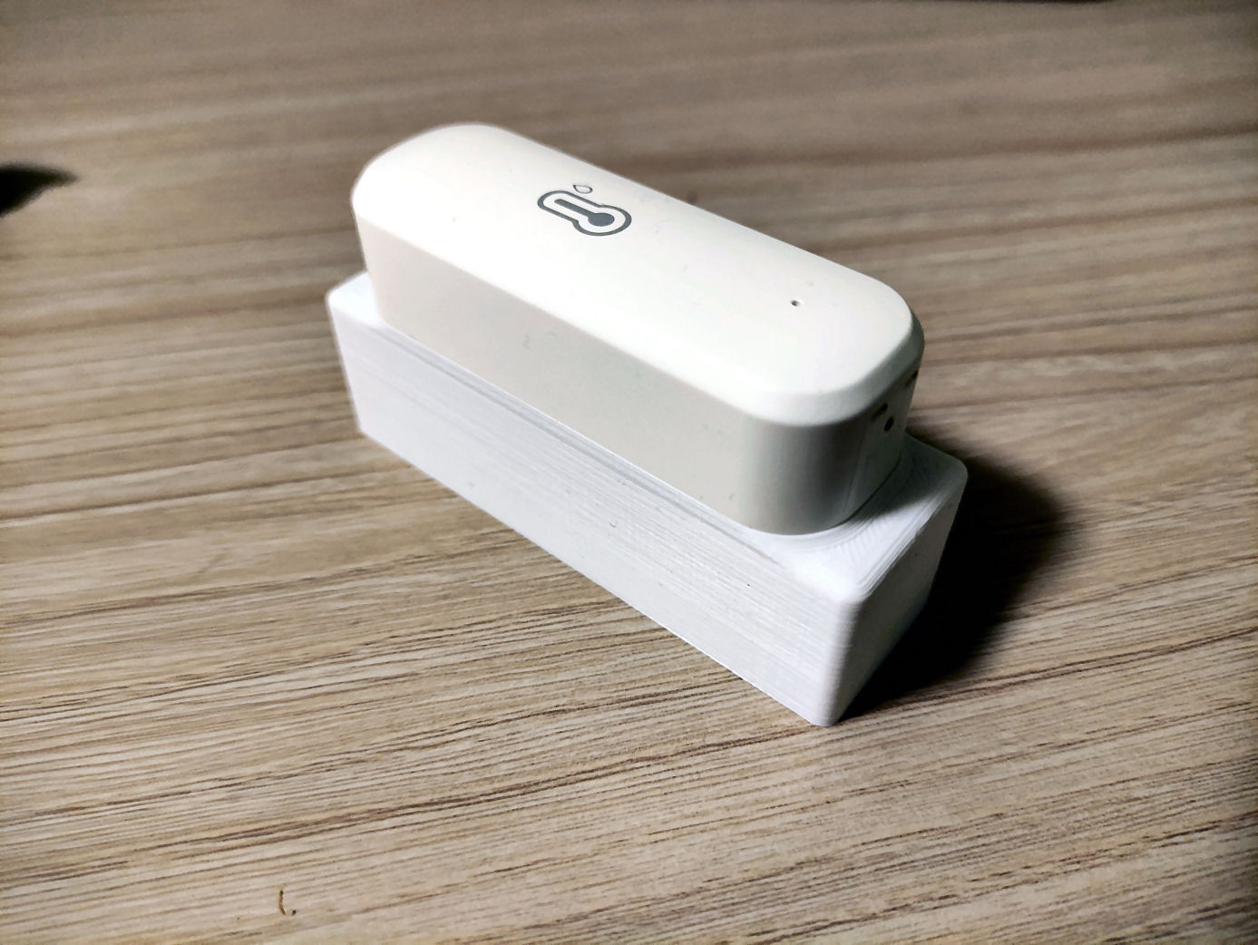

3. Additional housing for the 18650 cell.
As I wrote at the beginning, I replaced the power supply in my thermometers with a 18650 battery with a capacity of 3500mAh, which lasts much longer than AAA batteries (or accumulators).
I drew the housing in one of the popular 3D design programs and printed it from white PLA filament manufactured in Poland. If you want a more resistant print, you can consider printing from PET-G.
To download: obudowa186...mometr.zip (42.55 kB)You must be logged in to download this attachment.

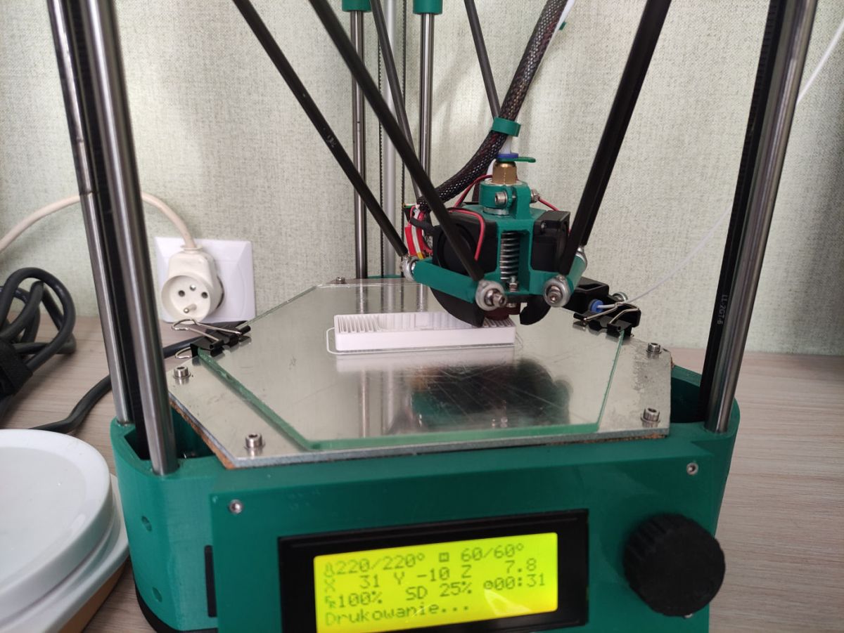

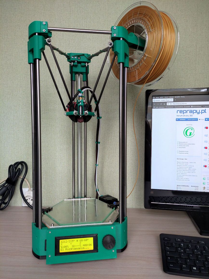

I printed it on a delta printer that I once made based on a design from the Internet. You can find more about it on the popular forum about 3D printers – Reprapy.pl forum : https://reprapy.pl/viewtopic.php?p=138698#p138698
Delta 3D printer with green parts on a desk next to a monitor.
I won`t go into much detail about how to print a casing, because each printer is different and you need to select the parameters for it. I will only add that you should print with supports and pay attention to whether the slicer (the program that prepares the file for the printer) also creates supports under the protrusions for mounting the thermometer.
Delta 3D printer printing a plastic enclosure.
So we already have a printed casing cleared of supports. In addition, you will need a basket for the cell and thin cables.
Components for assembling a WiFi thermometer: a case, battery holder, sensor, and wires

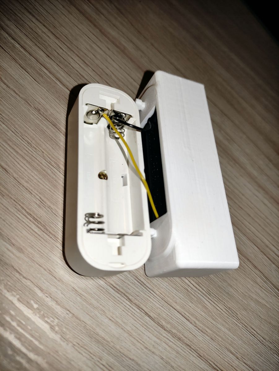

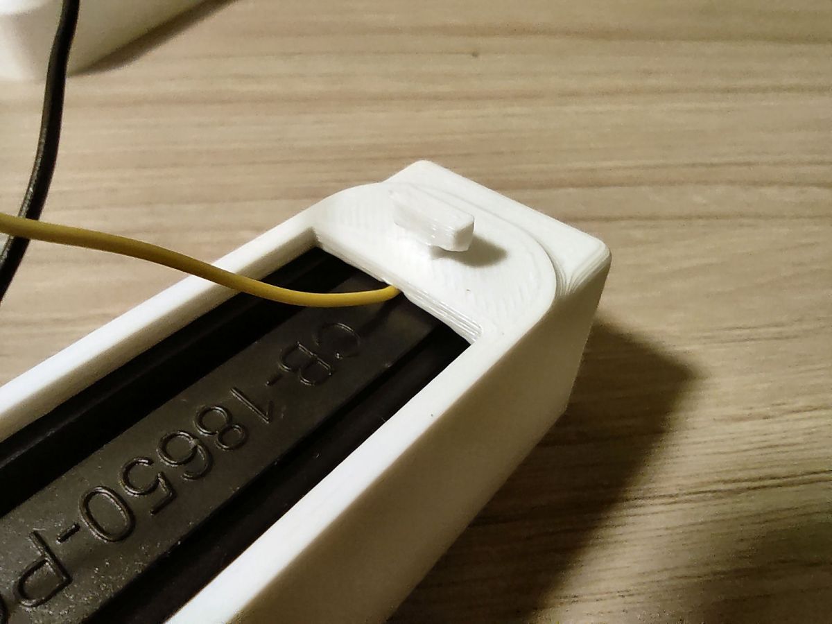

Before inserting the basket into the housing, we bend its legs and solder the cables to them. I also recommend squeezing the spring plates because it is very difficult for the battery to fit into the new baskets, which also makes it difficult to remove it when the basket is already in the housing.
Battery holder with attached yellow wire.
Insert the basket into the housing, making sure that the cables fit into the grooves. And the basket was blocked by locks.
18650 battery holder with wire Interior of a plastic case with a holder for a 18650 battery.
We still need to whiten the plates in the thermometer and solder the cables from the basket to them. The baskets have polarity markings + and -, it is worth paying attention to them when soldering. I recommend lightly scraping the soldering areas and applying flux paste, then the tin will easily catch.
Interior of thermometer casing with battery compartment. Open case of a white thermometer with two springs and a yellow wire inside, next to an additional battery housing.
Now just assemble the whole thing, insert the battery, paying attention to the polarity, and we have a ready thermometer!
WiFi thermometer on a 3D-printed base
I have been testing thermometers with this power supply for several months, initially I sent data via HTTP, now I am trying my hand at Home Assistant. During this time, changing the power supply did not damage any of them.

And what does it look like with flag 37? I checked it and somehow I didn`t notice any difference in connecting to Wi-Fi. Should the device connect significantly faster and does it even work in this case? ... [Read more]

Don`t be fooled by this screenshot. It was made to show the thermometer detection by HA. And I think so, there were some AAA batteries put in there back then. To correctly display the voltage and charge... [Read more]

https://github.com/openshwprojects/OpenBK7231T_App/blob/main/docs/flags.md https://github.com/openshwprojects/OpenBK7231T_App/blob/main/docs/flags.md At the beginning of work on the firmware,... [Read more]

  • BK7231N is rated for about 3.6 V max, while a fully charged 18650 reaches 4.2 V; the mod worked for months in the thread, but the author explicitly warned about possible chip damage. [#20887781]

How do I flash OpenBK onto a BK7231N WiFi thermometer with an SHT30 sensor using Tuya Cloudcutter step by step?
Use Tuya Cloudcutter with the BK7231N “CCtr Flash” OpenBK file. 1. Install Docker, Git, and NetworkManager on a clean Debian or Ubuntu system with a Wi‑Fi adapter that supports HotSpot mode. 2. Clone tuya-cloudcutter, place the OpenBK7231N firmware in custom-firmware, then run sudo ./tuya-cloudcutter.sh -p tuya-generic-temperature-and-humidity-sensor-v1.1.17 -f OpenBK7231N_UG_1.17.379.bin. 3. Put the thermometer into slow-blinking mode twice when prompted: first for config backup, then for the actual flash. The first run can take longer because Docker images are created. [#20887781]
What is Tuya Cloudcutter and when is it better to use it instead of opening the device and soldering to the board?
Tuya Cloudcutter is better when the device is hard to open or you want to avoid soldering. "Tuya Cloudcutter" is an exploit-based flashing tool that uses the original Tuya update path to load custom firmware, which lets you reflash supported devices without opening the enclosure or attaching wires. The thread says direct soldering is simple on this thermometer because one screw and clips hold the case, but Cloudcutter was preferred because the same user had flashed glued Tuya sockets that were nearly impossible to open cleanly. [#20887781]
Why does Tuya Cloudcutter say the WiFi adapter does not support HotSpot mode, and which chipsets worked in this setup?
It says that because Cloudcutter must create its own Wi‑Fi access point during flashing. The script should show WARNING: Selected wifi AP support: yes; if it does not, stop with Ctrl+C because the adapter cannot handle the required HotSpot mode. In this setup, Realtek-based adapters failed, while an Atheros-based adapter worked correctly. One later report also said Raspberry Pi 3 onboard Wi‑Fi worked after removing the Wi‑Fi section from /etc/network/interfaces so nmcli could control the card. [#20887781]
How do I put the Tuya SHT30 thermometer into the slow-blinking pairing mode so Cloudcutter can detect it?
Hold RESET until the LED blinks slowly, not quickly. First, insert the batteries. Then hold RESET: the LED will start fast blinking, which is the wrong mode. Press and hold RESET again until the LED changes to slow blinking; Cloudcutter detects the device only in that slow-blink HotSpot mode. You must repeat this sequence twice during the process: once for config backup and once before the OpenBK upload starts. [#20887781]
After flashing OpenBK, how can I connect the thermometer to WiFi and find its new IP address for configuration?
Connect to the temporary OpenBK... access point, open 192.168.4.1, and enter your Wi‑Fi SSID and password. After you submit the settings, the thermometer reboots and joins your normal network by DHCP. Then check your router logs or DHCP client list to see which IP address it received. Open that new IP in a browser to continue configuration from a computer or phone. The thread recommends this immediately after the first boot into OpenBK. [#20887781]
Where in OpenBK do I load the ready-made pin configuration for the BK7231N Tuya Generic Temperature and Humidity Sensor Battery Powered SHT30?
Load it from the OpenBK web app’s device database. Click Launch Web Application, choose chipset BK7231N, then select Tuya Generic Temperature and Humidity Sensor Battery Powered SHT30 from the device list. Click Copy device settings, review the generated configuration in the right column, scroll down, and press Save. After that, reboot the device and the main page should show SHT30 readings and battery voltage. [#20887781]
What MQTT and Home Assistant settings are needed so an OpenBK SHT30 thermometer is discovered correctly and shows as connected?
You need a working MQTT broker, the correct broker settings in OpenBK, and Home Assistant discovery enabled. In OpenBK, first enable flags 2 and 35, then optionally set a static IP and a clearer device name. Next, go to Configure MQTT and enter broker address, port, login, and a friendly reporting name. When the main page shows MQTT State: connected, open Home Assistant Configuration and click Start Home Assistant Discovery. The device should then appear in Home Assistant as a discovered sensor. [#20887781]
Which OpenBK flags should I enable for battery-powered thermometers, and what do flags 2, 35, and 37 actually do?
The thread uses flags 2 and 35, and later recommends testing 37 as well. Flag 35 prevents the sensor from becoming unavailable in Home Assistant when it sleeps, but it does not restore the last value after a Home Assistant restart. Flag 37 removes an artificial Wi‑Fi connection delay of about 3 seconds that was added for compatibility; later firmware work made it generally recommended. The thread does not explain flag 2 in plain language, but it is part of the author’s working Home Assistant setup for this thermometer. [#20890944]
Why does Home Assistant stop showing the last temperature and humidity values after a restart even when flag 35 is enabled, and how does retain affect this?
It happens because flag 35 only stops the entity from going unavailable during sleep; it does not make Home Assistant keep the last payload after a restart. The firmware maintainer explained that this behavior is expected. He suggested enabling MQTT retain and then restarting Home Assistant discovery so the change takes effect. That combination should let Home Assistant keep the last published value instead of waiting for the thermometer’s next wake cycle. [#20890944]
How can I create an autoexec.bat script in OpenBK to wake the thermometer every 15 minutes, publish SHT30 readings, and go back to DeepSleep?
Create autoexec.bat in the OpenBK file system and paste the startup script there. 1. Open Launch Web ApplicationFile SystemCreate file, name it autoexec.bat. 2. Paste the posted script with PowerSave 1, startDriver SHT3X, SHT_cycle 15, MQTT waits, publishChannels, and DeepSleep 875. 3. Save and reboot. The script measures the battery, waits for Wi‑Fi and MQTT, publishes sensor data, then returns to deep sleep for roughly 15 minutes before repeating. [#20887781]
What does PowerSave mean in OpenBK, and why is it recommended but not always enabled by default?
PowerSave is an OpenBK mode meant to reduce energy use, which makes it especially useful on battery devices. The firmware maintainer said it is recommended, but it is not always enabled by default because two reports claimed PowerSave pushed devices into Safe Mode and the issue could not be reproduced. He explained the project avoids enabling risky defaults across many hardware variants, even though Safe Mode offers some recovery protection after repeated failed boots. [#20890944]
How should I calibrate battery voltage for an 18650-powered BK7231N thermometer using Battery_Setup so the percentage and mV readings make sense?
Use the calibration line Battery_Setup 2500 4200 2.29 2400 4096 for the 18650 setup shown in the thread. The author later clarified that screenshots with odd values were taken with AAA cells, not the lithium pack. He explained the parameters as Battery_Setup [minbatt][maxbatt][V_divider][Vref][AD Bits], which in this case maps about 2.5 V minimum and 4.2 V maximum. Add battery_measure in the startup script so OpenBK updates the percentage and millivolt reading after wakeup. [#20889717]
What are the risks of powering a BK7231N thermometer directly from a 4.2V 18650 cell when the chip is rated for about 3.6V maximum?
The main risk is overvoltage damage to the BK7231N. The author explicitly warned that the chip’s maximum is about 3.6 V, while a fully charged 18650 reaches 4.2 V. His own thermometers worked that way for several months, but he stated clearly that copying the modification could still damage the system. Another user chose a 3.3 V converter instead, which avoids that voltage risk but removes battery-level indication in the application. [#20887781]
WiFi SHT30 thermometer vs Zigbee temperature sensor — which gives better battery life and more practical reporting for Home Assistant?
Zigbee gave clearly better battery life in this thread, while Wi‑Fi gave more firmware control. One user said the Zigbee version had been in a garden since spring and still showed 95% battery. By contrast, Wi‑Fi users reported anything from 3 days at 1-minute reporting to 3 months at 30-minute reporting and about half a year at 1-hour reporting. For Home Assistant, Wi‑Fi with OpenBK is more tunable, but Zigbee is the practical choice if long battery life matters most. [#20888073]
Which OpenBK build includes the SHT3X driver for SHT30 sensors, and how can I recover if I accidentally flashed a BK7231T firmware onto a BK7231N device?
The thread first recommends OpenBK version 1.18.11 as the latest build with the SHT3X driver included. A later post adds that, from 2025-06-19, SHT3X is available in a separate sensors release package with multiple sensor drivers enabled. If you flashed a BK7231T build onto a BK7231N device, recover by reflashing the correct N build; the reported brick happened after using a T image on an N chip. Logs like Driver SHT3X is not known in this build mean you loaded a build without that driver. [#21583370]
