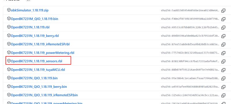

    After cloning, we enter the directory ./tuya-cloudcutter/custom-firmware and there we download the OpenBK firmware in the appropriate version needed to reprogram the thermometer.

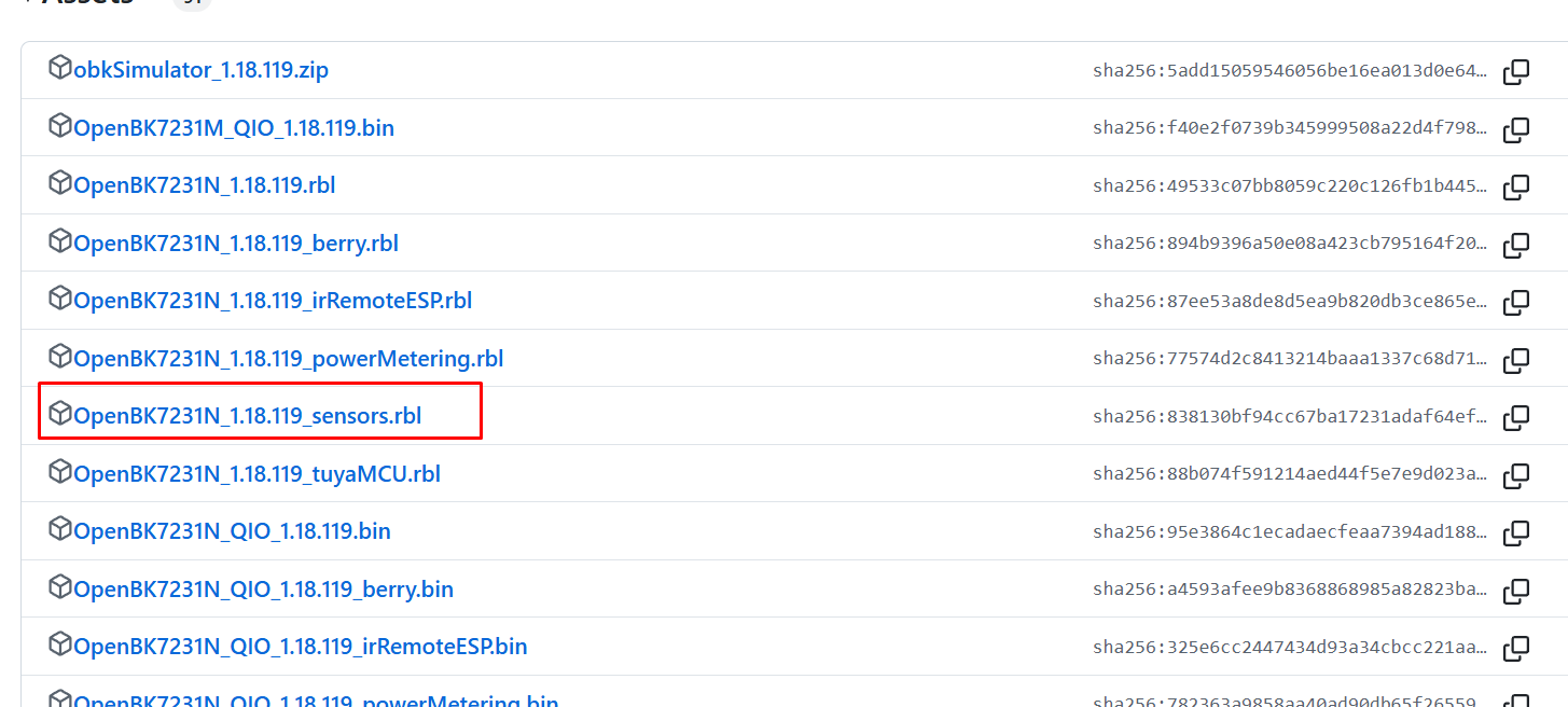

    To do this, go to the website:
    https://github.com/openshwprojects/OpenBK7231T_App/releases
    Our thermometer is on a chip BK7231N . Therefore, we must choose the firmware for this system and the version that works with Cloudcutter, i.e. described as CCtr Flash .
    We download with the wget command:
    (this is an example link, with the current fw version at the time of writing, I recommend replacing it with the current version)
    wget https://github.com/openshwprojects/OpenBK7231T_App/releases/download/1.17.379/OpenBK7231N_UG_1.17.379.bin

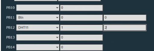

    Now you need to assign the pin configuration so that the firmware knows which pin of the Beken chip is connected to. This can be done manually, but a ready-made configuration is available for this thermometer.
    That`s why we click on "Launch Web Application" , on the page that opens in a column "Devices:" we choose ours "Chipset" That is BK7231N , and in the list below "Tuya Generic Temperature and Humidity Sensor Battery Powered SHT30" . A photo of the board will be displayed and the pin configuration will be listed. We clickon "Copy device settings" . The configuration will appear in the column on the right, scroll to the bottom of the page and click on "Save" . At this point, the LED on the thermometer housing should light up. We can close this page for now and return to the main page.
    Screenshot of the OpenBK WiFi thermometer configuration.
    We click on "Reboot" . After restarting, this page will display the SHT30 sensor readings and battery voltage.

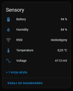

    All that`s left is to add the thermometer to Home Assistant. Then we enter the configuration again "Home Assistant Configuration" and click on "Start Home Assistant Discovery" .
    Home Assistant configuration window for WiFi thermometer with SHT30 sensor
    The device should be detected and displayed in Home Assistant.
    Screenshot of Home Assistant interface showing device information.

    Don`t be fooled by this screenshot. It was made to show the thermometer detection by HA. And I think so, there were some AAA batteries put in there back then.
    To correctly display the voltage and charge percentage, the battery calibration script "Battery_Setup 2500 4200 2.29 2400 4096" must be loaded - Battery_Setup [minbatt][maxbatt][V_divider][Vref][AD Bits].
    Screenshot of a sensor panel displaying battery status, humidity, temperature, and voltage information.

    It depends on who is measuring for what purpose... if only 1 hour is good.
    By the way, after changing the firmware, you can simply connect one of the supported temperature and humidity sensors, even the simplest DHT11, to basically any supported IoT product and then use, for example, a simple, network-powered relay module as a sensor. Of course, you must remember not to measure the temperature in its housing (because there will be some distortion), but it is still worth remembering that it is possible.
    Just set the GPIO and even with Home Assistant Discovery, HA itself will discover the presence of the sensor:
    Screenshot of GPIO configuration with DHT11 sensor settings.

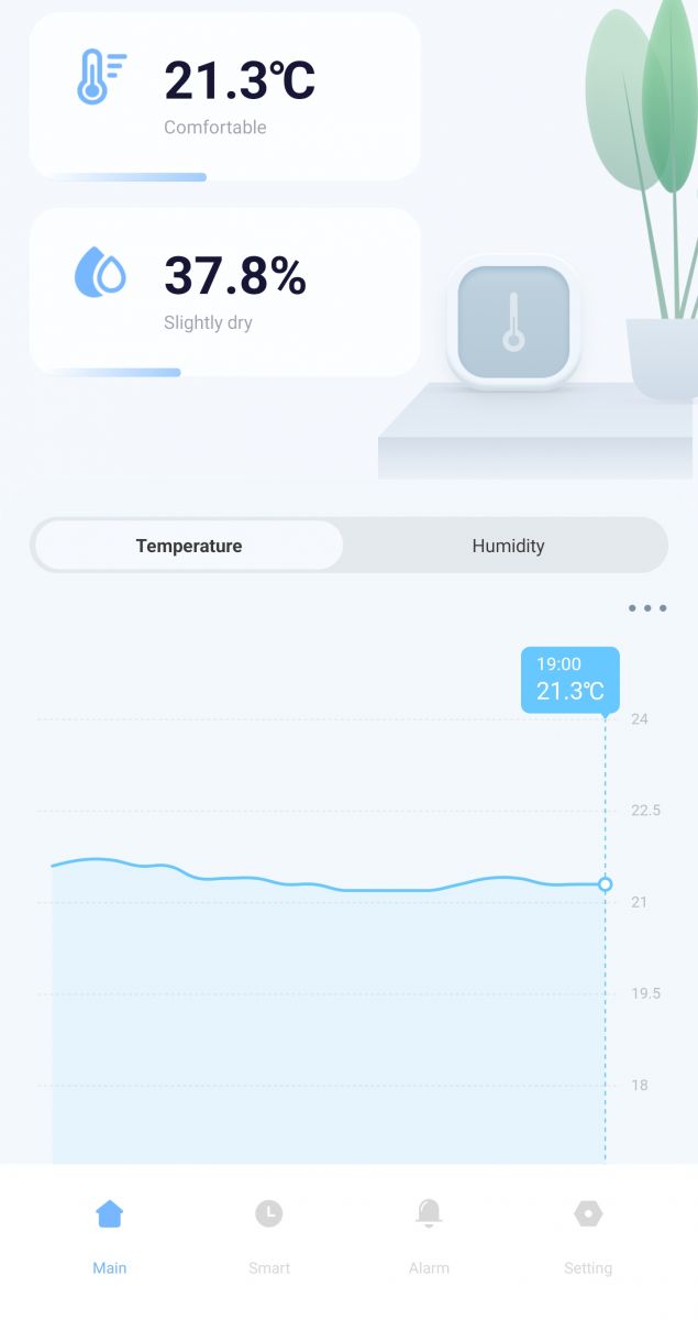

    >>20891376
    In practice, there is no problem with this
    App interface showing temperature and humidity.

    Upload version 1.18.11 - this is the latest with the SHT3X driver added.

    SHT3X is available from today in a separate package in Relases - the sensors version. This is the OBK with drivers enabled for multiple sensors but with TuyaMCU and LED disabled.
    WiFi thermometer with SHT30 - description of uploading OpenBK, integration with Home Assistant and p .
