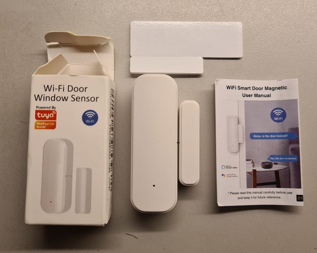

Pictures of the module:
Packaging of the Tuya Wi-Fi door and window sensor. Packaging of Tuya Wifi Door Sensor with SKU code and manufacturer information. Tuya Wi-Fi door sensor set with packaging and user manual.

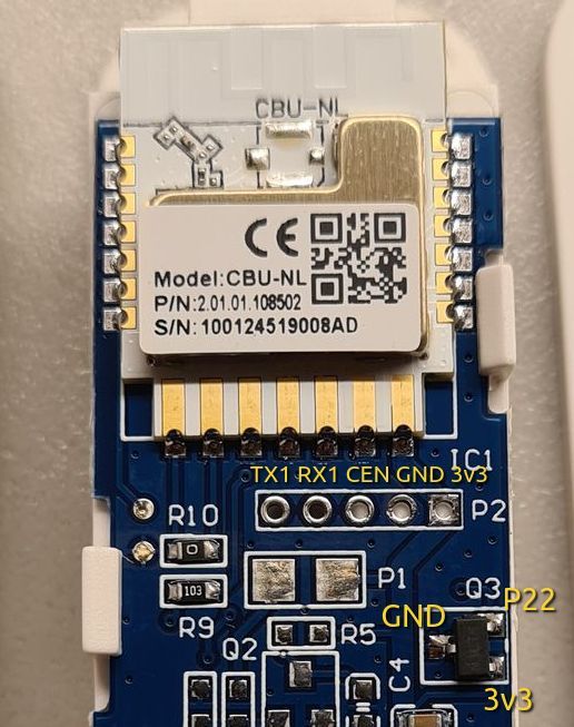

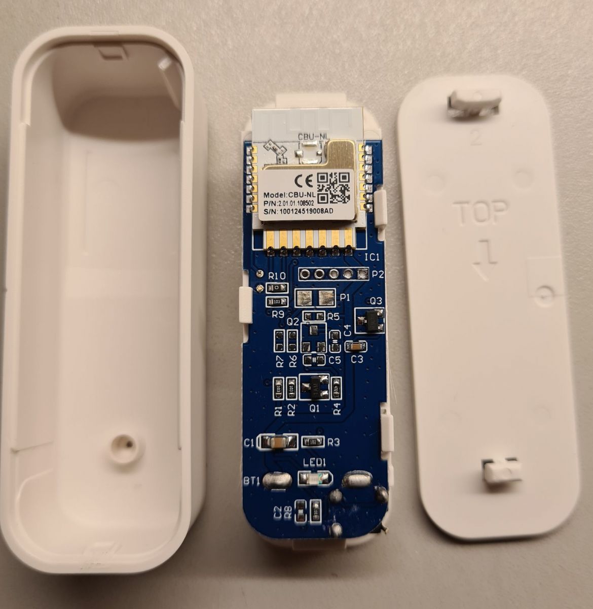

Tear-down pictures:
ONENUO WiFi door sensor module with disassembled casing ONENUO Tuya door sensor module with visible PCB layout and Wi-Fi module CBU-NL.
Pin config:
Surprisingly the push button is connected to both P14 and P16, but with different pull-ups. This might be used for some kind of debouncing or?
P15: WifiLED_n (Bat+ > R8 10k > LED1 > R3 1k > P15)
P14: BTN_n (Bat+ > R8 10k > P14)
P16: BTN_n (Bat+ > R8 10k > P14 > R9 10k > P16)
P20: BAT_rel (R1 10k - R2 10k voltage divider switched with Q3 through R4 4k7)
P22: DoorSnsrWSleep (Q3 sensor directly connected)
P23: BAT_adc (Bat+ > R1 10k > ADC > R2 10k > GND)
