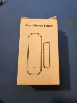

    Hi, first of all thank you for this amazing community and firmware, finally I got rid of Tuya apps thanks to OpenBK!
    I wanted to share my user experience on this device, since I successfully flashed and set up two of these recently, and they both worked exactly the same way. I believe it is the same device, no name Door Sensor (sold on AliExpress as AUBESS Door Sensor), also the one from this post: https://www.elektroda.com/rtvforum/topic3964392.html

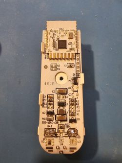

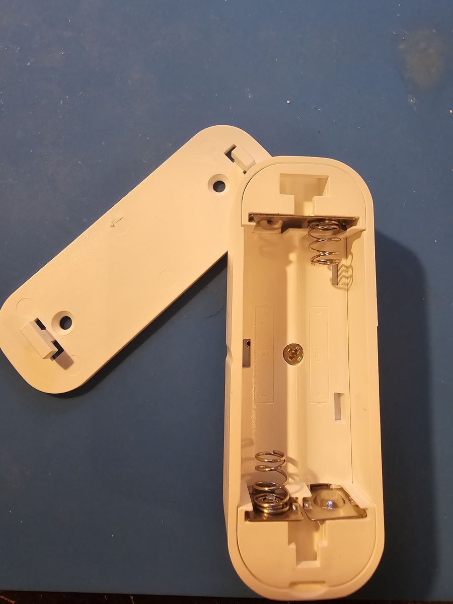

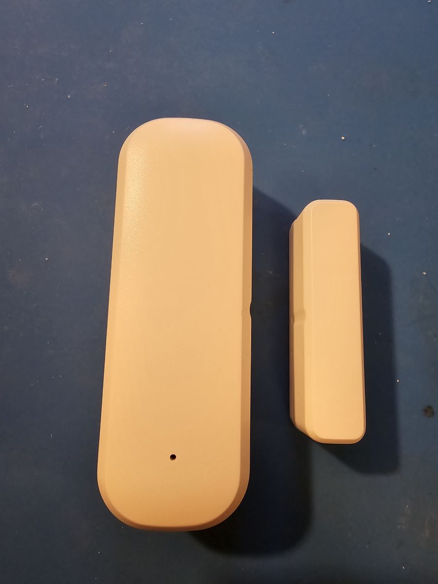

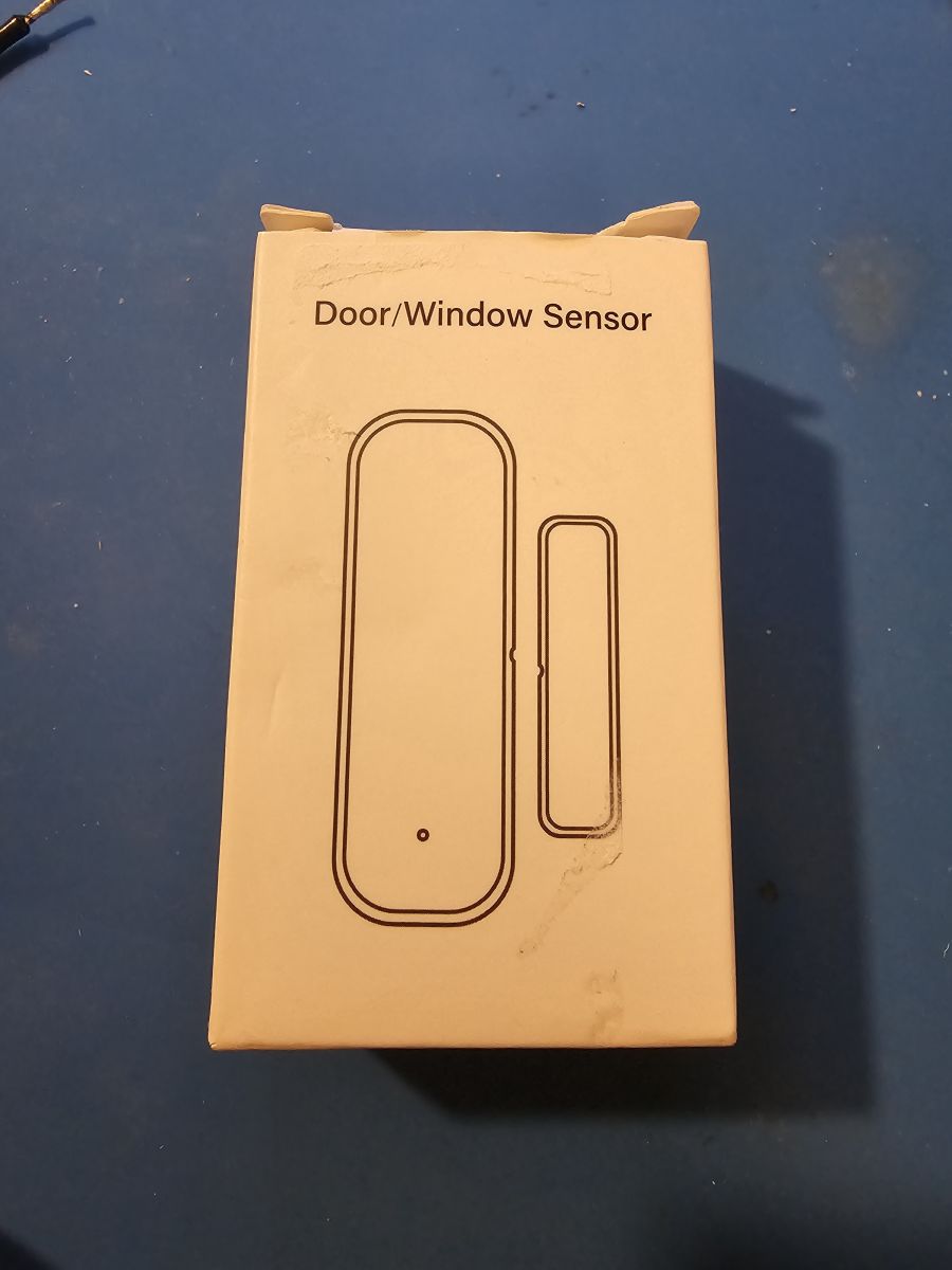

    A white cardboard box labeled Door/Window Sensor with a schematic outline of a door/window sensor set on a blue surface. Box of a door sensor with visible specifications and features printed on a light background. Opened white door sensor case with visible battery springs inside. Two white components of an AUBESS door sensor on a blue background. Door sensor PCB with electronic components and visible header pins for wire connection. Close-up of a PCB with exposed pins, a central microchip, and markings such as CBU and MK1, used in a door sensor. Close-up of a PCB with a BK7231N chip and visible pin labels.
    If you have trouble setting it up, maybe it helps to follow these steps.

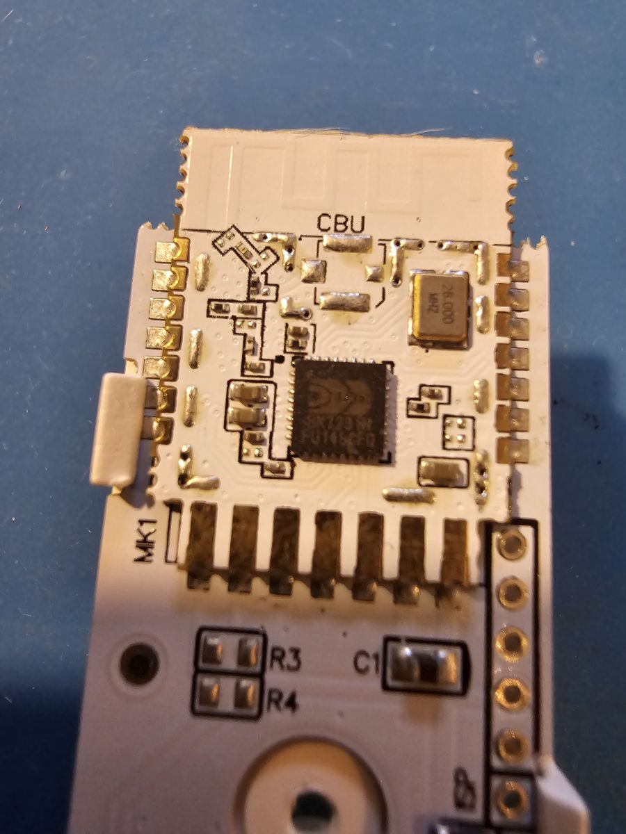

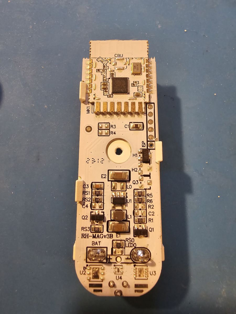

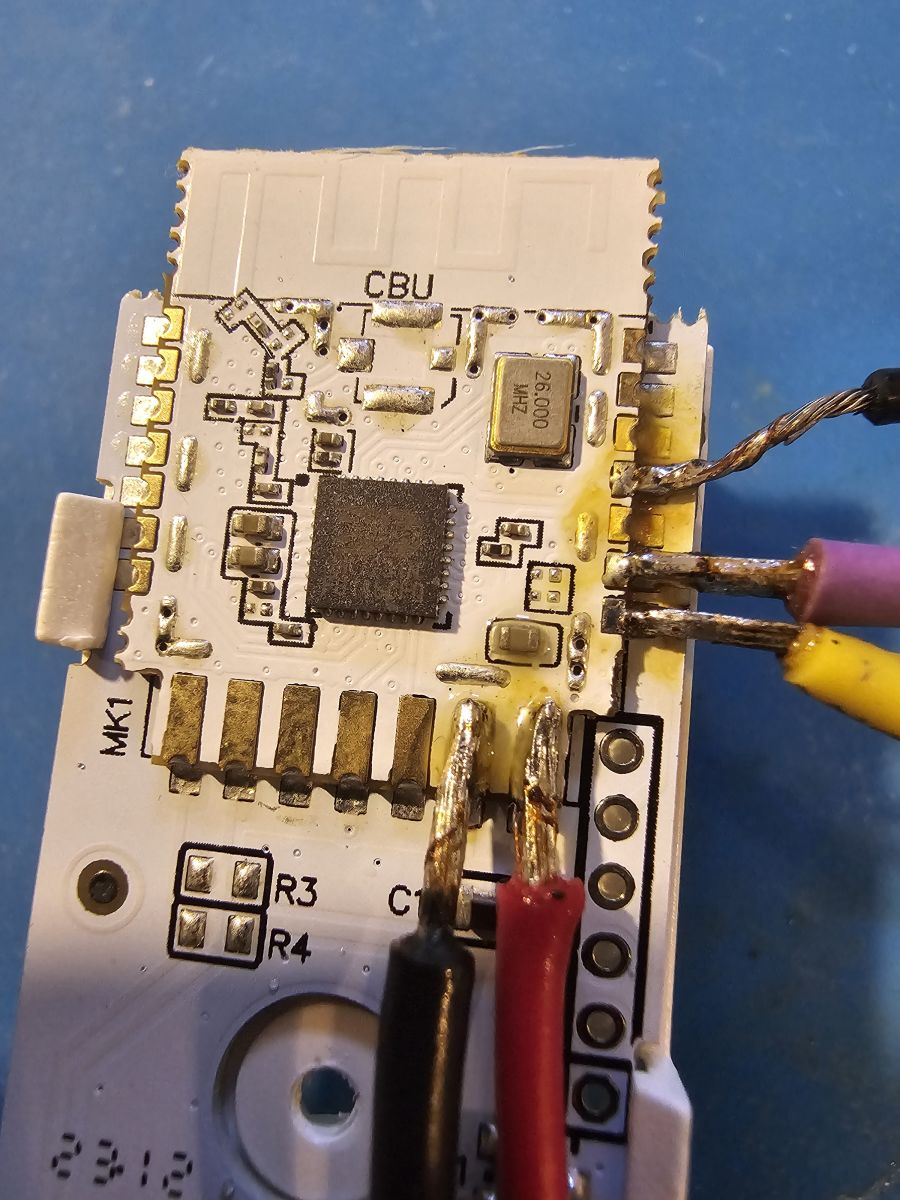

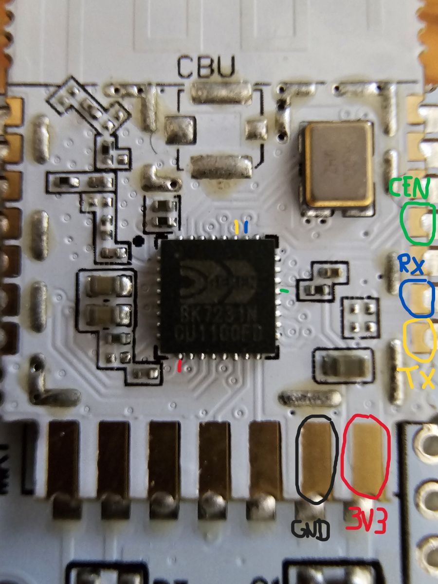

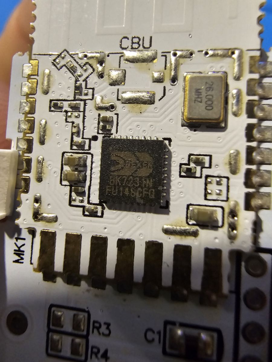

    1. prepare the Hardware and solder 5 wires to the pins, as in my picture:
    Close-up of a PCB board with pin labels. Close-up of a door sensor circuit board with soldered wires.
    2. connect 4 wires (3.3V, GND, TX-->RX, RX-->TX) to UART-USB-Module and make sure to use 3.3V power setting on your module. be careful with double checking the wires correctly connected and make sure you don't get any shorts, don't put any batteries in the device and don't plug in the USB yet

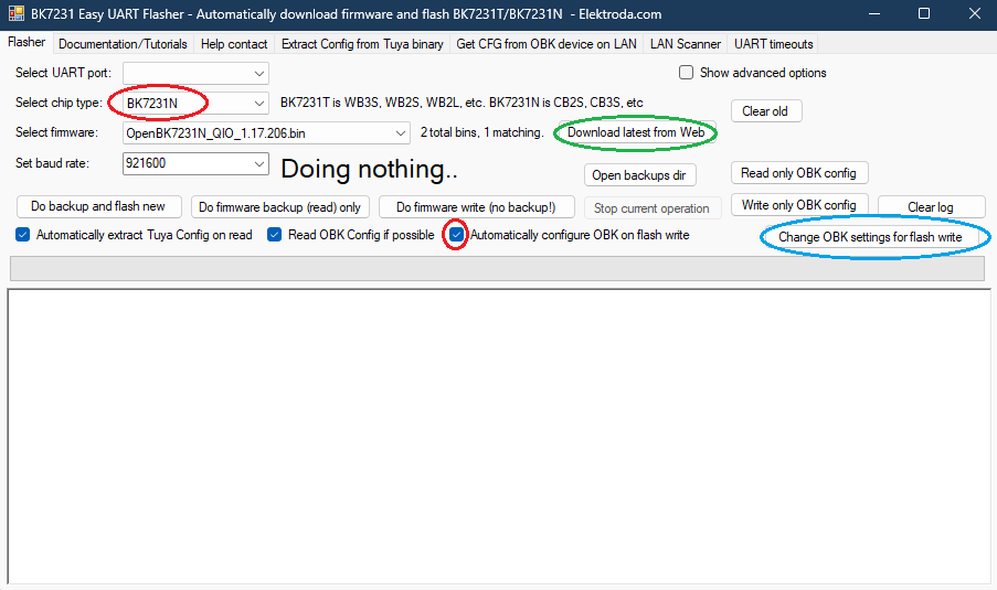

    3. open Windows bk7231flasher software, select chip type BK7231N and then click "download latest from web"
    Screenshot of BK7231 Easy UART Flasher application with highlighted options.

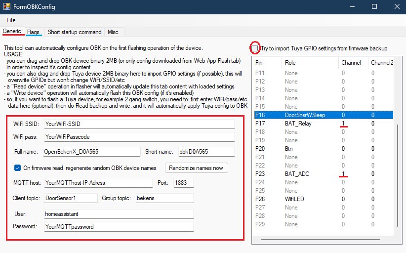

    4. this step is optional but I recommend it, since it makes everything easier. if you choose not to use this step, you will have to make all those settings via the web interface, which has the same result.
    click "change OBK settings for flash write", then fill in everything according to the screenshot. Important is to choose a different channel for the battery pins, or else the device will not work correctly. you can also predefine the flags, I chose flags 10, 11, 35 and 37, but maybe there are other settings that are useful too. Also, I chose to set a startup command [backlog dstime 30] to let the device sleep after 30 seconds from last sensor activity.
    Screenshot of OpenBK software configuration window.

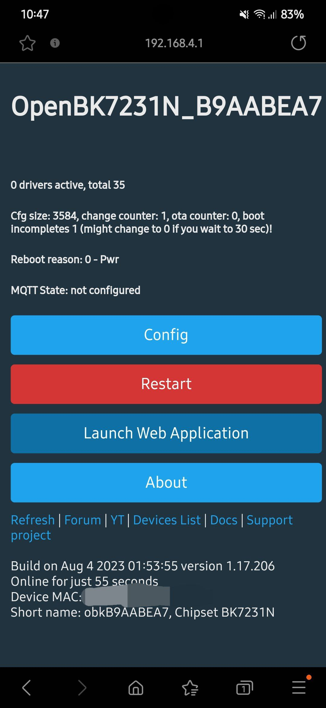

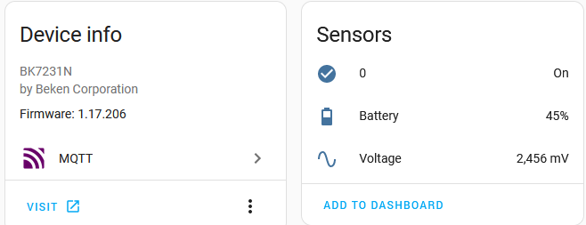

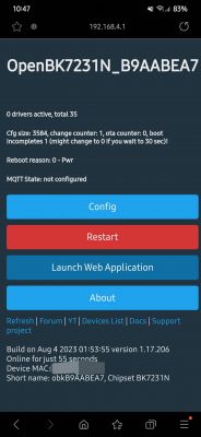

    7. If everything went well, the device should connect to your wifi automatically after powering it on (you can either connect 3.3V from your USB or insert batteries). you might wanna push the device button every 30 seconds (or move a magnet next to it) to keep the connection alive, since it will sleep after 60 seconds or 30 seconds in my case. Now check the device IP address in your router and open the web interface through the address. double check the module, name, flag, mqtt, startup command configuration and lastly, start Home Assistant discovery, done!
    Information interface with BK7231N device and sensors data.
    I hope this might be useful to someone. Have fun!

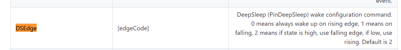

    Regarding the guide itself - I will just give here some hints:
    - make sure to configure both sensor pin and button pin. Button pin can be used to emergency-wakeup device without moving door
    - if device does not wake up from one of the states (for example closing doors wakes it up, but opening doesn't), try entering DSEdge setting in short startup command or autoexec.bat, there are 3 possible options for that, see our docs
    A table excerpt from documentation describing the DSEdge parameter for DeepSleep mode.
    Our docs:

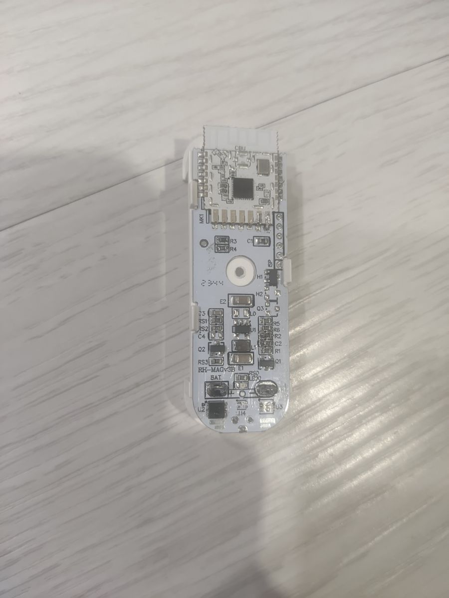

    I have a similar sensor, but a little differently organized hardware-wise (different BK pins). I've already arrived at what and how and it works nicely, but.....
    I wanted to use the sensor to report the opening of a letterbox. Unfortunately, the mailman opens the box for too short a time for the sensor to report anything. After a deep sleep, it needs some time to connect. Is there any way to set a flag that there was a change in input state after waking up and before connecting?

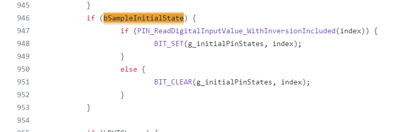

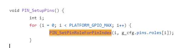

    I am confused because I am sure that we've fixed that issue with @nihildiximus and that the door sensor indeed reports the state from before it connected to MQTT.
    See:
    C code snippet about publishing initial door sensor states using MQTT.
    After getting WiFi and MQTT, for the first 3 loops (first 3 seconds), it force-publishes the initial states of pins which is queried in new_pins.c ...
    C code snippet setting GPIO pin roles Code snippet in C programming language with highlighted variable bSampleInitialState.
    Maybe I need to check it myself, find some sensor...
    @woszu - what about just reporting a custom value on every reboot? Doing a publish command or a SendGET in autoexec.bat?

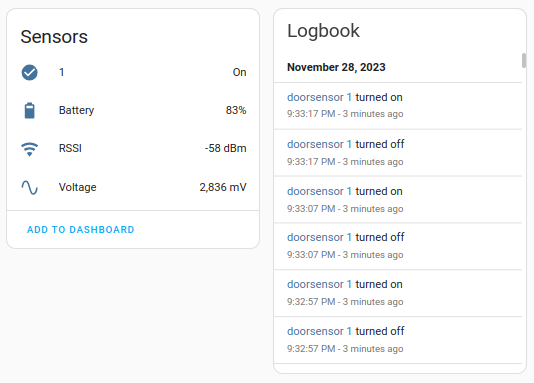

    #16 20835517
    emrecetinkaya86
    Level 4  
    Posts: 8
    Hi all,
    First of all, thank you all for sharing information here. It is very much appreciated!
    I have the same device and successfully burned the firmware on it. I applied the template and tried all the pin configurations described here, but no matter what I do, I get the following result:
    - On the index page, the sensor value doesn't change no matter what I do (changing magnet positions).
    - In HA, the sensor sends a "turned on/turned off" message every 10 seconds while it's powered on, by itself, without any change with the magnet.
    It seems like the pin number 16 may be wrong, or what am I missing?

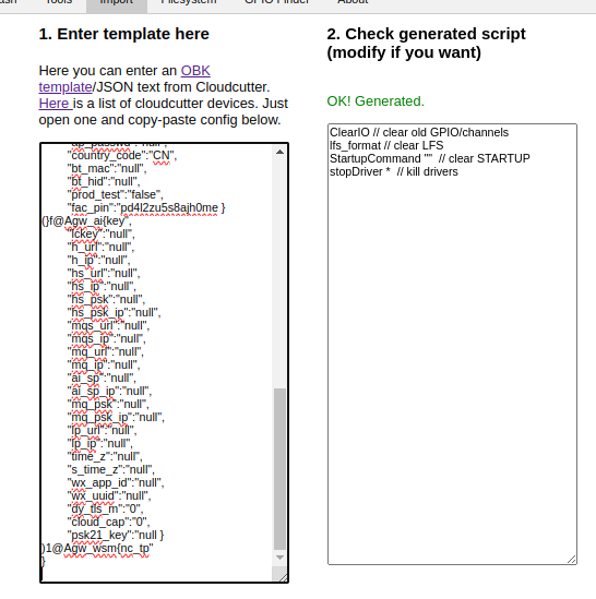

    Maybe they changed something., Try to extract the template (but disable door sensor driver for that time):
    https://www.youtube.com/watch?v=WunlqIMAdgw
  • #18 20836473

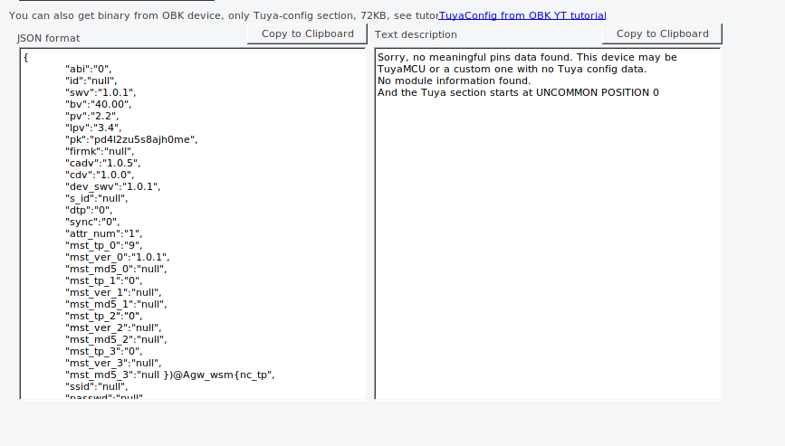

    emrecetinkaya86
    Level 4  
    Posts: 8
    Hi,
    Thanks for the answer. I've just tried but from binary, it says no meaningful data:
    Screenshot showing meaningless JSON data on the left and an error message on the right.
    And when I paste JSON in web app:
    Screenshot of a web application with a JSON converter in OpenBeken.
    I'm stuck... This is my first time with OpenBeken and I don't want to give up...
  • CBU-NL uses hall sensor on pin 22
    #19 20837792
    emrecetinkaya86
    Level 4  
    Posts: 8
    >>20835677

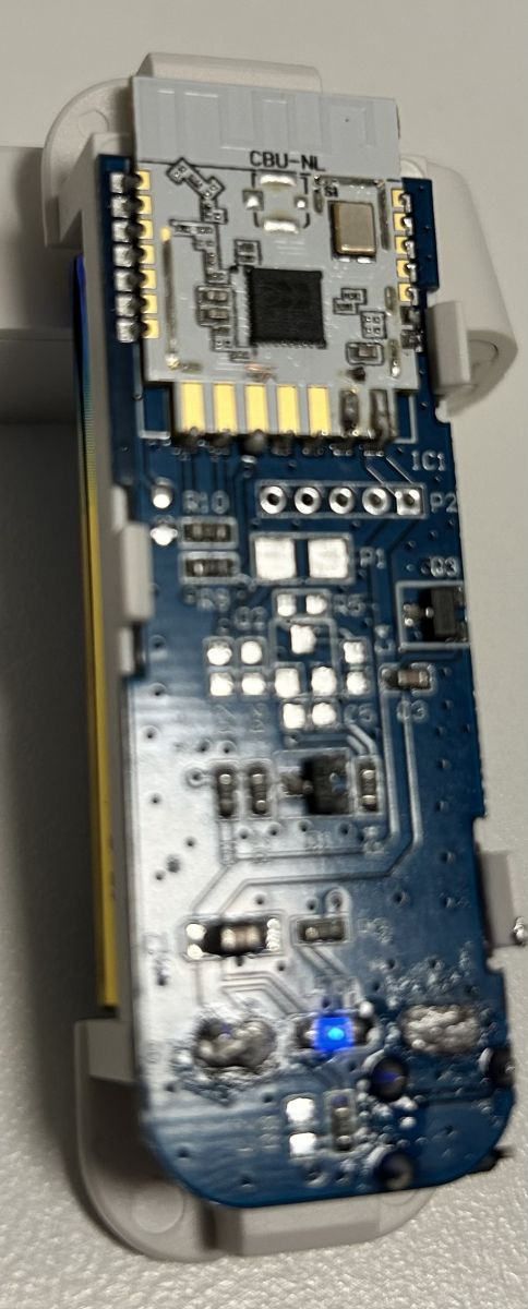

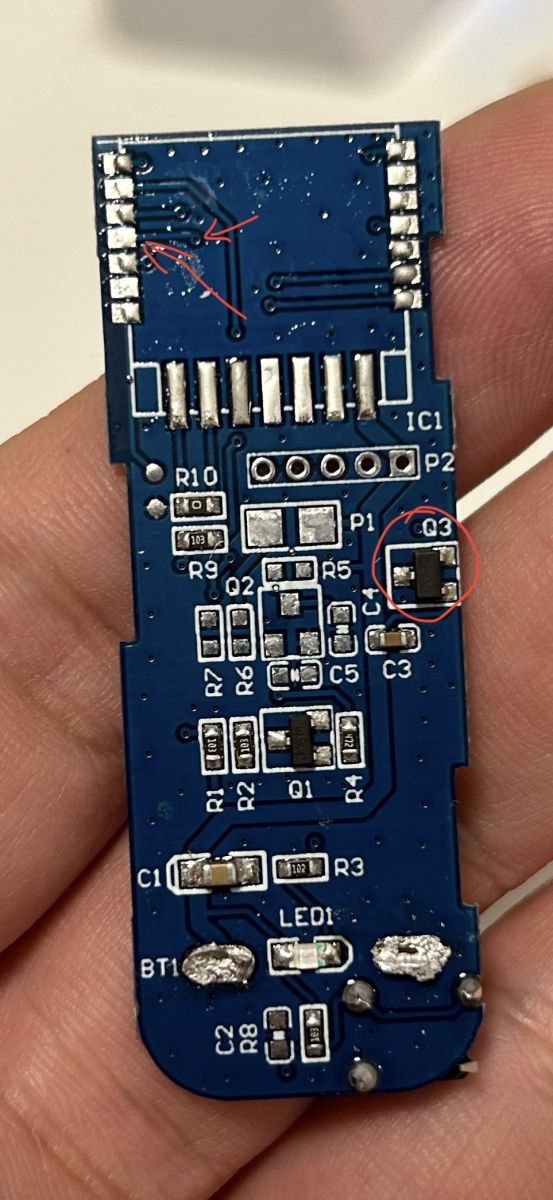

    Hi @p.kaczmarek2 and all,
    Yes they changed something, which is the pin number of hall effect sensor. At first I'm happy that I'll contribute to the community with this experience for the first time, with my pleasure! What to do to add this change what I explained below to the templates?
    After looking twice, I've recognized that the module on the device is CBU-NL instead of CBU. This is how the module looks like:
    Close-up of the CBU-NL electronic module with visible connectors and components on the circuit board.

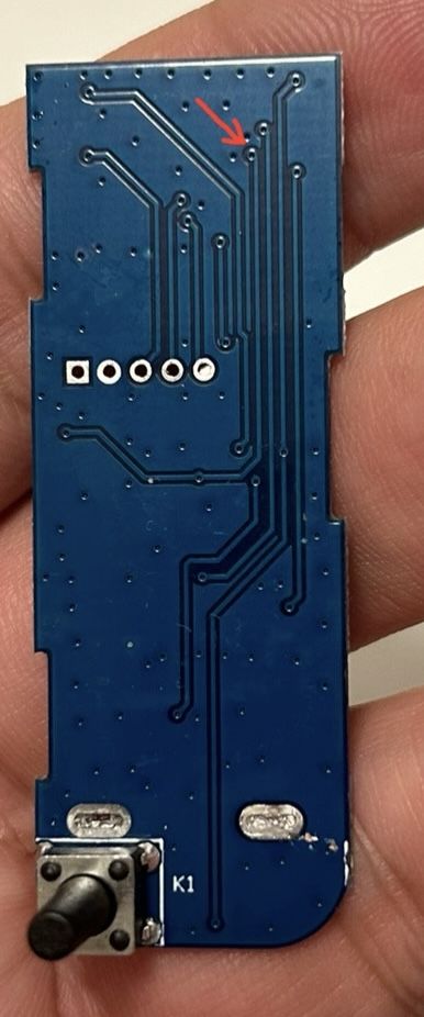

    Also, the board is different than the one in this topic and others in the forum. I've traced the hall effect sensor pin from it to module pin and it corresponds to pin 22, instead of 16! And it's pulled down.
    Image of a printed circuit board (PCB) held in hand with marked components. Photo of a circuit board with a marked pin.
    Then I've changed my pin configuration (other pins are still the same, only the hall effect sensor pin number has been changed):
    Screenshot of pin configuration for a module with channel type settings.
    I've also changed the channel type of channel 0 which hall sensor pin included to "openclosed", so I can see on the index page the status more clearly.
    The only thing remaining now is, when the module is awake after pin change, it sends sensor turned on/off messages every 10 seconds and without any change. And the sensor value came automatically doesn't show the correct value, I've copied sensor yaml lines from OpenBeken web to configuration yaml in HA and it shows the correct value.
    Screenshot of a user interface displaying sensor information and an event log.
    And my last question is, when the module wakes up, it stays awake for at least a minute and then sleeps. Is there any way to set it up like "do your job and sleep"? Sorry again if I ask something which was explained before, as I'm a newbie.
    Enjoy
  • #20 20837805
    Posts: 14754
    Rate: 12875
    Thanks for the info. Can you include template from the Web App so I can add it to devices list?
    I think you can set a DSTime variable to adjust the time how long it's up.
    Regarding on and off messages, is the status read in the OBK panel correct?
    PS: I think you can change channel name from that "1" string to any other with setChannelLabel command

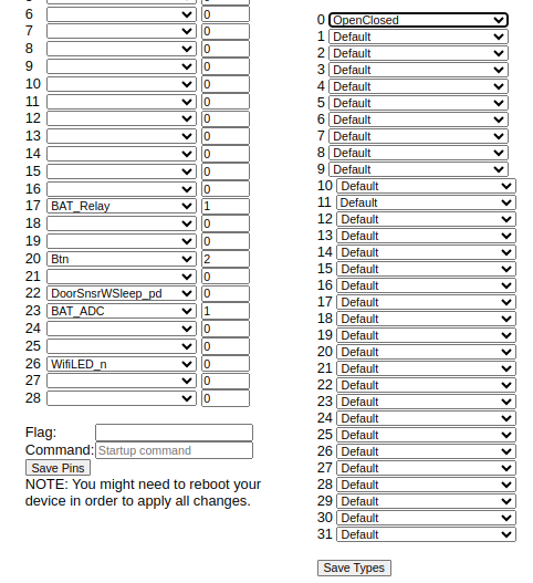

  • Battery ADC and relay needed separate channels
    #22 20881128
    Xinayder
    Posts: 24
    I have a very similar sensor I bought from AliExpress, branded as AUBESS: https://www.aliexpress.com/item/1005004699337230.html
    I used the Windows flasher tool and it worked perfectly, it even loaded the configuration retrieved from the original firmware.
    I also checked the door sensor guide on the forums and had to do a quick tweak on my sensor. By default, the battery relay/adc were set to the same channel as the door sensor, so whenever the HAL sensor was triggered, it would go to the opposite state because of the relay. To fix this, I set the battery ADC and relay to a different channel.
    The HAL sensor pin was set to DoorSnsrWSleep (no pull down or pull up), as instructed in the guide: https://www.elektroda.com/rtvforum/topic3960149.html
    I also enabled the quick wifi connect flag to prevent waiting a long time to broadcast the values. This is my template:

      "name": "AUBESS Smart Wifi Door/Window Sensor (no TuyaMCU)",
      "chip": "BK7231N",
      "board": "TODO",
      "flags": "1152",
      "keywords": [
        "TODO",
        "TODO",
        "TODO"
      "pins": {
        "16": "DoorSnsrWSleep;0",
        "17": "BAT_Relay;2",
        "20": "Btn;1",
        "23": "BAT_ADC;2",
        "26": "WifiLED_n;0"
      "command": "",
    EDIT: I've also attached the original firmware extracted from the sensor.
    • readResult_BK7231N_QIO_doorsensor_tuya_2023-28-12-18-12-52.bin (2 MB) You must be logged in to download this attachment.

    I also got a similar sensor, the PCB looks the same, but with different pin configuration so created a separate topic for it:
    [BK7231N CBU-NL] ONENUO Tuya Wifi Door Sensor - 19JWT
    The HAL sensor has neither pull-up nor pull-down, battery is read through a switchable voltage divider like above.

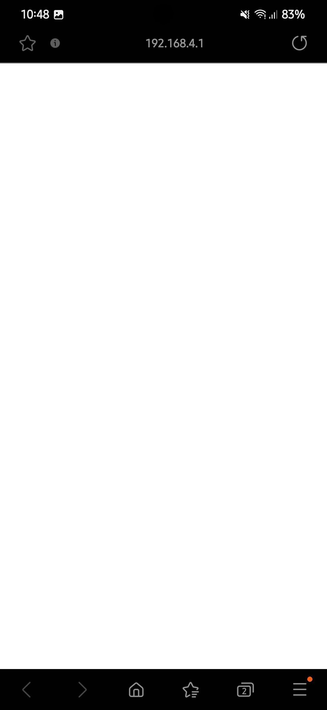

  • Configuration not saved after BK7231N flash
    #26 20968460
    pincopallino1010
    Posts: 22
    >>20683982
    Hi @auntlydia @p.kaczmarek2 (Sorry for the tag again). I flashed the firmware on one of these devices by following this guide (without entering any configuration via the tool) and unfortunately I can't figure out why the device seems to be "not working."
    It boots but whatever configuration I enter (pin, flag, wifi...) this is not maintained and also the web application page does not load.
    Screenshot of a web browser showing a blank page at the address 192.168.4.1.
    The screen I end up in when I connect to the device is as follows (photo).
    Screenshot of the OpenBK7231N device web interface showing configuration options.
    Even if I enter the configurations through the tool nothing seems to change, plus the led doesn't seem to light up anymore...
    Can anyone help me? Thanks!
  • #27 20968463
    Posts: 5206
    Help: 446
    Rate: 914
    I'd start by flashing an up-to-date version of OBK. The one in the screenshot is from August.
  • #28 20968641
    Posts: 14754
    Rate: 12875
    Wait, do I understand correctly, you haven't configured it? I can see no drivers running, nothing is set... you need to configure it first, I guess.
  • Persistent config reset after reboot on BK7231N
    #29 20969015
    pincopallino1010
    Posts: 22
    @divadiow I had already tried to install the latest version but it gave me the same problems, so I tried to install the one that is used in the guide
    @p.kaczmarek2 Initially I followed the procedure from top to bottom (entering the configurations via the tool) but I was having the same problems, so I thought of entering them "by hand" after flashing the firmware but nothing... for example if I set the wifi network to connect to it doesn't work when rebooting and it keeps creating its wifi to connect. Same with the pins, every time I reboot the device all the fields reset.
    What does it mean: "0 drivers active, total 35"
    And: "boot incompletes 1 (might change to 0 If you wait to 30 sec)!"
    Maybe they are the problem but I really don't understand what is going wrong....

    Circuit board with visible electronic components.
    Hardware mod, U2 is CHT8305. Now waiting for simultaneous pin and timer deep sleep support
    P7->CHT8305_SCK
    P8->CHT8305_SDA
