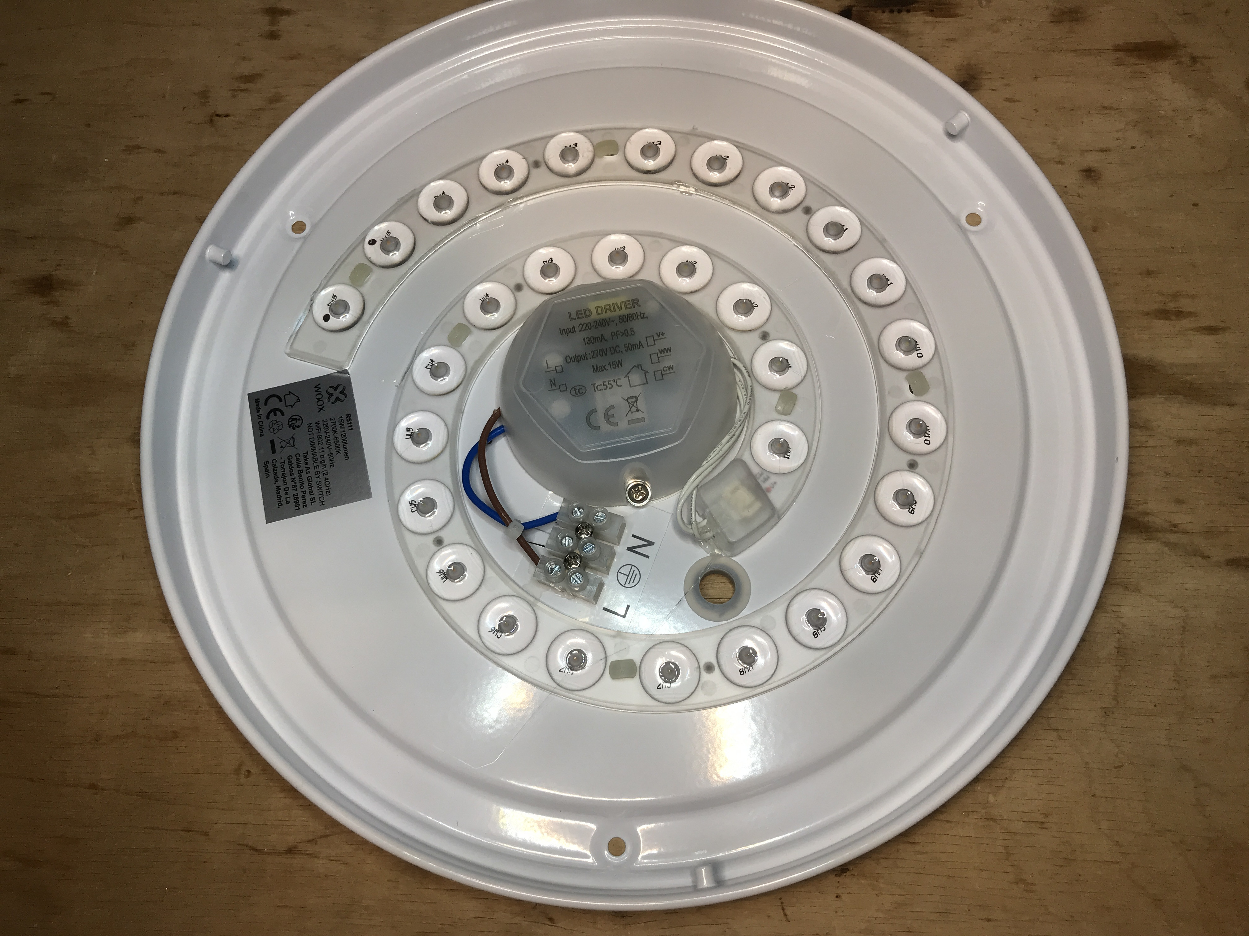

. Interior of the lamp The cover simply unscrews:
View of the interior of the Woox ceiling lamp with a spiral LED arrangement. White, round ceiling lamp Woox on a wooden surface
LEDs are arranged in spirals, inside is packed their controller and power supply in one:
Interior of Woox ceiling lamp with controller and power supply. View of the Woox ceiling light with specification label.
Everything is nicely described here, 230V AC input and V+ and WW (Warm White) and CW (Cool White) output, the manufacturer also declares PF greater than 0.5.
