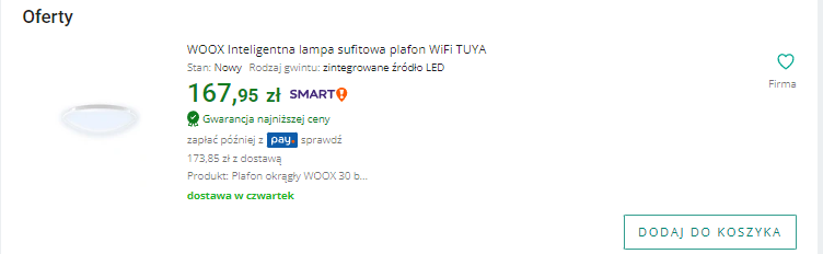

    Purchase the lamp and contents of the kit The lamp can be purchased for about PLN170. Normally it works with the Tuya app, but to change its firmware. Below are screenshots from the listing:
    Offering of Woox ceiling light with WiFi on an online store page.

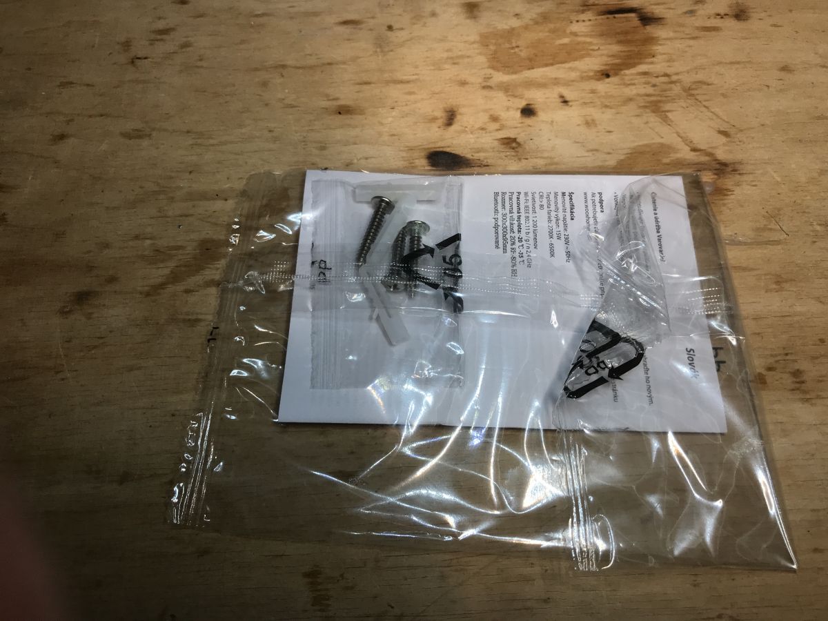

    Included in the kit, there are screws and pins for mounting:
    Ceiling lamp Woox mounting kit in transparent packaging.

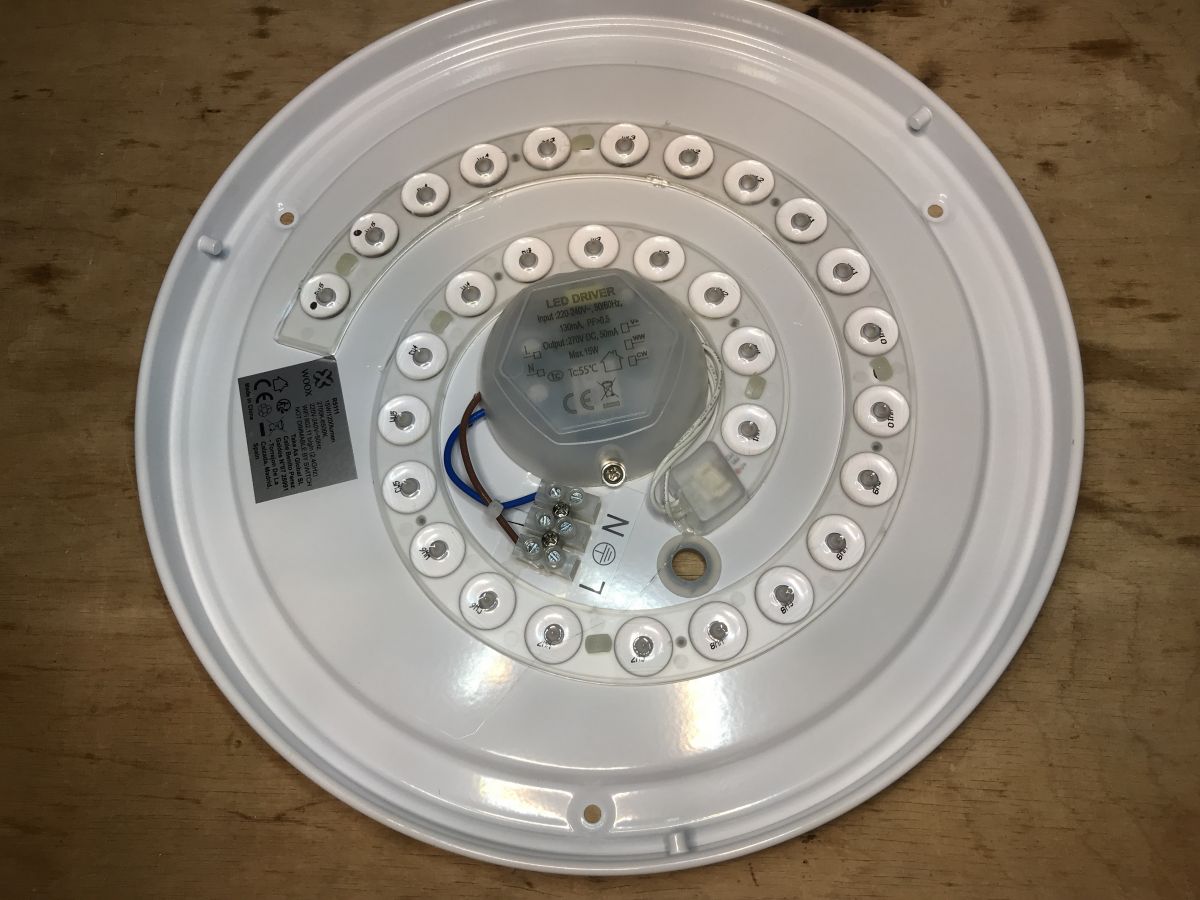

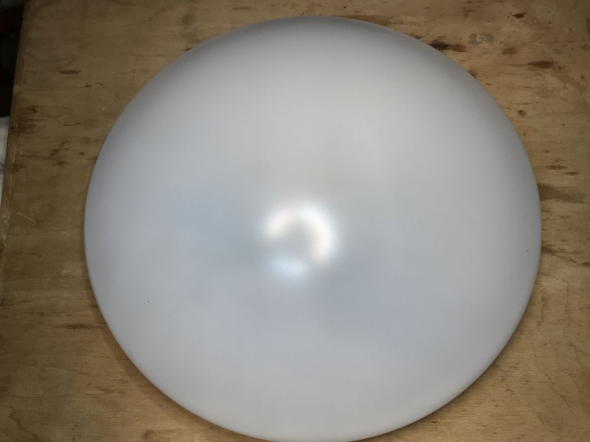

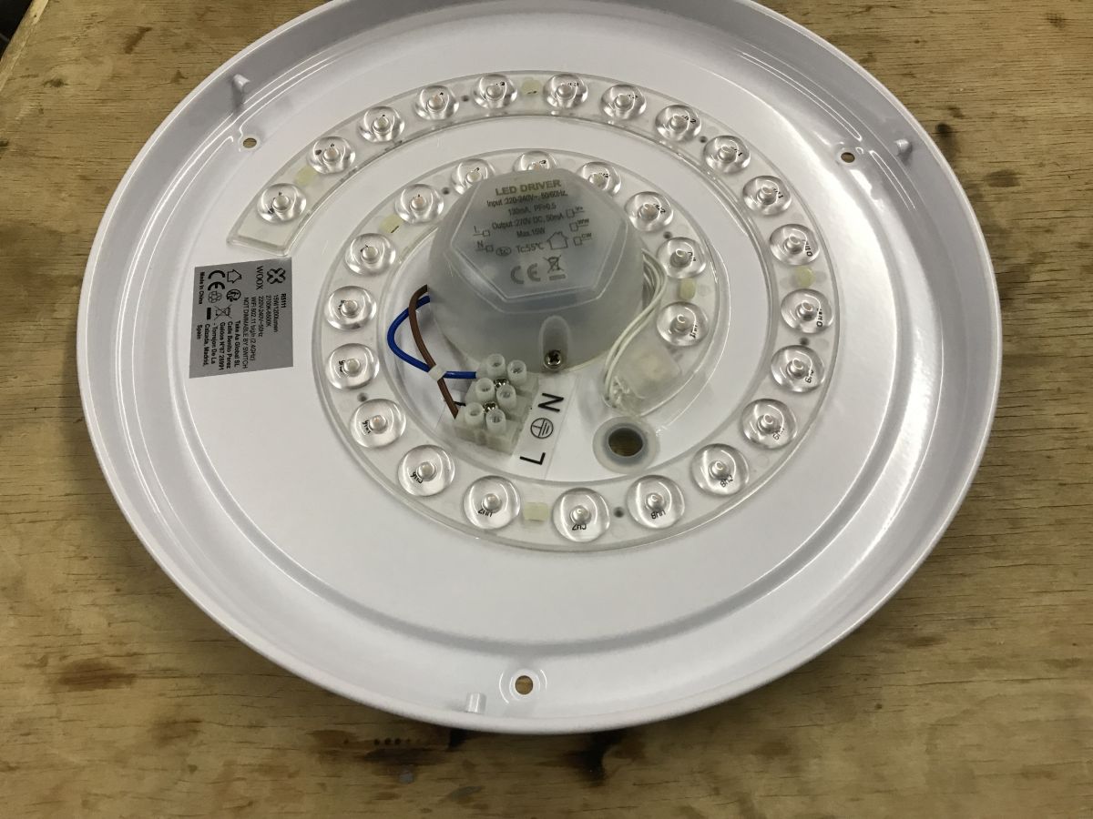

    . Interior of the lamp The cover simply unscrews:
    View of the interior of the Woox ceiling lamp with a spiral LED arrangement. White, round ceiling lamp Woox on a wooden surface

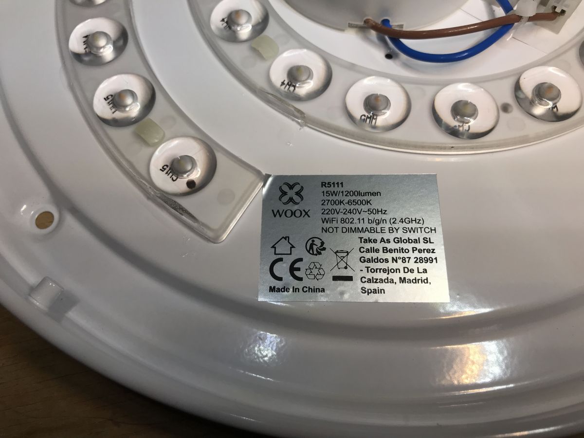

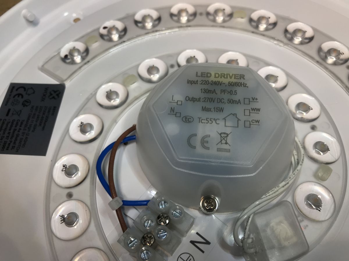

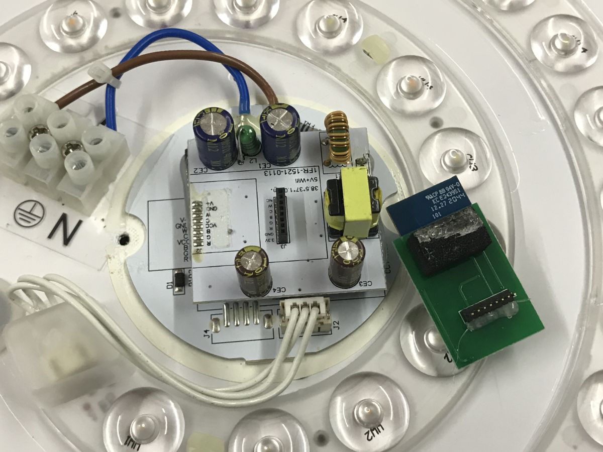

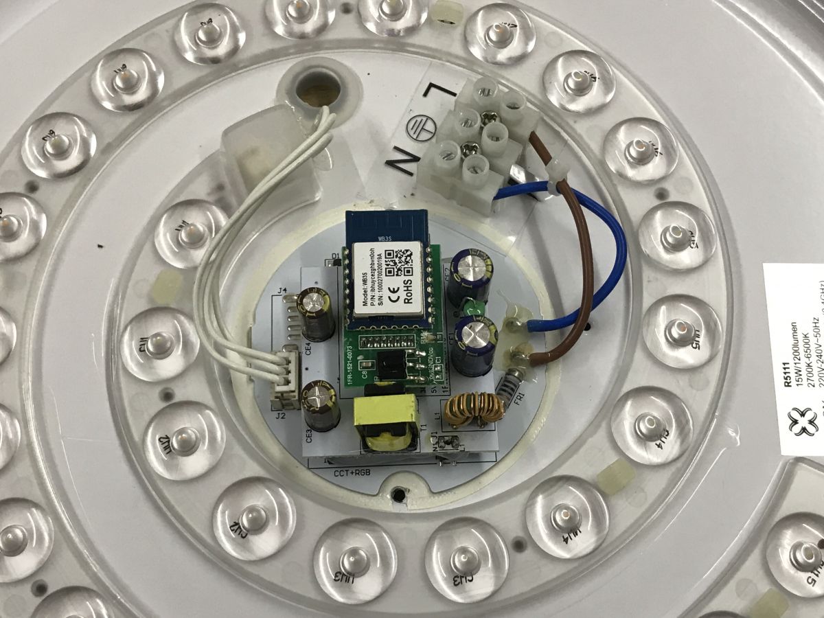

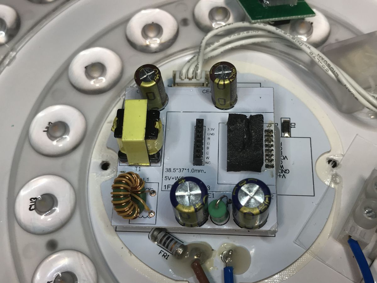

    LEDs are arranged in spirals, inside is packed their controller and power supply in one:
    Interior of Woox ceiling lamp with controller and power supply. View of the Woox ceiling light with specification label.
    Everything is nicely described here, 230V AC input and V+ and WW (Warm White) and CW (Cool White) output, the manufacturer also declares PF greater than 0.5.

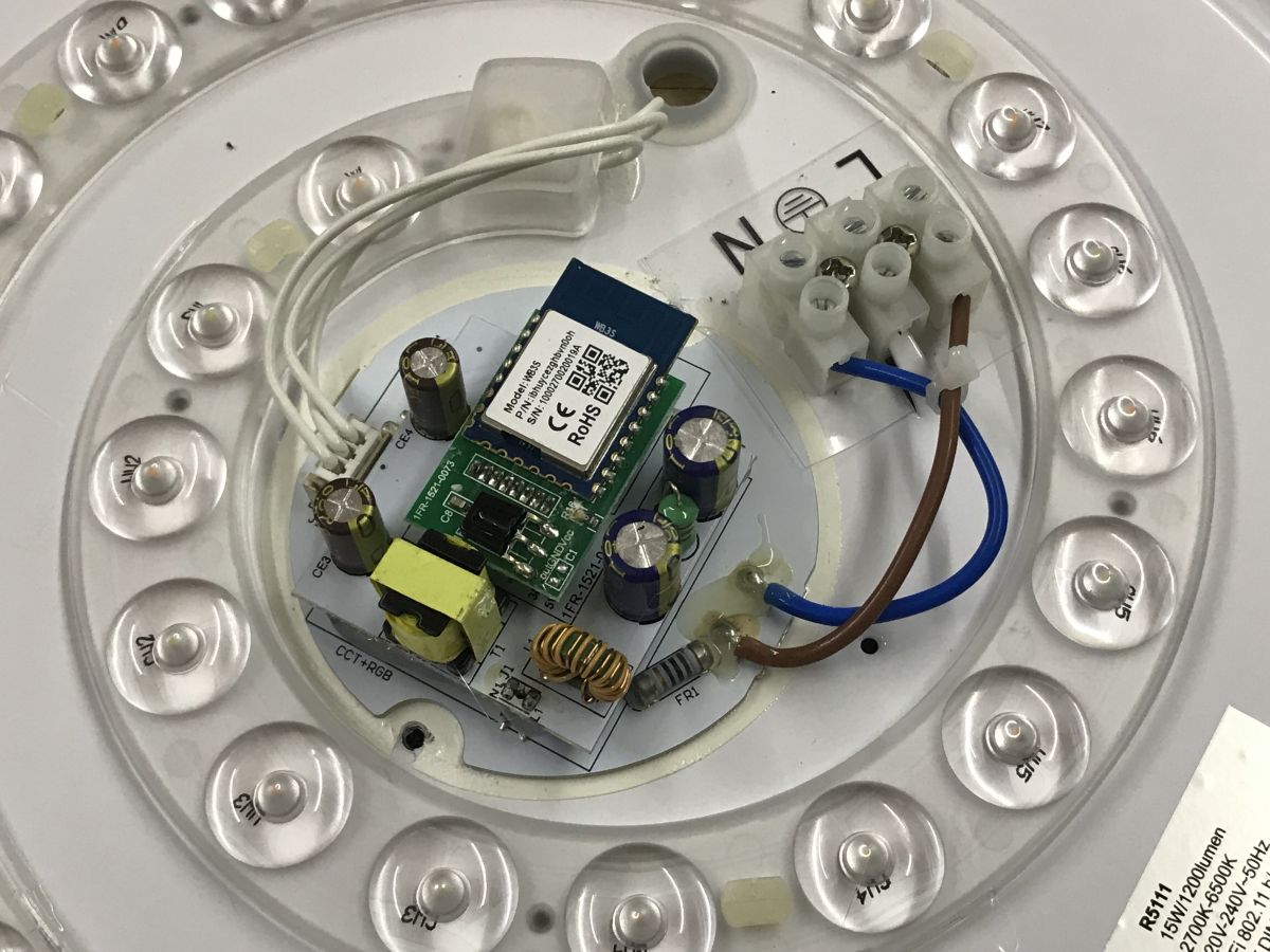

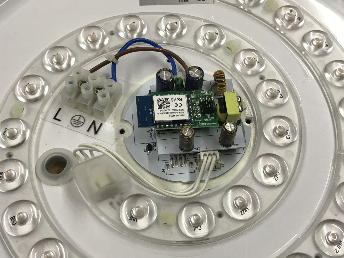

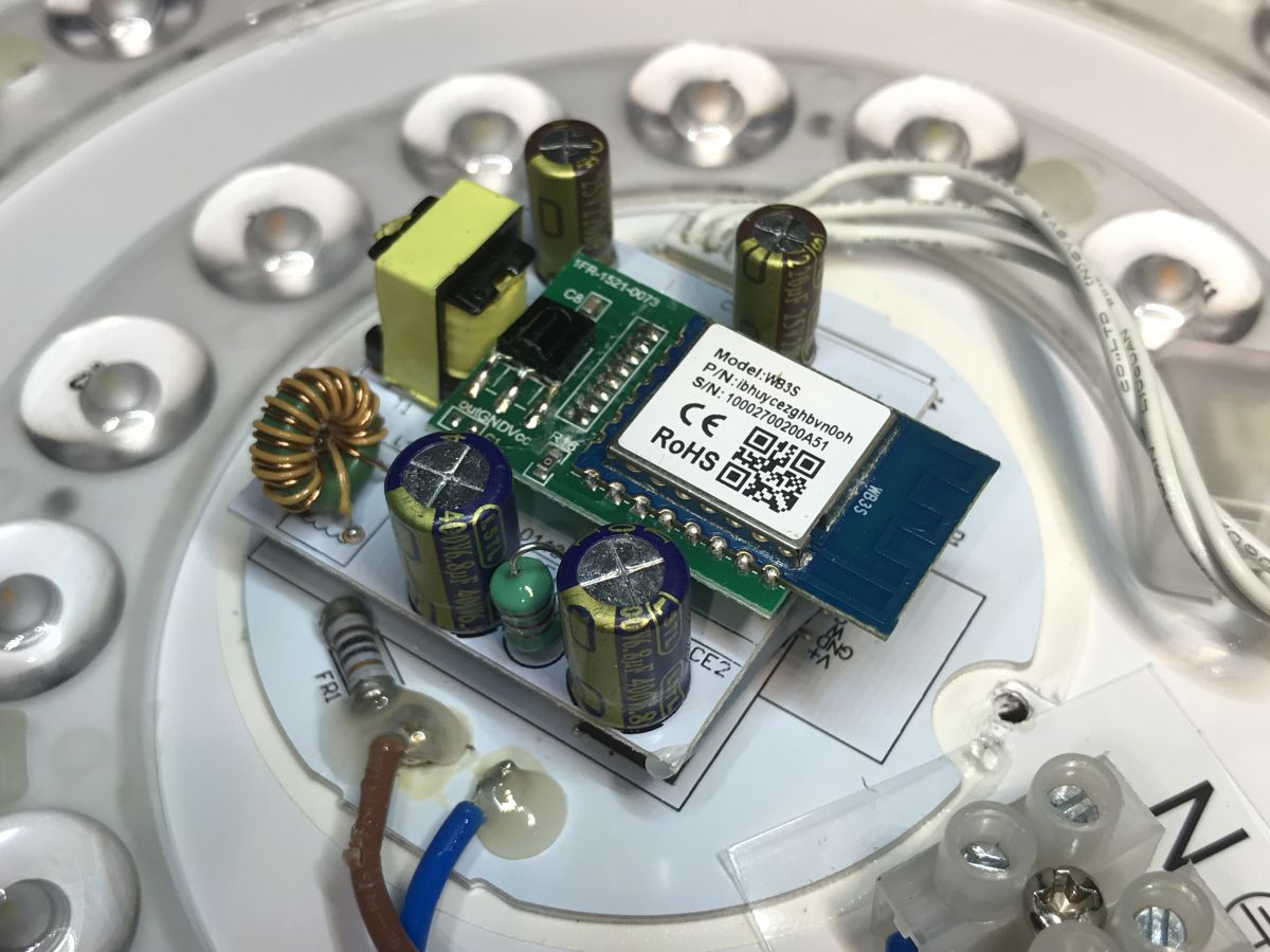

    Let's turn the screw to see the WiFi module:
    Close-up of the inside of a Woox LED lamp showing the WB3S WiFi module and electronic components.
    The whole thing is based on WB3S, or BK7231T:
    https://developer.tuya.com/en/docs/iot/wb3s-module-datasheet?id=K9dx20n6hz5n4

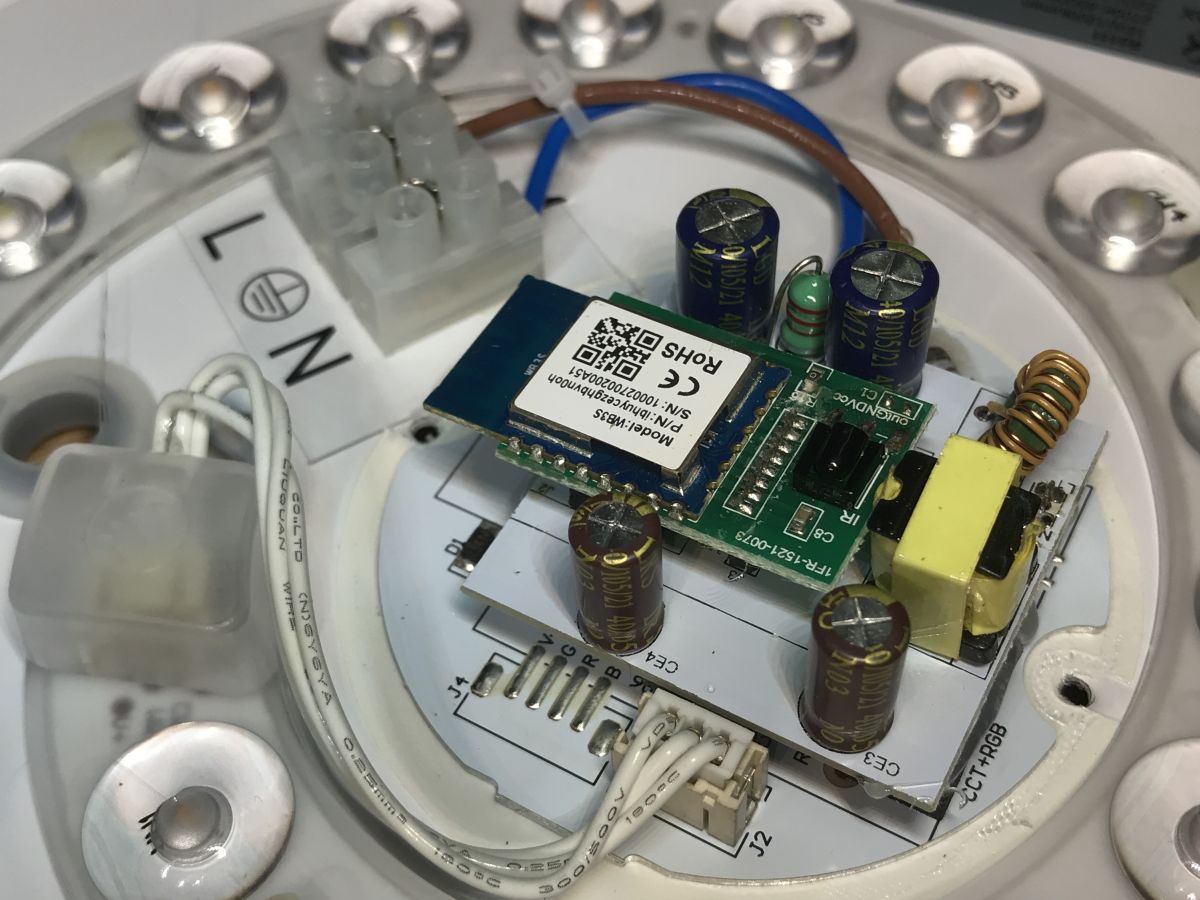

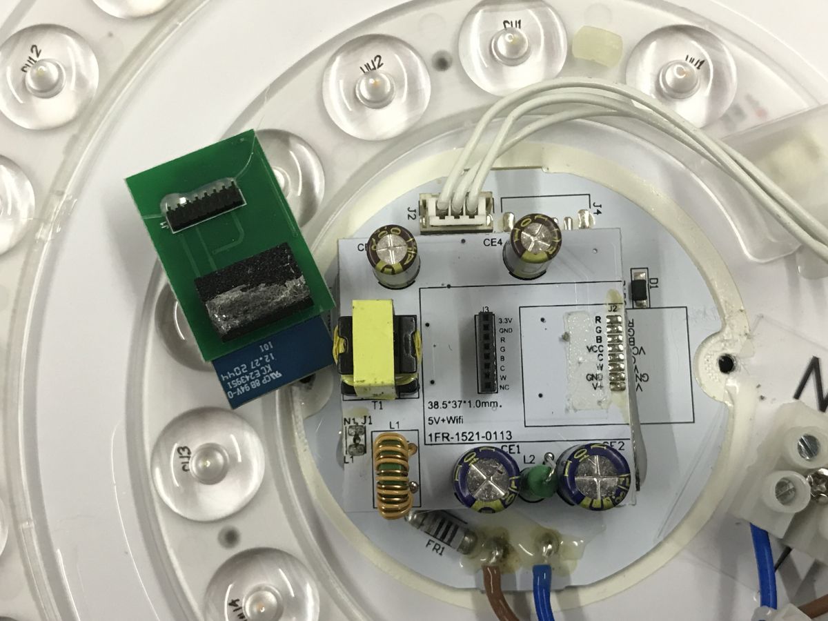

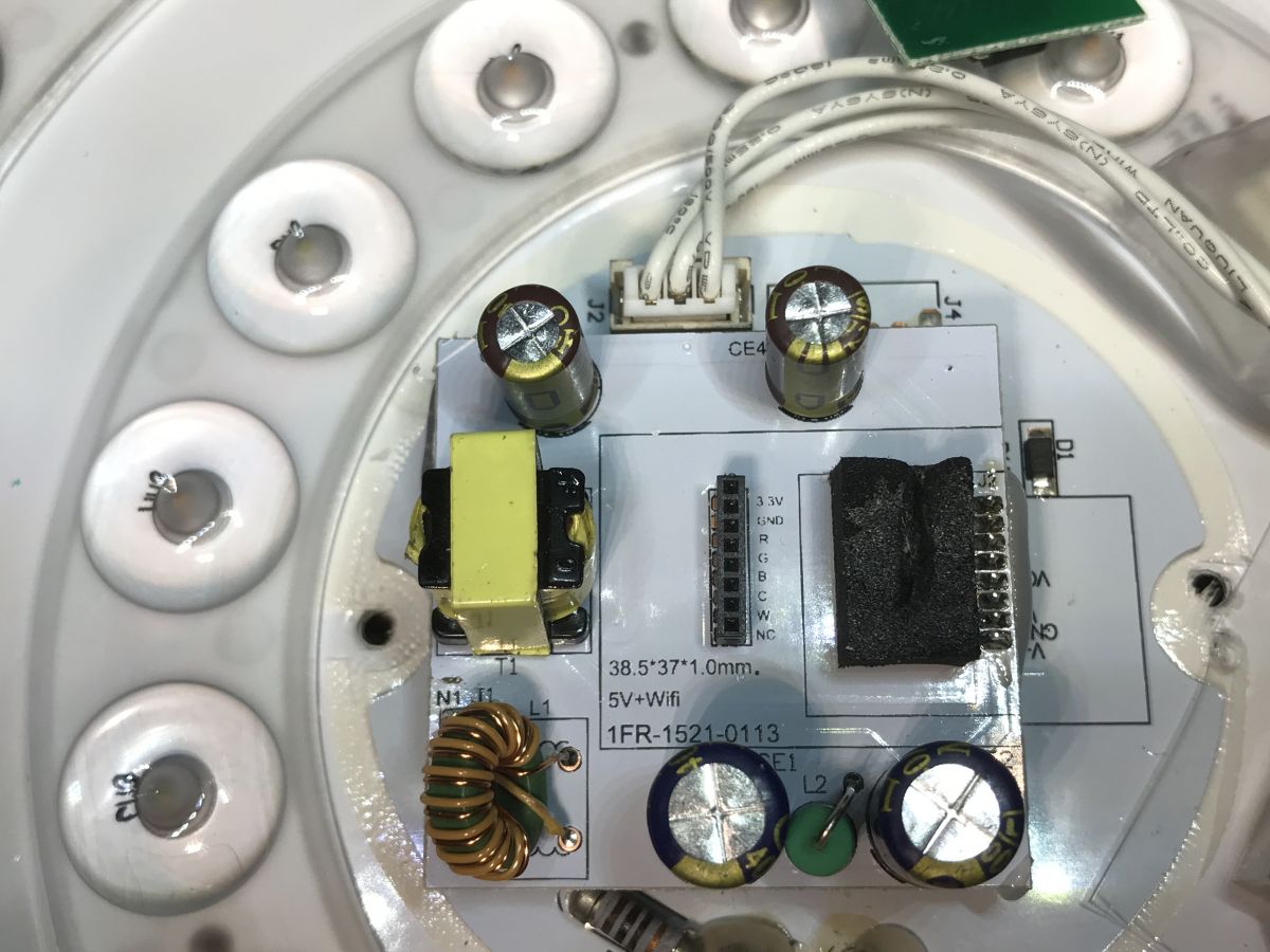

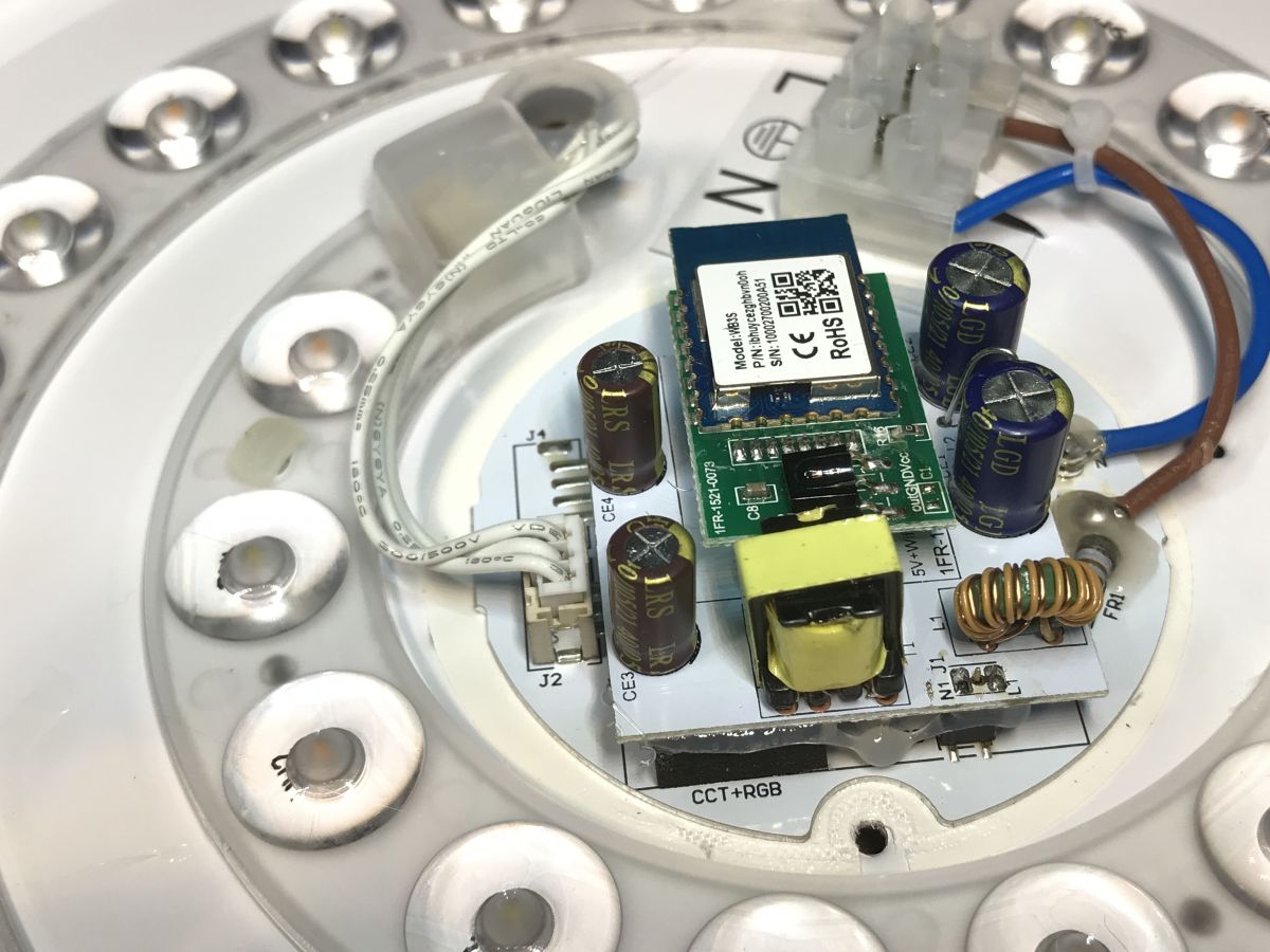

    You can also see the IR receiver and the power supply circuit. This is probably a flyback converter. Additional photos:
    WB3S WiFi module and capacitors inside a ceiling lamp. Interior of the Woox ceiling lamp showing the WiFi module and electronic components. Interior of Woox ceiling lamp with WiFi module.

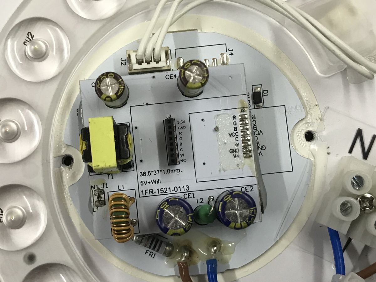

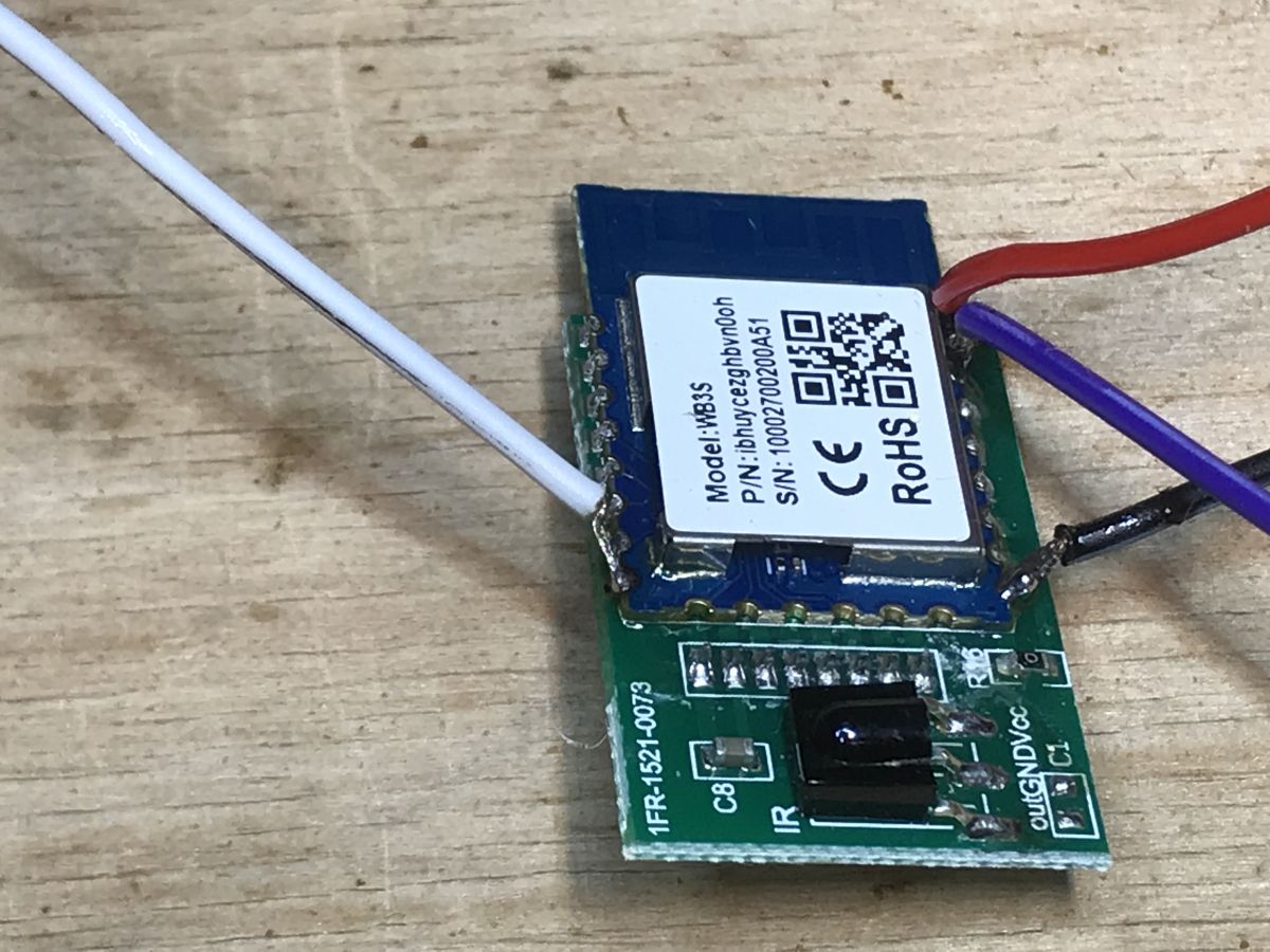

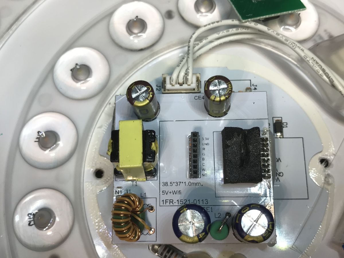

    The WiFi module is on a removable board. The pins are signed, and you can see the color coding, meaning the same PCB is probably also used for the RGBCW version.
    Control module inside the Woox ceiling light showing electronic components. Interior of Woox ceiling lamp with visible WB3S WiFi module. Close-up of the internal controller and power supply of an LED ceiling light.

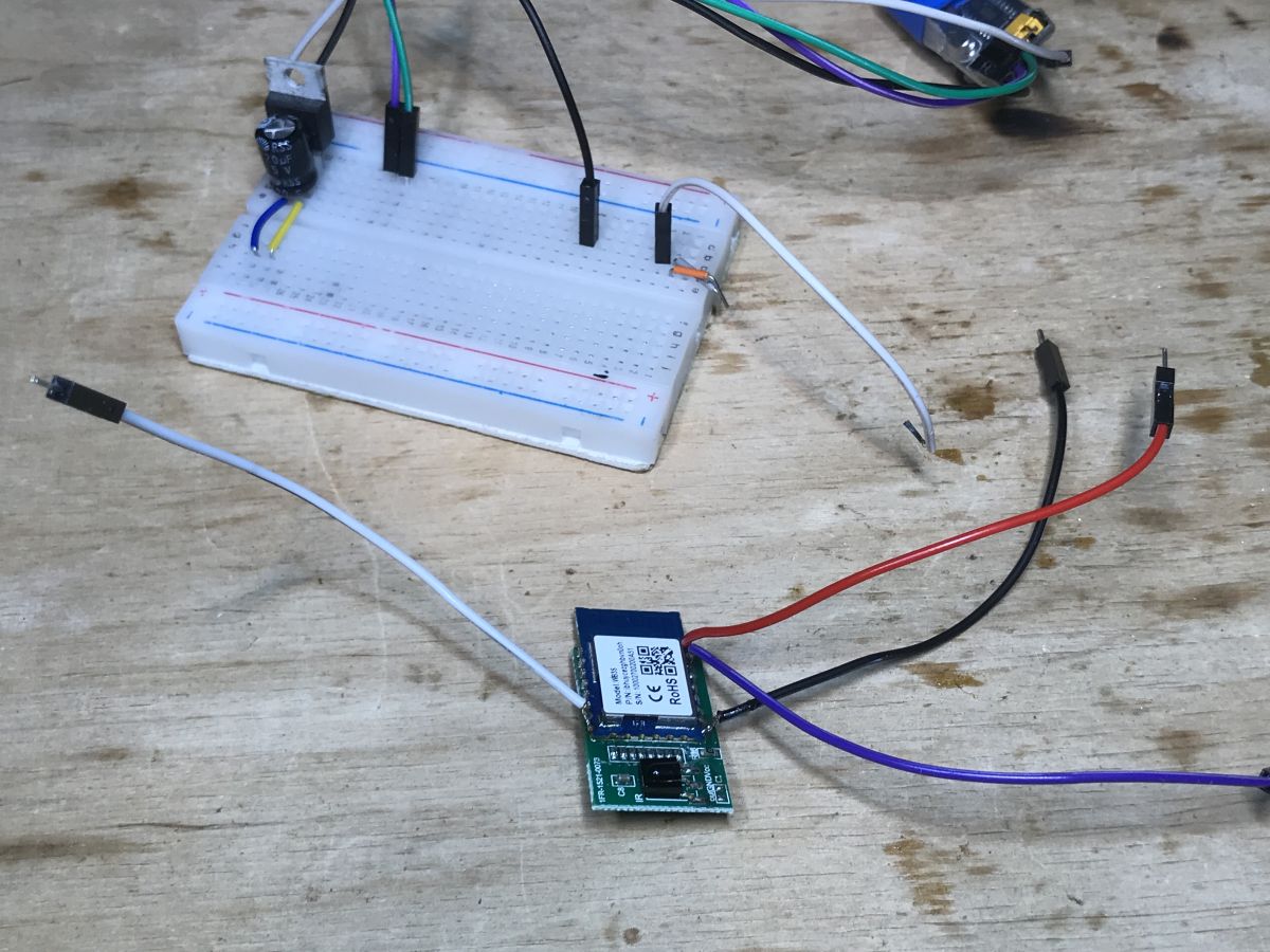

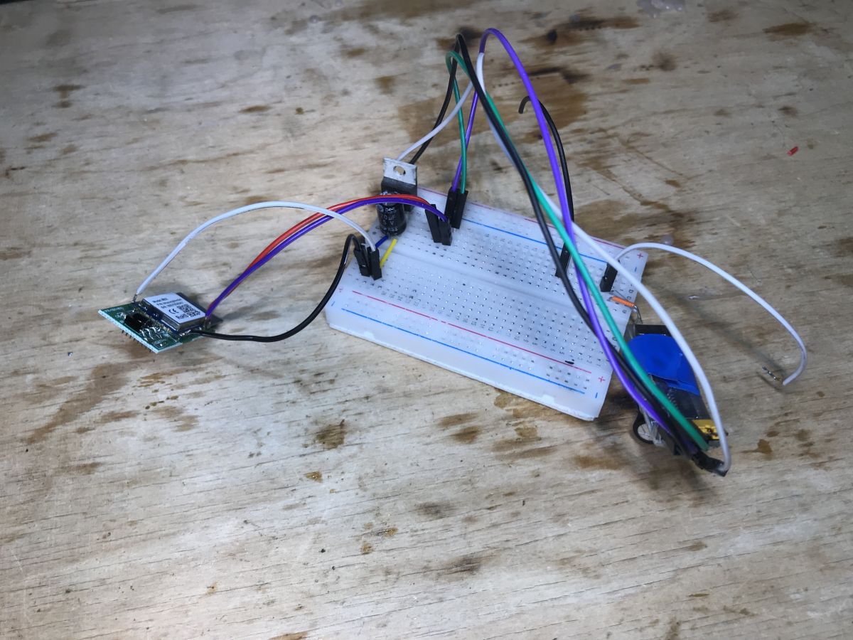

    We solder four wires, RX, TX, 3.3V and ground:
    Wires connected to the WB3S module on a breadboard. WB3S module with connected wires on a PCB board.
    We connect stable 3.3V and USB to UART converter, run the flasher:
    Woox WiFi module connected to a breadboard with wires.

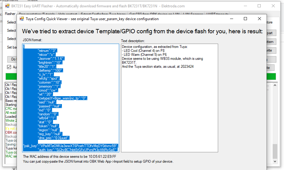

    BK7231GUIFlashTool correctly detects on which GPIO the color control is:
    Screenshot of a configuration tool with JSON data for a ceiling lamp.

    Tuya config:
