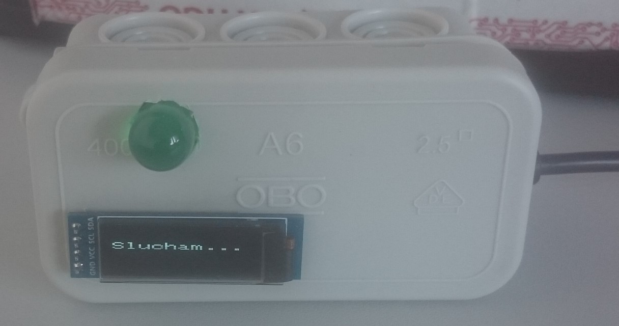

I would like to present a recently created contraption.
I gave it a working name Supervisor detector.
The ESP8266 chip and the SSD1306 OLED display are used here.
I`m in a hurry to explain the principle of operation.
The WIFI network is widely used, we use it at home, at work, in a cafe.
Very often, as I have noticed, people do not turn off WIFI on their phone, either because of laziness or ignorance.
And when phones lose connection to the network, they become quite "talkative" and periodically start desperate attempts to find a known WIFI network to connect to.
They do this by sending packets containing, among others: their MAC address and this feature was used in the presented device.
We have a defined list of MAC addresses in the table that we want to monitor and when one appears within the range of our ESP,
we have signaling in the form of lighting the LED for a few seconds and displaying the name assigned to a given MAC address on the display.
The algorithm is quite primitive, it only signals 1 active device nearby at a time, but it works great for the intended purposes.
The listening library is not my own, a Ricardo Oliveira project called Friend Detector was used here.
https://github.com/RicardoOliveira/FriendDetector
I made changes to adapt the code to my requirements.
It is true that the application is intended to be part of a building automation project and serve other purposes, i.e. after detecting the MAC address we want, it is supposed to turn on the air conditioner in the heating mode using the IR diode before the user even enters the house.
But at the moment I`m testing the system at work and it works great as a supervisor detector ;)
While writing the post, the LED light came on and I was able to prepare for my supervisor`s visit ;-) ) (greet him by name without even seeing him yet).
I noticed that the system can catch frames at a distance of about 80 m and in a quite radio-polluted industrial environment where a lot of machines work.
The casing is not very beautiful, but it was made quickly to protect the device so that bystanders would not accidentally short circuit it.
I don`t have a diagram because it is a manual connection of the OLED display and LED to the ESP.
Below is a video of the device in operation.
Source codes attached.

Incredible! Let me tell you, there is a deposit for a device that could be normally sold, for analyzing the presence of people, detecting, and notifying. Of course, it would support a certain number of... [Read more]
Kkuba79 05 Feb 2024 19:11
A very interesting and clever device. From what I can see on my phone, the MAC address is generated randomly, which may make it difficult to identify the user. [Read more]

It seemed to me that the device was scanning for networks. Only when it finds a network saved in itself with the right to establish a connection does it become "talkative". In other words, if a device... [Read more]
Sam Sung 06 Feb 2024 00:44
What you described is passive scanning. Smartphones perform active scanning by sending a frame cyclically probe request , in which - in addition to your own identifier - there is also a place for a... [Read more]

My observations show that random MAC is for different WiFi networks. If you connected to one network, e.g. at home, the phone will report the same "randomized" MAC address to a specific network. I don`t... [Read more]
pixel7 06 Feb 2024 08:30
This is actually true, otherwise the pool of addresses reserved on the router would increase. And with poor coverage, when the phone would lose and find (new MAC) the network, another IP would be blocked.... [Read more]
szdom 06 Feb 2024 10:02
If the phone loses coverage, it starts sending probe request frames and when it finds itself in the network coverage again, it is renegotiated on the DHCP server and the same IP address is granted for... [Read more]
