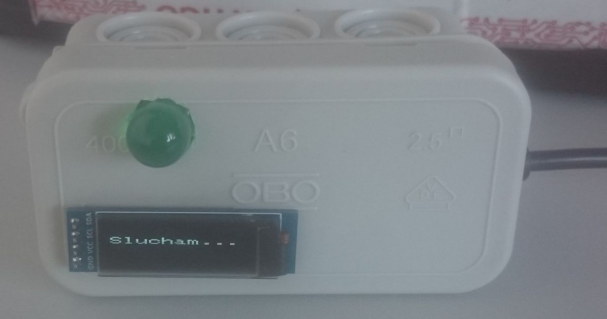

    I would like to present a recently created contraption.
    I gave it a working name Supervisor detector.
    The ESP8266 chip and the SSD1306 OLED display are used here.
    I`m in a hurry to explain the principle of operation.
    The WIFI network is widely used, we use it at home, at work, in a cafe.
    Very often, as I have noticed, people do not turn off WIFI on their phone, either because of laziness or ignorance.
    And when phones lose connection to the network, they become quite "talkative" and periodically start desperate attempts to find a known WIFI network to connect to.
    They do this by sending packets containing, among others: their MAC address and this feature was used in the presented device.
    We have a defined list of MAC addresses in the table that we want to monitor and when one appears within the range of our ESP,
    we have signaling in the form of lighting the LED for a few seconds and displaying the name assigned to a given MAC address on the display.
    The algorithm is quite primitive, it only signals 1 active device nearby at a time, but it works great for the intended purposes.

    It is true that the application is intended to be part of a building automation project and serve other purposes, i.e. after detecting the MAC address we want, it is supposed to turn on the air conditioner in the heating mode using the IR diode before the user even enters the house.
    But at the moment I`m testing the system at work and it works great as a supervisor detector ;)
    While writing the post, the LED light came on and I was able to prepare for my supervisor`s visit ;-) ) (greet him by name without even seeing him yet).
    I noticed that the system can catch frames at a distance of about 80 m and in a quite radio-polluted industrial environment where a lot of machines work.
    The casing is not very beautiful, but it was made quickly to protect the device so that bystanders would not accidentally short circuit it.
    I don`t have a diagram because it is a manual connection of the OLED display and LED to the ESP.
    Below is a video of the device in operation.
    Source codes attached.

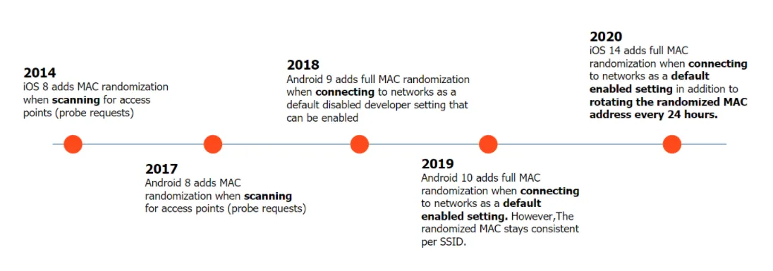

    I came across an interesting website: Link , and in it a picture:
    Timeline diagram of MAC address randomization implementation by iOS and Android systems
    It shows that iOS8 and Android 8 already had random MACs in the probe request. In 2019 (Android 10), random MAC addresses were also enabled by default when connecting to the network. So the question arises - how does the "detector" work - the boss probably has a very old phone :)

    Interesting idea, can any ESP or other controller be used?

    I`m thinking about using this device for monitoring. In the case of a separated and fenced building, you can detect that someone is hanging around (of course, if they have a phone :) . I noticed that information about the signal strength is transmitted - so you can determine approximately how far someone is. I am thinking about working in two modes - collecting data and then sending it via classic WiFi. This requires constant changes to the ESP settings. Currently in listening mode we have:
    Code: Arduino
    Here I have a question for people who know ESP well - how to switch it to transmit mode (STA)? Will running the above code again switch it back to listening mode?

What is MAC randomization on Android and iPhone, and how does it affect identifying a specific user with an ESP8266 detector?
MAC randomization changes the address a phone presents, which makes stable user identification harder. Several posters noted that if Randomized MAC is enabled, “targeting” can fail, and one later cited that iOS 8 and Android 8 already randomized probe requests while Android 10 enabled randomized MAC by default for network connections. In practice, the detector still worked on some devices, but reliability depended on phone model, OS behavior, and per-network settings. [#20948517]
