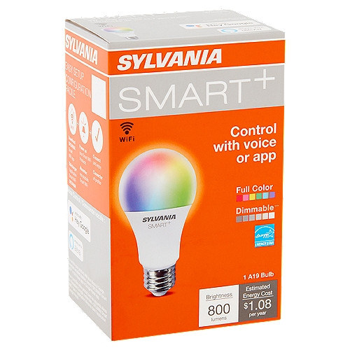

The guide examines a SYLVANIA SmartPlus A19CCECWF RGBCT bulb and its hidden Tuya/Sylvania identifiers, including Model A19CCECWF and product_id 1ijupffokexbz0cl.
A sacrificed bulb was opened, the PCB and LED package were inspected, and Cloudcutter was used to flash the device.
The bulb carries SKU 75663 for the 1-pack and SKU 75674 for the 4-pack, and the module is labeled WB8P BK7231T.
Flashing succeeded, but the device configuration reports WB3S even though the module is WB8P, leaving RGBCT tuning for another bulb.
I have a bunch of these and decided to sacrifice one bulb so I could use cloudcutter on the others if it all works out. I was able to successfully flash the bulb using the cloudcutter method.
Model name stamped on the base:
The model name is a bit obfuscated with this one:
Model: A19CCECWF (Printed on the base of the bulb itself, but this is nowhere to be found online or on LEDVANCE/SYLVANIA's website anywhere)
SKU: 75663 (1-pack)
SKU: 75674 (4-pack)
product_id: 1ijupffokexbz0cl (Tuya / Sylvania product identifier found with [tuya-uncover](https://github.com/blakadder/tuya-uncover))
