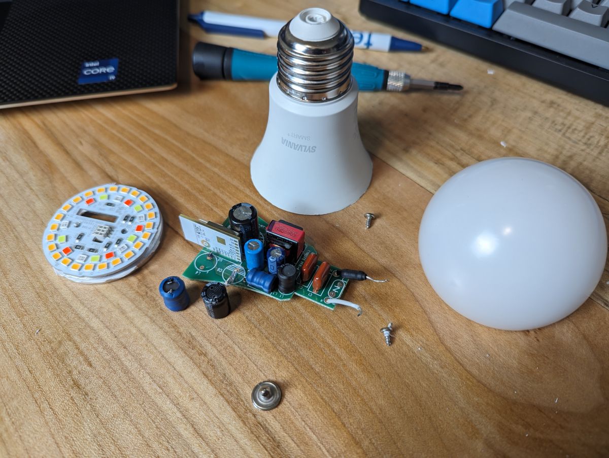

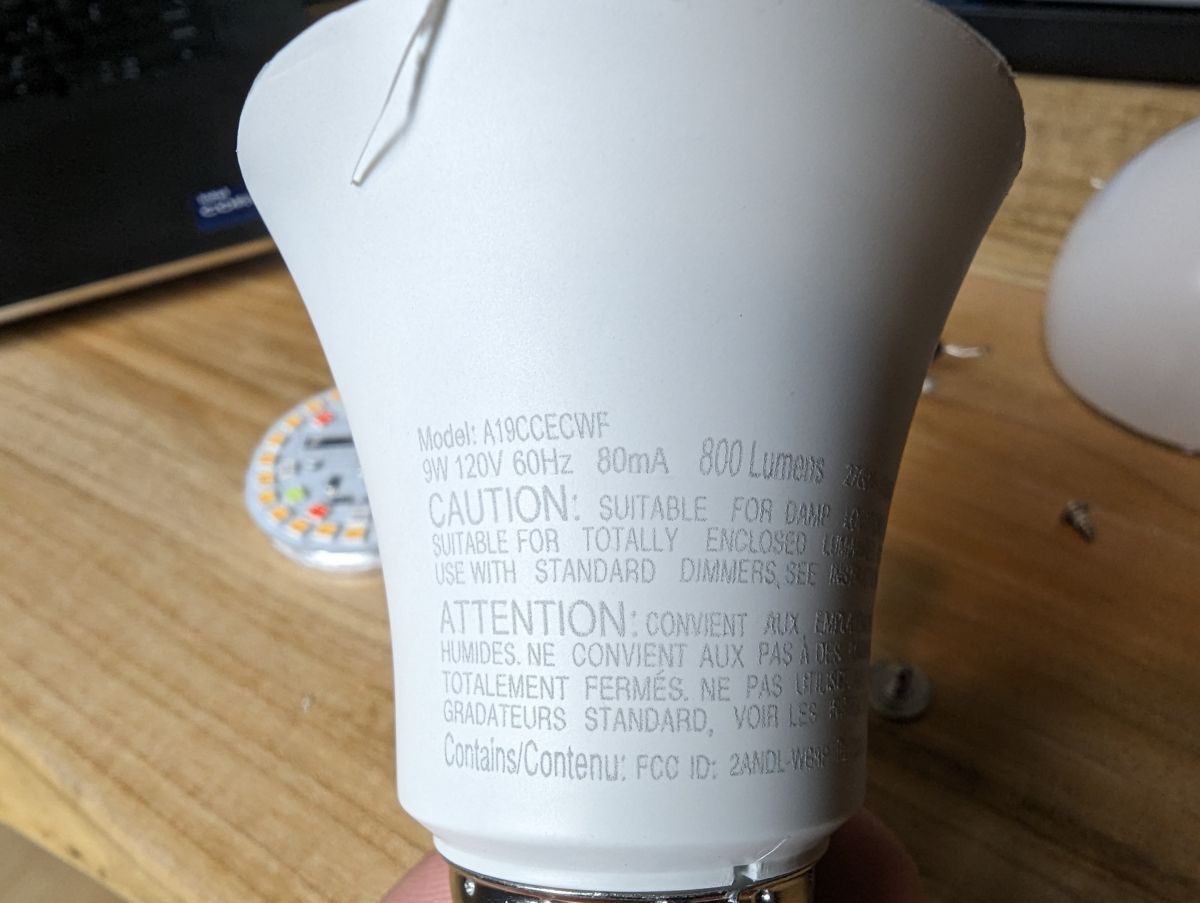

  • I have a bunch of these and decided to sacrifice one bulb so I could use cloudcutter on the others if it all works out. I was able to successfully flash the bulb using the cloudcutter method.
    Packaging of Sylvania SMART+ smart bulb with WiFi and color control features.
    Model name stamped on the base:
    Close-up of a smart LED bulb with visible model and specifications.
    The model name is a bit obfuscated with this one:
    Model: A19CCECWF (Printed on the base of the bulb itself, but this is nowhere to be found online or on LEDVANCE/SYLVANIA's website anywhere)
    SKU: 75663 (1-pack)
    SKU: 75674 (4-pack)
    product_id: 1ijupffokexbz0cl (Tuya / Sylvania product identifier found with [tuya-uncover](https://github.com/blakadder/tuya-uncover))
    Like all smart bulbs, they basically come apart the same way:
    Disassembled LED bulb with visible internal components.

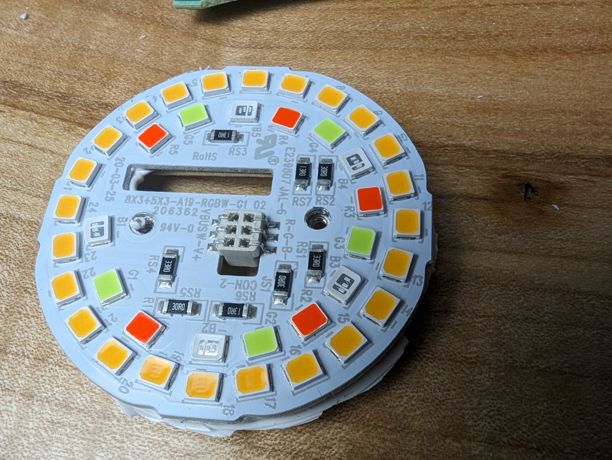

    LED close up:
    LED board of a smart bulb with visible diodes.

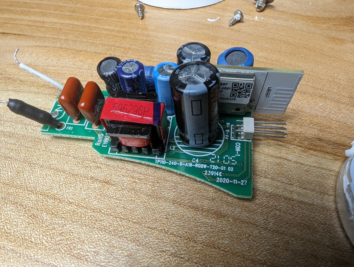

    Board close up 1:
    Close-up of a circuit board with electronic components.

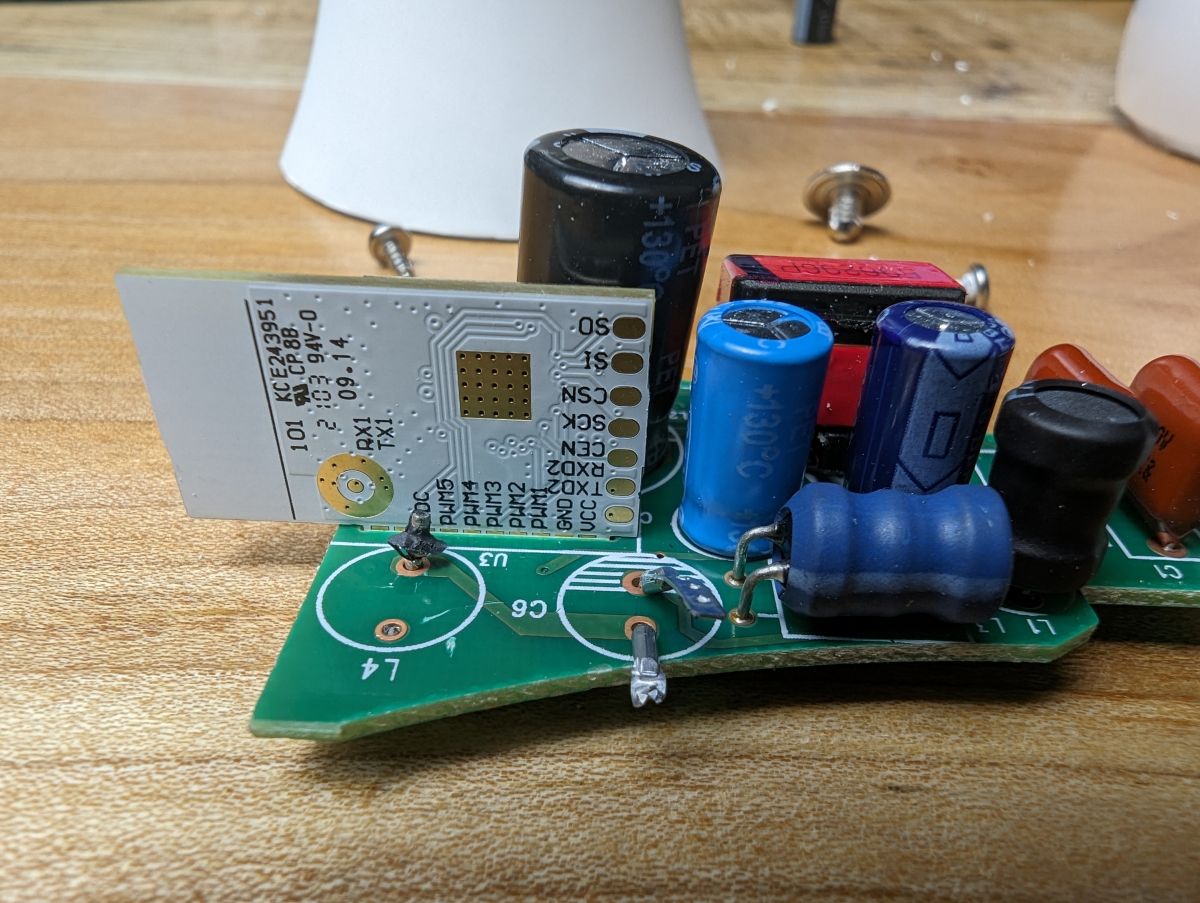

    Board close up 2 (thought I needed to get the capacitors out of the way to read the flash, but not needed):
    Close-up of a circuit board with electronic components and capacitors.

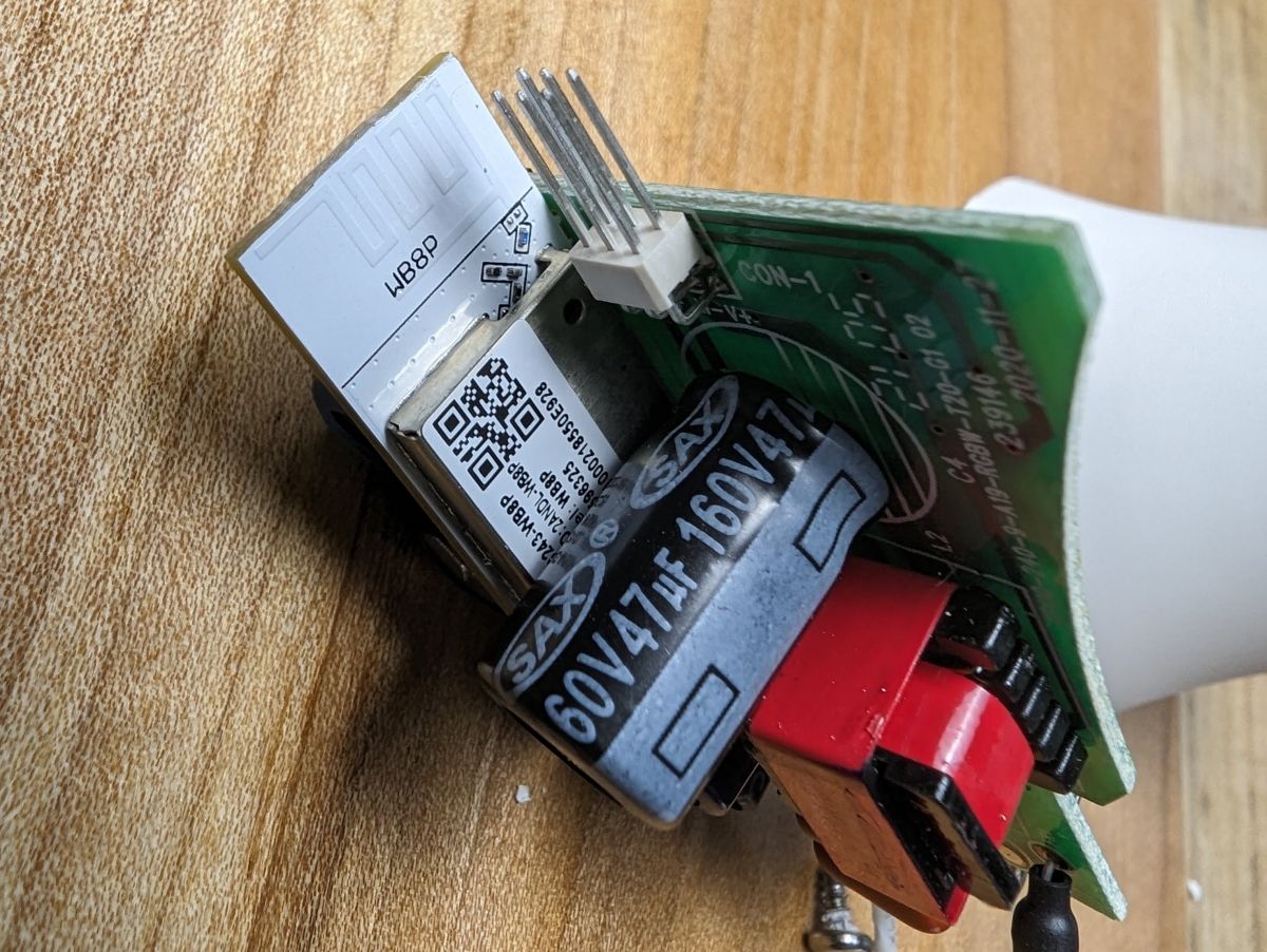

    WB8P BK7231T:
    Close-up of the internal components of a smart bulb with a visible WB8P module.

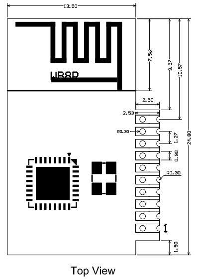

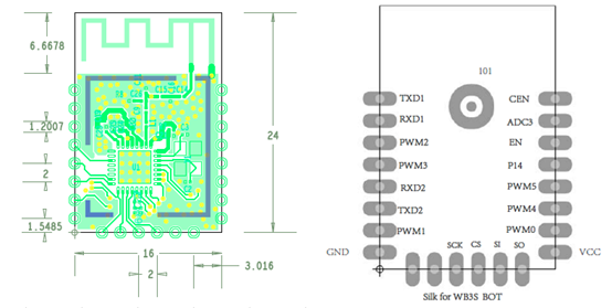

    The only thing odd is the device configuration states it is a WB3S, however, the module is a WB8P. Maybe that's actually "normal"?

    WB3S config mismatch likely due to WB8P revision
    #4 20953843
    Sunnysky
    Posts: 57
    Near as I can tell from comparing these boards is that the 8P has improved characteristics for antenna gain 2 dBi vs 1.2 and higher operating temp 105 'C vs 85'C with a new layout with I/O pins on 1 side vs 3 sides.
    Top view of an electronic module with an antenna and pins.
    Comparative schematic of two electronic boards with different pin layouts.
    Thus "normal" to use latest Revision. So they keep track of major revisions by changing the model # and firmware changes ought to be compatible but may have bugs fixed.

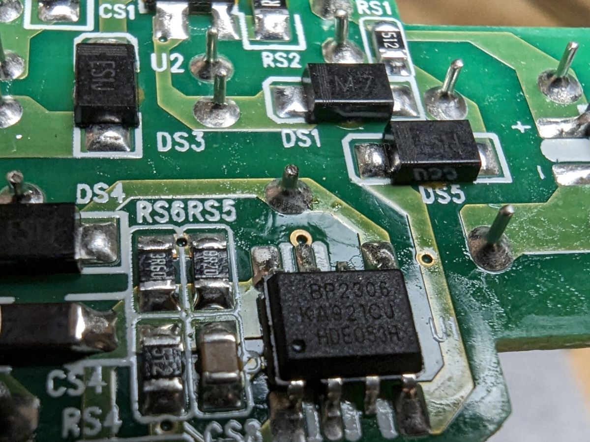

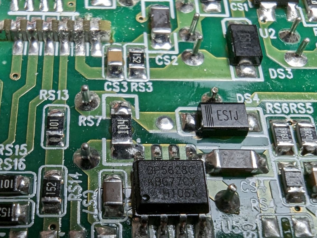

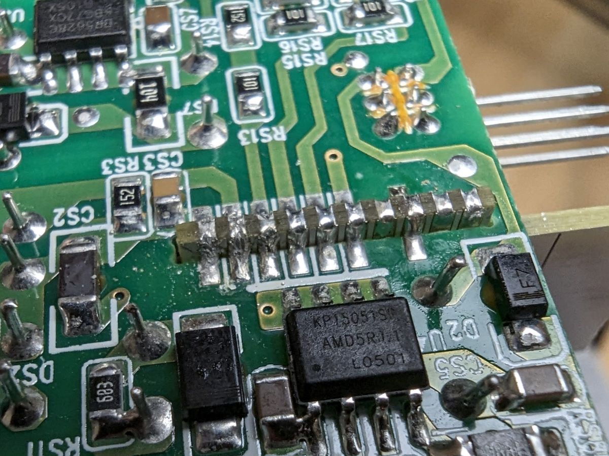

    I've taken a closer look at the main chips used on the circuit board:
    BP2306 - LED Driver:
    Close-up of a printed circuit board with visible chips BP2306, BP5628C, and KP15051SPA.
    BP5628C - Dimmer:
    Close-up of a printed circuit board with visible electronic components, including the BP5628C chip.
    KP15051SPA - Power Distribution:
    Close-up of a circuit board with various components and chips visible, including BP2306, BP5628C, and KP15051SPA.
    No idea how to try to test these out with the configuration / pinout. I'll take a look around the forums for some other examples.

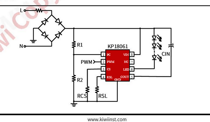

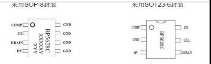

    LED driver is controlled by PWM Diagram of LED controller IC BP2306XJ with labels like HV, DRAIN, VCC, and DIM.
    The low side switch for regulation and buffer of current is provided by FET
    Diagram of two ICs BP5628C and BP5629C.
    This chip supports PWM Current Sensing (CS) Schematic of an LED driver circuit with PWM and current sensing.

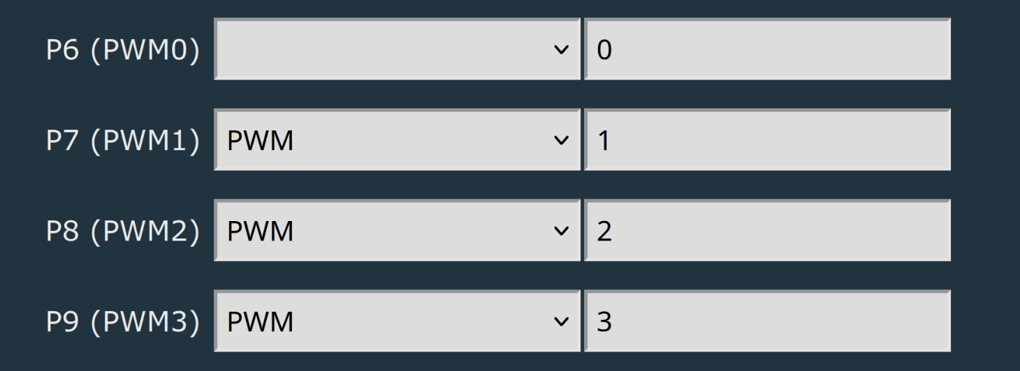

  • PWM mappings and flags for full RGBCT control
    #7 20953963
    rronnander
    Posts: 8
    Okay, I have the following PWM mappings:
    Screenshot of a table with PWM settings for pins.
    RGB mode seems to be working well with brightness and colors. The RED seems a little miscalibrated in the color picker. There's a sweet spot of deep red and then everything quickly looks pink, other colors seem pretty calibrated.
    Setting the proper color range (2700-6500K):
    CTRange 154 370
    Playing around with the PWM mappings on 24/26 give me the temp color slider. This puts the bulb into what appears to be white color mode stock temp (2700K). Adjusting the slider just acts as a weird additional brightness control but the color temp stays at 2700K. Looking into this more, but progress!
    Added after 2 [hours] 20 [minutes]:
    Okay, I think I have it working as expected now.
    I enabled the following extra flags:
    Flag 8 - [LED] Alternate CW light mode (first PWM for warm/cold slider, second for brightness)
    Flag 24 - [LED] Emulate Cool White with RGB in device with four PWMS - Red is 0, Green 1, Blue 2, and Warm is 4
      "pins": {
        "7": "PWM;1",
        "8": "PWM;2",
        "9": "PWM;3",
        "24": "PWM;5"
    It's "working" in all modes. Looks good at first glance, but I'll test it against a tuya firmware version later this weekend. When the dust settles I'll update my original post with all the current config/info.
        pin: P9
      - platform: libretiny_pwm
        pin: P7
        pin: P24
    light:
      - platform: rgbw
        color_interlock: true
        red: output_red
        green: output_green
        blue: output_blue
        white: output_white
        effects:
          - random:
          - flicker:

  • The bulb was identified as SYLVANIA SmartPlus A19CCECWF RGBCT, with SKU 75663 for a 1-pack, SKU 75674 for a 4-pack, and Tuya product ID 1ijupffokexbz0cl. [#20952558]
  • The opened bulb used a BK7231T chip on a WB8P module, even though the device configuration showed WB3S. [#20952558]

How do you configure the PWM pins for the BK7231T/WB8P inside the SYLVANIA SmartPlus A19CCECWF so RGB and white modes work correctly?
Use PWM on pins 7, 8, 9, and 24, then enable the two LED flags that fix white-mode behavior. The working map was P7=PWM1, P8=PWM2, P9=PWM3, and P24=PWM5. The thread also enabled Flag 8 for alternate CW light mode and Flag 24 to emulate cool white with RGB plus warm. That combination made RGB mode and white mode both work acceptably on the BK7231T/WB8P bulb. [#20953963]
What CTRange setting was used to get the SYLVANIA A19CCECWF bulb to the proper 2700K-6500K color temperature range?
The thread used CTRange 154 370 to match the bulb to roughly 2700K-6500K. That setting was posted after the RGB channels were already working and was specifically described as the proper color range. Before the final flag changes, the temperature slider acted more like a second brightness control and stayed near a stock-looking 2700K. [#20953963]
Why does the OpenBeken or device configuration show WB3S when the bulb module is actually marked WB8P?
The thread suggests this can be normal because WB8P may be a later hardware revision compatible with earlier WB3S-oriented configuration data. One reply compared the modules and described WB8P as having 2 dBi antenna gain instead of 1.2 dBi, a 105°C rating instead of 85°C, and a revised pin layout. The same reply concluded that manufacturers may keep major compatibility while changing module revisions. [#20953843]
What are the BP2306, BP5628C, and KP15051SPA chips doing on the SYLVANIA A19CCECWF bulb board?
BP2306 is the LED driver, BP5628C is the dimmer, and KP15051SPA handles power distribution on this board. A follow-up comment added that the LED driver is PWM-controlled and uses a low-side FET for current regulation and buffering, with PWM current sensing support. Those three parts explain why the bulb needs both power-stage control and separate channel dimming for RGB and white output. [#20953869]
