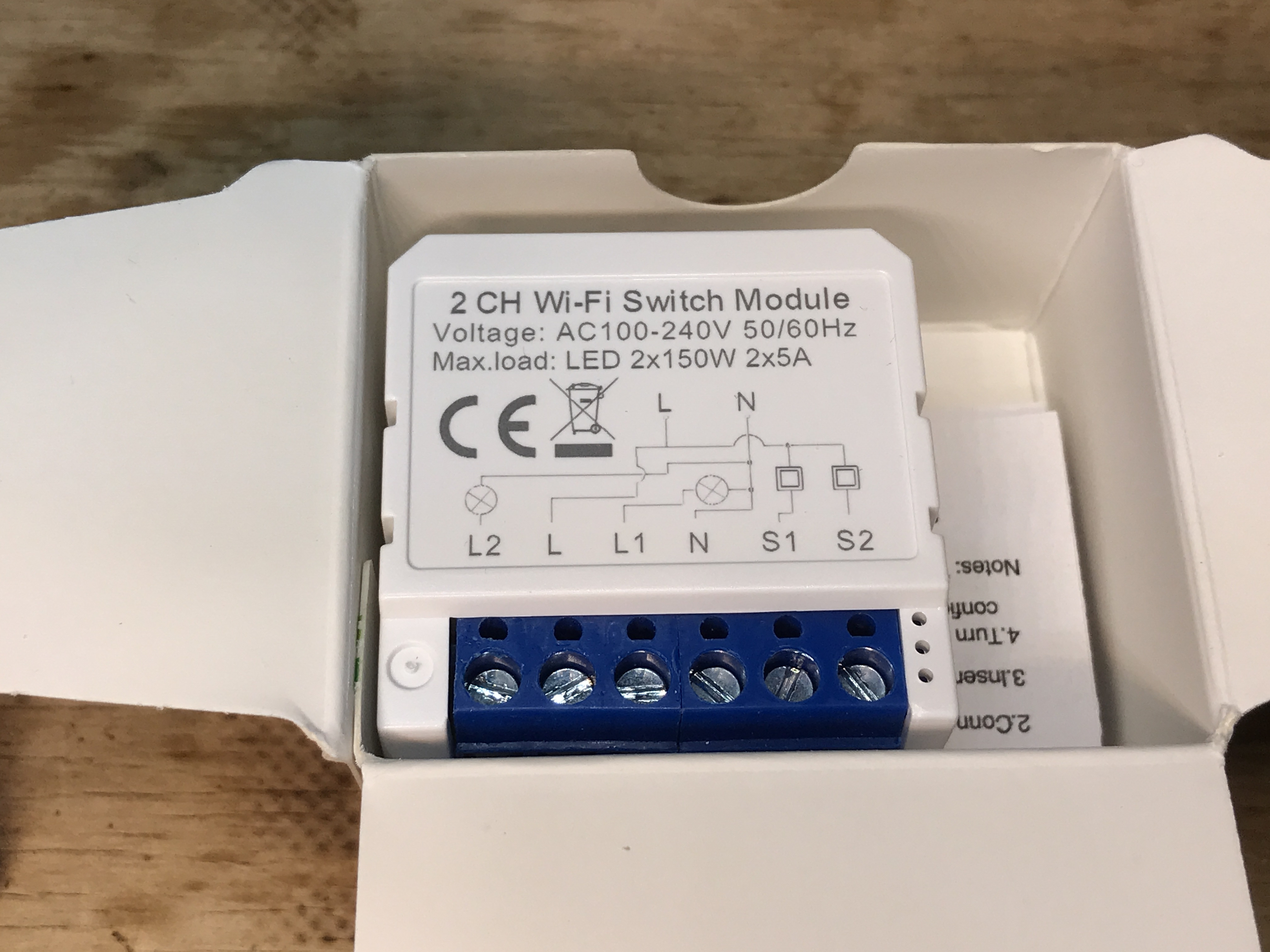

AVATTO WSM16-W2 2-channel Wi-Fi switch module in packaging
Some time ago I reviewed the Tuya single relay module AVATTO WSM16-W1 WiFi relay for PLN 30 , today it`s time for a similar gadget, but with two relays. All this in a small housing measuring 39mm x 39mm x 19mm. The maximum load on one channel is only 150W, but it is still worth giving this product a chance and taking a look inside...
We bought AVATTO WSM16-W2 for PLN 56, which is quite a lot, considering the fact that its "single" version cost only PLN 30:
Tuya WSM16-W2 switch front view with a mobile app illustration.
Specification:
Smart switch AVATTO WSM16-W2 with description and technical specifications.
White WiFi relay module with two channels, markings, and terminals.
In practice, we get a small box:
Technical specifications on the packaging of the AVATTO WSM16-W2 relay module. Box of the AVATTO WSM16-W2 module with logo and compatibility information with Tuya Label on the box with information about INNPRO importer.
There is even an importer`s logo on the switch:
View of AVATTO dual relay Wi-Fi switch module in an open box. View of the AVATTO WSM16-W2 module with branding and certifications on top.
Instruction:
User manual of the AVATTO WSM16-W2 WiFi switch module with diagrams and technical specifications. User manual for pairing the AVATTO WSM16-W2 module with an app
But I haven`t discussed pairing with Tuya for a long time, let`s look inside.

We remove the cover:
PCB of AVATTO WSM16-W2 model with electronic components. Interior of the AVATTO WSM16-W2 smart module with two relays.
PCB is practically the same. Even the date is correct - MK-Z2-001_V1.0 20221219
We take out the plate:
View of the interior of the AVATTO WSM16-W2 module in an open casing.
You can see the first difference:
Close-up of the AVATTO WSM16-W2 relay module with two relays.
Yes, there are two relays and they are very narrow:
AVATTO WSM16-W2 module with two relays on a wooden surface.
The relay model is HF49FD 005-1H11T, 5A 250VAC.
The rest is the same as in the case of the single version.
