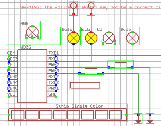

Basic OBK simulator usage
Start the simulator executable. A basic window with sketch should appear:
Screenshot of the OpenBeken IoT simulator with layout of components.
At the same time, you should get a working OBK page on your local host, the default port is 80, just like with most HTTP programs:
OpenBeken IoT simulator homepage with device status information and configuration buttons.
As you can see, it's like a normal OBK device web page. Everything is functional there.
Now, the basic OBK simulator is simple:
- in the schematic editor window, you can place relays, buttons and other peripherals, basically to create your virtual OBK device
- in the OBK simulator page, you can configure your device just like you would be configuring your physical device
It is important to note that the schematic editor window is interactive, so all buttons there, relays, etc, are really working.

Let's load a sample scene first - the one with buttons and relays:
Circuit diagram using elements such as bulbs, measurement modules, and LED strips.
Now, note down which pins are used for relays and for buttons and configure them in OBK itself. P10 and P11 are relays (bulb icon):
Table describing UART1 RXD and TXD pins and their serial interface functions.
PWM2 and PWM3 are buttons:
Technical documentation excerpt with information on PWM3 and PWM2 connectors.
This is how I configured them:
Screenshot of the configuration interface for the OpenBeken IoT simulator.
Now, with left mouse button, click the virtual buttons:
OpenBeken IoT module schematic with peripheral elements.
As you can see, the relay (bulb icon) state changes, but with a delay. It's actually expected. It's long known "feature", it's the same in Tasmota. You need to consult our FAQ to read more about it:
A section of the OpenBeken simulator instructions explaining settings for instant touch switch response.
So let's enable this flag and try again.
Screenshot of WinTest OBK user interface with various flag options.
Now it works even better:
Schematic diagram with various electronic components and connections on a grid.
