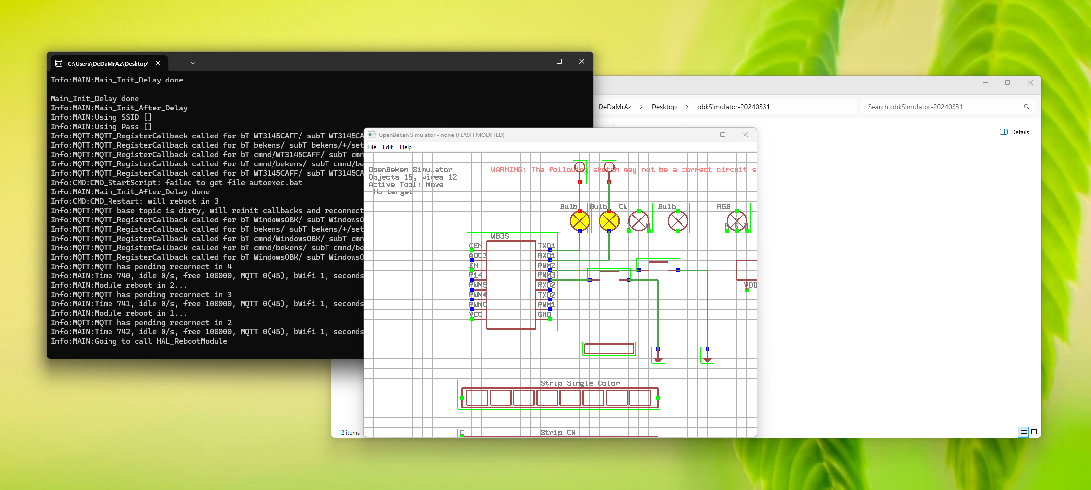

    Start the simulator executable. A basic window with sketch should appear:
    Screenshot of the OpenBeken IoT simulator with layout of components.
    At the same time, you should get a working OBK page on your local host, the default port is 80, just like with most HTTP programs:
    OpenBeken IoT simulator homepage with device status information and configuration buttons.
    As you can see, it's like a normal OBK device web page. Everything is functional there.

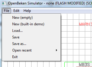

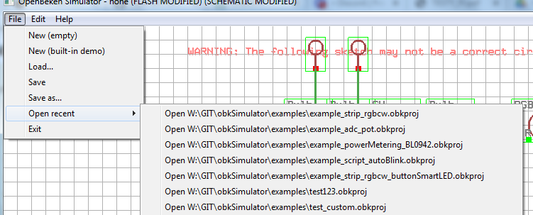

    OBK schematic editor features a simple menu bar with schematic management options:
    OpenBeken Simulator window with File menu open.
    Load, save, etc options should be self-explanatory. Your current scene can be easily saved and loaded, just make sure to save manually after making changes to device flash memory - by default, they are NOT saved. To manage virtual devices, use FILE menu:
    - File->New (Empty) - will create an empty scene
    - File->Save - saves changes to current sketch
    - File->Save As - allows you to save current sketch to another file
    - File->Open Recent - provides a list of recently viewed sketches for your convenience:
    OpenBeken simulation window with file menu and circuit sketch.

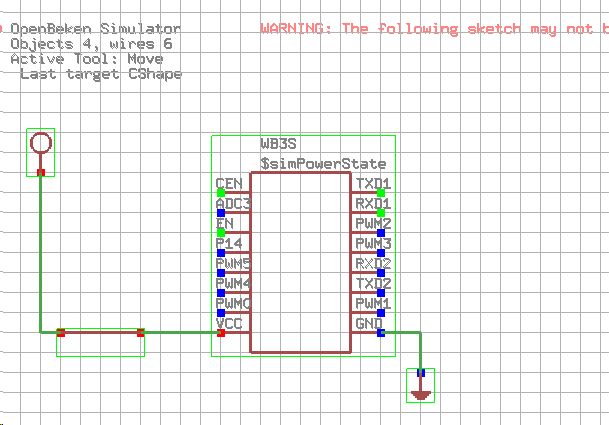

    Basic operations within schematic editor
    There is almost no GUI at all in the current alpha version of the OBK simulator, so you will need to use hotkeys. They are on the alphanumeric keyboard.
    - Key 1 is Use Tool, which allows you to press buttons, move sliders
    - Key 2 is Move Tool, which allows you to move objects
    - Key 3 is Wire Tool, which allows you to draw wires. Press LMB to draw, and press RMB to change draw mode
    - Key 4 is Delete Tool, which allows you to delete objects, labels and wires
    - Key 5 is Copy Tool, it can be used to quickly make a duplicate of clicked object
    - Key 6 is Info Tool, it prints debug information about object under mouse cursor
    - Key 7 is Text Tool, which allows you to print text on simulator sketch
    Currently active tool is displayed on GUI:
    OpenBeken Simulator interface showing the number of objects and wires, along with the active tool.
    Schematic editor interactions demo

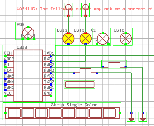

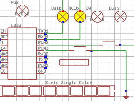

    Let's load a sample scene first - the one with buttons and relays:
    Circuit diagram using elements such as bulbs, measurement modules, and LED strips.

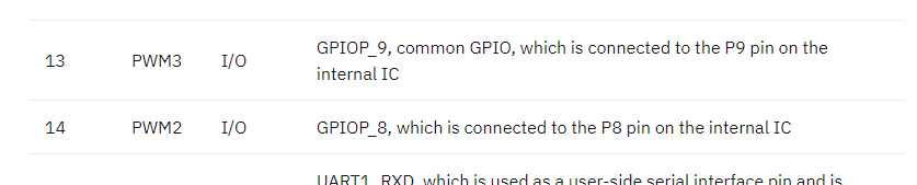

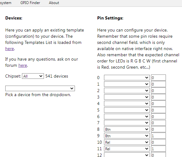

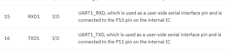

    Now, note down which pins are used for relays and for buttons and configure them in OBK itself. P10 and P11 are relays (bulb icon):
    Table describing UART1 RXD and TXD pins and their serial interface functions.
    PWM2 and PWM3 are buttons:
    Technical documentation excerpt with information on PWM3 and PWM2 connectors.
    This is how I configured them:
    Screenshot of the configuration interface for the OpenBeken IoT simulator.

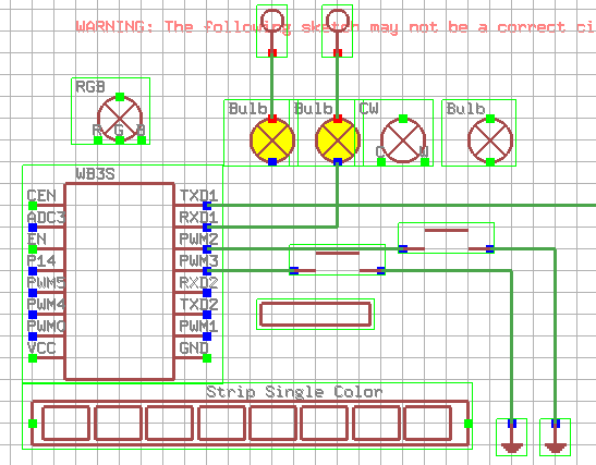

    Now, with left mouse button, click the virtual buttons:
    OpenBeken IoT module schematic with peripheral elements.

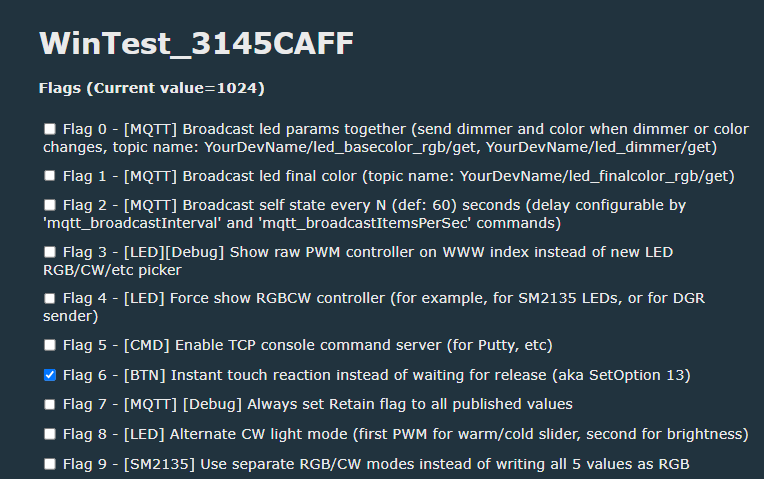

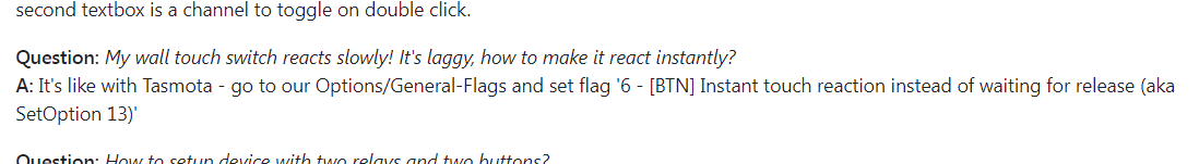

    As you can see, the relay (bulb icon) state changes, but with a delay. It's actually expected. It's long known "feature", it's the same in Tasmota. You need to consult our FAQ to read more about it:
    A section of the OpenBeken simulator instructions explaining settings for instant touch switch response.
    So let's enable this flag and try again.
    Screenshot of WinTest OBK user interface with various flag options.
    Now it works even better:
    Schematic diagram with various electronic components and connections on a grid.

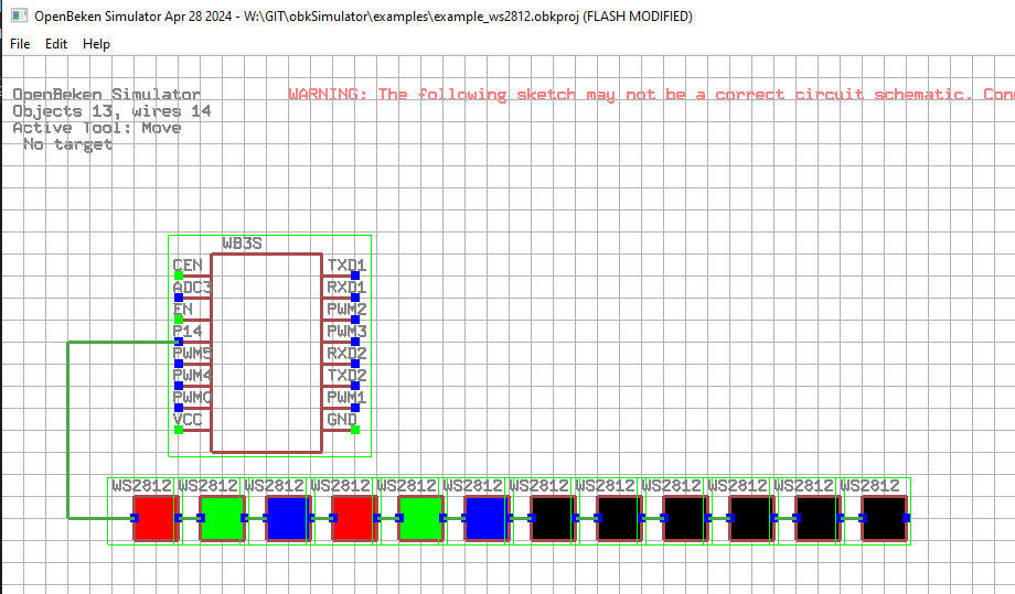

  • #7 21063768

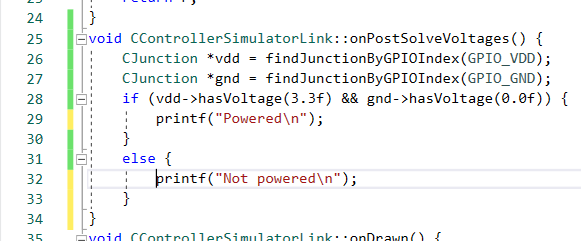

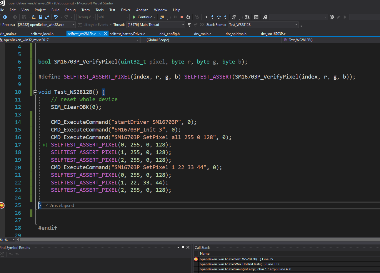

    Posts: 14615
    Help: 655

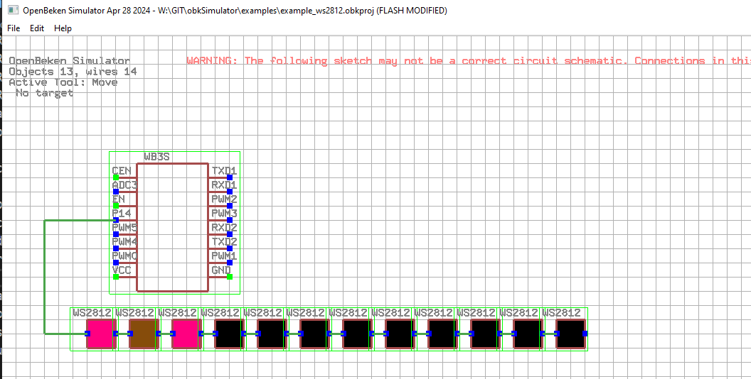

    Rate: 12632

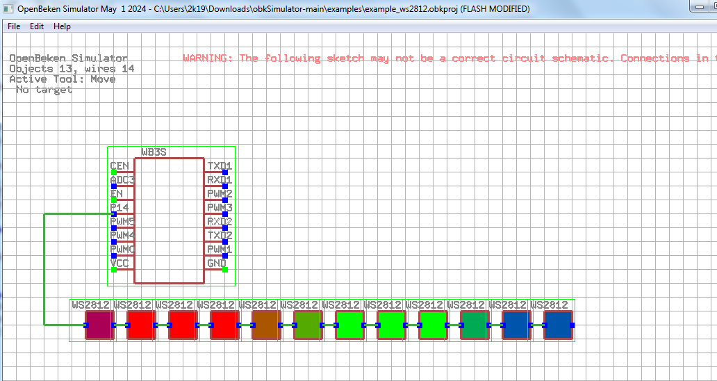

    I am adding WS2812B driver self-tests and soon I will include them in Simulator as well:
    Screenshot of Visual Studio with code testing the WS2812B driver.
    Added after 1 [hours] 32 [minutes]:
    Screenshot of OpenBeken simulator showing the circuit schematic with WS2812B LEDs.
    Added after 36 [minutes]:
    Simulation of WS2812B wiring in OpenBeken Simulator with circuit schematic warning.

    Rate: 12632
    I am working now on per-pixel LED animations:
    Circuit simulation with WS2812 LEDs in OpenBeken software.

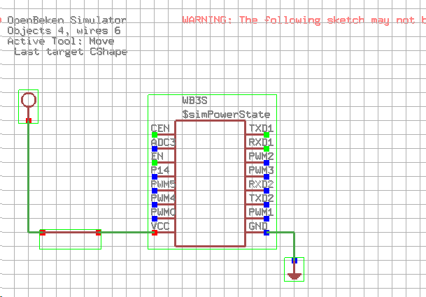

    Rate: 12632

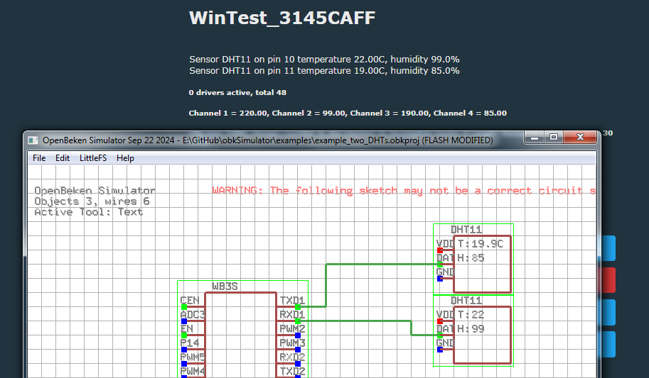

    Now virtual DHT11 has a "body", so there can be two or more of them:
    Screenshot from the OpenBeken simulator showing a test of two DHT11 sensors in a circuit.

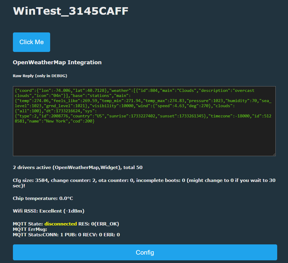

    Rate: 12632
    I love this Simulator, I can test OpenWeatherMap integration on Windows, without flashing any device:
    Screenshot of a Windows simulator testing OpenWeatherMap integration.

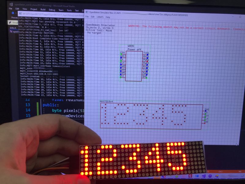

    And now simulator has a crude but working MAX7219 driver:
    LED display showing 12345 with circuit simulation software open on a monitor

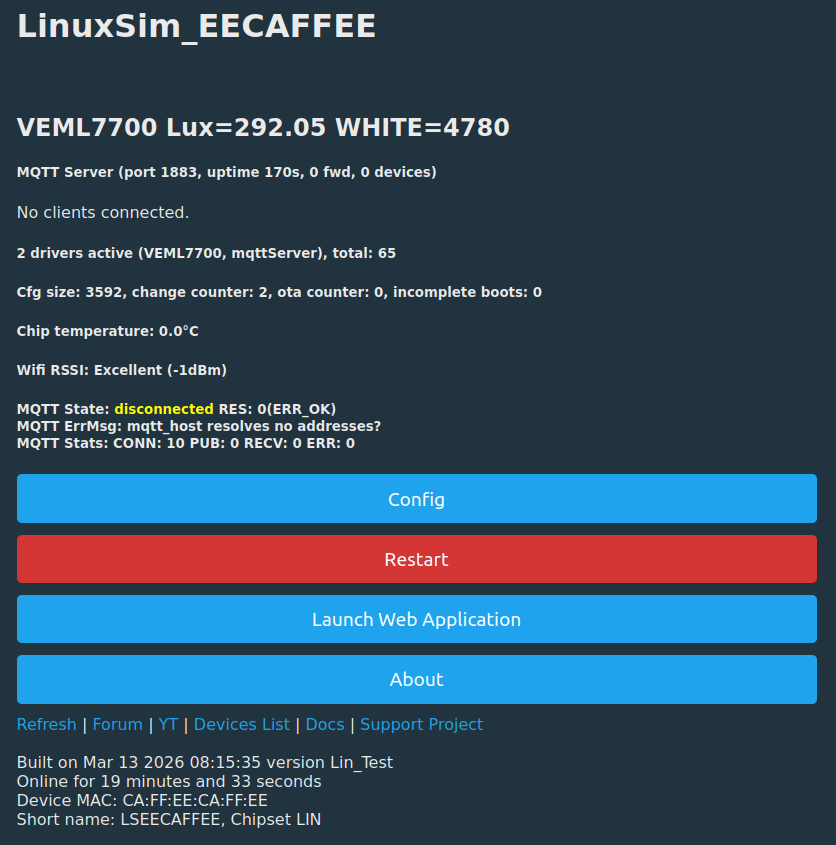

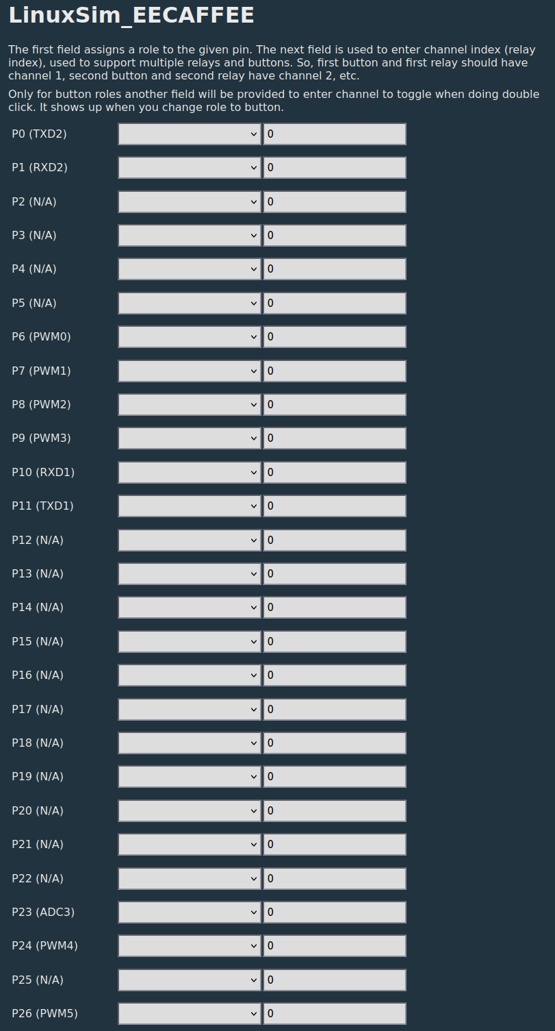

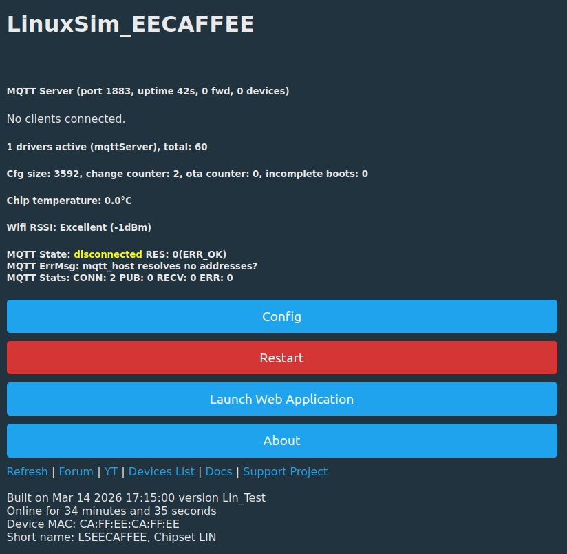

    #18 21862523
    max4elektroda
    Posts: 755
    Help: 48
    Rate: 187

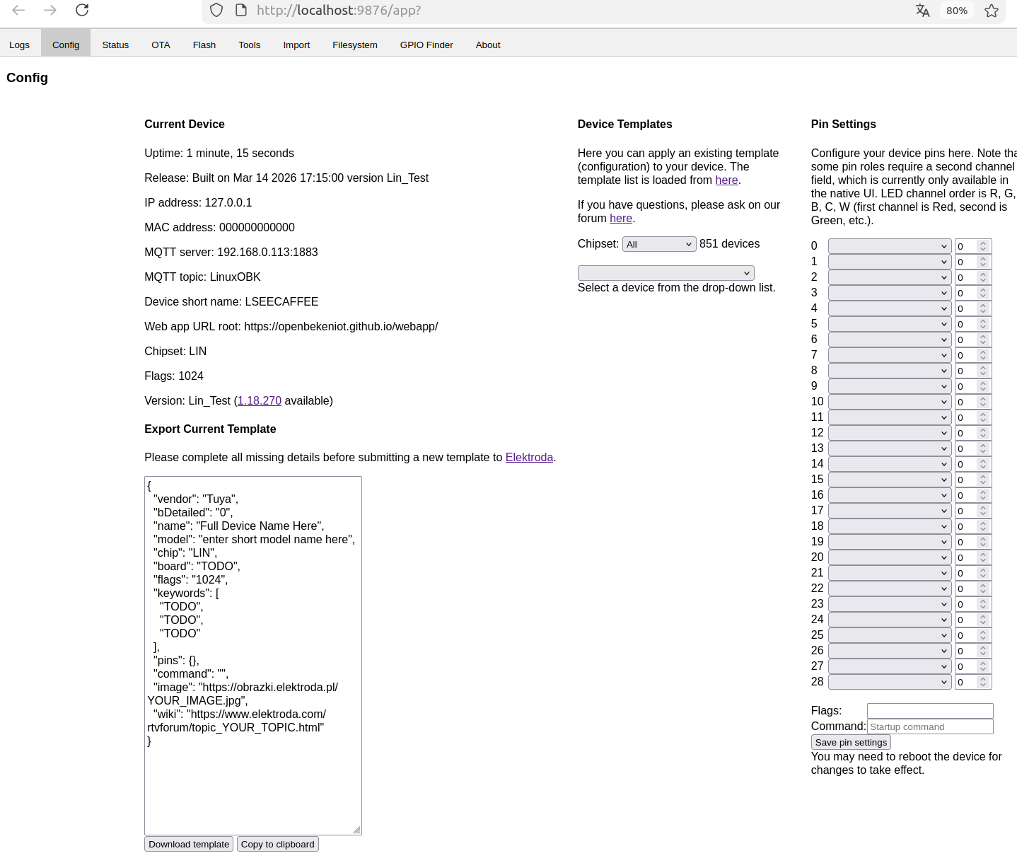

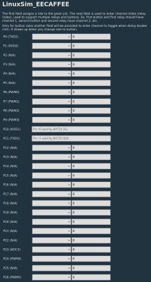

    Just added some PRs I would like to be reviewed please @p.kaczmarek2 :
    Since long time I struggled with using OBK simulator was only possible with Windows binary - meaning using wine on Linux.
    Finally I found some time to investigate, also, why all Linux "selftest" tesitng was so slow.
    I found the two "culprits" (some wrong "#defines" for the MS "Sleep()" command, so Linux "sleep" was used leading to a x seconds(!) sleep instead of the intended x ms).
    And The simulator isn't started (hence no "Main_Init()), so neither commands were registered nor webserver was started.
    I added some more code to reflect it's Linux, not windows and changed the script setting device IP when calling webapp - using JS location will now not only fix e.g. W800 in AP mode but also allow to use it when using a port != 80.
    PR #2025
    A screenshot of GUI and one showing WebApp for the simulator
    Screenshot of LinuxSim_EECAFFEE status page showing MQTT info and buttons Config and Restart Screenshot of localhost “Config” page showing device info, device templates, and GPIO pin settings list.

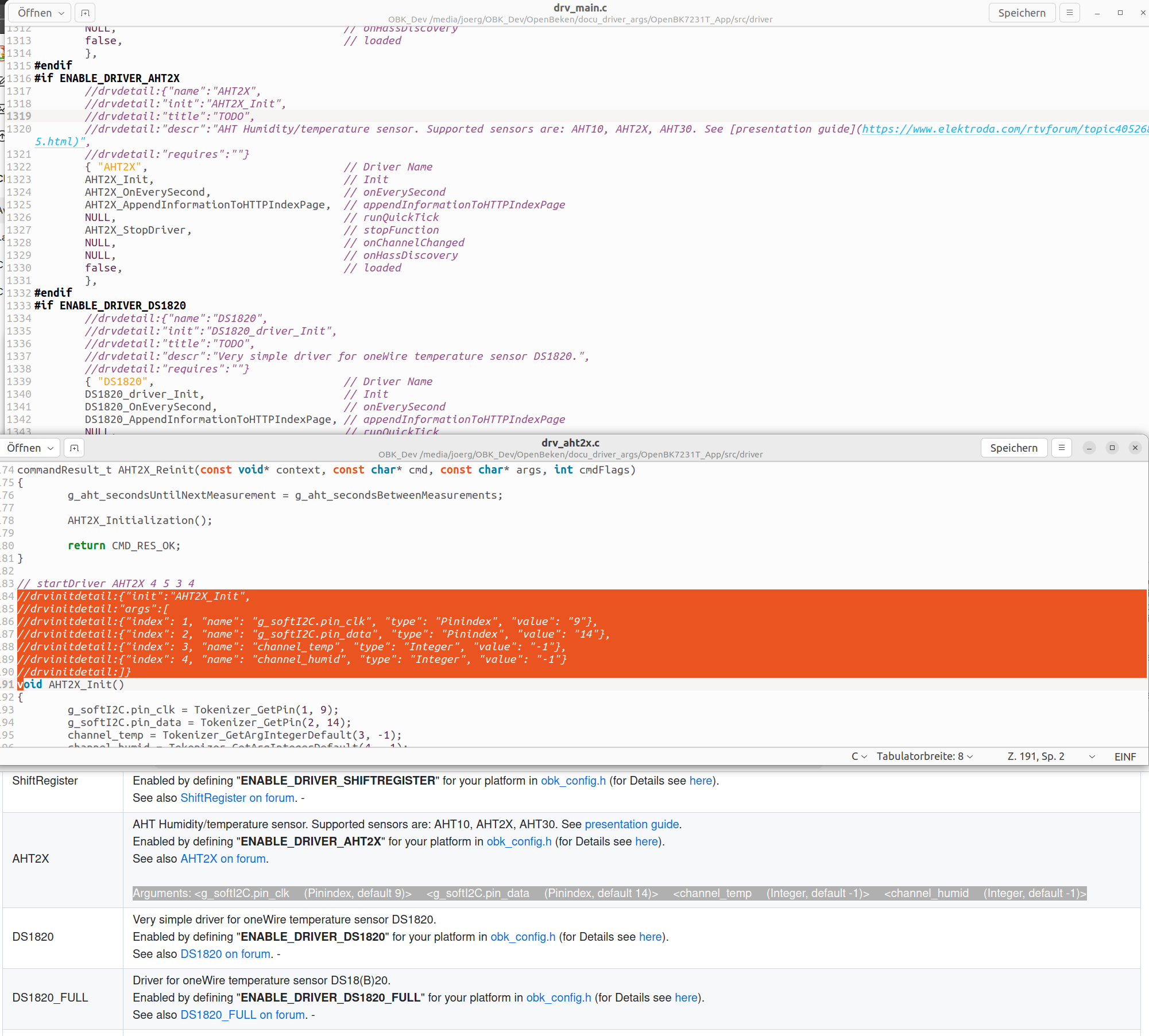

    For my actual work I also suggest an extension to tokenizer for "named" arguments.
    I often struggle on the parameters order e.g. when starting a driver like AHT2x:
    is it <sda> <scl> <channel temp> <channel hum>?
    or <scl> <sda> <channel hum> <channel temp> ?
    or ...???
    So I'd like a call with "named" arguments like
    SDA=17 SCL=19 chan_h=3 chan_t=4
    which is totally equal to
    chan_h=3 SCL=19 chan_t=4 SDA=17
    so no need to remember the order and/or meaning of arguments.

    If I use a driver without an own "IORole" selectable in config page, the usage is not shown there.
    e.g. startdriver aht2x 10 11 3 4 will start the driver, but I cant see it in the GUI:
    Screenshot of LinuxSim_EECAFFEE showing pins P0–P26 with dropdown role fields and channel index inputs
    My change will allow to call a new command
    setPinUsedString(int index, const char *str)
    which will show the pin as "used" in cfg config page, even if there is no "IORole" for this driver.
    Sample usage in AHT2x added in the PR:
       setPinUsedString(g_softI2C.pin_clk, "AHT2X SCL");
       setPinUsedString(g_softI2C.pin_data, "AHT2X SDA");
    which will show (for startdriver aht2x 10 11 3 4 as above)
    "Pin 10 used by AHT2X SCL" / "Pin 11 used by AHT2X SDA"
    Screenshot of LinuxSim_EECAFFEE showing pins P0–P26 with role dropdowns and channel index fields
    Code is in PR #2026

    Maybe a "teaser" about what might come:
    Spoiler:

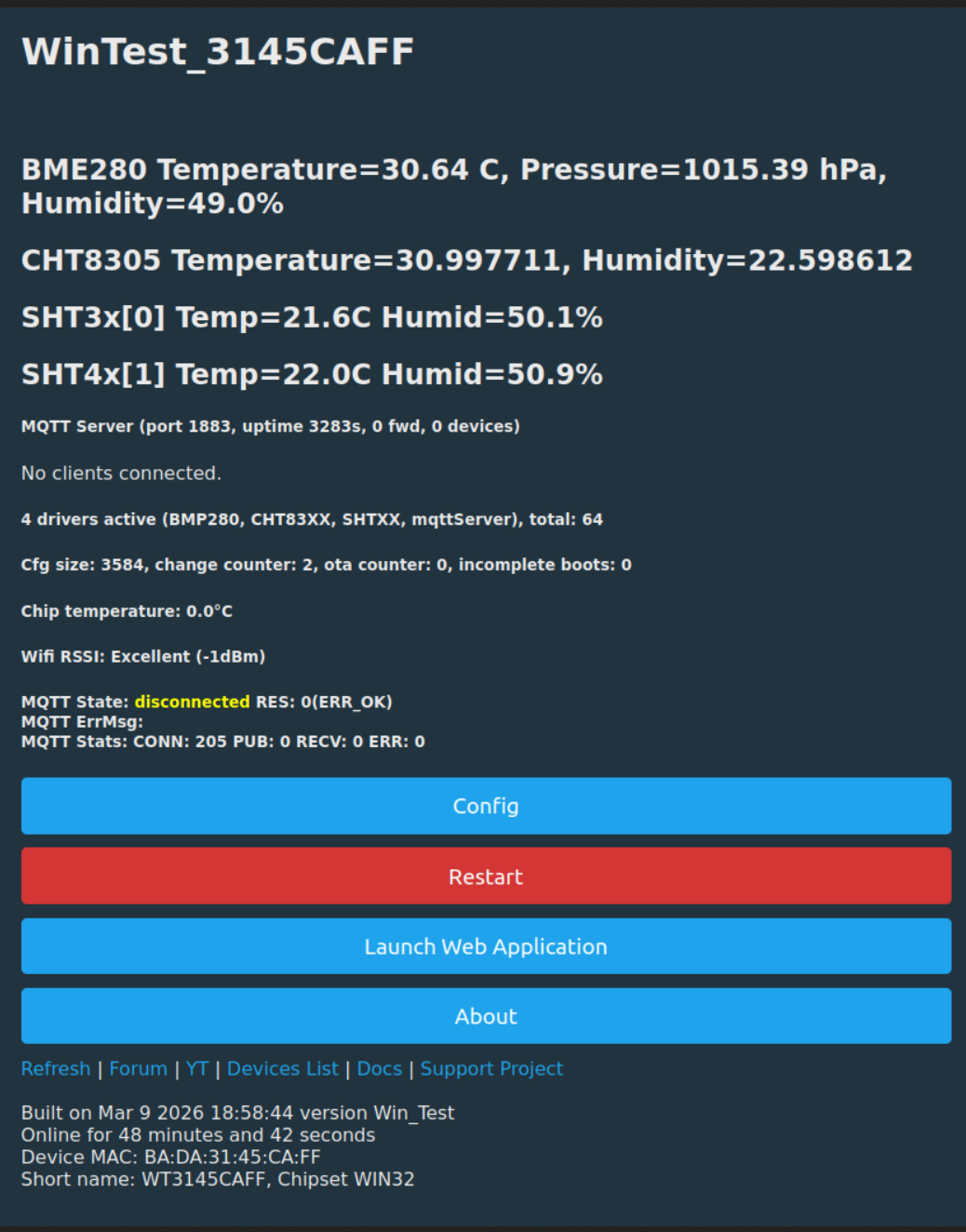

    I2C simulator for some sensors: BMP280/BME28, AHT2X, SHT3x/SHT4x, CHT8305/CHT8310/CHT8315
    Screenshot of “WinTest_3145CAFF” status page with sensor readings and Config/Restart buttons
    VEML7700 driver (and VEML7700 simulated sensor)
    Screenshot of LinuxSim web panel showing VEML7700 readings: Lux292.05 and WHITE4780

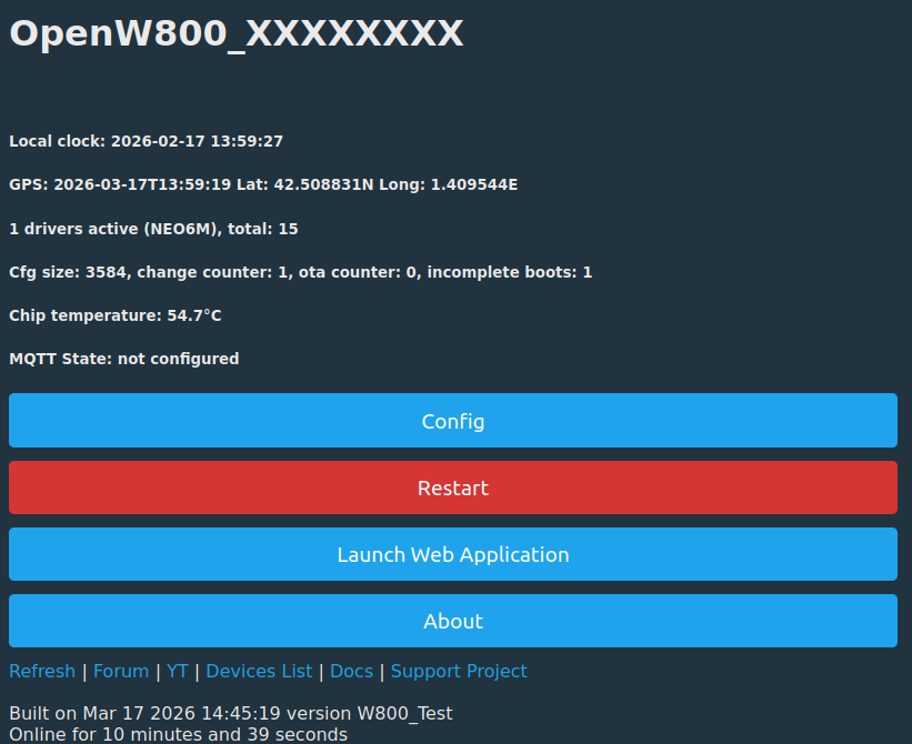

    Made PR #2034 to disable NEO6M driver for W800 and BL602 (and fixed some bugs and did some tuning while at it ;-))
    Ready to merge - driver works for me and otherwise it will only disable the defines for W800 and BL602.
    Screenshot of OpenW800 web interface showing time, GPS data, and buttons: Config, Restart, Launch Web Application, About

    Before doing more work ...
    Here's my basic Idea for the docs: Add "init" to drivers //drvdetail: matching the drivers "Init" function called.
    Then in driver code, add the details for the drivers arguments. I think its much easier to do the "documentation" in the file with the actual driver code, not in "drv_main.c"...
    Screenshot of C source code with driver metadata comments and a documentation preview table below
    Added after 53 [minutes]:
    First try - see documentation for drivers here in my testing branch
