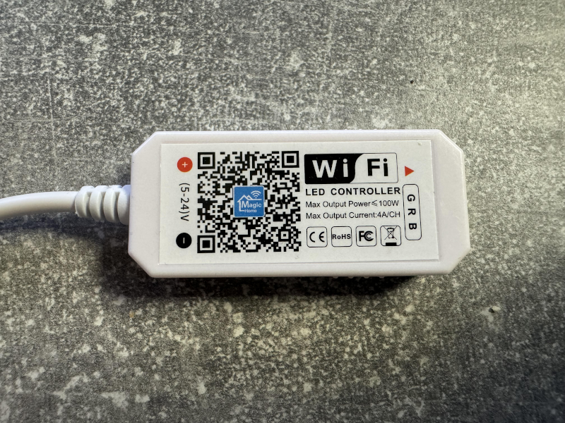

These original devices (with BL602 chip) can be flashed via WiFi to OpenBeken without soldering.
White WiFi LED controller with labels and QR code on housing
This is done via manufacturer's OTA mechanism, but from your own server.
Doing this step by step the procedure is as follows:

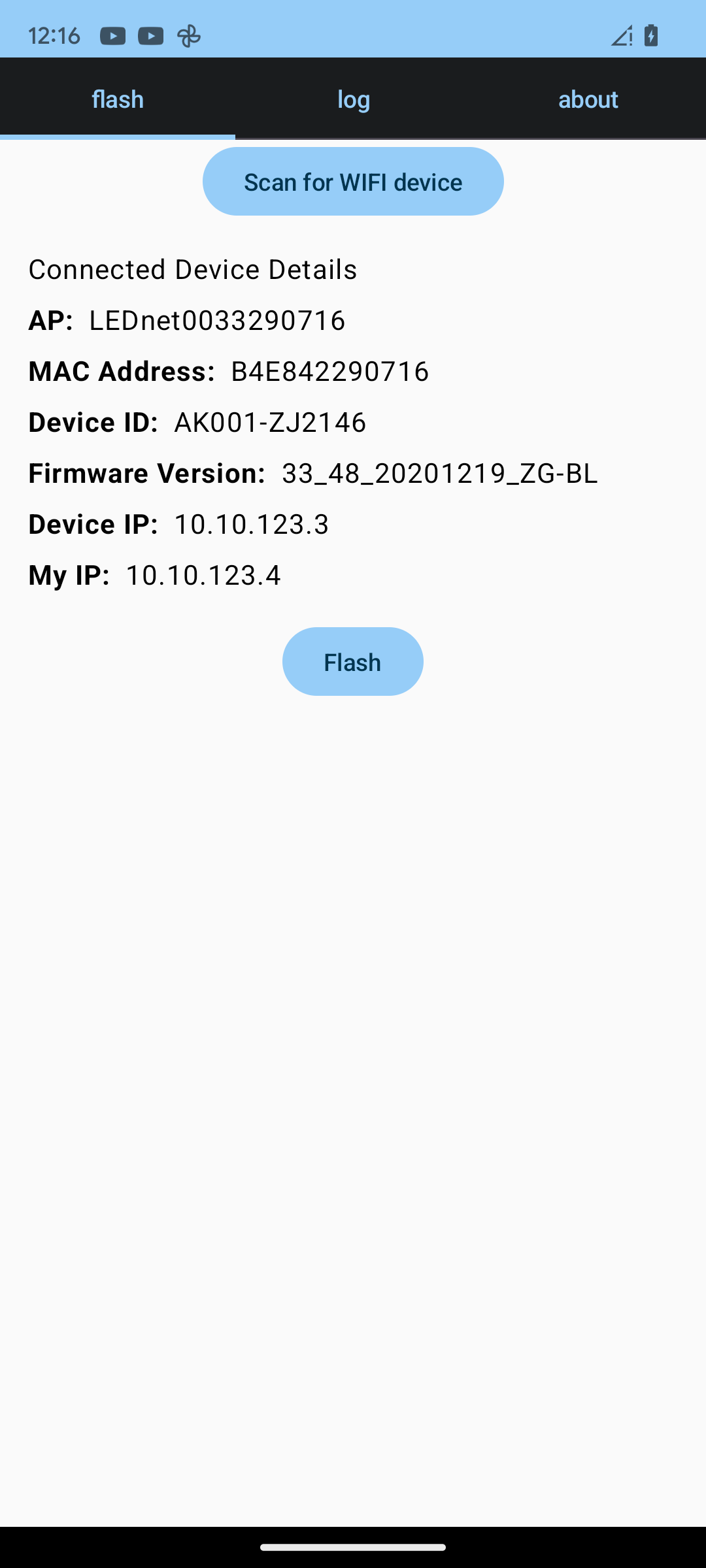

As a side project i made an Android version of this procedure, it is called mhflasher, source is available here
https://github.com/kruzer/mhflasher. Apk's can be downloaded from releases folder
Interface of the mhflasher app on Android showing connected device information.
