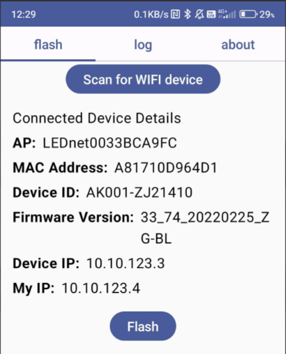

    As a side project i made an Android version of this procedure, it is called mhflasher, source is available here
    https://github.com/kruzer/mhflasher. Apk's can be downloaded from releases folder
    Interface of the mhflasher app on Android showing connected device information.

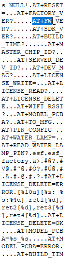

    No, I didn't have any documentation, just a firmware dump, Ghidra, and logging. The console in this device allows for input and output; there are a few commands for viewing RAM or even swapping bytes in memory.
    All AT commands i found are available here

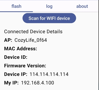

    this is me chancing it with an LN firmware and the APK.
    I don't think I have any Magic Home factory fw. This is with CozyLife which of course broadcasts a different SSID
    Screenshot of an app displaying connection details with a device over WiFi.
    uart output as AP is connected to by app
    what does it check before it'll reveal the flash button? is it just based on the SSID name?
    It tests udp communication on 48899 port first, and this device/firmware likely doesn't support this method.
    But i saw "CosyLife" logo in the firmware dump provided by @p.kaczmarek2 is this a LN882H device?

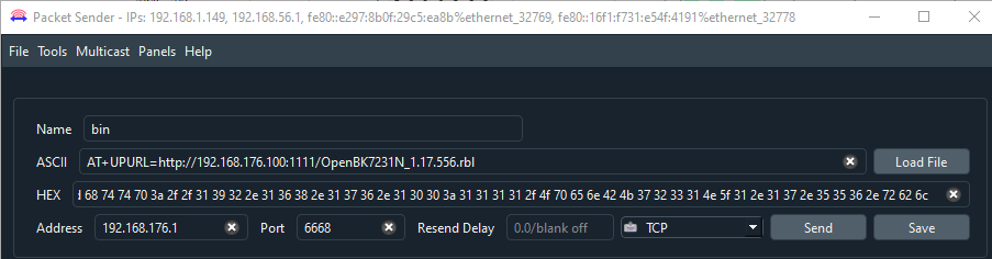

    im trying AT commands after setting up a Python http server. not getting anything interesting happen. The Cozylife AP is 192.168.4.1. I see port 5555 open on the AP IP, but sending AT command does nothing,
    Added after 51 [minutes]:
    Lmk if I should test anything specific
    Added after 8 [hours] 31 [minutes]:
    just adding that I've also played with a BK7231N SmartLife device AP but this requires SSL.
    Windows gets 192.168.176.100 and AP is 192.168.176.1

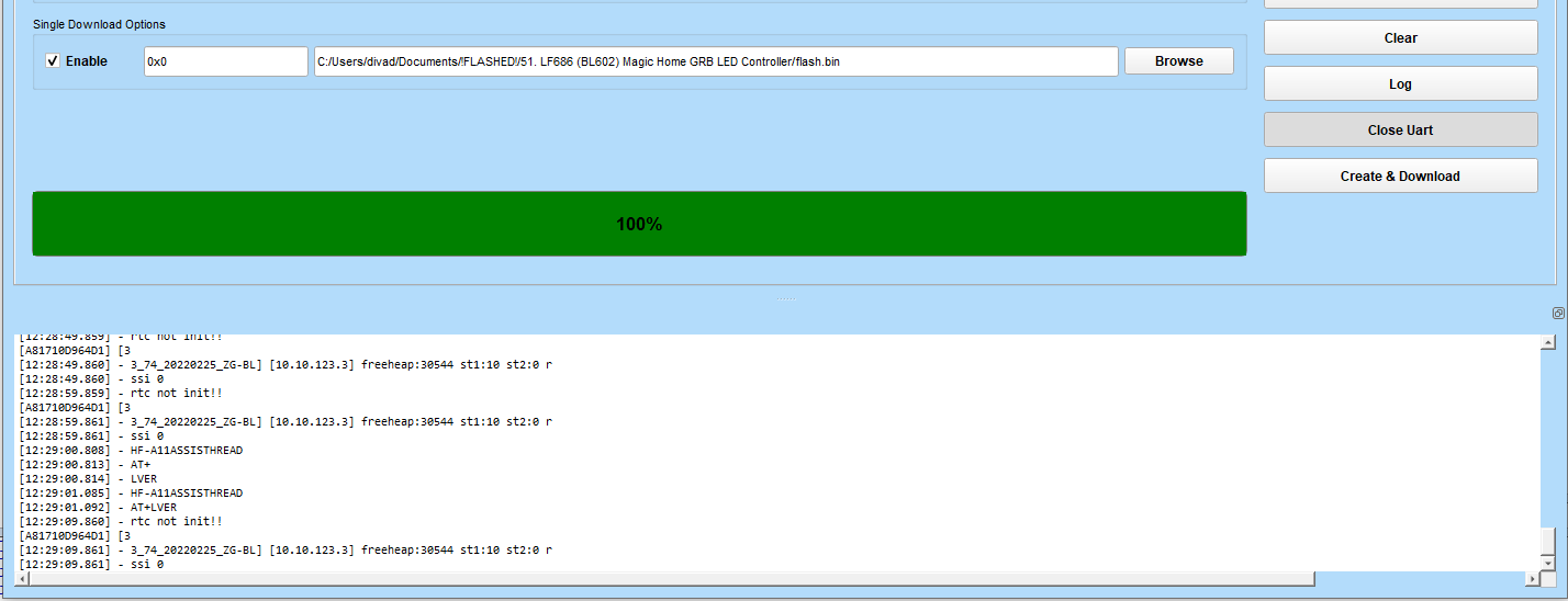

  • #13 21063112
    Posts: 5106
    Help: 441
    Rate: 902

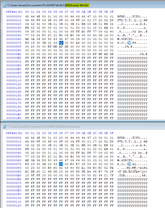

    Dev is 4mb. All flashes I have are from 2mb devices. You think dumps probably include bootloader so I might need to trim or work out a way to flash with file offset?
    I've tried the different partition table files, devcube and blflash.

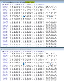

    hmm. seems I have already flashed a bin that I think doesn't need trimming - the Bl602Lamp-4th.bin file from your repo. I trimmed one of my own to start from 0x10000 and it has the same starting code as the lamp now. Still, no success yet
    Screenshot comparing two binary files with hexadecimal code.
    Added after 42 [minutes]:

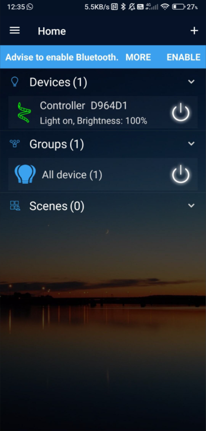

    I took the plunge and decided to flash from 0x0 using the single download option using one my most recent factory dumps - the GRB MagicHome from https://www.elektroda.com/rtvforum/topic4024917-30.html#21040727
    User interface from a software screen for flashing a Magic Home LED Controller.

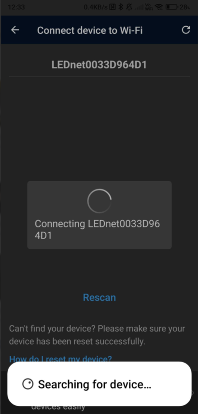

    it now boots and it's broadcasting the "LED..." AP as expected.
    Screenshot of an app for managing a WiFi device with connection details.

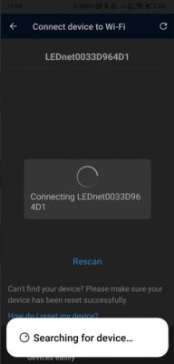

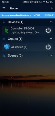

    you can even pair it successfully in the MagicHome app and control the onboard LEDs on the dev board. The blue LED also blinks when the device is in pairing mode.
    Screen showing connection attempt with device LEDnet0033D964D1 in a Wi-Fi setup app.
    Screenshot of the MagicHome app showing a list of devices and groups
    Added after 7 [minutes]:
    here is complete BLDC output from flashing MagicHome fw, rebooting, joining LED... AP with mhflasher, OTA flashing and finally OBK booting :)
    • mhflasher.txt (119.62 KB) You must be logged in to download this attachment.

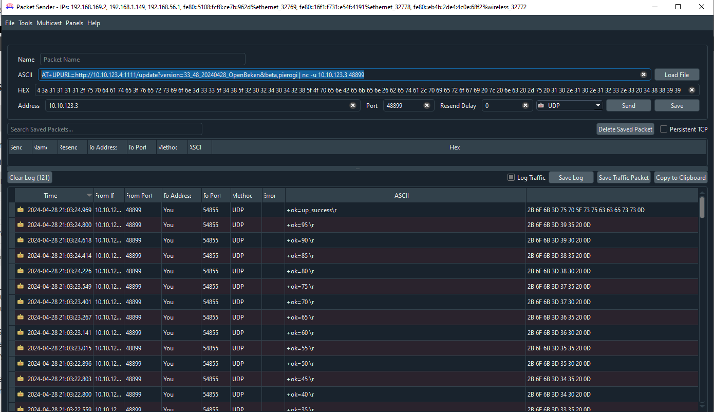

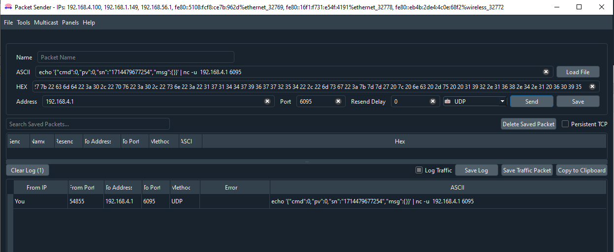

    if anyone wants to try in Windows you can use PowerShell and the free app Packet Sender https://packetsender.com/download
    Get your MagicHome device into AP mode with 5 sequential resets. Connect to the LEDnetXXXXXX AP.
    Open PowerShell and run this, changing the path and filename to suit
    Code: Powershell
    set UDP, device IP and port then send this command in Packet Sender
    You'll see the Packet Sender upload and OK
    Packet Sender application window showing UDP request details and packet transfer logs.
    when it's finished it'll reboot and run OpenBeken.
    If you're watching the uart log out you'll see the flash progress, completion and the reboot

    for example, here's mention of AT+ commands inside the fw for an RMW002 BL602 Ewelink mini switch which broadcasts the Sonoff-like "ITEAD-XXXX" AP.
    Fragment of code with AT commands from documentation related to an Ewelink device.
    I will persist.

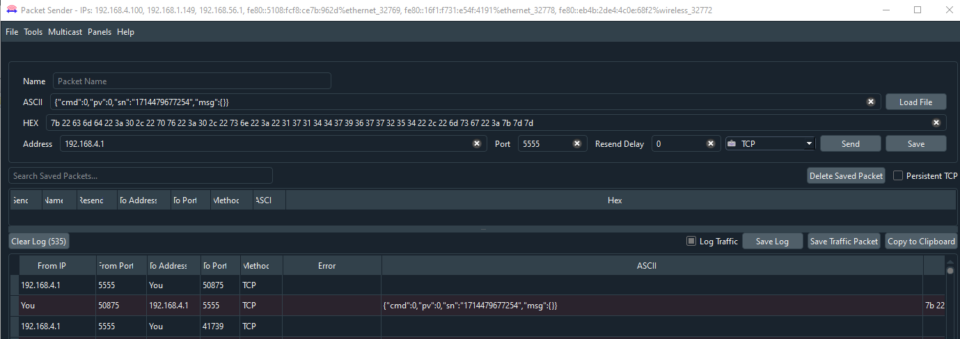

    alwas wrote:

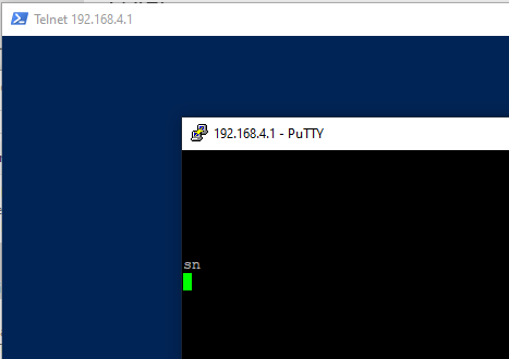

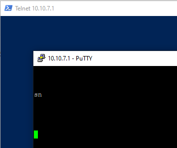

    maybe someone could try to telnet to this port 5555 and try commands:
    hmm. no connection with PowerShell or Putty to 192.168.4.1:5555 on LN882H device.
    Screenshot of a PuTTY window with IP address 192.168.4.1.
    Added after 31 [minutes]:

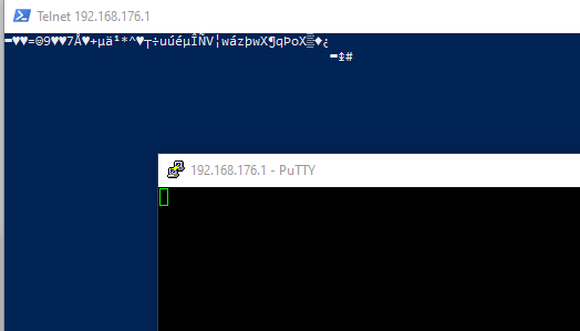

    no luck with a SmartLife BK7231N on 192.168.176.1:6668 either
    Screenshot of attempted connections via Telnet and PuTTY to IP addresses.
    Added after 5 [minutes]:
    nor BL602 Ewelink 10.10.7.1:80 device
    Screenshot displaying a PuTTY window with address 10.10.7.1.

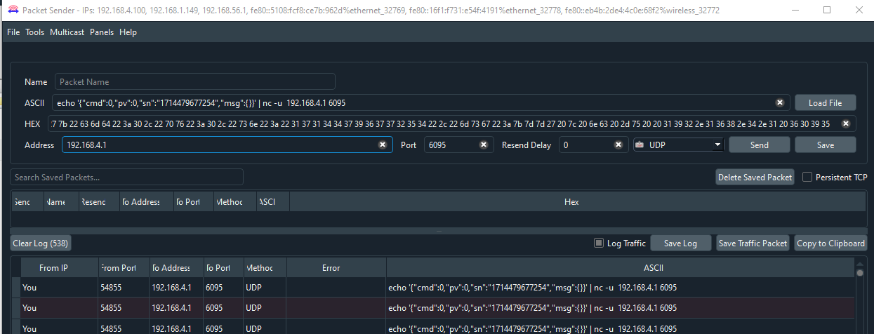

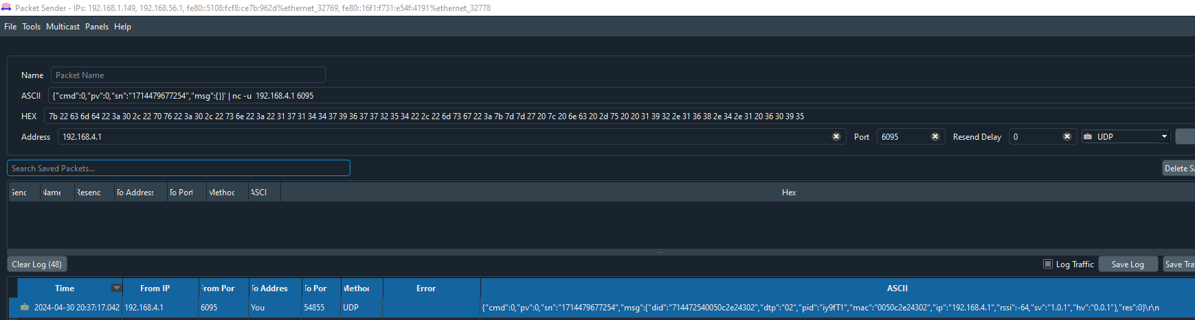

  • #19 21065603
    alwas
    Posts: 42
    Rate: 23

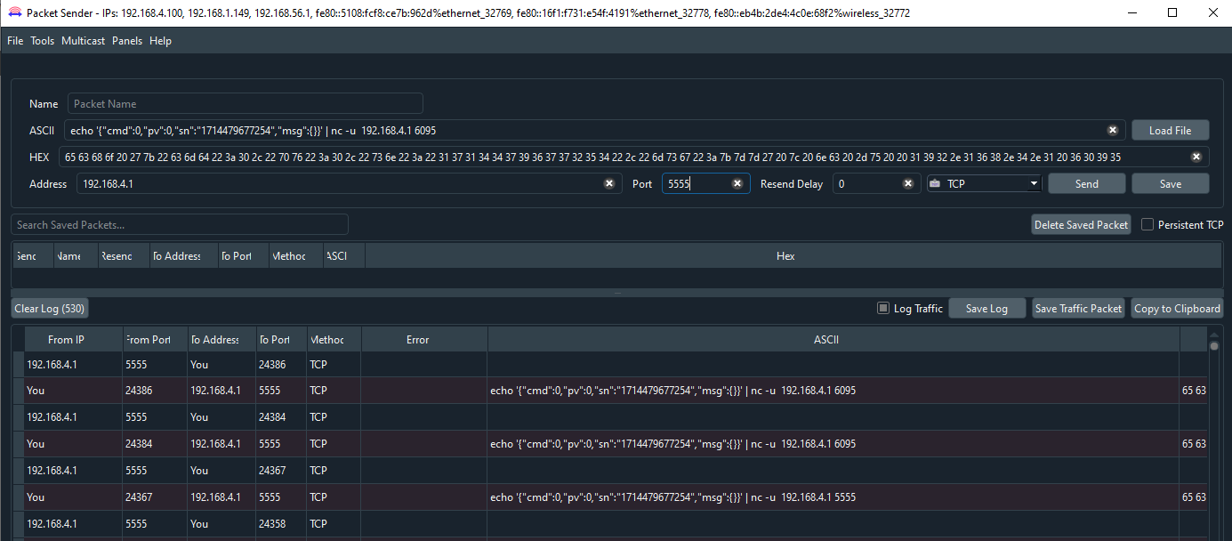

    ok, maybe let's try json formatted string:
    {"cmd":0,"pv":0,"sn":"1714479677254","msg":{}}
    with a different endline - Enter or ctrl-d or ctrl-x at the end
  • #20 21065622

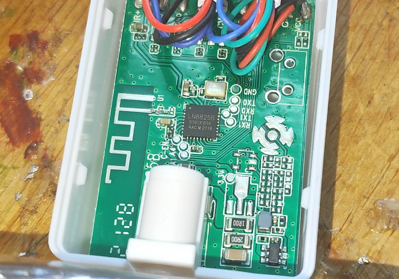

    I still have LN8825 LED strip controller, maybe we can also check that one for some endpoints?
    LED strip controller LN8825 with visible wiring and integrated circuits.

    try this one
    echo '{"cmd":0,"pv":0,"sn":"1714479677254","msg":{}}' | nc -u  192.168.4.1 6095
    on LN882H and check if it gives any response
  • #23 21066032
    Posts: 5106
    Help: 441
    Rate: 902
    Screenshot of the Packet Sender application showing details of sent and received network packets.
    no response
    Screenshot of Packet Sender application displaying data packets.
    not sure what this means though
  • #24 21066039
    alwas
    Posts: 42
    Rate: 23
    try sending the same payload to UDP 6095
  • #25 21066044
    Posts: 5106
    Help: 441
    Rate: 902
    no reply
    Screenshot of the Packet Sender application showing UDP packet configuration to send to IP address 192.168.4.1 via port 6095.
  • #27 21066060
    Posts: 5106
    Help: 441
    Rate: 902
    hmm. Can't quite remember the one I flashed. I reflash.
    6095 is open on this one
    Added after 4 [minutes]:
    Screenshot of a Packet Sender program showing packet settings for sending to address 192.168.4.1 via UDP port 6095.
  • #28 21066065

    I played with the command and now get a response
    Screenshot of Packet Sender tool displaying network packet data.
  • #30 21066089
    alwas
    Posts: 42
    Rate: 23
    cool, now we have the communication medium, the command to send is only the fragment - json string
