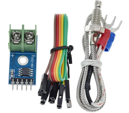

K-type thermocouple with MAX6675 A/D converter module, kit.
The K-type thermocouple together with the MAX6675 A/D converter module allows you to easily measure high temperatures from 0°C to 800°C with 12-bit resolution. The kit presented here operates on a voltage from 3 V to 5.5 V and uses a simple SPI protocol for communication, which can be equally well implemented on any three GPIOs of the selected microcontroller.
Let's probably start with the most important thing, i.e. the price - at the moment of writing this topic, the whole kit can be bought with shipping for a few tens of zlotys in our country, and importing from China we can close in the amount of 10 zlotys.
Offer of type K temperature sensors with MAX6675 module Screenshot of the MAX6675 temperature module offer with a Type K thermocouple.
It is only important to order the whole set, and not accidentally the module alone with the MAX6675.... and by the way let's have a look at its catalogue note:
