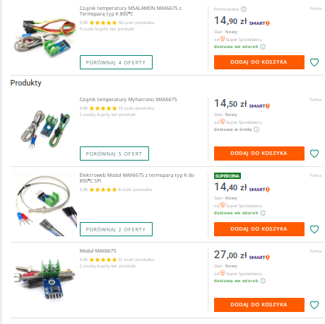

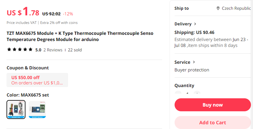

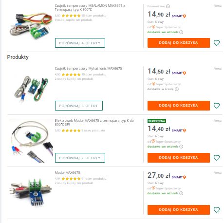

    Let's probably start with the most important thing, i.e. the price - at the moment of writing this topic, the whole kit can be bought with shipping for a few tens of zlotys in our country, and importing from China we can close in the amount of 10 zlotys.
    Offer of type K temperature sensors with MAX6675 module Screenshot of the MAX6675 temperature module offer with a Type K thermocouple.
    It is only important to order the whole set, and not accidentally the module alone with the MAX6675.... and by the way let's have a look at its catalogue note:

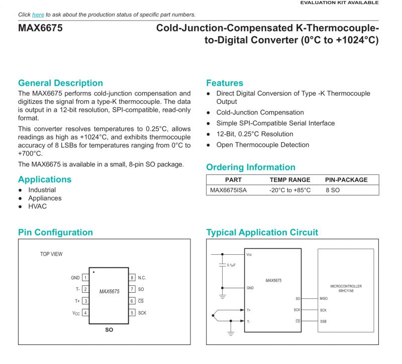

    Diagram of applications for MAX6675 chip
    The connection to the MCU seems to be very simple, only three lines are needed
    MISO, SCK, SSB, but let's not forget also the common ground and the power supply.

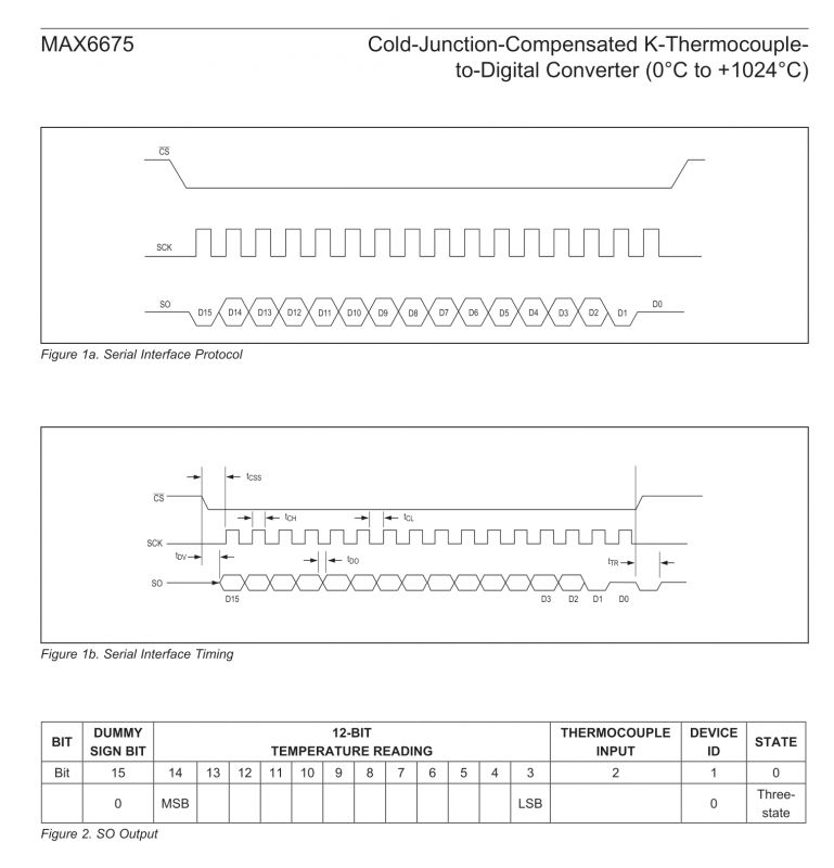

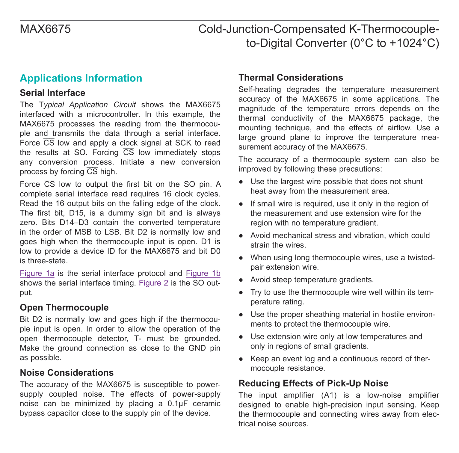

    The SPI protocol - it sounds scary, but in practice here SPI is used in the simplest possible way. The datasheet note describes how the communication is done:
    Page from the MAX6675 datasheet.
    Visually presented communication:
    Diagrams showing the serial interface protocol and data reading method for the MAX6675 chip.
    So basically we set the CS to a low state, then manipulate the clock and read the next bits from the SO. The whole thing has to be done at the same time respecting the timings, but everything is on the diagram. The meaning of the 16 bits read is also defined in the diagram - we are mainly interested in the 12 bits of measurement, i.e. bits 3 to 14 inclusive.

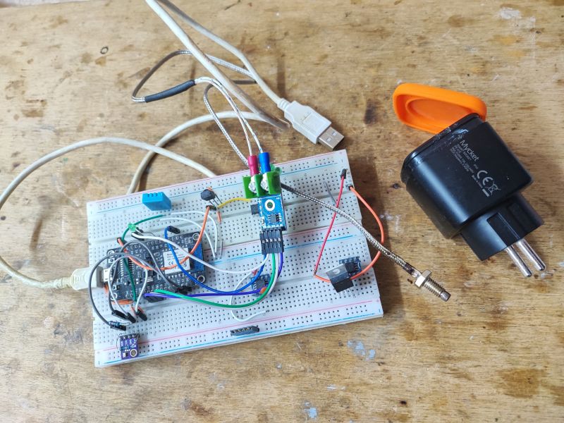

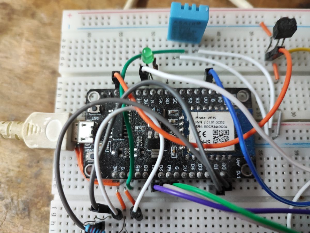

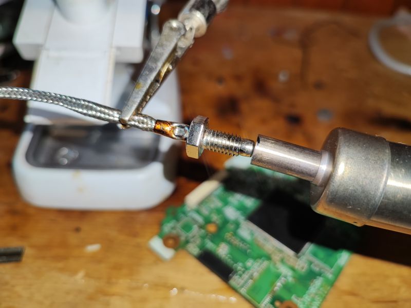

    What can this be used for? In my case, the kit with the MAX6675 is useful for hot air testing:
    Type K thermocouple with MAX6675 A/D converter module on a breadboard.
    Microcontroller with connected wires on a breadboard Close-up of a type K thermocouple connected to a screw in a workshop setting.
    This is extremely useful for me, because, as I have found out over time, the temperature actually 'seen' by the PCB can differ significantly from the temperature on the display of the hot air station, depending on which station you have and what blowing you set. I document my measurements and put them on interactive graphs ( version 350°C , version 450°C ).

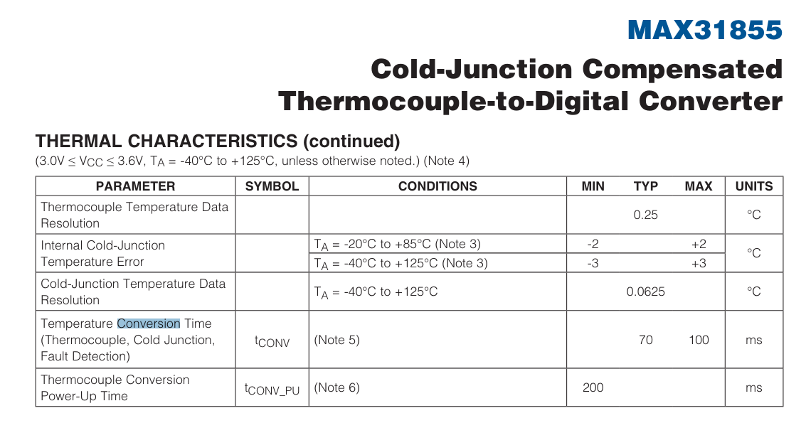

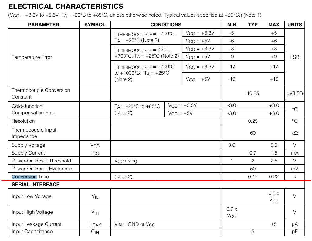

    It is better to use the MAX31855 chip, the max6675 at 2 measurements per second above 600* "jams" and the measurements change every 2-3s. I was making a controller for EGT reading in the car and just initially this module was used but on testing errors came out, MAX31855 3 readings per second and zero problems.
  • #3 21070494
    Posts: 14771
    Rate: 12914
    That's interesting, I haven't encountered this problem with the MAX6675, only that I only use it up to 500°C. Additionally, according to the datasheet for the MAX6675 it should not take more than 0.22s:
    Table of electrical characteristics for the MAX6675 sensor, including conversion time.
    MAX31855 on the other hand has 0.1s:
    Table with thermal characteristics for the MAX31855 converter.
