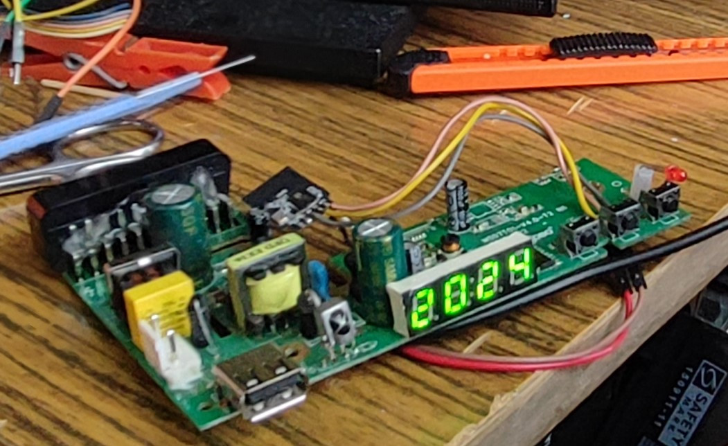

Close-up of an electronic circuit with a LED display showing 2024. In the previous topic I managed to capture the HD2015 communication using a Salae logic state analyser, bought for PLN40. Here I will continue the work and try to map this communication in my code written in C, for variety I will use the LN882H platform here. By the way in practice I will compare the handling of this controller with controllers such as TM1637, TM1638, etc.

There was chaos at first
There's not much to comment on here, but my fun is to remove what is unnecessary from such electrical junk and revive it with new microcontrollers, preferably WiFi. This is better than desoldering ICs which are then often not used at all anyway.... so first I removed what was unnecessary from the patient:

First communication
In the previous section I collected the packages responsible for displaying the time 14 on the display, so here I simply tried to send them. I program the LN882H WiFi module via OTA in OpenBeken. and I compile online on Github , because it's more convenient that way.
In OBK I have a simple software I2C based on the bit-bang method:
Code: C / C++
It's worth mentioning here that, again, it's not really I2C because, as I found out during the protocol analysis, this chip doesn't support addressing multiple devices on a single bus, it just immediately gets the address of the command (or register?) with only the R or W bit set accordingly, but that doesn't actually change anything for me. By calling Soft_I2C_Start I am therefore specifying not the address of the device itself, but of the target register, and without the bit offset.
The bytes sent are from the subject line:
Salae 24MHz logic state analyser for PLN40 - analysis of unknown LED display protocol Here's the result:
Close-up of a green PCB with an LED display showing 8:8.8 and connected wires.
That is, I captured the communication well. Everything works.
I'll just add one important tip here - when sending, it's a good idea to verify with a logic analyser that you are sending what you think you are sending.
