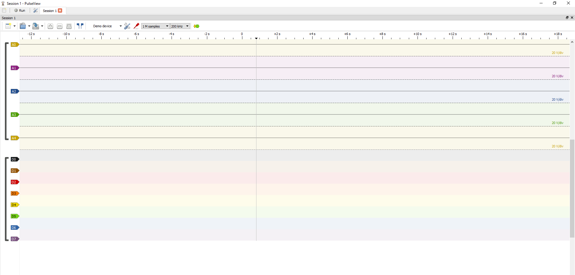

    My software of choice is PulseView, PulseView is a graphical interface for Sigrok, the application was written in the QT environment and is available for free:
    https://sigrok.org/wiki/PulseView
    You can download it here, both in 32 and 64-bit versions:
    https://sigrok.org/wiki/Downloads
    PulseView allows you to capture live data from the analyzer and play back data previously saved to a file. After starting, we are greeted by a minimalist interface:
    Screenshot of PulseView application with multiple signal channels.

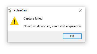

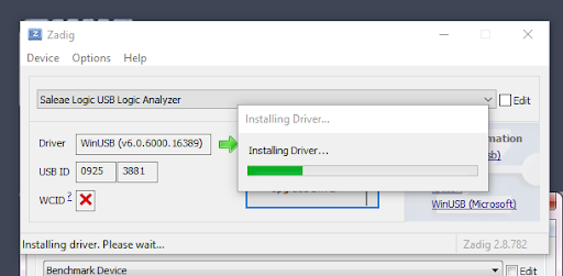

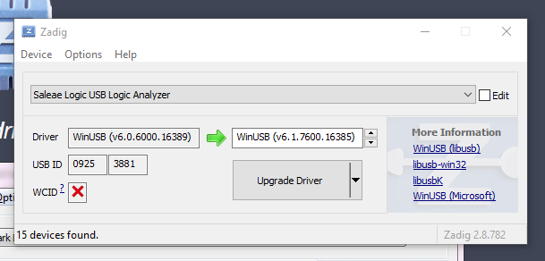

    But it is possible that the analyzer will not be detected yet:
    PulseView error message indicating no active device is set.
    Then you need to install the drivers, I downloaded them from here:
    https://zadig.akeo.ie/
    I selected my analyzer in the list and started the installation:
    Screenshot of Zadig software for USB driver installation
    Zadig driver installer dialog box showing driver installation process.

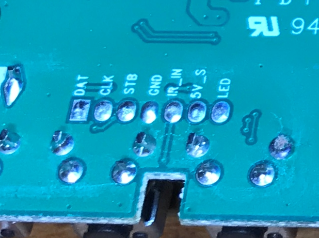

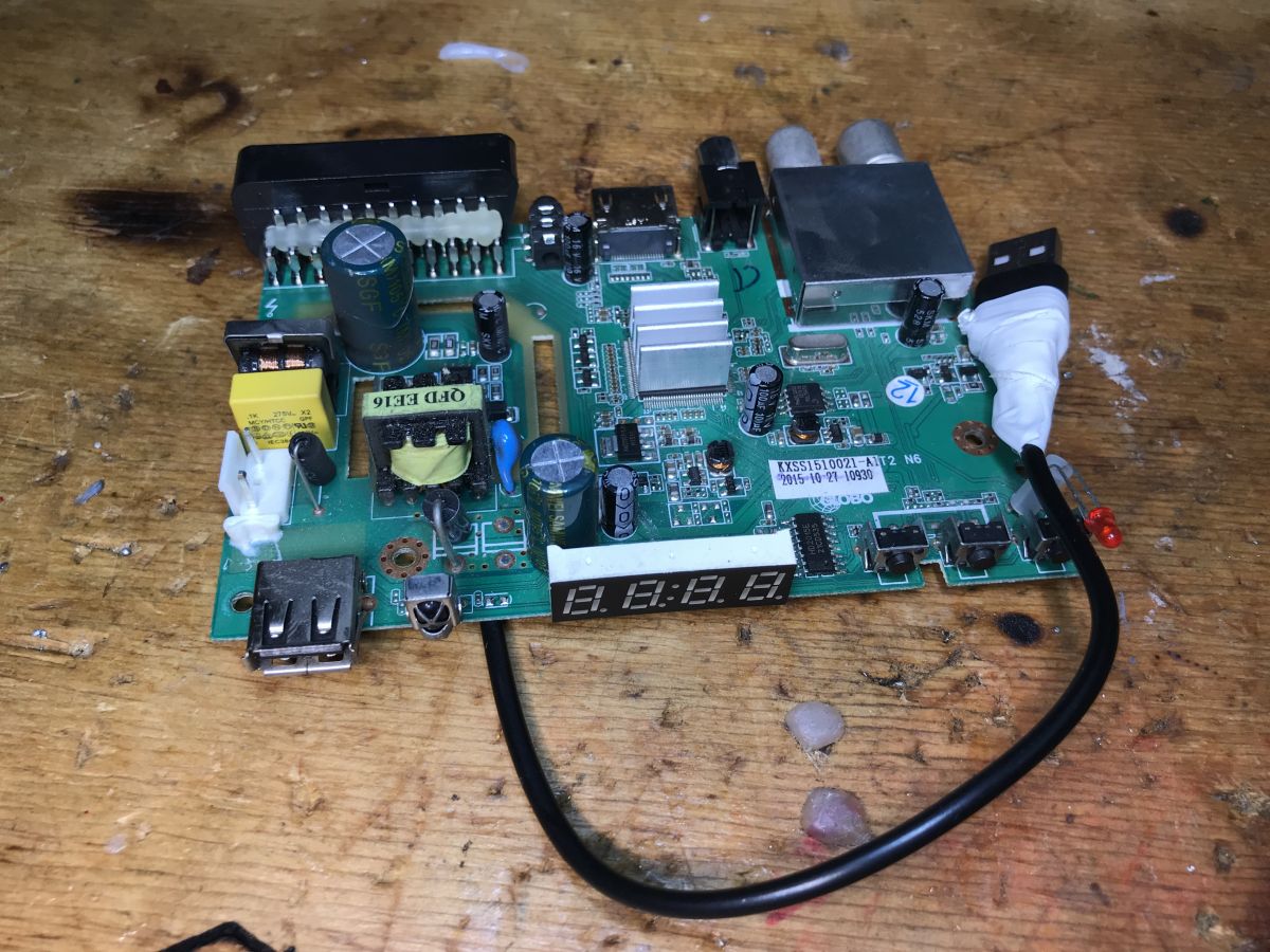

    Preparation of equipment - HD2015E LED controllerclass="notranslate">
    As part of the Salae demonstration, we will capture I2C communication of a 4-digit, 7-segment LED display controller with additional button support. The display board comes from this topic:
    Old DVB-T2 decoder - STB HD N6 - interior, potential for conversion into a DIY clock

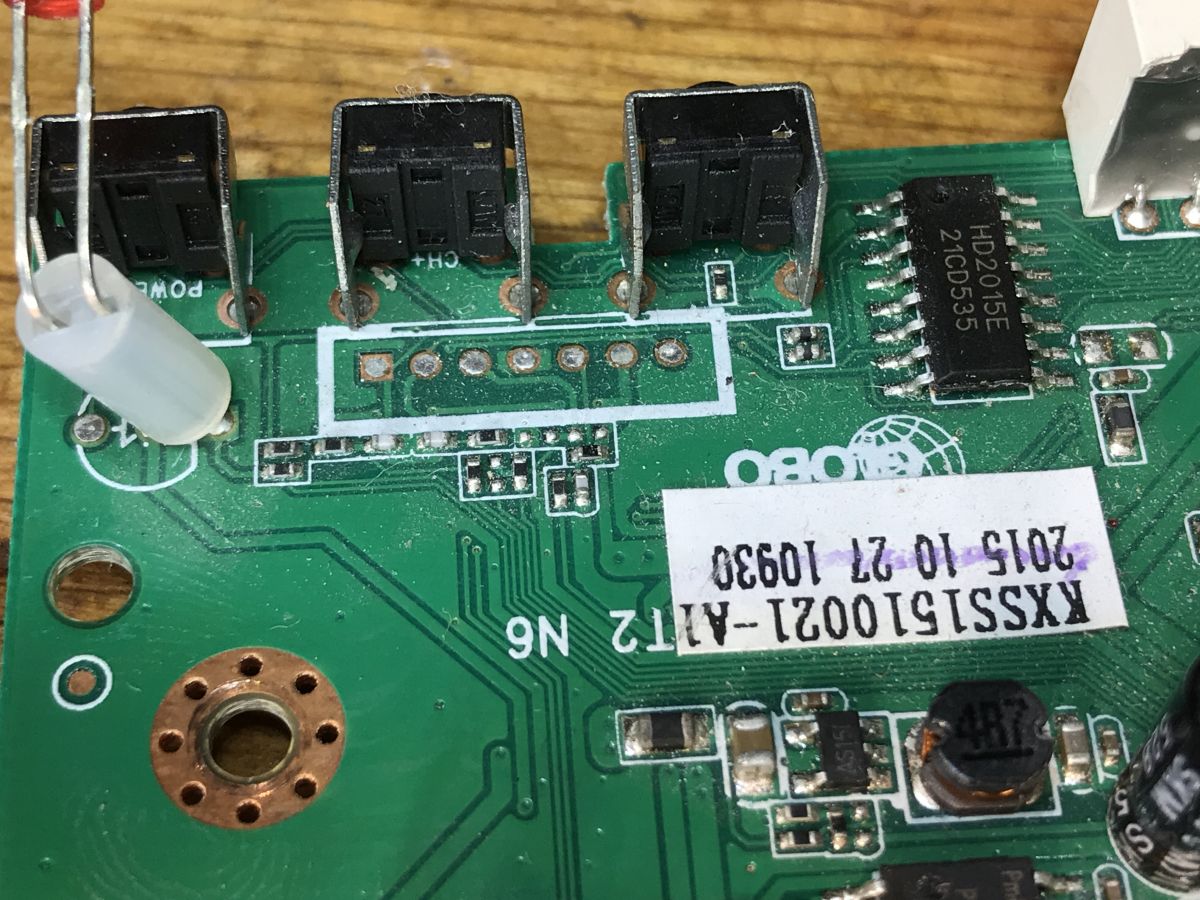

    Even without knowing the pins of the system, it is easy to know what is connected where, because we have signals output to the pads. Both power supply, CLK and DAT are signed:
    Close-up of a circuit board with connectors labeled DAT, CLK, STB, GND, IR_IN, 5V_S, LED.
    In the photo below you can see that CLK and DAT are connected to the HD2015E pins via two resistors.
    HD2015E chip on a circuit board with components and connectors.

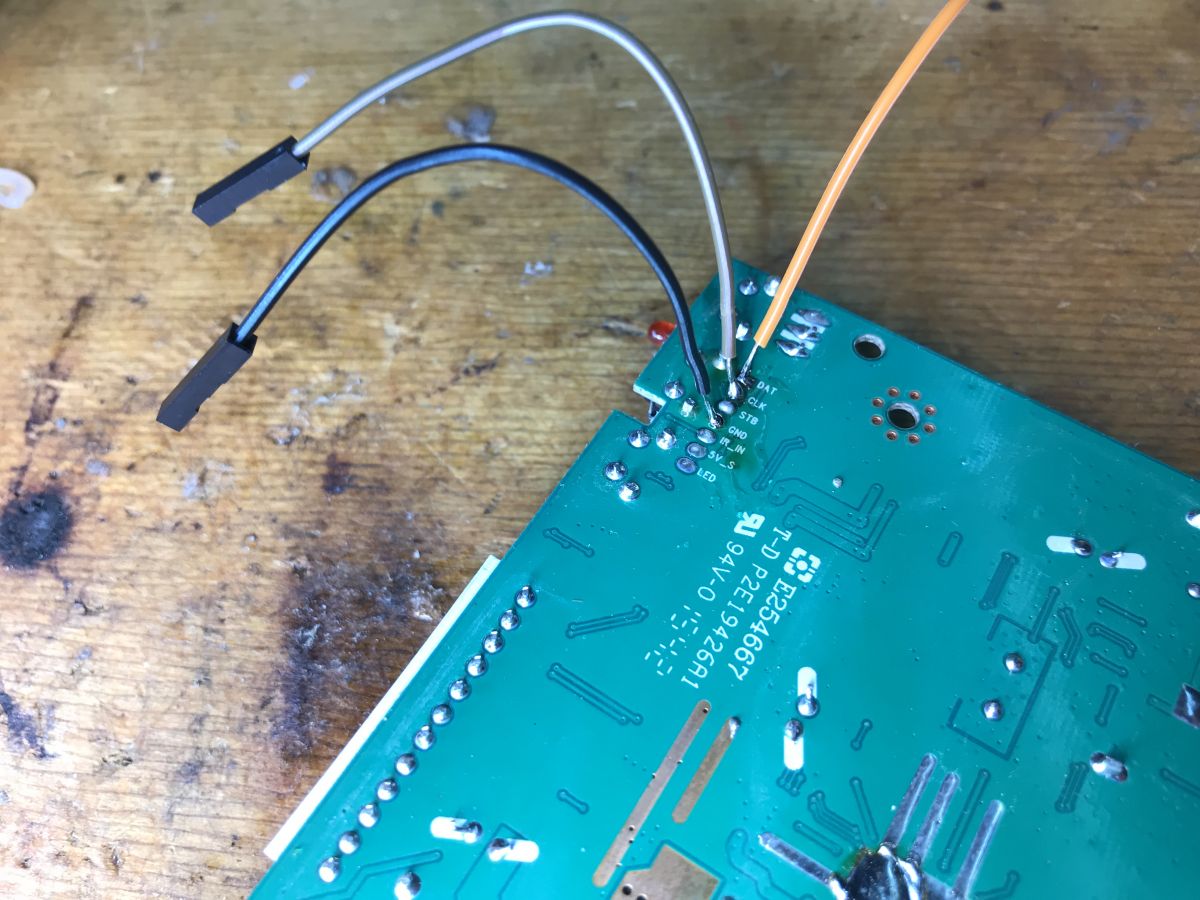

    All that remains is to connect the analyzer - but how?
    First of all, you should ensure safe power supply to the tested system, not all converters provide isolation from the mains, so I recommend powering everything from the same laptop/computer on which we perform the analysis. . I will not delve into this topic, because the Salae analyzer is discussed here, but as a good rule of thumb, I simply checked that the power supply on the board gives 5V and I decided to solder a 5V cable to the output of this power supply:
    Close-up of a green PCB with soldered wires and electronic components.
    A circuit board with electronic components and a 7-segment display.

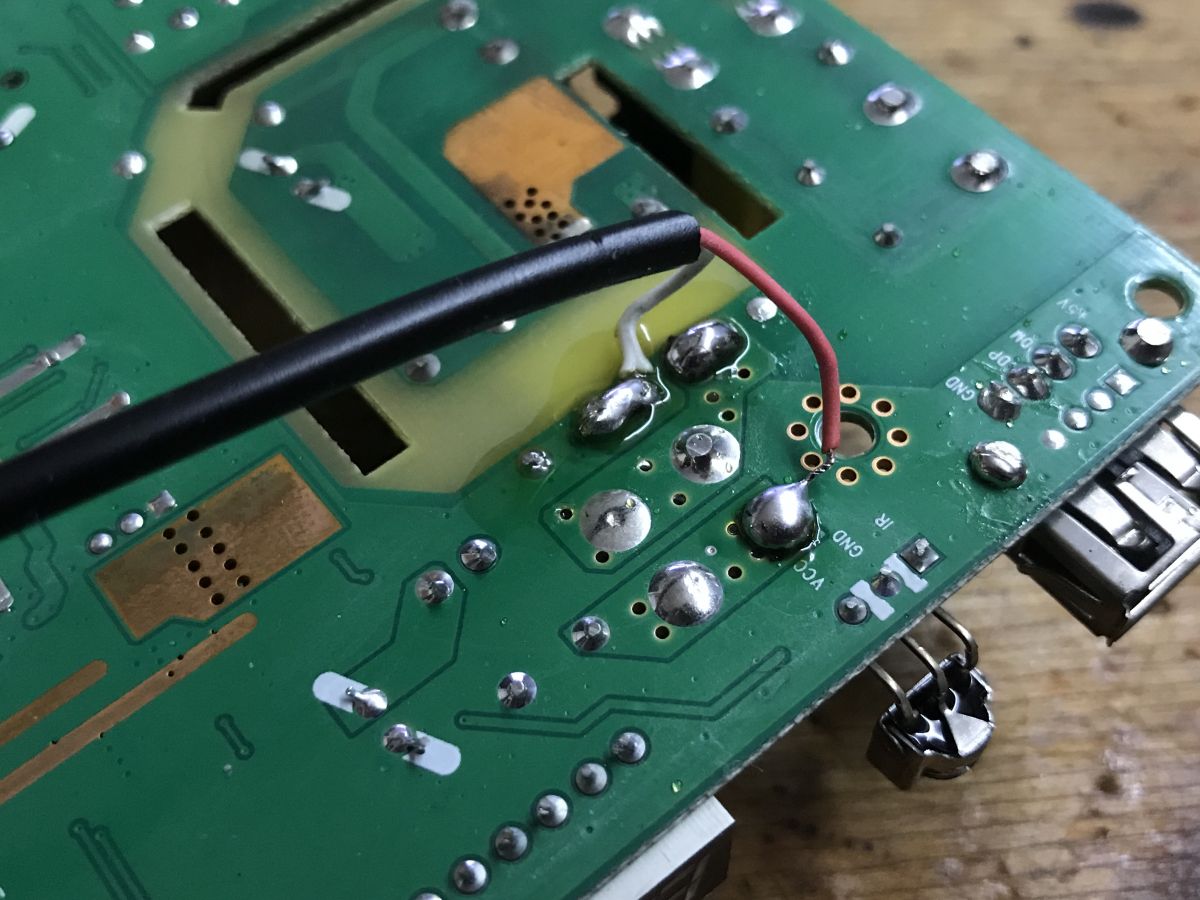

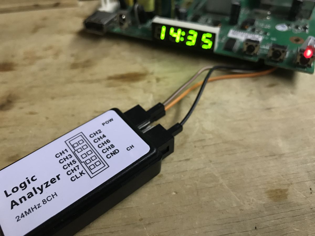

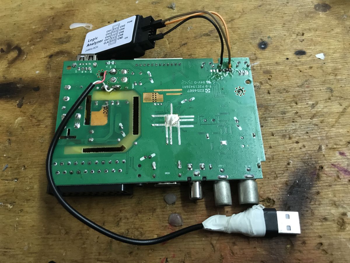

    Now you need to connect the analyzer. We connect the channels we are interested in and be sure to do so too mass , we need to have a common benchmark.
    Circuit board with cables connected for I2C analysis.
    Whole system:
    Circuit board with connected logic analyzer.
    The whole thing will be powered by the USB of one computer, without access to the network.

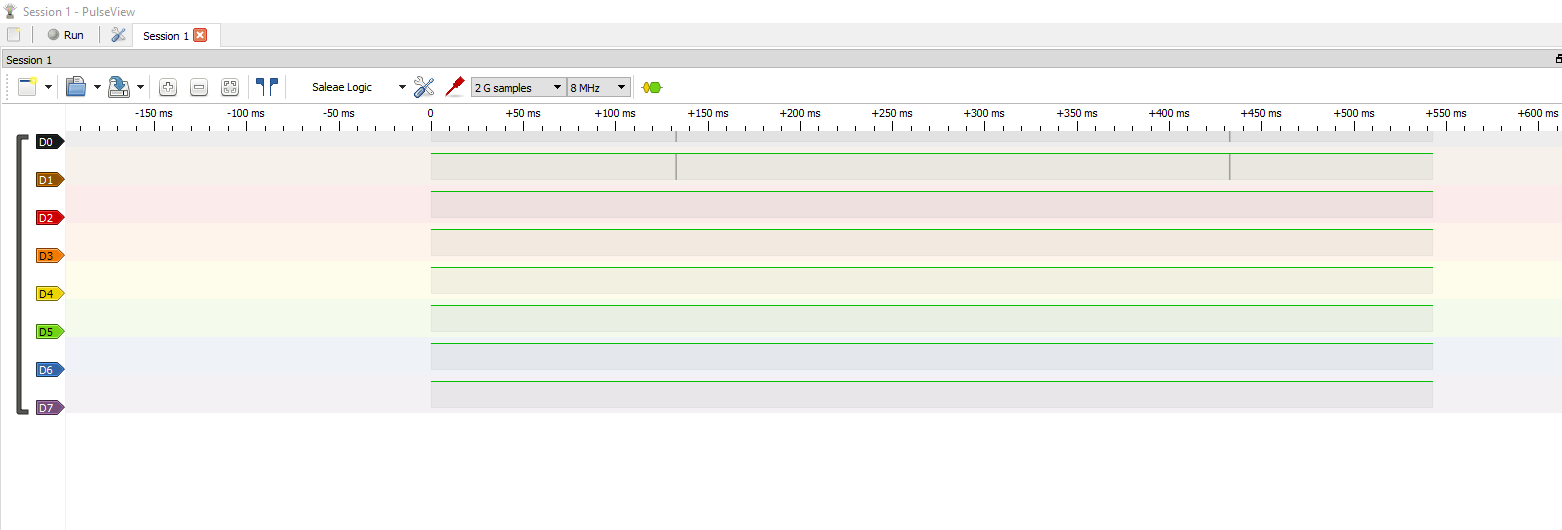

    Capture and analysis

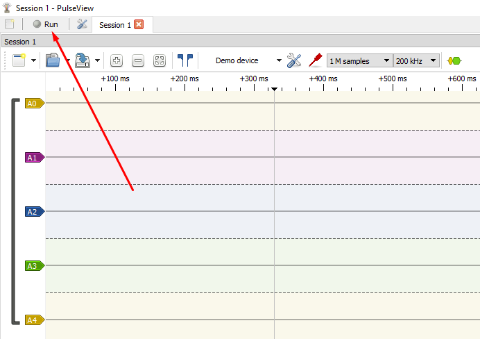

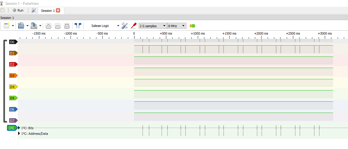

    We launch Pulseview and click Run, here:
    Screenshot of PulseView program showing an analysis session.
    The capture should start. In case of problems, it is worth trying to restart the program, computer and possibly reinstall the drivers, but I assume that you have already installed them before.

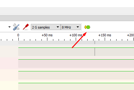

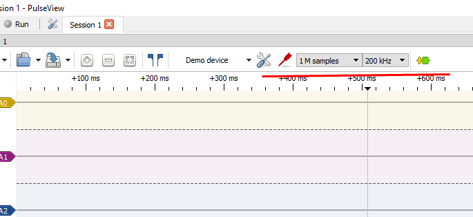

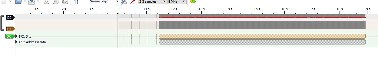

    If necessary, it is also worth increasing the sampling density:
    PulseView interface for logic analysis with sampling settings.
    Initially, I had the sampling set so sparsely that the observed I2C was too fast to read.

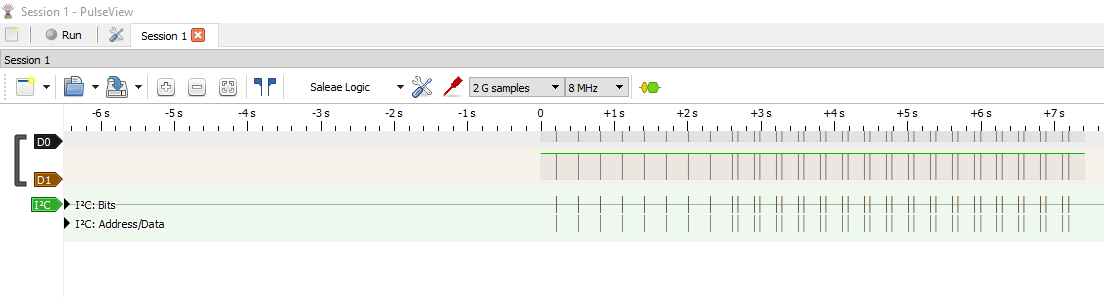

    Only the settings as below gave me the result:
    Screenshot of PulseView application with logic state graph.
    The screenshot shows that something happens from time to time. Capture was enabled with the tuner running. What could this be? I suspect it`s keyboard "polling". The display shows the channel number all the time, so it doesn`t need to be refreshed, so it`s probably not the display. However, I don`t see any interrupt pin for pressing a key (some INT, interrupt), so the MCU probably regularly polls the controller about the status of the keys.

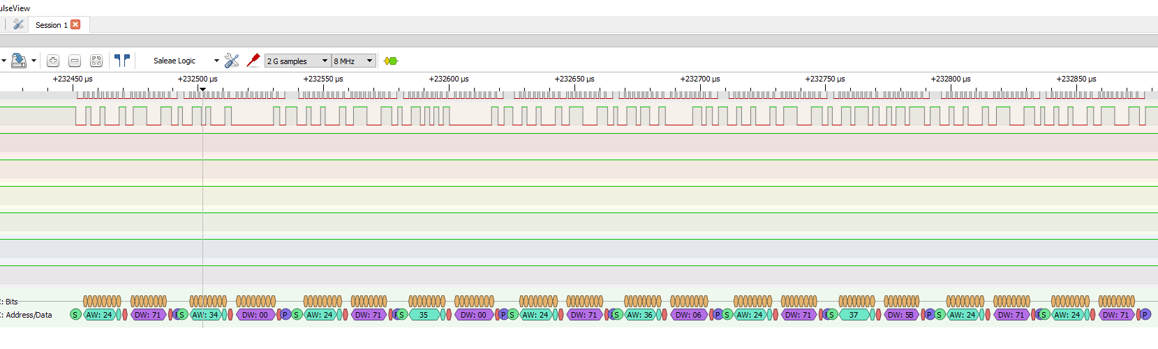

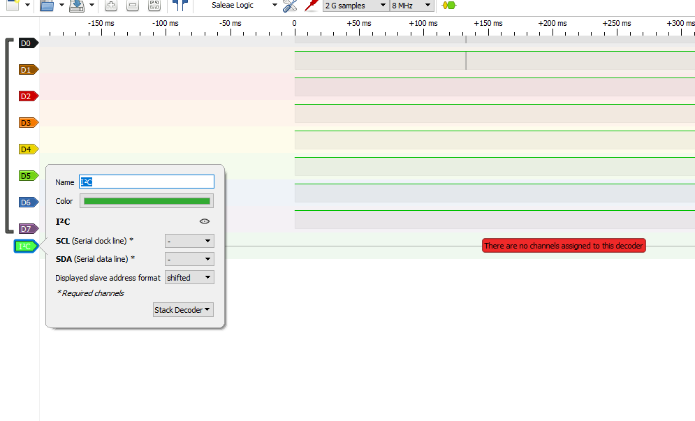

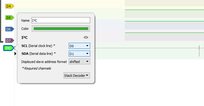

    Now it`s time to decode the collected data. We can decode them as I2C:
    Screenshot of Pulseview application with Run button highlighted

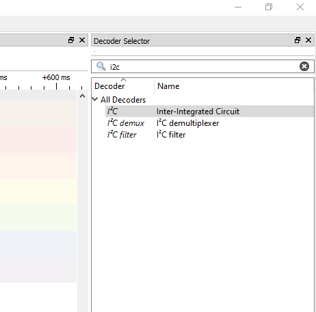

    Pulseview decoders are built by the community. We select from the I2C list:
    Screenshot showing the I2C decoder selection panel in PulseView.
    The I2C decoder will appear on the timeline, but you still need to click on it to set the SDA and SCL lines:
    View of PulseView interface with I2C decoder settings.
    I set it according to the connections from the board:
    Screenshot of I2C decoder configuration in PulseView
    From this point the slow I2C decoding process will begin. Patience! With long timelines this may take some time.

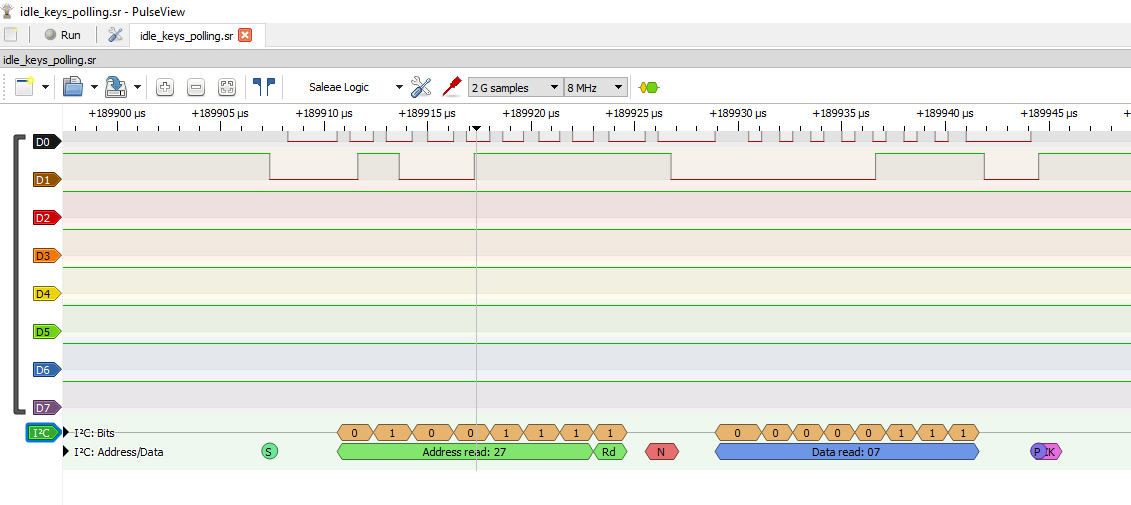

    Communication analysis - idle state
    By "idle state" I mean the equipment is turned on but no operations are performed. A channel is simply selected and the user does nothing.
    Nevertheless, from time to time something happens and we capture something:
    Screenshot of Pulseview software displaying a session of I2C data analysis.
    Let`s zoom in and see what`s being transferred:
    Screenshot of PulseView software showing I2C bus signal analysis.

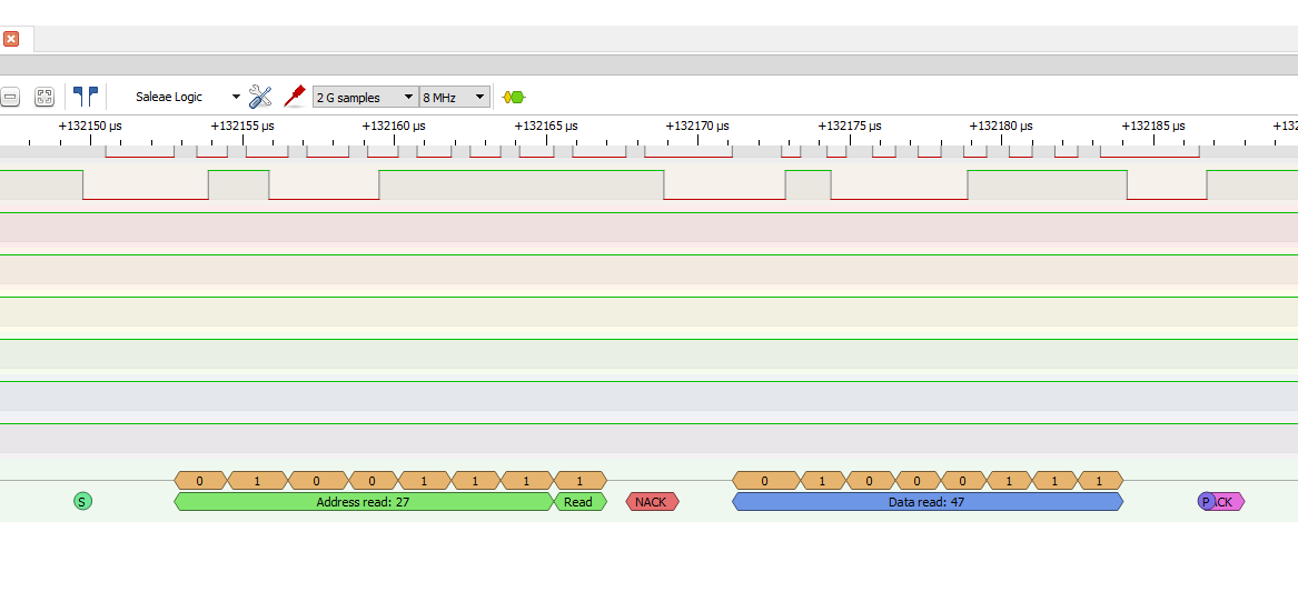

    It seems that one address is given (it is not the address of the device, but of the register, probably the protocol here is not actually I2C, I have already seen versions without the device address) and then data from this address is read.
    I suspect that this is asking the system about the state of the keys, the so-called "polling". This chip does not have an INT/Interrupt pin to indicate that something has happened, so the MCU must regularly query it about the state of the keys to see if anything has changed.
    The state of the keys is read from register 0x27 (or: command 0x27).
    The response 0x07 is the same every time, but will it change when I hold down a key?

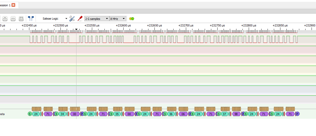

    Let`s take a closer look at them. First, the package I suspected of handling keys;
    Logic signal analysis on the I2C interface.
    The read value changes. The register is still 0x27, but now we read 0x47 and not 0x07.
    Bitwise it is:
    - 0x07 -> 0000 0111
    - 0x47 -> 0100 0111
    So one key equals one bit, as expected. Probably pressing the second key would light a different bit.

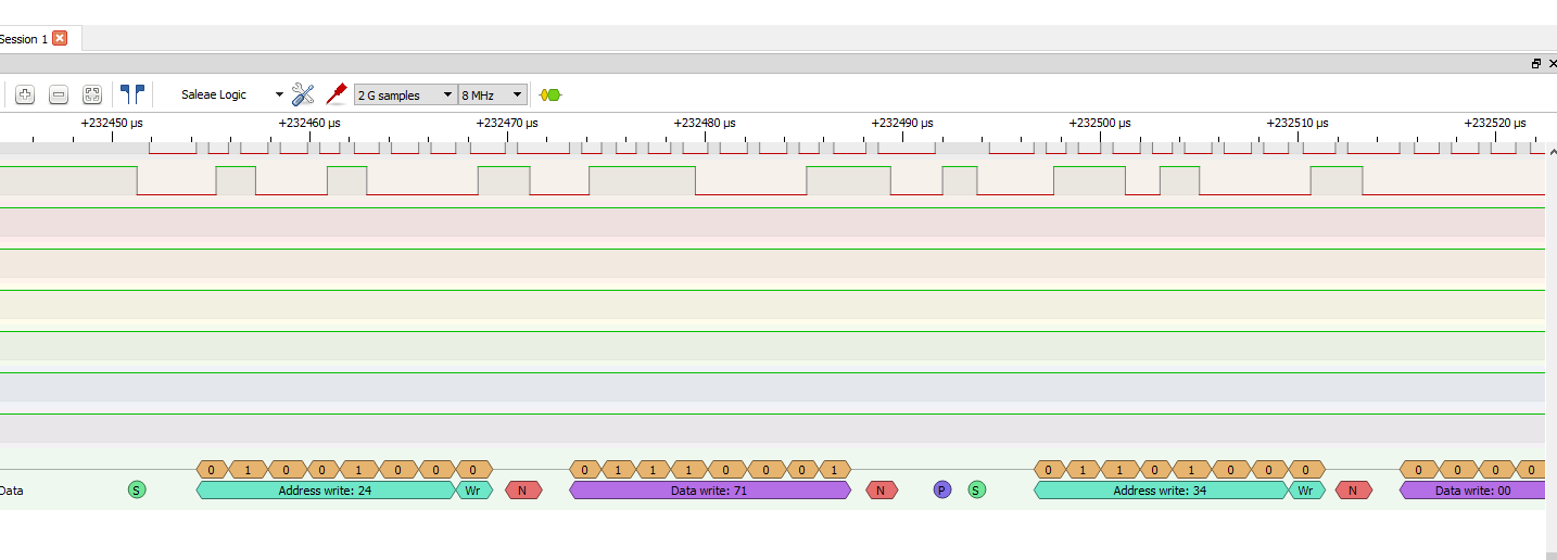

    But that`s not all, here is the second package, let`s take a look at it:
    Screenshot of logic signal analysis in PulseView.

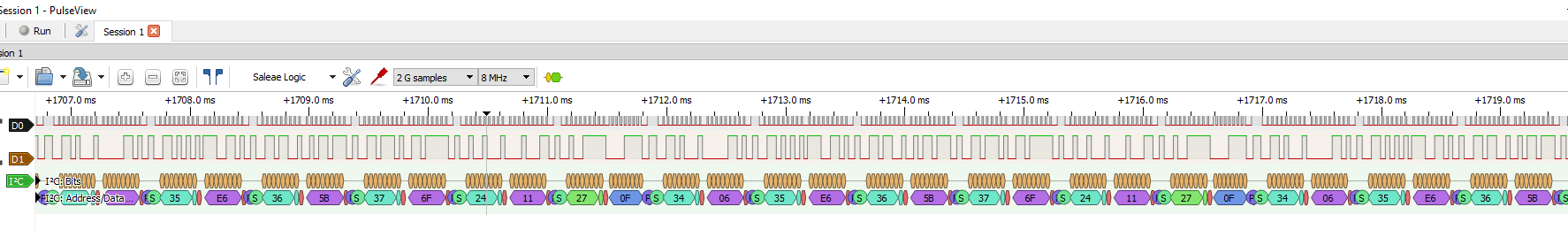

    There`s a lot going on here. Basically I see here:
    - setting the register with address 0x24 to the value 0x71 (repeated)
    - subsequent setting of registers with addresses 0x34, 0x35, 0x36 etc. to different values
    I would assume that 0x24 is the display control register and the registers starting from 0x34 are the registers of displayed digits. The display has 4 digits and we have subsequent entries for 0x34, 0x35, 0x36 and 0x37. Additionally, the first two values written to these registers are 0x00, which agrees with what I see on the display, because I see that the first two digits are off.

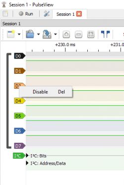

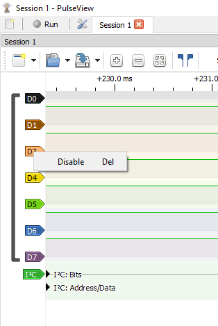

    Oh, I almost forgot - for convenience, let`s hide the unnecessary lines:
    Screenshot from PulseView software showing I2C signal analysis.
    We just click on them and select "Disable" to hide them.
    Ok, now let`s see what the first channel number is sent to the display, i.e. the first three digits are off and then the character 1.
    I deliberately scrolled to the last channel so that I could access channel 1 with one press of the key.
    Results:
    Screenshot from PulseView showing captured I2C communication.

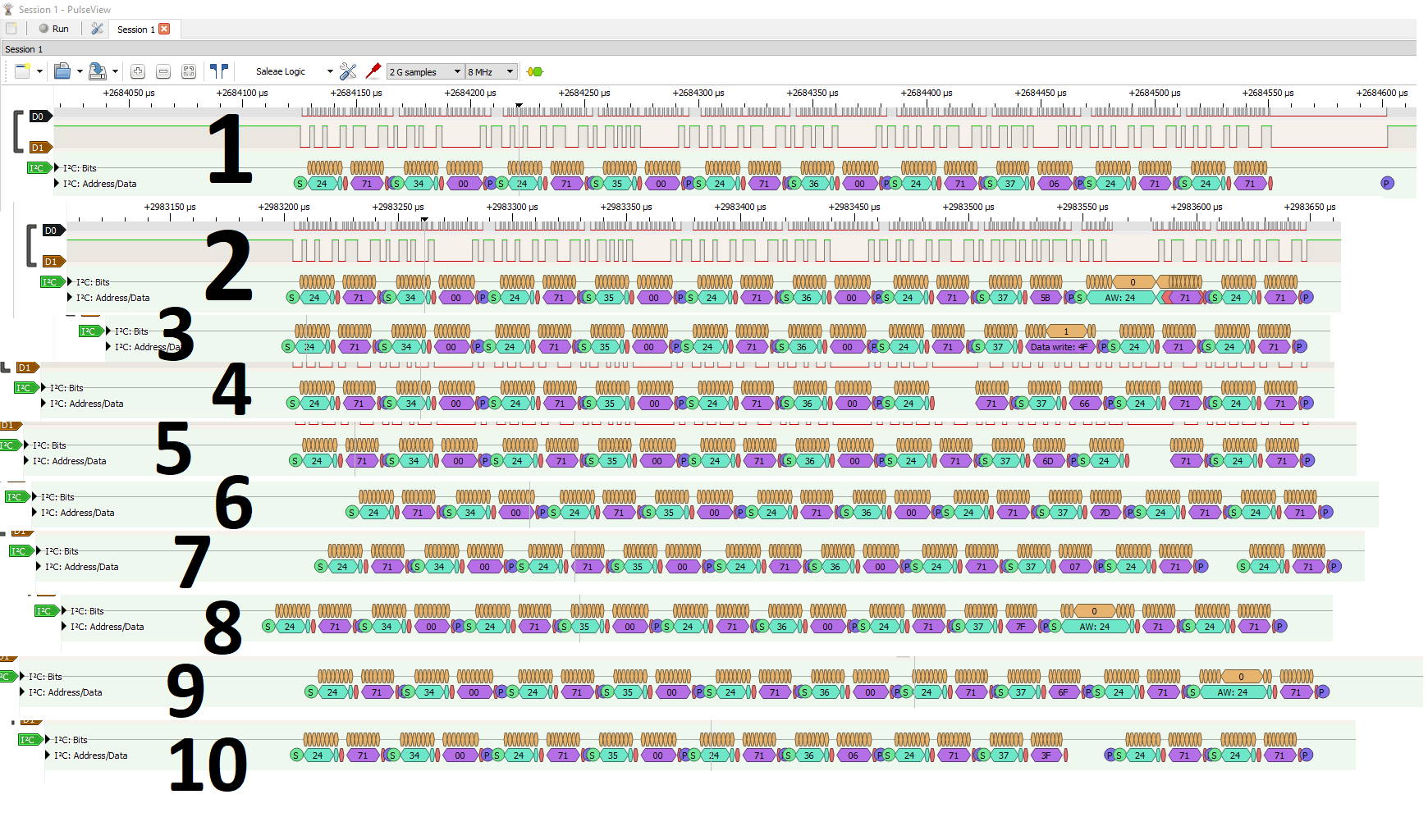

    Following suit, I also captured subsequent channel changes, always one further, to be able to compare the segment codes sent .
    Here`s the finished comparison:
    I2C communication analysis in PulseView for DVB-T2 decoder
    What do we see here?
    - for 1, the registers are set to 0x00 0x00 0x00 0x06
    - for 2, the registers are set to 0x00 0x00 0x00 0x5B
    - for 3, the registers are set to 0x00 0x00 0x00 0x4F
    - for 4, the registers are set to 0x00 0x00 0x00 0x66
    - for 5, the registers are set to 0x00 0x00 0x00 0x6D
    - for 6, the registers are set to 0x00 0x00 0x00 0x7D
    - for 7, the registers are set to 0x00 0x00 0x00 0x07
    - for 8, the registers are set to 0x00 0x00 0x00 0x7F
    - for 9, the registers are set to 0x00 0x00 0x00 0x6F
    - for 10, the registers are set to 0x00 0x00 0x06 0x3F
    You can see here that in the case of 10, the digit 1 also appears earlier and has the same code 0x06 as in the last place.

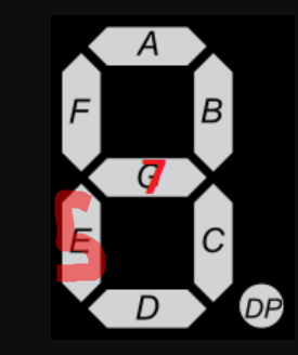

    Now we can determine which bits are which segments.
    Let`s start by comparing 0 (0x3F) and 8 (0x7F):
    - 0x3F -> 0011 1111
    - 0x7F -> 0111 1111
    So the middle beam is the seventh bit.
    Diagram of a 7-segment display with labels for each segment.
    Now let`s compare 5 and 6, because 5 is 6 without one segment:
    - 0x6D -> 0110 1101
    - 0x7D -> 0111 1101
    We can see that the difference between them is the bit in position 5:
    Diagram of a 7-segment display with labeled segments.
    In this way, we can also determine the roles of other segments.
