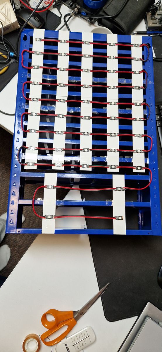

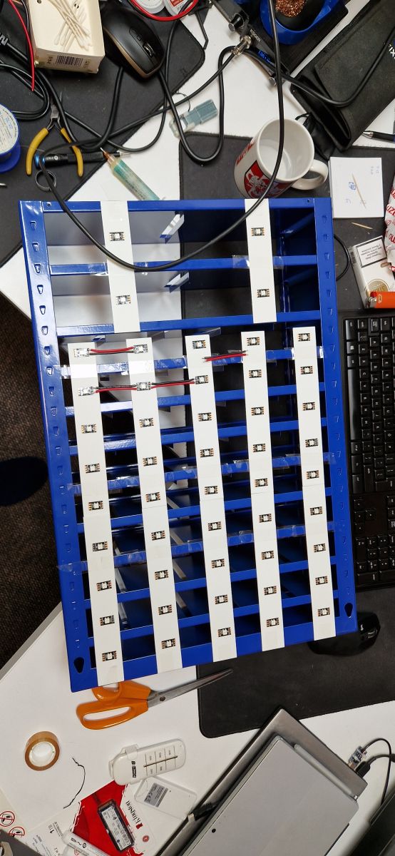

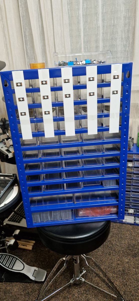

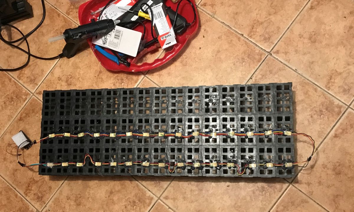

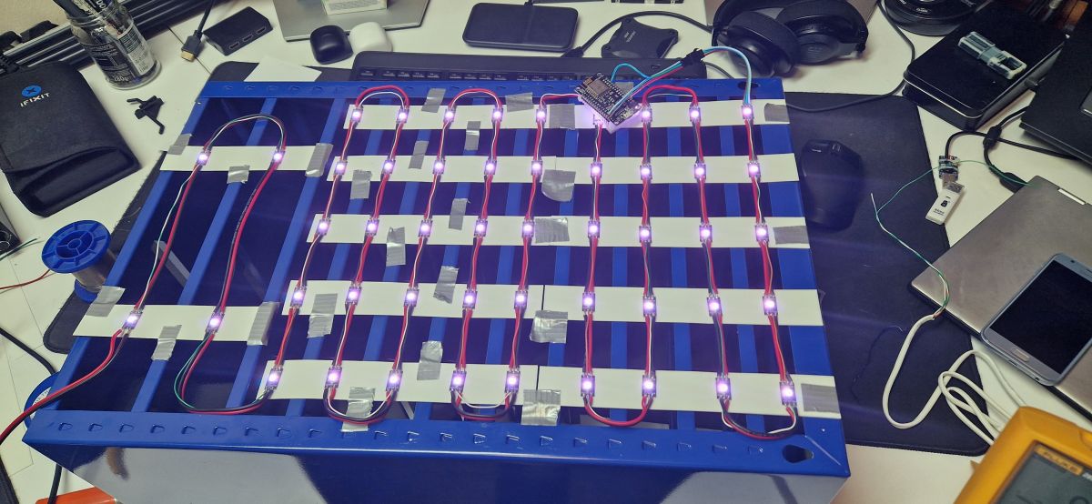

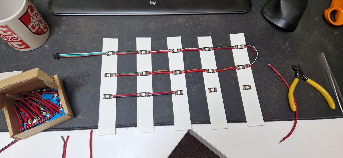

Building drawers You will need some sort of drawer rack to which it is easy to attach the diodes. Attach one diode per drawer. The order in which the diodes are attached matters, because somehow you have to count the index of a given X/Y position on the PHP side, but this can always be changed later in the code. The bigger problem is how much work is involved in attaching the diodes themselves....
Here are some photos of the work, both from a colleague and myself.
Fitting:
Workshop shelf with blue drawers and installed WS2812B LED strips.
Preparing the connections:
Preparation of WS2812B LEDs for the workshop drawers project.
Fitting can be soldered on the drawers or separately:
Workshop shelf with mounted LED lights.
Right off:
Workshop frame with mounted LED lights.
Testing with NodeMCU:
Smart workshop drawers project with LED lighting.

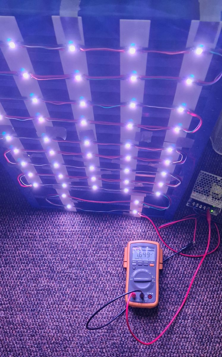

In the testing stage it is also worth measuring the current consumption. This will verify our earlier estimate of what kind of power supply we need:
LED panel connected with wires to a multimeter on the floor.

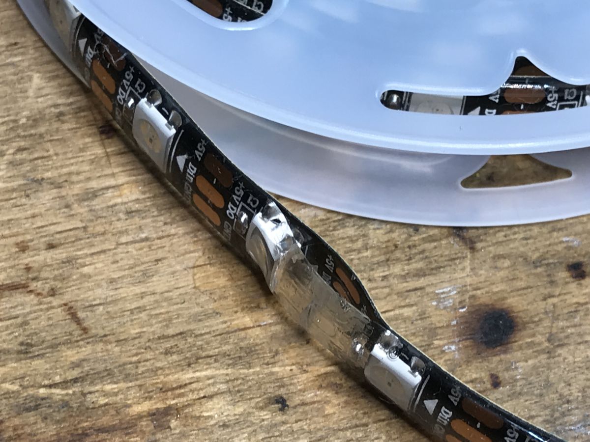

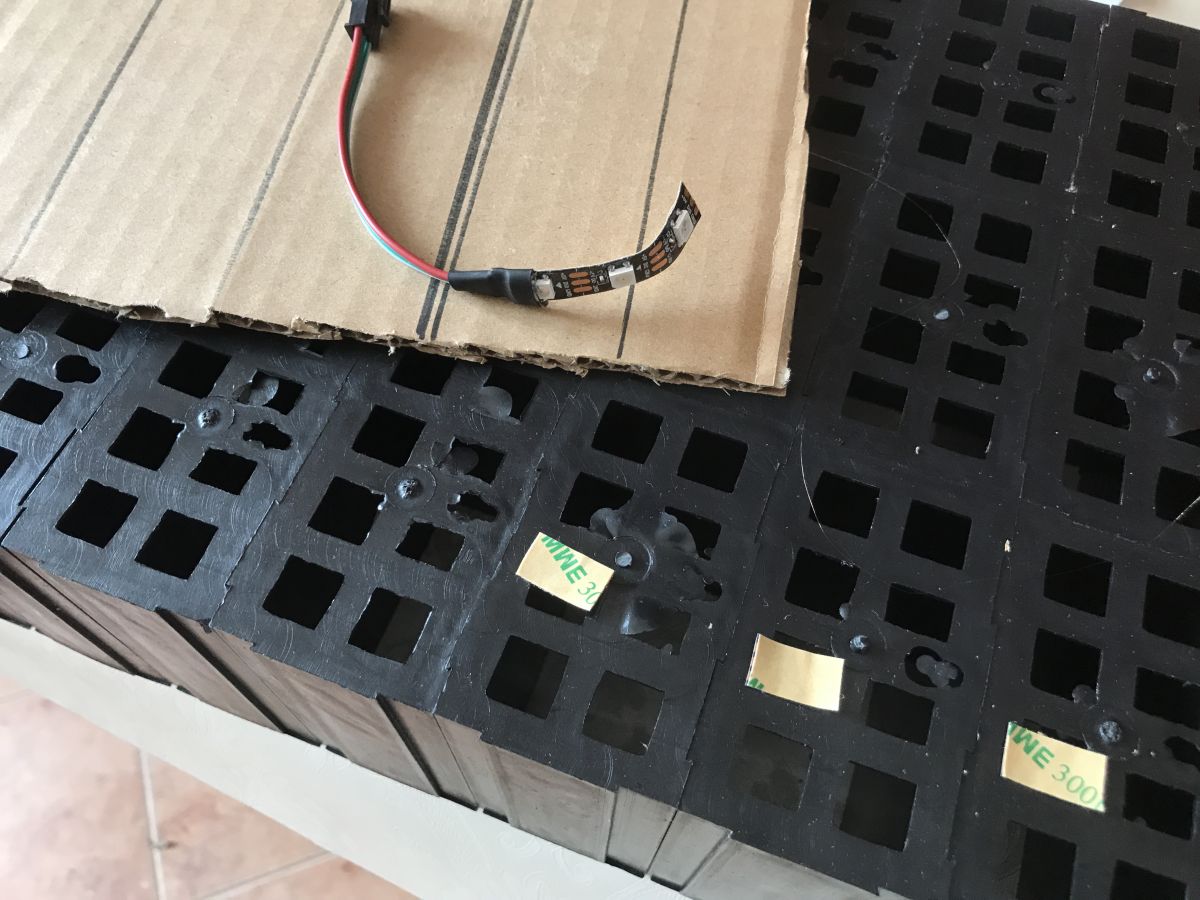

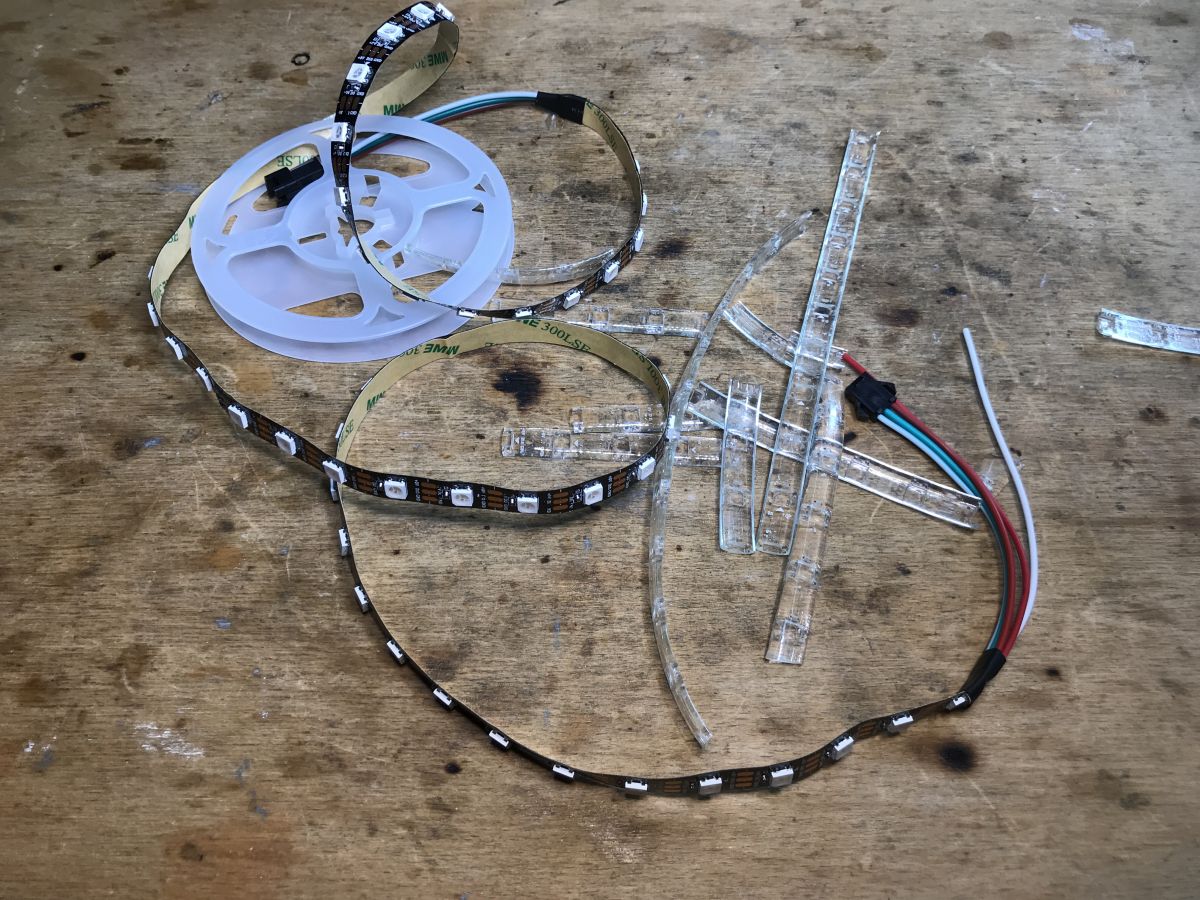

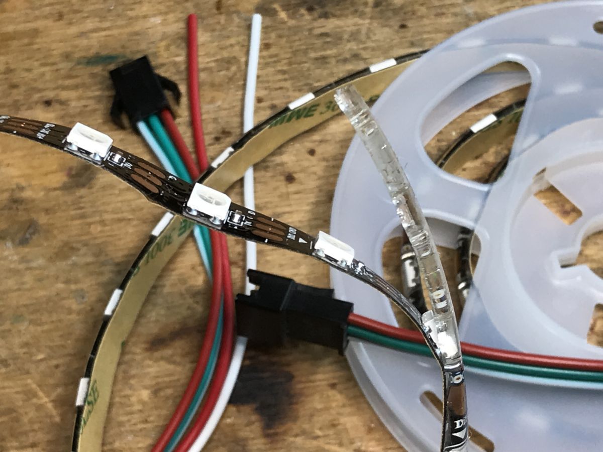

I also made one segment myself. I had a WS2812B protected from moisture on hand, so I had to free them first:
Roll of WS2812B LED strip on a wooden surface. LED strip WS2812B with visible wires on a wooden surface. WS2812B LED strips on a workshop table with wires and plastic covers.

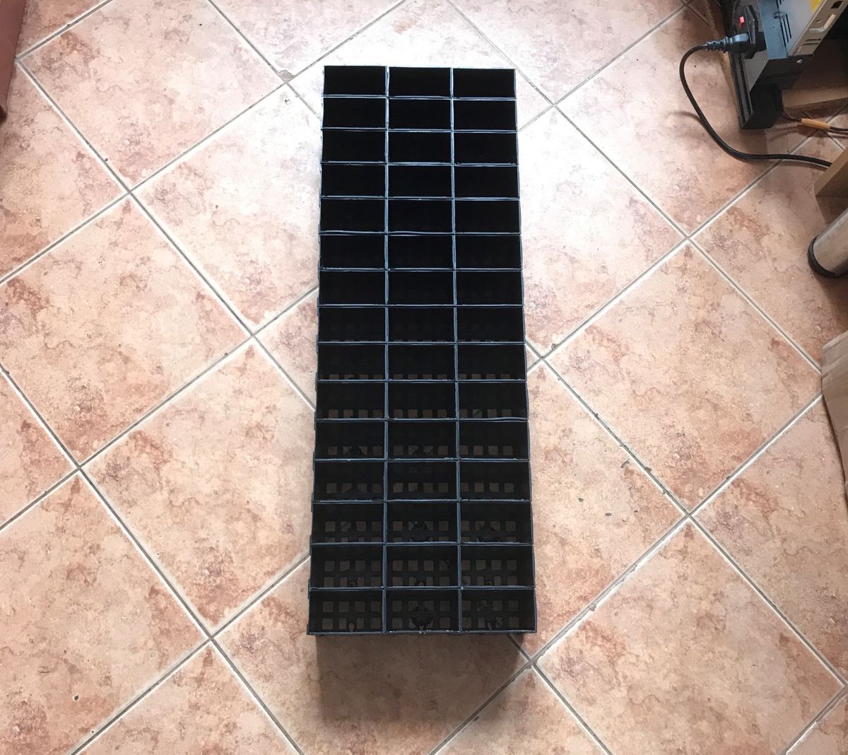

I built my patrol drawers with them :
Shelf composed of black plastic workshop drawers. Rack with empty black drawers on the floor. .
Findings:
Workshop drawer shelf with connected LED strip on cardboard.

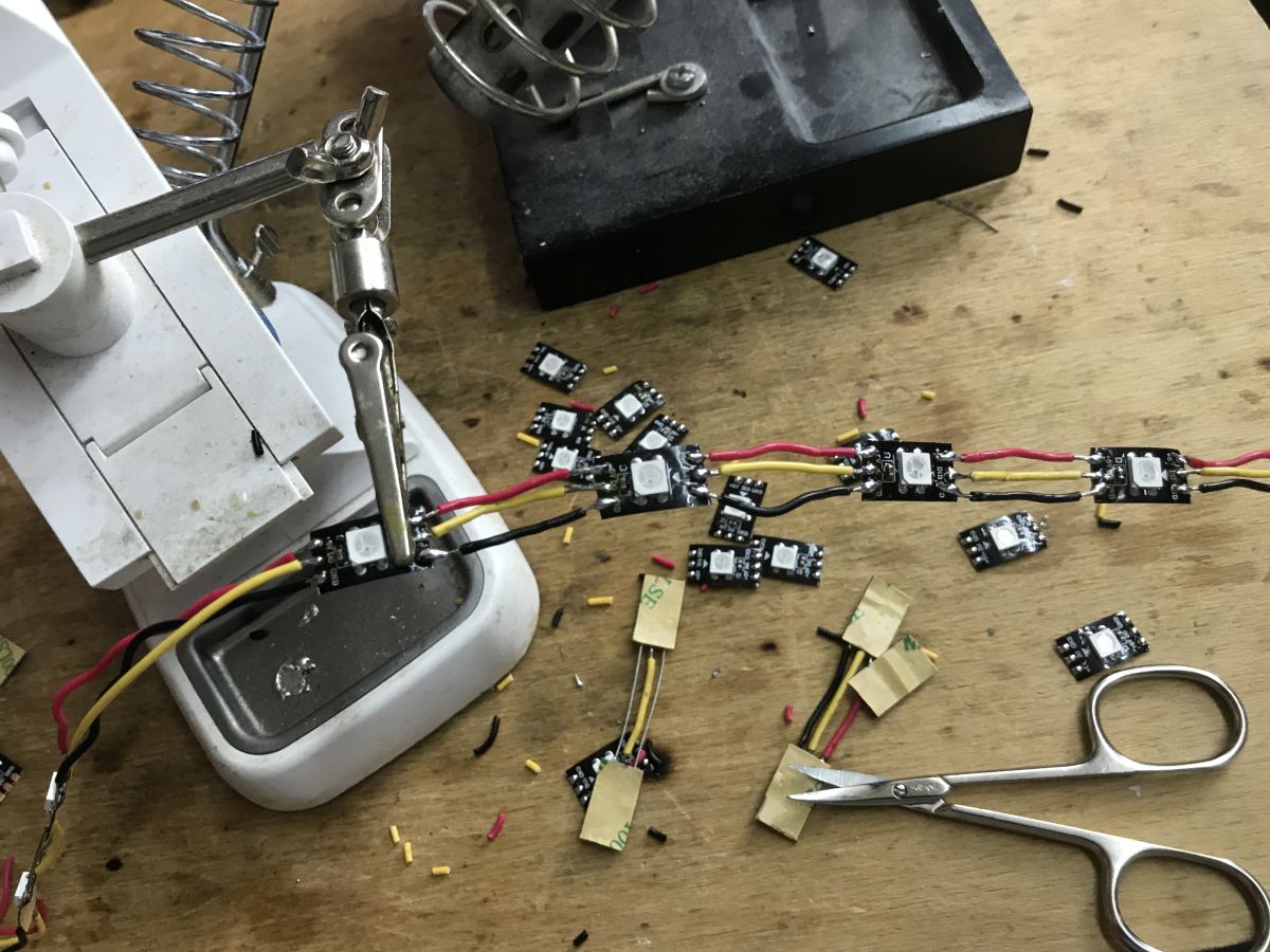

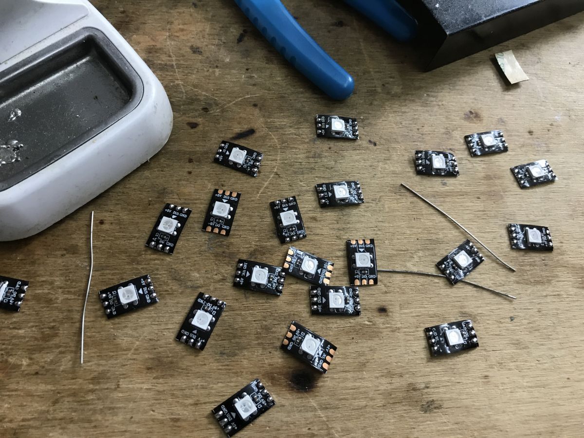

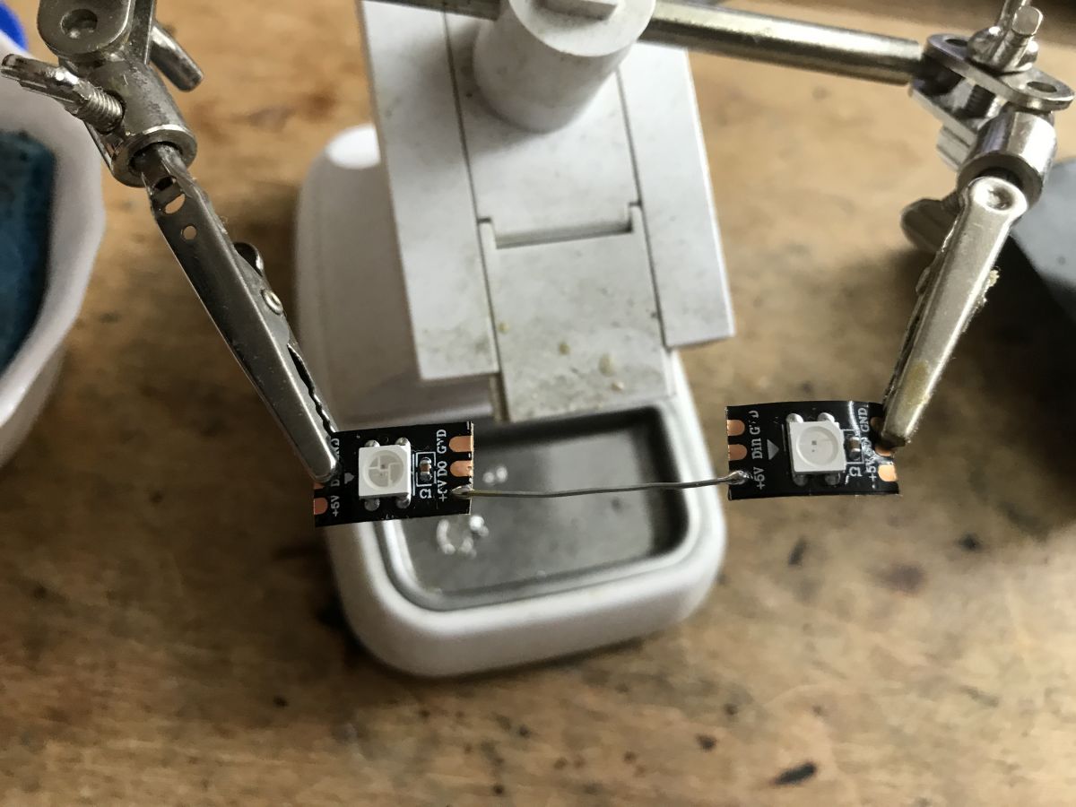

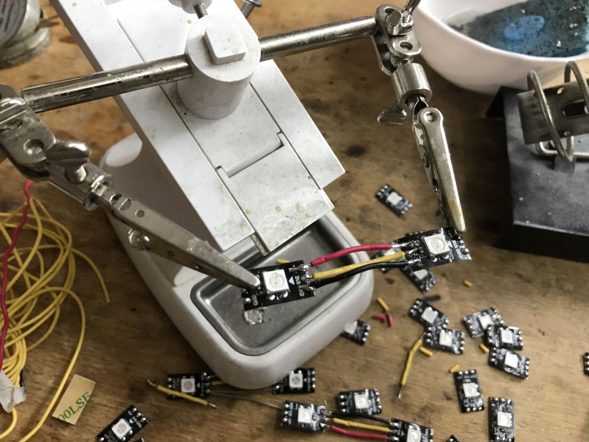

Soldering outside the drawers - this has the downside that minor imprecisions accumulate....
LED modules on a workbench beside soldering equipment. Two WS2812B LED diodes being soldered by robot arms on a workbench.
I have bad memories of this soldering, you have to be patient. It's not that it's difficult, as the solder came out the first time, but it was time consuming.
Soldering LED components held in a third hand tool. Soldering wires to LED modules on a workbench.
Fixed, hopefully it won't need servicing. The two loops of longer wires are sort of like "buffers" to be able to match the alignment of the other LEDs:

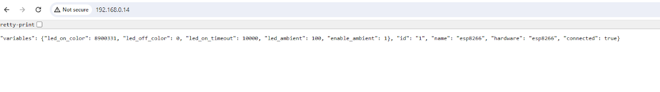

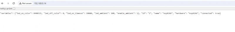

The above queries run in the browser, they can be tested without putting up a database.
The empty query returns the current settings (this is not implemented for the version on BK7231):
Screenshot of a browser interface displaying connection settings.

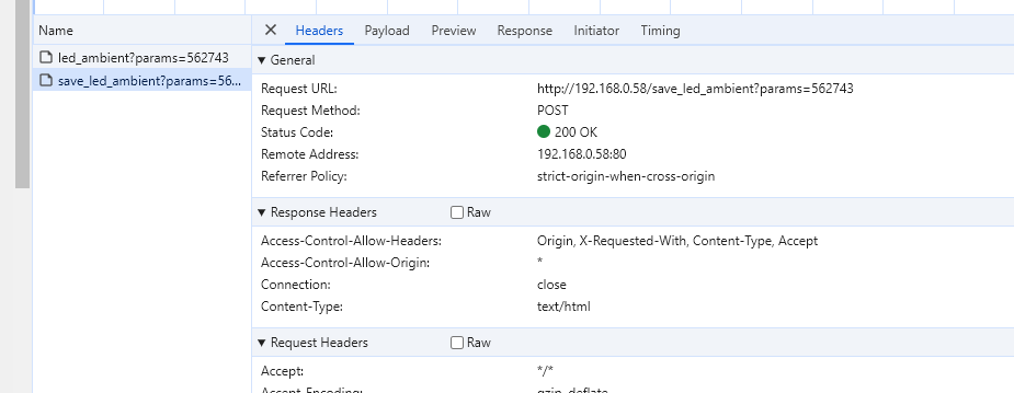

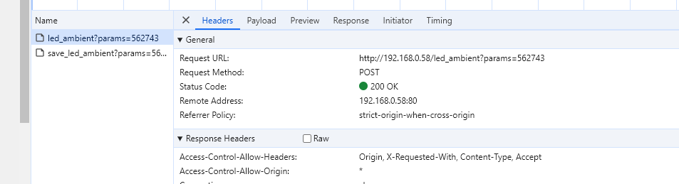

This is what these queries look like in practice - suspect in Wireshark:
Wireshark screen showing HTTP request details. Screenshot showing details of an HTTP POST request in the developer tool.

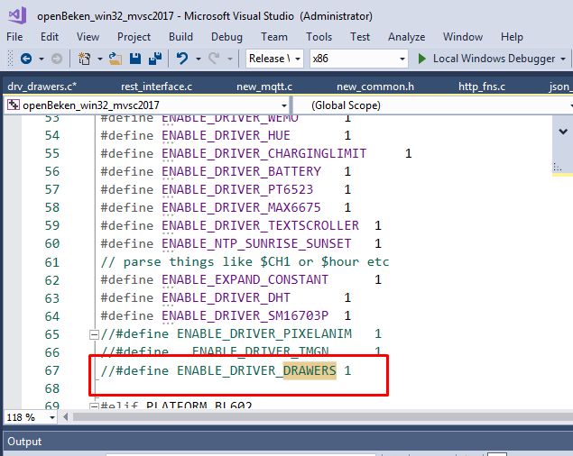

. Firmware on BK7231
Firmware on BK7231 is basically a driver for OpenBeken . It should be included in obk_config.h:
Screenshot of Microsoft Visual Studio with code highlighted.
Compilation can be done online, nothing needs to be installed, there are instructions .

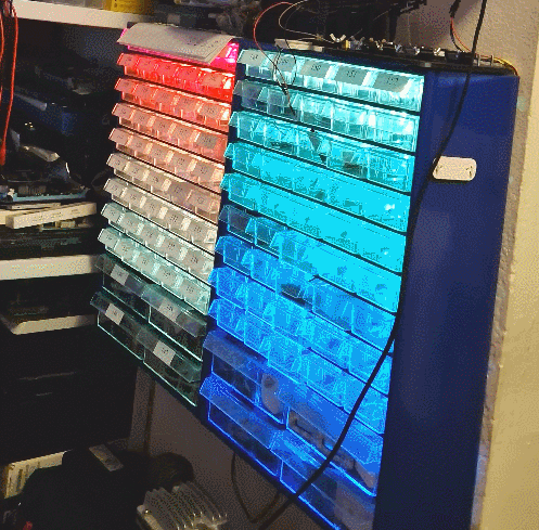

We also fired up some animation on the LEDs. We used OBK and the PixelAnim driver for this:
LED drawers with animated blue lighting
Animated LED lights mounted on drawers in a workshop.

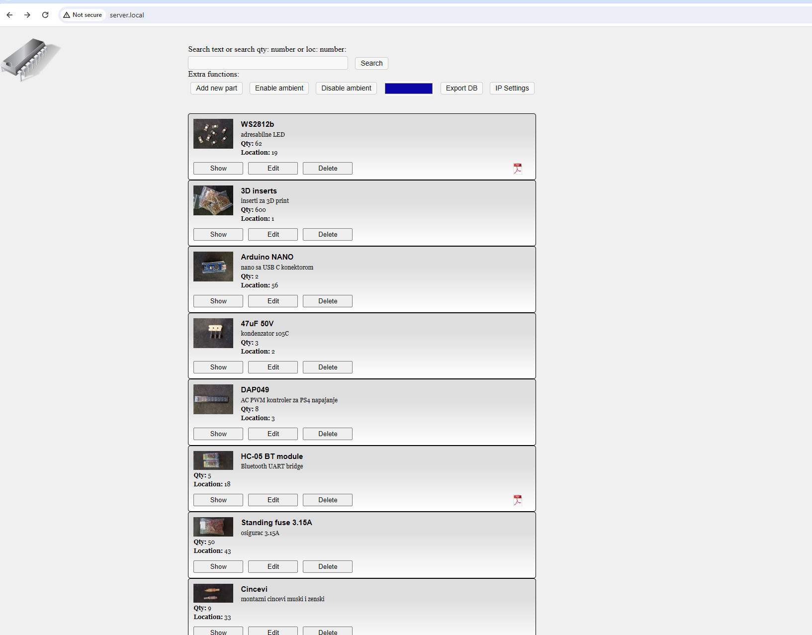

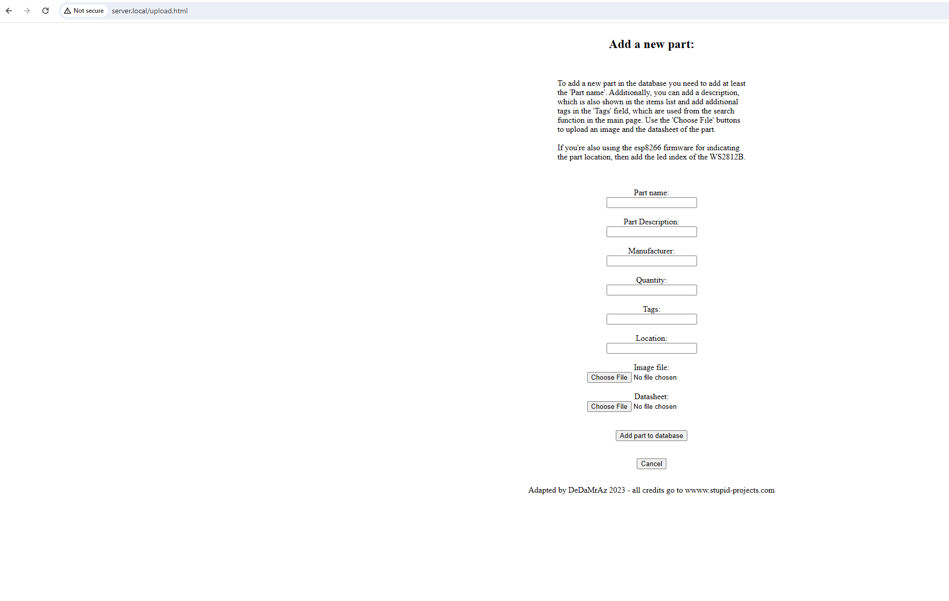

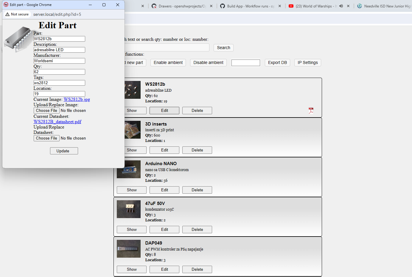

LED-lit drawers with light effects. Web site Web site offers a simple database of elements. We can add, delete, view and update.
Web interface with a list of parts and editing options.
Updating:
Part editing window in a database system for workshop resource management.
Addition (in progress, convert to pop-up):
Form for adding a new part to the database on a webpage.

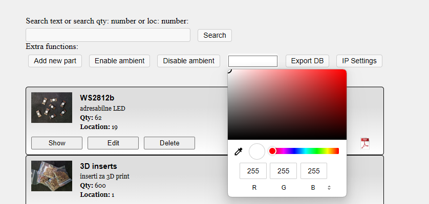

Fun ambient colour:
User interface with a parts list and a color selection tool.

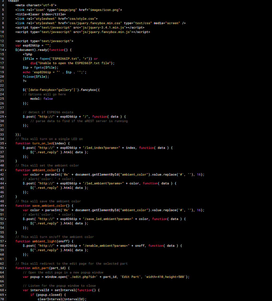

This page calls functions on the NodeMCU/BK7231 from within Javascript:
Screenshot of HTML, CSS, and JavaScript code for the workshop drawers project.

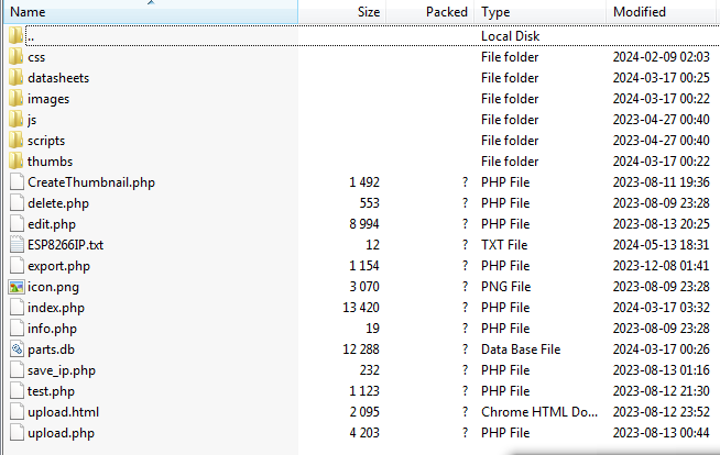

List of page files:
Screenshot showing the file list of the smart workshop drawers project.
From the more interesting files are parts.db - database, and ESP8266IP.txt - IP address of our LED controller.

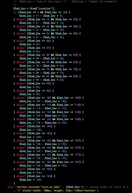

A striking and seemingly simple project, but in practice I advise you to be patient. This diode soldering requires some time.
Particularly to get it working at your place will require appropriate modification of the function separating and mapping the chamber indexes to the drawers, but this I leave to the reader. At a colleague from Serbia it looks like this:
Screenshot of PHP code controlling LED lighting in workshop drawers.
