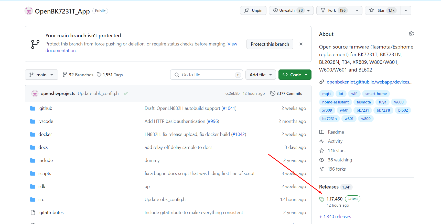

    Main OpenBeken Releases
    Main releases are available for everybody at the releases tab. Open our repository:
    Go to releases:
    Screenshot of the OpenBK7231T_App repository on GitHub showing the list of directories and version information.

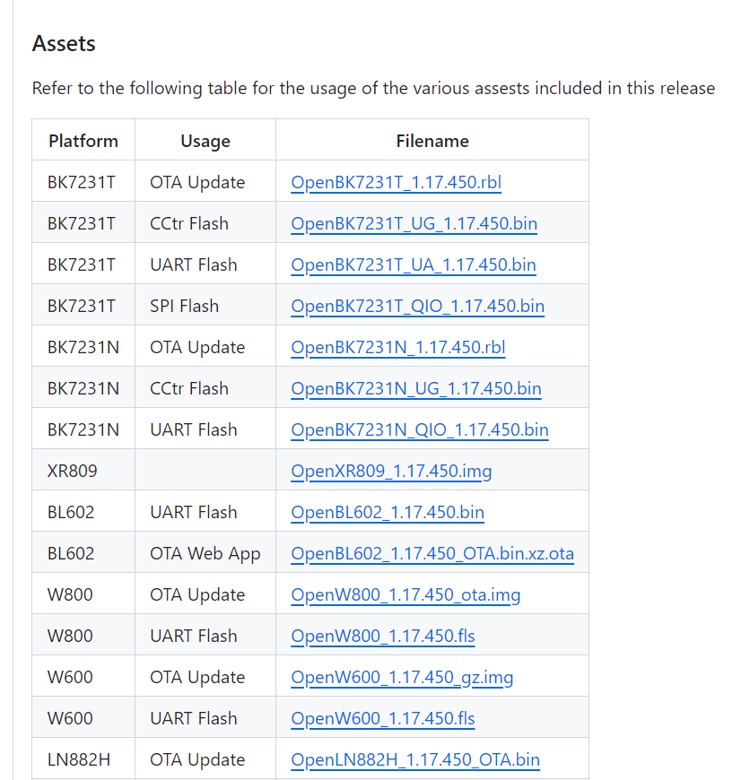

    In releases, you can find a table of all build binaries for supported platforms:
    https://github.com/openshwprojects/OpenBK7231T_App/releases
    See screenshot below:
    Table of OpenBeken assets for various platforms and usage types.

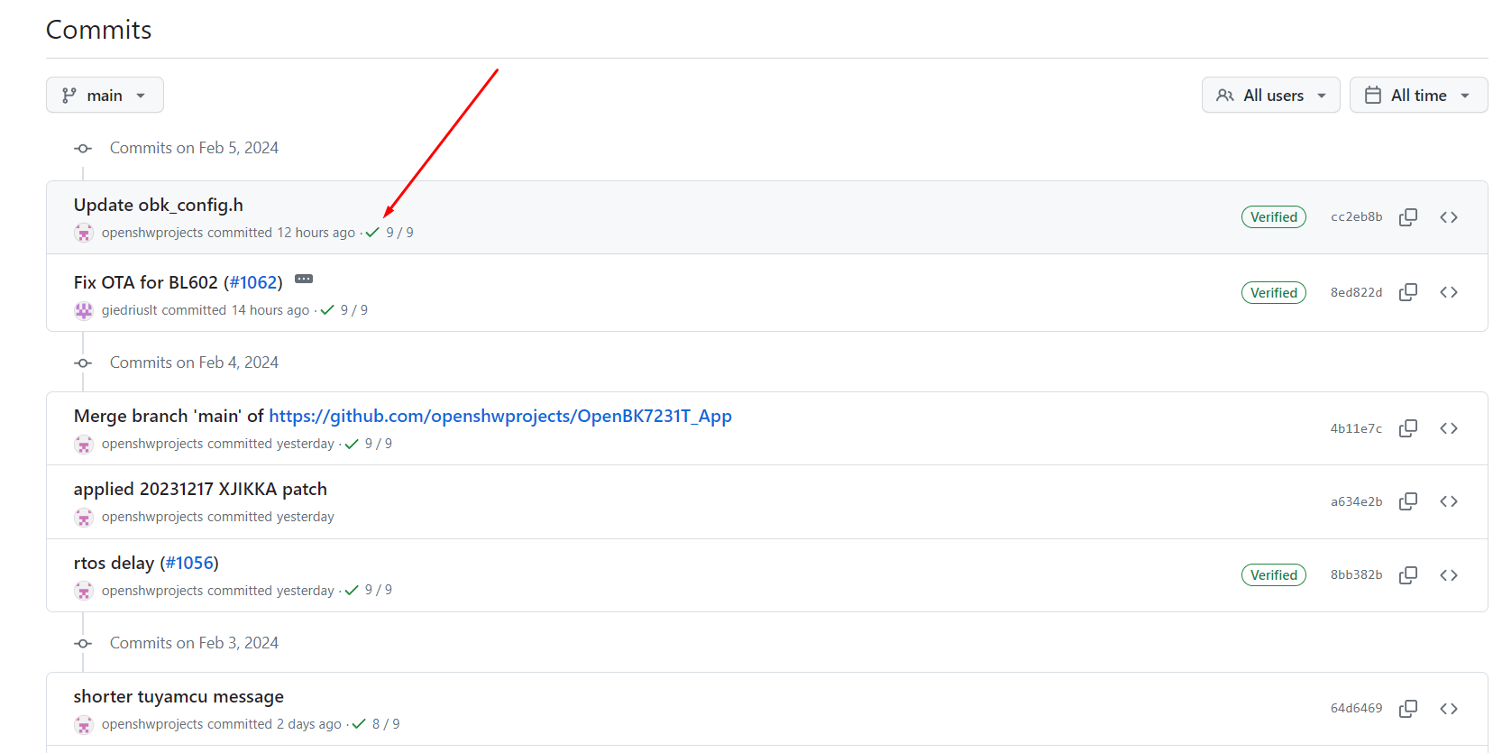

    First you need to see the list of commits, here:
    https://github.com/openshwprojects/OpenBK7231T_App/commits/main/

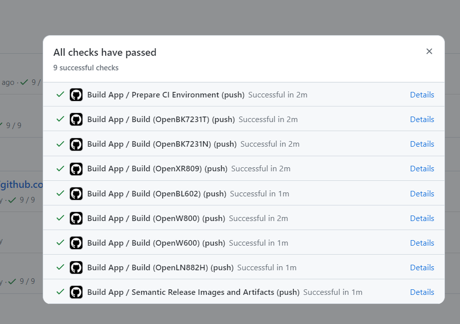

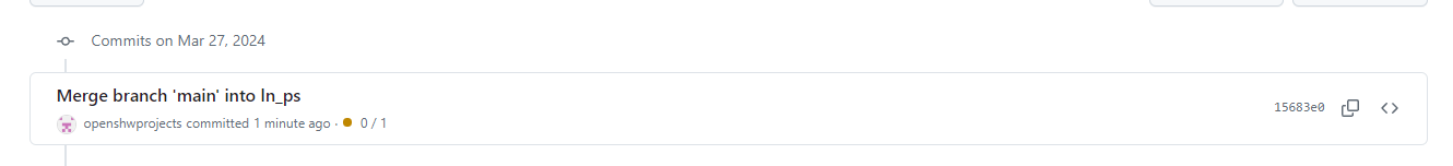

    Then, notice the green mark, click it:
    Screenshot of a GitHub commit list for the OpenBK7231T_App project.
    Then, on the screen below, click any "Details" link:
    Screenshot of build results in Github Actions showing 9 successful checks.

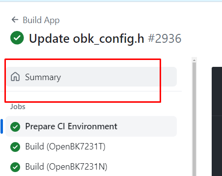

    Now you should be on build details page:
    GitHub app screen showing build information for OpenBeken.

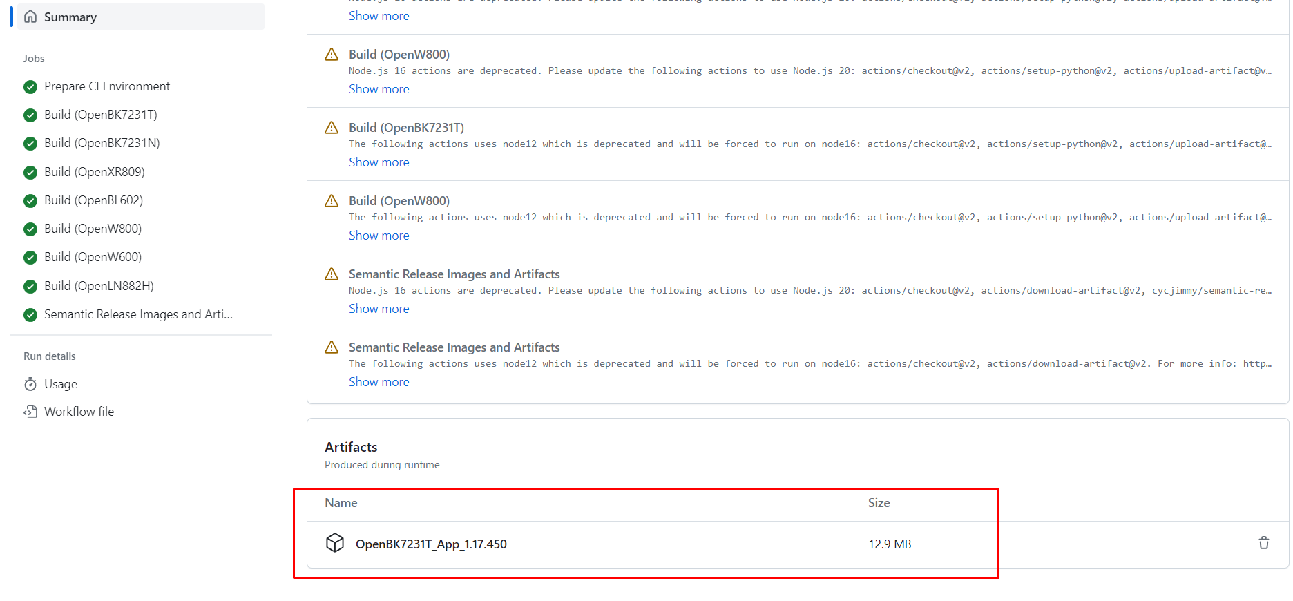

    Click "Summary":
    Screenshot of the GitHub Actions build process with the Summary section highlighted.
    Scroll down to the bottom of the page:
    OpenBeken build screen on GitHub.

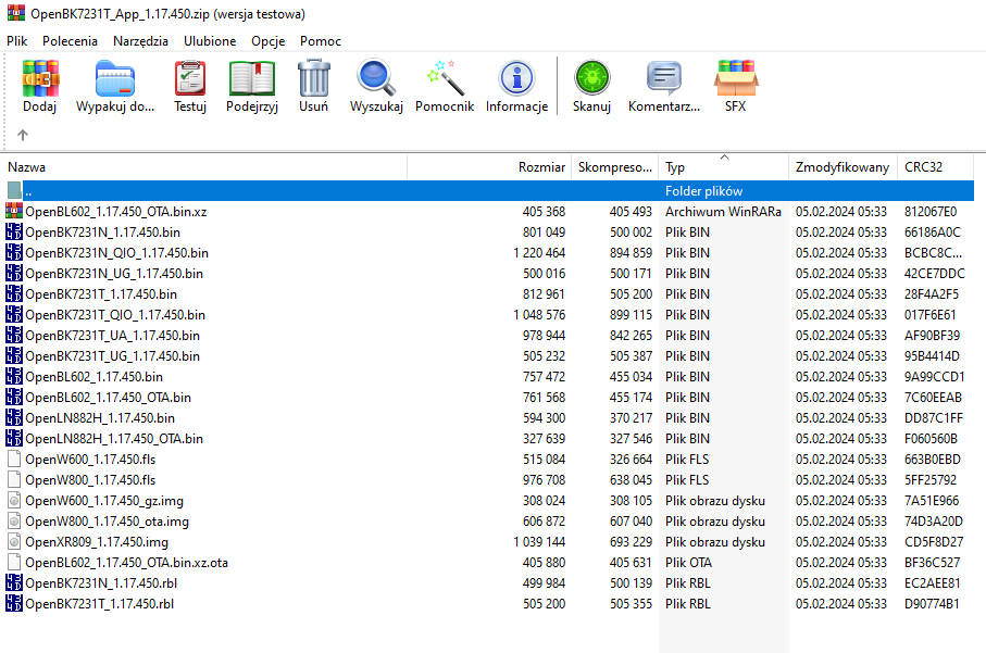

    This "artifacts" file contains all build binaries, download it:
    List of binary files in OpenBK7231T_App_1.17.450.zip archive displayed in an archiving program.
    As you can see, all binaries are here.

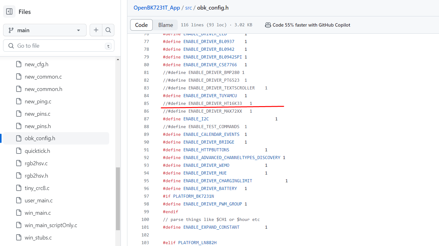

    Customizing your own build
    The automated build system can be easily used to customize your own OBK build. For example, let's say you want to enable some feature in obk_config.h:
    https://github.com/openshwprojects/OpenBK7231T_App/blob/main/src/obk_config.h
    For example, if you want to enable HT16K33 driver:
    Screenshot of an online code editor showing the obk_config.h configuration file with the OpenBeken repository opened on GitHub.
    You can just change the #define of the feature you want to include and then use online build system (either setup on your own fork, or just create a PR to just get binaries) and you will get everything compiled for all platforms without even setting up one compiler on your PC.

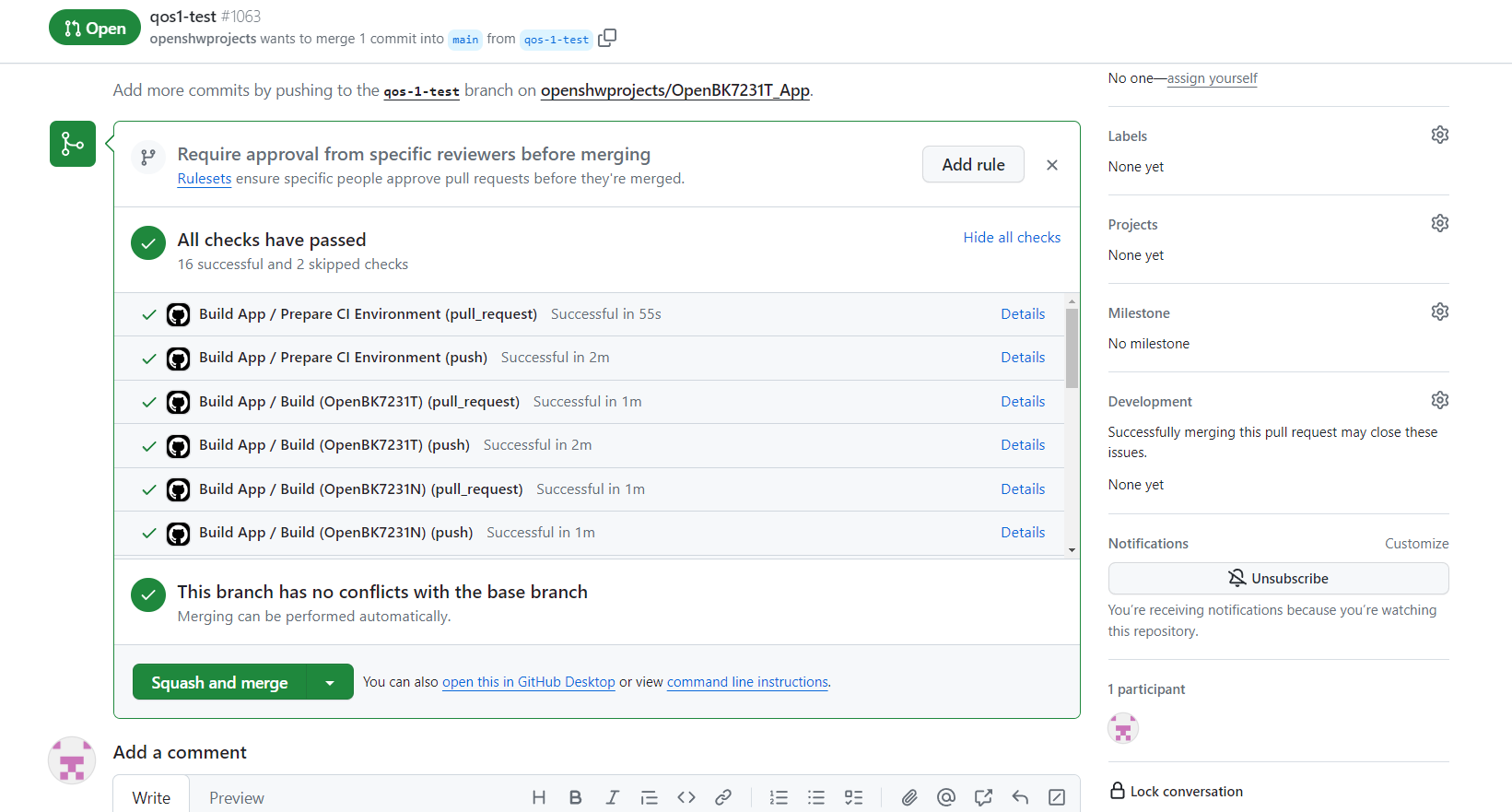

    do *we* build our own bins on our own forks or is that something you have to do for each PR?
  • #6 20979829
    Posts: 14750
    Rate: 12866

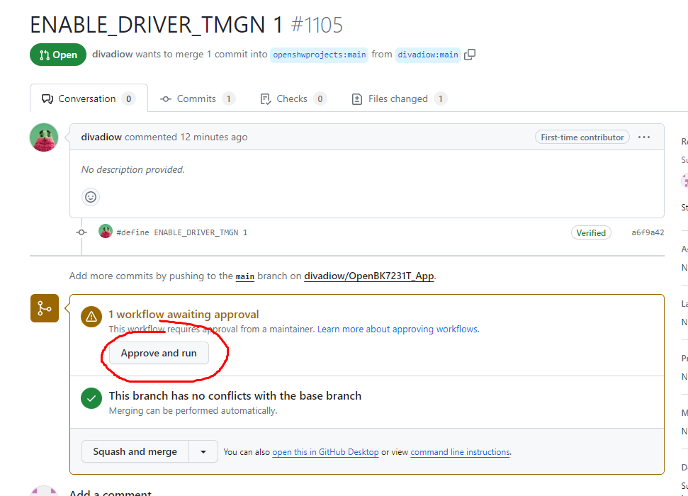

    I think that in order to run a build on my repo, I need to confirm it first there:
    Screenshot from GitHub showing an open pull request requesting approval and build execution.
    However, I think you can as easily just enable building fully on your side, without my intervention.

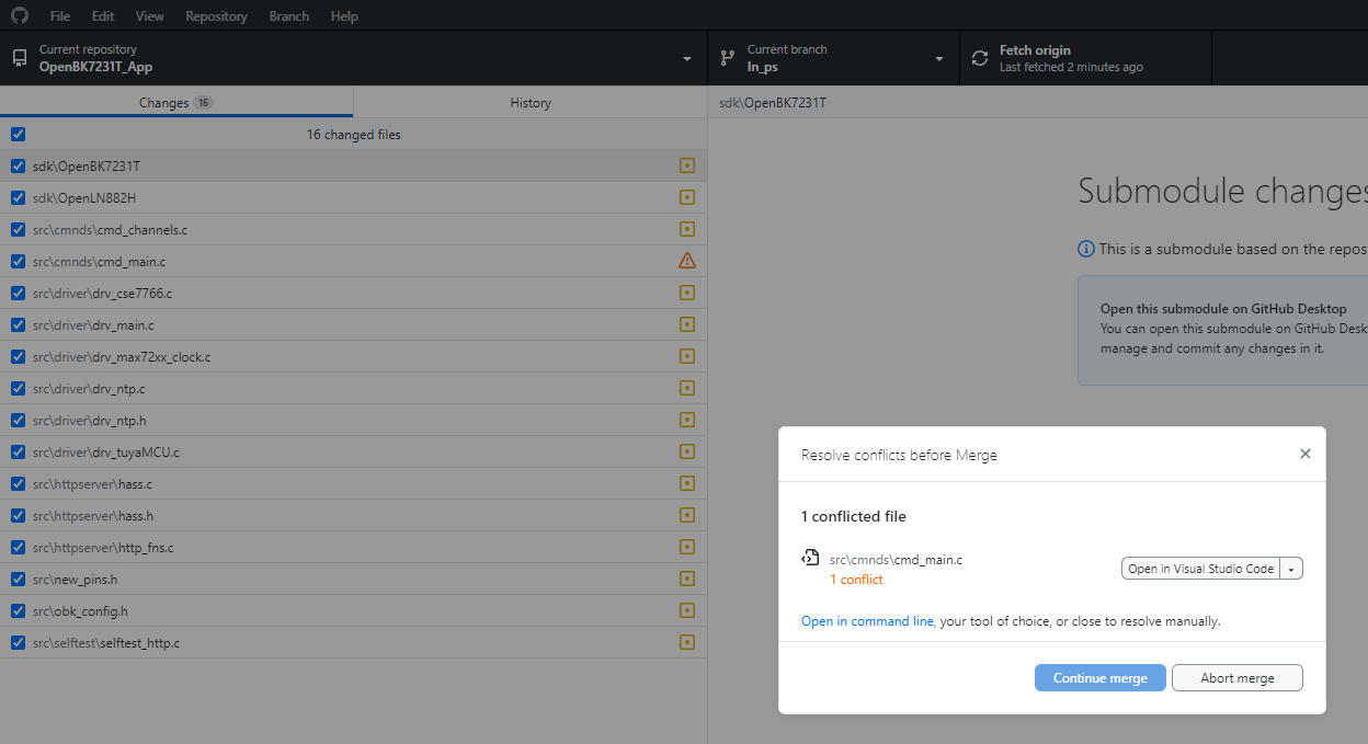

  • Updating a fork from main in GitHub GUI
    #14 21021685

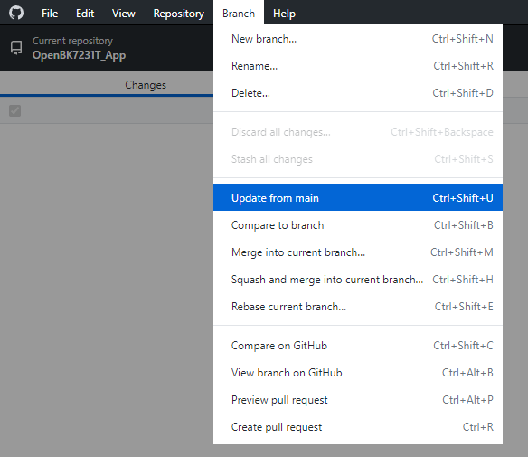

    Posts: 14750
    Rate: 12866
    I am referring to a situation that happens when you make a fork (with a PR or not) and some new changes are added to the main and you want to merge those changes into your fork.
    This can be done easily in Github GUI.
    In Github GUI, switch to your fork, in my case ln-ps:
    Screenshot of GitHub Desktop UI showing no changes in branch ln_ps.
    Then you can select "update from main":
    Screenshot of a dropdown menu in GitHub Desktop interface with the Update from main option highlighted.

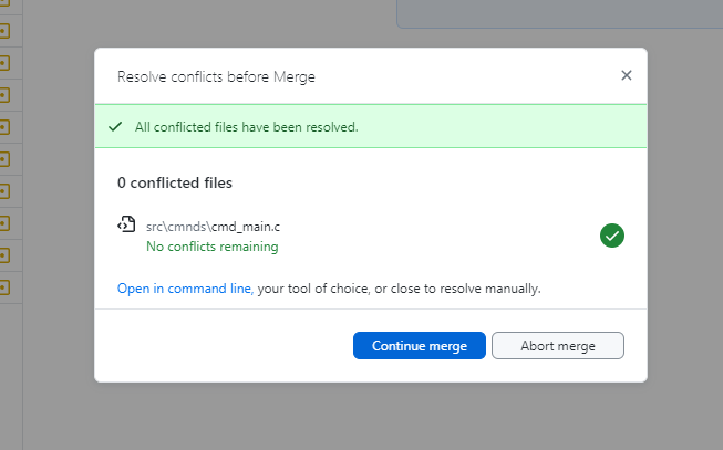

    Then, you may need to solve conflicts (if any):
    Github interface showing modified files in a repository and a conflict resolution dialog box.

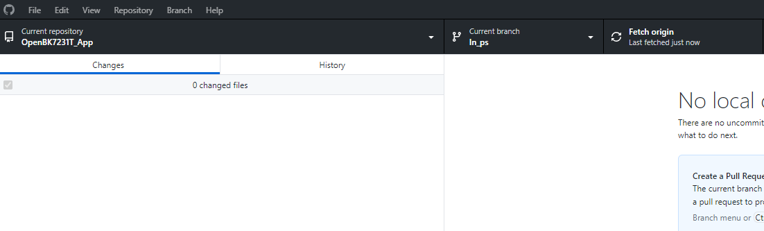

    Then, once resolved:
    Github dialog box showing no conflicts before merging.
    And finally, once commited and pushed, you get:
    Screenshot showing the merge information of branch 'main' into 'ln_ps' on Github.

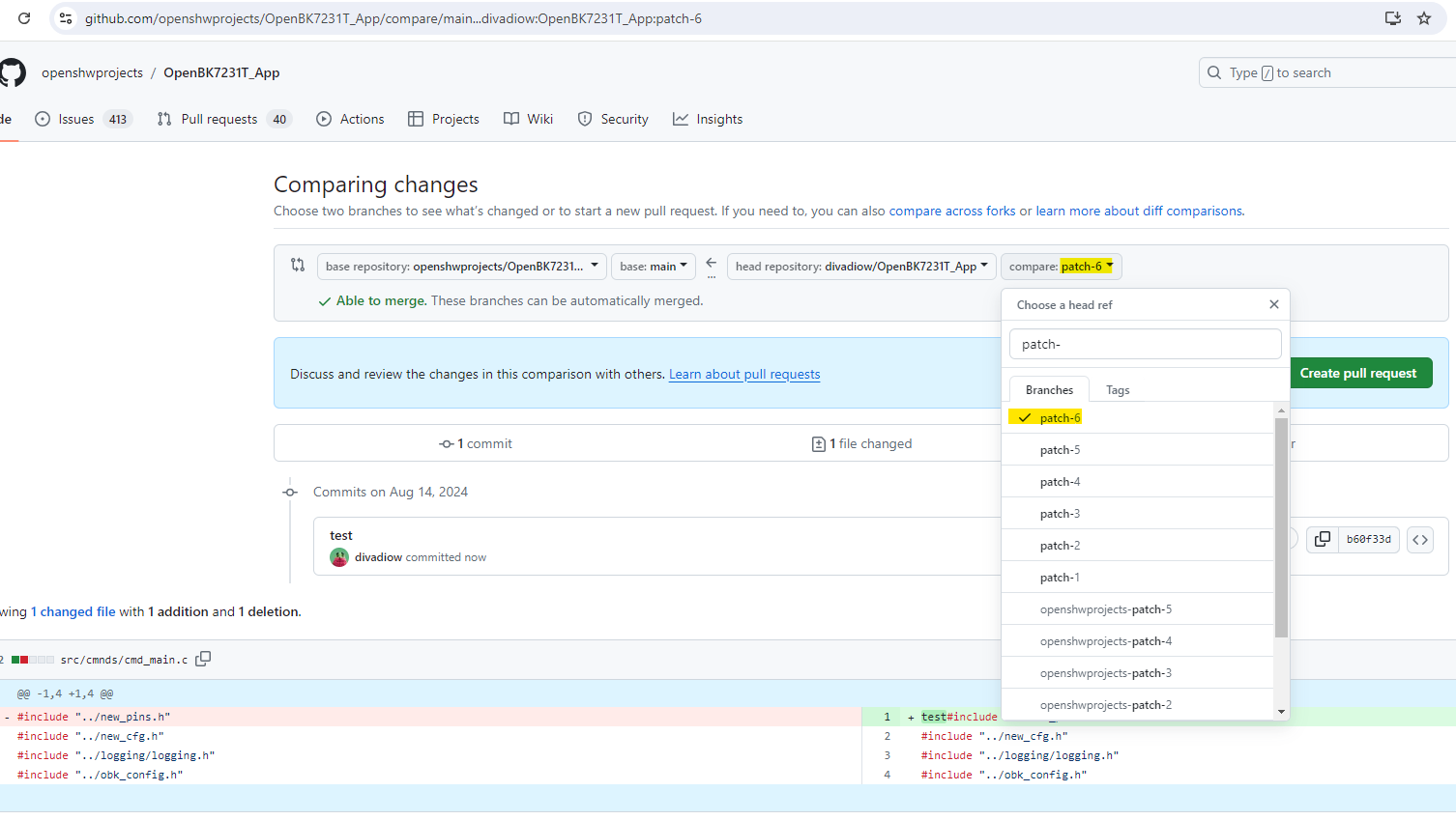

    morgan_flint wrote:
    building in one's branch

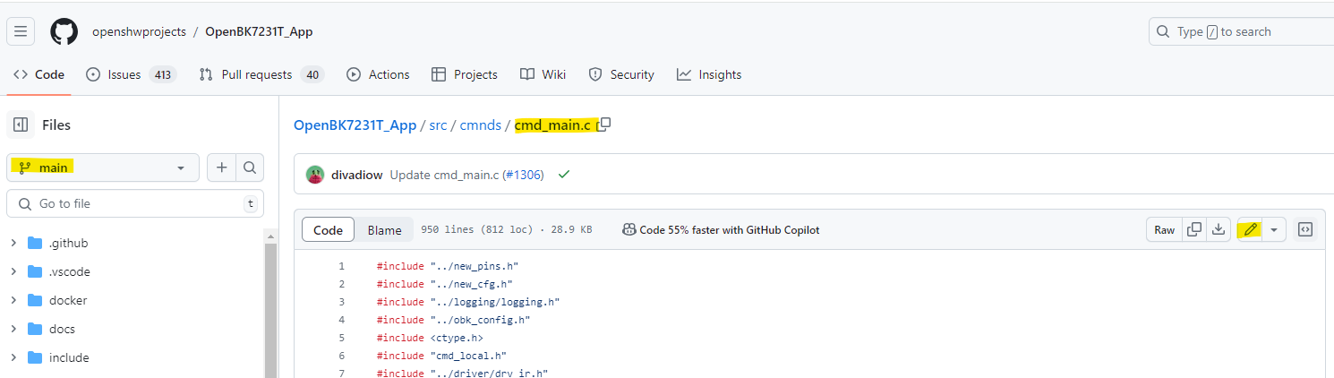

    does this mean you want to kick off a build and download the zip of binaries off the back of your own PRs?
    If the change is small and in the main repo I tend to just go the file where I want to make the change, switch to the main branch so the edit pencil allows editing, commit changes and open a PR with that change. eg for cmd_main.c
    Screenshot showing the cmd_main.c file in the OpenBK7231T_App repository on GitHub.
    when you commit your changes it makes a new branch with a generic "patch-#" name
    GitHub comparison screen between main and patch-6 branches in the OpenBK7231T_App repository.
    https://github.com/openshwprojects/OpenBK7231...mpare/main...divadiow:OpenBK7231T_App:patch-6
    you can then open a PR which will start a build
    If needing to edit a submodule I fork main and sub then clone to PC. modify .gitmodules to be sure paths and remote addresses and branch details are correct. then I forget what I need to do to push those changes upstream from my submodule into the upstream main repo and ask chatgpt :)
    If I make a mess I delete the lot and start from scratch

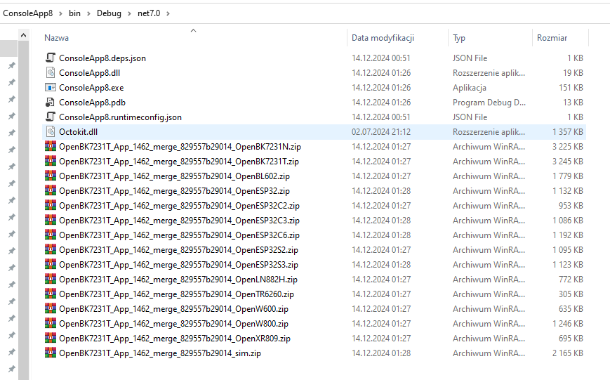

  • #19 21347437
    Posts: 14750
    Rate: 12866
    I'm working on something interesting, guys. It's related to our online builds. Who can guess what's happening there?
    Screenshot of a .NET project folder showing various DLL and ZIP files.

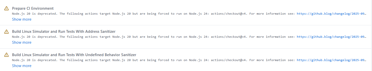

    OpenBeken online building system - compiling firmware for all platforms (BK7231, BL602, W800, etc)
    switch to node.js 24 ahead of "fall 2026"
    Beginning on June 16th, 2026, runners will begin using Node24 by default. To opt out of this and continue using Node20 after this date, set ACTIONS_ALLOW_USE_UNSECURE_NODE_VERSION=true as an env in your workflow or as an environment variable on your runner machine. This will only work until we upgrade the runner and remove Node20 later in the fall of 2026.
    https://github.com/openshwprojects/OpenBK7231T_App/pull/2169

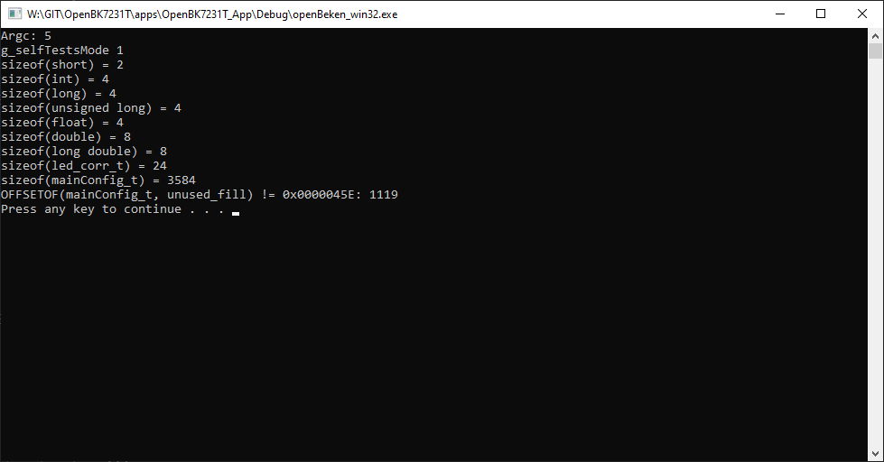

    Regarding online builds - I have only pulled latest changed, and I get this in Simulator:
    Windows console window showing sizeof outputs and “Press any key to continue...”
    Did something change recently or is there a problem on my side?

Where can I find the main OpenBeken release binaries on GitHub, and how do I tell which file matches my platform?
You can find the main binaries in the repository’s Releases tab on GitHub. The thread says each release includes a table of build binaries for supported platforms, so you identify the correct file by matching the platform name shown in that release list to your target chip or board family. That gives you the official packaged binaries rather than temporary test artifacts. [#20946719]
What are per-commit builds in OpenBeken, and how do I download the artifacts for a specific GitHub commit?
Per-commit builds are automatic binaries generated for each GitHub commit, even when no formal release exists. Use this 3-step flow: 1. Open the commit list on the main branch. 2. Click the green status mark, then Details. 3. Open Summary, scroll to the bottom, and download the artifacts file containing the binaries. This path is useful when a developer removed an old release or when you need one exact revision. [#20946719]

A per-Pull Request build runs automatically for each PR and lets you test experimental changes before merge. After the build finishes, the compiled binaries are stored as downloadable artifacts in the GitHub build details page; the thread says you reach them by clicking Details, then Summary, then scrolling to the artifacts section. That gives you test firmware without publishing anything as a main release. [#20946719]
Why does my first OpenBeken Pull Request need administrator approval before GitHub Actions will build it?
Your first PR needs administrator approval because the repository owner must explicitly allow the workflow to run. The thread says first-time PR builds must be accepted by an administrator, and later confirms the maintainer sees an approval prompt before a build runs on the main repository. That gate reduces risk before executing code changes inside the project’s GitHub Actions environment. [#20979829]

How can I customize my own OpenBeken build by editing obk_config.h, for example to enable the HT16K33 driver or ENABLE_DRIVER_TMGN for GN6932?
Edit src/obk_config.h, change the relevant #define, and let the online build system compile the result. The thread gives HT16K33 as the direct example and later mentions wanting a build with ENABLE_DRIVER_TMGN for GN6932. This workflow works well for feature flags and small driver enables because GitHub can build all supported targets after one config change. [#20946719]

What is meant by merging upstream changes into an OpenBeken fork, and how do I do 'Update from main' in the GitHub GUI?
Merging upstream changes means pulling new commits from the main OpenBeken repository into your forked branch. Use this 3-step flow: 1. Switch to your fork in GitHub. 2. Click Update from main. 3. Resolve conflicts, then commit and push. The thread shows this GUI path and explains it is the way to sync your fork when the main project changes after you opened a PR or started a custom branch. [#21021685]
