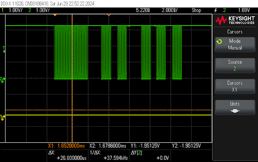

PWM signal waveform on an oscilloscope screen showing visible pulses. .
Here I will describe the implementation process of sending an IR signal based on a PWM and a timer. The signal sent like this from the microcontroller will be able to control the air conditioning. In addition, the signal format used will be compatible with what Flipper Zero captures, allowing the signals captured in this way to be used to send them from my platform. I will implement the topic based on the MCU on which I am doing my project, but I think the steps shown here will be analogous on other platforms as well.
Plan of action .
In the previous topic we looked at the IR signal captured by Flipper Zero:
Building an IR signal, captured in Flipper Zero, written in raw format .
So we already know that you will need:
- PWM, in this case 38kHz with adjustable fill
- some form of timer to be able to wait a given time to switch the PWM on/off

Oscilloscope screenshot showing PWM signal. .
Indeed, it all comes together. The whole thing could still be significantly optimised by replacing the pin handling by a function with direct register operations, but for now we're just running the timer, so I'll skip that.
Run the PWM .
Similarly, we now need to run PWM. All for now as a separate example. On my BK7231 it looks like this:
Code: C / C++
26000000 is the MCU clock frequency, which is 26MHz. We divide it by 38kHz to get the PWM period value. Then we set the fill to half the period - 50%. It works:
Oscilloscope displaying a PWM signal at 38 kHz frequency. .

Oscilloscope screenshot showing a PWM signal in rectangular waveform. .
Oscilloscope screenshot showing a waveform signal lasting 900 μs. .
It all adds up. The high state is about 100us, then a low of 500us and again a high of 300us. This is what I have specified in the file.

Example result (screenshot from Sigrok):
Screenshot of IR signal analysis. .
When zoomed in you can see the PWM (here from the oscilloscope):
PWM signal graph at 38 kHz frequency from an oscilloscope. .
