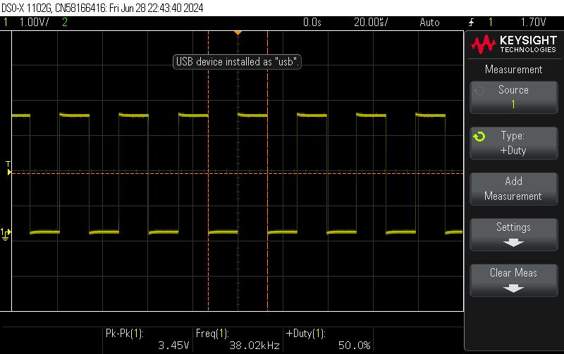

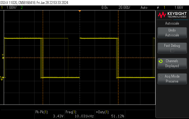

    In addition, in order to check if the timer works, I decided to "wave" some GPIO. Setting the pin to output mode:
    Code: C / C++
    Well, and our ISR - Interrupt Service Routine - handling the interrupt from the timer:
    Code: C / C++
    Uploading, testing:
    Oscilloscope screenshot showing PWM signal. .
    Indeed, it all comes together. The whole thing could still be significantly optimised by replacing the pin handling by a function with direct register operations, but for now we're just running the timer, so I'll skip that.

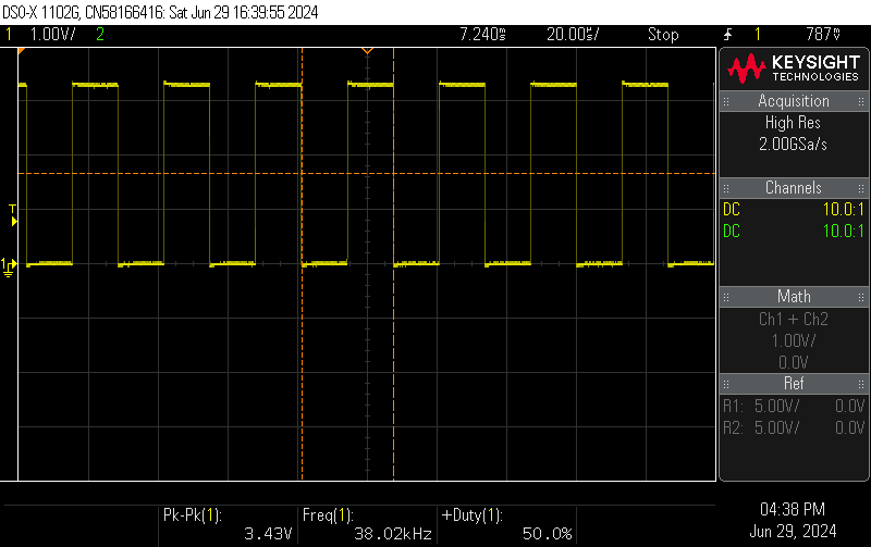

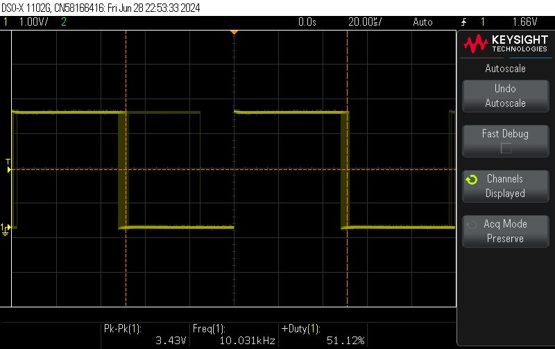

    Run the PWM .
    Similarly, we now need to run PWM. All for now as a separate example. On my BK7231 it looks like this:
    Code: C / C++
    26000000 is the MCU clock frequency, which is 26MHz. We divide it by 38kHz to get the PWM period value. Then we set the fill to half the period - 50%. It works:
    Oscilloscope displaying a PWM signal at 38 kHz frequency. .

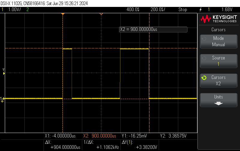

    Now let's still set the timer period and the variable counting the elapsed time. By the way, we need to remember the state (we are sending PWM or not) so that we can convert it to the opposite when the timer expires:
    Code: C / C++

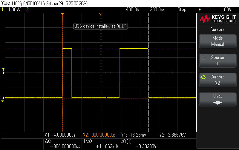

    And now our ISR, however, without PWM to start with - just waving a pin:
    Code: C / C++
    The above code counts how much time has elapsed, compares the elapsed time with the next threshold and if the threshold has been passed, the code 'jumps' it and subtracts its value from the current time (so as not to accumulate an error).
    I also added command parsing to this in the format:
    Send 100,500,300,500,100
    This topic is not about parsing ASCII text into a buffer, but I'll mention that I used strtok anyway - code for reference:
    Code: C / C++
    The only important thing here is to remember not to start sending data prematurely, during parsing. This is why I set the "cur" pointer to the first element of the array at the end, already after parsing.

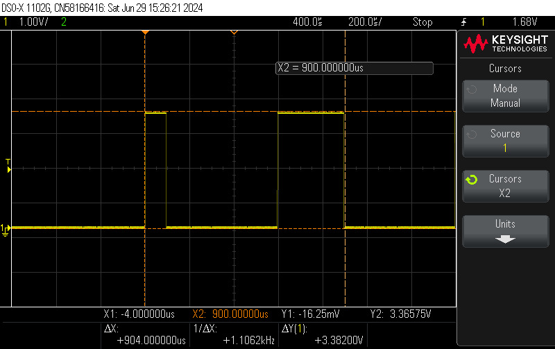

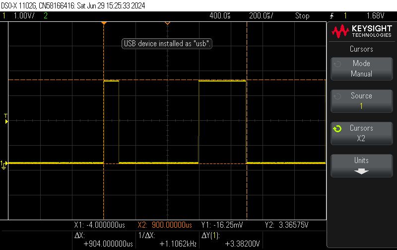

    We test - we send the "data":
    Oscilloscope screenshot showing a PWM signal in rectangular waveform. .
    Oscilloscope screenshot showing a waveform signal lasting 900 μs. .
    It all adds up. The high state is about 100us, then a low of 500us and again a high of 300us. This is what I have specified in the file.

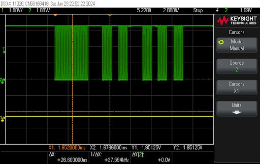

    PWM comes into action .
    Since swiping the pin according to the times already works, PWM can be plugged in. Basically we just change a few lines. Depending on the state (sending or not), we set the appropriate fill (although you could just as well turn off the whole PWM...):
    Code: C / C++
    Time to test this. In my environment, everything is wrapped in text commands that look roughly like this:
    // start the driver
    startDriver IR2
    // start timer 50us
    // arguments: duty_on_fraction, duty_off_fraction
    StartTimer 50 0.5 0
    // send data
    Send 3500, 1500, 500, 1000, 1000, 500,

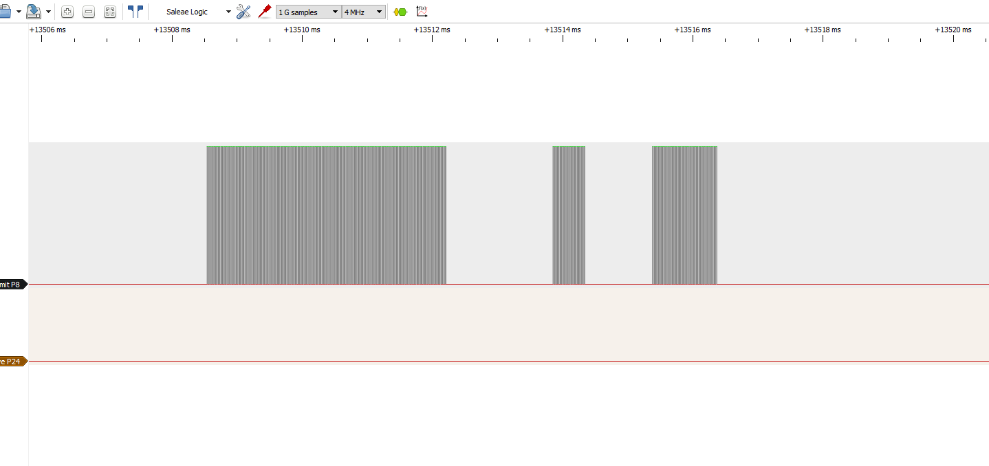

    Example result (screenshot from Sigrok):
    Screenshot of IR signal analysis. .

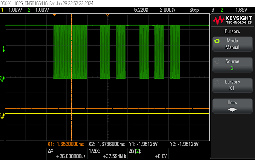

    When zoomed in you can see the PWM (here from the oscilloscope):
    PWM signal graph at 38 kHz frequency from an oscilloscope. .

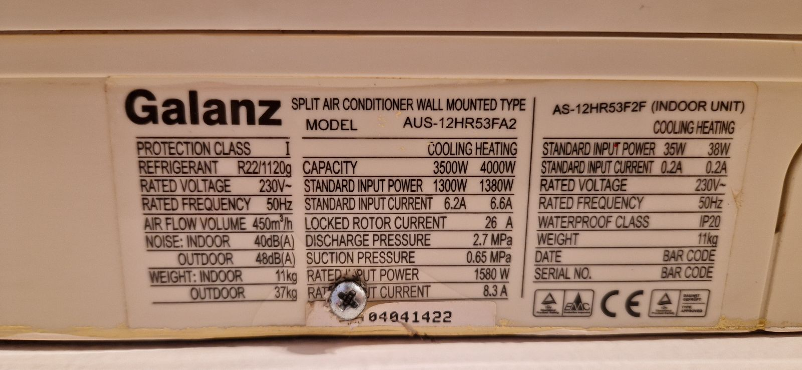

    Final test .
    For our final test, we used the Galanz AUS-12HR53FA2/AS-12HR53F2F air conditioner:
    Galanz air conditioner label with technical specifications. .

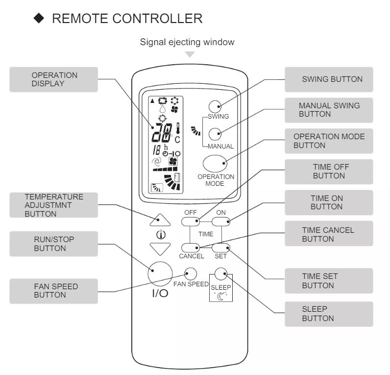

    This air-conditioning does not have WiFi, but has a remote control with enough functions for comfortable use:
    Air conditioner remote control with button labels .
    We captured the Flipper Zero command ON:
