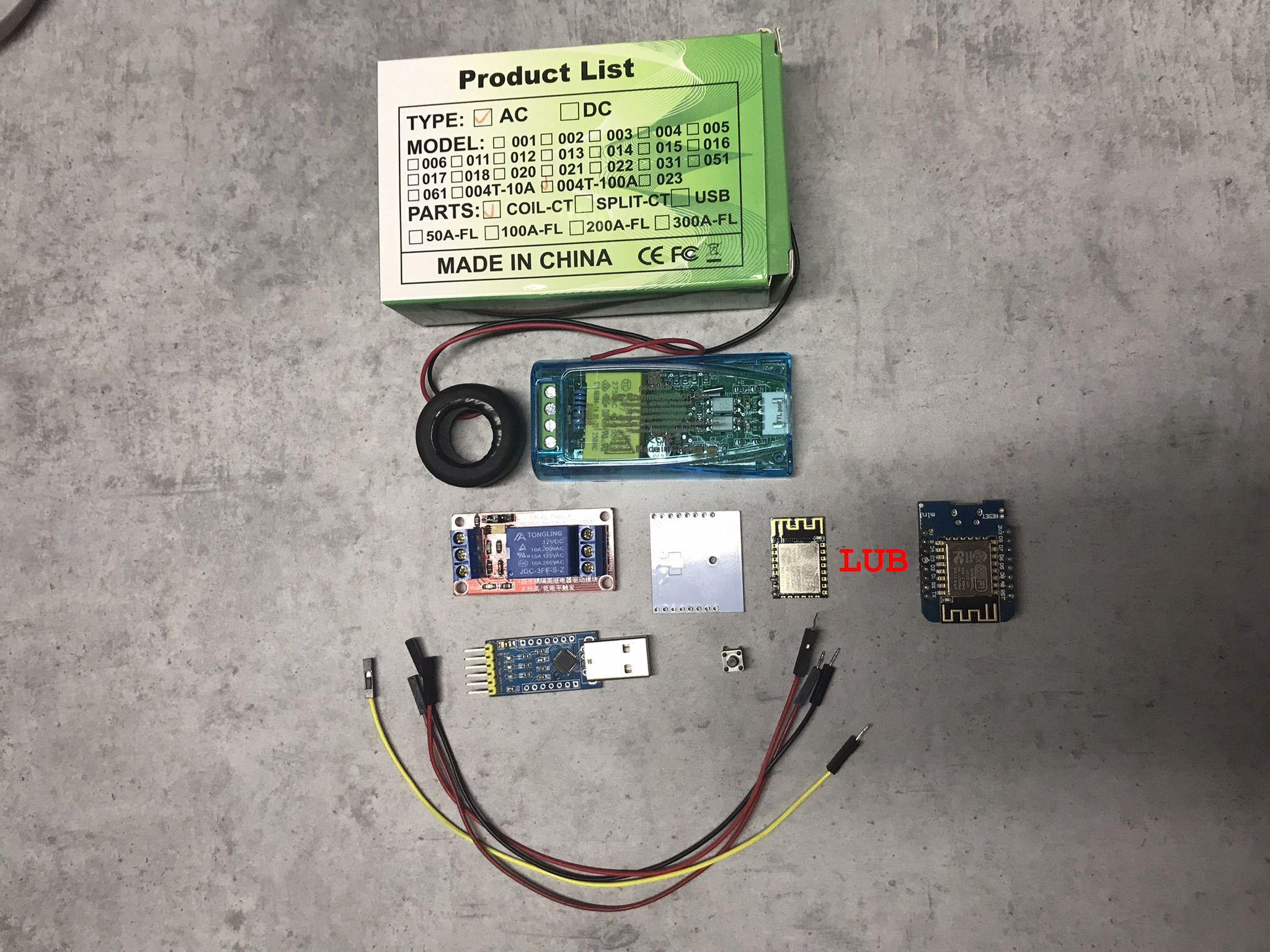

The elements I used in the project are:
1. PZEM 004-t measuring module
2. ESP 8266 + board with 5V stabilizer because I just had it, but we can use wemos D1 mini or NodeMCU then we won't need USB TTL programmer but just USB cable from phone to program wemos. For those new to the subject, I would recommend buying a Wems D1 mini, it has everything you need on board for programming and operation once the tasmot is loaded.
3. a button - which will be used to put the ESP into a configuration state.
4. wires to connect the ESP8226 to the input of the PZEM 004-t Module, you can also buy the original cable with plug that fits the PZEM 004-t.
5. the female-to-female wires will also be useful if you purchase the Wemos D1mini.
6. 5V relay module
7. 5V power supply - a phone charger can be used.
8. Tasmota software and NodeMCU Flasher links above.
Components for a heater control project in a photovoltaic system. .
