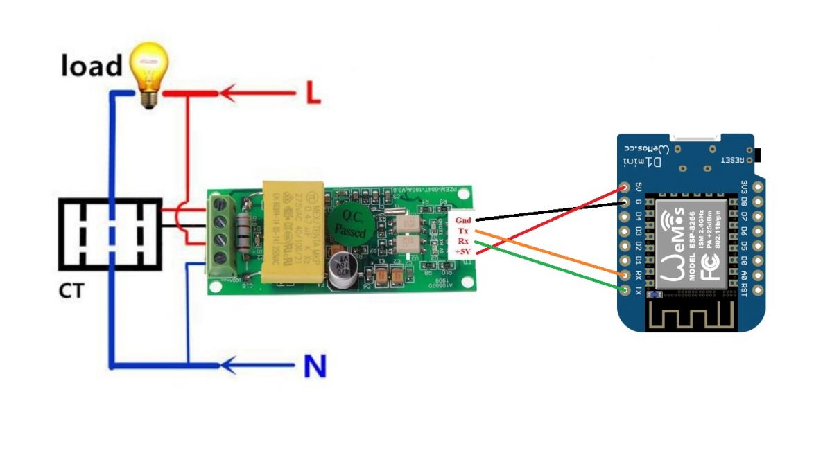

    PZEM to ESP there is a lot of this on the internet, as well as how to upload the Tasmota and its first start-up. I do not want to duplicate these instructions here, they can be found on google.
    Borrowed diagram from google:
    Wiring diagram of PZEM module to ESP8266 .

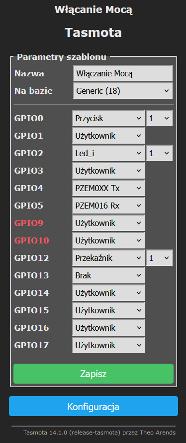

    We connect the PZEM module to GPIO 4 and GPIO 5 GPIO 4 TX PZEM to GPIO 5 RX PZEM.
    We connect the relay module to the free GPIO.
    To GPIO 0 and to GND we connect the button giving GND to GPIO0 6 times puts the module into hot-spot mode while giving GND to GPIO while turning on ESP puts it into flash mode.
    After loading the tasmota and the first start-up, having the ESP with the tasmota already in our local network, we move on to the module settings:
    Screenshot of Tasmota configuration showing GPIO port settings. .

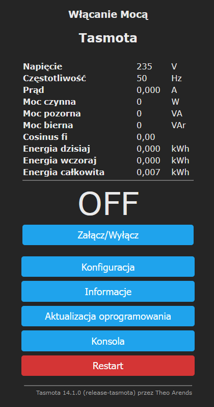

    Such settings we save the module restarts and we have the screen:
    User interface for the Tasmota system displaying voltage and power data. .
    We can check if our relay is working and if we have voltage on the PZEM
    Of course we connect 230V to the PEM according to the diagram above.

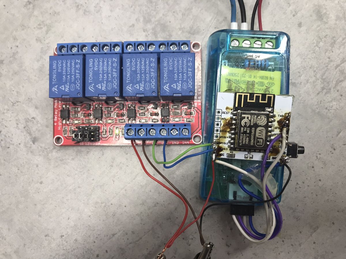

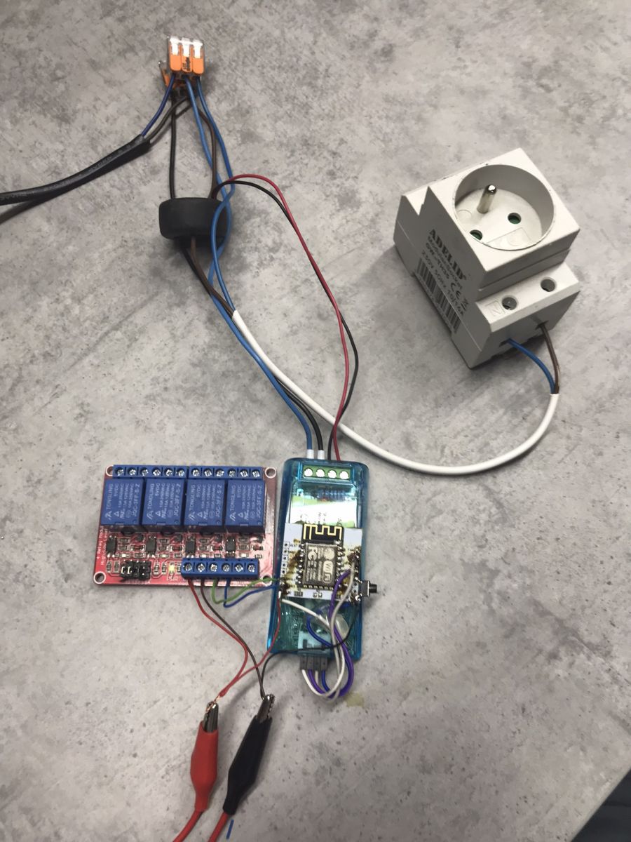

    I for testing did it like this:
    ESP8266 module with relay module and wiring. ESP8266 and PZEM 004-t modules connected to a 4-channel relay .
    The picture shows a 4 channel relay module connected under two GPIOs because I was testing two rules which are designed to switch on individual relays at different powers. That is, for example, the power going through the PZEM, e.g. above 2000W turns on relay 1, the power going above 3000W turns on relay 2.
    How much power we set is an individual matter.

    Now checking that everything is working is enough to mount it in the switchgear.

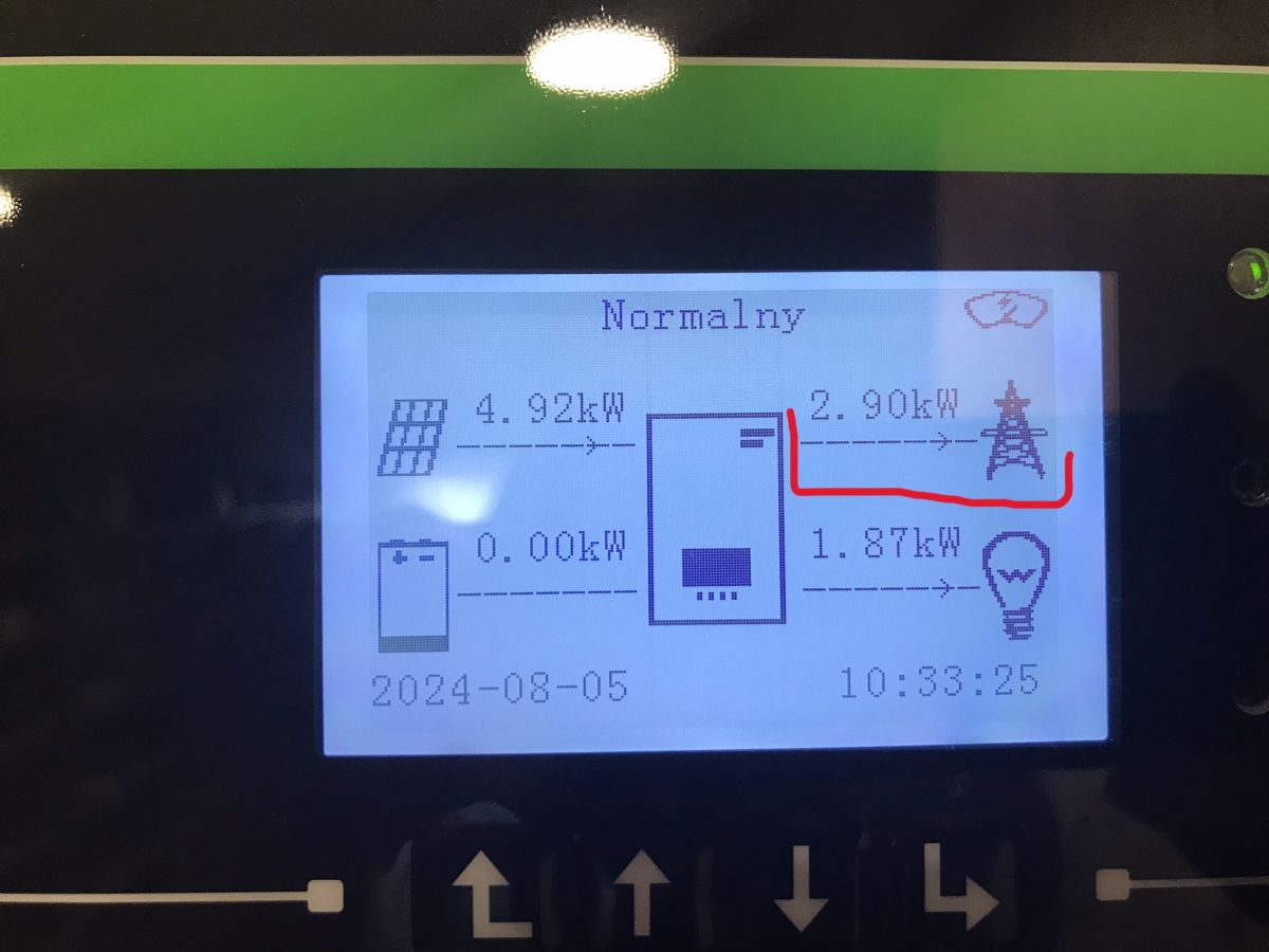

    We mount the measuring clamp on the phase conductor going directly from the inverter and take 230V from the same phase to the PZEM.
    The PZEM module sees the power and current flow no matter which way it flows, so we have to mount it directly on the wire from the inverter.

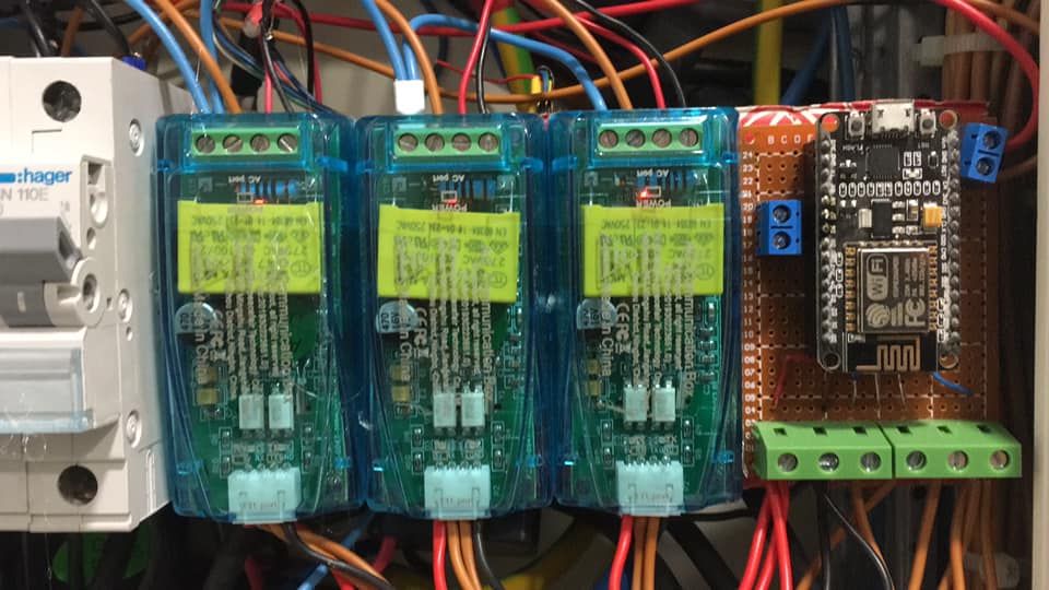

    I have also made a project on 3 PZEM modules which monitors the energy consumption for the house was mounted directly on the power supply of the distribution blocks for the protection on the house. The inverter has been plugged in front of the blocks that supply the house thanks to this in tasmotoa I can see the energy consumption of the house and the current power flowing from the inverter.
    Relay modules and ESP8266 on a prototype board in an electrical distribution box. .
    The above project has not yet gained a casing is currently a prototype but I think that the casing and implementation will already be an individual matter of each, I wanted to throw in a general idea of making such a control for water heating counting on the ideas of other more experienced users in the software Tasmota and ESP8266.

    Do I understand correctly? There is no information about the direction of the energy flow, so you used it to measure the actual power generated by the pv inverter?
    This is exactly why the installation of a measuring clamp is important.

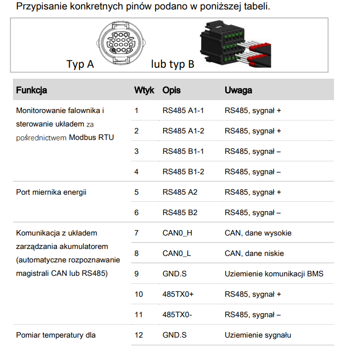

    I also have pin 1 and 3 out for communication and pin 5 and 6 used for communication with the meter it works with.
    Table of pin assignments and connection diagram for inverter and measurement devices. .
    I tried to communicate this with the RBPi on which I have Domoticz. But somehow I failed.
    Topic about this where someone even created a plugin for this but you still have to set up other topics and I relented.
    If I managed to get all the available data from Sofar into domoticz it would be fun to use. So far in domoticz I only have what the reading from tasmota allows me to do.

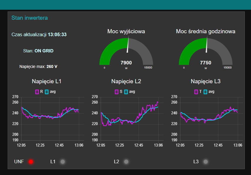

  • Node-RED as MQTT middleman for inverter control
    #11 21179432
    michal.zd
    Posts: 1697
    Help: 85
    Rate: 276
    Daro1003 wrote:
    NodeRed I don't have anything about it I don't know what or how.
    it's great, there's basically nothing you can't do on it.
    domoticz it doesn't even compare with nodered along with dashboard.
    see example view with nodered, i took a screenshot a while ago.
    Screenshot of a Node-RED dashboard displaying inverter status and voltage graphs for three phases. .
    and this is in a minute:
    Screenshot of the Node-RED interface displaying inverter status and voltage charts. .
    The status of the inverter is itself transmitted via mqtt from my broker.
    The data for the voltage graphs also, the pink line is the instantaneous voltage, while the turquoise line is the average voltage over the last ten minutes. This data serves as input to the block responsible for keeping the voltages normal, switching on the heaters in the buffer. If possible, of course, because sometimes the mains voltage is so high that no amount of power will help. Fortunately, such a situation is not frequent, and also the duration is several minutes. But thanks to the fact that I know that at this point my inverter has switched off, I also switch off the heaters. The controller logic is just written in javascript and works as a 'node' in nodered. The status is shown at the bottom as a light with a 'UNF' label indicating which phase has exceeded the voltage (this still needs to be worked out, it's fresh functionality)
    I also have domoticz, but after struggling for a few hours to integrate it with my broker, it turned out that nodered was the necessary middleman here. As soon as I started using nodered, I realised that domoticz here was really completely missing the point, just consuming memory and prock percentage. It flew out of rpi, I only have nodered.
    It's worth a go, I was already able to do what I want in it after two days of learning. Javascript is a simple language, and there is no need to use it as long as the 'node' blocks available in nodered are sufficient.

    Added after 32 [minutes]:
    I also looked at the discussion on the smart home forum you have a link to.
    It appears to me that this plugin is attached to the inverter via a cable connector.
    I immediately communicate via wifi with the LSW logger attached.

  • Use PZEM-004T to measure grid export and trigger heater
    #19 21180446
    Daro1003
    Posts: 2715
    Help: 295
    Rate: 608
    I have a 3 phase build on a PZEM 004-t on each phase the power is identical rather there is no point in measuring from the inverter the power on each phase unless you want to use it to measure the power consumption in the house.
    Single-channel 57zl two-channel 66zl you have to order a single-channel one to test what and how you can set it there.
    We still don't have any information about the over production that the inverter has, and in total this is the most important thing, i.e. the power that goes into the grid and above e.g. 1500W we switch on the heater.
    Inverter display screen showing power generation and transmission values. .

    That's why you put the measurement on the output to the grid. The direction of the current flow tells you whether you have an overproduction and send it to the grid or a shortage and take it. You can make a second measuring point on the heater. You need to think about the measurement points, especially if you have a three-phase installation and inverter.
    I'm not interested in monitoring the power on the phases from the inverter, that's what I have in the app from the inverter. However, my inverter does not show what you have on the display, because it can only do such things after attaching a so-called SmartMeter, which costs too much to satisfy curiosity ;) .
