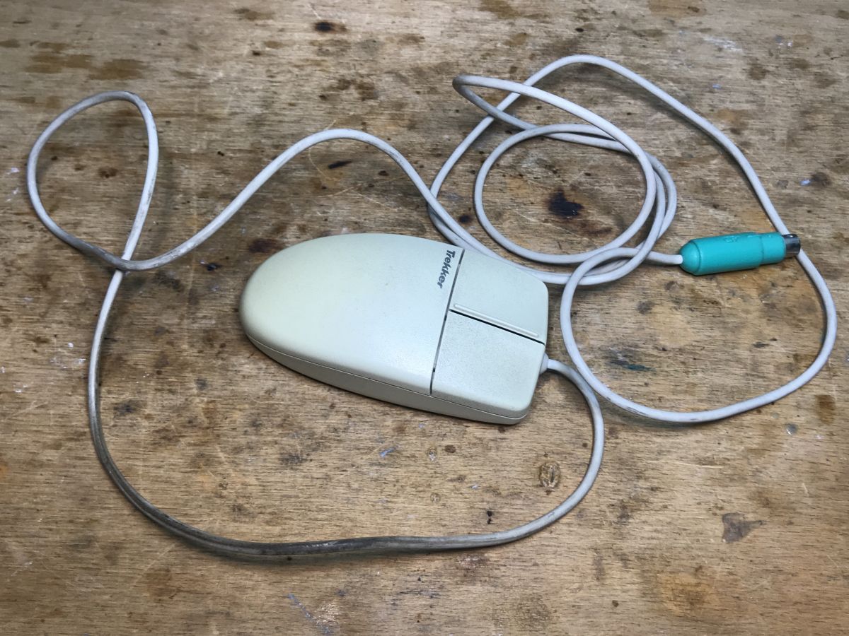

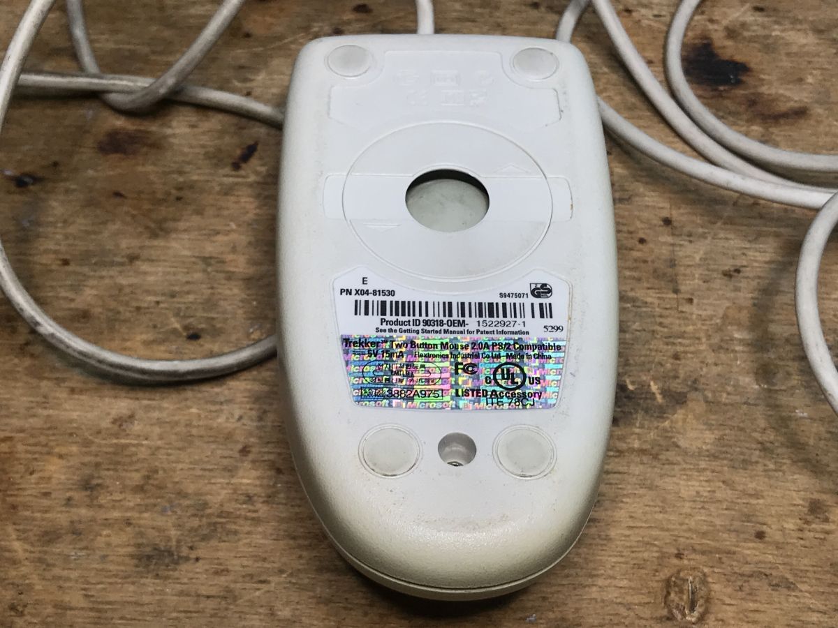

Trekker mouse .
We start with a mouse without a wheel. Personally I don't remember ever having one, was it even possible to work on this? What were those times like? That's all I can find out from your comments.
Old Trekker computer mouse with two buttons on a wooden surface.
Trekker Two Button Mouse 2.0A PS/2 Compatible
PN X04-81530 90318-OEM-
5V 15mA
Old Trekker computer mouse with a visible label on its bottom. .

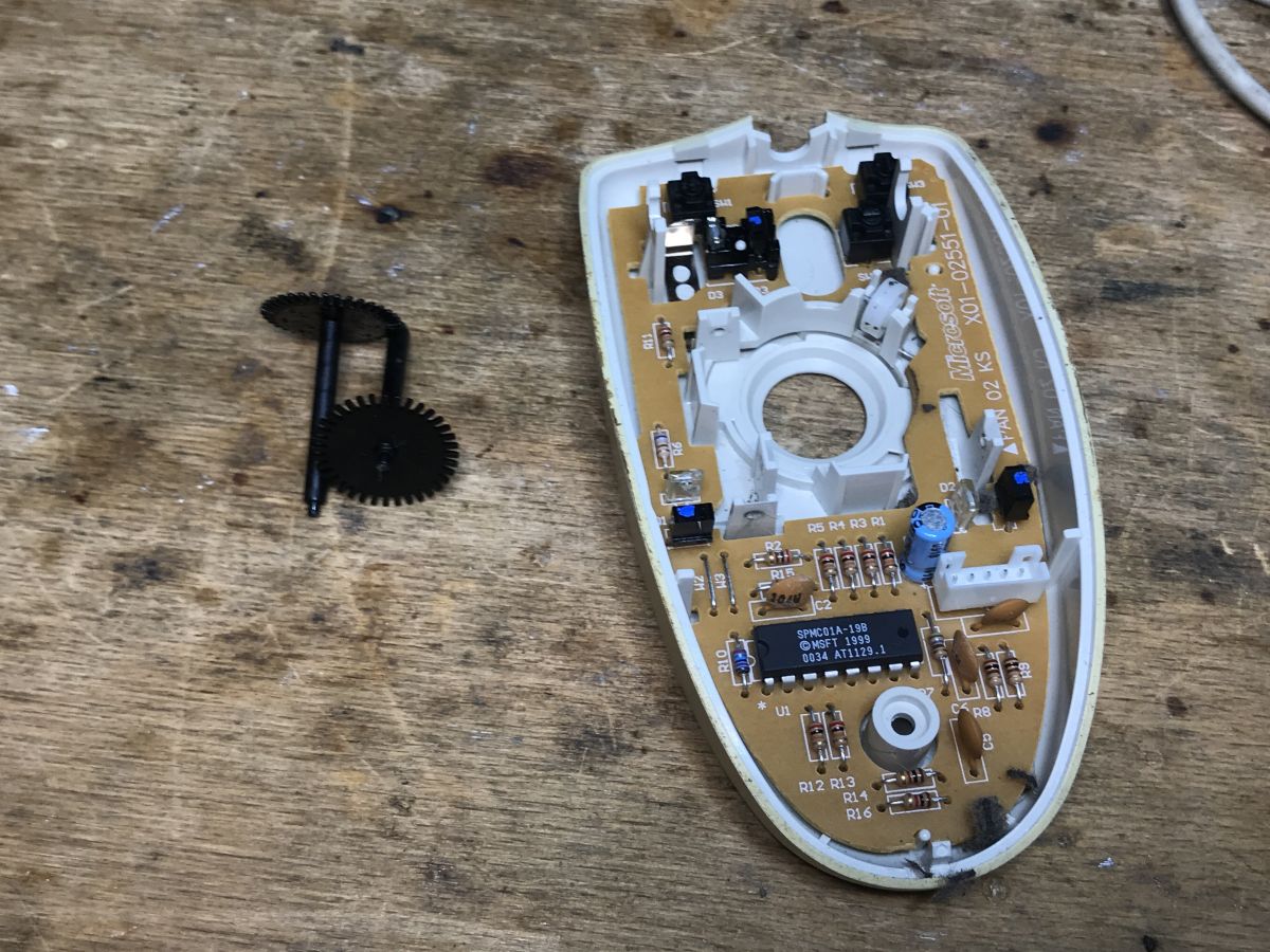

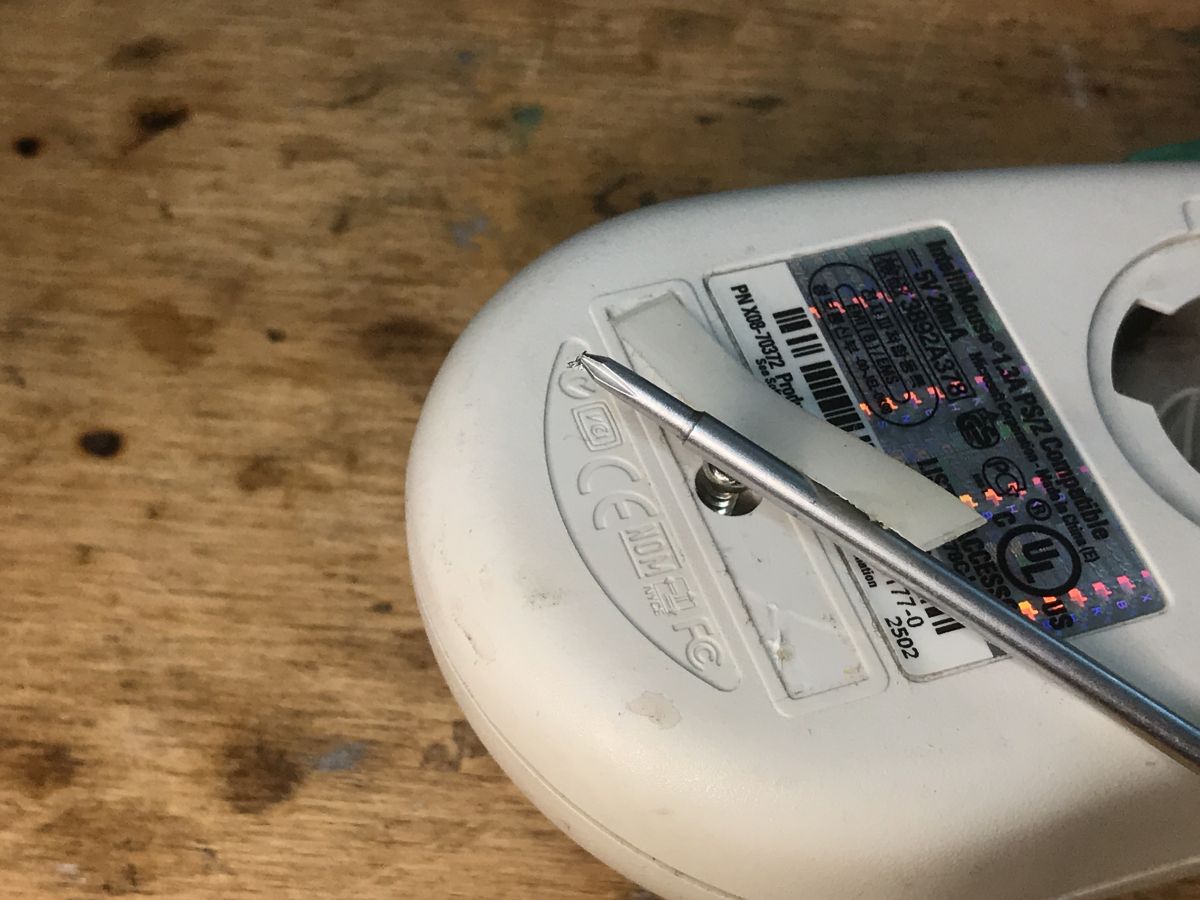

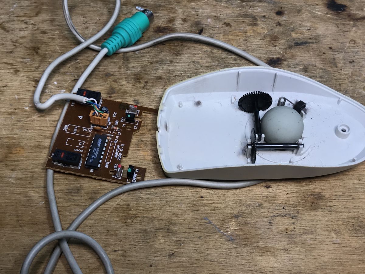

Unscrew one screw and look inside:
An old Trekker mouse on a wooden surface next to a screwdriver with a removed screw. .

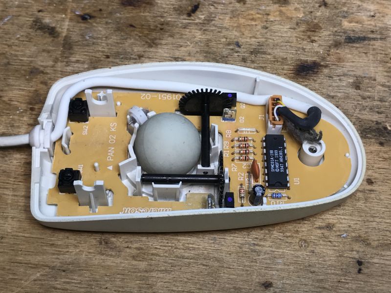

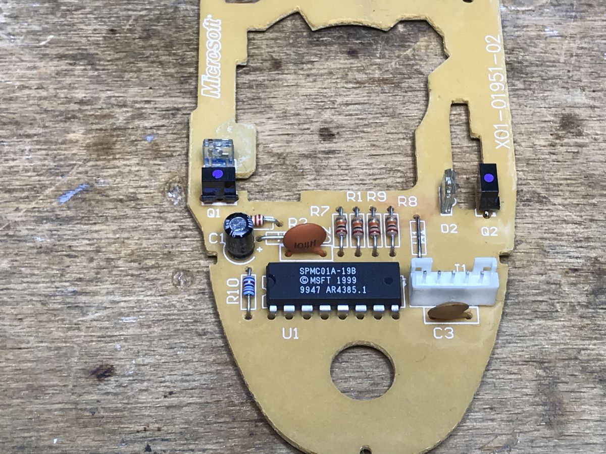

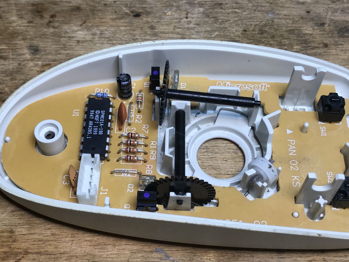

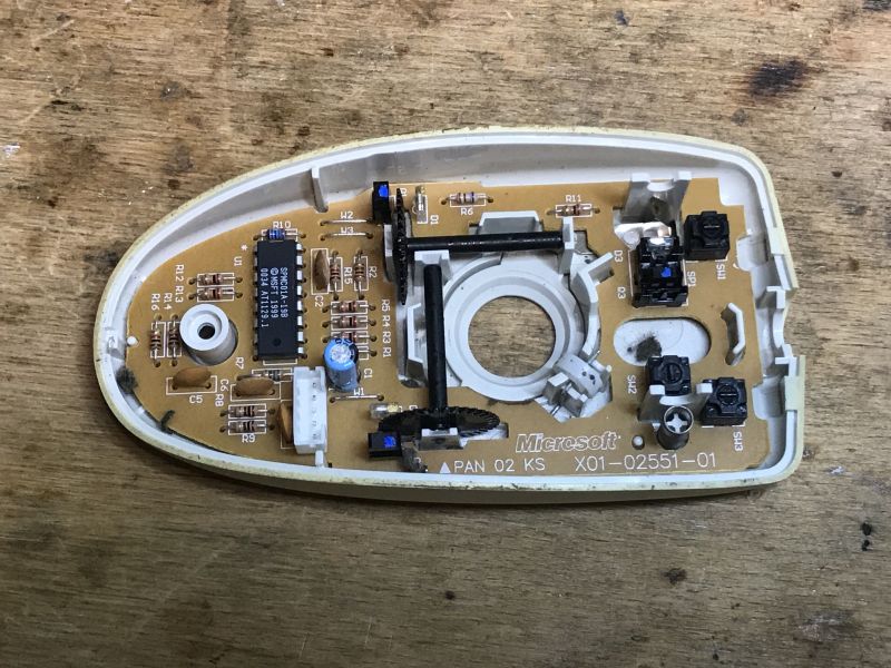

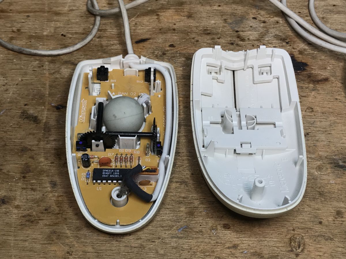

The mouse is based on the SPMC01A-19B. In the centres you can see two buttons (left and right) and two diode-phototransistor pairs, one each for the X and Y axis.
Interior of a disassembled ball mouse showing the circuit board and components .

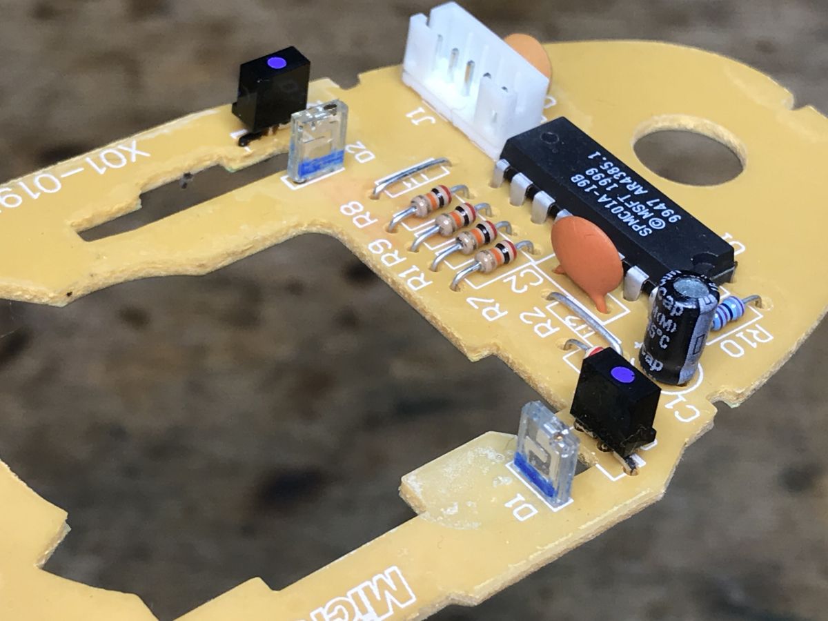

These teeth, due to the rotation of the ball, cover and expose the diode and the phototransistor collects the pulses and determines the movement on this basis. But we still need to know which way the movement is, for this reason two phototransistors are needed per axis. Here, by the way, you can see that the diode has two legs and the receiver has three:
Printed circuit board with exposed tracks and soldered connections. .

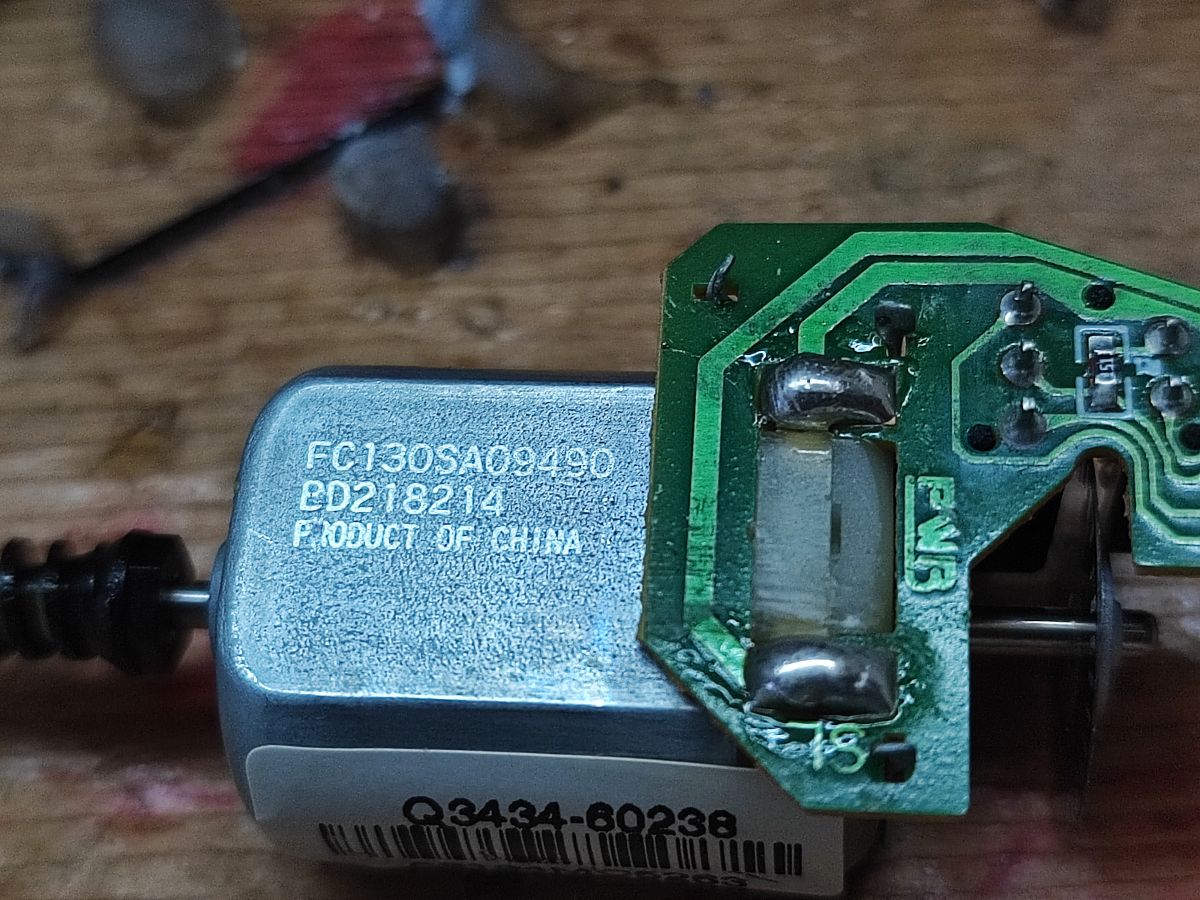

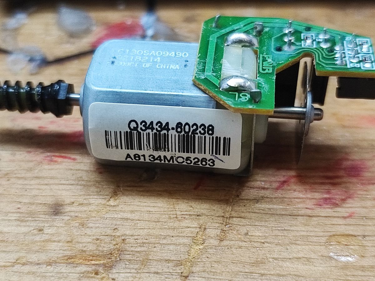

The same mechanism is also, for example, with the scanner motor from the printer, a DC motor, as manufacturers do not want to use stepper motors there as a cost-saving measure:
DC motor with a circuit board on a workbench. DC motor from a printer with a visible encoder. Small DC motor with an encoder from a dismantled printer. .
Anyway, see to the mentioned topic , there I implement support for this in the Arduino.

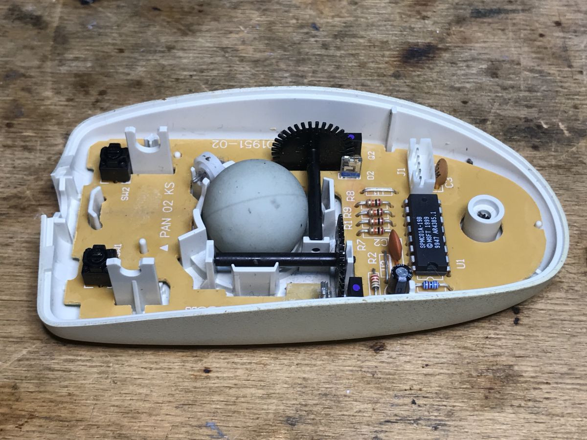

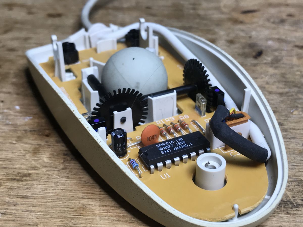

Interior of a classic ball mouse. Interior of an old ball mouse without a scroll wheel. Interior of an old ball mouse with visible SPMC01A-19B chip and dirt. Inside view of old ball computer mice Interior of an older ball mouse with electronic components. .
Let's get the ball rolling:
Interior of an old ball mouse without the ball Interior of an old ball mouse, consisting of a casing and a circuit board. Interior of a computer mouse with SPMC01A-19B chip from 1999 Circuit board of a computer mouse with electronic components. Close-up of a circuit board from an old computer mouse with visible electronic components. Close-up of a circuit board from an old computer mouse with visible electronic components.

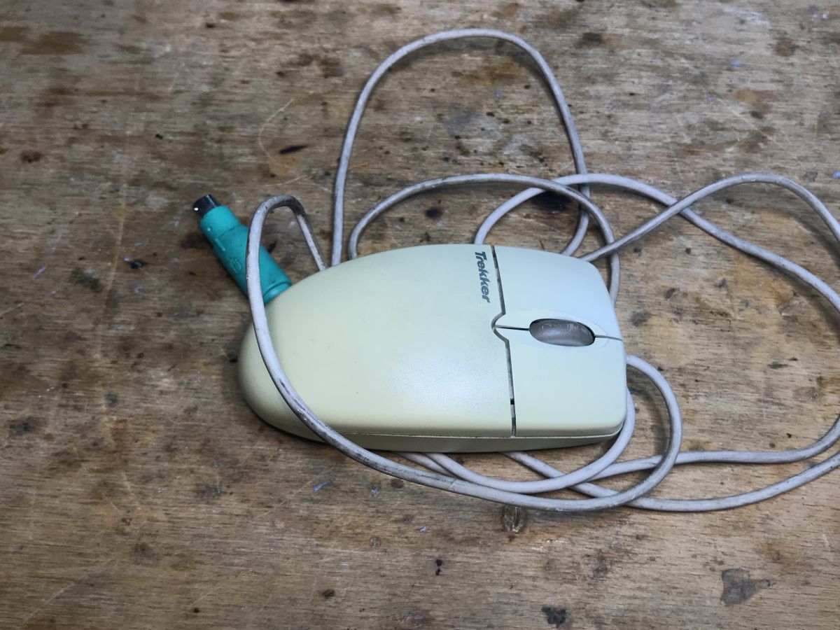

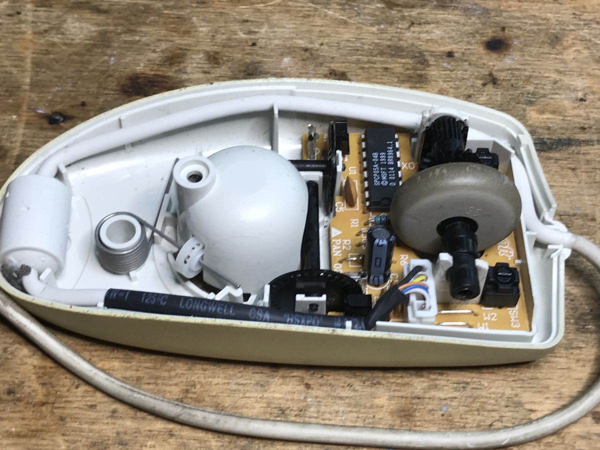

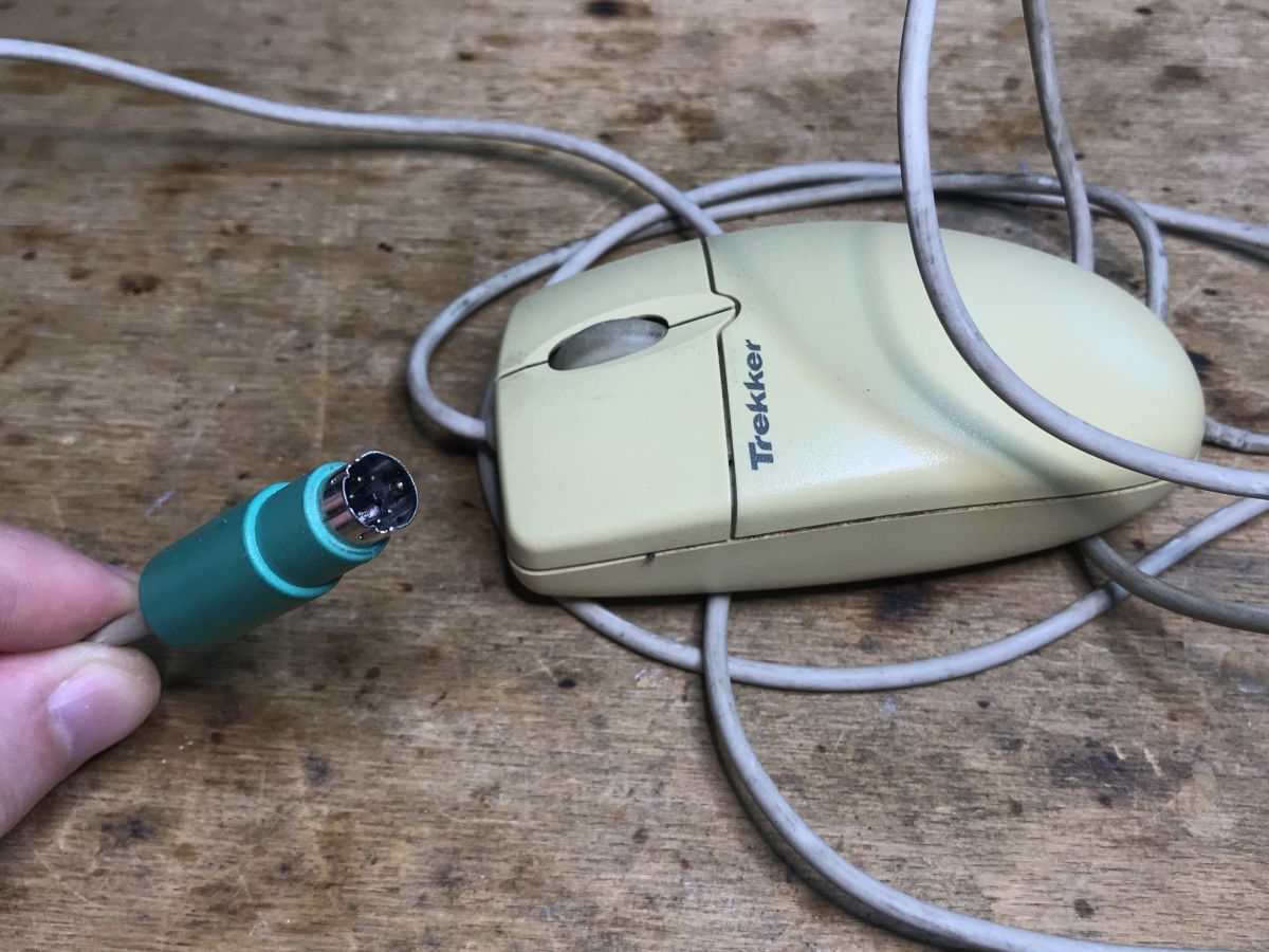

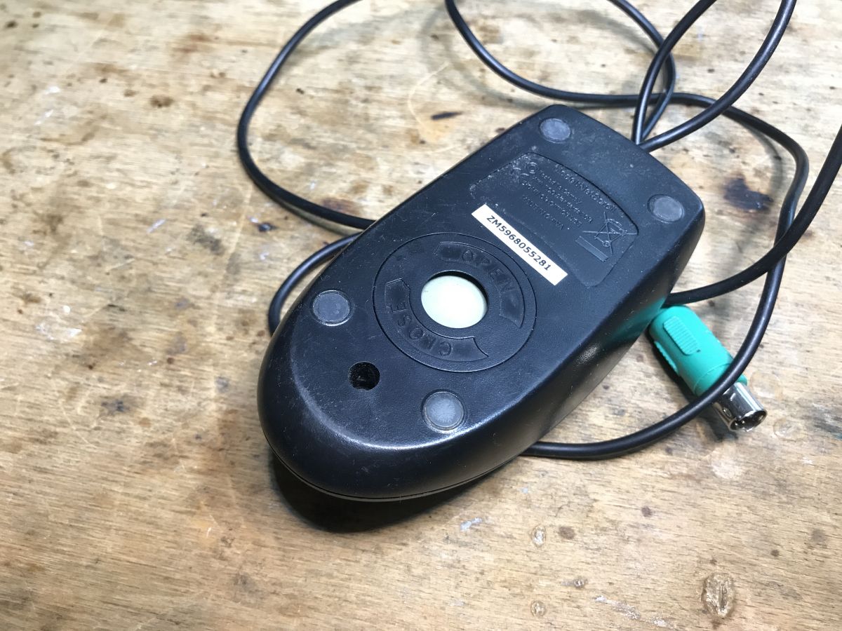

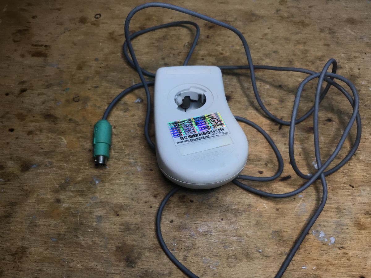

Trekker mouse with wheel .
The second mouse is also a Trekker, this time 3.0A, interestingly here at 5V and 20mA current rather than 15mA. Is this because there is a wheel here too?
Old Trekker computer mouse with PS/2 connector on a wooden background. .
PN X05-53753 Product ID 83351-OEM-
Old Trekker ball mouse with visible cable and PS/2 connector on a wooden table. .

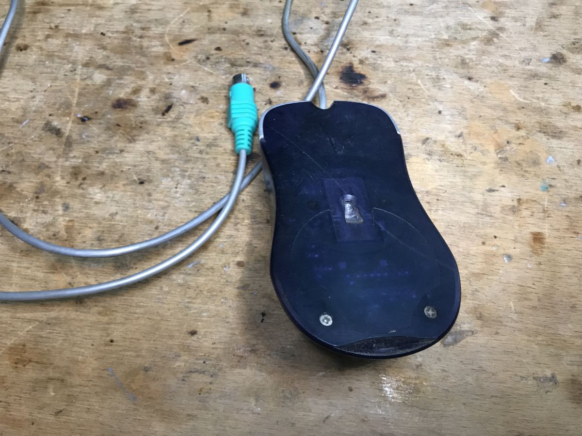

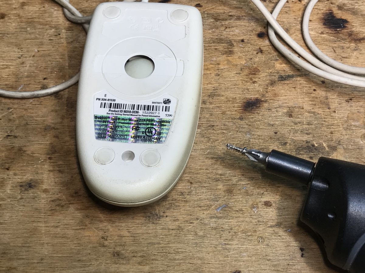

The screw is behind the ball:
Old ball mouse Trekker without the ball. Interior of an opened Trekker ball computer mouse on a wooden table. .

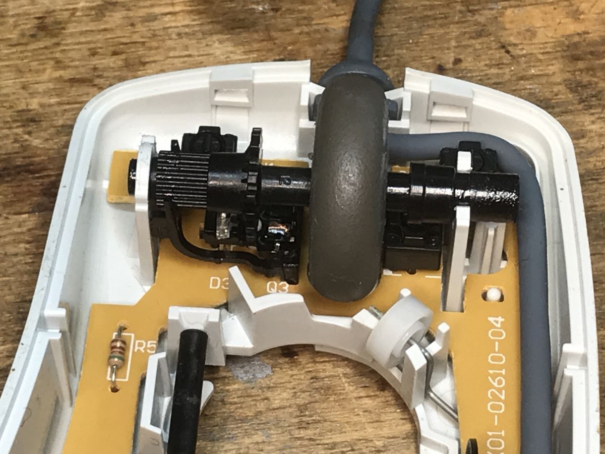

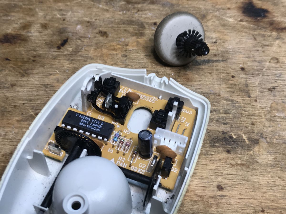

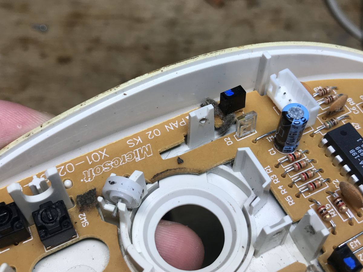

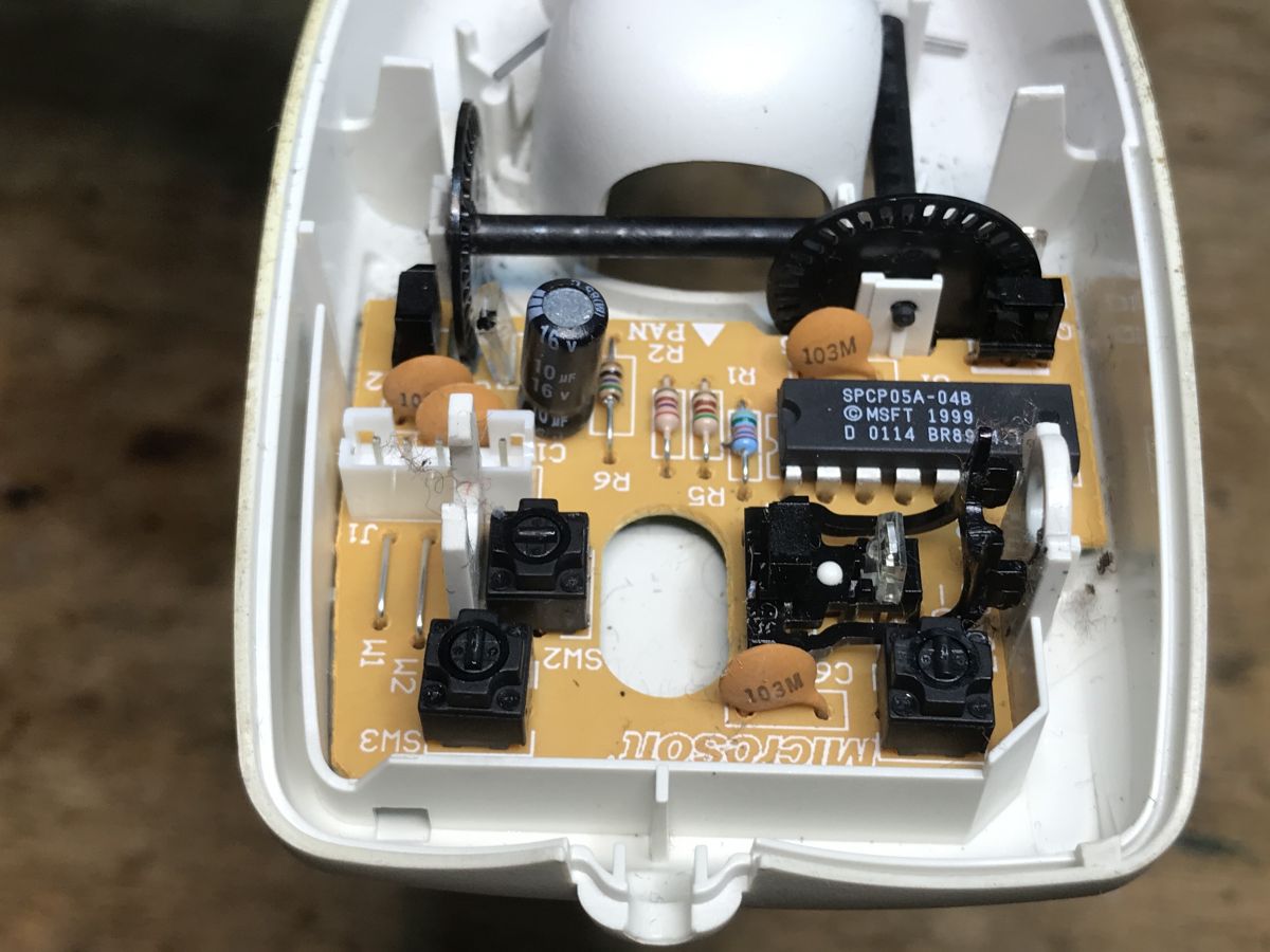

Here we have two additions - a third axis (wheel) and a third button.
Inside view of an old ball mouse with an opened casing. The image shows the interior of an old ball mouse with visible internal components. Interior of an old ball mouse showing electronic components. .
But the third axis is realised in the same way as the first two:
Inside view of an old ball computer mouse with electronic components .

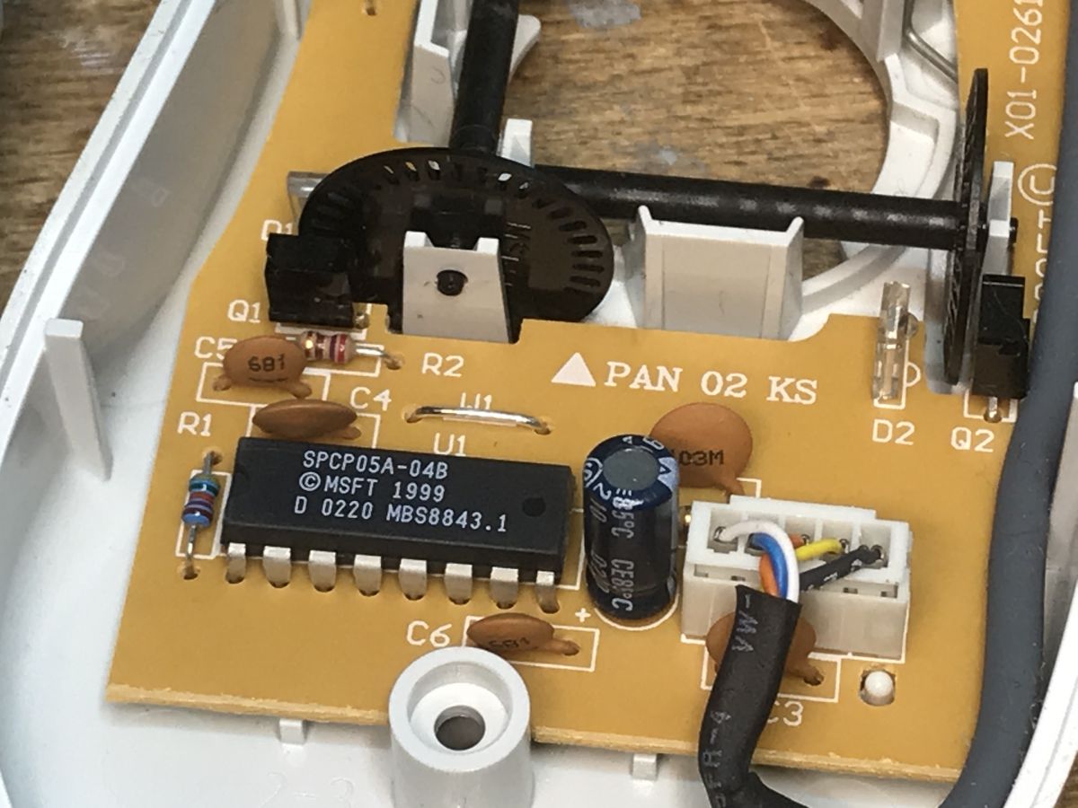

The controller is the SPCP05A-04B:
The interior of an old ball mouse with a close-up on the SPCP05A-04B chip. Interior of a Trekker ball mouse with visible circuit board. .

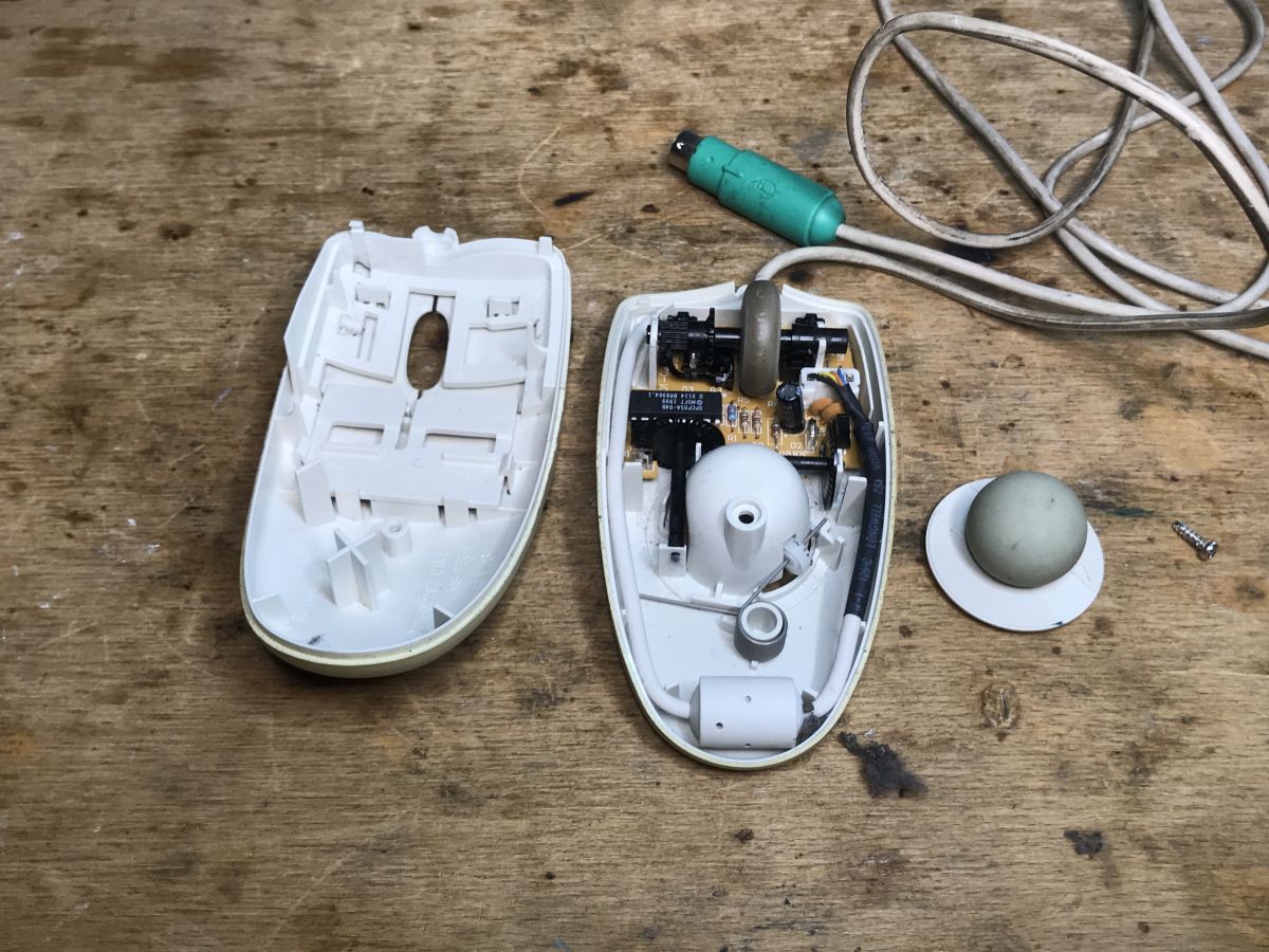

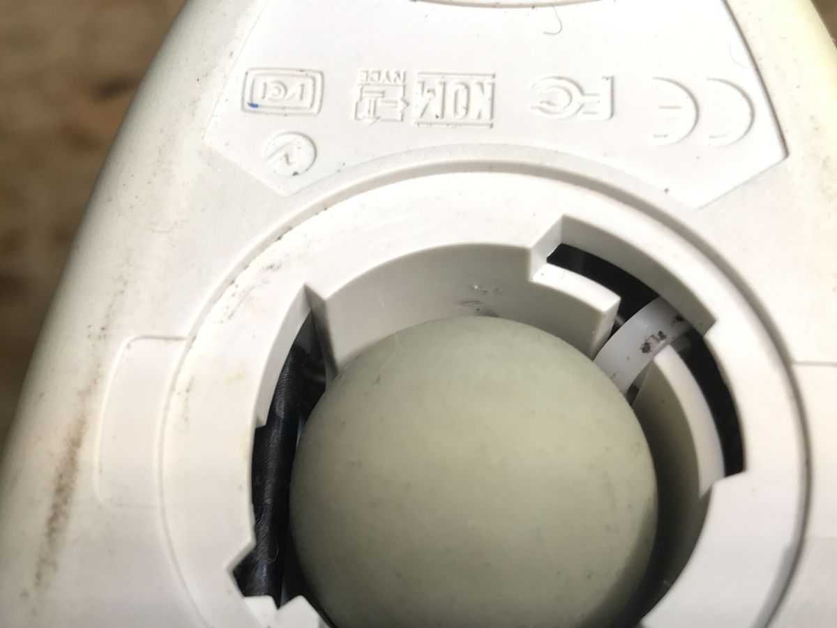

Ball attachment:
Photo of the underside of a ball mouse with the ball visible. Trekker ball mouse with identification stickers on the casing. Photo of the bottom of an old Trekker ball mouse showing the ball. .

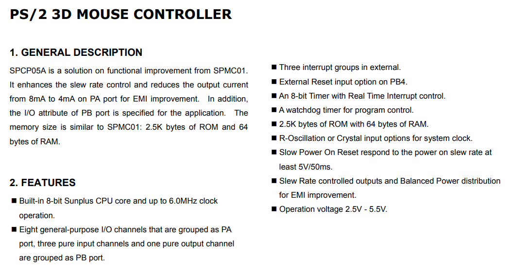

It is interesting to note that the SPCP05A is programmable:
PS/2 3D mouse controller documentation. .

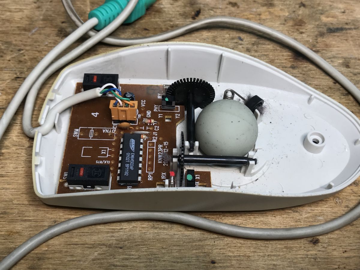

We take a look inside - the build is very similar to previous builds. This one is based on the SPMC01A-19B:
Interior of an old ball mouse with visible SPMC01A-19B chip and electronic components. Interior of an opened ball mouse showing electronics and mechanism. Interior of a disassembled ball mouse with old mechanism Interior of an old ball mouse showing visible electronic components. Inside of a disassembled ball mouse. Interior of an old computer mouse with visible electronic components .
Removed:
Interior of an old computer mouse with a circuit board. Interior of a disassembled computer mouse on a wooden surface .

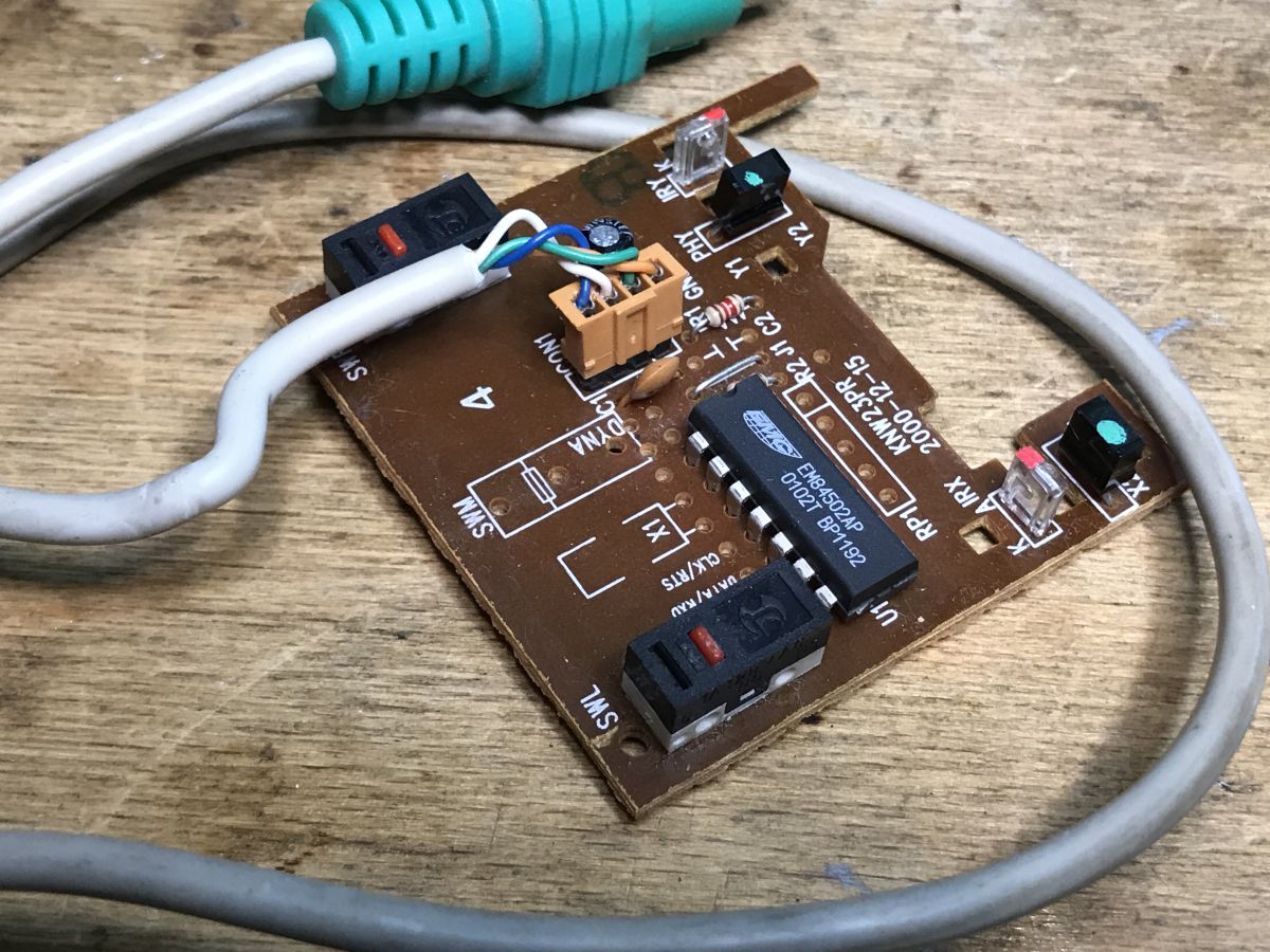

This mouse is two-button, but the board was also for the wheel version:
Interior of an old ball mouse showing the mechanism. Interior of an old ball mouse with visible electronics and ball .

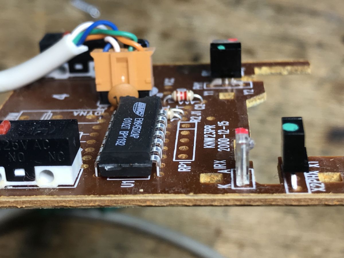

The date on the board is 2000-12-15, at this point it's about 24 years ago! The main controller is an EM84502AP.
Circuit board of an old computer mouse with electronic components. .
Switches:
Inside view of a circuit board from an old computer mouse with visible wires and a PS/2 connector. .
Simple, single-sided board:
EM84502AP chip on the PCB of an A4Tech OK-720 mouse. Interior of an old computer mouse with visible circuit board and wiring. Printed circuit board with electronic components from an old computer mouse. Interior of an old computer mouse with visible EM84502AP chip Printed circuit board from a computer mouse with a PS/2 connector cable. .
The EM84502AP, on the other hand, does not appear to be programmable:

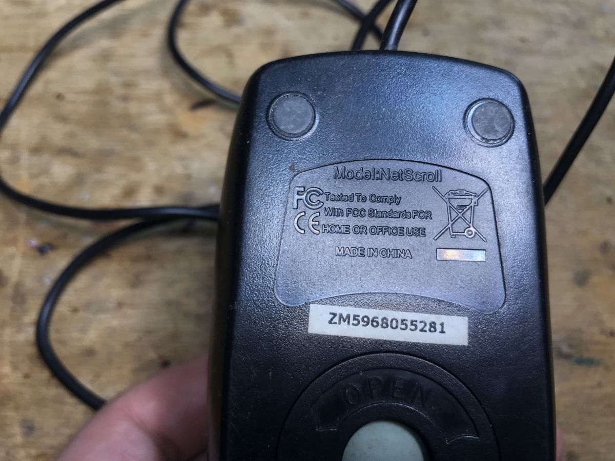

Model: NetScroll, a little less information.
Bottom of NetScroll mouse with label and cord .
Looking in:

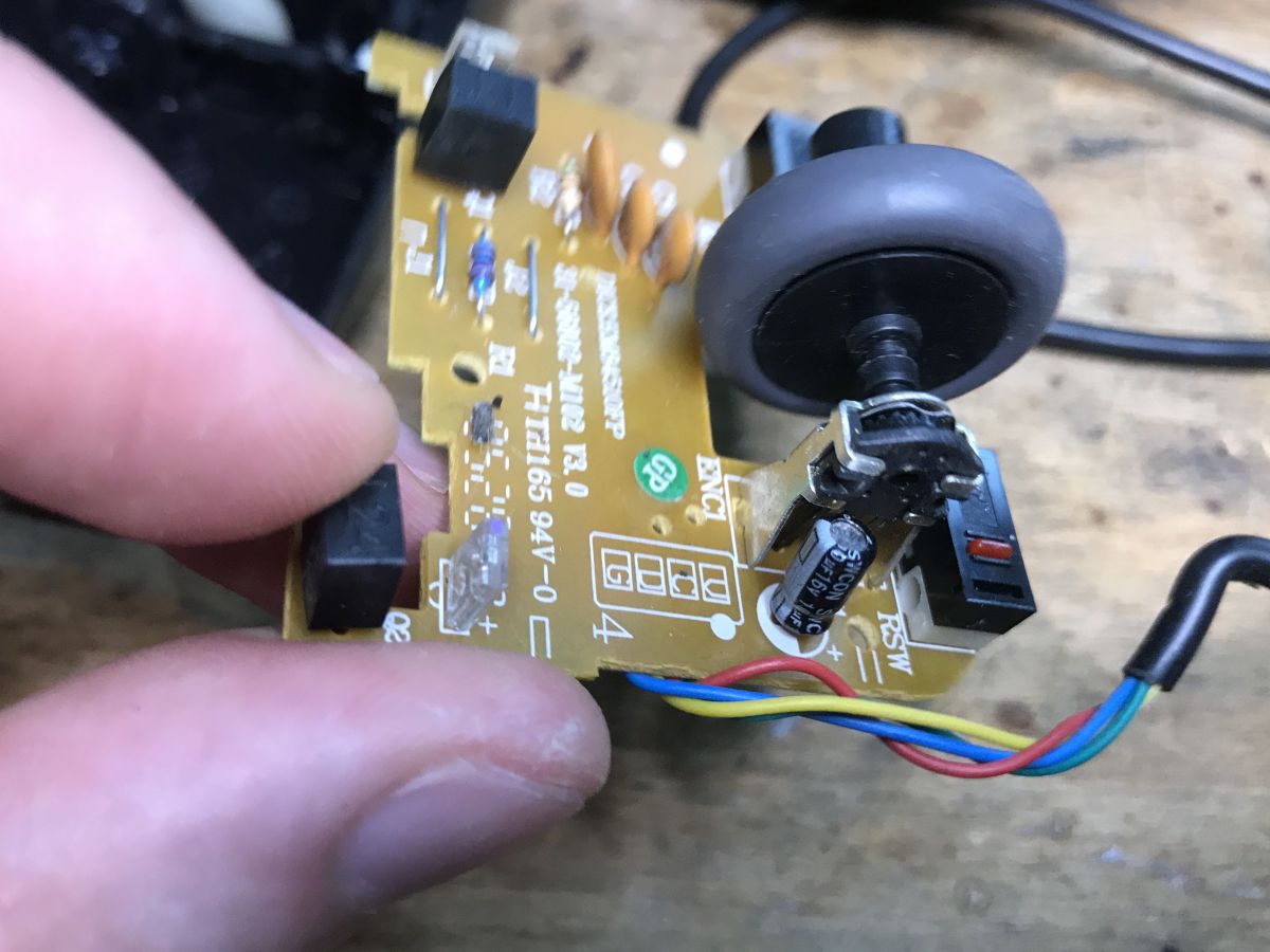

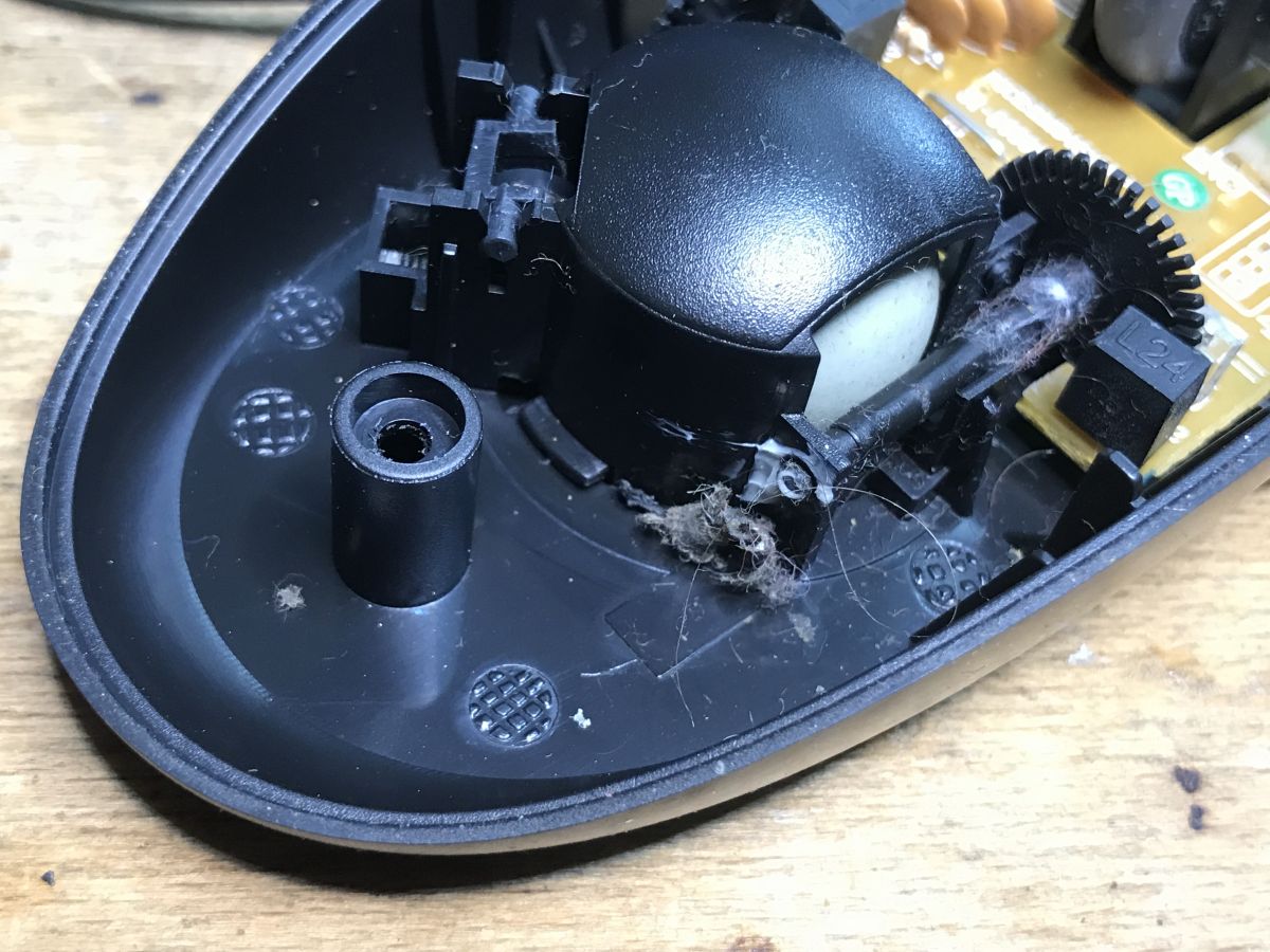

As usual, the mouse qualifies for cleaning inside:
Interior of an old ball mouse showing the ball and mechanism. .

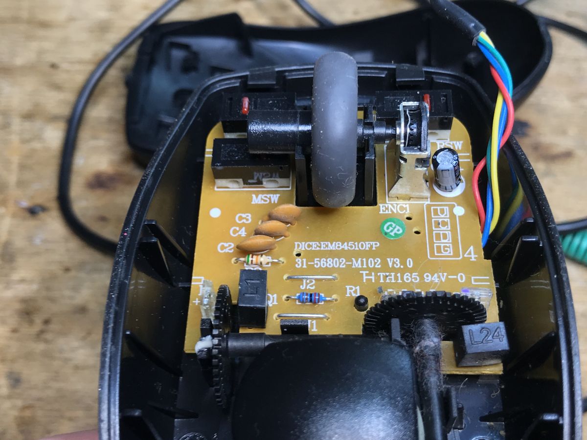

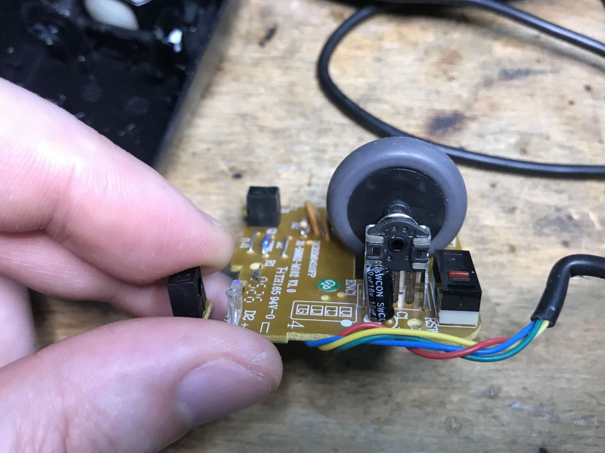

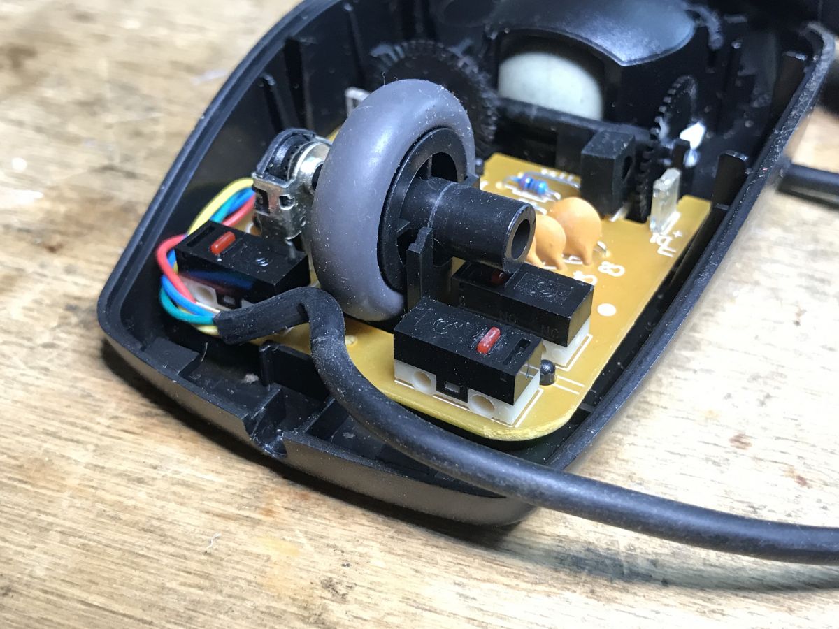

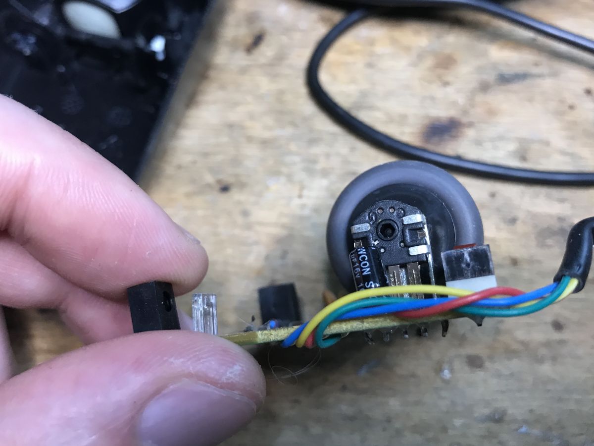

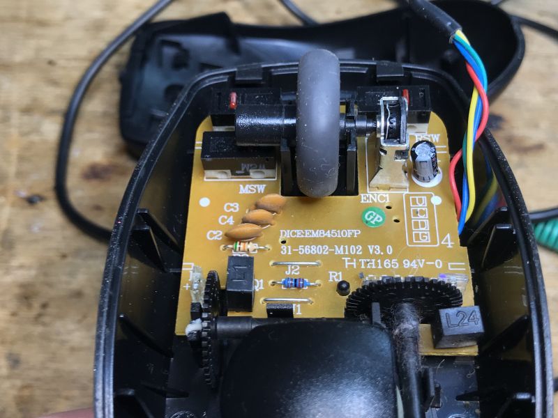

Oh, that's interesting, here the wheel is implemented differently - there is an encoder for the wheel.
Interior of an old ball mouse with circuitry and scroll wheel Interior of an old computer mouse with visible circuit board and wheel. Inside view of an old computer mouse with visible PCB and components. .

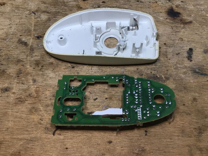

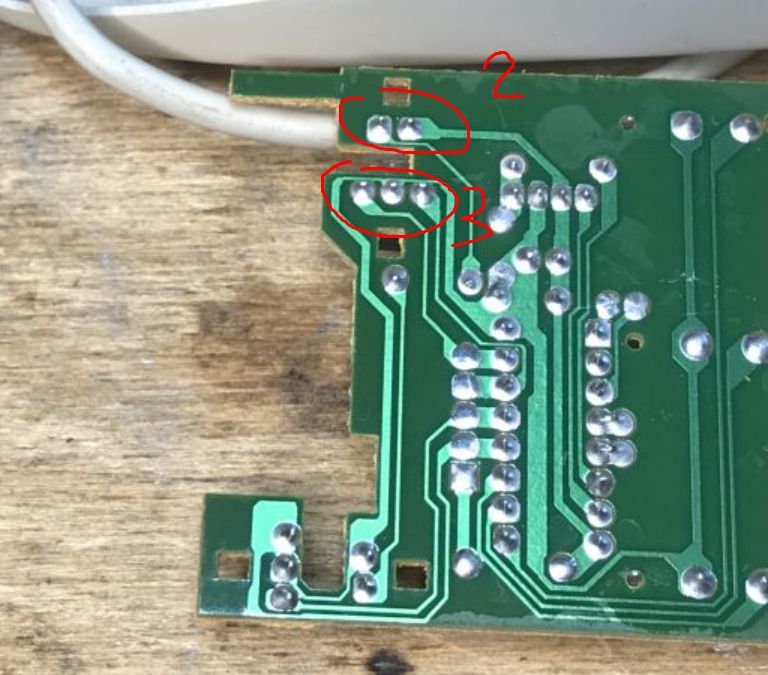

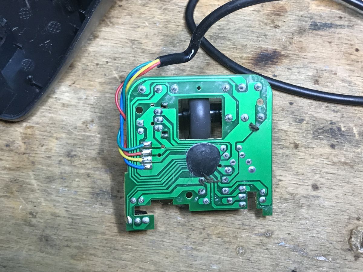

But where is the integrated circuit? Let's make the PCB free:
Interior of an old computer mouse with visible components Interior of an old ball mouse with electronic components on a circuit board. Inside of an old computer mouse with a visible encoder and colored wires Interior of an old computer mouse with a visible encoder and colored wires. .
Unfortunately.... and the wires are also soldered to the PCB, you can see that they have learned to save money over time. Why pay for a plug and connector?

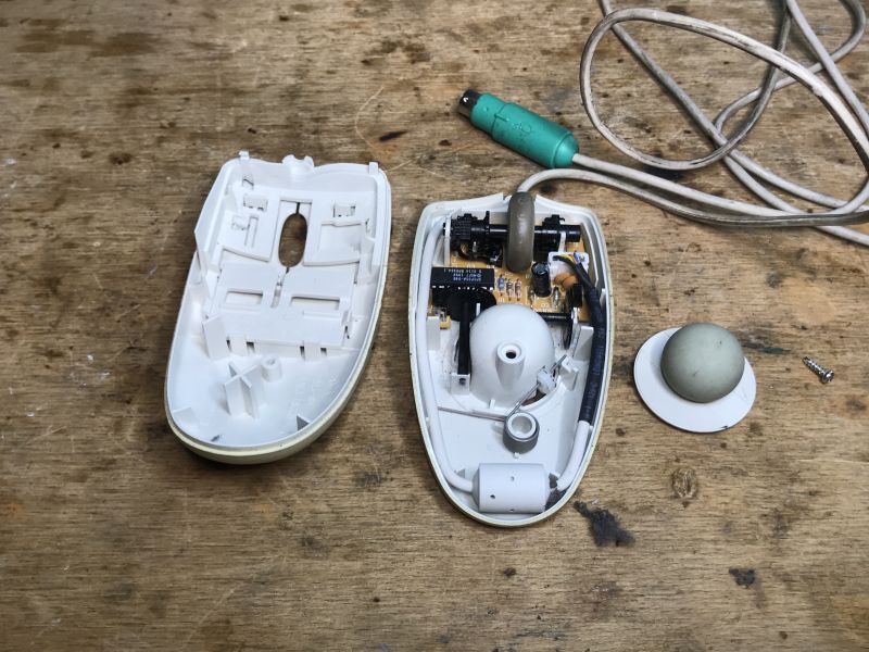

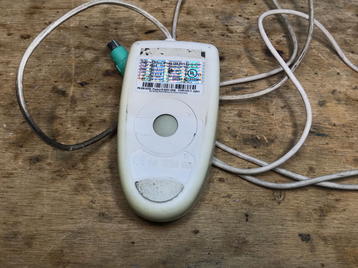

Now it is time for equipment that is not symmetrical:
Old ball mouse with a cable ending in a PS/2 plug, lying on a wooden table. .

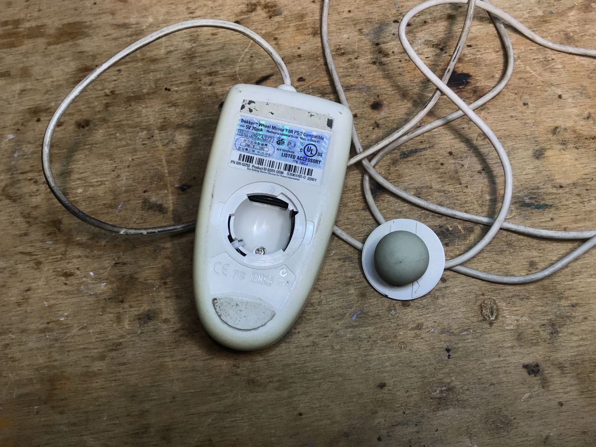

This time without the ball. We are looking for a screw:

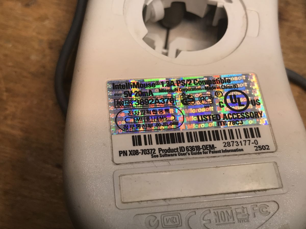

Label on the bottom of an old Microsoft IntelliMouse. Photo of the bottom of an old PS/2 computer mouse with a screw for opening the case. .

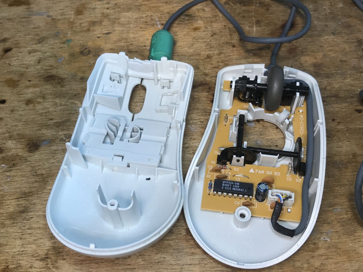

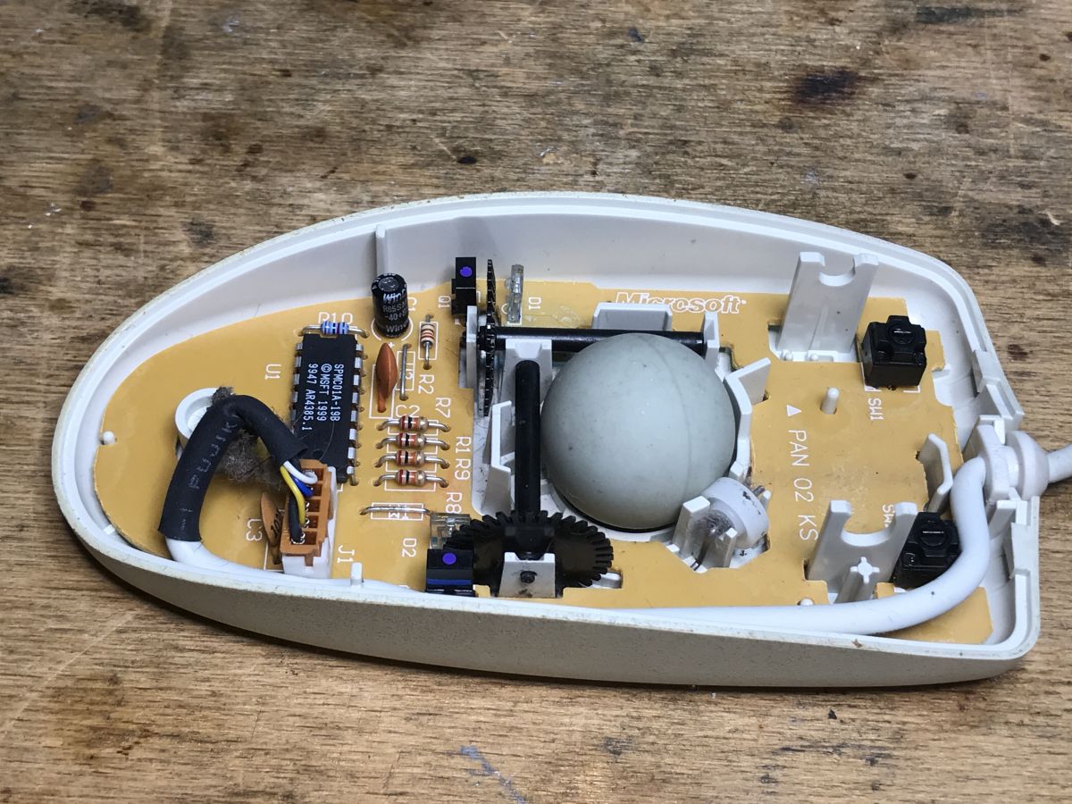

We take a look inside:
Interior of a disassembled ball mouse showing the circuit board and mechanical components. .

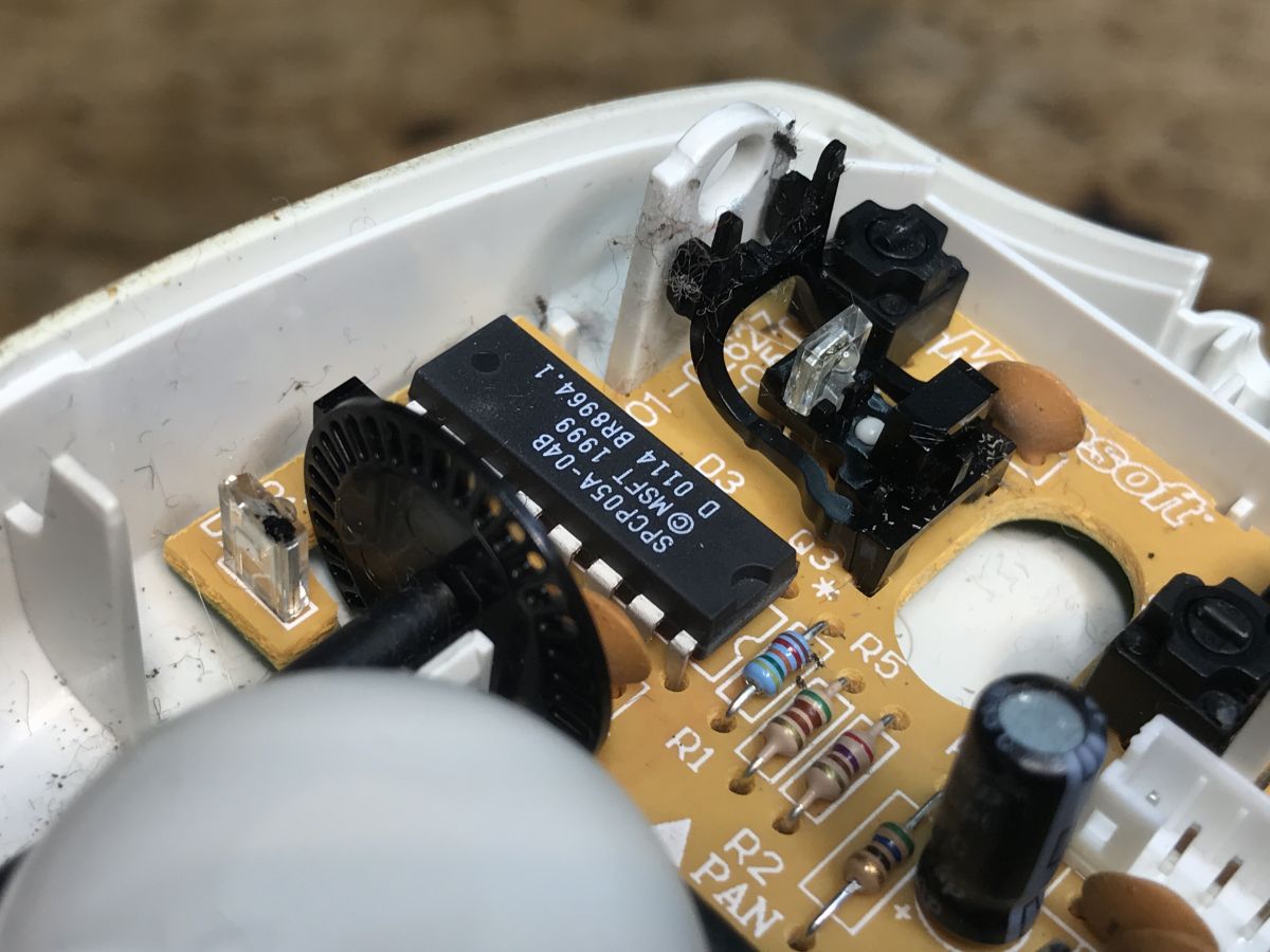

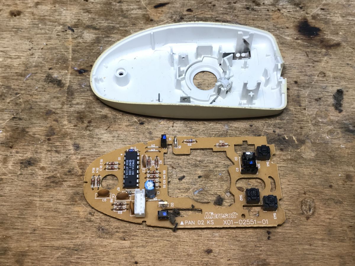

This mouse is based on the SPCP05A:
Inside view of an old computer mouse featuring the SPCP05A-04B chip. Interior of an old computer mouse with SPCP05A-04B chip Interior of a computer mouse showing mechanical components. .
I have already mentioned the SPCP05A a few mice above.

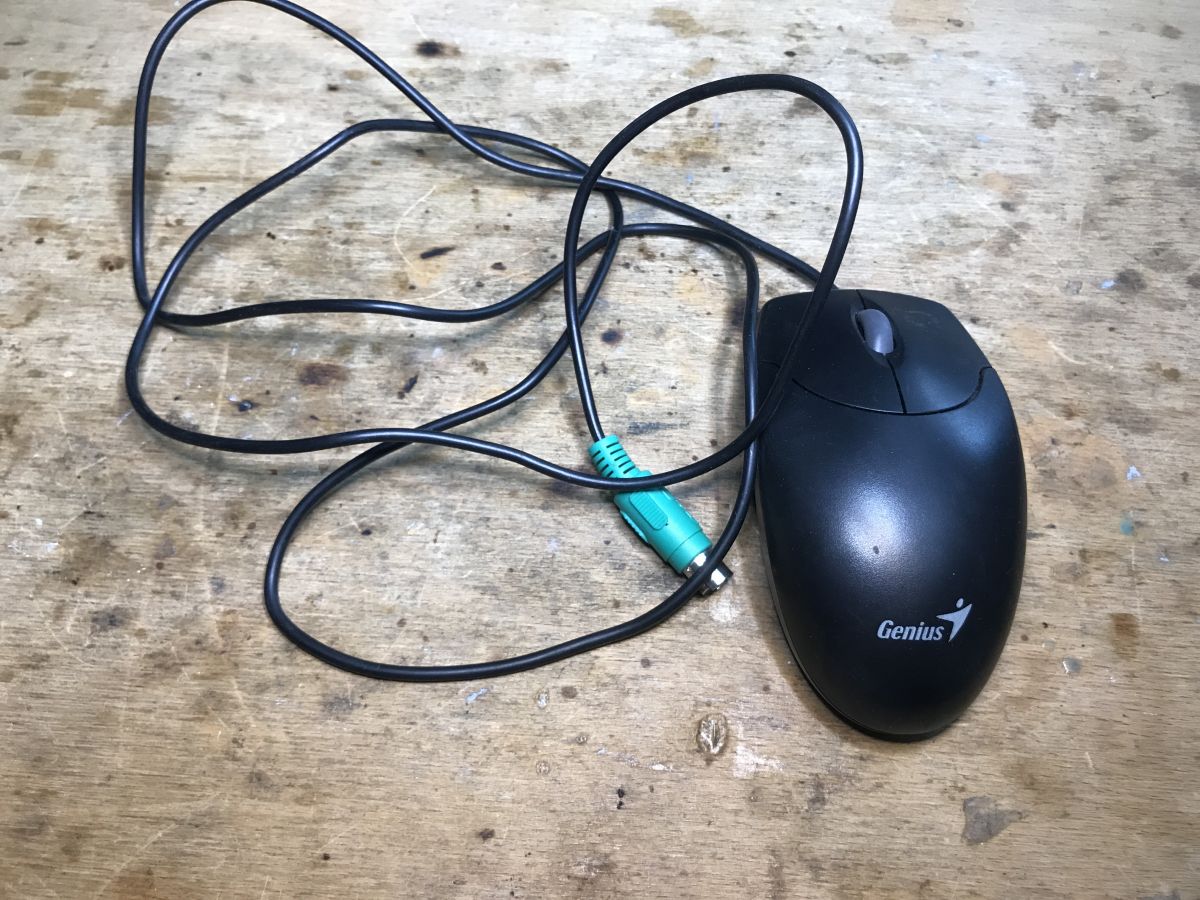

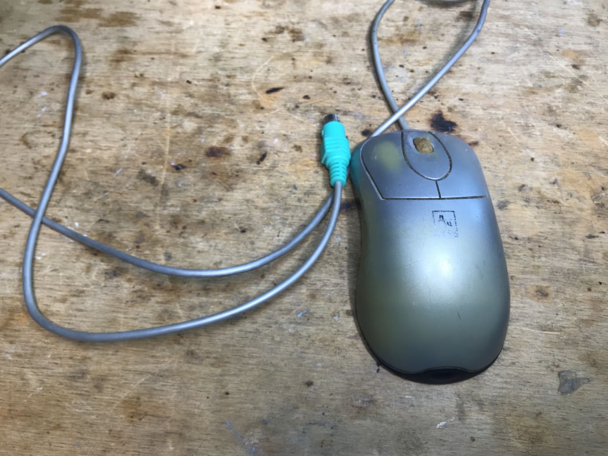

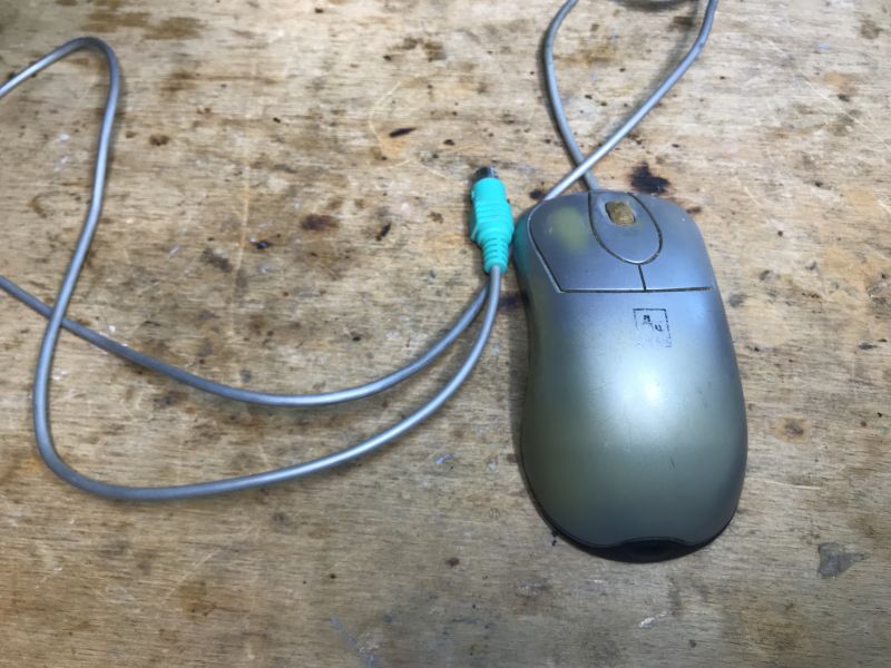

A slightly newer mouse this time - a laser mouse. Do you prefer this solution or the classic ball-and-socket?
Old A4Tech computer mouse with PS/2 cable on a wooden table.
Old ball mouse with PS/2 cable on a wooden surface. .

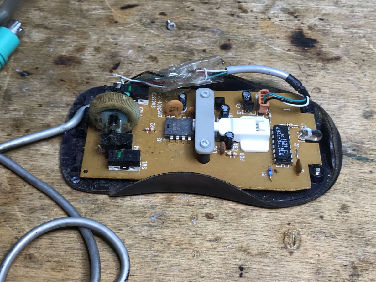

Let's take a look inside:
Interior of an old computer mouse with visible electronic components. .
Someone here has replaced the wire and without soldering.
Interior of an old laser mouse with TP8472BP chip .

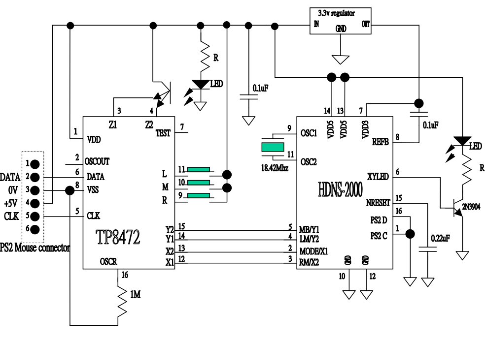

The mouse is based on the TP8472BP.
Inside old computer mice with a visible scroll wheel and electronic circuits. Interior of an old computer mouse with visible circuit board and electronic components. PCB board inside an old computer mouse. Interior of a classic computer mouse with a circuit board and connector. Close-up of a printed circuit board inside an old computer mouse. .
The U2 is probably an optical sensor, so the layout probably looks more or less like this:
Connection diagram of a laser mouse with TP8472 and HDNS-2000 ICs .
The optical sensor receives the light from the LED reflected from the desk and converts it into movement along the X/Y axis.

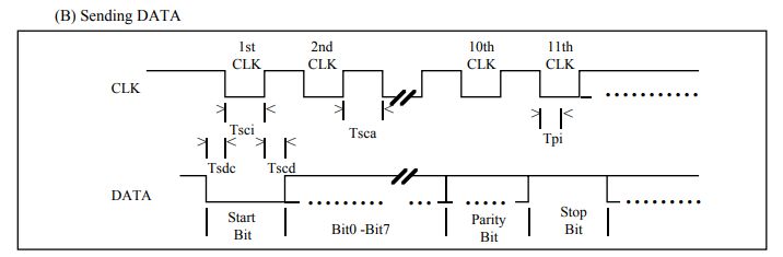

Mouse communication protocol with PS/2 .

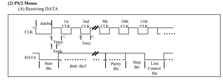

We will use the EM84502AP catalogue note here. But first we will start with the basics.
Here we have 4 signals:
- 5V
- ground
- clock (CLK)
- data (DATA)

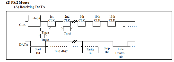

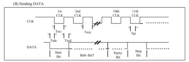

Communication here is bidirectional. Normally it is the mouse that sends data to the computer.
The clock and data are pulled up to 5V through resistors.
The data sent to the PC is read during the falling edge of the clock.
One byte is sent between the start bit (0), the parity bit (1 if the number of ones is even), and the stop bit (1).
Diagram of data transmission in a PS/2 mouse with clock and data signals. .

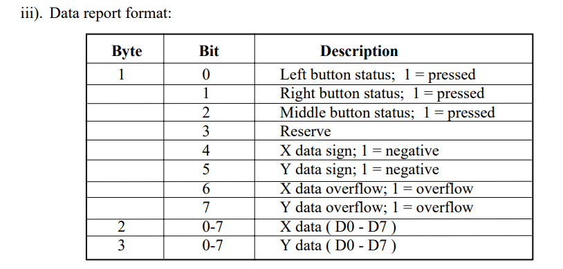

The format of the frame reported by such a mouse is really very simple. The individual bits correspond to the keys, we also have bits encoding the characters and the X and Y overflow, and separately we have the 8-bit values of these X and Y.
Data report format for a mouse, divided into bytes and bits. .
Now just a question, how can we here still add sending data to the mouse from the computer? Or to the keyboard, e.g. sending Caps Lock?
If the host wants to send data, it just has to signal it - set a low state on the clock line for at least 100 microseconds, then the data line too. Then the clock is released and the mouse controls it again, then the data transfer takes place. The data sent by the PC to the mouse is read on the rising edge of the clock:
PS/2 mouse communication diagram. .
