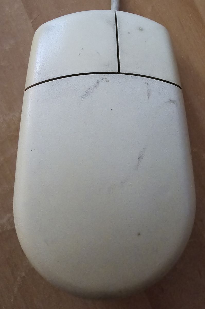

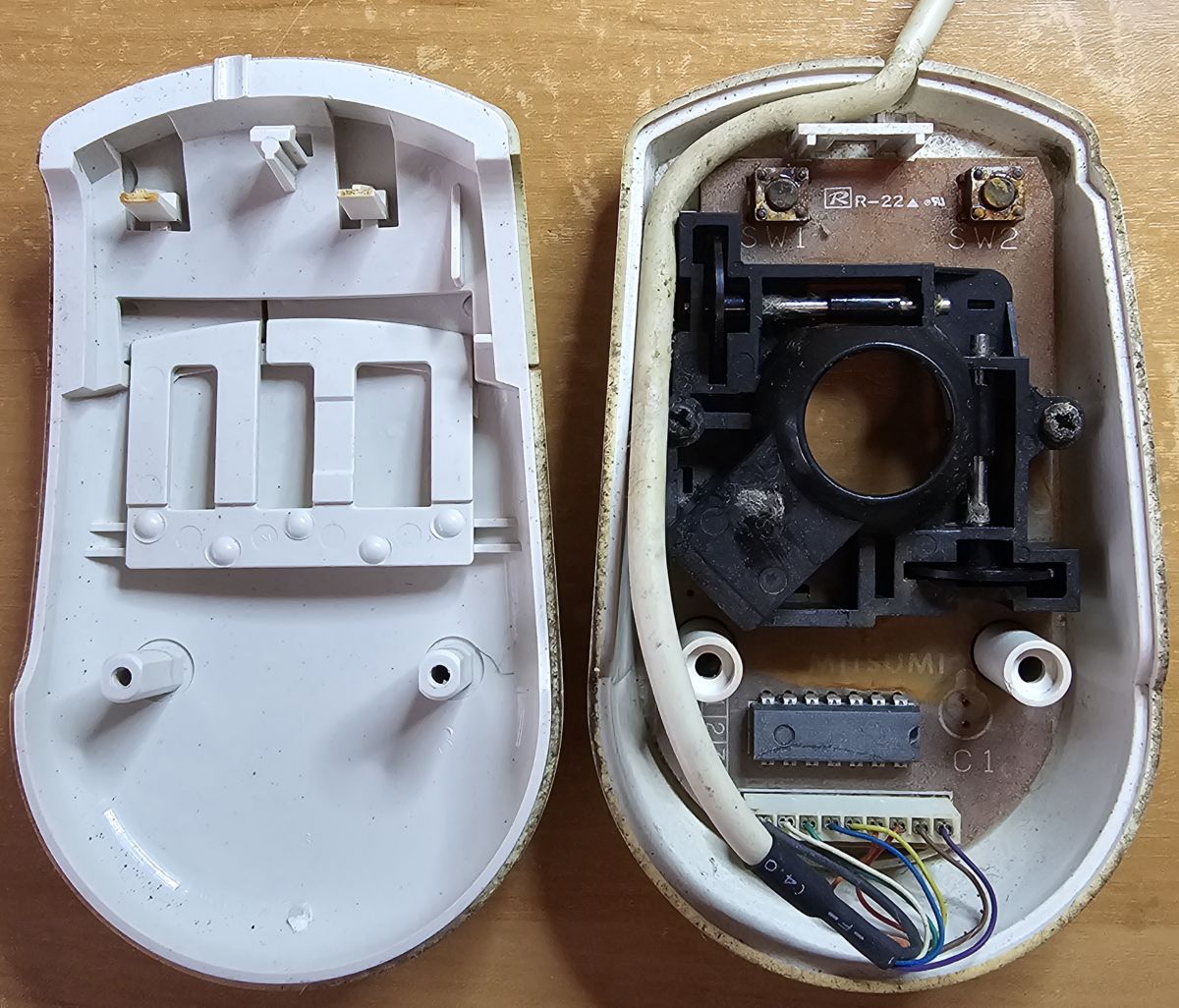

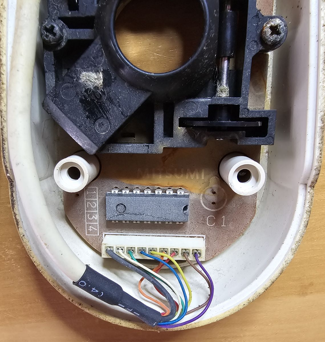

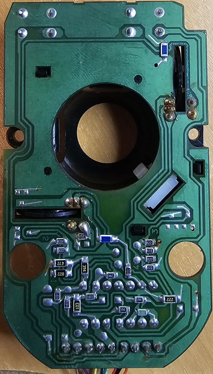

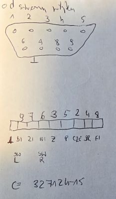

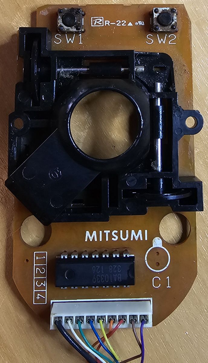

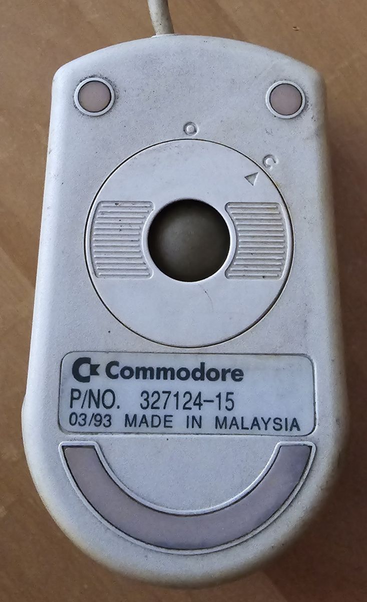

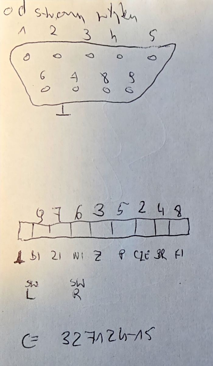

  • Amiga DB9 mouse before restoration and repair
    #6 21221641
    LA72
    Posts: 6596
    Help: 648
    Rate: 1657
    And here's something similar.
    A mouse from an Amiga under DB9.
    This is how it came to me.
    Here pics before restoration and repair.
    Old computer mouse for Amiga before refurbishment. Old Commodore computer mouse from 1993, viewed from the bottom. Interior of a disassembled computer mouse from an Amiga, with visible electronics and wires. Interior of an Amiga computer mouse with cables and a wiring diagram. Electronic circuit of a Mitsumi mouse for Amiga, before restoration. Printed circuit board from Amiga mouse before refurbishment.
    With wiring diagram on the wire.
    Drawing of a DB9 connector wiring diagram for an Amiga mouse. .
