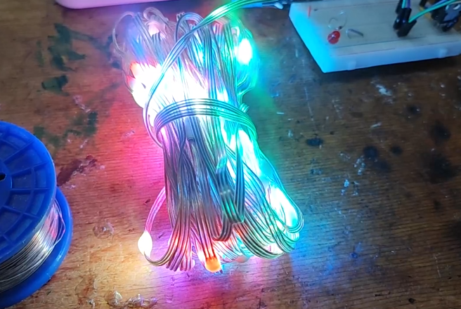

As the product is quite unusual, I decided to test it both with the manufacturer's application and separately with OpenBeken (after changing the firmware)
Test with Tuya application .
We pair according to the instructions. In my case, the app immediately sensed the new device:

Example animation:

A very interesting product. Works pretty well both with the manufacturer's app and after a software change. The control offered over the LEDs is really large and also the choice of animations is wide. The animations can also be played to the rhythm of music, which is also configurable and available in many modes, which I would not be able to show all of here, because who would want to watch a dozen videos? And with the inclusion of sound sensitivity changes there would be even more....
The most important thing for me was to change the firmware and this was also done - along with the remote control operation. The final configuration is up to you, you can customise everything.
