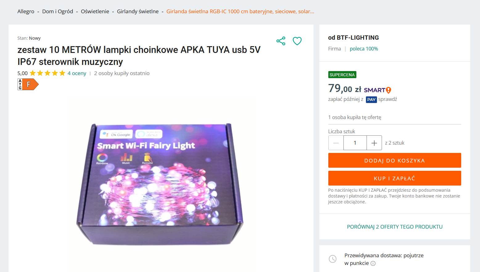

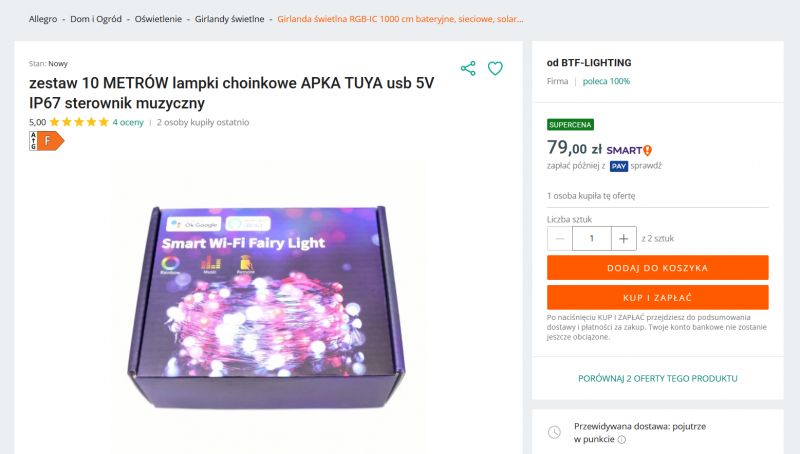

  • A ready-made 10-metre WS2812 Christmas tree light set with controller, remote control, and music-reactive effects was tested and later reflashed for OpenBeken/Home Assistant use.
  • Tuya pairing worked immediately, exposing per-LED colour control, LED-count adjustment, dynamic animations, music modes, schedules, and countdowns.
  • The kit is listed at PLN80 and includes 100 LEDs plus a CR2025 battery for the remote.

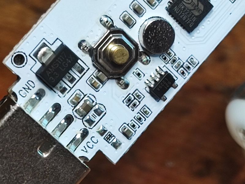

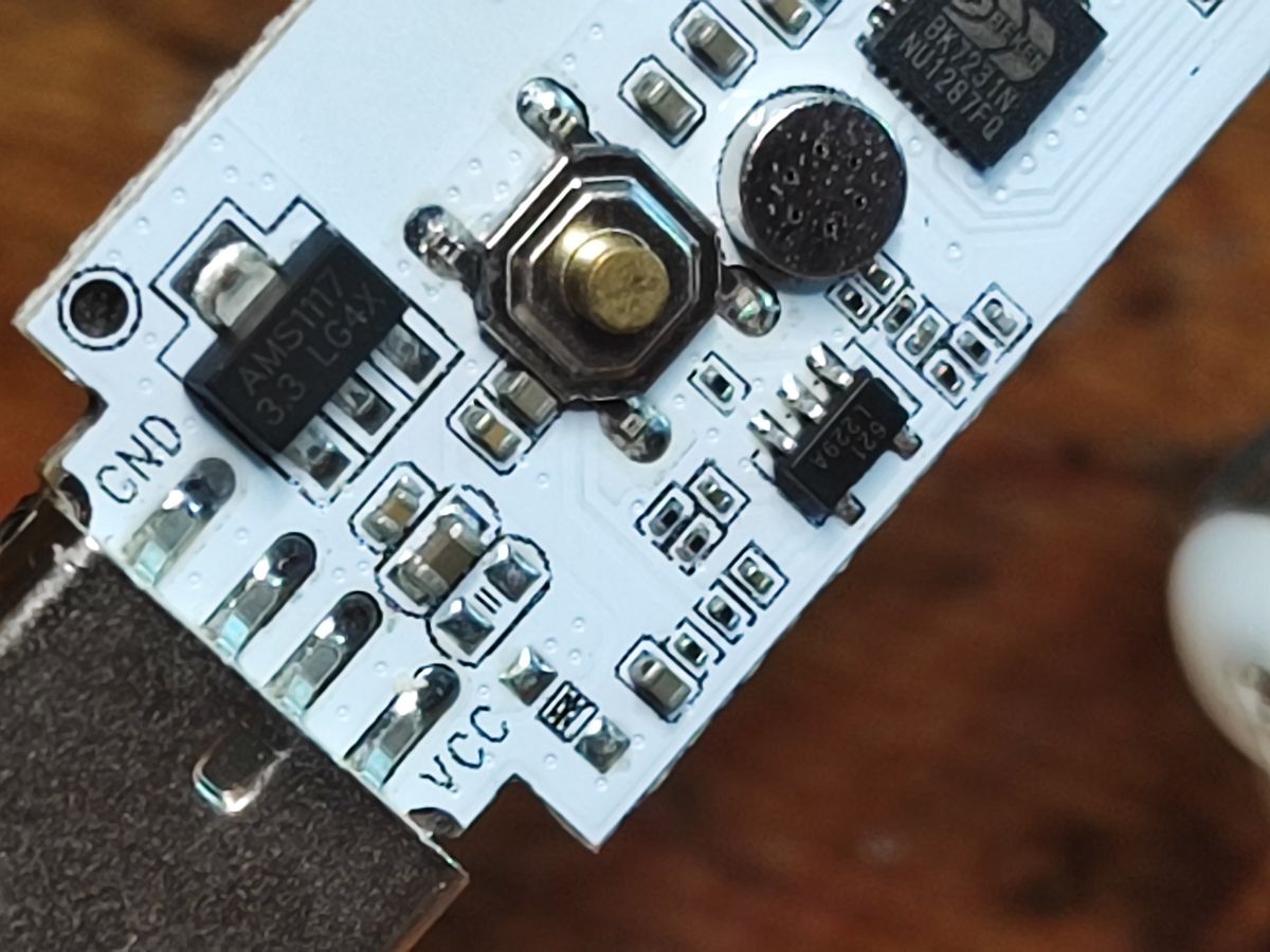

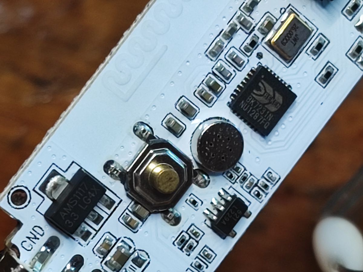

  • Opening the snap-on case revealed a BK7231N, IR receiver, microphone, pairing button, and 3.3V LDO; flashing needed 3.3V, GND, RX, and TX.

    Smart Wi-Fi Fairy Light Christmas light set with Tuya app. .

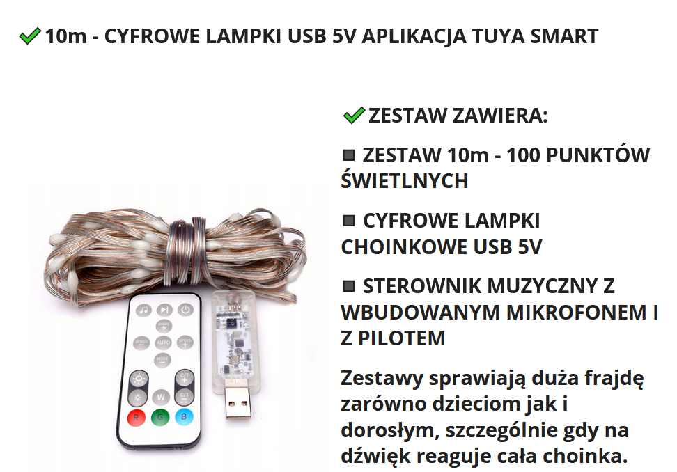

    To quote the description. 100 LEDs and even a remote control is included.

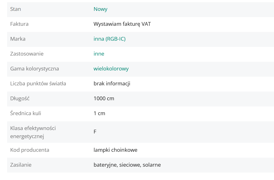

    LED WS2812 Christmas light set with controller and remote. .

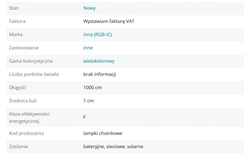

    CR2025 battery for the remote control also included. I wonder if this longevity is true?

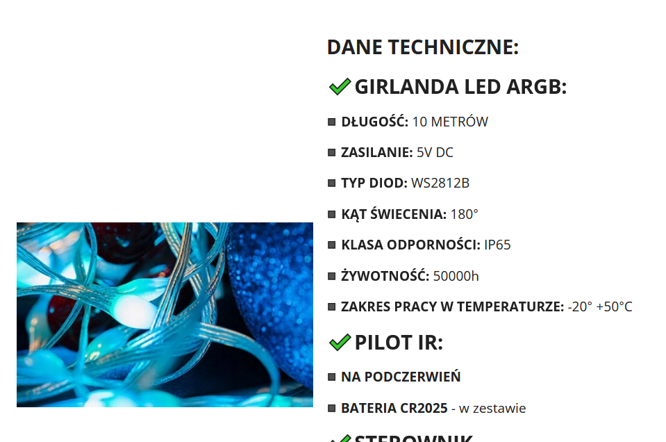

    Close-up of technical details for WS2812B LED garland with an image of the lights. .
    Specifications:
    Technical specification table for WS2812 LED Christmas lights. .
    But where did the solar power come from? That's some mistake.

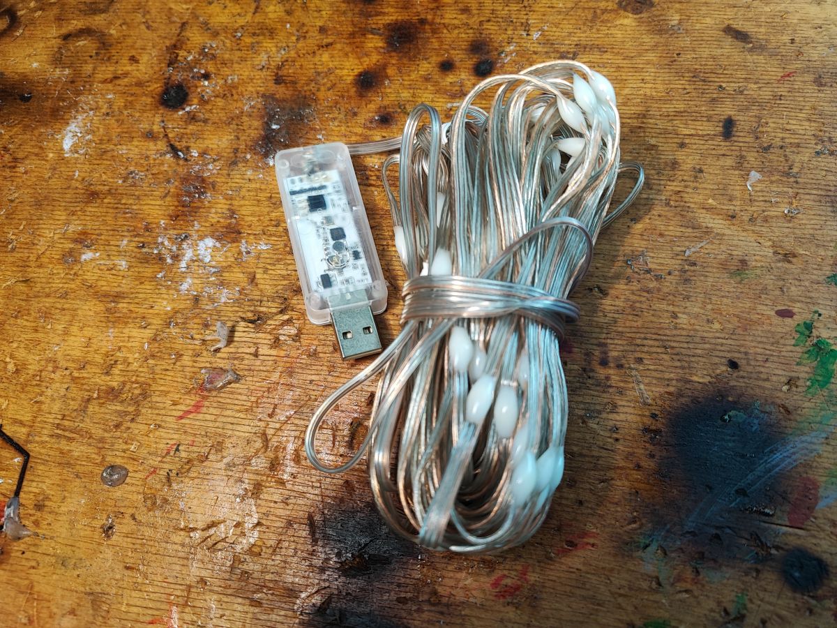

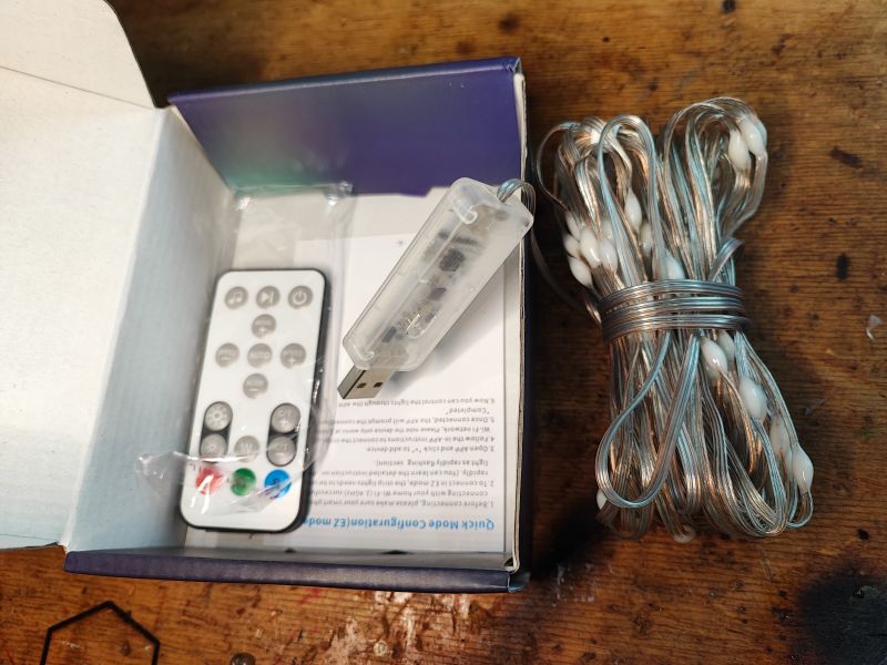

    Kit contents. The power supply is not there:
    WS2812 LED set with remote control and USB controller. WS2812 LED strip and controller on a workbench .

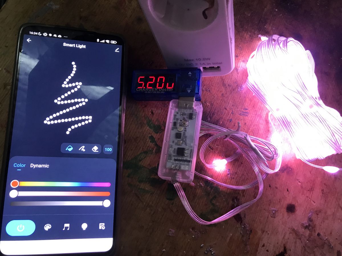

    As the product is quite unusual, I decided to test it both with the manufacturer's application and separately with OpenBeken (after changing the firmware)
    Test with Tuya application .

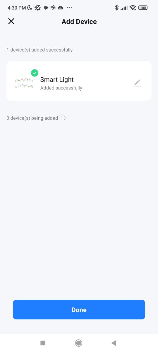

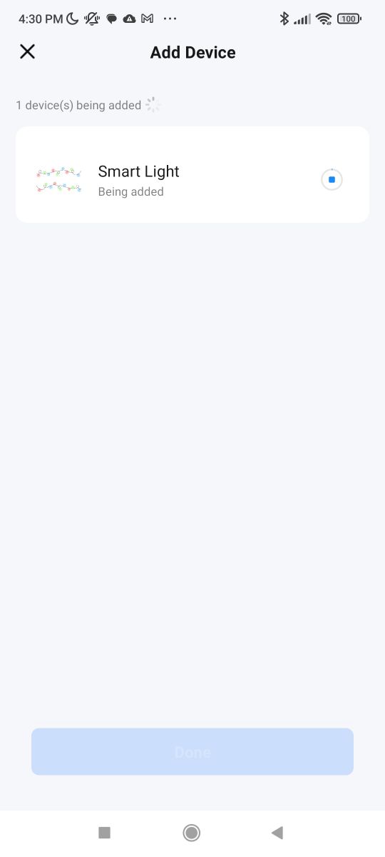

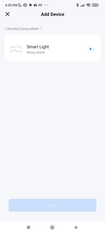

    We pair according to the instructions. In my case, the app immediately sensed the new device:
    App screen for adding new devices, showing the option to add Smart Light. .
    After entering the WiFi name and password, everything went smoothly:
    Process of adding a smart lighting device to an app. Smartphone app with added Smart Light device. .

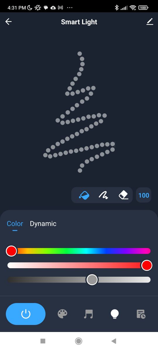

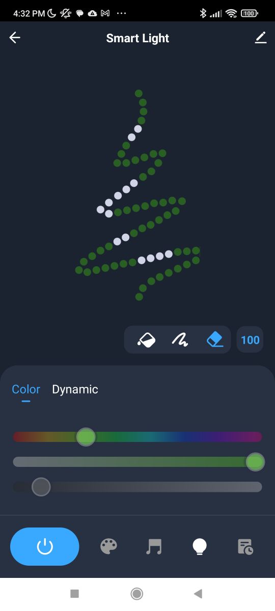

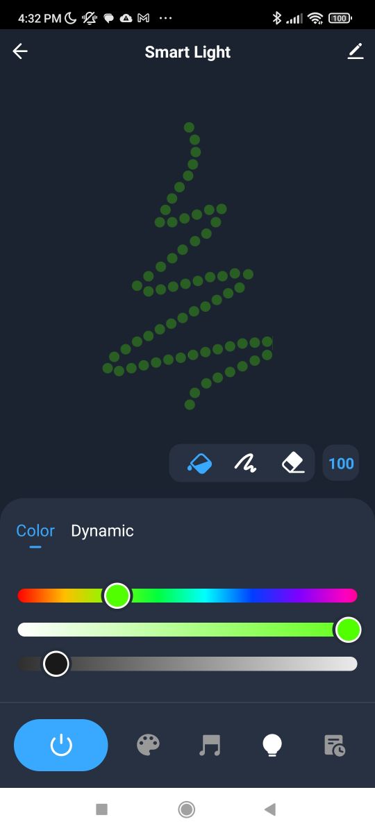

    In the app, we are greeted by a panel like this:
    App screen controlling LED lights in the shape of a Christmas tree. .
    One colour can be set globally, but there is more...
    App screen for controlling WS2812 LED lights with a red tree graphic. View of the smart LED lighting control app interface. .
    You can also manually set the colour of the selected LEDs:
    App screen for controlling WS2812 LEDs in a Christmas tree shape .

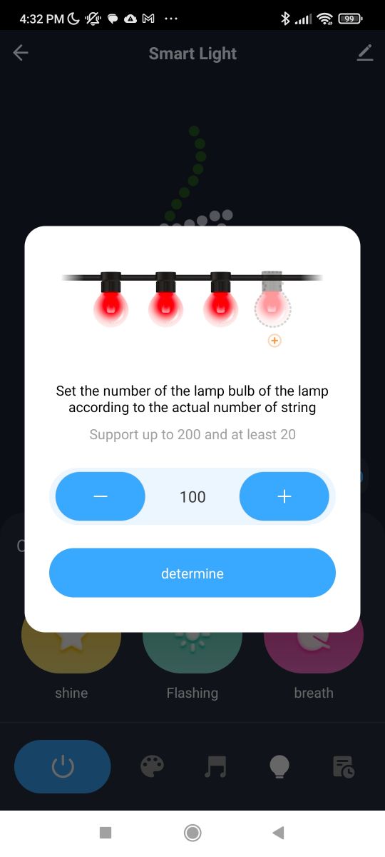

    You can also set the number of LEDs in the strip, i.e. artificially lengthen or shorten the strip. Not bad!
    App interface controlling LED lights. .

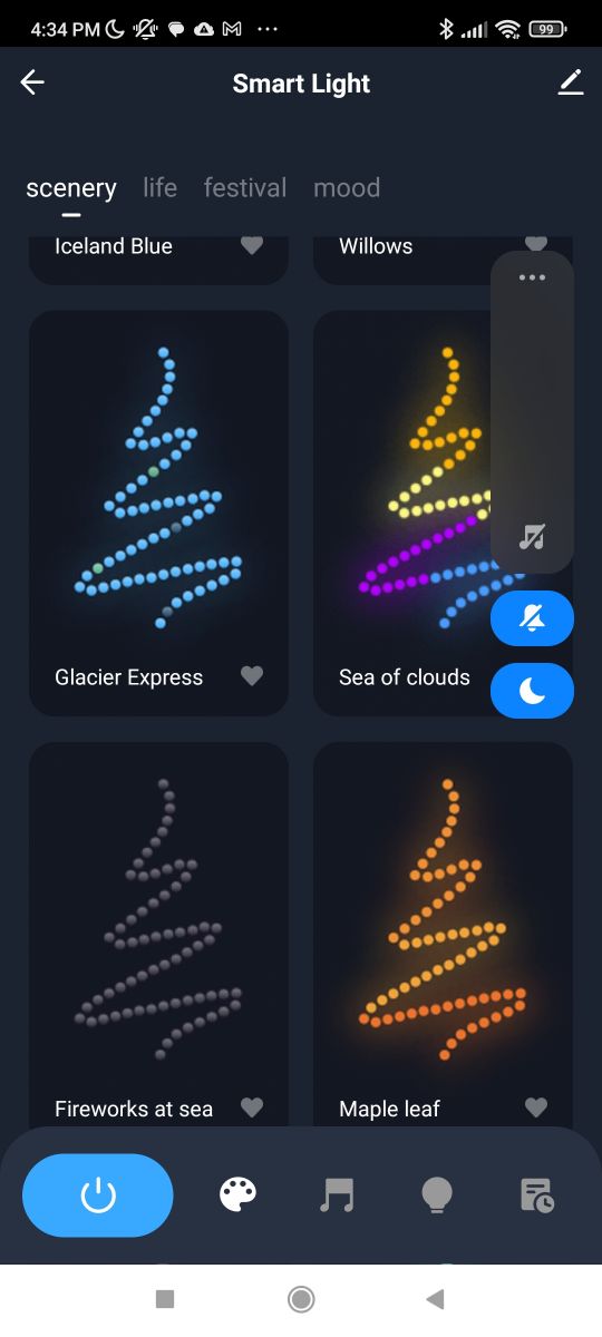

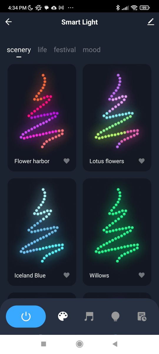

    The 'Dynamic' tab, on the other hand, has animations:
    App interface for controlling holiday decorations with LED animation settings displayed on screen. Smart Light app menu displaying LED tree-shaped light patterns. Smart Light app interface with different lighting modes. LED light control panel in an app. Three colors: green, blue, and orange in a Christmas tree shape. .
    The choice is wide.

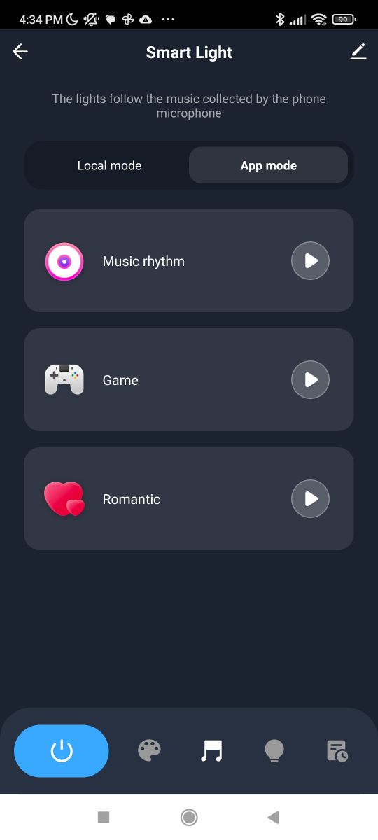

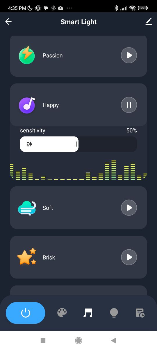

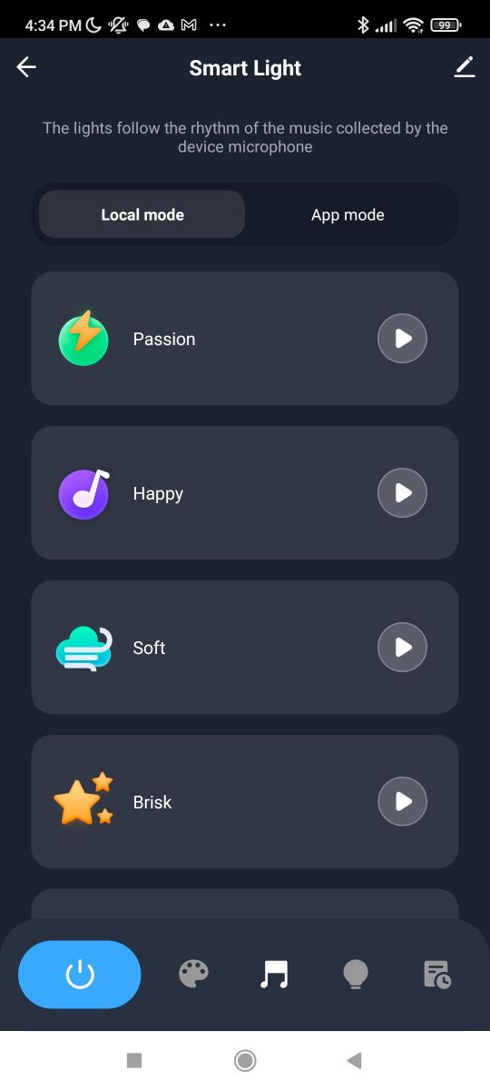

    Here we also have a third control option - according to the rhythm of the music. Here, too, there are many modes to choose from, I haven't even tested them all. Certainly, the device can take music both from the microphone and from the phone (as a BT speaker, without playing it, of course):
    Smart Light app screen with music rhythm, game, and romantic modes. Smart Light app screen with lighting modes. .

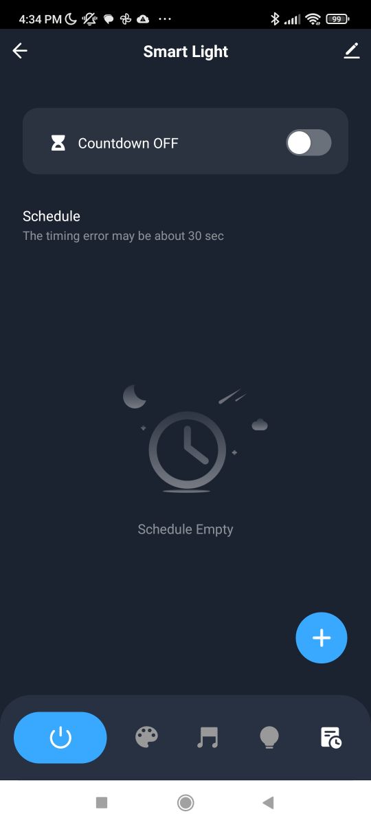

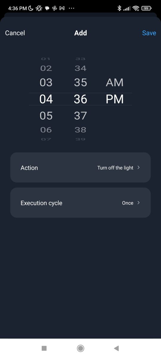

    A schedule and countdown are also available:
    Screenshot of Smart Light app showing schedule settings. App screen displaying schedule settings for turning off a light. .

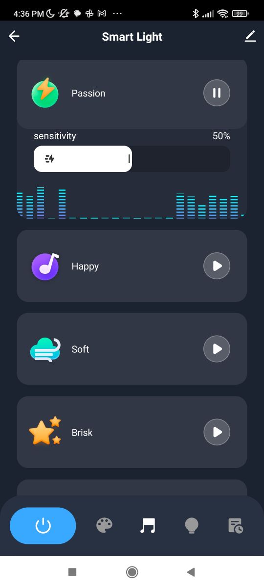

    Music modes also allow you to set their sensitivity:
    Control panel of the app for smart LED lights App screen for controlling WS2812 lights with lighting modes. .

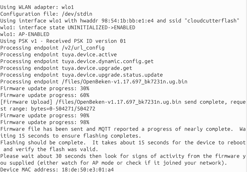

    The product can also be freed from the cloud and connected to Home Assistant. OpenBeken is uploaded:
    Upload tool and instructions for flashing via UART:

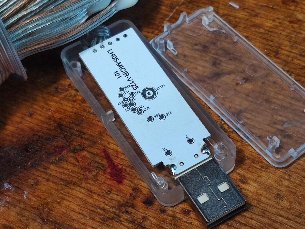

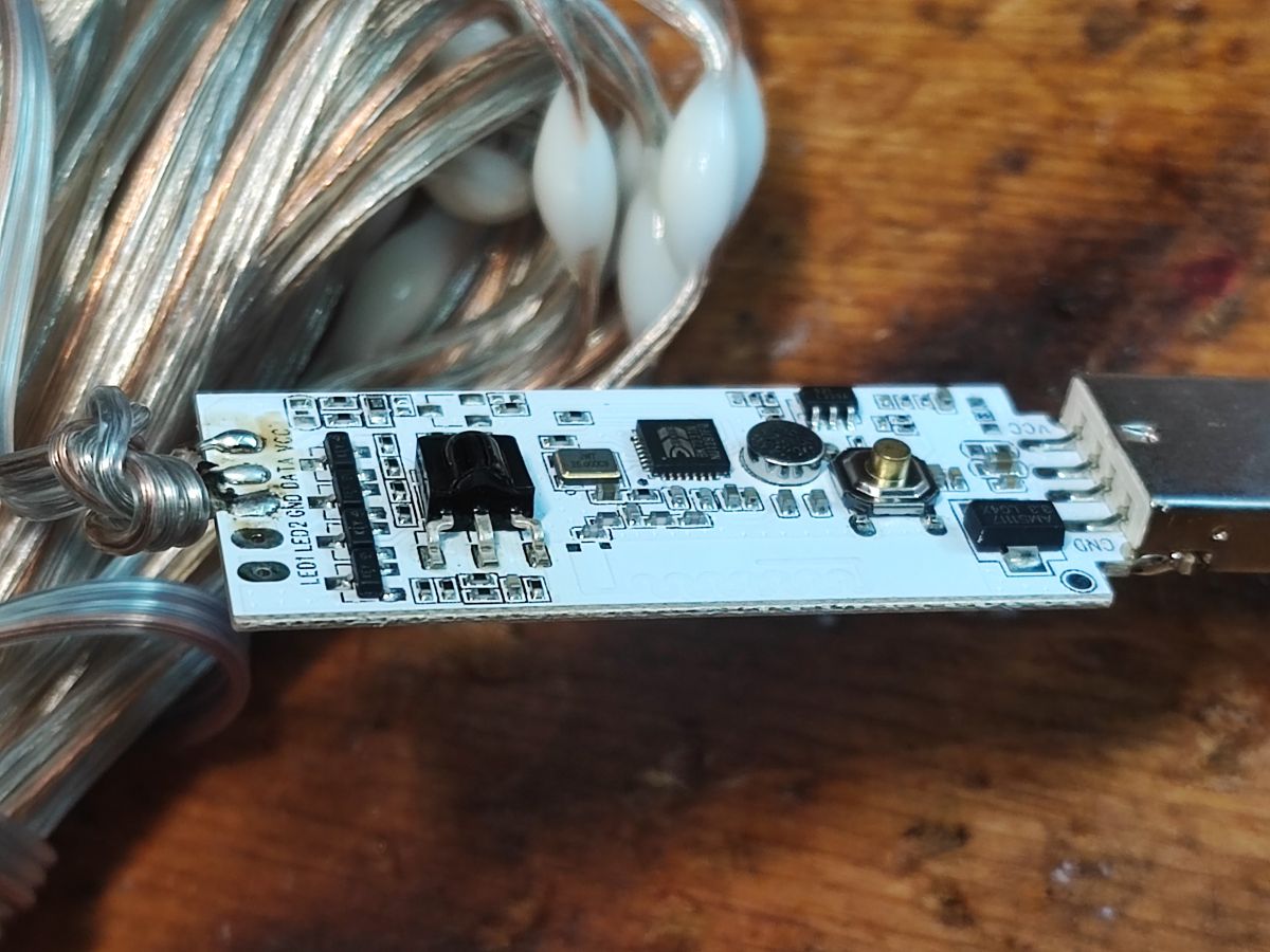

    To do this, we open the case - it's snap-on:

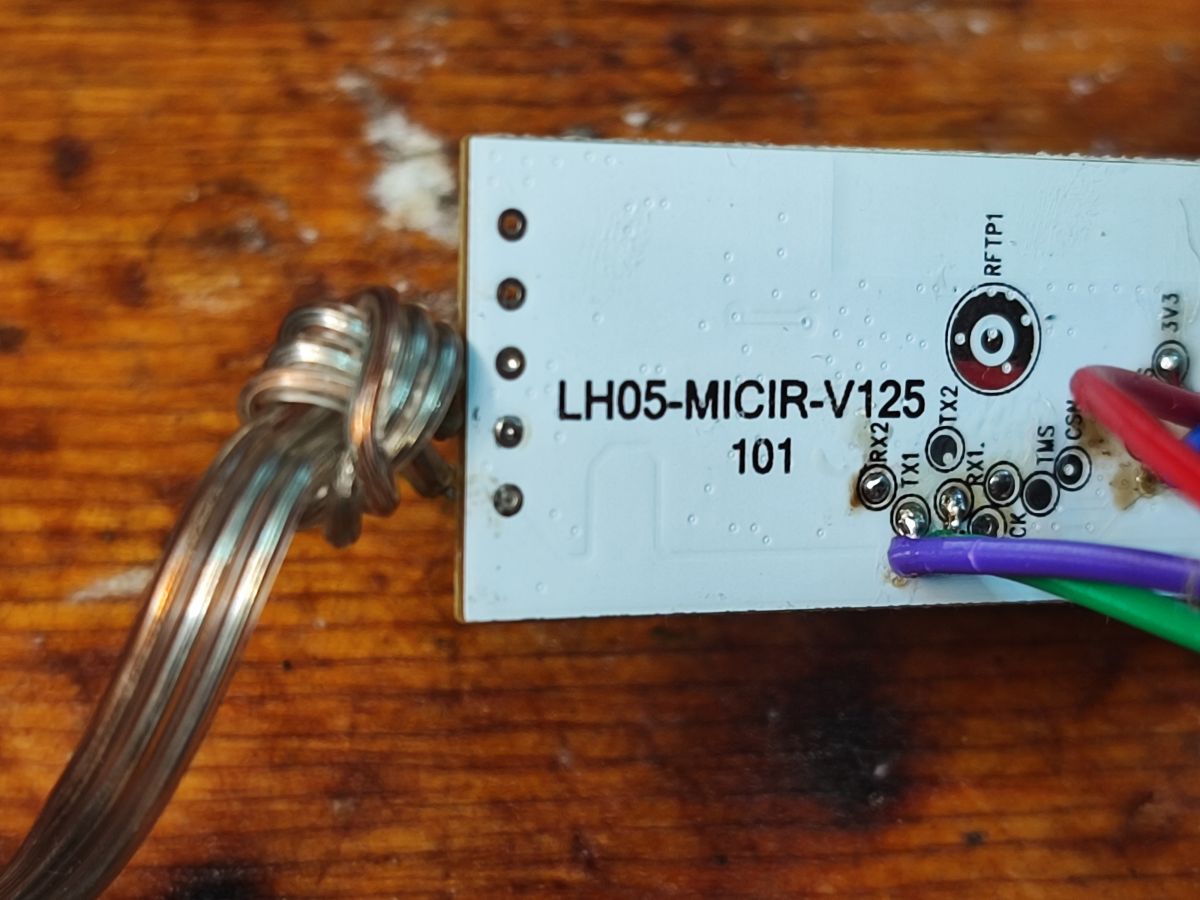

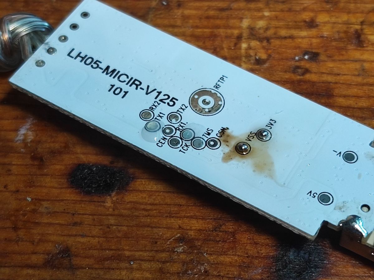

    LH05-MICIR-V125 PCB module on a wooden surface .
    PCB designation: LH05-MICIR-V125

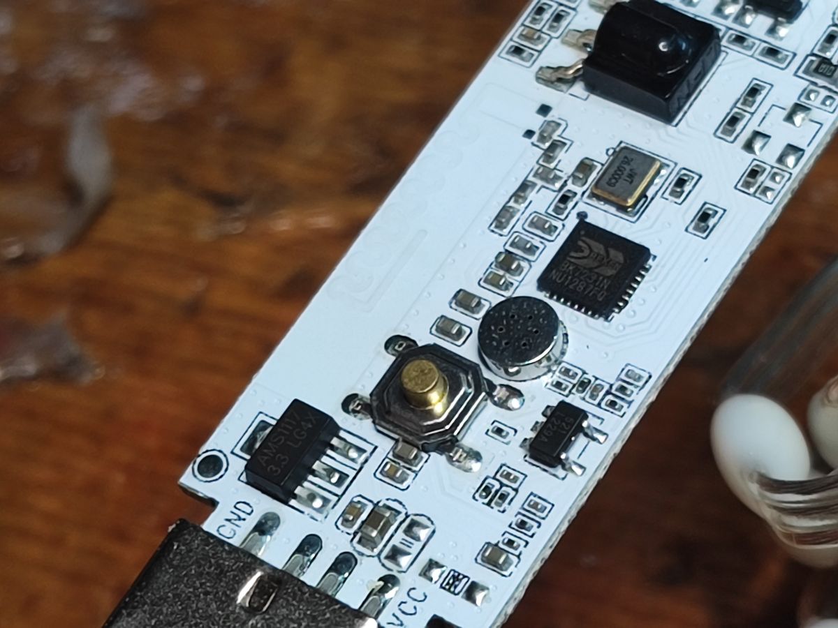

    By the way we can see the electronics inside, here we have the IR receiver, the button (from pairing) and the microphone and the 3.3V LDO regulator powering the BK7231N.
    WS2812 LED controller with wires Close-up of an electronic circuit board with components. Close-up of a PCB with electronic components and labeled pads. Close-up of a PCB with electronic components. Close-up of a circuit board with electronic components. Close-up of a printed circuit board with electronic components. .

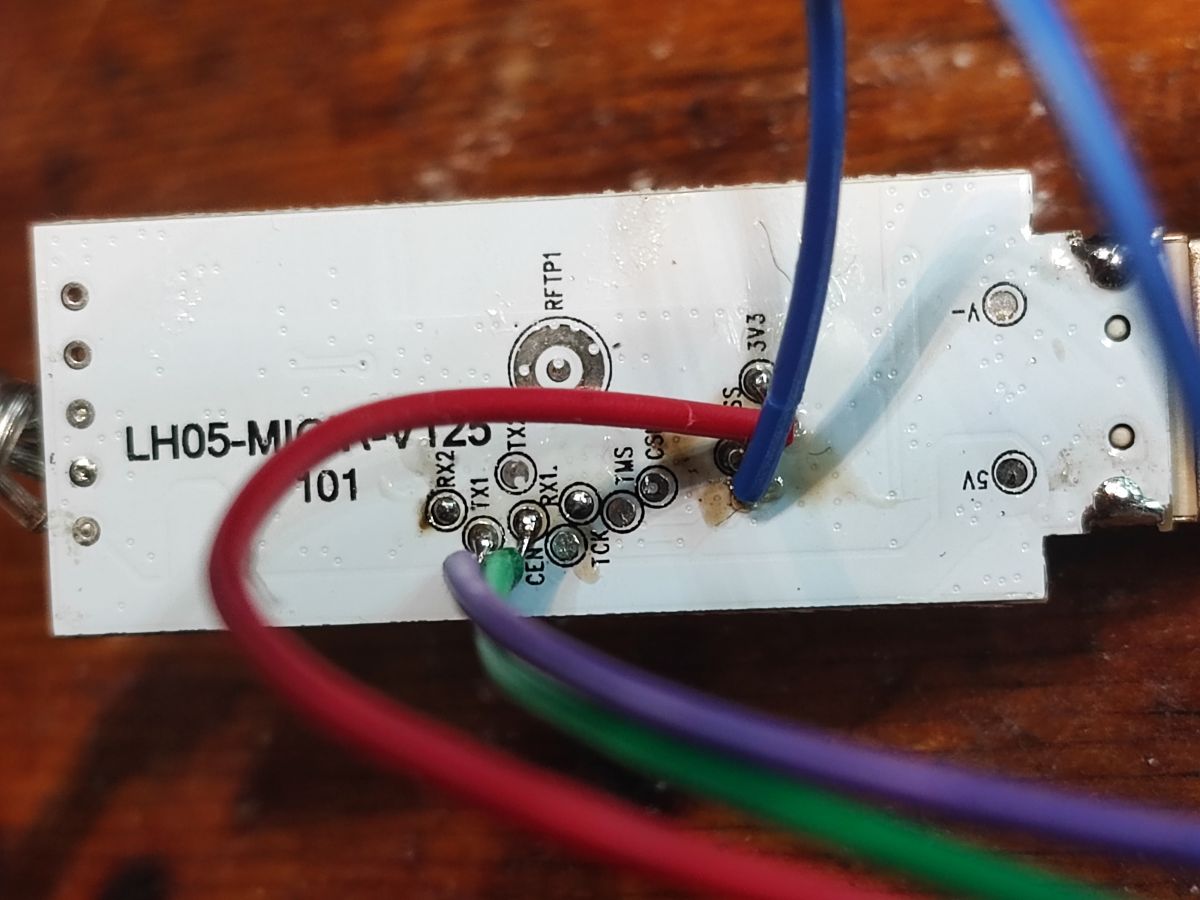

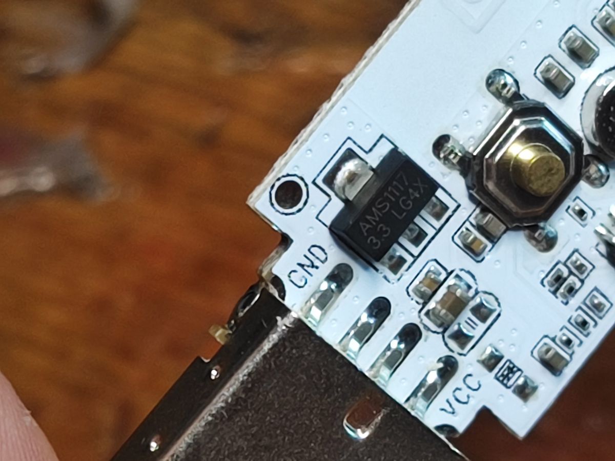

    You will need 4 cables for programming - 3.3V, GND, RX and TX. The pads are signed:
    Close-up of a PCB labeled LH05-MICIR-V125 with visible pads and labels. .

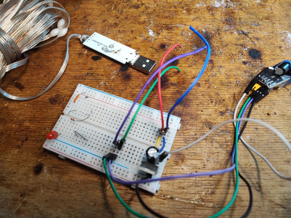

    Here is my whole layout for programming, I have my own 3.3V LDO on the contact board, although for this particular device you could just as well use the LDO that is on the board there. It's just that sometimes I program separate modules such as the CB2S or WB2S and in their case there is no LDO already on the PCB so I have to have my own.
    WS2812 LED strip programming set with breadboard and wires .
    Soldered wires - you can see exactly which pad is which:
    Image of a PCB labeled LH05-MICIR-V125 with soldered wires. View of a PCB with soldered wires.

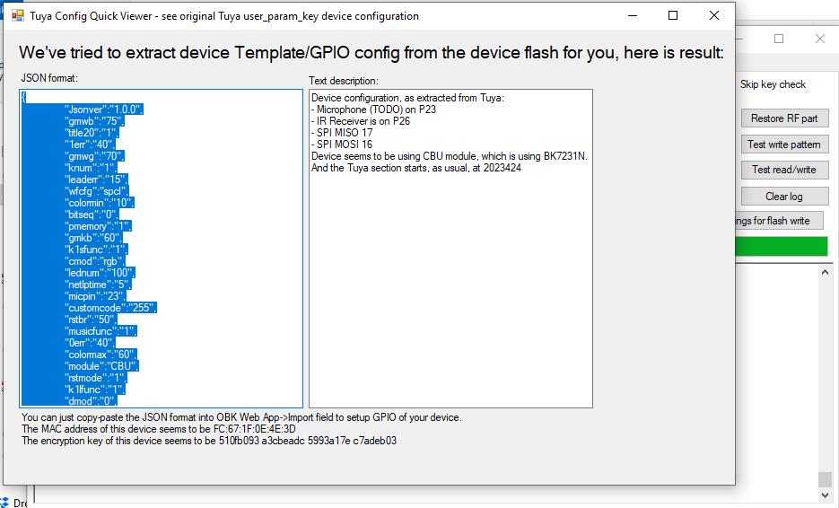

    BK7231 Easy GUI Flasher correctly detects GPIO roles:

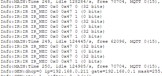

    Once the IR controller is running and the IRRecv pin is set, codes can also be captured from the remote control:
    Screenshot of system logs with information on time, idle state, and IR transmission. .

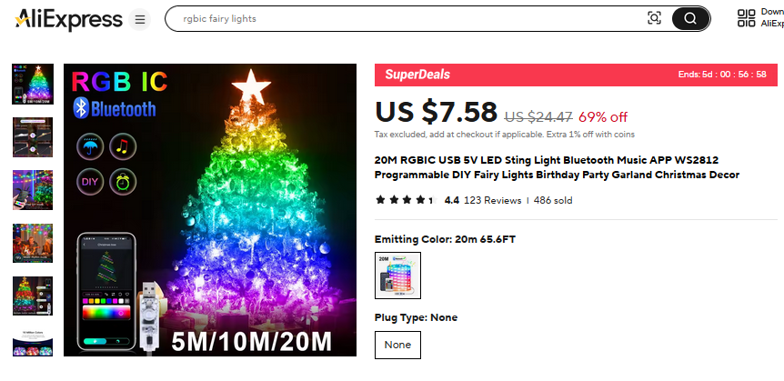

  • Suggesting 2D LED mapping for animations

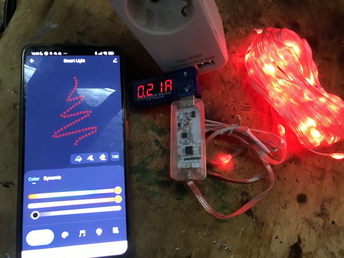

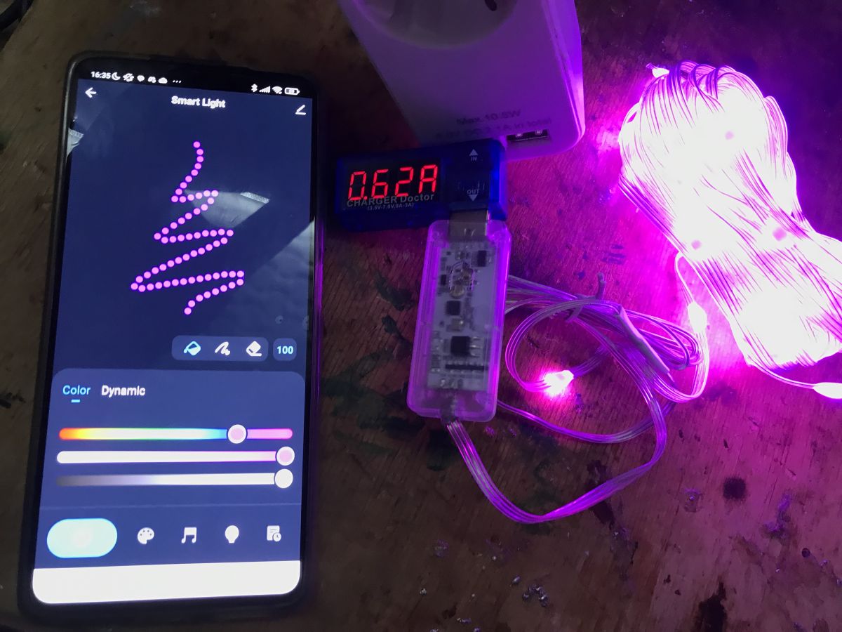

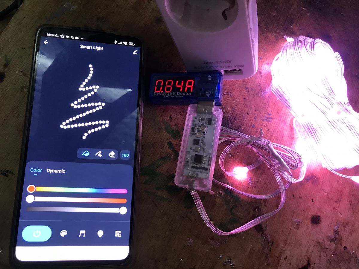

    @p.kaczmarek2 Missing information on how much power these 100xWS2812 draws from USB at full brightness, as probably quite a lot....

    Posts: 14770
    Rate: 12912
    Good point @ArturAVS , I have now measured it and it comes out that it does not exceed 1A though:
    Smartphone and connected LEDs with a current meter showing 0.59A. Controlling LED lighting using a smartphone Smartphone with LED light control app, meter displaying 0.84A, and lit LED string lights. Smartphone displaying a Smart Light app next to glowing LED lights and a current measurement device. Smartphone with an app for controlling LED lights and a connected meter showing 0.62 A current. Smartphone with a light control app next to a set of red LED lights. Smartphone with an app controlling LED lights, display showing power consumption of 0.21A. Smartphone with an app controlling LED lights, display showing power consumption of 0.21A.

    Has anyone tried connecting 2x10m to one controller and setting more than 100 lights in the application ? (yes I know you can buy 200 lights from the manufacturer but they are more expensive than 2x10m)
    What is in the Tuya app is enough for me, I have more of these 10m ones and I don't know if it makes sense to connect them together....
  • #15 21380500

    I haven't tested it myself, but since the app allows you to set there number of lights up to 200, it should rather work? Just make sure you have the right power supply.

    I cut off the last diode of the first 100 because there wasn't enough wire at the end and soldered the next 100 on, definitely a good thing because with the "100" setting in the app 99 of the first chain and the first of the second chain work. Unfortunately when I click a larger number than 100 in the Tuya app it reverts to the previously set number of diodes that were working, so I suspect there is a hard max set in the code and the app has the same look no matter if you connect to the original 100 or 200 lights. Maybe someone has access to the 200 and is able to rip the software that is there as long as the same microcontroller is there too?

    But the drama, that is, this option of theirs that supposedly can be set to 200, is just "for show" and doesn't work? The one I showed in the first post? Sorry, if I had known, I would have warned you, but I didn't even think it was that poor with this Tuya software.

    1. i doubt tuya is to blame here, rather the manufacturer of the lights and the code in the microcontroller, i searched to see if they made the 200 LEDs themselves, according to the post on allegro what this thread is about was made by some "nexoo" (i have the same board as you with the controller the same) but i didn't find it, with offers of similar lights compatible with tuya which are 20m long and 200 LEDs rather some other manufacturers and i can't see from the pictures the same board with the controller but it is hard to say without having in hand what is sitting there....
    2. cool, but you also have the same soft as me certainly made for 100 LED so it won't do anything :) .
    3. we'll see maybe I'll find somewhere else or hear from someone who bought a 200 LED from another manufacturer then the flasher will come in handy
