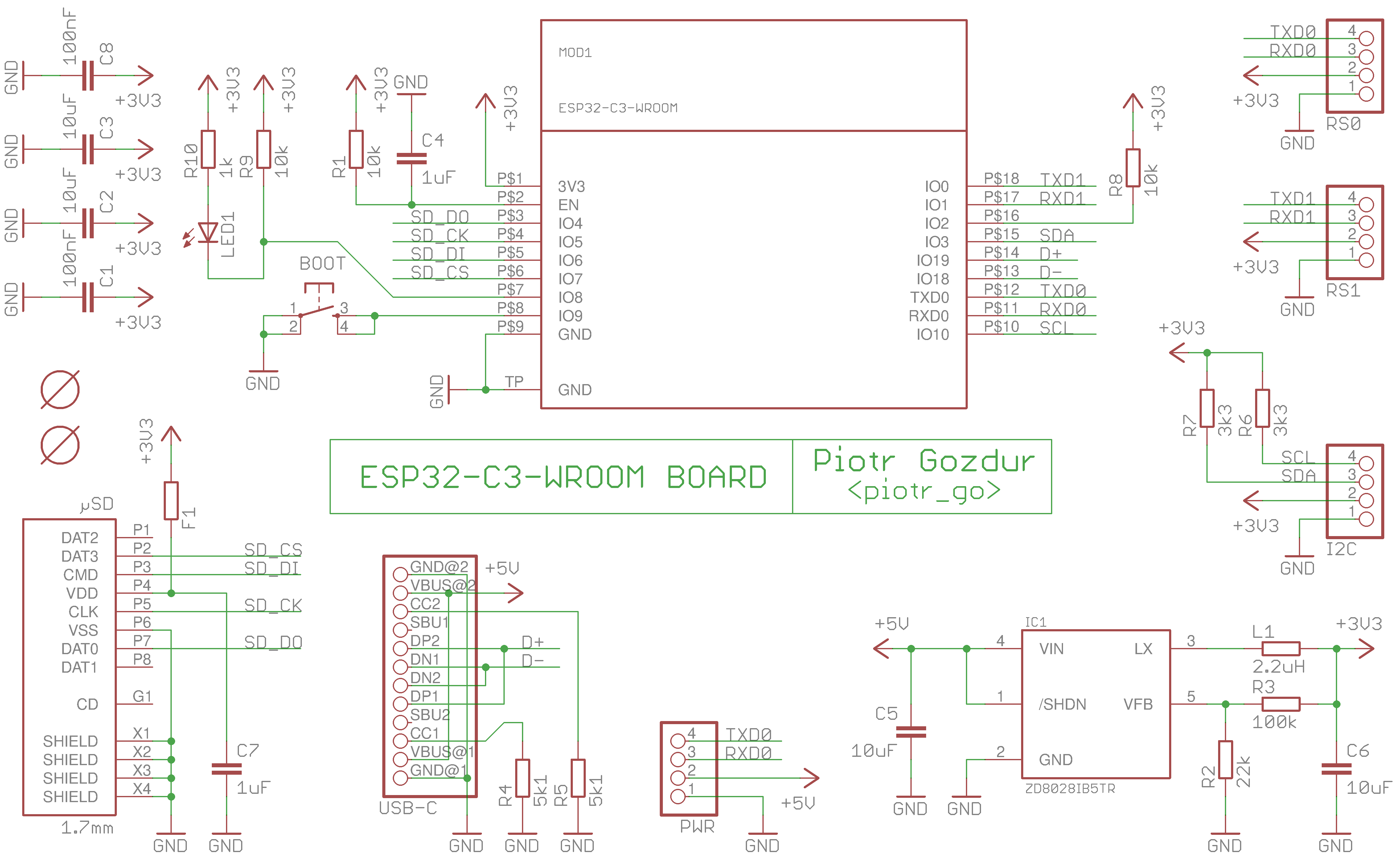

Scheme: .
ESP32-C3-WROOM board schematic for a 3D print server. .
The printer is connected to RXD0/TXD0 (note, 3.3V logic).
Baud rate 115200.

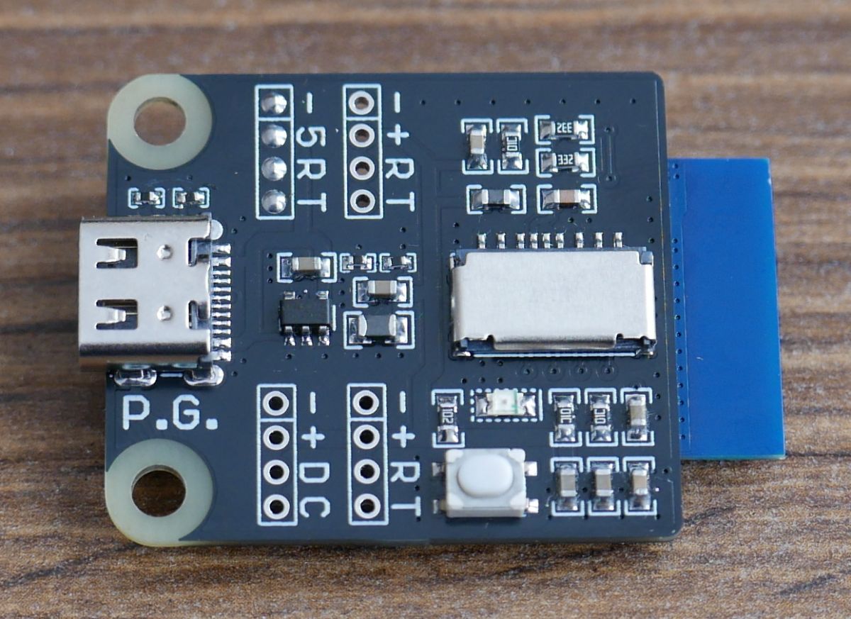

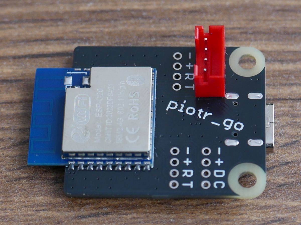

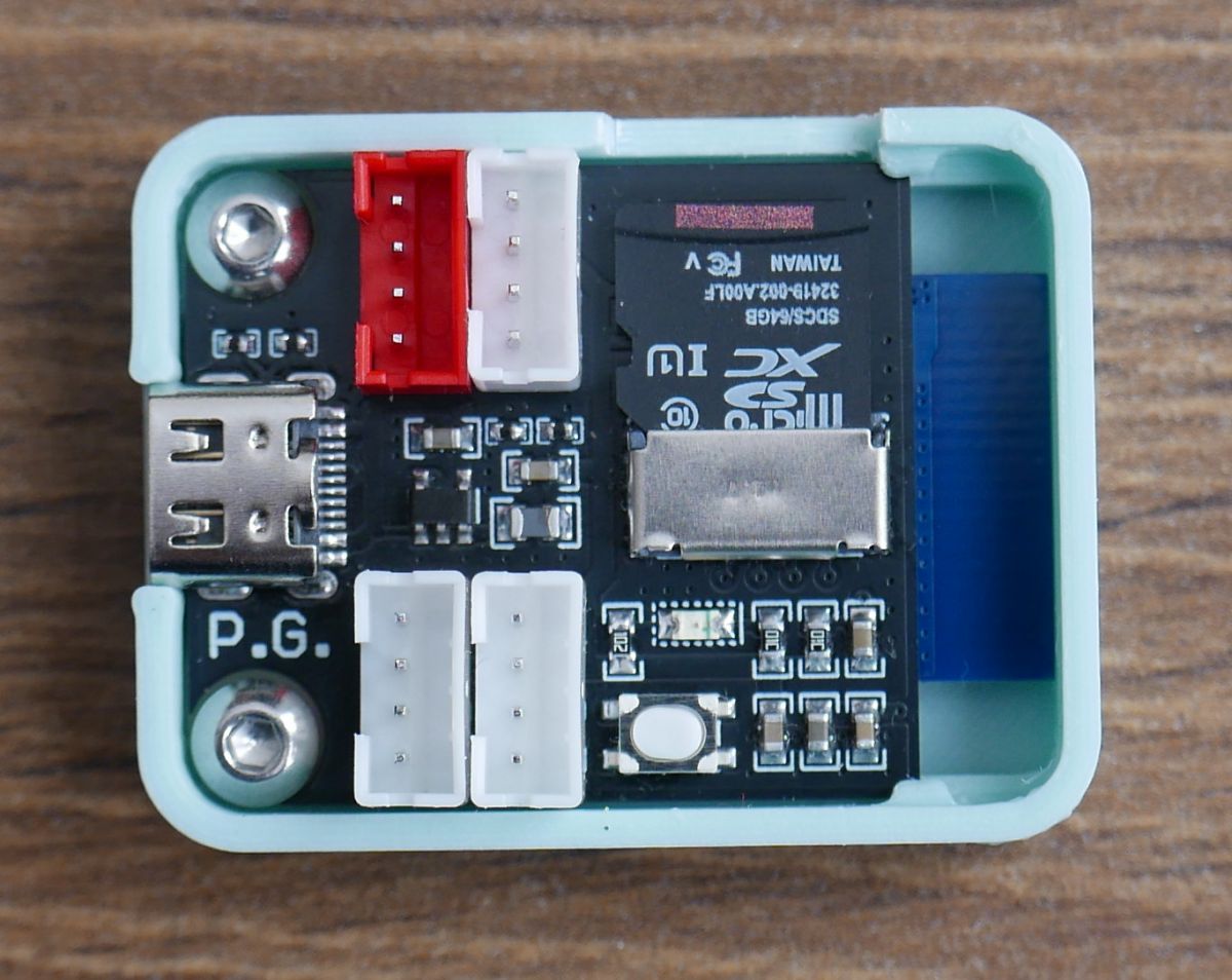

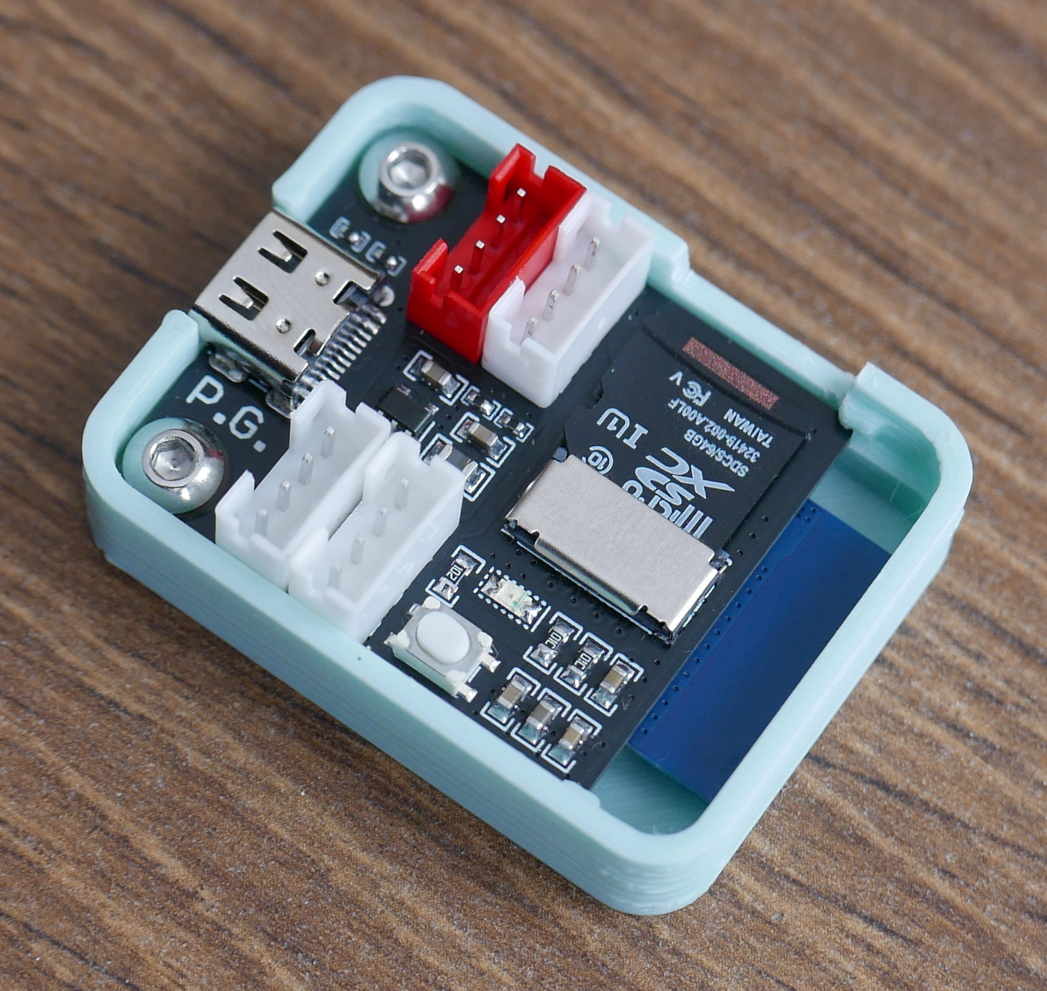

PCB: .
Electronic module with various connectors and an SD card slot. Electronic module on a wooden background, with a USB-C port and SMT components. ESP32-C3 module mounted on a PCB. .

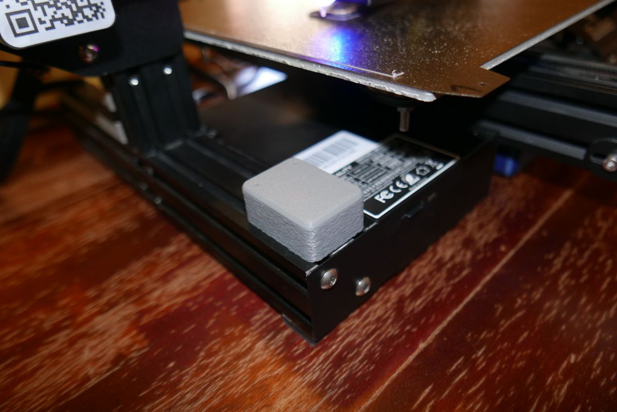

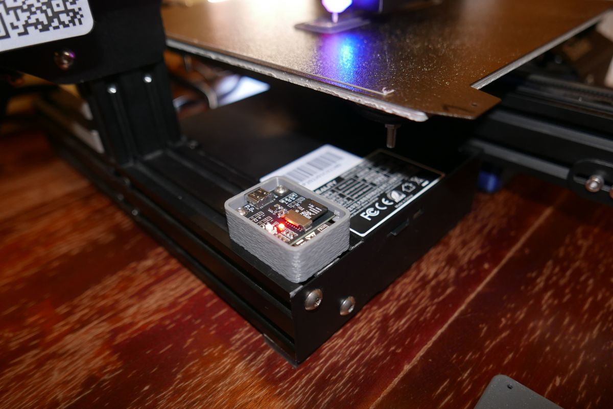

Print server installed in the Ender 3 Pro printer:
ESP32-C3 module connected to Ender 3 Pro printer with a red LED indicator. Adapter on Ender 3 Pro printer. .

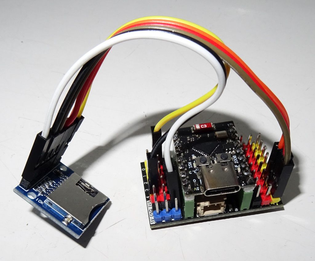

The circuit can be assembled on cheap modules from Ali.......:
ESP32-C3 module connected to a microSD card adapter using cables. .
Put the file "wifi.txt" with the network name and password (2 lines) on the card.
When the printer is switched on, the display will show the IP address that the printer has received.

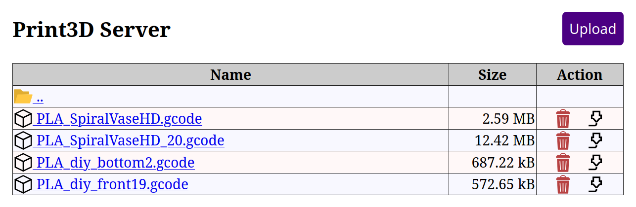

Fire up the browser, type in the address and you can upload files:
Print3D server page showing a list of 3D printing files .
The upload speed is approximately 300...600kB/s.

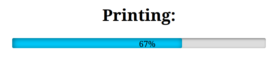

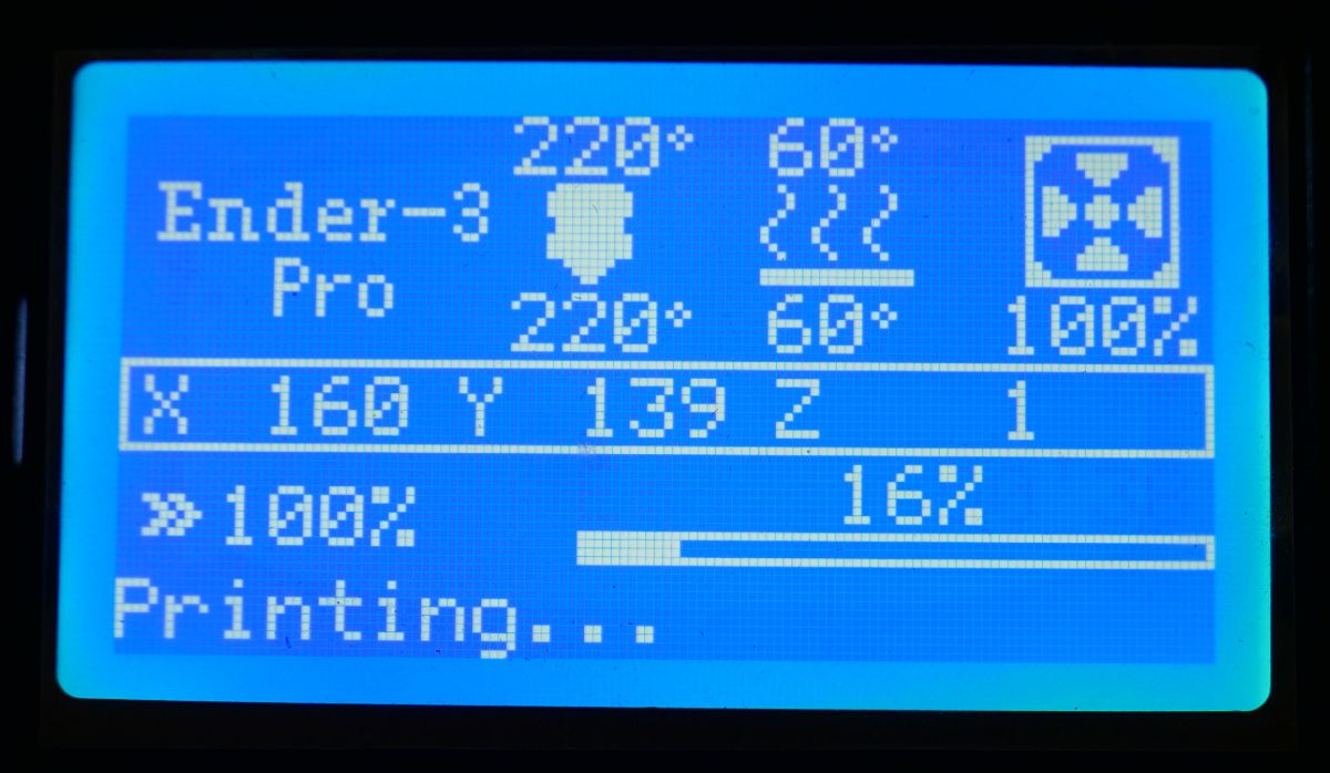

When printing, both the web interface and the LCD display show progress:
Printing progress bar showing 67%. .
Ender 3 Pro printer screen during printing, showing 16% progress. .

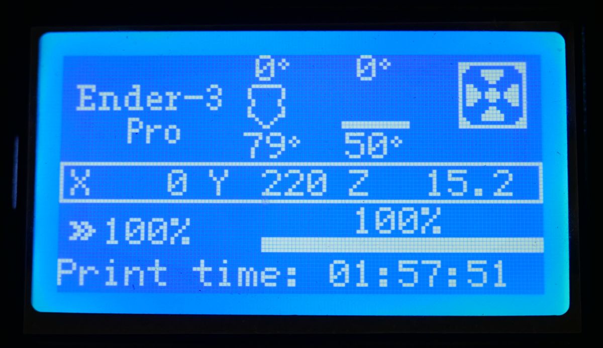

When the printout is complete, we can see the printing time on the display:
Ender-3 Pro printer display showing parameters and print time. .

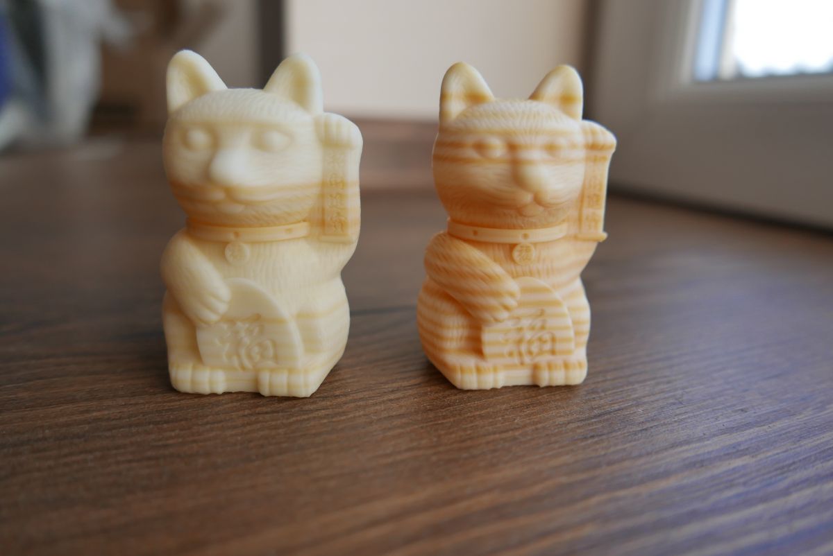

Printing time for an example 32MB file:
- from printer card 6h25m +-1m
- from ESP32-C3 card 6h25m +-1m
Two 3D printed cat figurines on a wooden surface. .

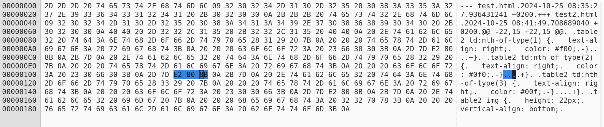

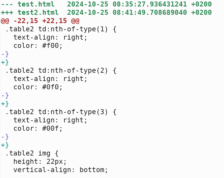

Comparison of HTML code differences between two file versions. .
"diff" from the image shows the difference between not working and working code.
The text editor I'm using doesn't display anything but brackets and plus/minus there.
There is no invisible character.
Only a peek in the hex-editor reveals the extra bytes after the brackets.
Differences in code in a hex editor using diff example. .
I came across such wonders while writing the software.
