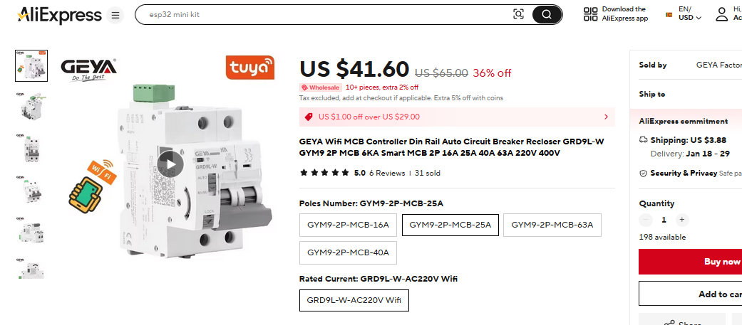

Wanted to incorporate the following device into my MQTT Network:
https://vi.aliexpress.com/item/1005006309773987.html
View of GEYA Wifi MCB Controller Din Rail Auto Circuit Breaker on AliExpress.
Actually I wanted to detach the device and use with a RCB. Detaching was simple as there were two retaining latches at the top and the bottom.
