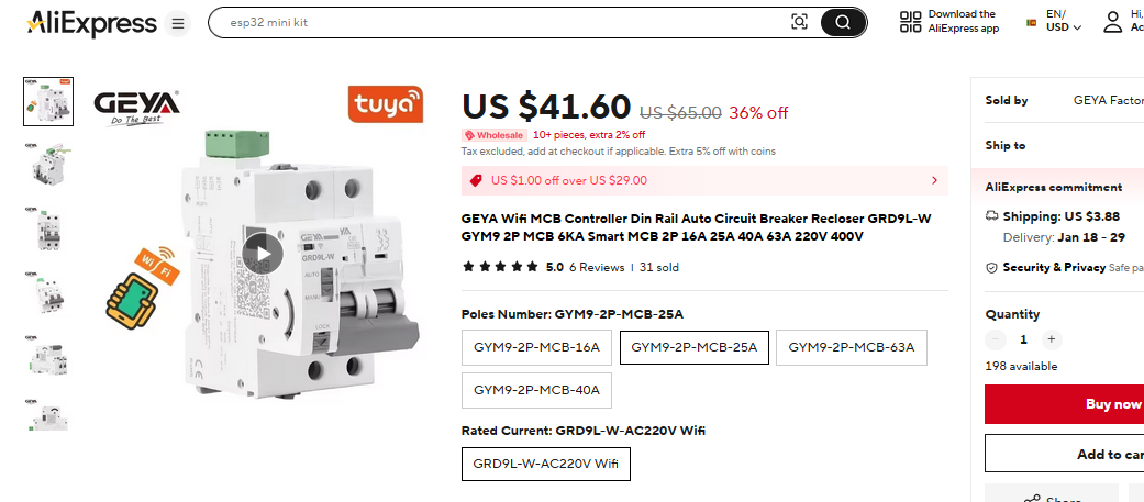

  • Wanted to incorporate the following device into my MQTT Network:
    https://vi.aliexpress.com/item/1005006309773987.html
    View of GEYA Wifi MCB Controller Din Rail Auto Circuit Breaker on AliExpress.

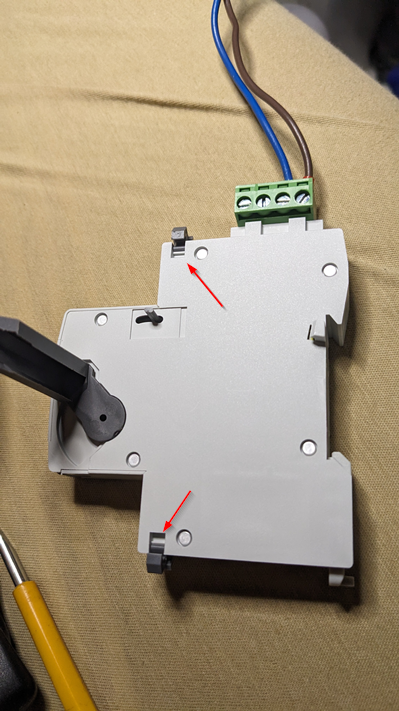

    Actually I wanted to detach the device and use with a RCB. Detaching was simple as there were two retaining latches at the top and the bottom.
    Back of a device with two clips and connected wires
    Electrical switch with AUTO, MANU, and LOCK buttons

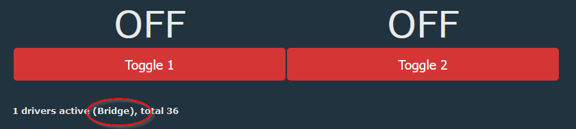

    I set PINs 15/17 (Bridge) as Channel 1 and PIN 14 (Relay) as Channel 2
    Screenshot of a GUI interface with two Toggle buttons set to OFF.
    So far so good.

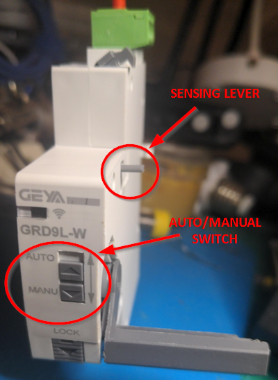

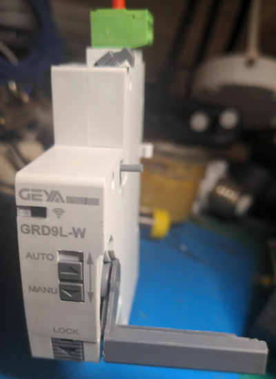

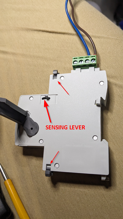

    There is a SENSING LEVER which engages with a mechanism in the attached breaker to detect the ON/OFF position from the breaker also. However I could not figure out yet on how it is detected.
    Switch with sensing lever and auto/manual switch
    Circuit breaker box with a sensing lever on the casing.
    So I want to put these together in a script to make it work like original setup.
    May need some help.
    1. Probably I need to match Button 26 with Relay 14. That is the AUTO/MANUAL switch enables/disables the FWD/REVERSE relay operation
    2. Figure out how to programmatically turn on RED LED
    3. Make use of the HALL EFFECT SENSOR inputs to detect the current state? Suppose there was a manual operation of the switch and when software becomes active how can I detect the actual physical state of the switch?

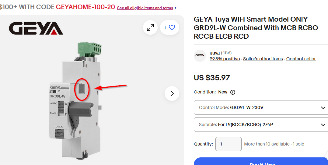

    I found the same product with no position sensor on eBay:
    https://www.ebay.com/itm/395819581447
    Geya GRD9L-W switch with WiFi module, with a button clearly indicated in the image.

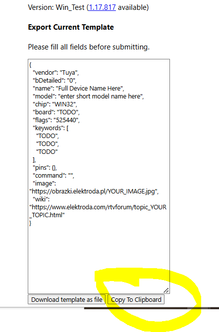

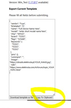

    cool. please post your template JSON from the web application so I can add to the device list.
    Screenshot of an app interface with a JSON template ready to be copied.

    Objective:
    To detect the position of the AUTO/MANUAL Switch.
    GEYA GRD9L-W switch with AUTO and MANU options.
