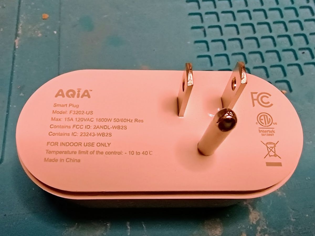

Here is the back of the unit.
Rear view of Aqia Model F3202-US Wi-Fi smart plug.

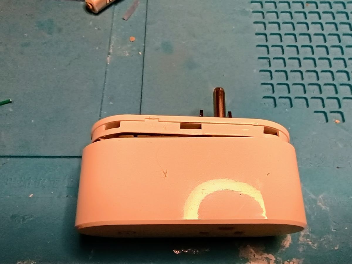

Opened a bit so you can see where to pry the case.
Partly open Aqia Model F3202-US Wi-Fi smart plug.

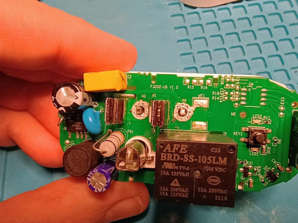

The top side of the control board (A point of pride for me - the yellow C2 was ALREADY melted when I opened it!) This is after desoldering the H3 and H4 contacts.
Desoldering those was pretty much the hardest part of this entire process. There is a very large mound of solder on them and you either have to use a LOT of desoldering braid, or a vacuum de-soldering tool to work on them. I did four of these sockets and ended up heat-deforming the case on all four.

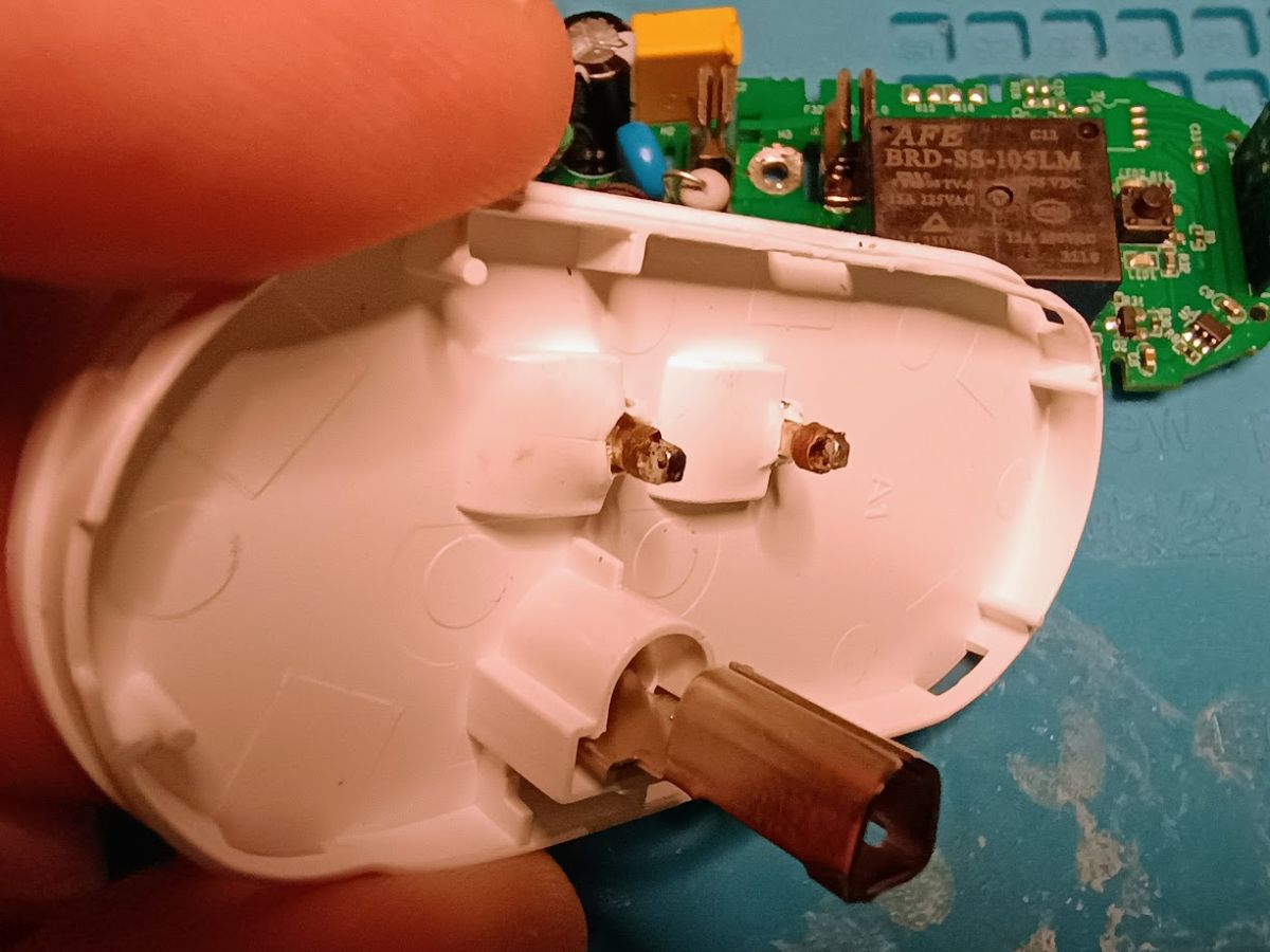

You can see the desoldered posts here. Notice the melted plastic. Also notice the rings around the posts that are still attached.
View of the internal part of the casing and components of the smart Wi-Fi socket.

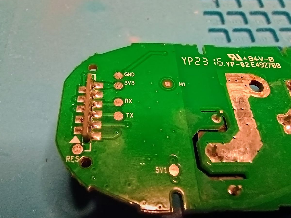

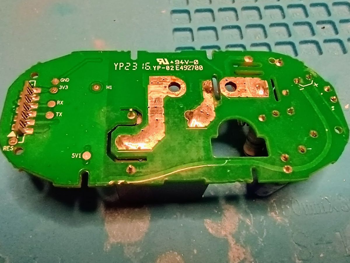

Once you have the controller board separated from the housing, you can access the back of the control board and see where the WB2S is attached.
Controller board of Aqia F3202-US Wi-Fi smart socket with visible traces and pins.
Image of a circuit board with visible connectors labeled GND, 3V3, RX, TX.

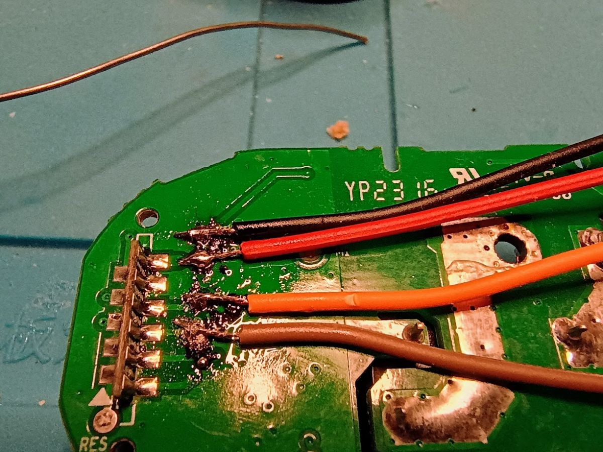

At first, I tried to talk to the WB2S directly, but the circuitry on the controller board was messing me up:
Circuit board with soldered wires of different colors.
So I followed the advice given here and removed the WB2S board and worked directly with it.
That removal process is demonstrated very well in this youtube video at around 1 minute and 40 seconds:

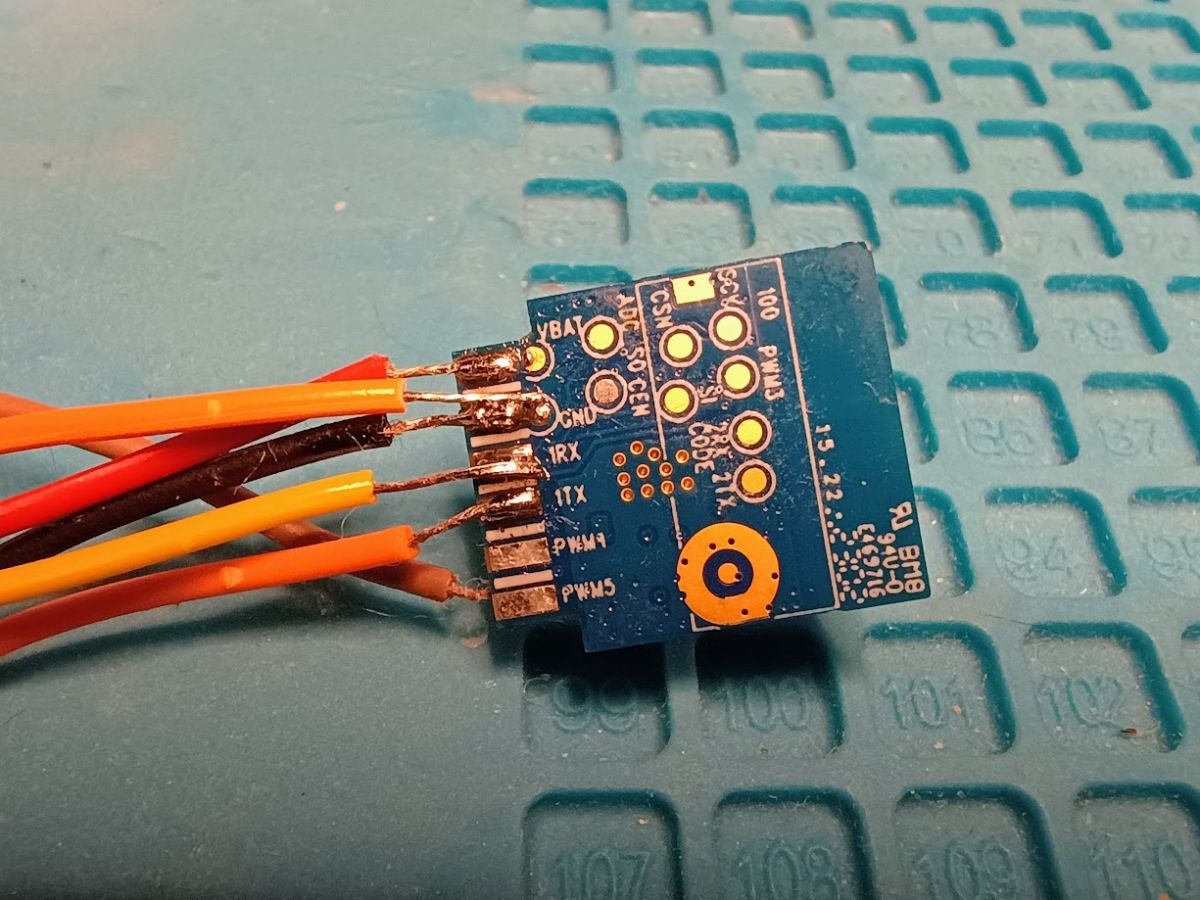

As I sit looking at this now, I realize I used the WORST possible colored wires to make a post about this board.

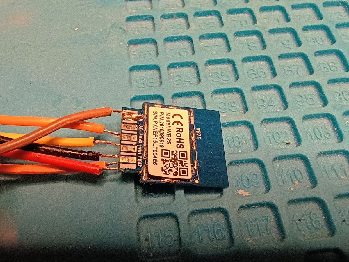

Please notice that in this picture, there are leads attached to VBAT, GND, 1RX, and 1TX on this side of the WB2S.
There are actually TWO leads attached to GND here, one which goes to the UART programmer and the other to the push button shown below.
Close-up of a WB2S module with attached wires.
On the OTHER side of the WB2S, there is a lead attached to CEN. This also goes to the button shown below.
WB2S module with soldered wires on a blue mat.

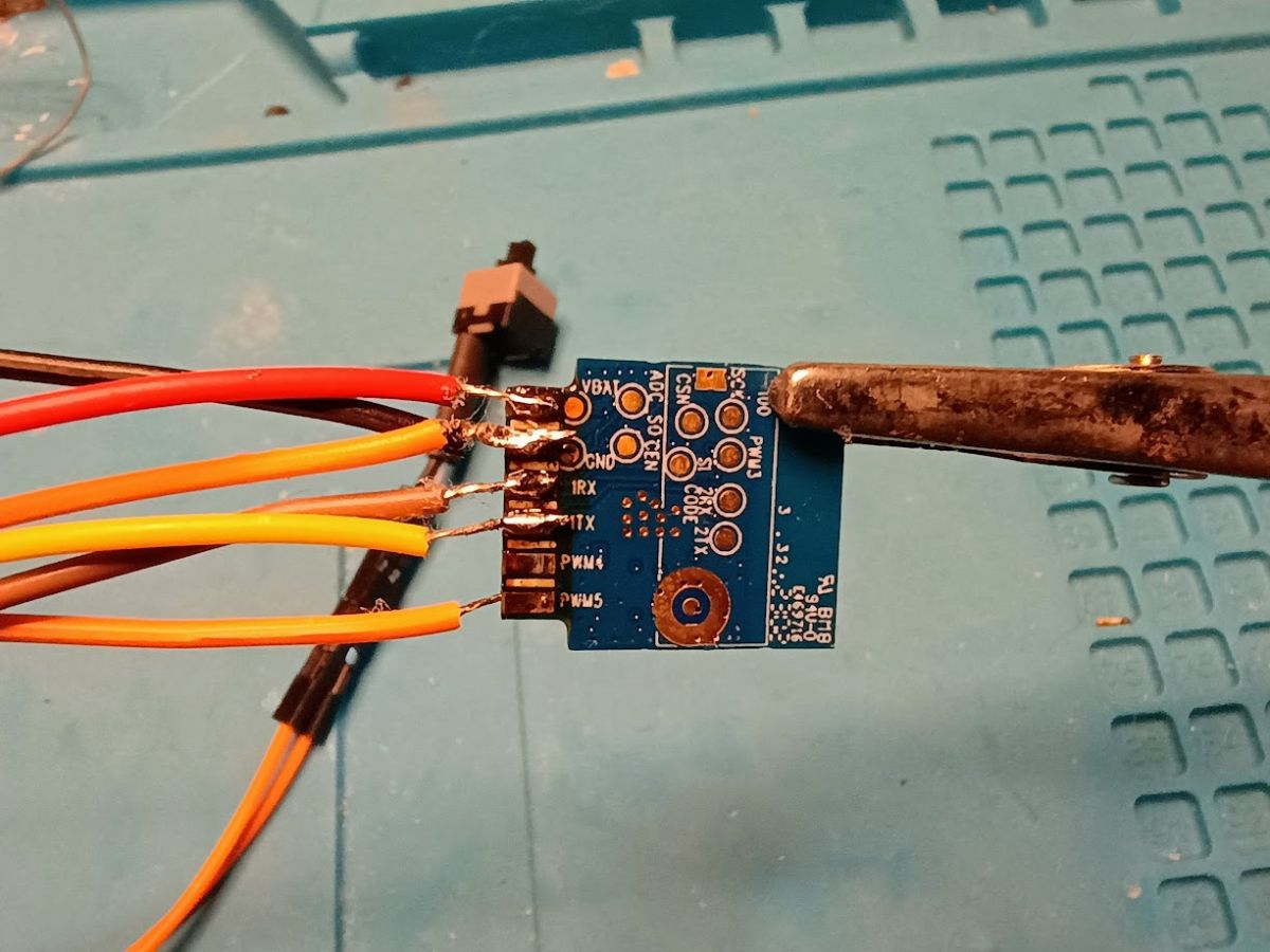

This is the best picture I could get that shows the button. This is a momentary, Normally Open button switch. This allows for an EASY WAY
to activate the programming mode on the WB2S chip when are using the flashing tool. I tried several times to do it with just touching the wires together, or touching the chip at just the right time, but this actually makes it simple and much less of a hassle.

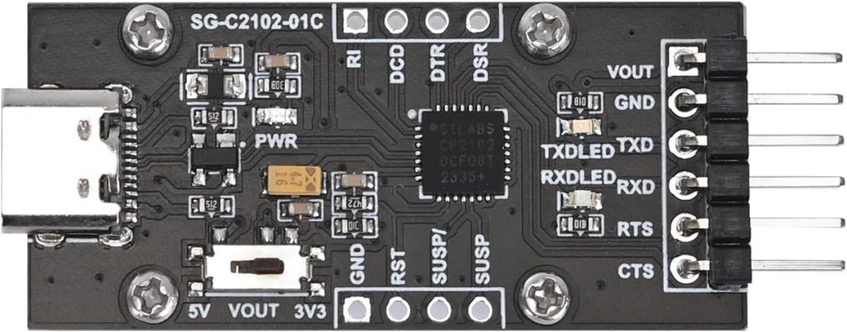

I used a cheap UART programmer with the output set to 3.3V to hook up to my Windows PC.
UART Programmer listing on Amazon.com
UART programmer module with micro USB port and pins on the board.
I used those DuPont breadboard wires to make connecting it easy.
VOUT -> VBAT, GND -> GND, TXD -> 1RX, RXD -> 1TX (cross over the TX/RX pins)
