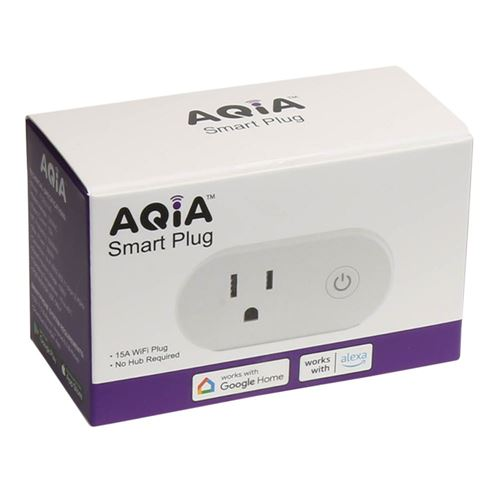

  • This is a teardown for an Aqia Model F3202-US Wifi smart outlet. This outlet is controlled via a WB2S module.
    Item description page from MicroCenter
    This was my first reformatting of any sort of smart appliance. I made this work with Home Assistant via the MQTT protocol. I got four of them on sale for $5 each, and was able to convert them all.
