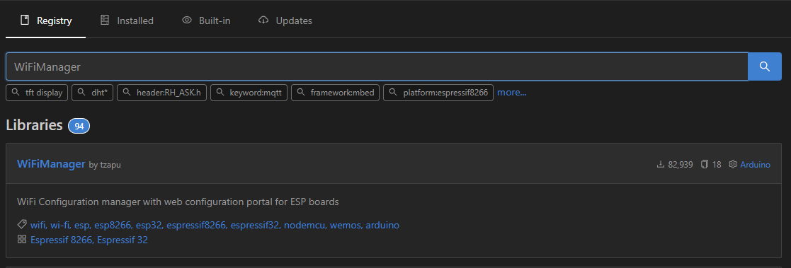

I implement my project based on PlatformIO because of the simplicity and availability of this environment. I prefer it over ArduinoIDE. So first we add the WiFiManager via PlatformIO/Libraries:
Screenshot of the library registry in PlatformIO with the WiFiManager library selected. .

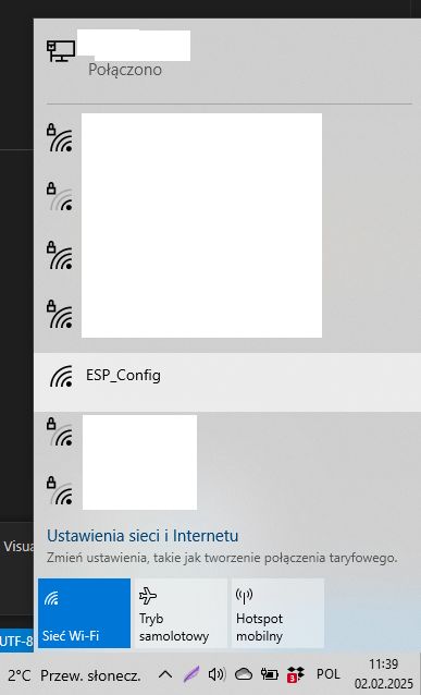

Now it's time to see if it works. I compiled, uploaded and lo and behold, the configuration network appeared:
List of available Wi-Fi networks on a computer with ESP_Config network visible. .

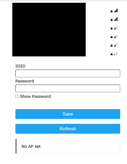

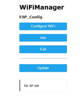

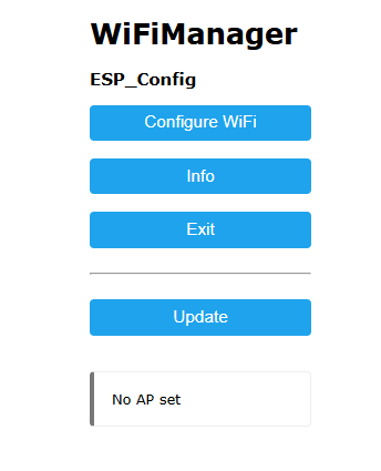

Once connected, you can visit the 192.168.4.1 address:
WiFiManager interface with ESP_Config .
There you can get a list of WiFi networks seen by the ESP and connect to one of them:
Screenshot of WiFiManager configuration with SSID and password fields .

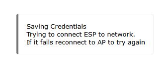

The ESP remembers the password given and joins my WiFi after a while:
Information bubble with text about saving credentials and connecting ESP to the network. .
Success! .

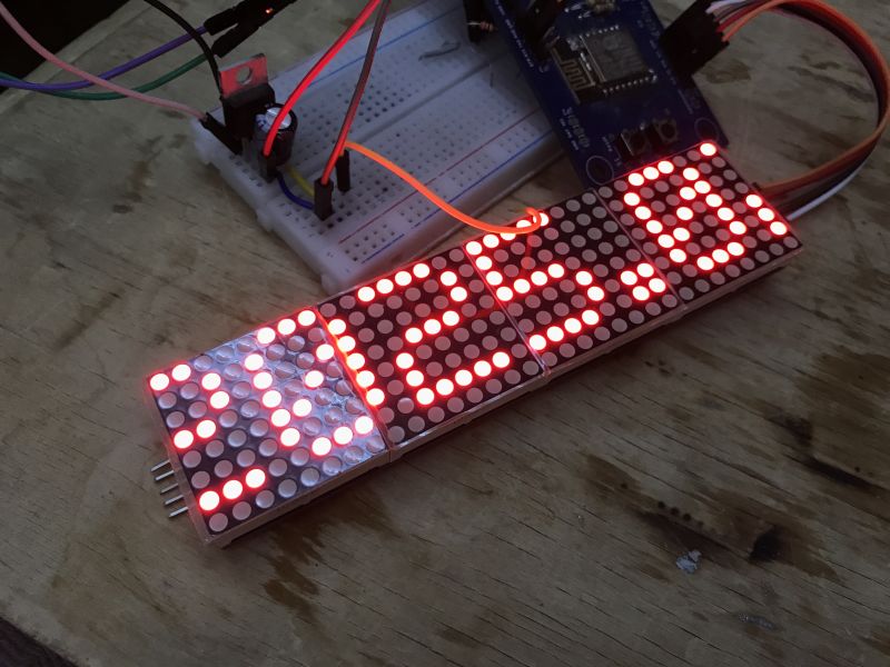

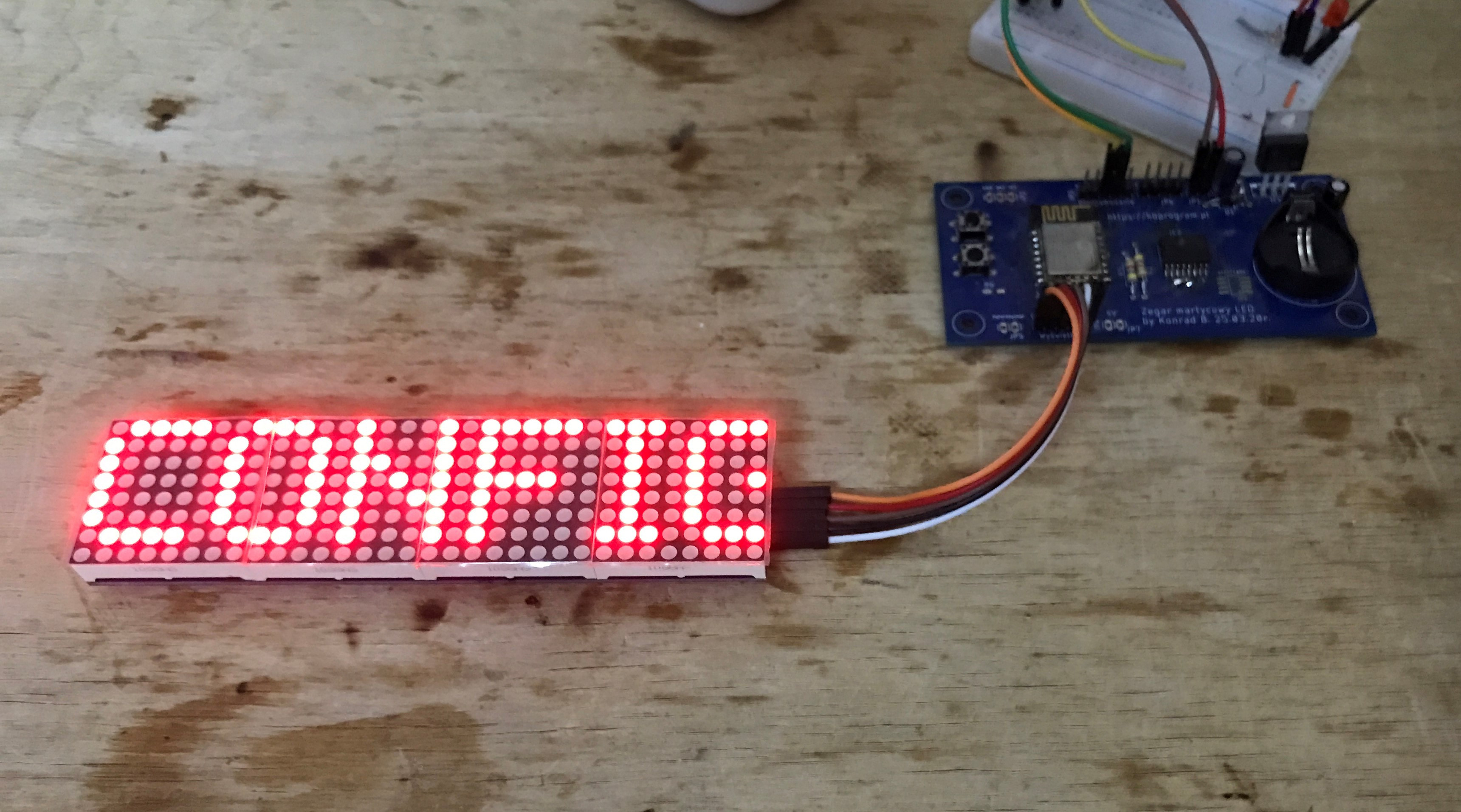

I also checked the behaviour of the button - correctly restarts AP mode and, in order to communicate this to the user, I have then added the display of the word Config to the screen:
LED display with the text 'CONFIG' connected to a prototyping board. .

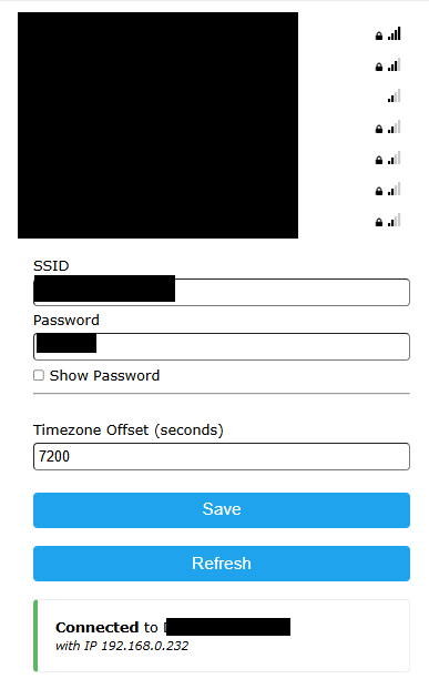

From now on, the parameter is visible on the configuration page:
WiFiManager configuration page with fields for SSID, password, and timezone offset. .

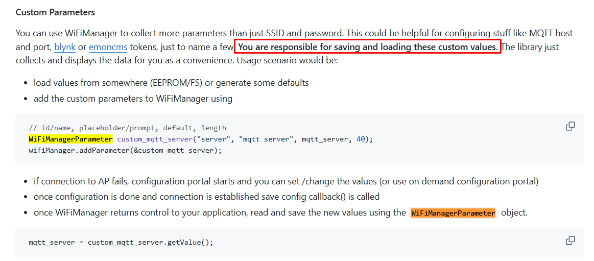

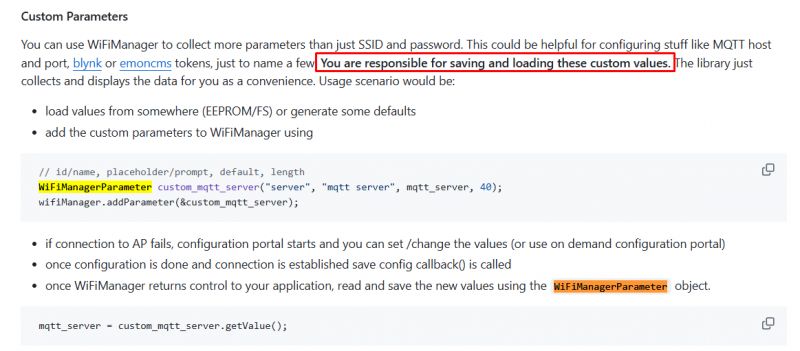

We test, everything works, and then suddenly we restart ESP i.... surprise - the parameter has reset.
The explanation for this phenomenon is in the WiFiManager documentation itself:
WiFiManager documentation on custom parameters .
WiFiManager unfortunately does not save them, we have to do it ourselves.

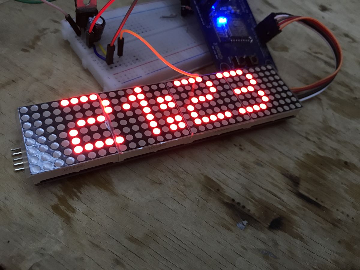

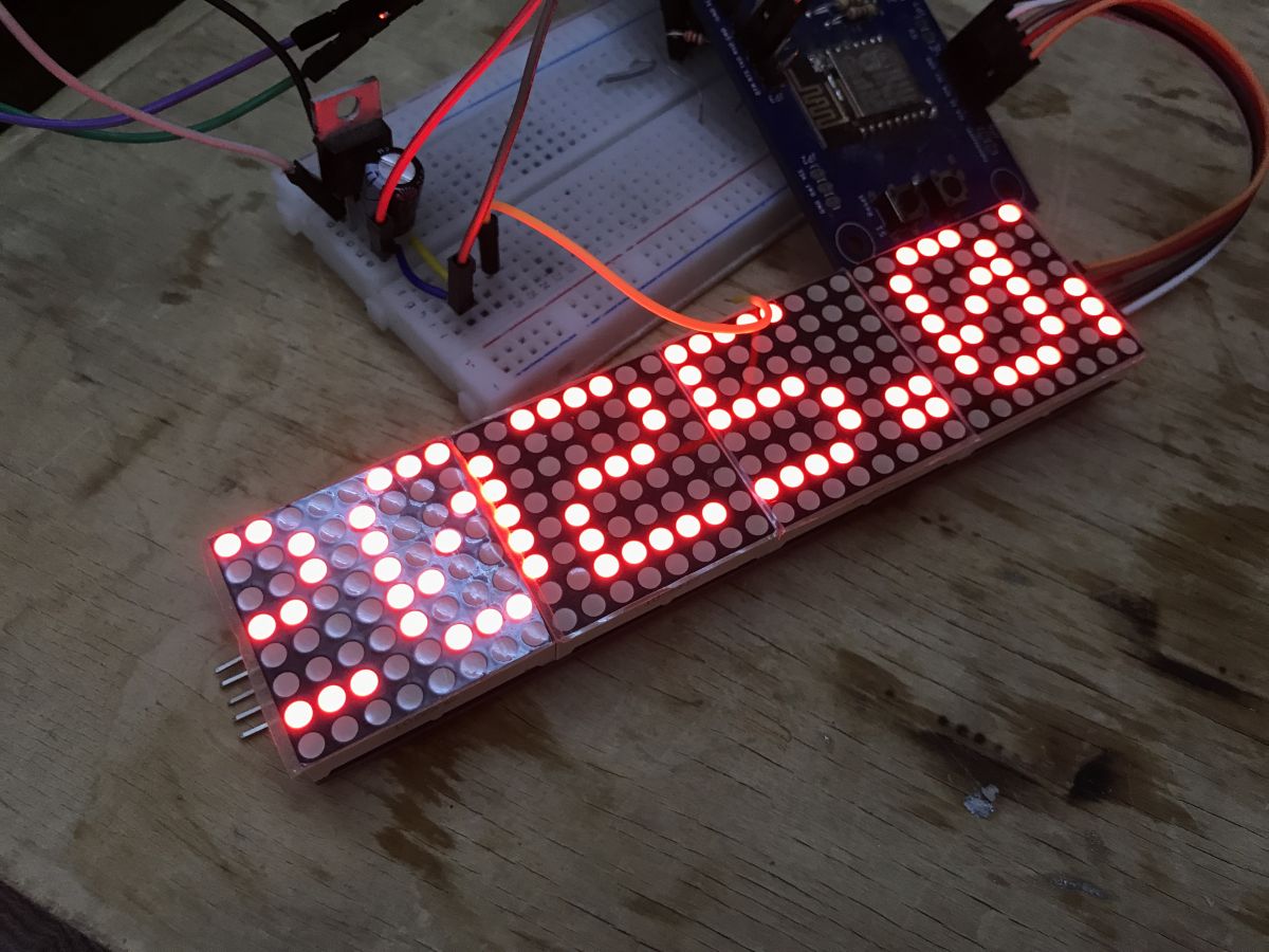

From now on, the time offset is remembered even after loss of power. The clock shows the correct time:
LED display showing time connected to a breadboard. .
LED display showing the time 21:23 on a prototyping breadboard. .

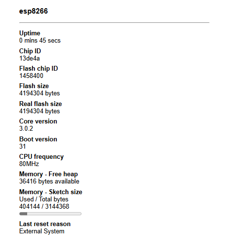

. Information page .

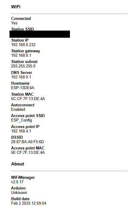

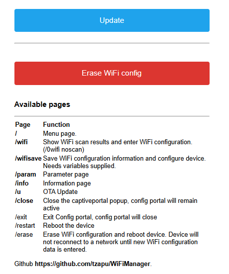

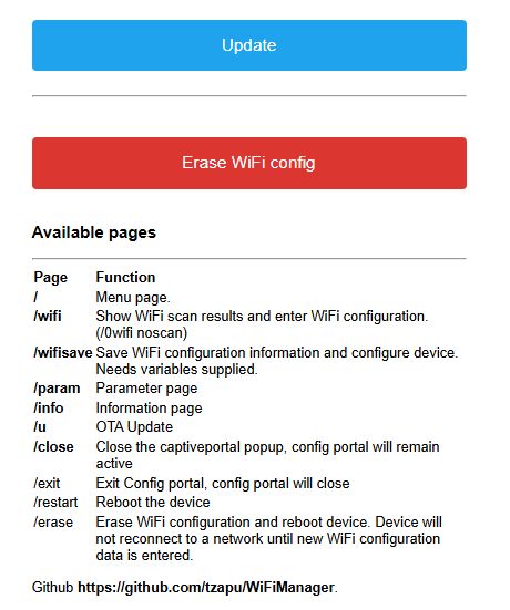

It is also worth mentioning that WiFiManager offers a simple information page about our device. There you can check the status of the ESP and the network it is connected to. This is available at the resource address /info.
ESP8266 information page with technical data .
Screenshot of WiFiManager information panel. .
WiFiManager user interface with update and erase WiFi config options .
