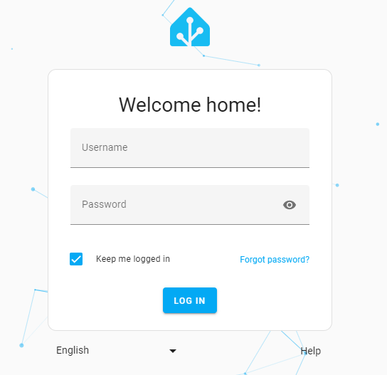

I assume that you're seeing login screen in browser but don't know the password:
Home Assistant login screen with fields for username and password.

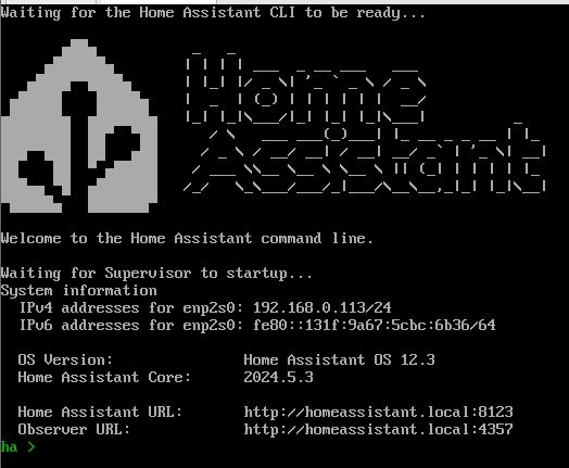

This can be easily recovered via HA command line:
Home Assistant command line screen with system information.
Use the following command, make sure to replace user with your existing user name, password can be any new password:

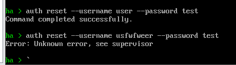

auth reset --username user --password test
The change will be accepted correctly:
Password reset command in Home Assistant completed successfully.
NOTE: If you specify user name that does not exist, you will get unknown error:
Screenshot of command line showing password reset commands in Home Assistant.

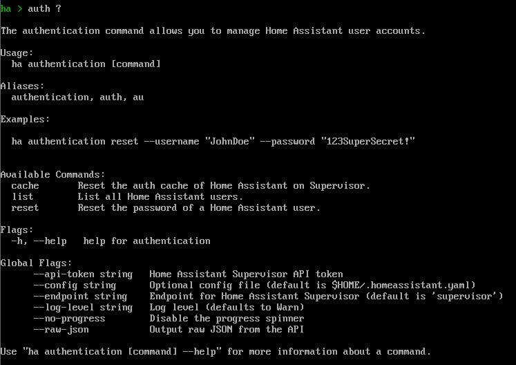

You can also get more generic help if you type auth ?:
Screenshot showing the command line for managing Home Assistant user accounts.

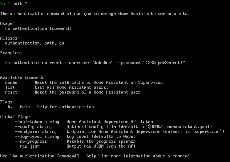

For example, auth list will list users and their information:
Screenshot showing the auth list command in Home Assistant.
