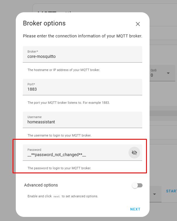

    How to recover lost/forgotten MQTT password without creating new MQTT user, without having to reinstall everything again? Why does my password field reads "__**password_not_changed**__" ? Home Assistant Mosquitto broker behaviour has been recently changed. In the past the password was easily accessible via Home Assistant Devices & Services -> MQTT menu, but now it's hidden. That could have taken some users by suprise (including me), so here's a simple solution.

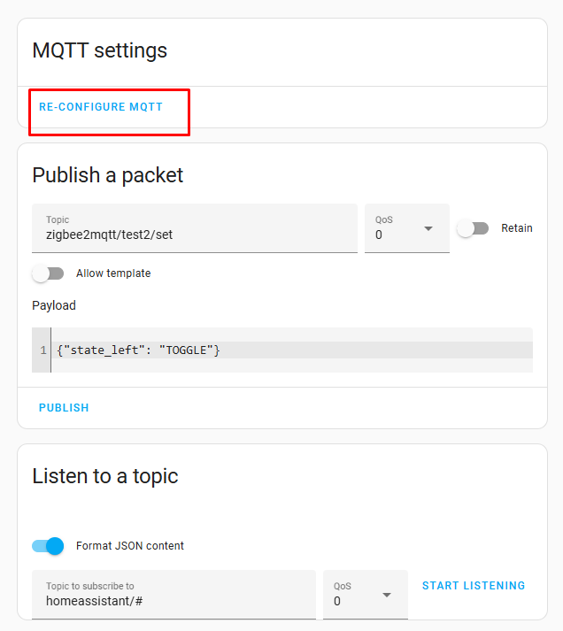

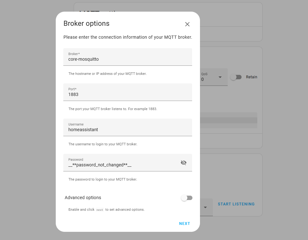

    So, in the past, Home Assistant MQTT password used to be easily available in Re-Configure MQTT menu:
    Screenshot of MQTT settings in Home Assistant with the Re-Configure MQTT button highlighted.

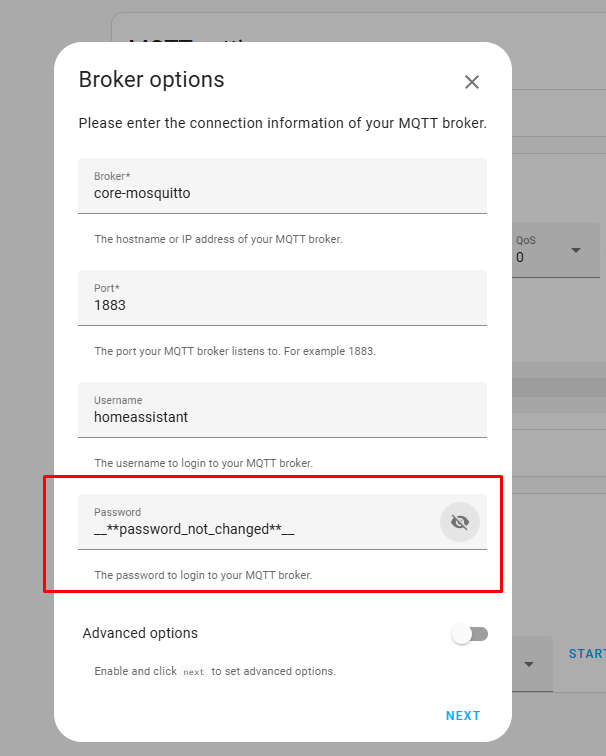

    It was easy to display it and copy to your devices to configure them. However, with recent update 2024.5, it is not possible to get password there:
    MQTT broker settings message in Home Assistant with password __**password_not_changed**__.

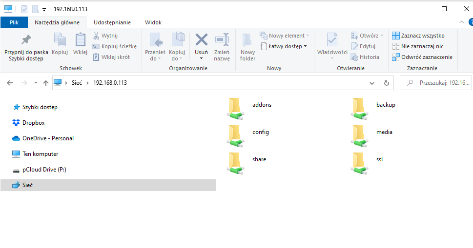

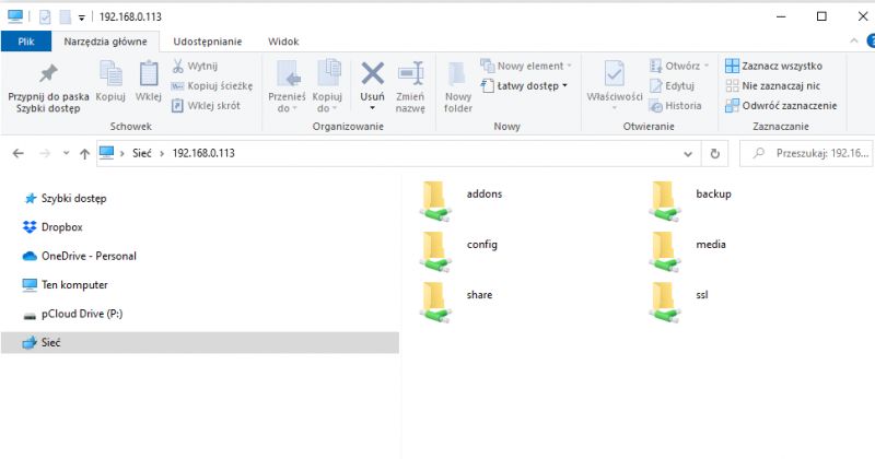

    Luckily you can still get it from core.config_entries. For that, you will need to access this file. I have SMB integration already installed, which makes HA access from Windows easy:
    Screenshot of a Windows window showing a network directory view.
    Of course, any other file access solution should also work, it does not have to be the one I used.
    Connect to it and navigate to path:

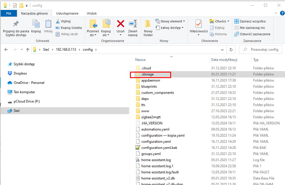

    /config/.storage/core.config_entries
    Note that .storage directory will be hidden:
    Screenshot of a file manager showing the .storage folder in the config directory.

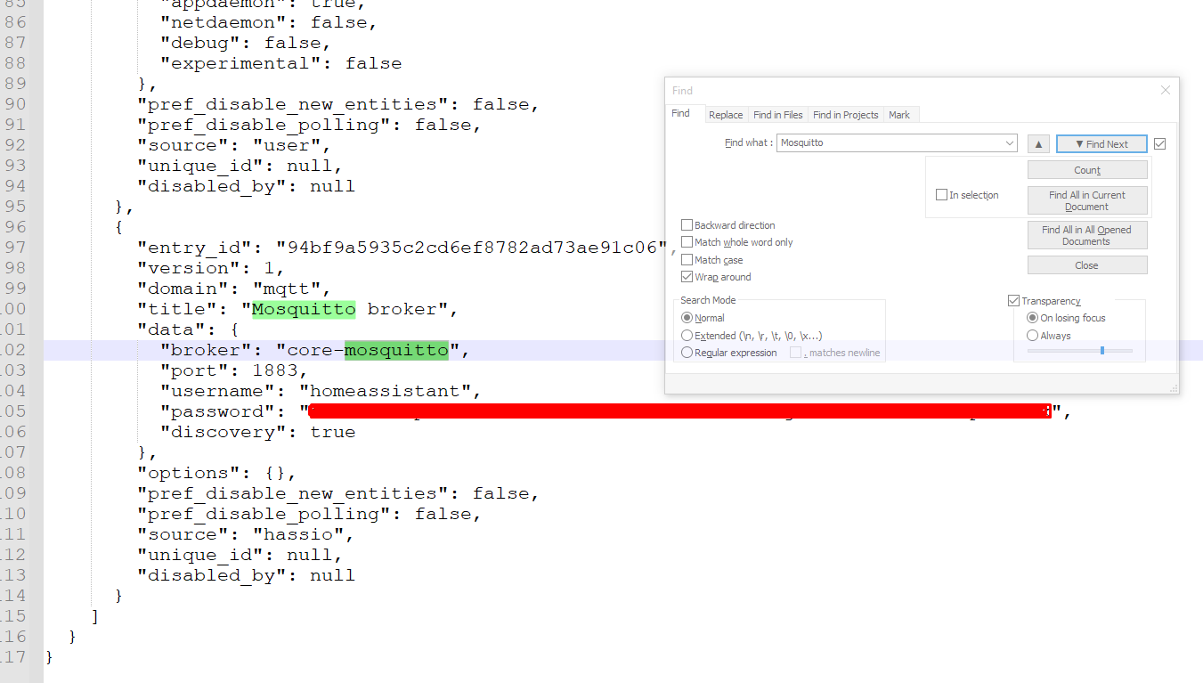

    Now, open this file with any text editor and search for Mosquitto:
    Screenshot of a text editor with an open file showing Mosquitto configuration in Home Assistant.
    and here it is - this your lost MQTT password!
    Of course, do not edit this file, just copy out your password...

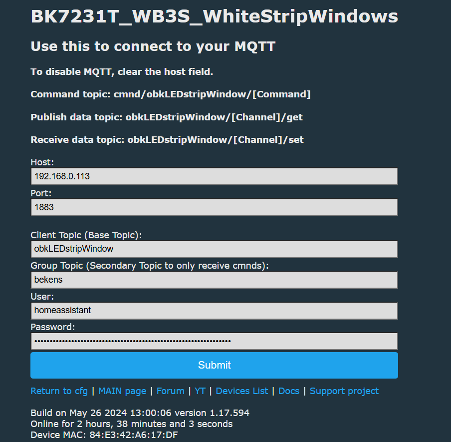

    Now you can easily use it to configure your other devices, for example, OpenBeken.
    Screenshot of the MQTT settings interface with filled fields for host, port, client topic, and user.
