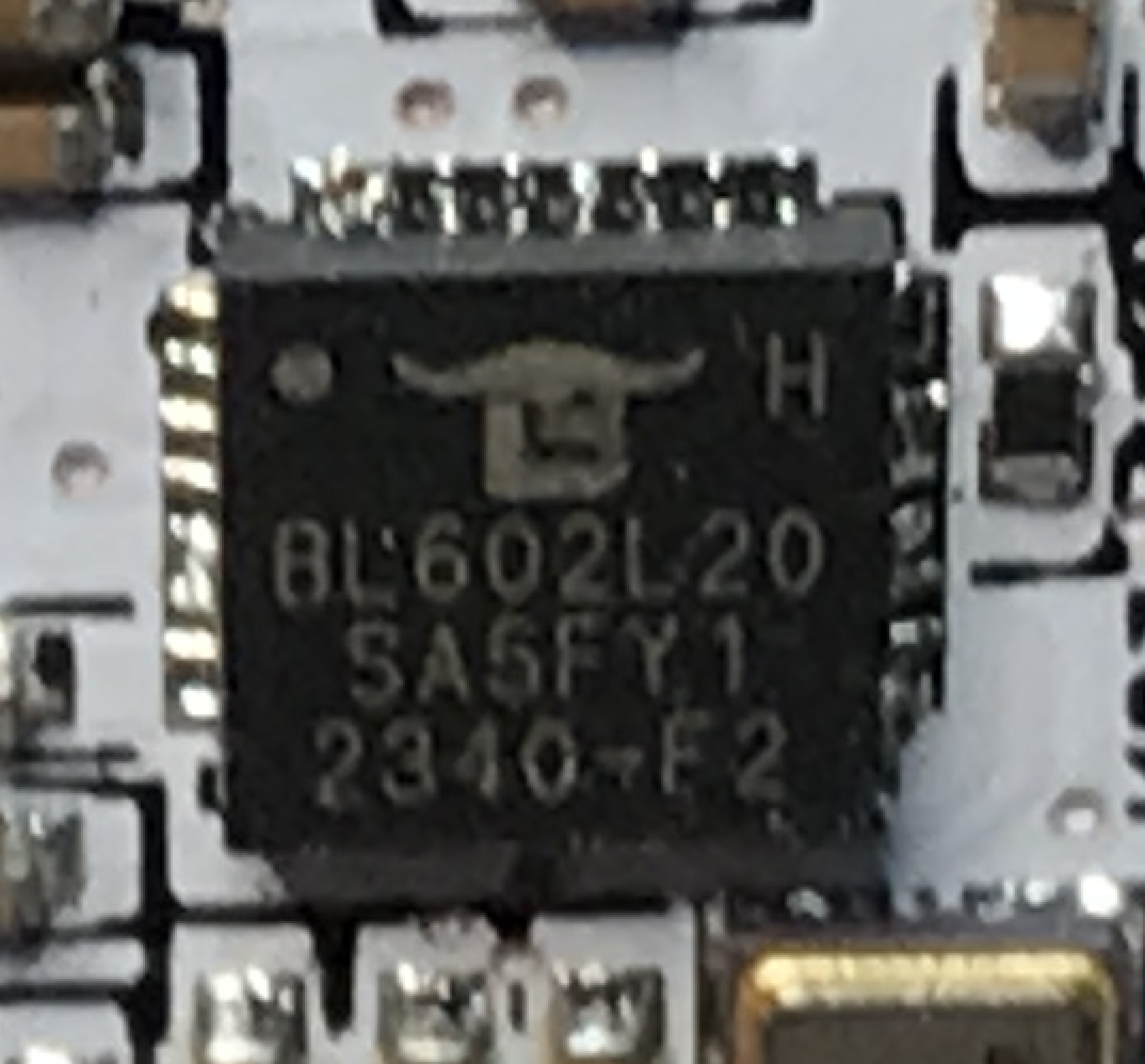

Close-up of an integrated circuit on a printed circuit board.
BL602 is a WiFi+Bluetooth 32-bit SoC found in some Sonoff and eWeLink devices. It comes in 2MB and 1MB flash versions, but here I will focus on 2MB one. BL702, on the other hand, is a Zigbee chip. They both can be read and flashed with BLDevCube, here are the connection details and step by step guide for flash read.

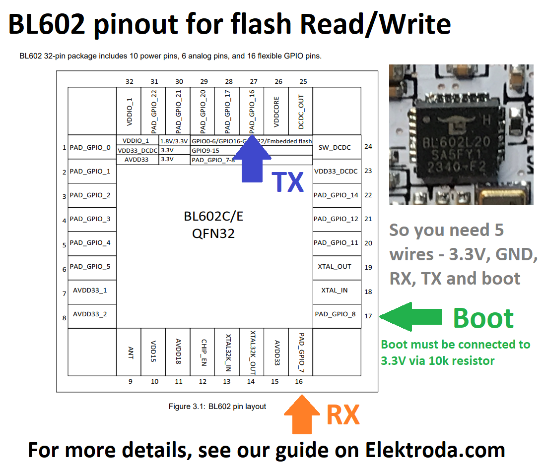

Let's start by considering the GPIO pinout of BL602 and determine which signals we will need to read and write flash.
BL602 pinout for flash read/write.
Remember that dot marks the first pin!
Required connections are:
- GPIO16 (TX) - connect to USB to UART converter in 3.3V mode (like CH340, etc)
- GPIO7 (RX) - connect to USB to UART converter in 3.3V mode (like CH340, etc)
- GPIO8 (Boot) - must be connected to 3.3V via 10k resistor
- VDD (3.3V)
- GND - ground of power supply and USB to UART converter must be common
The 3.3V power supply must be reliable, it may not be enough to power it from USB to UART converter. It may fail to flash or bootloop on AP creation/connect. Wires should be short. Do not connect boot directly to 3.3V. Make sure to do power off/on cycle between each flash operation, just like on ESP.
Disconnect device from mains before doing any operations on it!!!

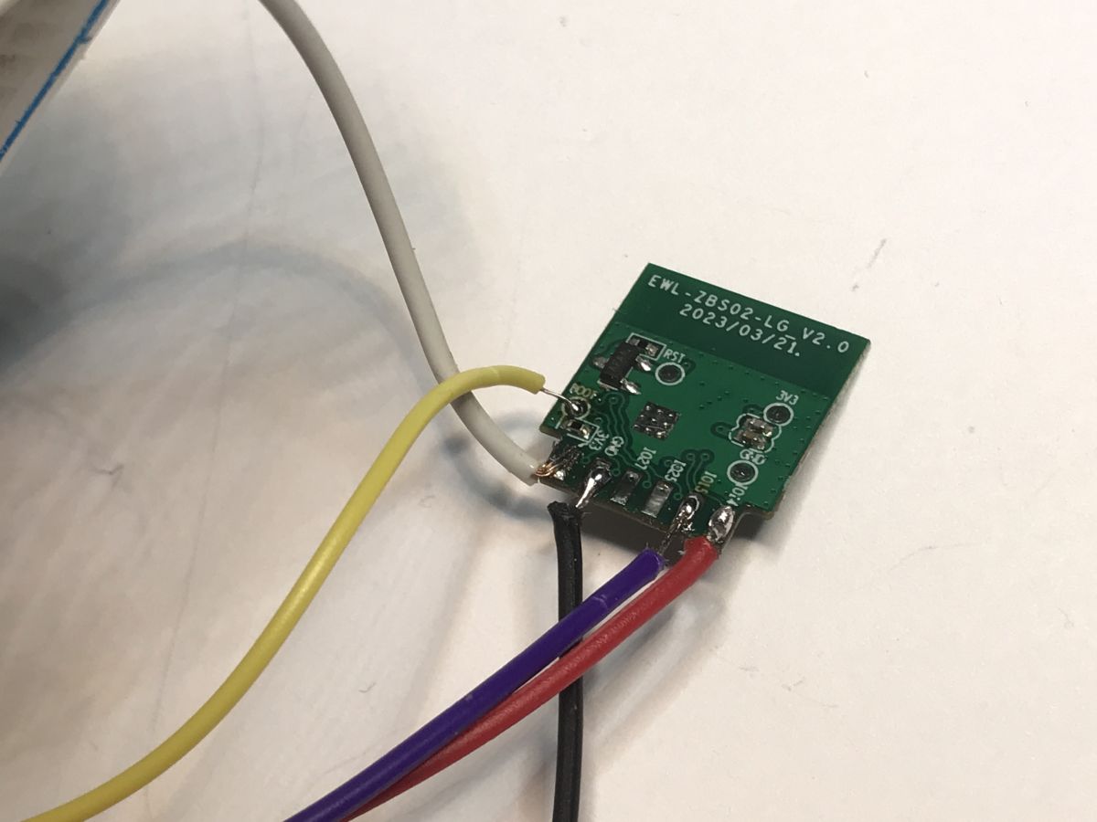

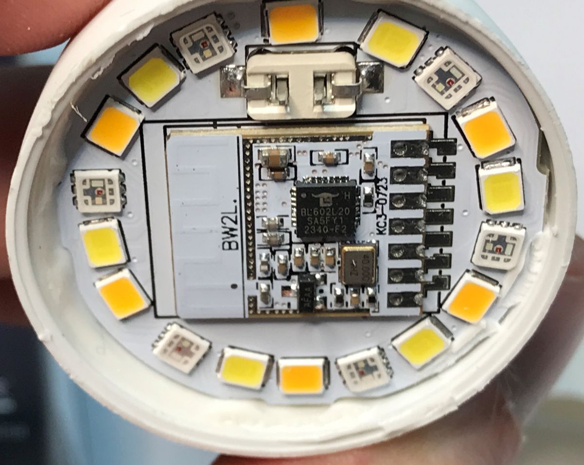

Hardware setup - example BL602
Here's BW2L module, as desoldered from eWeLink E14 candle RGBCW bulb. It has no pin markings, so we have to determine which pin is which. Luckily, we have our GPIO diagram, the one I made in previous section.
Interior of a smart LED bulb with visible diodes and electronic components.
Now we can use multimeter to test which pad connects where.

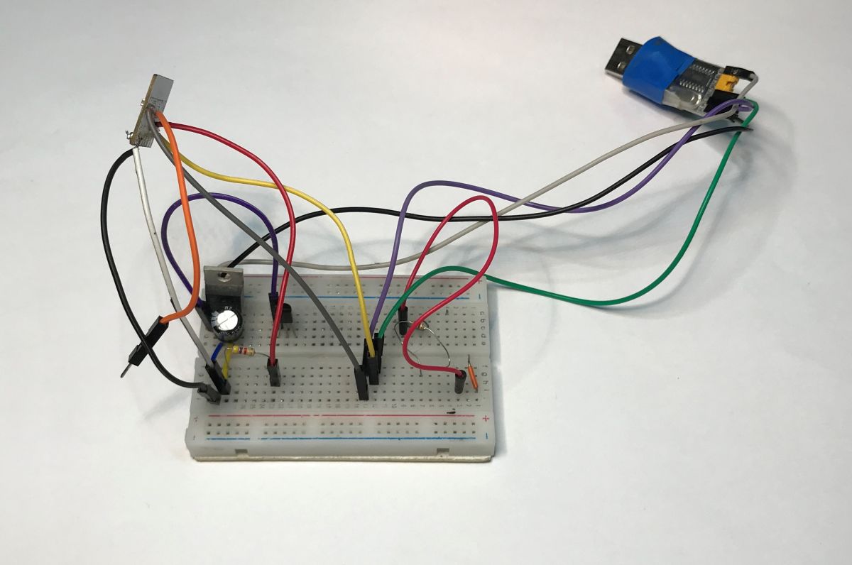

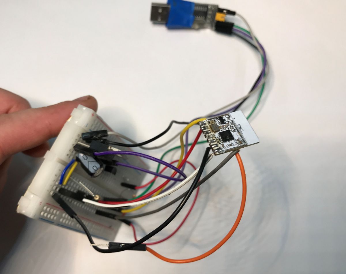

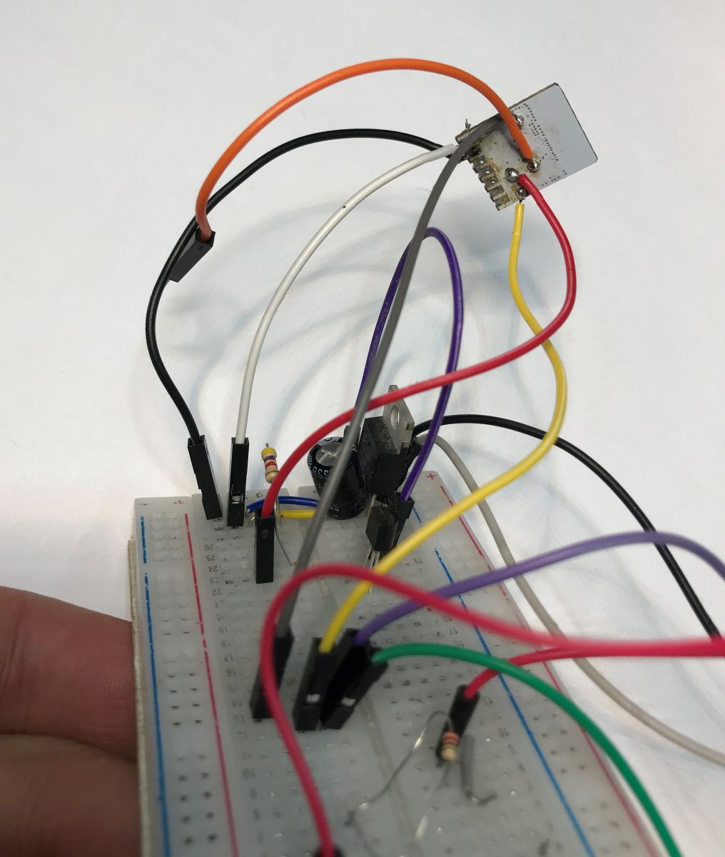

Here are my connections:
Breadboard with mounted electronic components and multicolored wires.
Breadboard with connected colorful wires.
Prototype with a breadboard, wires, and electronic components.
Close-up of a breadboard with a capacitor, wires, and a resistor.

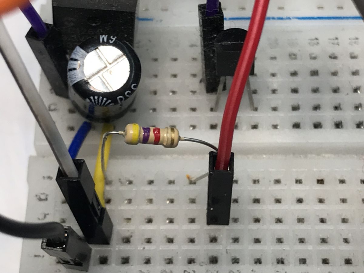

Please note few things:
- UART wires are relatively short
- on the proto board, there is a 3.3V LDO powered from 5V, so we can get good 3.3V for WiFi module. I am using TC1264, but you can use AMS1117 or any other, or get 3.3V from NodeMCU or Arduino
- the 10k resistor for BOOT is clearly visible
- when in doubt, swap RX and TX

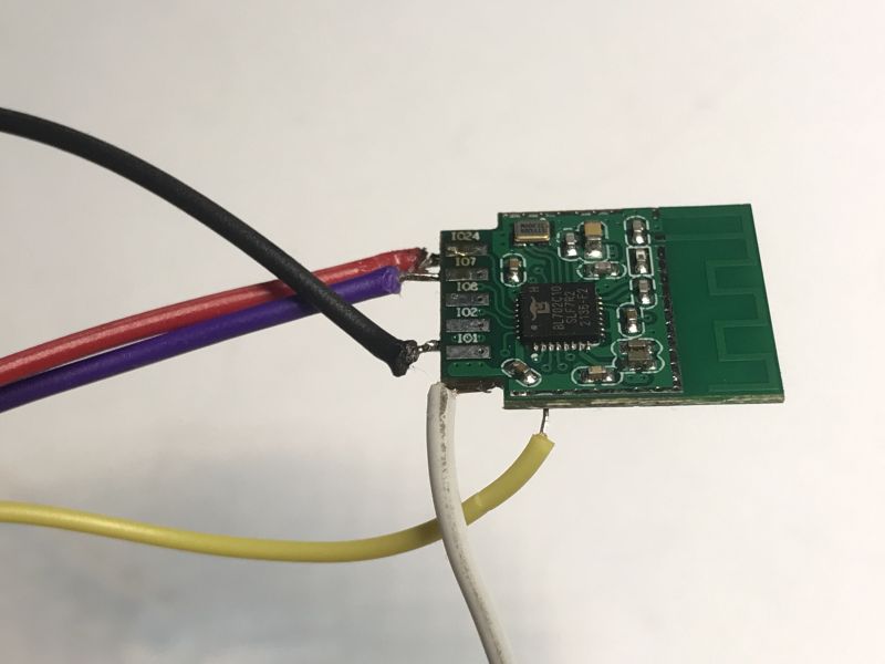

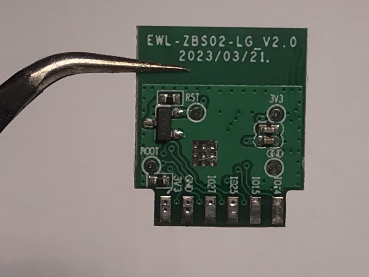

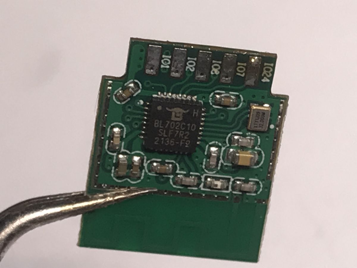

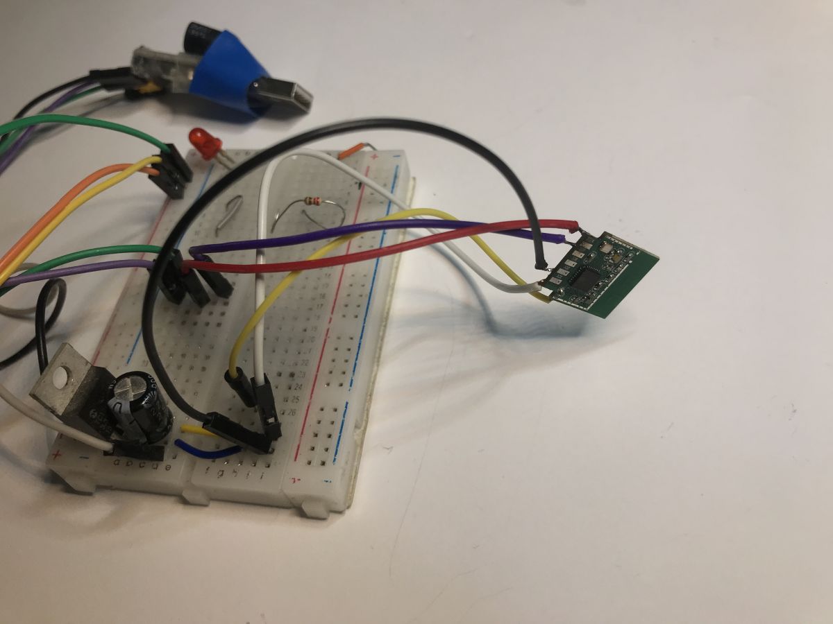

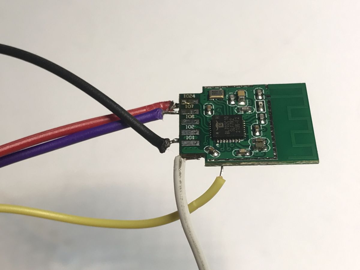

Hardware setup - example BL702
Here's second hardware sample, this time with Zigbee chip. This time silkscreen with markings was present, so there was no guessing involved.
Small green circuit board held by a metal tool on a white background.
Small green circuit board with labels and electronic components.
Electronic breadboard with multicolored wires and components.
Close-up of a small electronic module with soldered wires.
Small green electronic board with connected wires.
Not much extra commentary is required here, as the process is the same as for BL602.

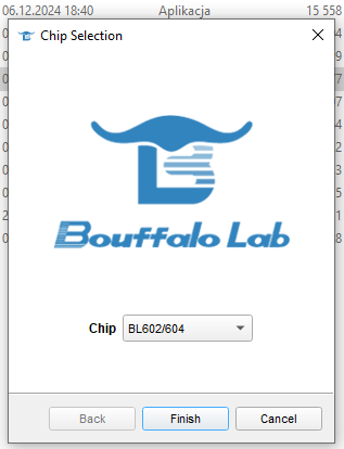

Unpack, and first select chip type:
Chip selection window with Bouffalo Lab logo and options to select BL602/604 chip.

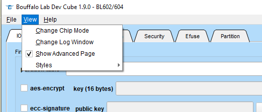

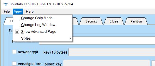

Enable advanced view:
Screenshot of Bouffalo Lab Dev Cube 1.9.0 with the View menu open and the Show Advanced Page option checked.

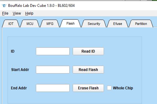

Open Flash Tab:
User interface of Bouffalo Lab Dev Cube application with the Flash tab.

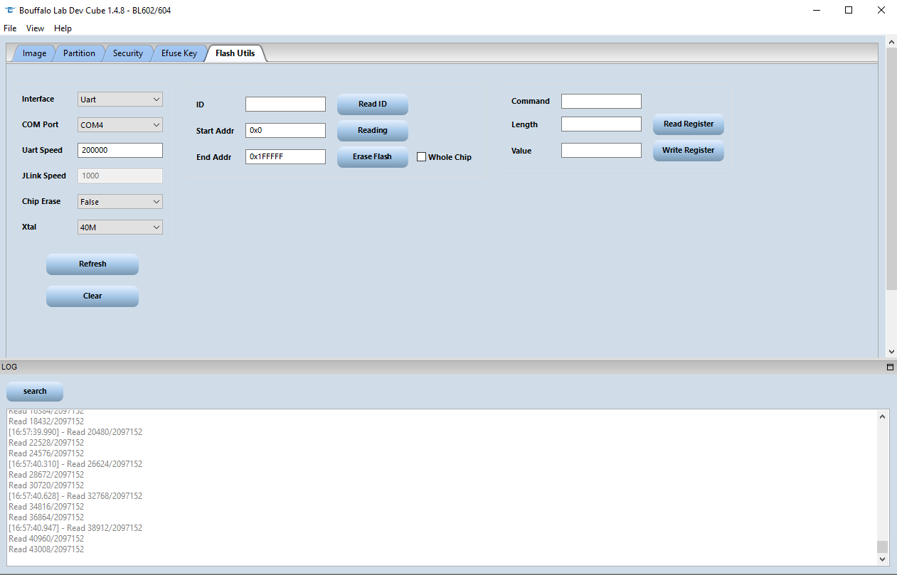

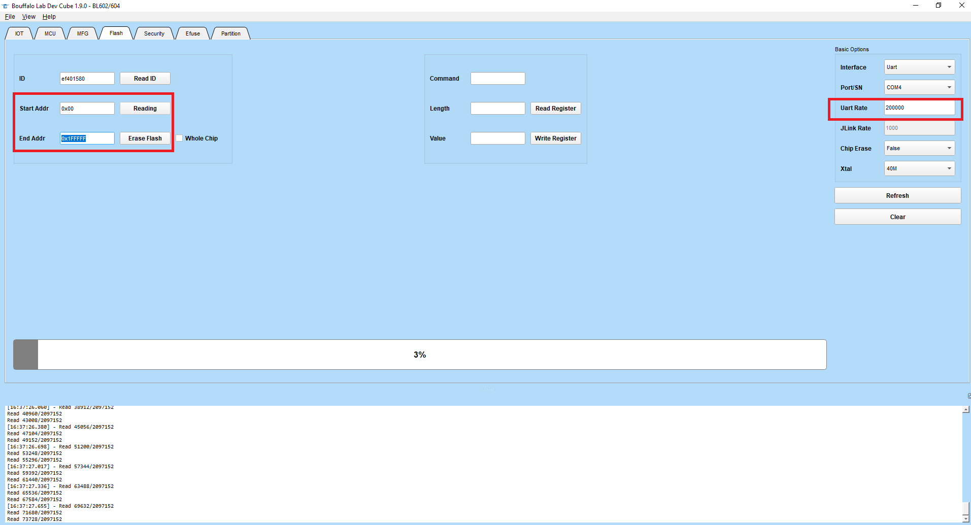

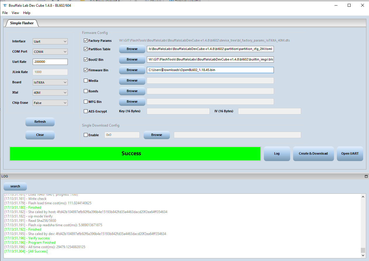

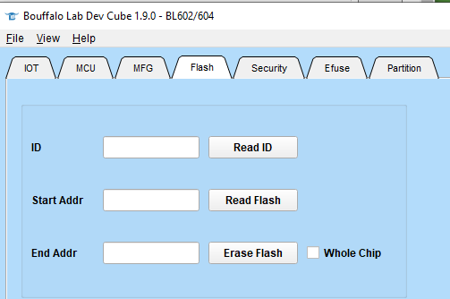

Select your com port, enter start offset (0x0) and read length (0x1FFFFF). Use "read flash", do not press "erase"!
Screenshot of Bouffalo Lab Dev Cube 1.9.0 interface with flash memory settings.
If you are getting:
[16:56:43.375] - Read operation
[16:56:43.376] - ========= flash read =========
[16:56:47.406] - Read data error,maybe not get excepted length
[16:56:47.406] - Retry
[16:56:49.408] - ack is b''
[16:56:49.409] - Not ack OK
Then lower baud. 200000 is ok, default 2000000 is too high.

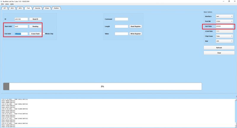

For flash size, make sure that you are entering 0x1FFFFF. If you enter 0x200000, you will get:
[16:40:29.599] - ========= flash read jedec ID =========
[16:40:29.602] - Read flash jedec ID
[16:40:29.603] - flash jedec id: ef401580
[16:40:29.603] - Finished
[16:40:29.608] - get flash size: 0x00200000
[16:40:29.609] - Read operation
[16:40:29.609] - read flash end addr 0x00200000 was overflow with flash size 0x00200000
[16:40:29.609] - ErrorCode: 0045, ErrorMsg: BFLB FLASH SIZE OVER FLOW
[16:40:29.609] - Burn Retry
[16:40:29.610] - 0
[16:40:29.610] - Burn return with retry fail
So enter 0x1FFFFF as a work around, it's just one byte less than 0x00200000 .

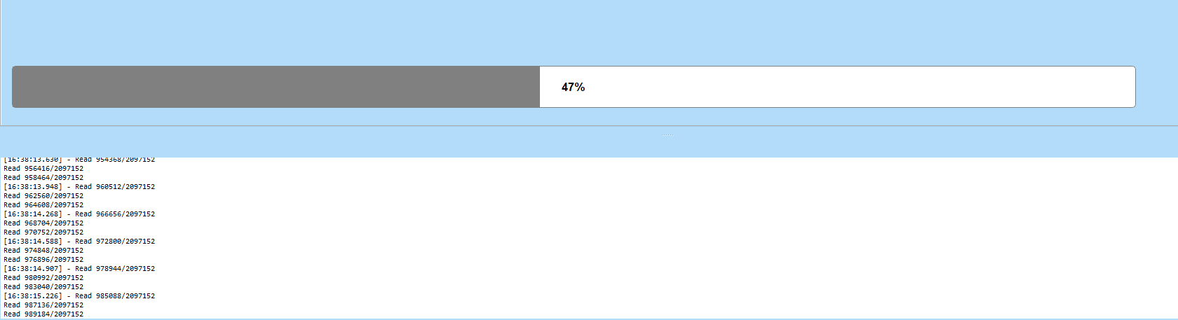

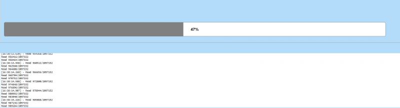

Now flash read should work, wait patiently:
Progress bar filled to 47% on a blue background with log lines below.

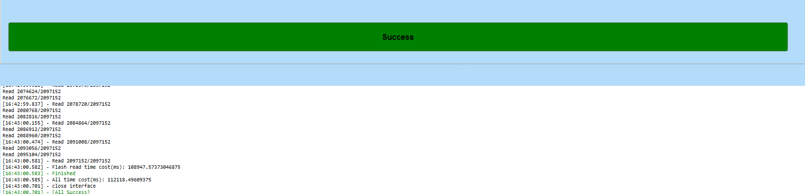

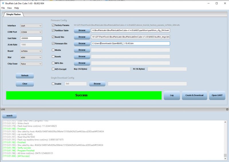

Flash read should be successful:
User interface with a Success message on a green background and operation logs.

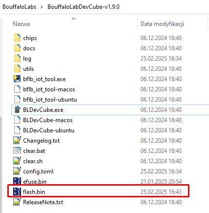

File will appear where BLDevCube is:
Screenshot of a file explorer window showing the BouffaloLabs folder containing various files.

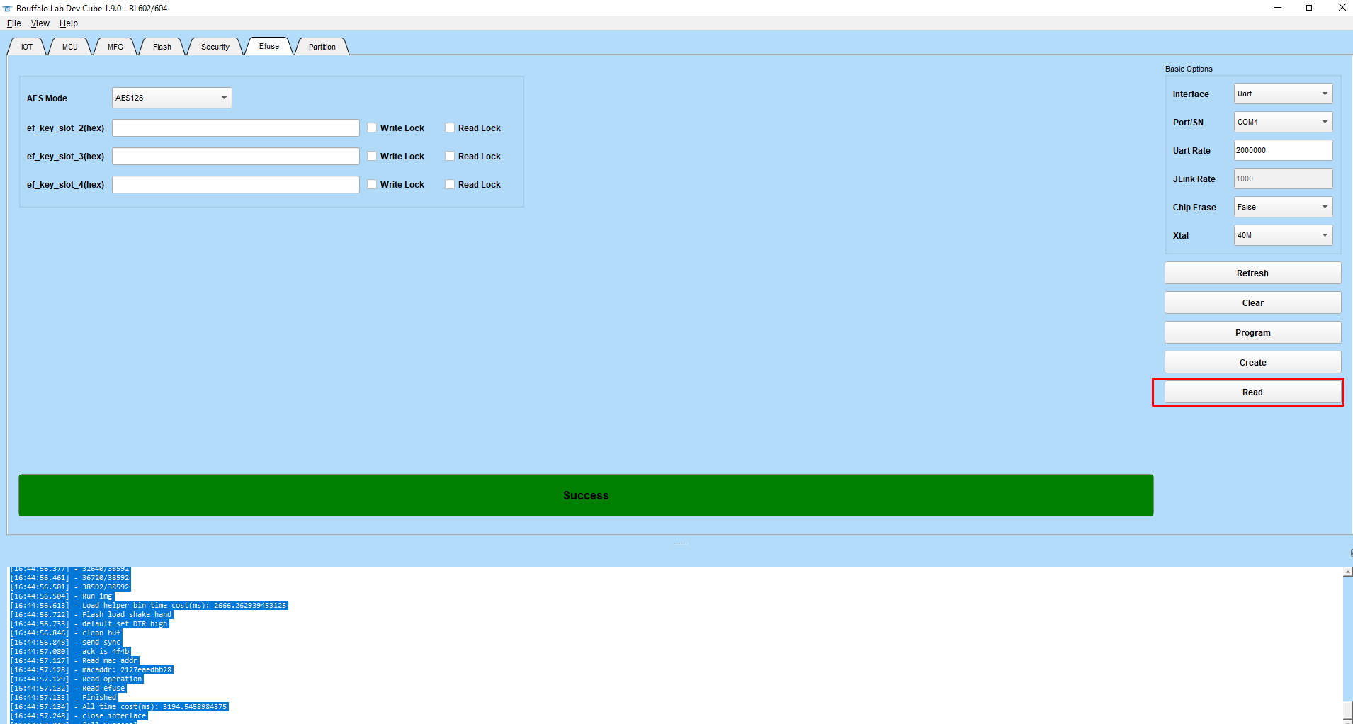

You can also read eFuse:

Read 1935360/2097152
[16:42:52.499] - Read 1937408/2097152
Read 1939456/2097152
Read 1941504/2097152
[16:42:52.819] - Read 1943552/2097152
Read 1945600/2097152
Read 1947648/2097152
[16:42:53.139] - Read 1949696/2097152
Read 1951744/2097152
Read 1953792/2097152
[16:42:53.457] - Read 1955840/2097152
Read 1957888/2097152
Read 1959936/2097152
[16:42:53.775] - Read 1961984/2097152
Read 1964032/2097152
Read 1966080/2097152
[16:42:54.094] - Read 1968128/2097152
Read 1970176/2097152
Read 1972224/2097152
[16:42:54.413] - Read 1974272/2097152
Read 1976320/2097152
Read 1978368/2097152
[16:42:54.732] - Read 1980416/2097152
Read 1982464/2097152
Read 1984512/2097152
[16:42:55.050] - Read 1986560/2097152
Read 1988608/2097152
Read 1990656/2097152
[16:42:55.369] - Read 1992704/2097152
Read 1994752/2097152
Read 1996800/2097152
[16:42:55.688] - Read 1998848/2097152
Read 2000896/2097152
Read 2002944/2097152
[16:42:56.007] - Read 2004992/2097152
Read 2007040/2097152
Read 2009088/2097152
[16:42:56.326] - Read 2011136/2097152
Read 2013184/2097152
Read 2015232/2097152
[16:42:56.645] - Read 2017280/2097152
Read 2019328/2097152
Read 2021376/2097152
[16:42:56.964] - Read 2023424/2097152
Read 2025472/2097152
Read 2027520/2097152
[16:42:57.282] - Read 2029568/2097152
Read 2031616/2097152
Read 2033664/2097152
[16:42:57.601] - Read 2035712/2097152
Read 2037760/2097152
Read 2039808/2097152
[16:42:57.921] - Read 2041856/2097152
Read 2043904/2097152
Read 2045952/2097152
[16:42:58.242] - Read 2048000/2097152
Read 2050048/2097152
Read 2052096/2097152
[16:42:58.561] - Read 2054144/2097152
Read 2056192/2097152
Read 2058240/2097152
[16:42:58.881] - Read 2060288/2097152
Read 2062336/2097152
Read 2064384/2097152
[16:42:59.200] - Read 2066432/2097152
Read 2068480/2097152
Read 2070528/2097152
[16:42:59.518] - Read 2072576/2097152
Read 2074624/2097152
Read 2076672/2097152
[16:42:59.837] - Read 2078720/2097152
Read 2080768/2097152
Read 2082816/2097152
[16:43:00.155] - Read 2084864/2097152
Read 2086912/2097152
Read 2088960/2097152
[16:43:00.474] - Read 2091008/2097152
Read 2093056/2097152
Read 2095104/2097152
[16:43:00.581] - Read 2097152/2097152
[16:43:00.582] - Flash read time cost(ms): 108947.57373046875
[16:43:00.583] - Finished
[16:43:00.585] - All time cost(ms): 112118.49609375
[16:43:00.701] - close interface
[16:43:00.701] - [All Success]
[16:44:45.474] - Save as efuse.bin
[16:44:45.475] - Version: eflash_loader_v2.5.1
[16:44:45.476] - Program Start
[16:44:45.476] - ========= eflash loader cmd arguments =========
[16:44:45.476] - Config file: W:\GIT\FlashTools\BouffaloLabs\BouffaloLabDevCube-v1.9.0\chips\bl602\eflash_loader\eflash_loader_cfg.ini
[16:44:45.477] - serial port is COM4
[16:44:45.477] - cpu_reset=False
[16:44:45.478] - chiptype: bl602
[16:44:45.478] - ========= Interface is uart =========
[16:44:45.478] - com speed: 2000000
[16:44:45.478] - Eflash load helper file: W:\GIT\FlashTools\BouffaloLabs\BouffaloLabDevCube-v1.9.0\chips\bl602\eflash_loader/eflash_loader_40m.bin
[16:44:45.478] - ========= load eflash_loader.bin =========
[16:44:45.478] - Load eflash_loader.bin via uart
[16:44:45.479] - ========= image load =========
[16:44:45.695] - Not ack OK
[16:44:45.696] - FL
[16:44:45.696] - result: FL
[16:44:45.973] - tx rx and power off, press the machine!
[16:44:45.974] - cutoff time is 0.1
[16:44:46.082] - power on tx and rx
[16:44:46.898] - reset cnt: 0, reset hold: 0.005, shake hand delay: 0.1
[16:44:46.899] - clean buf
[16:44:46.900] - send sync
[16:44:47.132] - ack is 4f4b
[16:44:47.177] - shake hand success
[16:44:47.193] - get_boot_info
[16:44:47.196] - data read is b'ffffffff00000000030004002127eaedbb281700'
[16:44:47.196] - ========= chipid: 28bbedea2721 =========
[16:44:47.197] - last boot info: None
[16:44:47.198] - eflash loader present
[16:44:47.198] - Error: Image load fail
[16:44:47.198] - shakehand with eflash loader found
[16:44:47.198] - Load helper bin time cost(ms): 1718.669189453125
[16:44:47.198] - ErrorCode: 0003, ErrorMsg: BFLB LOAD HELP BIN FAIL
[16:44:47.199] - Burn Retry
[16:44:47.199] - 0
[16:44:47.199] - Burn return with retry fail
[16:44:53.939] - Save as efuse.bin
[16:44:53.940] - Version: eflash_loader_v2.5.1
[16:44:53.940] - Program Start
[16:44:53.941] - ========= eflash loader cmd arguments =========
[16:44:53.942] - Config file: W:\GIT\FlashTools\BouffaloLabs\BouffaloLabDevCube-v1.9.0\chips\bl602\eflash_loader\eflash_loader_cfg.ini
[16:44:53.943] - serial port is COM4
[16:44:53.943] - cpu_reset=False
[16:44:53.943] - chiptype: bl602
[16:44:53.946] - ========= Interface is uart =========
[16:44:53.946] - com speed: 2000000
[16:44:53.947] - Eflash load helper file: W:\GIT\FlashTools\BouffaloLabs\BouffaloLabDevCube-v1.9.0\chips\bl602\eflash_loader/eflash_loader_40m.bin
[16:44:53.947] - ========= load eflash_loader.bin =========
[16:44:53.947] - Load eflash_loader.bin via uart
[16:44:53.947] - ========= image load =========
[16:44:54.177] - Not ack OK
[16:44:54.177] - FL
[16:44:54.178] - result: FL
[16:44:54.461] - tx rx and power off, press the machine!
[16:44:54.462] - cutoff time is 0.1
[16:44:54.572] - power on tx and rx
[16:44:55.391] - reset cnt: 0, reset hold: 0.005, shake hand delay: 0.1
[16:44:55.391] - clean buf
[16:44:55.394] - send sync
[16:44:55.622] - ack is 4f4b
[16:44:55.669] - shake hand success
[16:44:55.684] - get_boot_info
[16:44:55.687] - data read is b'0100000000000000030004002127eaedbb281700'
[16:44:55.688] - ========= chipid: 28bbedea2721 =========
[16:44:55.688] - last boot info: None
[16:44:55.688] - sign is 0 encrypt is 0
[16:44:55.689] - segcnt is 1
[16:44:55.697] - segdata_len is 38592
[16:44:55.782] - 4080/38592
[16:44:55.867] - 8160/38592
[16:44:55.952] - 12240/38592
[16:44:56.037] - 16320/38592
[16:44:56.122] - 20400/38592
[16:44:56.207] - 24480/38592
[16:44:56.292] - 28560/38592
[16:44:56.377] - 32640/38592
[16:44:56.461] - 36720/38592
[16:44:56.501] - 38592/38592
[16:44:56.504] - Run img
[16:44:56.613] - Load helper bin time cost(ms): 2666.262939453125
[16:44:56.722] - Flash load shake hand
[16:44:56.733] - default set DTR high
[16:44:56.846] - clean buf
[16:44:56.848] - send sync
[16:44:57.080] - ack is 4f4b
[16:44:57.127] - Read mac addr
[16:44:57.128] - macaddr: 2127eaedbb28
[16:44:57.129] - Read operation
[16:44:57.132] - Read efuse
[16:44:57.133] - Finished
[16:44:57.134] - All time cost(ms): 3194.5458984375
[16:44:57.248] - close interface
[16:44:57.249] - [All Success]
Screenshot of the Bouffalo Lab Dev Cube 1.9.0 application interface with various settings and logs.
Flash read - Bouffalo Lab DevCube v1.4.8
This version also seem to work good - no extra commentary is required here.
User interface of Bouffalo Lab Dev Cube 1.4.8 software with Flash Utils tab, displaying various settings and flash memory control options.
Both BlDevCubes work good for me.
Flash write - Bouffalo Lab DevCube v1.4.8
We already have some guides for firmware write process, so you can check them out first:
Still, the process is very similar to flash read, just use different flash section and select the Partition Table and Boot2 bin and Firmware Bin as we've shown on our screenshot:
Bouffalo Lab Dev Cube 1.4.8 user interface with successful process completion.
Remember to get our binary from Releases:
It should flash and create OBK access point as soon as you disconnect BOOT from resistor and do power off/on cycle:
Wi-Fi network icon with the name OpenBL602_EDEA2721.

divadiow 26 Feb 2025 09:01
that's cool. I hadn't considered dumping the efuse on BL. I hadn't seen a BW2L module before either. Seems like it's pin-compatible with at least: TYWE2L, CB2L, DT-BL200, TYWE2L, WB2L, WBR2L, WR2L,... [Read more]
p.kaczmarek2 26 Feb 2025 09:46
I still didn't figure out the remaining pinout of the BW2L module, but maybe it's the same as in DT-BL200? [Read more]
divadiow 07 Mar 2025 13:55
Maybe. Did you trace each pin in the end? Look what came today https://obrazki.elektroda.pl/1437538300_1741352085_thumb.jpg [Read more]
p.kaczmarek2 07 Mar 2025 17:56
Are you able to flash it? I may be posting flashing guide for this device soon, so if you manage to flash it on time, you could also add your experience there. And I still haven't figured out which... [Read more]
divadiow 07 Mar 2025 18:42
I have not done anything to it yet, I will note my experiences, with pics, when the time comes. Added after 6 [minutes]: I was about to say surely the assignments are mentioned in the updated, verbose... [Read more]
p.kaczmarek2 10 Mar 2025 16:10
It seems that I got the same bulb as you. So now I have E14 with BW2L and E27 with BW2L. https://github.com/openshwprojects/FlashDumps/commit/e44fbdfe8a41e4c0fdee07cb1c6a98e4eb5e290d [Read more]
divadiow 10 Mar 2025 18:41
cool. they both seem to be v1.1.1 and then offer update to v1.5.0 eWeLink-C3009-EW-E14-BWL2-bulb_(FWLED-CK0205PWM-LIGHT-BL602L_v1.5.0).bin was added to dumps to sit alongside your original E14 [Read more]
p.kaczmarek2 10 Mar 2025 21:02
Have you added all your BW2L dumps? Btw, did you know that C3009 marking is present on all three bulbs I have - two BW2L based from eWeLink and the Tuya one as well? https://obrazki.elektroda.pl/2887217500_1741636866_thumb.jpg... [Read more]
divadiow 10 Mar 2025 21:17
yes. these two anyway. 1.5.0 not done yet. I guess our EW-A60-15Ws will be the same. eWeLink-C3009-EW-E27-BW2L-RGBCW-EW-A60-15W_(FWLED-CK0205PWM-LIGHT-BL602L_v1.1.1)_divadiow.bin eWeLink-C3009-EW-E27-BW2L-RGBCW-EW-A60-15W_(FWLED-CK0205PWM-LIGHT-BL602L_v1.1.1)_efuse_divadiow.bin... [Read more]
p.kaczmarek2 10 Mar 2025 21:25
I've copied my OBK template from E14 version to E27 and it works just fine, so PWM roles are 100% the same. Still, it would be nice to find out where GPIOs are stored for BL602 eWeLink devices. [Read more]
divadiow 10 Mar 2025 21:27
Ah. makes sense. of course there doesn't have to be anything device-specific if theyre wired the same way. Config extraction from eWeLink would be nice... [Read more]
p.kaczmarek2 10 Mar 2025 23:04
It has some string references like cw_power... https://obrazki.elektroda.pl/3304701200_1741642310_thumb.jpg Have you tried to load this binary in Ghidra or any other tool like that? Added after... [Read more]
divadiow 10 Mar 2025 23:34
Interesting. I'm also wondering if we can use what looks like the pin assignments in some BL602 boot logs as a reference point. eg https://www.elektroda.com/rtvforum/viewtopic.php?p=20987133#20987133 ... [Read more]
p.kaczmarek2 10 Mar 2025 23:54
I'm able to find those strings in Ghidra, but when I search for code referencing them, it finds nothing. There is something wrong with the way I import BL602 dump. [Read more]
