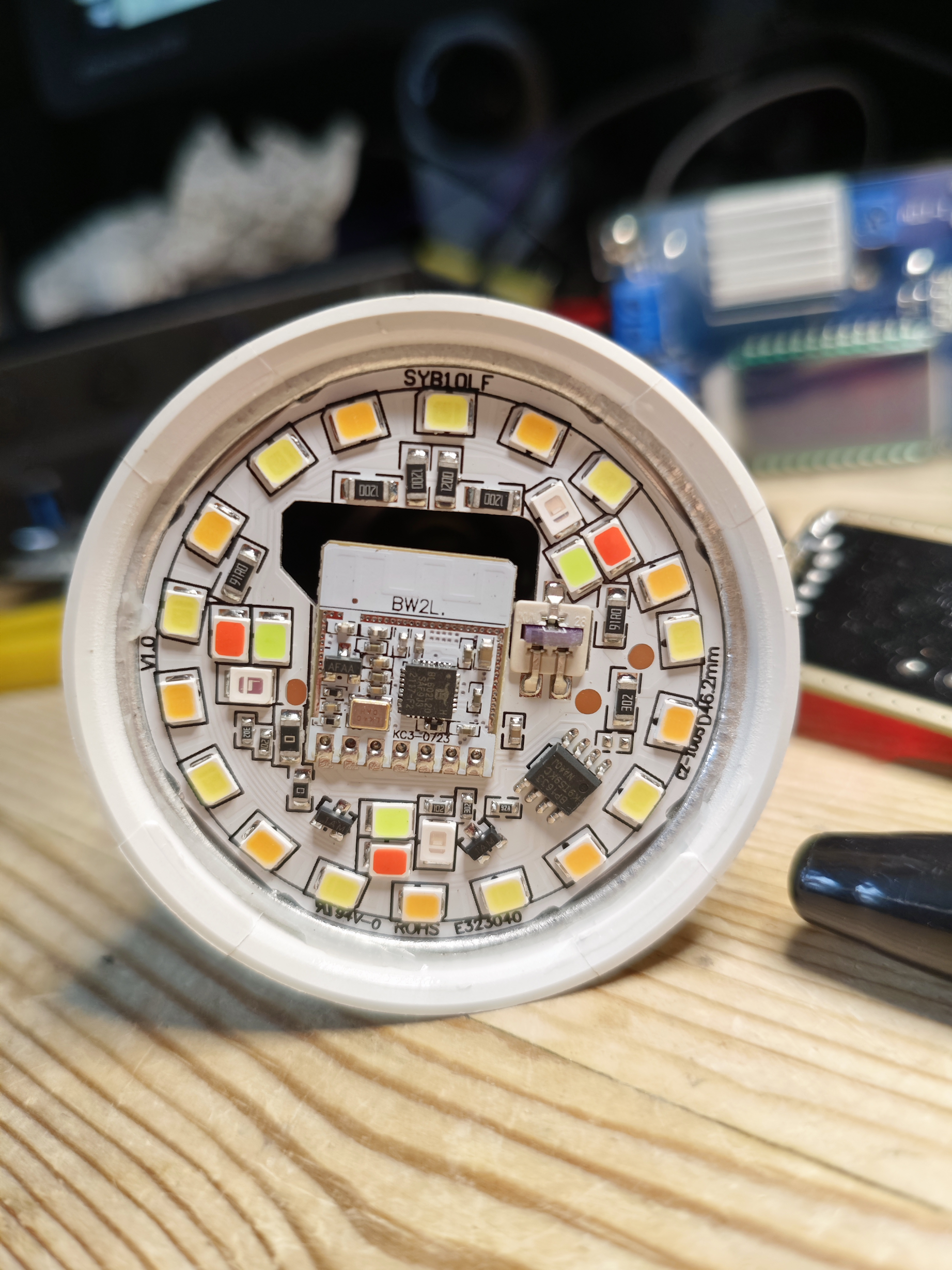

    Hardware setup - example BL602
    Here's BW2L module, as desoldered from eWeLink E14 candle RGBCW bulb. It has no pin markings, so we have to determine which pin is which. Luckily, we have our GPIO diagram, the one I made in previous section.
    Interior of a smart LED bulb with visible diodes and electronic components.

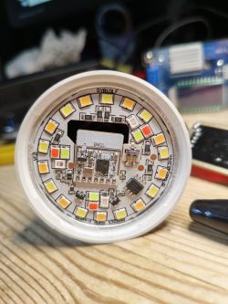

    Look what came today
    Close-up of a round circuit board with LEDs and electronic components.
  • #5 21470262
    Posts: 14797
    Rate: 12954
    Are you able to flash it? I may be posting flashing guide for this device soon, so if you manage to flash it on time, you could also add your experience there.
    And I still haven't figured out which pin is which, but I already have template for that bulb. It was not had, with GPIO Doctor...

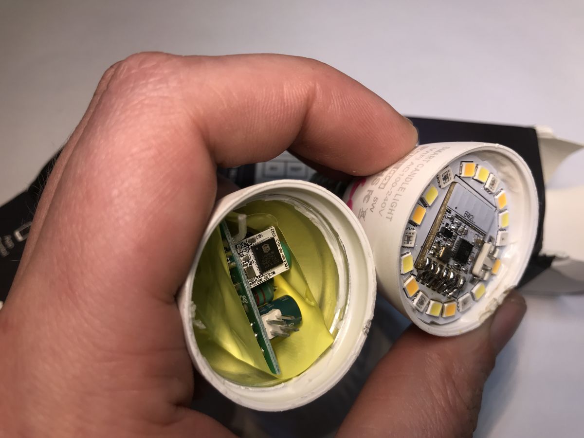

    It seems that I got the same bulb as you. So now I have E14 with BW2L and E27 with BW2L.
    https://github.com/openshwprojects/FlashDumps/commit/e44fbdfe8a41e4c0fdee07cb1c6a98e4eb5e290d

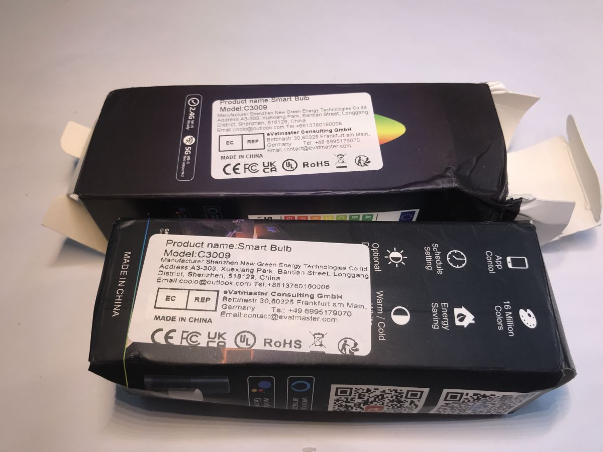

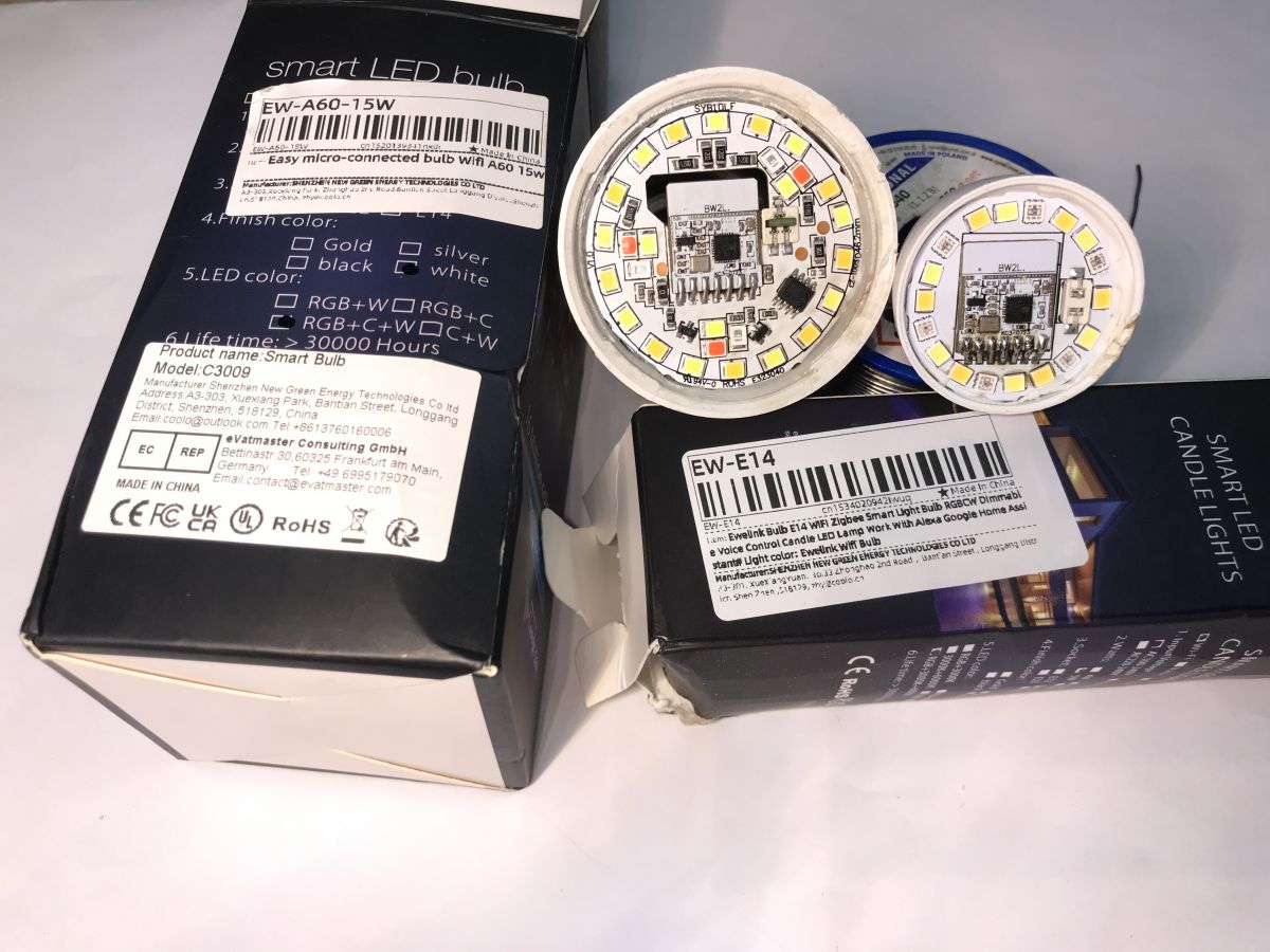

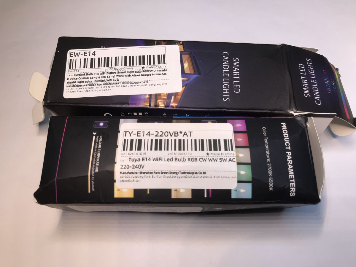

    Btw, did you know that C3009 marking is present on all three bulbs I have - two BW2L based from eWeLink and the Tuya one as well?
    Two LED bulbs with visible electronic circuits next to their packaging.
    Two LED E14 bulb packages with labels.
    Two boxes containing smart LED E14 bulbs.
    Smart bulb model C3009 packaging with visible product information.
    A person holding an open LED bulb showing the interior and electronic components.
    The meaningful marking is the prefix, for eWeLink I have, for example, EW-E14, and for Tuya, TY-E14...

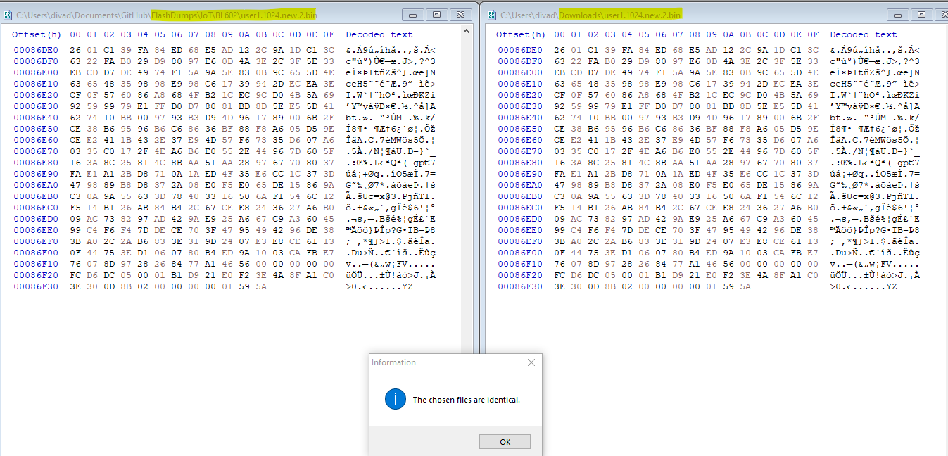

    yes. these two anyway. 1.5.0 not done yet. I guess our EW-A60-15Ws will be the same.

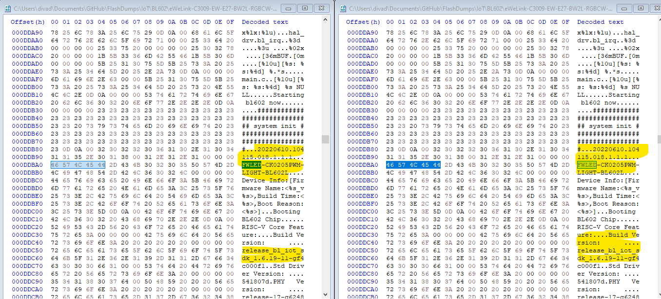

    eWeLink-C3009-EW-E27-BW2L-RGBCW-EW-A60-15W_(FWLED-CK0205PWM-LIGHT-BL602L_v1.1.1)_divadiow.bin
    eWeLink-C3009-EW-E27-BW2L-RGBCW-EW-A60-15W_(FWLED-CK0205PWM-LIGHT-BL602L_v1.1.1)_efuse_divadiow.bin
    Also interesting is that the E27 ota file is identical to the E14, so maybe there's some config part of the firmware that has device-specific schema or whatever for each type
    Comparison of two binary files using a text editor, both files are identical.
    Added after 3 [minutes]:
    our backups aren't identical but they look essentially the same
    View of hex editor showing segments of binary and textual data.

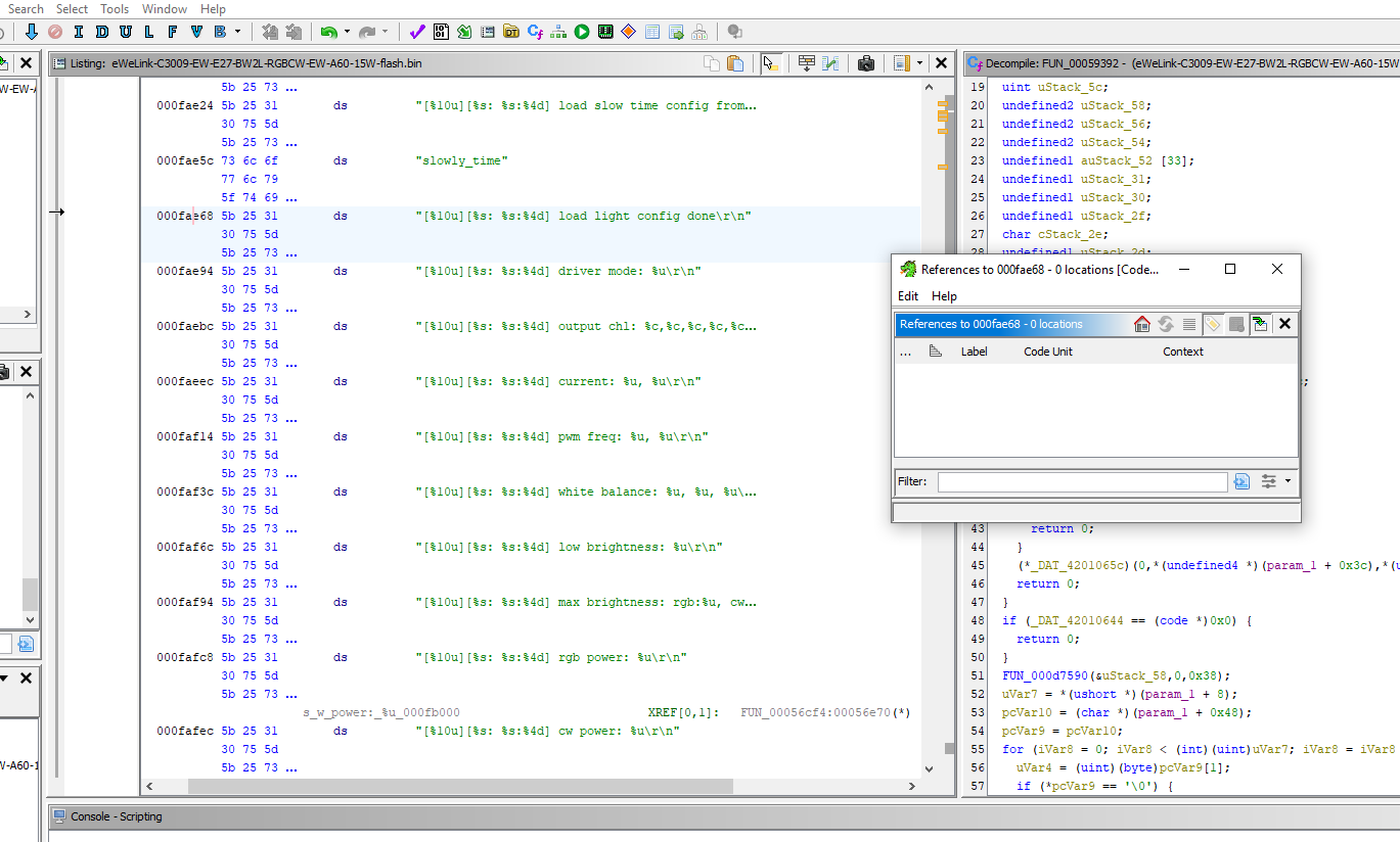

  • Suggesting Ghidra analysis of string references and data section
    #13 21474569
    Posts: 14797

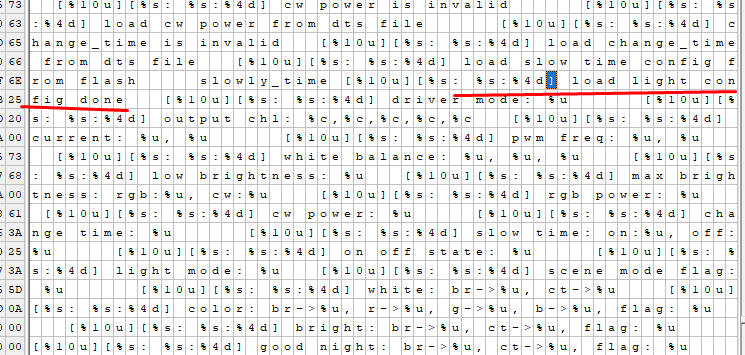

    Rate: 12954
    It has some string references like cw_power...
    Spreadsheet with text data and numerical values in a grid.
    Have you tried to load this binary in Ghidra or any other tool like that?
    Added after 43 [seconds]:
    Screenshot of a table with a summary of codes and text descriptions.
    Added after 11 [minutes]:
    @divadiow https://www.youtube.com/watch?v=3Ikn8Y775Lk
    Added after 16 [minutes]:
    I'm trying to find code that refers to those strings but Ghidra fails to find references:
    Screenshot of binary code analysis software.
    Data section?
    Hexadecimal view of a file with ASCII text next to it in a hex editor.

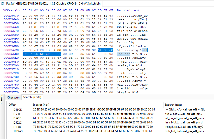

  • Questioning BL602 GPIO values from boot logs
    #14 21474627
    Posts: 5236
    Help: 450
    Rate: 920

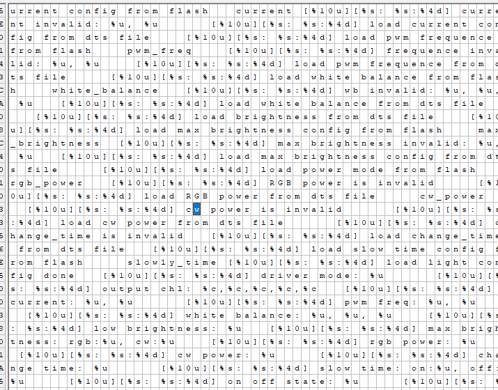

    Interesting. I'm also wondering if we can use what looks like the pin assignments in some BL602 boot logs as a reference point. eg
    https://www.elektroda.com/rtvforum/topic3945435.html#20987133
    I'm guessing 200 = not assigned or something.
    Screenshot of a hex editor showing binary data and their textual representation.
    but where's it actually retrieving the values from?
