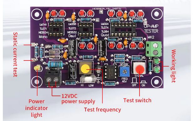

So much theory (deliberately simplified to the necessary minimum). In practice, the testers look like this:
Operational amplifier tester on a printed circuit board.
Operational amplifier test board on AliExpress.
And closer:
Operational amplifier tester with labeled components.
Both models work similarly. Both can check single, double and quadruple amplifiers. Both signal operation with LEDs connected to the outputs. And finally, both testers allow the widest variety of circuits to be tested quickly and reliably - provided they have typically spaced-out leads.

One of the testers (the one shown at the very beginning of the article) is a little more elaborate - it has a separate generator signal switch and generator control, plus the ability to operate in two frequency sub-bands for a more confident circuit check. Personally, I would recommend one for those of you who are (for now) "less involved" in electronics. We can also (this is a suggestion for the advanced) build a similar tester ourselves, according to the descriptions posted in this topic.
