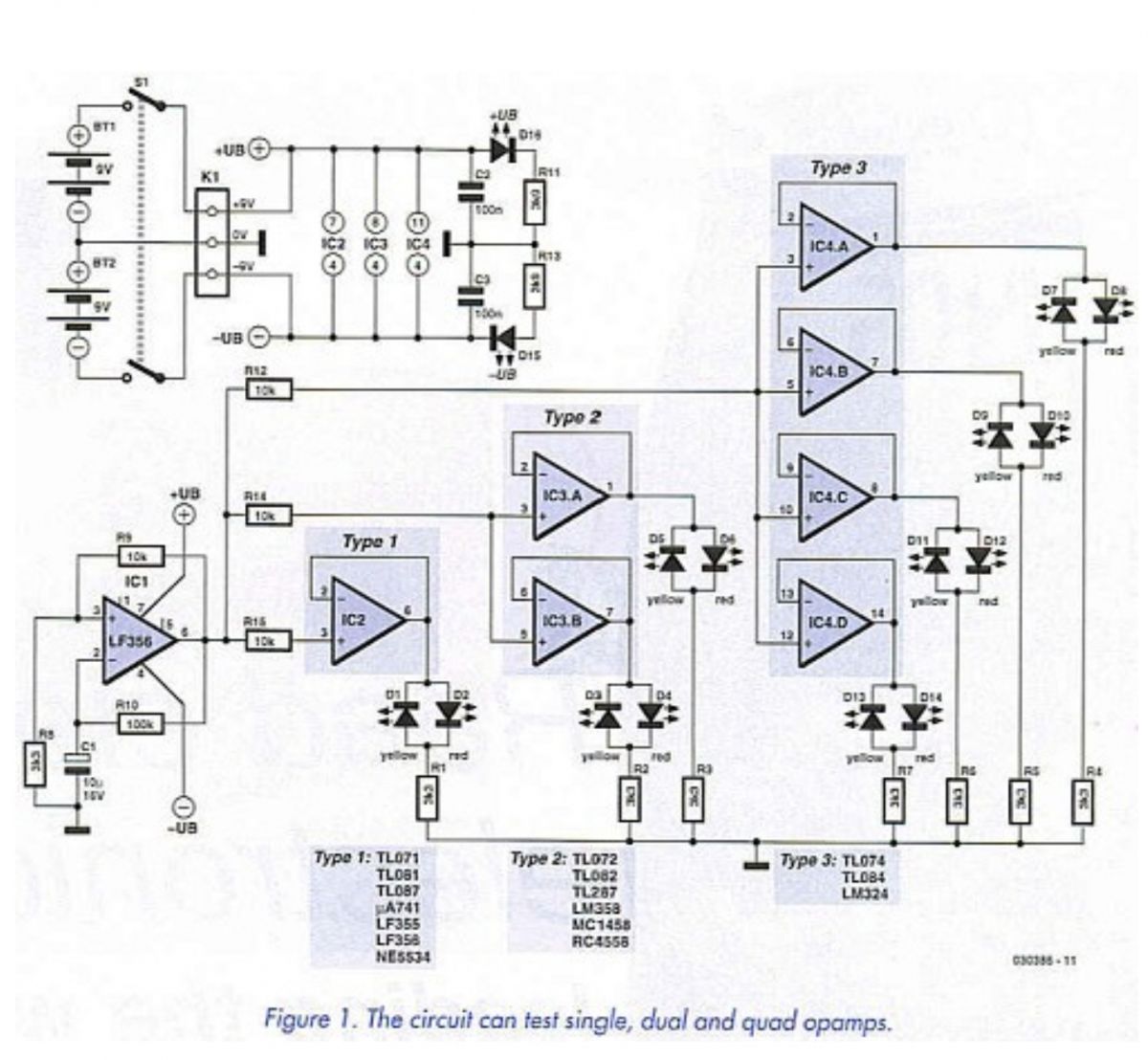

    maciej_333 wrote:
    Is there a schematic of this circuit somewhere? You could at least comment on what this circuit does and whether it has any use.
    I couldn't find a schematic of the Chinese kit, but quite possibly it is based on something similar:
    Circuit diagram for testing single, dual, and quad operational amplifiers. .

    acctr wrote:
    maciej_333 wrote:
    Is there a schematic of this circuit somewhere? You could at least comment on what this circuit does and if it has any use.
    It is already possible to talk. So here we have just a rectangular waveform generator on IC1 and individual operational amplifiers as secondaries. There are oppositely connected diodes on the outputs to show that there is a polarity change. Something like this is ingenious, but it's just a test to see if the operational amplifier is perhaps undamaged. No reliable test it is not.
    It is good that at least there are R12, R14 and R15. Question for the reader. Why were these resistors used? Let's leave aside the obvious answer that the amplifier under test has some sort of input short to the power supply.

    Not that I'm picking on you, but operating an LED in the reverse direction requires a catalogue check of the reverse voltage. I've had red ones like this that died already at 6V reverse voltage.
