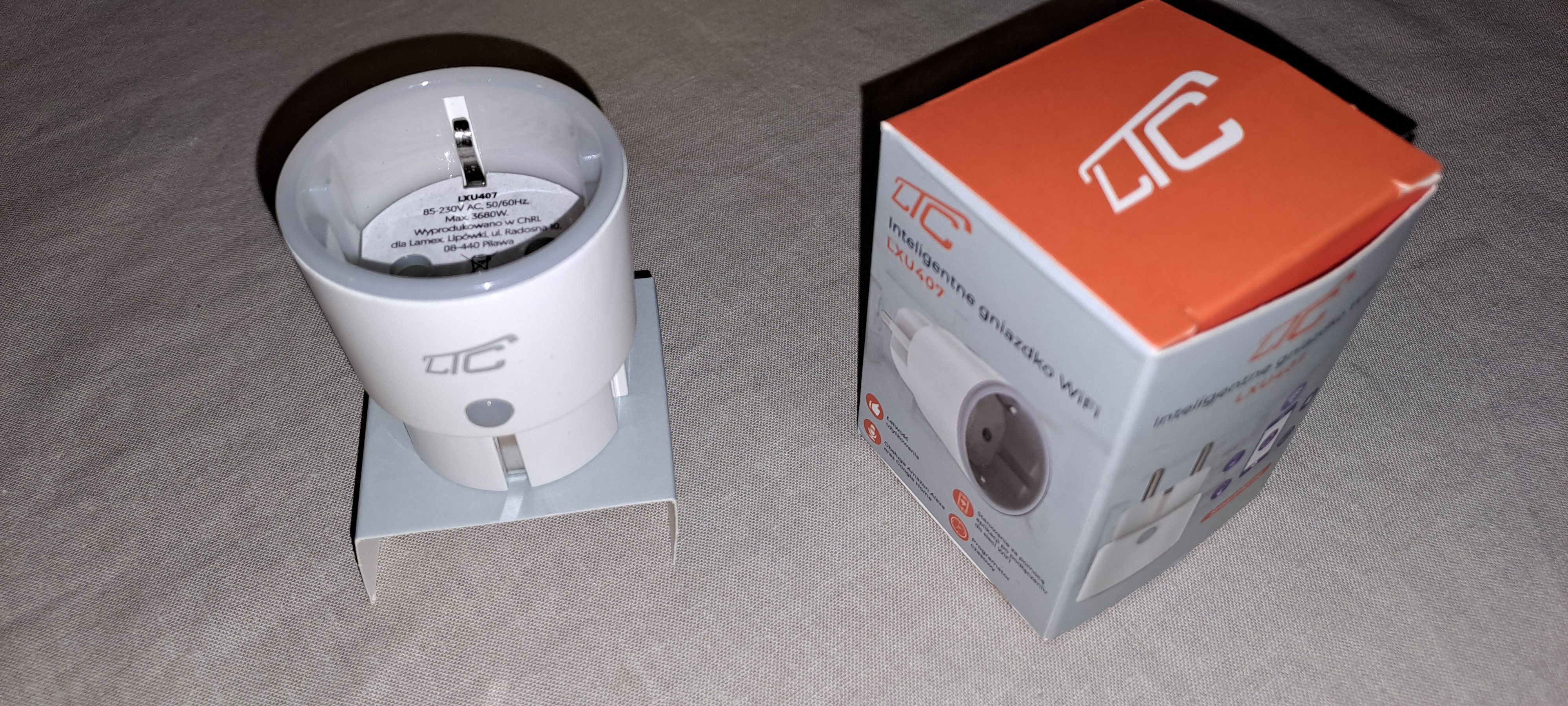

Good morning.
As I've been using a dozen or so smart sockets of one type for over two years, I've finally matured into trying to make them cloud free.
I use them for Home Assistant with LocalTuya integration (which in itself no longer requires the cloud), but I wanted to change the firmware completely.
The socket is quite compact (that's what I was looking for), with tuya-cloudcutter it is unfortunately impossible to sflash it (soft 1.1.8).
But to the edge. It looks like this:
Smart WiFi socket next to its original packaging on a table. .
Once I found the right way to open the case it went quite straightforward.
