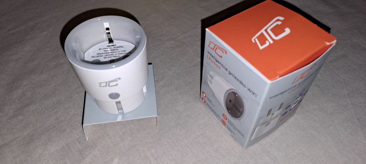

    The socket is quite compact (that's what I was looking for), with tuya-cloudcutter it is unfortunately impossible to sflash it (soft 1.1.8).
    But to the edge. It looks like this:
    Smart WiFi socket next to its original packaging on a table. .

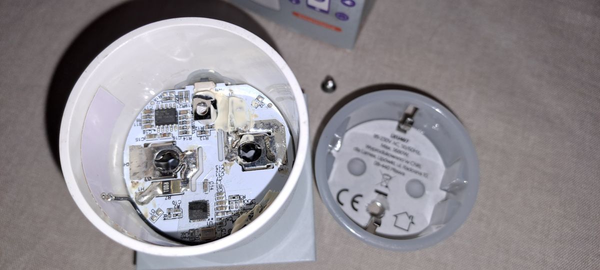

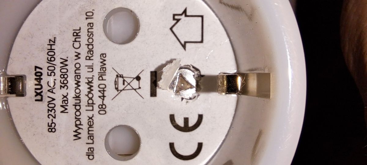

    Once I found the right way to open the case it went quite straightforward.
    Under the sticker is a screw with an unusual head (triangular keyway).
    View of the bottom part of a smart socket with the sticker removed, revealing a triangular screw head. .
    After unscrewing it and gently removing the top, the interior with the stick-on antenna begins to be visible.
    The image shows the interior of an opened smart plug, revealing the electronic circuit board. .

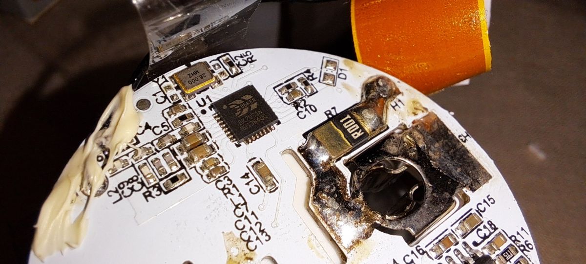

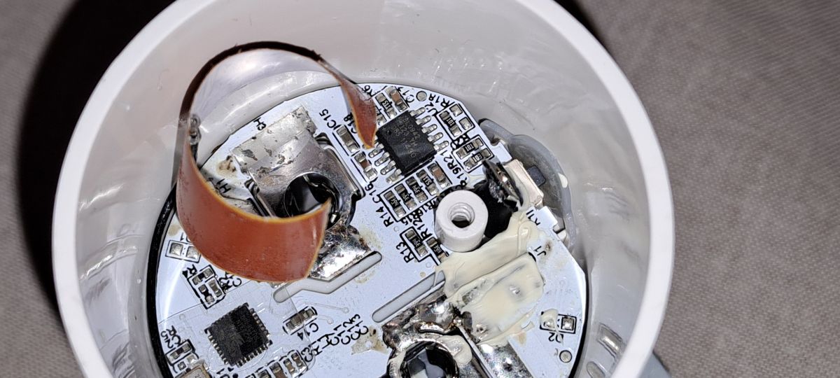

    You can already find the Beken chip, but I couldn't imagine flashing by touching the chip feet directly (but I was prepared to do so).
    However, after gently peeling off the antenna
    Interior of a dismantled smart socket showing electronics and a detached antenna.
    and placing the socket upside down with the pins and DELICIOUSLY treating them with a hammer, everything comes out nicely.
    Image of the interior of a dismantled smart socket with visible electronic components. .
    It remains to be seen what this has on board - BK7231N and BL0942.
    Close-up of a circuit board featuring a Beken BK7231N chip and other electronic components. .

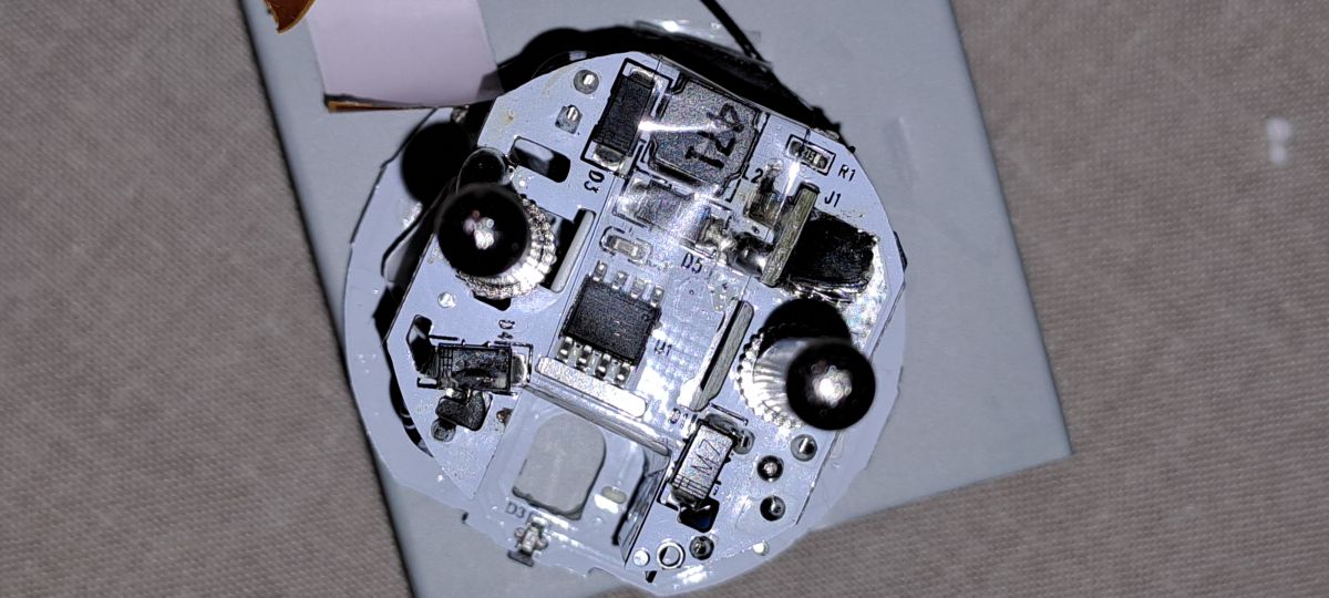

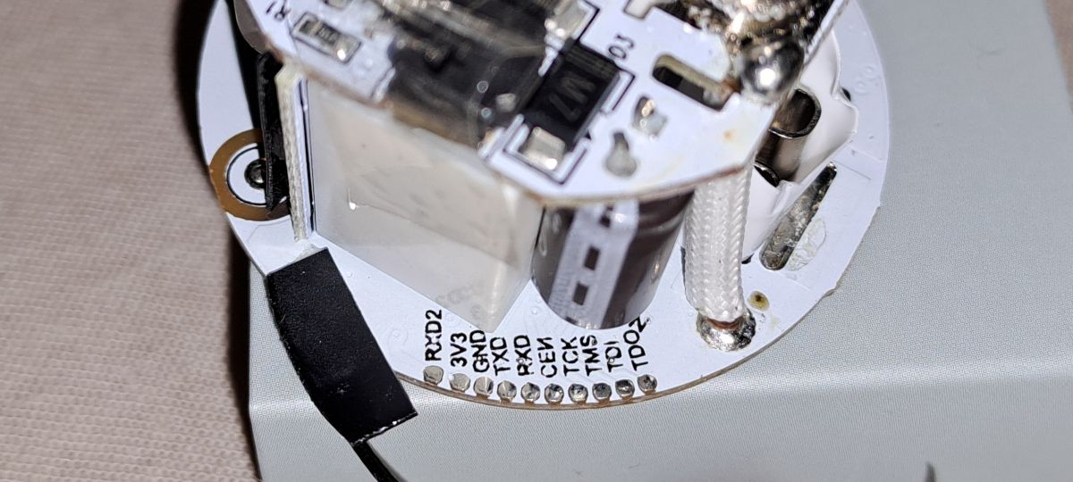

    The best hides on the opposite side of the board where the chip is.
    Inside of a disassembled smart plug showing a circuit board.

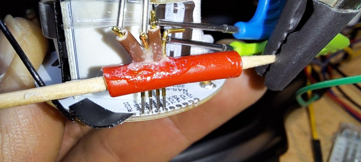

    This is where simple flashing remains. It is possible to solder, but I, due to the large number of devices to be reworked, went for spring-loaded pins (pogo-pin) type P50-B1, available on a large Polish shopping portal.
    Interior of a smart socket with connected pogo pins. .
    Pin configuration:
    pin 6 - LED_n 1 / WifiLED_n
    pin 9 - Btn 1
    pin 26 - Rel 1
    Startup script:
    backlog PowerSave 1; startDriver B0942
    I still use
    alias mode_wifi setPinRole 6 WifiLED_n
    alias mode_relay backlog setPinRole 6 LED_n; SetPinChannel 6 1;
    mode_wifi
    addChangeHandler WiFiState == 4 mode_wifi
    addChangeHandler WiFiState != 4 mode_relay

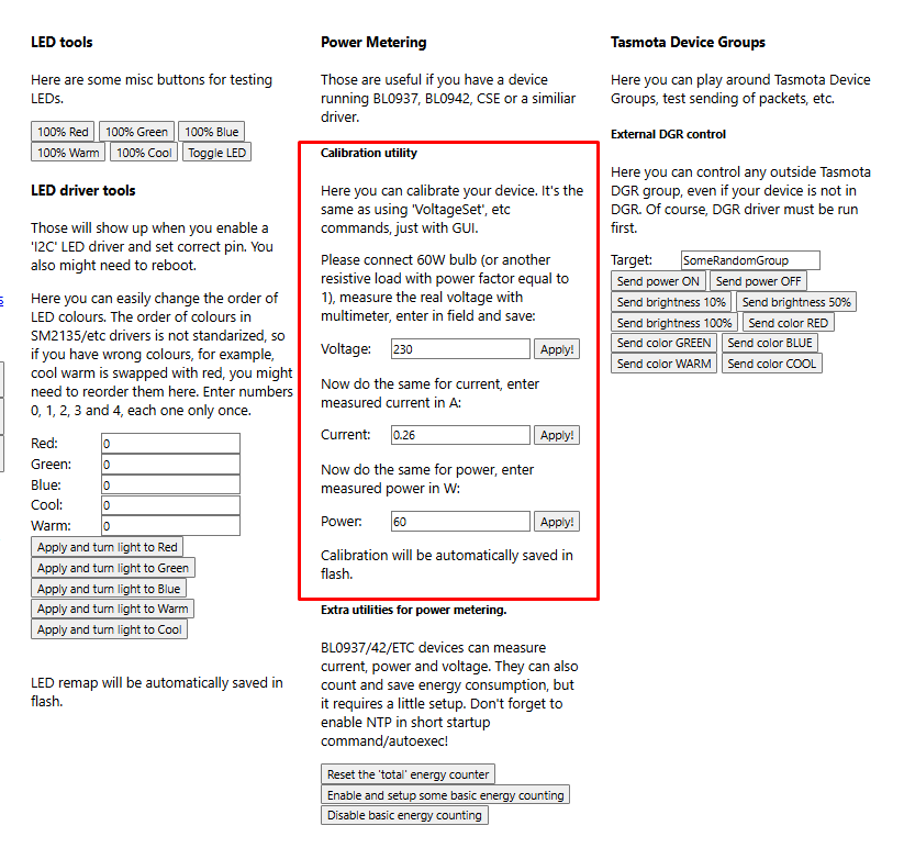

    I noticed that the voltage indication is not very accurate (usually overestimated), so calibration is rather advisable.

    Calibration is always a must, this can be done via WebApp:
    Calibration panel for devices in Tasmota software. .

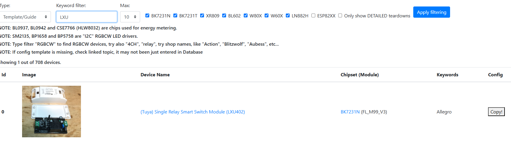

    You should immediately be able to search for this device here:
    By the way, where did you buy them? I saw the LXU series on our Polish auction portal.
    Screenshot of the device list in the OpenBeken web application. .

Why does the voltage reading on the LTC LXU407 with BL0942 appear too high after flashing, and how should I calibrate it?
The voltage reads high because the raw post-flash measurement is not calibrated for this hardware. The thread states that voltage was usually overestimated and that calibration is required, with WebApp calibration described as easy and recommended after conversion, especially when doing several plugs in one batch. [#21474910]
