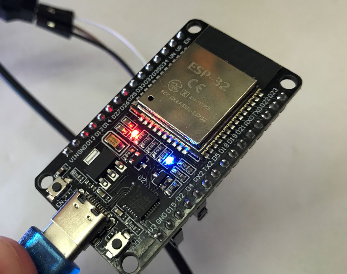

This time I will make the program based on ESP32:
ESP32 module with USB cable connected and lit LED lights. .
I start the presentation with my classic code integrating WiFiManager and OTA (batch update via WiFi):

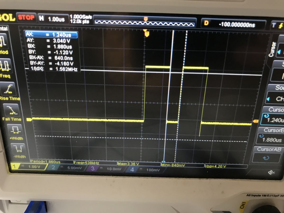

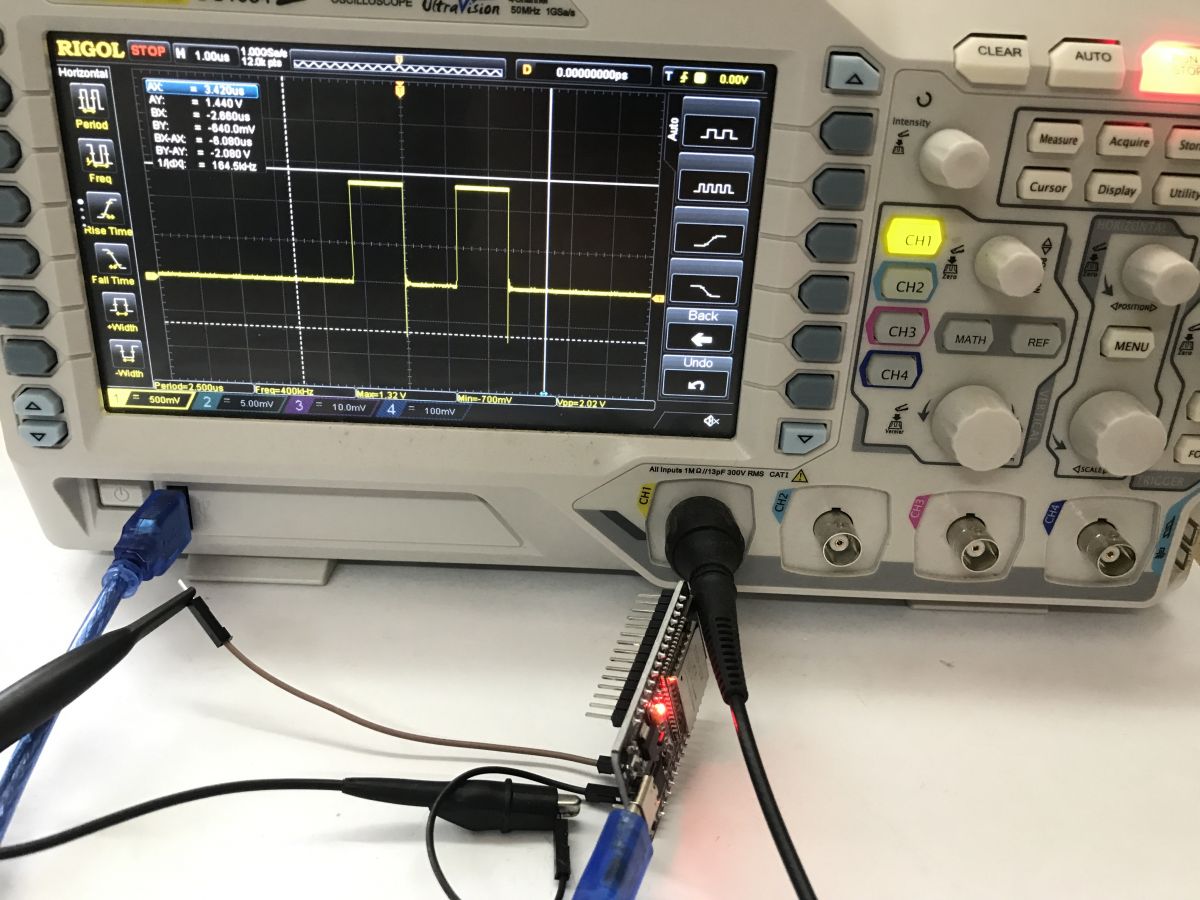

Now the oscilloscope can be connected. You will need Single mode, pulse trigger, we need to catch that moment when the ESP will send the data:
Oscilloscope displaying signal waveform with connected ESP32. .
Oscilloscope screen showing waveform signals from a Rigol oscilloscope. .
I used the Cursor function to measure the mileage. It is fine, the error is negligible (I manually set it). Everything works, now you can experiment.

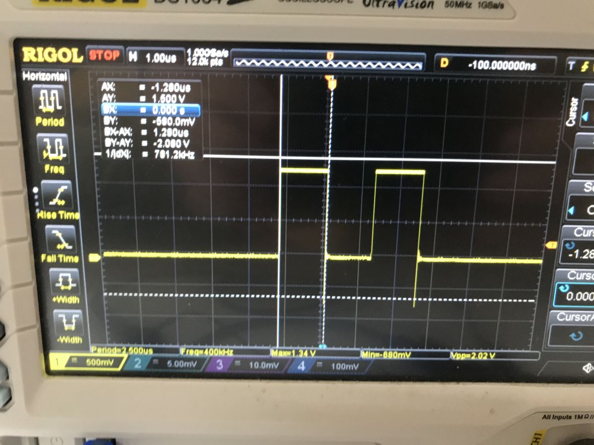

Shorter low state of the first cycle:
Code: C / C++
Oscilloscope screenshot showing signal waveforms from ESP32. .

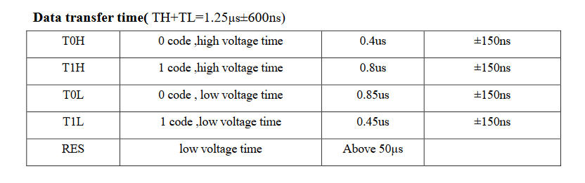

It is time to convert this to support WS2812B. We start by reading the catalogue note:
Table showing data transfer times for WS2812B. .
First we have T0H - 0.4us. How many cycles will 0.4us be? 0.4us/25ns = 16.
Similarly, we count the remaining times. I came out with:
Code: C / C++

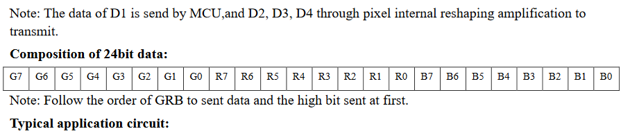

The WS2812B uses 8-bit RGB. In total we have 24 bits - 8 bits per channel. We will therefore need 24 objects of the rmt_item32_t structure.
Code: C / C++

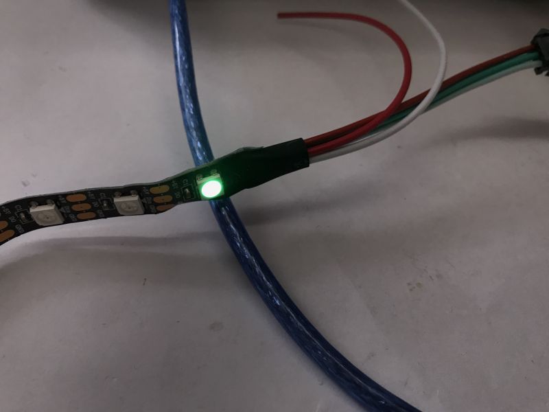

I have added to the main loop:
Code: C / C++
Flashes green... well, yes, but it's not an error. The format expected is GRB.

Diagram showing the composition of 24-bit data for WS2812B .
That's two colours now:

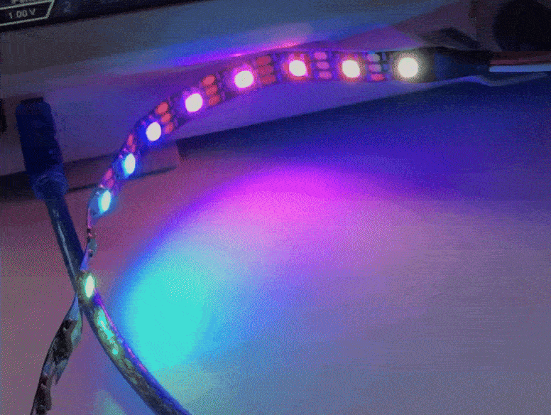

The next step is to generalise the case for N pixels, or perhaps even better, for N bytes, as some bars are in RGBW format.
Code: C / C++

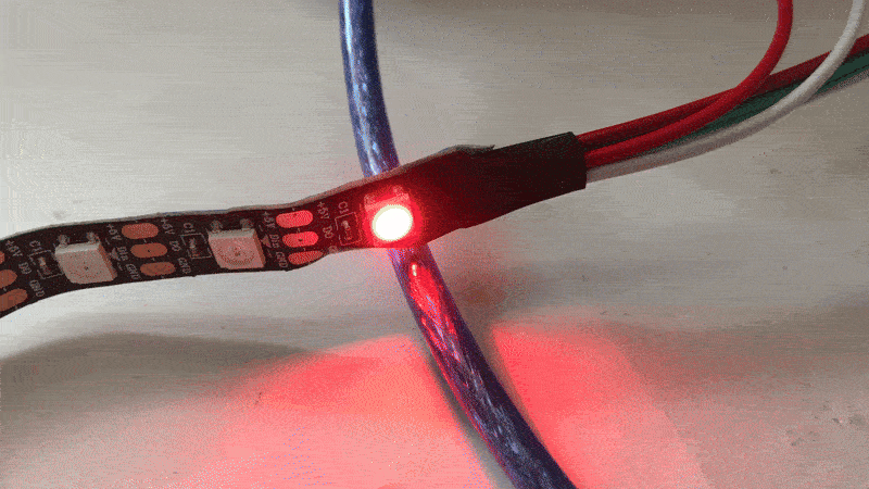

This way you can do effects where each pixel has a different colour:
Code: C / C++

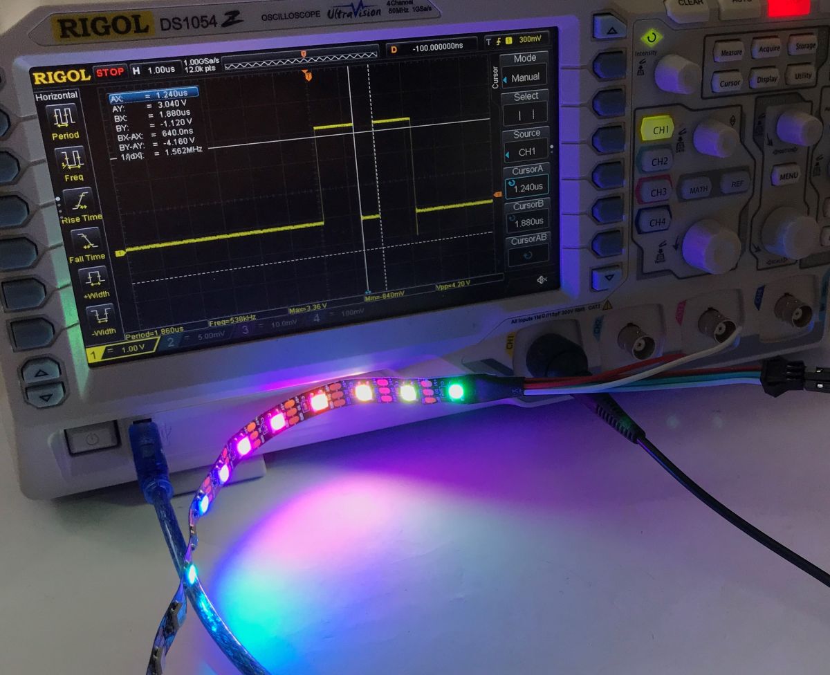

Step is a counter which specifies the current frame of the animation.
Flashing WS2812B LED strip connected to an oscilloscope with ESP32. .
You could also use HSV and make a better animation as in WLED, but that's a bit beyond the scope of this topic:
Code: C / C++

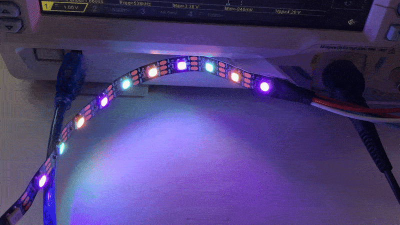

The result:
Flashing LED strip with WS2812B LEDs .
