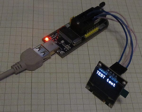

I would like to present an application that is a collection of test tools using CH341 as a physical interface.

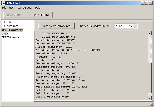

The original purpose of this application was to repair laptop batteries.
However, I had to familiarise myself with the CH341 chip beforehand, I started with more elementary functions like I2C support and the application took the form of a collection of loosely related modules.
Programming the smart battery turned out to be more complicated than I expected and, given that I only have a few such batteries, I stopped at reading their parameters for the time being.
Screenshot of CH341A Tool application showing smart battery information. .
What emerged from this, however, was a tool with a wider range of functions, reminiscent of Bus Pirate.

- smart battery status reading

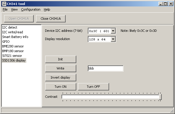

- support of displays: HD44780 directly and via PCF8574, SSD1306, MAX7219 8x8 LED, CH455 LED from a DVB-T decoder

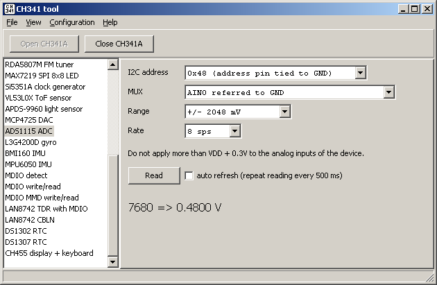

- support for the MCP4725 DAC and ADC ADS1115

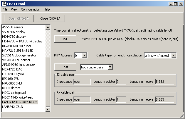

- read/write of ETH PHY registers via MDIO interface (Clause 22 + MMD)
- support for Ethernet cable length measurement function via LAN8742 (TDR + CBLN)

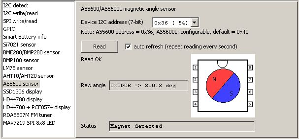

Some screenshots and photos:

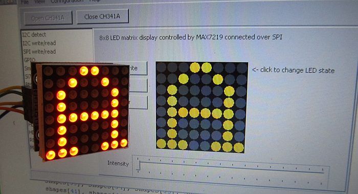

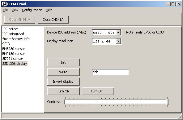

Screenshot of the CH341 tool application interface for managing I2C devices. .
CH341 module with OLED display showing text. .
8x8 LED matrix controlled by MAX7219 with application on screen .

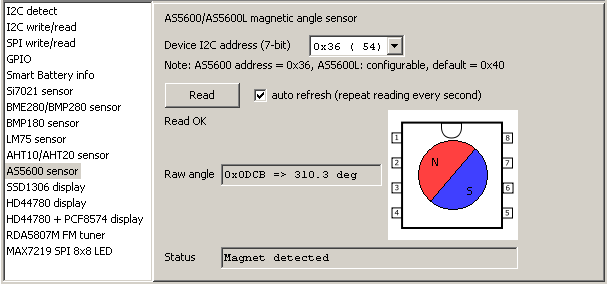

Test application interface with CH341 chip supporting AS5600/AS5600L sensor .
Screenshot of the CH341 tool application with user interface. .

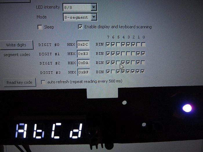

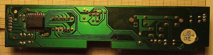

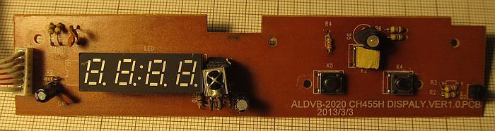

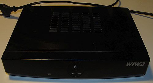

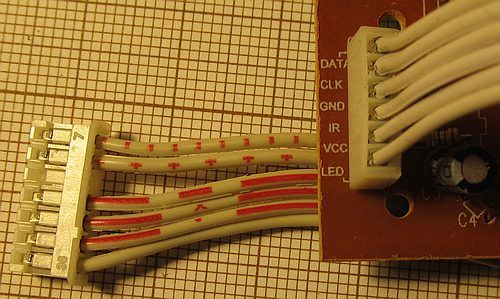

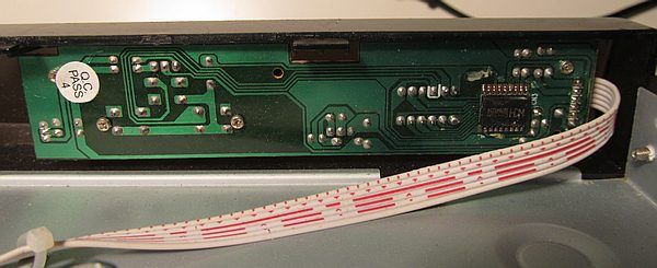

I found out about the CH455 LED and keypad controller from the topic https://www.elektroda.pl/rtvforum/topic4066595.html, but in my case the "donor" was a WIWA HD-102 (burnt out power supply even before switching to DVB-T2) in which the display with the controller is placed on a separate board connected by tape.
Black WIWA HD-102 set-top box with power button and channel buttons on the front panel. .
Close-up of a circuit board controller with a ribbon cable. .
LED display module with buttons and electronic components. .
Close-up of a circuit board with an integrated circuit and tracks. .
Close-up of a circuit board with attached wires. .
Curiosity: clearly "burnt" segments of the display where "C" was displayed as "CHANNEL":
Segmented LED display and application interface with segment settings. .
This is already most of the electronic trinket I have that can be handled.

kassans 23 May 2026 21:11
Great programme! Could still add support for HD44780 i2C, LCD from Nokia 5110, DS18B20. [Read more]
ostrytomasz 23 May 2026 21:39
HD44780 + PCF8574 (as well as connected directly, requiring a few more lines) is: https://obrazki.elektroda.pl/5631942200_1779564055_bigthumb.jpg I hadn't thought about the display from the... [Read more]
kassans 23 May 2026 21:50
In fact, somewhere these screens from the Nokia 5110 have become extinct and it's a shame. [Read more]
ostrytomasz 23 May 2026 22:05
Because the Nokias themselves are also extinct.... There are still some of these displays in the Chinese and they can still be useful due to their fairly low power consumption, but the choice of cheap... [Read more]
Michal2002 03 Jun 2026 08:34
You could add some unusual RF layouts. [Read more]
ostrytomasz 03 Jun 2026 18:32
Any examples? I suppose this could be a problem, I rather need to test what I write, an untested tool would be of no value. The other problem with radio technology is the rather specialised tools and skills... [Read more]
Michal2002 04 Jun 2026 16:07
E.g. Si4735 , DSP - ADAU1701. I don't think much is needed. A development tool can be quite useful even for designers. [Read more]
