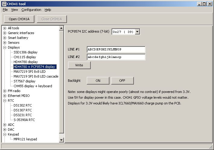

    What emerged from this, however, was a tool with a wider range of functions, reminiscent of Bus Pirate.
    Currently (version 1.04) funcionality includes:
    - detection of I2C devices
    - writing/reading raw data using I2C, SPI
    - smart battery status reading
    - sensor support: BME280/BMP280, Si7021, BMP180, SHT11, LM75, AHT10/AHT20, AS5600, APDS-9960, L3G4200D, BMI160, MPU6050, VL53L0X
    - support of displays: HD44780 directly and via PCF8574, SSD1306, MAX7219 8x8 LED, CH455 LED from a DVB-T decoder
    - support for Si5351A generator
    - support for FM tuner RDA5807M
    - support for RTC DS1302 and DS1307
    - support for the MCP4725 DAC and ADC ADS1115
    - read/write of ETH PHY registers via MDIO interface (Clause 22 + MMD)
    - support for Ethernet cable length measurement function via LAN8742 (TDR + CBLN)

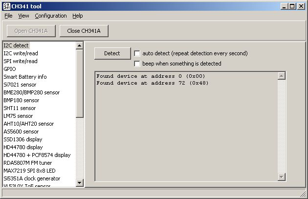

    A simple, small, multi-purpose and multi-purpose programmer - these are the kind of tools that prove most useful. I have suggestions for changes/improvements:
    1. the scanner could scan the entire address range of devices on the I2C bus ($00-$7F) and present the result in graphical form - the detected device denoted by a given symbol, placed in the corresponding 0-7 row and 0-F column. This kind of presentation is clear and allows you to quickly determine the addresses of detected devices. I used it myself in my scanner ( Link ).
    2. an option could be added to the program to identify the type of OLED display driver (SSD1306/SH1106/SH1107), based on the identification value read from its status register (status register, address $00). This detection method uses the "ss_oled 4.3.1" library for Arduino ( Link ). The first read of the status register may fail (for example, this is the case with the SH1106 controller), but the second read always returns the correct value.
    The documentation of the SSD1306 controller does not contain a description of the identification value returned (all bits "Reserved"), and also informs that it is not possible to read this register via the serial interface (I2C). Nevertheless, it can be read along with an undocumented identification value, from which the type of display driver can be determined. The returned values are (lower 6 bits): $03/$06 = SSD1306, $07/$0F = SH1107, $08 = SH1106. Additionally, some of the new 128x32/128x64 OLED display modules I currently have return values of: $02/$04 - according to my information and practical experience, these indicate an SSD1315 controller completely compatible with the SSD1306. I'm also curious as to what value a display with an SSD1309 driver returns - I'll check this as soon as I get my hands on one.

    RomanWorkshop wrote:
    1. The scanner could scan the entire address range of devices on the I2C bus ($00-$7F) and present the result in graphical form - the detected device denoted by a given symbol, placed in the corresponding row 0-7 and column 0-F. This kind of presentation is clear and allows you to quickly determine the addresses of detected devices. I have used it myself in my scanner (Link).
    It does indeed fit very nicely on a small graphical display (and the Linux i2cdetect presents it similarly), but I think the text form is more practical in this case. As I look at it now, it would be possible to add a value in binary form for convenience, because sometimes that's the only thing in the documentation (I just happen to have a pdf of the MAX11601 in front of me) and I myself have sometimes got stuck by confusing 7- and 8-bit conventions.
    Screenshot of CH341A tool showing an interface for detecting I2C devices. .
    I used to think about trying to detect the type of chip based on an address (or set of addresses), but the effectiveness and, above all, the desirability of this seems debatable to me at the moment.

    ostrytomasz wrote:
    This does indeed fit very nicely on a small graphical display (and is similarly presented by the Linux i2cdetect), but I think the text form is more practical in this case.
    You could always add a switch of how the detected devices are presented, as both can be useful in practice.
    ostrytomasz wrote:
    I used to think about trying to detect a circuit type based on an address (or set of addresses), but the effectiveness and above all the desirability of this seems debatable to me for now.
    Detecting a particular chip just based on its address is not possible, because many of them use the same addresses. The author of the library Bit Bang I2C recognises a specific device based on its address and the values read from its specific registers. Such detection makes some sense, but only for the most popular chips/sensors. By the way, I've started making a simple database of I2C chip/device addresses - I'm somewhere in the middle of the current offerings from one of the chip companies and already have over 300 chips. I wonder how many chips with an I2C interface have been produced in the world so far? Probably going to be a couple of thousand, which means I'm still a bit down ;) .

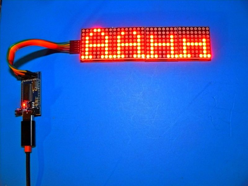

    ostrytomasz wrote:
    Support for a given system is most often limited to basic or selected functions, allowing testing but not necessarily giving access to all capabilities.
    Right. Your program is good for quick component tests, without the need to compile examples from Arduino for example.
    Just now I checked a 4xMAX7219 display I bought from the Chinese with your program and the result seemed strange at first glance:
    4xMAX7219 display showing HMMM with a controller. .
    But after looking into the DS of this MAX, it came out that everything is as ok as it should be.
    It's also cool that your programme is growing.

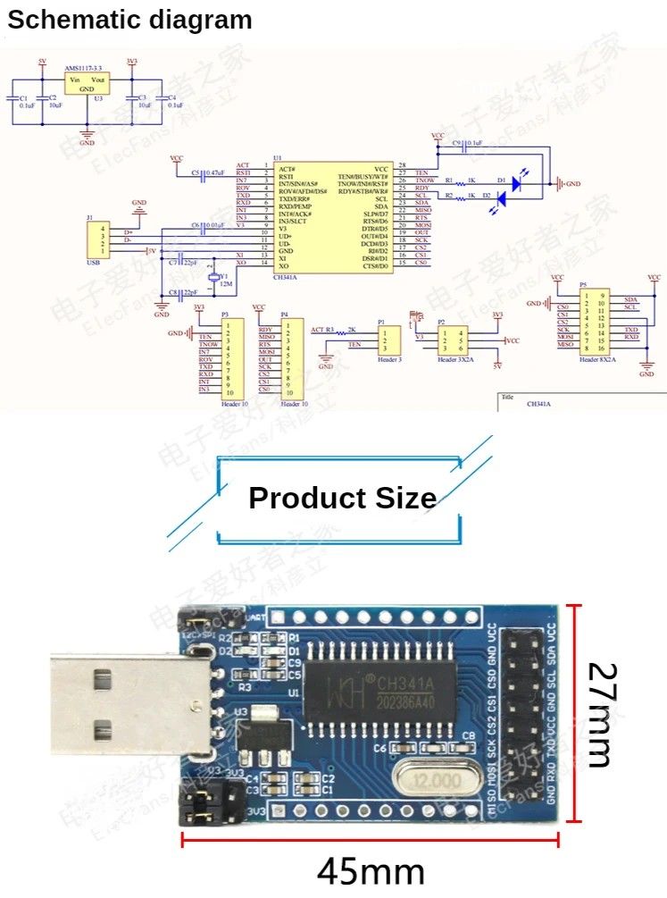

    There is one problem with this topic though, that the CH341A is associated with these particular memory programmer boards. Which are simply faulty by design and the first action after purchase is to cure them. I see from the pictures that your board is also corrected.
    But I would like to point out here that for use as a component tester with your software, CH341A boards are more suitable, but in the version without ZIF socket. For example such as I use myself.
    Here it is with a little unclear schematic, but I could not find a better one:
    Schematic of the CH341A circuit and its dimensions. .
    Switching the logic and power supply voltages of the circuit under test (3.3V, 5V) is correct and convenient. The rest of the features in use as a tester, are the same as this unfortunate programmer board.

    rb401 wrote:
    Just now I was checking a 4xMAX7219 display I bought from the Chinese with your program and the result seemed strange at first glance:
    I haven't thought about series bonding unfortunately - I only have one piece for now. Looks like an empty byte needs to be added on the transitions.
    But I would like to point out here that for use as a component tester with your software, the CH341A boards are more suitable, but in the version without the ZIF socket.
    I plan to add one to my next order from ali too - a bit as a spare, a bit for convenience and availability of (I think) all pins.

    ostrytomasz wrote:
    I haven't thought about linking in series unfortunately - I only have one piece so far. It looks as if you need to add an empty byte on the transitions.
    This is not a nuisance. You only need to additionally press the Write key once so that those words left in the shift registers of the previous cubes reach those cubes displaying the incomplete image and it is ok.
    So it is perfectly possible to test such multiple displays with your program.
    It is just a matter of not immediately panicking when you see missing lines on the right-hand displays that maybe the Chinese have inserted the LED matrix wrongly in the socket or have not soldered something in.
    But in fact, adding some No-Op (i.e. e.g. 16 zero bits) at the end of each transfer would probably not hurt and would eliminate this effect.

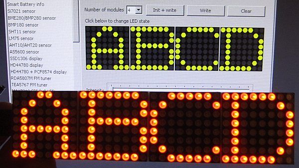

    List of changes in version 1.5.0:
    - added ADC MAX11601
    - added TEA5767 FM tuner
    - added RTC S35390A
    - rTC DS3231 added
    - added LCD display ST7567
    CH341 à la Bus Pirate - cheap and moderately useful
    - added support for cascaded 8x8 LED displays with MAX7219 (up to 4 units)

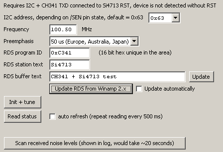

    - additional configuration options when detecting I2C (scan range limitation, interval) to facilitate oscilloscope triggering
    - pins used for MDIO transmission replaced with electrically safer SCL + SDA set (external resistor redundant)
    - added VEML7700 illumination sensor

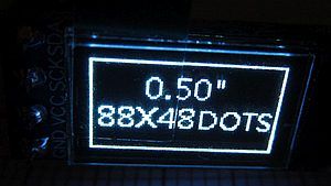

    - cH1115 48x88px 0.5" OLED display added

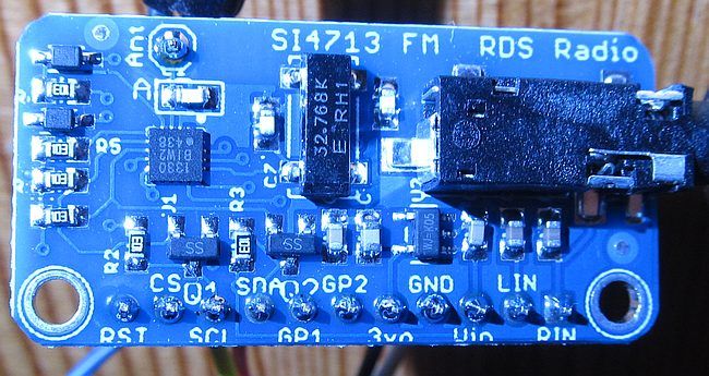

    - si4713 FM transmitter added; option to download text to RDS from Winamp 2.x
    CH341 à la Bus Pirate - cheap and moderately useful added FM transmitter

    Great programme! Could still add support for HD44780 i2C, LCD from Nokia 5110, DS18B20.

    kassans wrote:
    May still add support for HD44780 i2C, LCD from Nokia 5110, DS18B20.
    HD44780 + PCF8574 (as well as connected directly, requiring a few more lines) is:
    Screenshot of “CH341 tool” with “HD44780 + PCF8574 display” selected and text line input fields.
    I hadn't thought about the display from the 5110, I don't have one at the moment and I guess they are no longer attractively priced at the moment. The DS18B20 (1-wire in general) is probably unfortunately not doable due to its timing requirements and the limitations of the CH341 (similar to e.g. WS2812 support, even in UART mode where a stop bit is dragged at higher baudrates).
    In version 1.7.0, the tools have been categorised (as shown above), SHT4x readout, TSL2591 light sensor, MPR121 keypad and KT0803L FM transmitter control added.

  • #18 21915481
    Michal2002
    Posts: 1361
    Help: 18
    Rate: 179
    E.g. Si4735 , DSP - ADAU1701. I don't think much is needed. A development tool can be quite useful even for designers.
