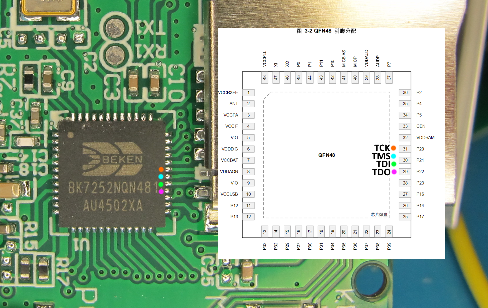

  • The internals use a Beken BK7252NQN481, with TX1/RX1 UART access and pads for TDI, TDO, TMS, and TCK for boot-log capture and flash backup.

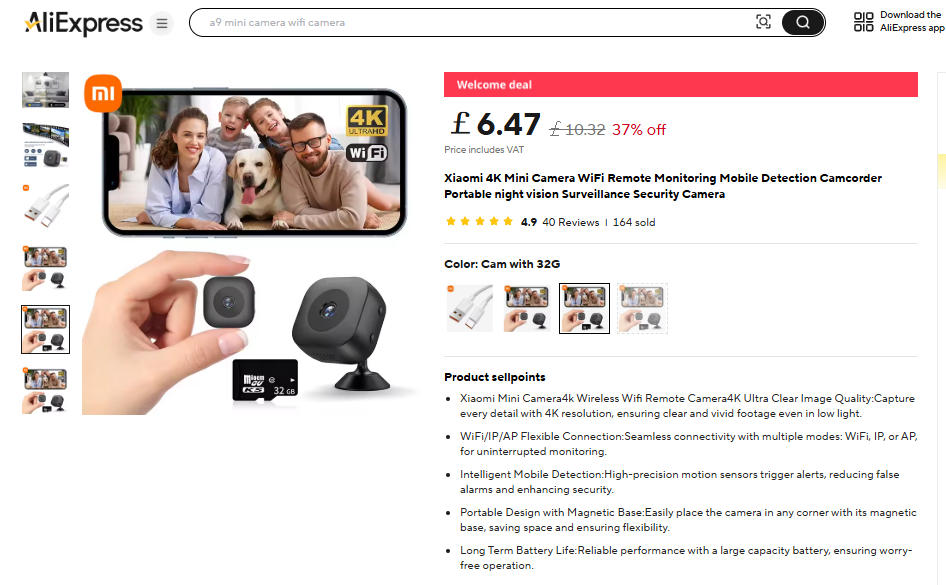

The ubiquitous A9 Mini Wi-Fi Camera, in its seemingly many forms, is a compact, budget-friendly smart surveillance device, often seen for as low as $1USD as a Welcome Deal on sites like Ali Express. Positioned as a security camera, baby monitor, spycam, camcorder, it is often advertised by sellers as being 4K, having night-vision/infra-red, AI, motion detection. It can usually be said that one or more of these claims is false or at best, exaggerated. The device that is the subject of this post is listed with these "sellpoints" on Ali:
-Xiaomi Mini Camera4k Wireless Wifi Remote Camera4K Ultra Clear Image Quality:Capture every detail with 4K resolution, ensuring clear and vivid footage even in low light.
-WiFi/IP/AP Flexible Connection:Seamless connectivity with multiple modes: WiFi, IP, or AP, for uninterrupted monitoring.
-Intelligent Mobile Detection:High-precision motion sensors trigger alerts, reducing false alarms and enhancing security.
-Portable Design with Magnetic Base:Easily place the camera in any corner with its magnetic base, saving space and ensuring flexibility.
-Long Term Battery Life:Reliable performance with a large capacity battery, ensuring worry-free operation.
I am immediately sceptical about it being 4K and having anything to do with Xiaomi!
My device was sourced from Ali here https://www.aliexpress.com/item/1005008584918966.html

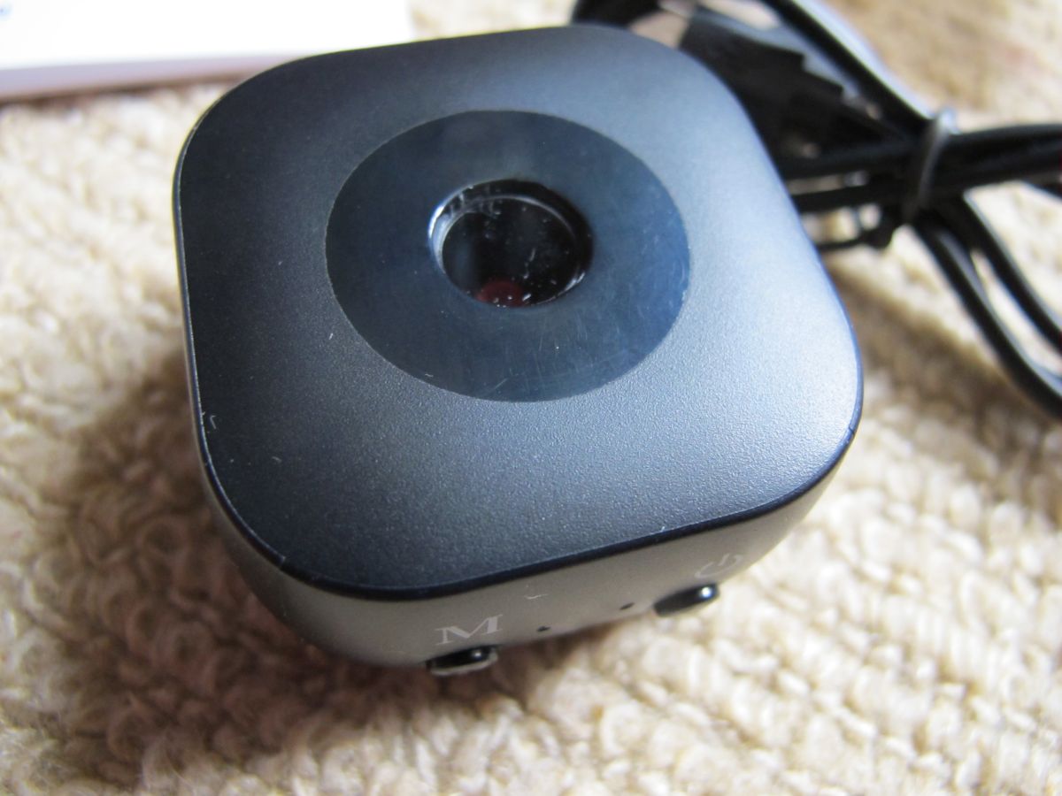

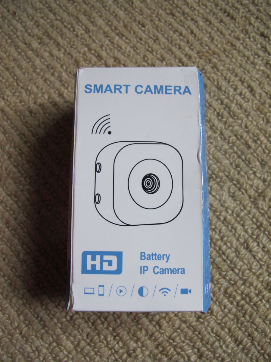

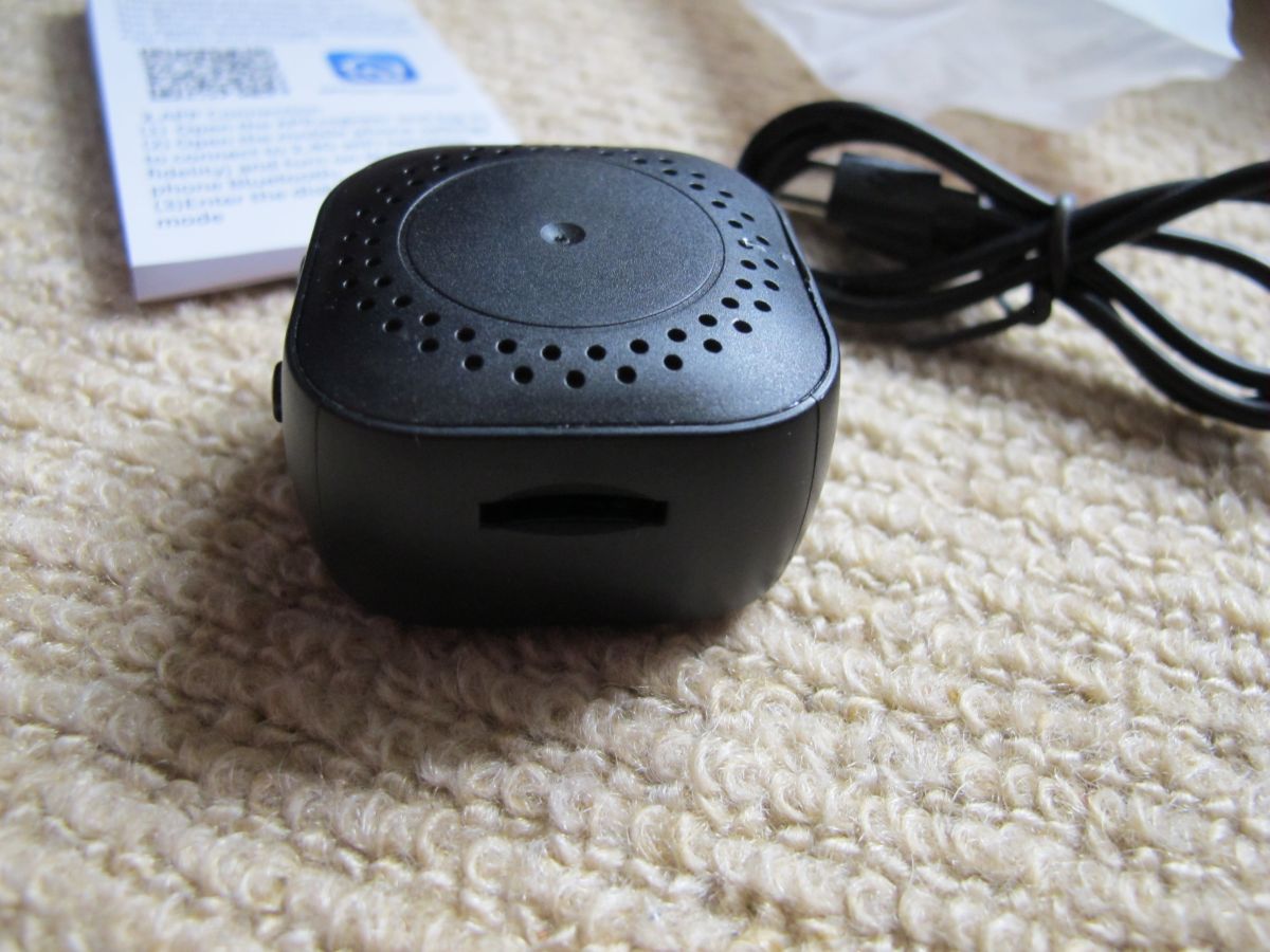

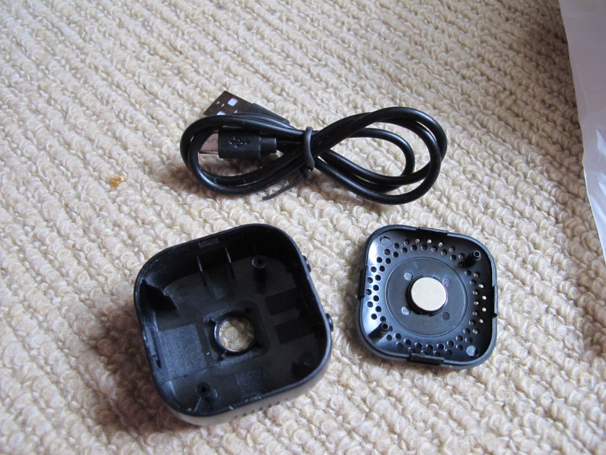

I'll now start by documenting the packaging and device before diving into the internals. Subsequent posts will detail the pairing/app user experience, as well as providing real images and videos created by the device.

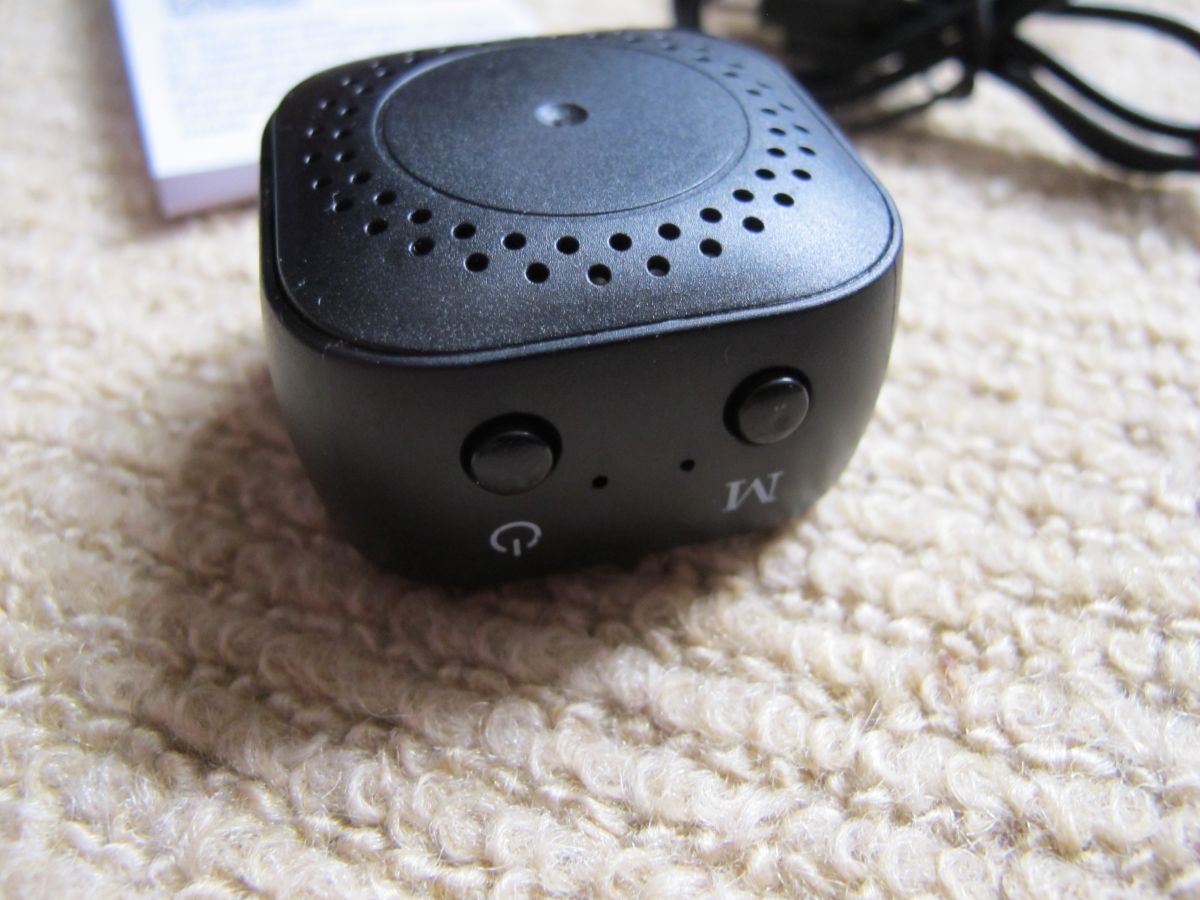

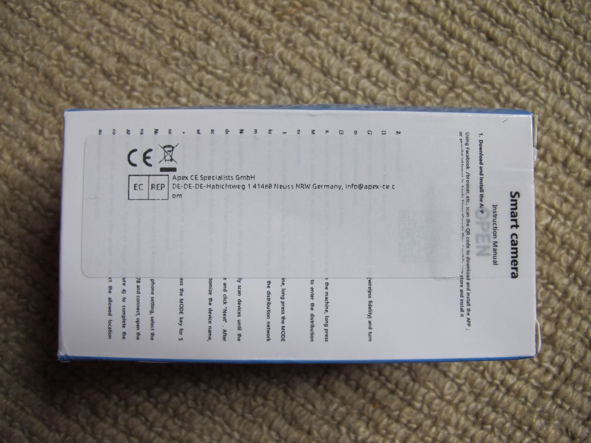

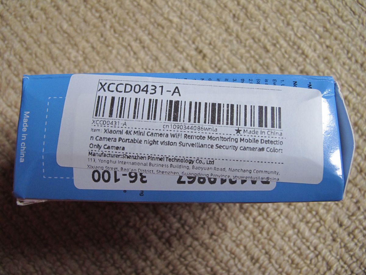

The box for this came marked with reference to "Shenzhen Pinmei Technology Co., Ltd".
Blue box with a white label showing a barcode and description of a Xiaomi 4K Mini Camera. Box of a battery-powered HD IP camera labeled Smart Camera. A smart camera product box with an instruction manual placed on a carpet. IP camera set: camera, USB cable, mount, manual, and box on carpet. The interior of a small electronic device with a visible lithium-polymer battery and circuit board. A small, black, square portable speaker is lying on a light carpet. Micro USB port on a black plastic electronic device. A small, black, square speaker or electronic device with vent holes and a slot, placed on a beige carpet. A black, square-shaped webcam with a central lens and attached USB cable, lying on a carpet. Small black electronic speaker with two buttons, lying on a beige carpet. Disassembled plastic case and USB cable on a carpet. Wi-Fi device setup instructions from a mobile app shown on a paper lying on a carpet. Smart camera instruction manual with QR code, app icon, and screenshot of mobile app interface.

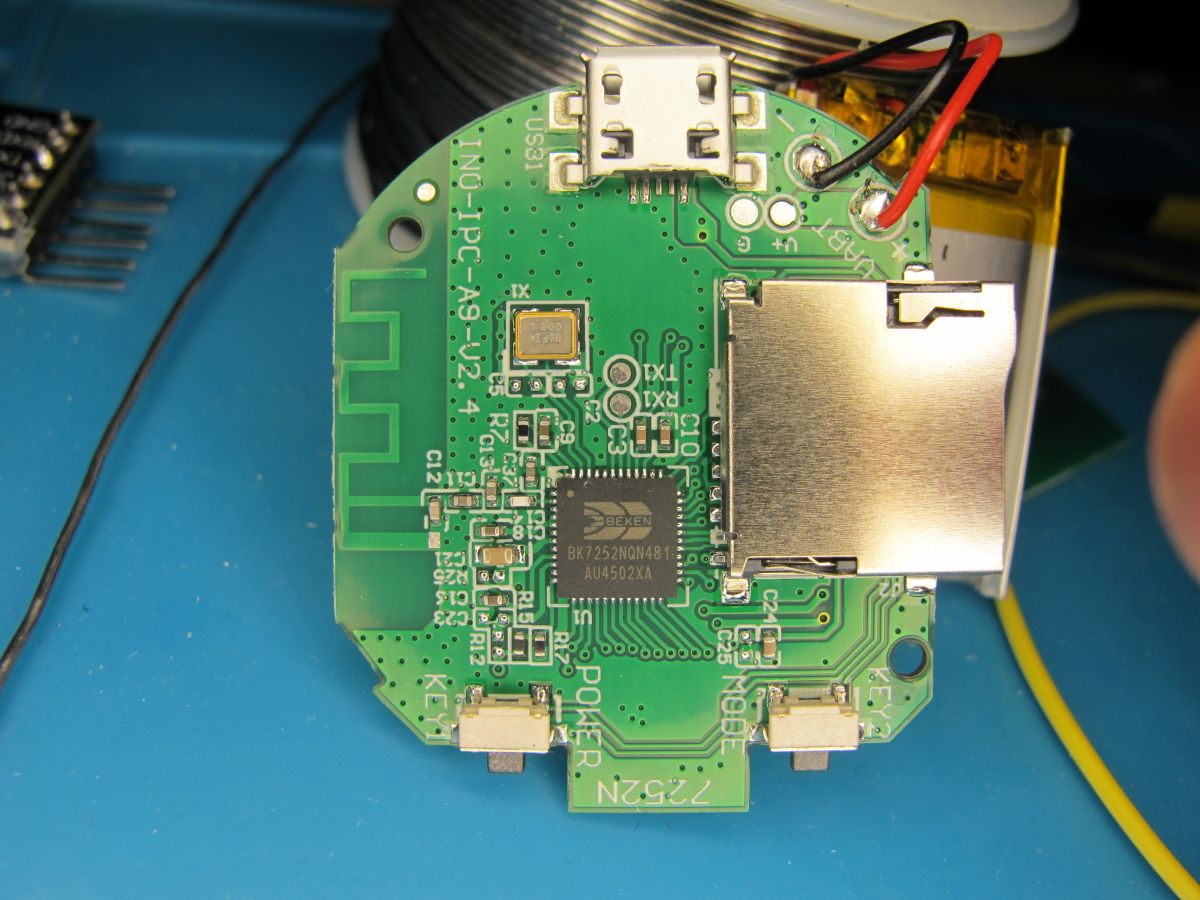

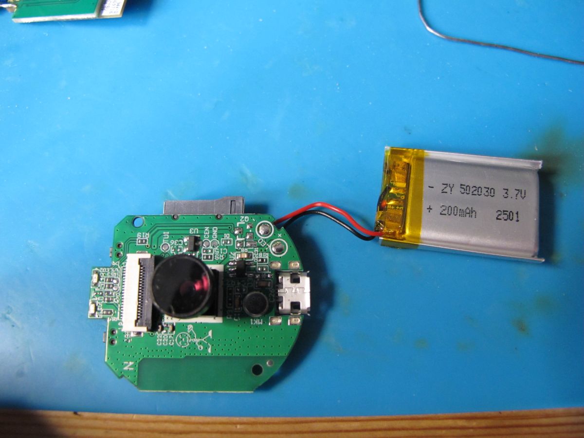

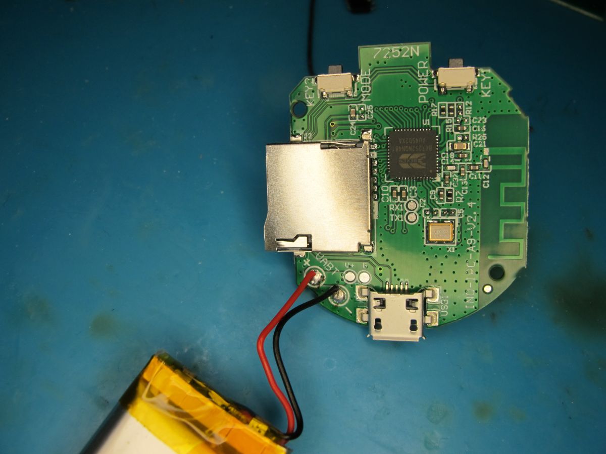

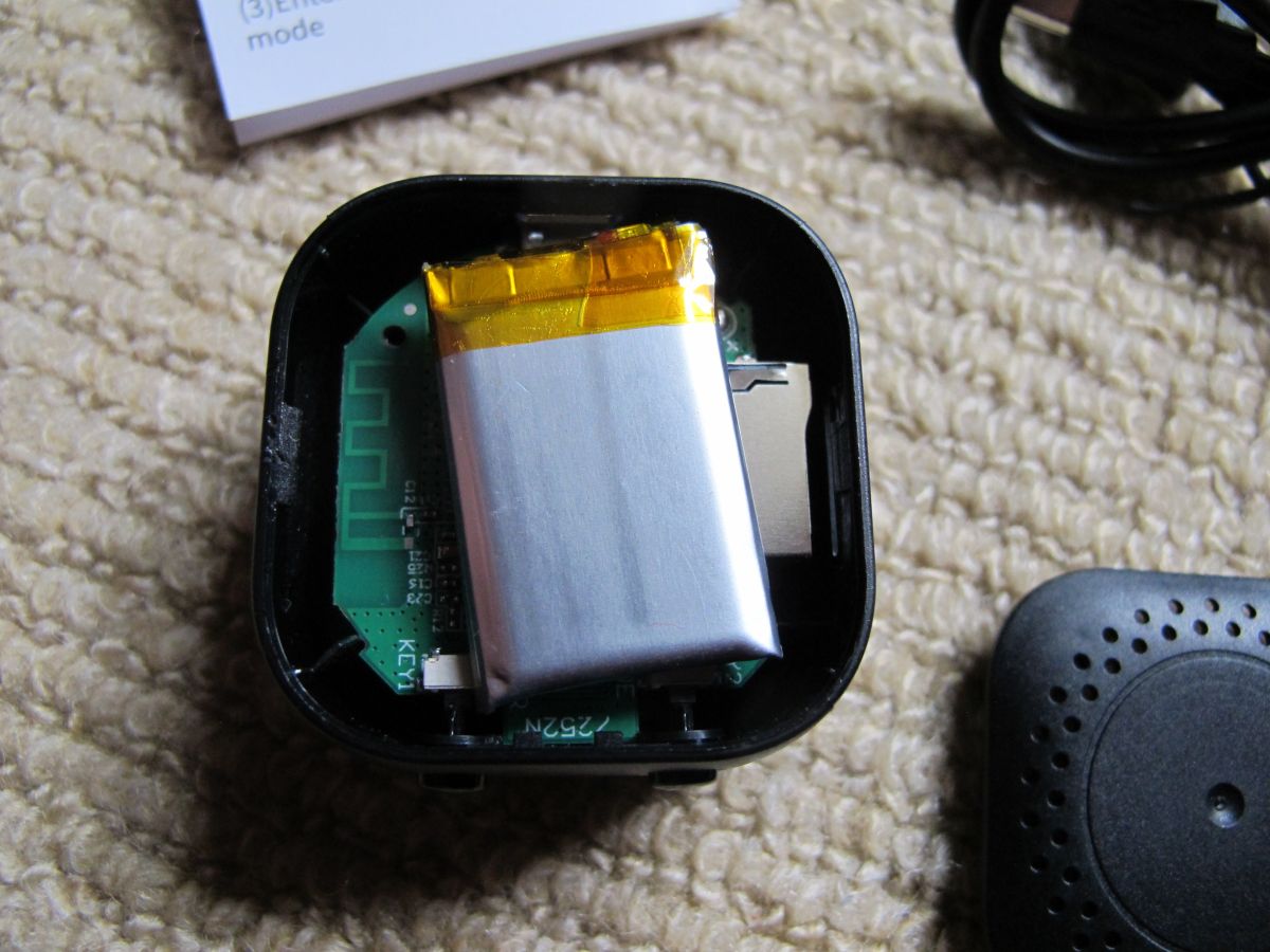

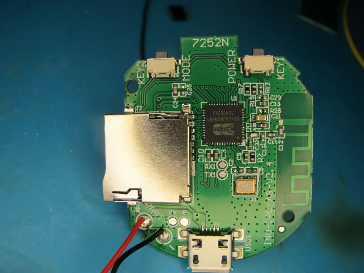

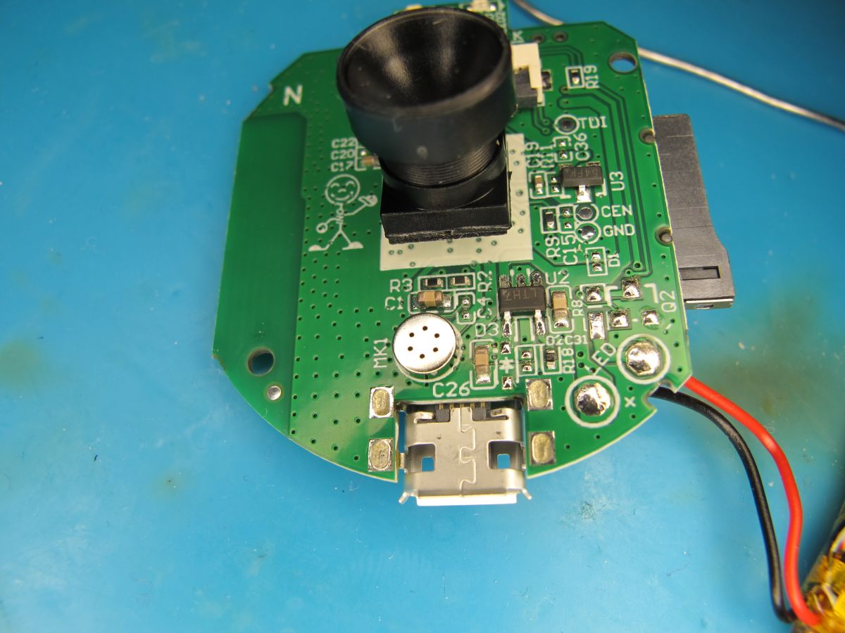

Inside we see a 2mb BK7252NQN481 - datasheet: https://www.elektroda.com/rtvforum/topic4118348.html#21526095

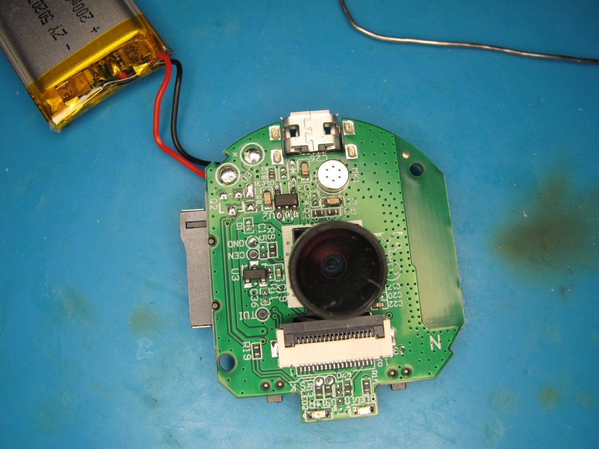

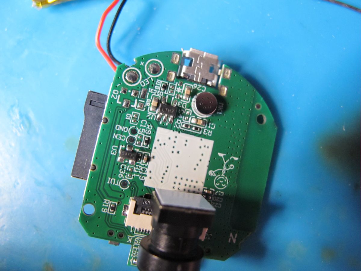

Printed circuit board with microSD slot, micro USB port, integrated circuit, and buttons. Printed circuit board with a connected battery and micro USB socket. Printed circuit board with electronic components, a micro USB port, and a camera lens on a blue surface. A circuit board with a mounted camera lens and a lithium-polymer battery on the left. Electronic module with camera lens and flat cable connector on a blue background. A printed circuit board with electronic components, including a microphone, connectors, and ICs. A circuit board with a mounted camera lens and a connected lithium-polymer battery. A printed circuit board with electronic components and a microSD card slot. Printed circuit board with electronic components, a micro USB port, memory card slot, and power wires.
from TX1 @115200 baud

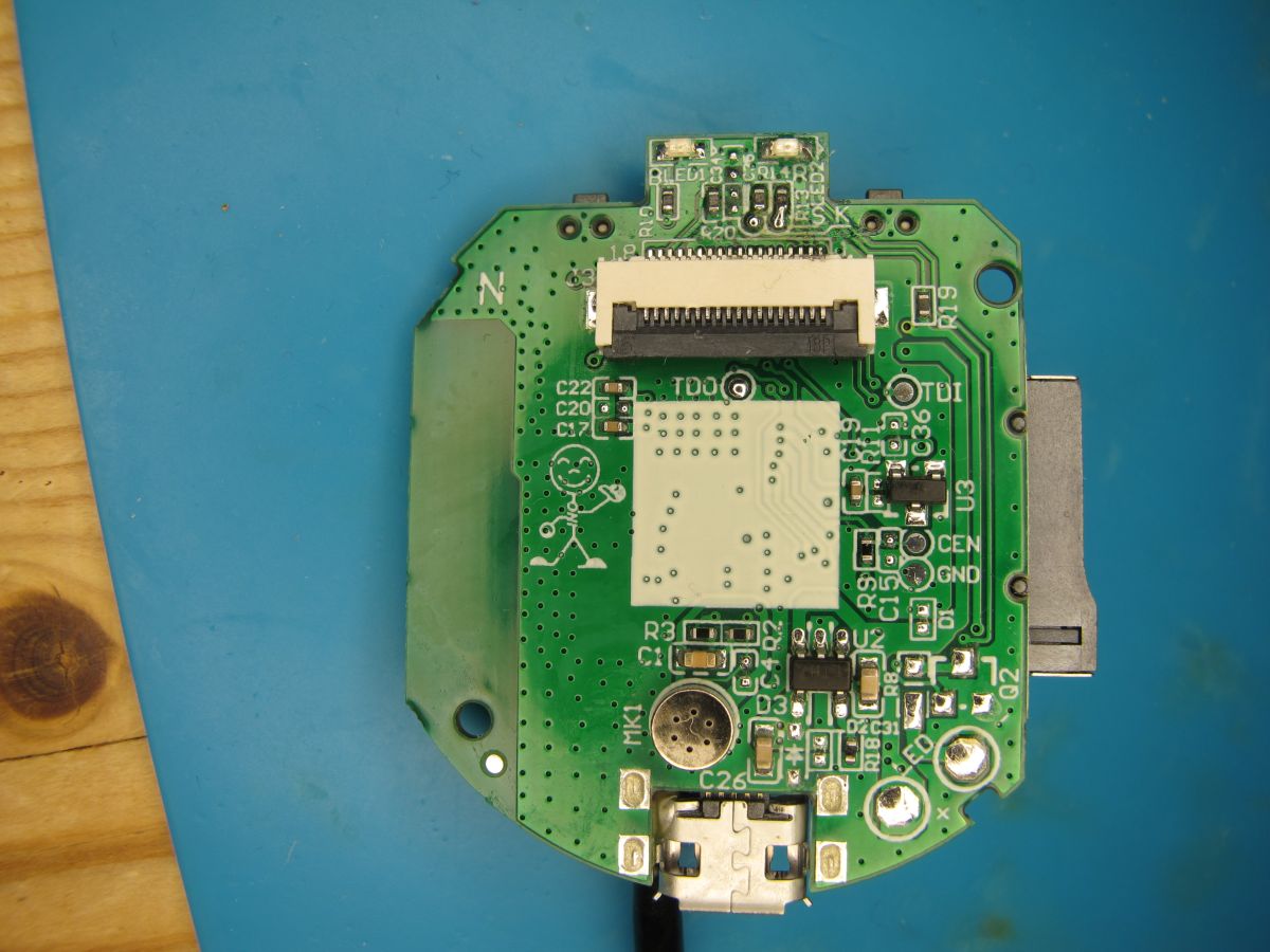

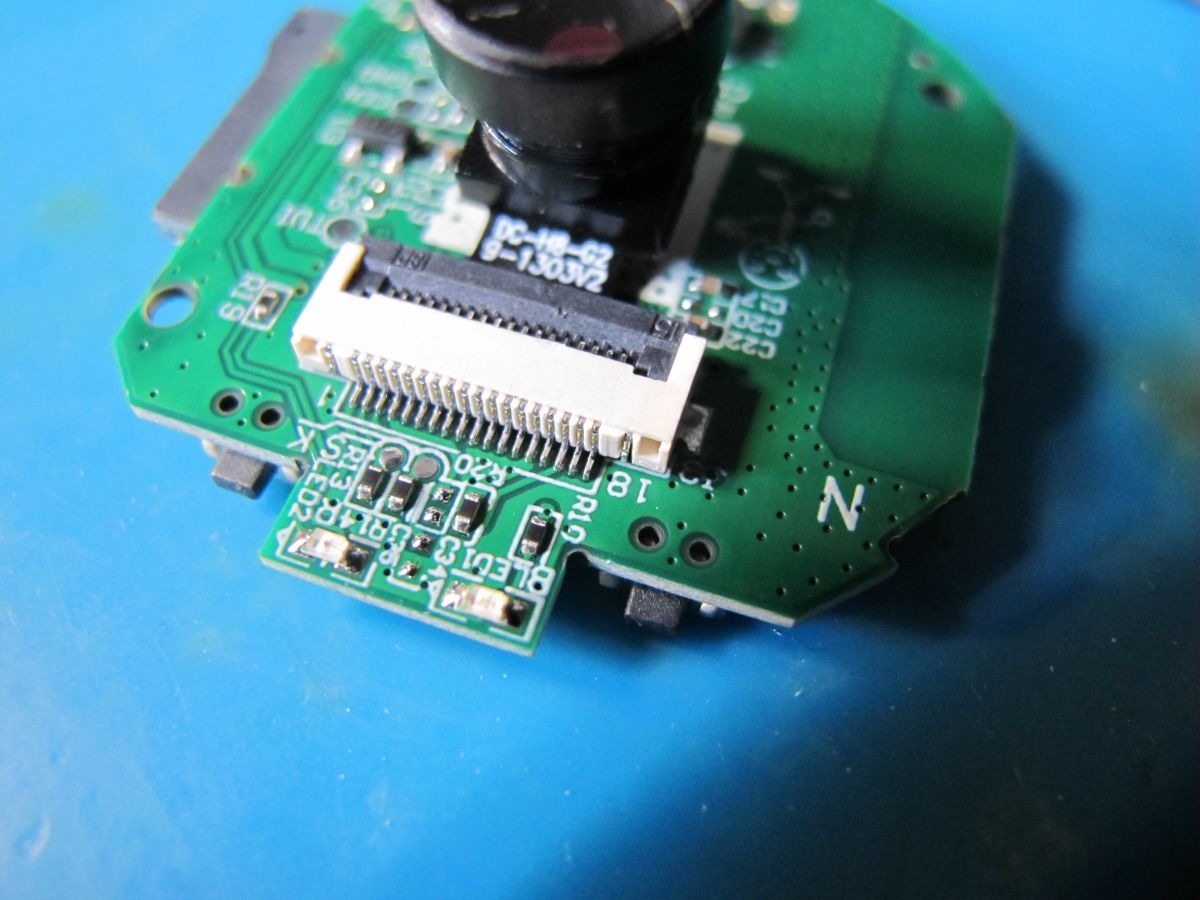

On one side are pads labelled TDI and TDO (accessible with camera ribbon removed). TMS and TCK are not so obvious.
PCB of the Wi-Fi A9 camera module seen from above, placed on a blue service mat.
TCK and TMS are these two:
A circuit board with a camera lens, battery, and labeled technical pins on a blue background.
I will later attempt SPI dump using these 4 pads as well as UART backup.
Close-up of BEKEN BK7252NQN48 chip on PCB with marked JTAG pins and a partial pinout diagram.
PCB text: INO-IPC-A9-V2.4 - I have not found FCC submissions for this device or company

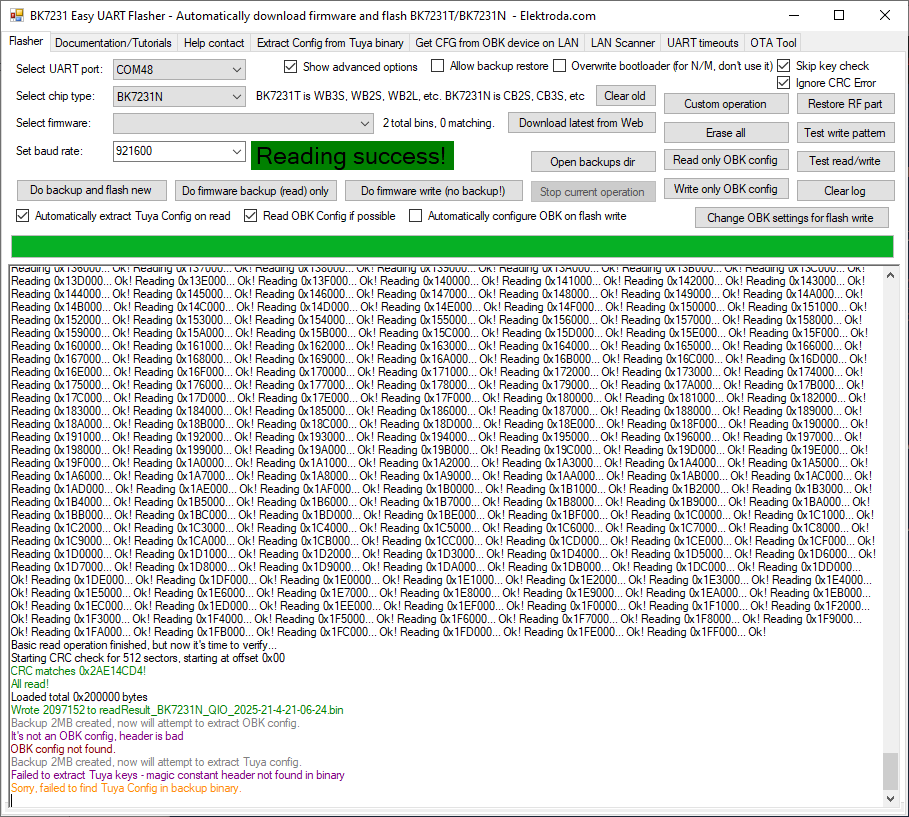

From RX1/TX1 Easy Flasher reads in BK7252 mode but this skips bootloader. It also reads in N mode which covers the whole 2MB. Maybe BK7252N is more like BK7231N, it also seems to have a romcode like N. Maybe EF needs to have separate BK7252U and BK7252N modes. Maybe EF could have chip detect and it select the right mode if known? BK7252N CHIP_ID = 0x7252a
BKFIL is also happy with BK7252N where it wasn't interested in the older BK7252U.
Screenshot of BK7231 Easy UART Flasher software with Reading success! message and memory read details.
Flash ID is familiar EB6015 and coeff in efuse is 00e46d00 00e46d00 00e46d00 00e46d00
