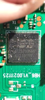

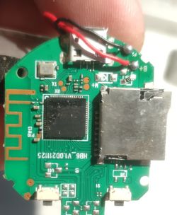

    Inside we see a 2mb BK7252NQN481 - datasheet: https://www.elektroda.com/rtvforum/topic4118348.html#21526095
    Printed circuit board with microSD slot, micro USB port, integrated circuit, and buttons. Printed circuit board with a connected battery and micro USB socket. Printed circuit board with electronic components, a micro USB port, and a camera lens on a blue surface. A circuit board with a mounted camera lens and a lithium-polymer battery on the left. Electronic module with camera lens and flat cable connector on a blue background. A printed circuit board with electronic components, including a microphone, connectors, and ICs. A circuit board with a mounted camera lens and a connected lithium-polymer battery. A printed circuit board with electronic components and a microSD card slot. Printed circuit board with electronic components, a micro USB port, memory card slot, and power wires.
    from TX1 @115200 baud
    On one side are pads labelled TDI and TDO (accessible with camera ribbon removed). TMS and TCK are not so obvious.

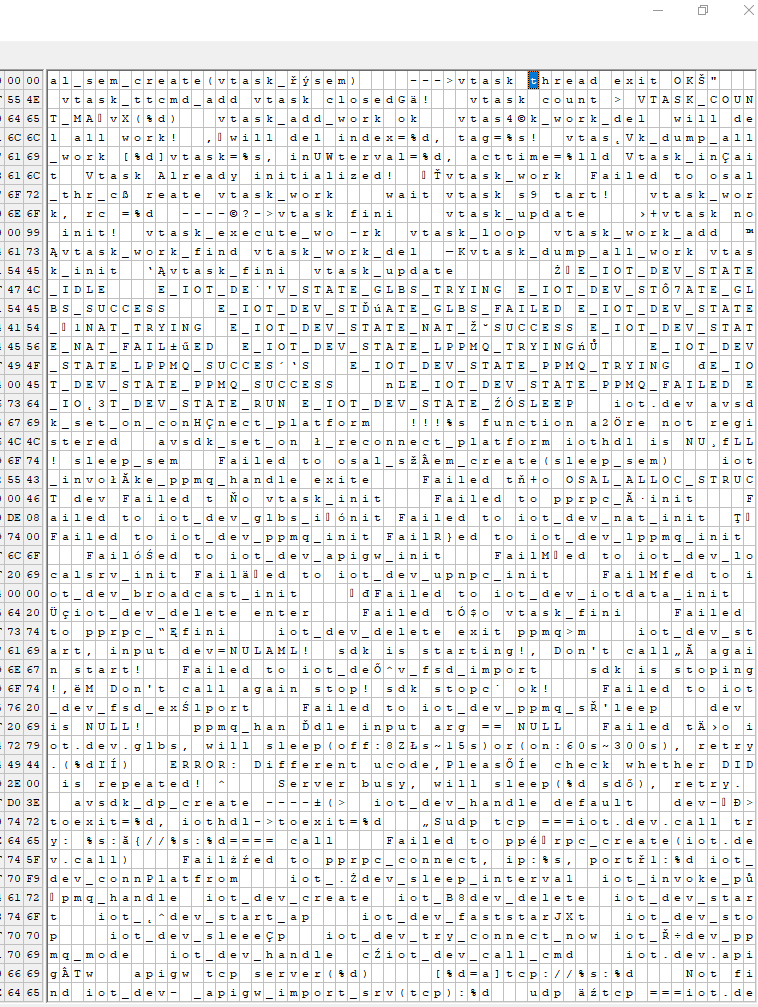

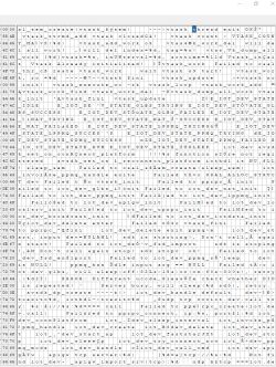

    Are you sure that this device is encrypted? This encryption keys looks like the NiceMCU keys, which are invalid because readout is disabled. @insmod ?
    Is your device working with this exploit (get video locally): https://www.elektroda.com/rtvforum/topic4117962.html
  • Readout-disabled efuse may not contain real keys
    #3 21526900
    Posts: 5234
    Help: 449
    Rate: 918
    not yet analysed dump to see if encryption is used. that's just what was read from efuse.
    if readout is disallowed isn't the read 00000s rather than an actual key?
    not yet attempted
  • Bootloader location and brick risk on BK7252NQN481
    #4 21526914
    Posts: 14792
    Rate: 12937

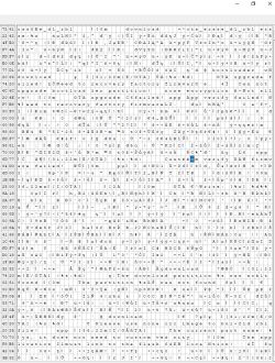

    There are string references, so I guess not encrypted.
    A program window displaying a grid filled with random characters and letters, resembling hexadecimal or binary data view.
    Screenshot showing a table with system messages and code snippets in a desktop application.
    I think we already saw the same "read key is incorrect" behaviour in this topic:
    https://www.elektroda.com/rtvforum/topic4092465-60.html#21342226
    Also here:
    https://www.elektroda.com/rtvforum/topic4092465-30.html#21341811
    So, is this chip like BK7231N, has it bootloader "stored outside in romcode", so it can't be bricked by writing garbage data to 0x0 - 0x11000 section? Or is it like BK7231T and old BK7252, where it can be bricked by overwriting bootloader in 0x0 - 0x11000 section (then it has to be recovered via SPI)?
    It would be cool if this chip could boot on BK7231N binaries

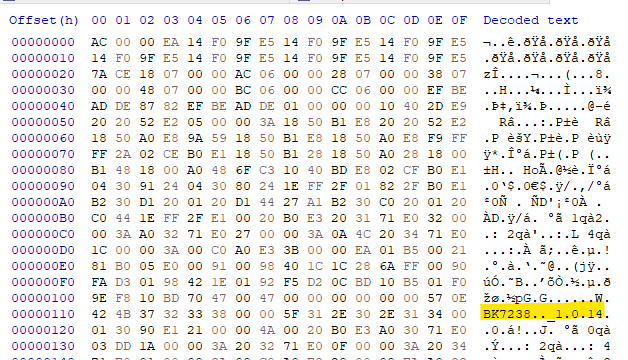

    Rom mentions BK7238 at 0x18B8, so i guess you would have to try to boot 7238 binaries, and not N.
    And keys readout is not disabled, since we can get at least something out of them, but addresses were probably just shifted,
    ah yes. did notice this in main flash dump actually
    Screenshot of a hex editor displaying a file with the string BK7233...1.0.0.14 highlighted.

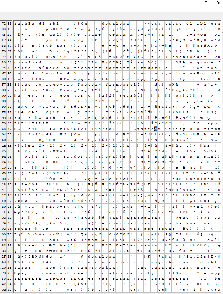

  • Address wraparound enables BK7231T bootloader access
    #10 21527091

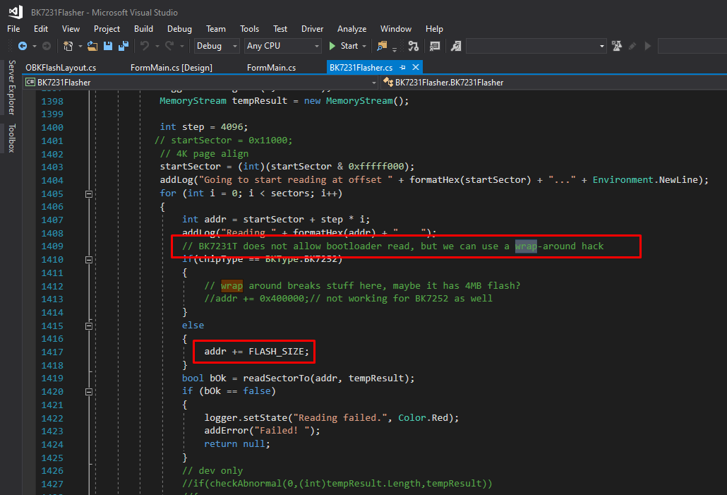

    Posts: 14792
    Rate: 12937
    It's the address wrap around I've mentioned recently. This is the way we can read bootloader on BK7231T. BK7231T has read offset 0x0 to 0x11000 protected, but if we add 2MB, then we can both read.... and write there. That's how you can brick your BK7231T.
    A screenshot of Visual Studio shows a C# code segment for managing BK7231T microcontroller flash memory.
    Added after 1 [hours] 49 [minutes]:

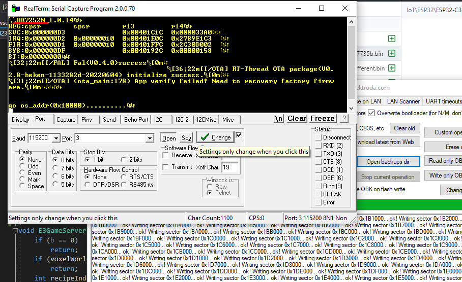

    Tried flashing to BK7238, no luck:
    BK7238_1.0.14
    REG:cpsr        spsr        r13         r14
    SVC:0x000000D3              0x00401C1C  0x000033A0
    IRQ:0x000000D2  0x00000010  0x00401E0C  0x27C9E5CB
    FIR:0x000000D1  0x00000010  0x00401FFC  0x8C30D003
    SYS:0x000000DF              0x0040192C  0x00000158
    ST:0x00010000
    [I/FAL] Fal(V0.4.0)success
                                           [I/OTA] RT-Thread OTA package(V0.
    2.8-beken-1133282d-20220604) initialize success.
    [E/OTA] (ota_main:178) App verify failed! Need to recovery factory firmw
    are.
    go os_addr(0x10000)..........
    and if I flash with bootloader overwrite:
    BK7252N_1.0.14
    IRQ:0x000000D2  0x00000010  0x00401E0C  0x0789E181
    FIR:0x000000D1  0x00000010  0x00401FFC  0x8430D003
    ST:0x00010000
    are.
    Interesting, it managed to print out stuff and identify itself as BK7252N:
    Screenshot of RealTerm program displaying BK7231T microcontroller boot messages and serial port settings.

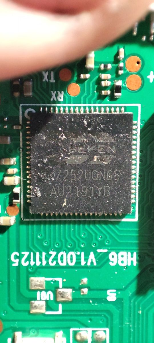

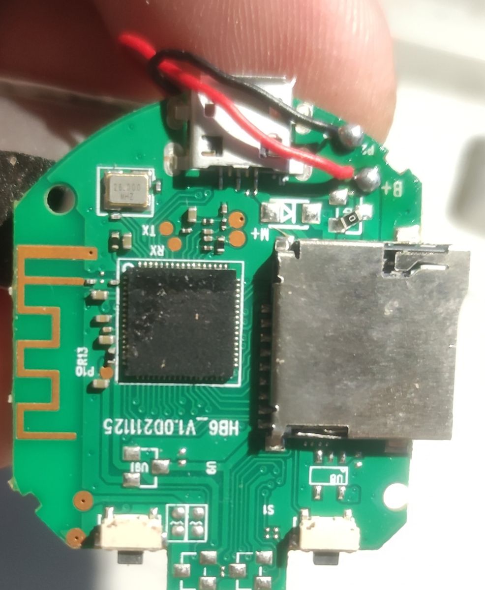

  • Questioning whether the round A9 shares the same hardware
    #12 21527849
    austin007
    Posts: 768
    Help: 6
    Rate: 278

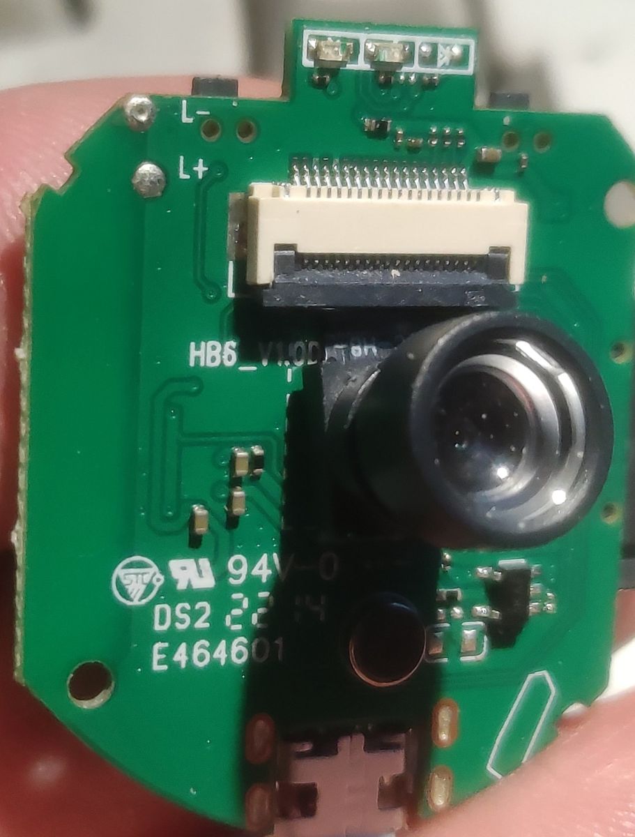

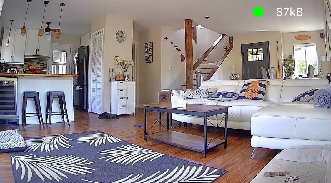

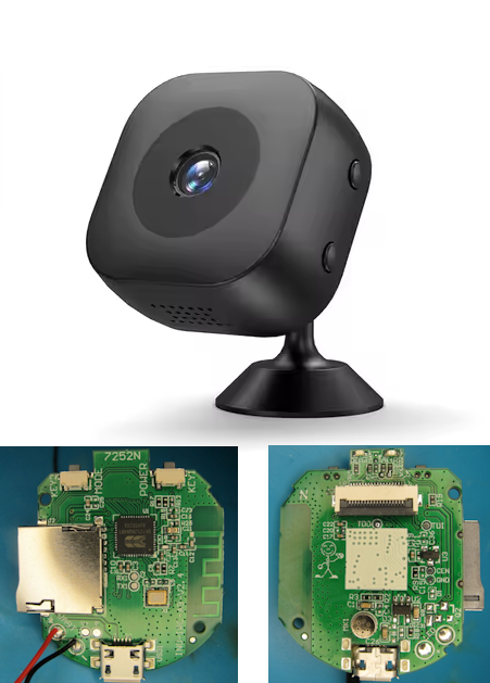

    Thank you for sharing your work. Is it the same hardware as in the round A9 camera from the thread discussed earlier*? I looked at a picture of one customer on Aliexpress and it looks better than the ones from the round A9. If it's the same image sensor and lens, the difference is due to the firmware and would manage to upload it from yours to the round A9.
    *https://www.elektroda.pl/rtvforum/topic4117962.html
    AE photo:
    Surveillance camera view of a bright living room with a white sofa, leaf-pattern rug, kitchen, and stairs; green dot with “87kB” in the top right corner. .
  • #13 21527997
    error105
    Posts: 481
    Rate: 146
    And I'm interested in whether it outputs any stream? For 9PLN a nice option to read my analogue water meter, I have an ESP32CAM there but this one so much more convenient because it has a case etc :)
  • Different A9 variants use incompatible batches
    #14 21528009
    Posts: 14792
    Rate: 12937
    @austin007 we've already seen about four variants of these A9s and their batches are not interchangeable with each other (there is either BK7525, or BK7525N, or XF16, or some other chip). On the other hand we would still love to see the inside of your camera from @divadiow , what MCU do you have inside there? Will you rip the batch?
    @error105 in this topic we are focusing on changing the firmware. Access to the video stream is available without changing the firmware. This was presented here: How to access the A9 camera video stream for $1 from the LAN (NodeJS) site? .

    that sample pic looks too good to be an A9 cam though doesn't it? The aspect ratio and wide angle lens isn't something I've seen I don't think for a camera at this level, not my A9s anyway.

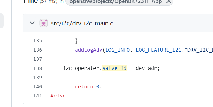

    salve_id is in BK code:
    Screenshot showing a fragment of code in drv_i2c_main.c with a typo in the variable salve_id.

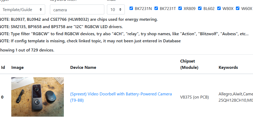

    Btw maybe we should add a "camera" tag for Devices List?
  • #17 21528729
    Posts: 5234
    Help: 449
    Rate: 918
    sure. there are other platforms missing too though.
  • #18 21528956
    Posts: 14792
    Rate: 12937
    This also needs to be fixed - there is just one result for "camera" on our site:
    Screenshot of a device list table showing a camera, button, and cable.

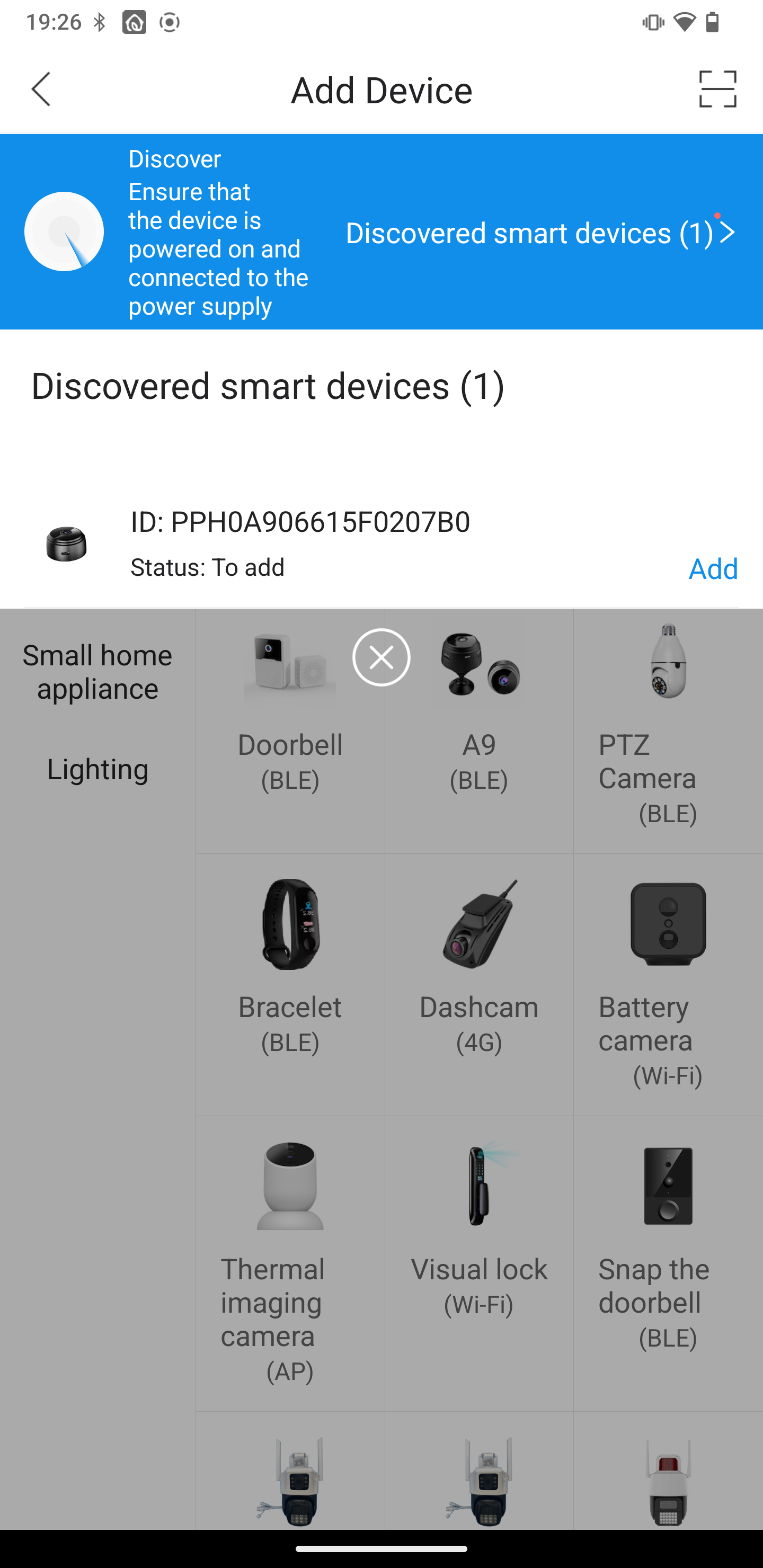

  • Pairing AP credentials and open ports found

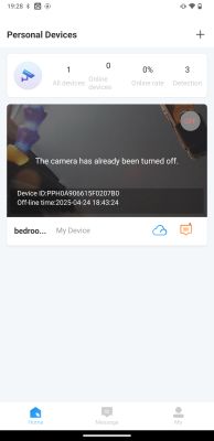

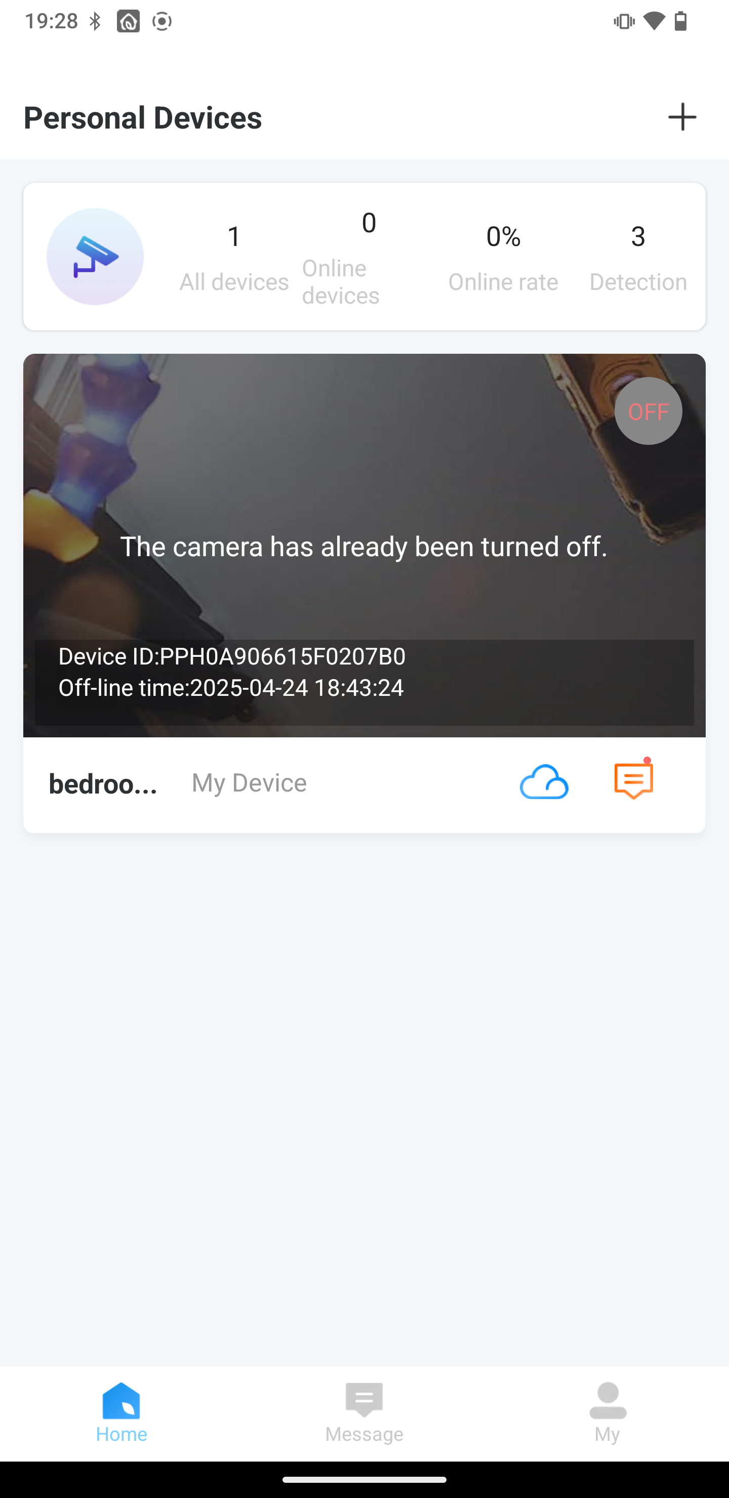

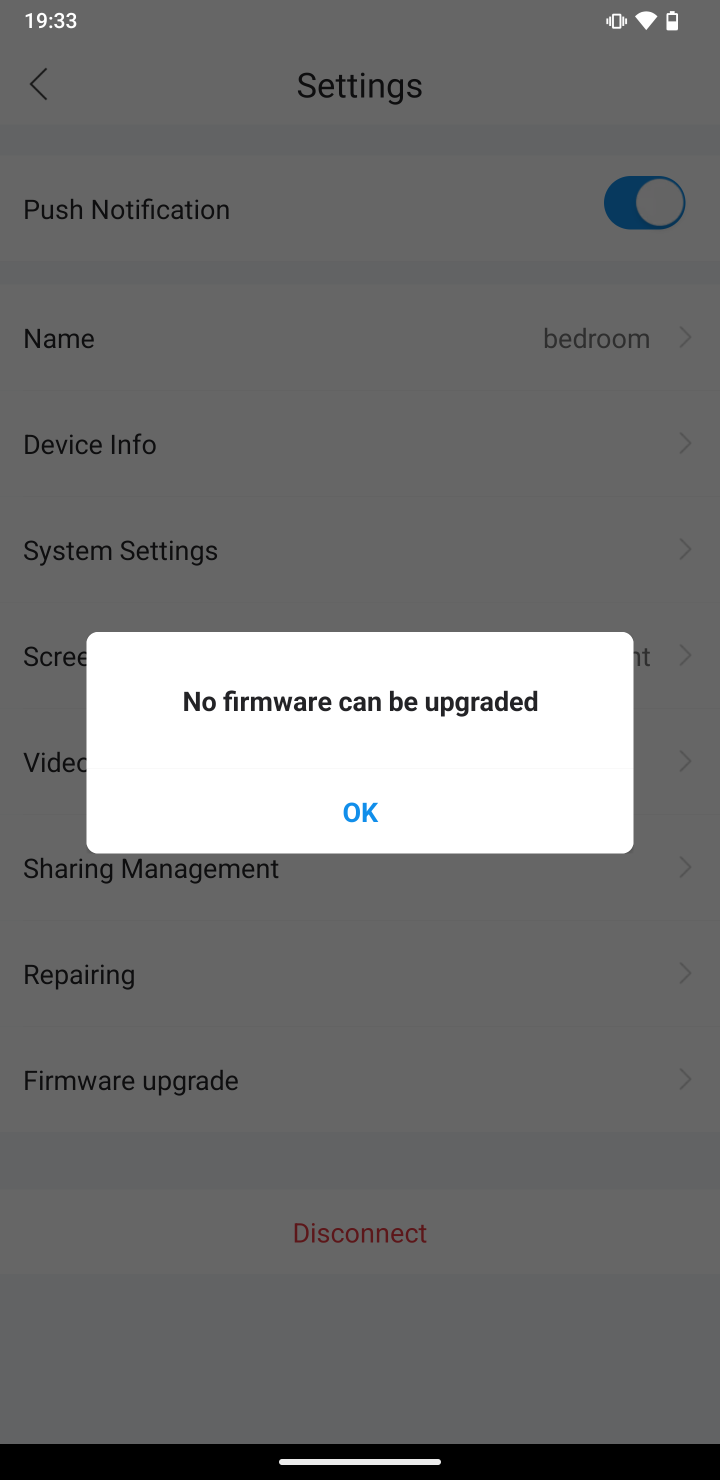

    #19 21529763
    Posts: 5234
    Help: 449
    Rate: 918

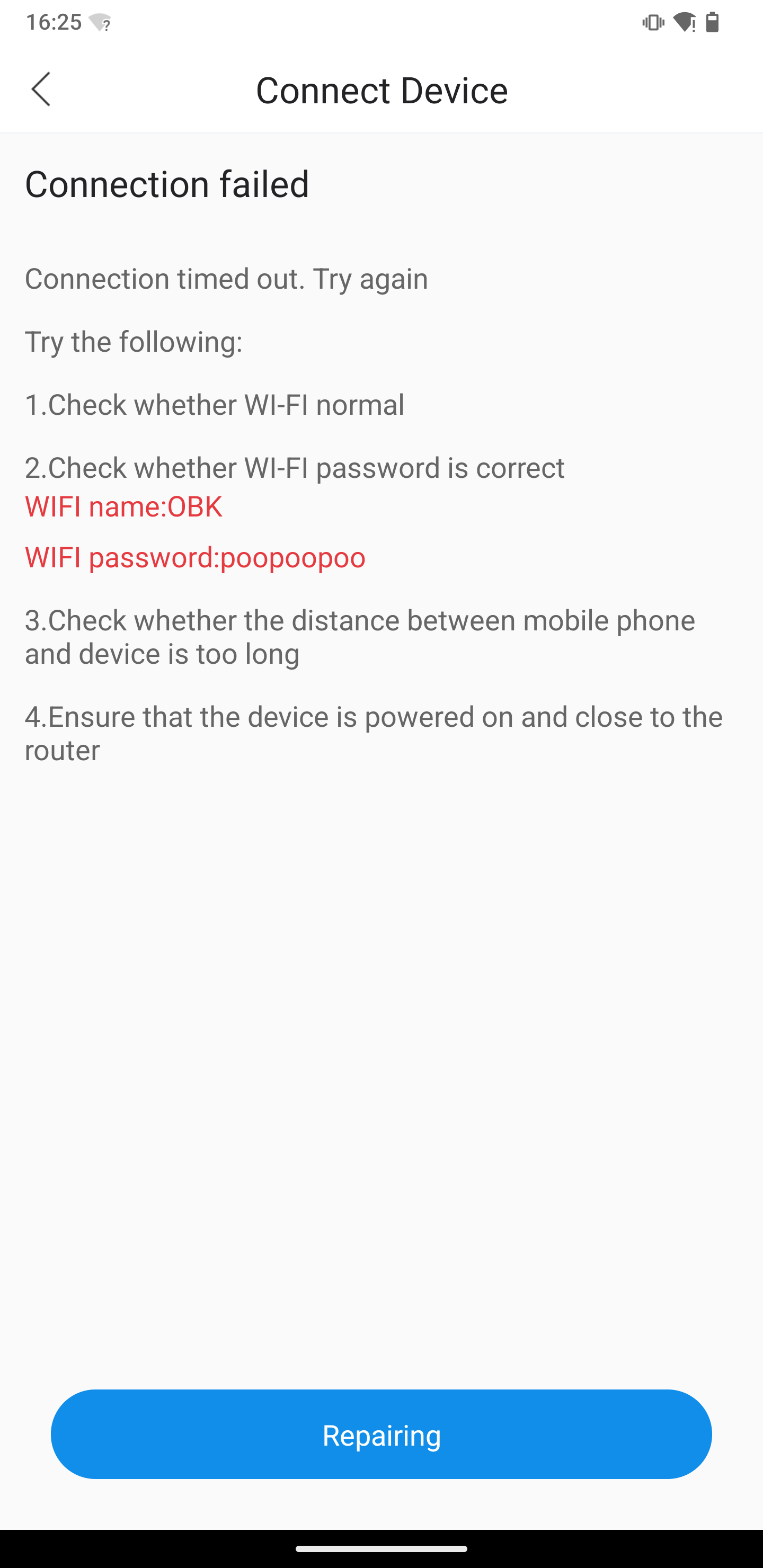

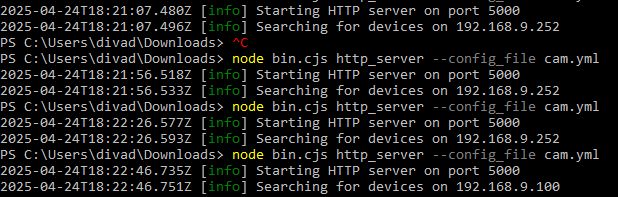

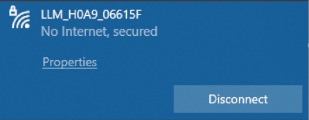

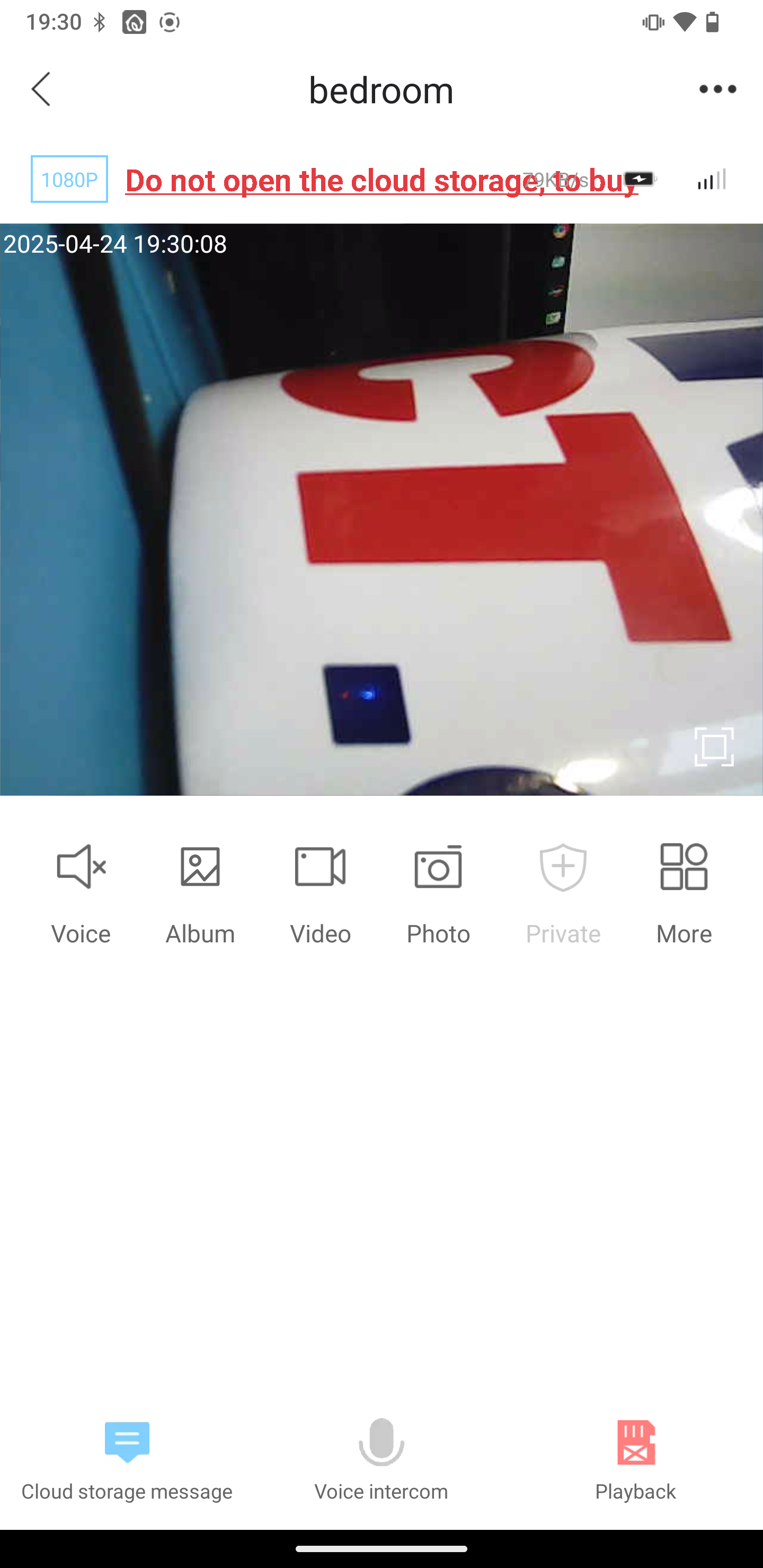

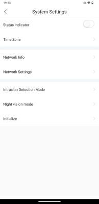

    On the subject of the Pinmei A9 BK7252 cam:
    in pairing mode it broadcasts an AP - the SSID and key for which can be seen in the boot log
    Screenshot showing Wi-Fi network LLM_H0A9_06615F with No Internet, secured message.
    client is assigned 192.168.9.100 from cam on 192.168.9.252

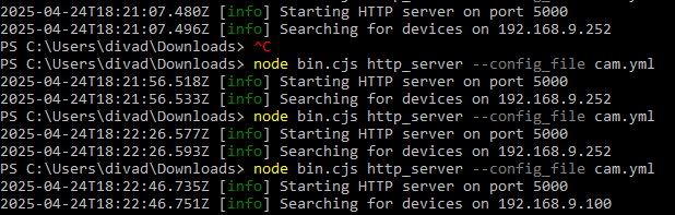

    Nmap with scan command nmap -sS -sU -T4 -v -p T:0-65535,U:0-65535 192.168.9.252 sees these ports and states:
    mention of one such ports here https://community.home-assistant.io/t/popular...mini-wi-fi-camera-the-ha-challenge/230108/394
    no signs of life with cam-reverse
    A console log fragment showing HTTP server start and network device search.
    Screenshot of a terminal showing logs from running an HTTP server and searching for devices on a local network using the bin.cjs script.

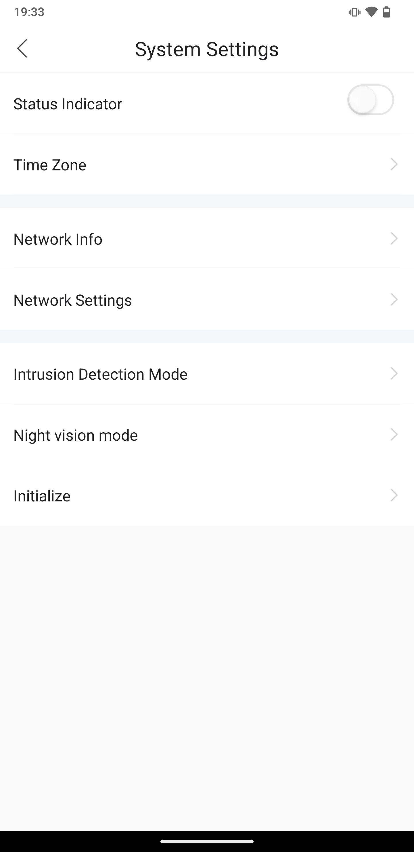

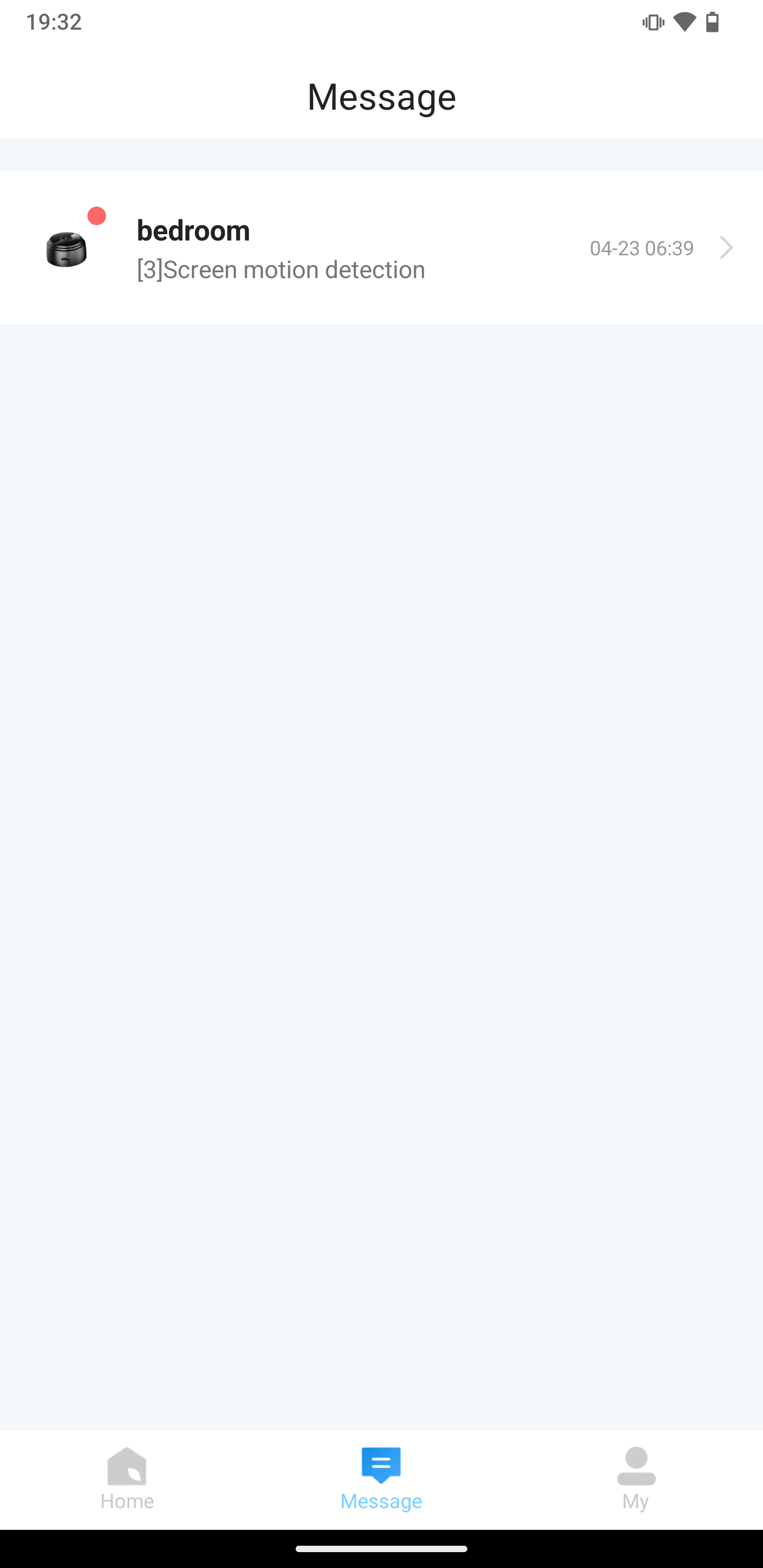

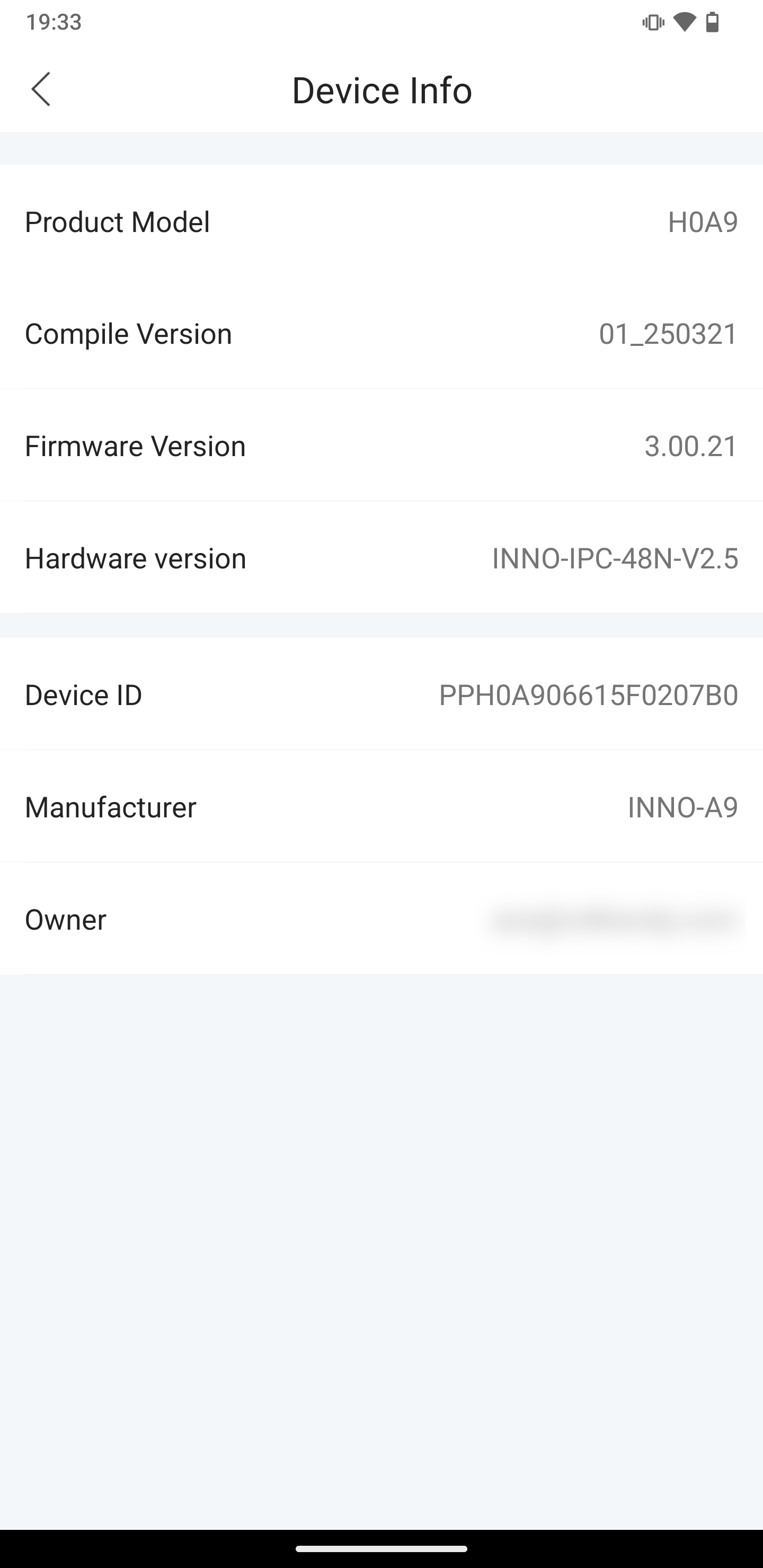

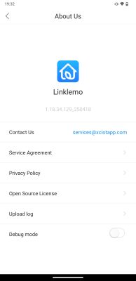

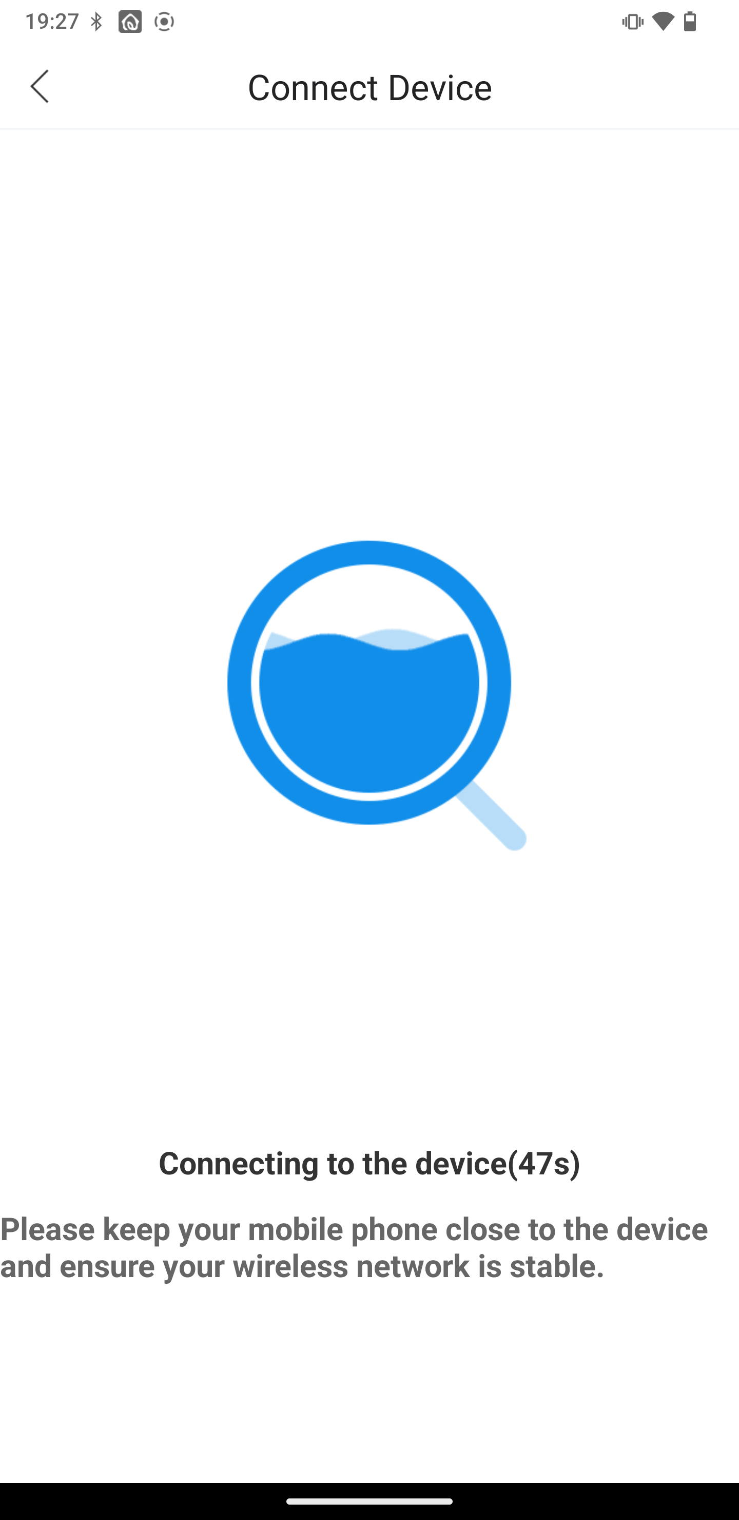

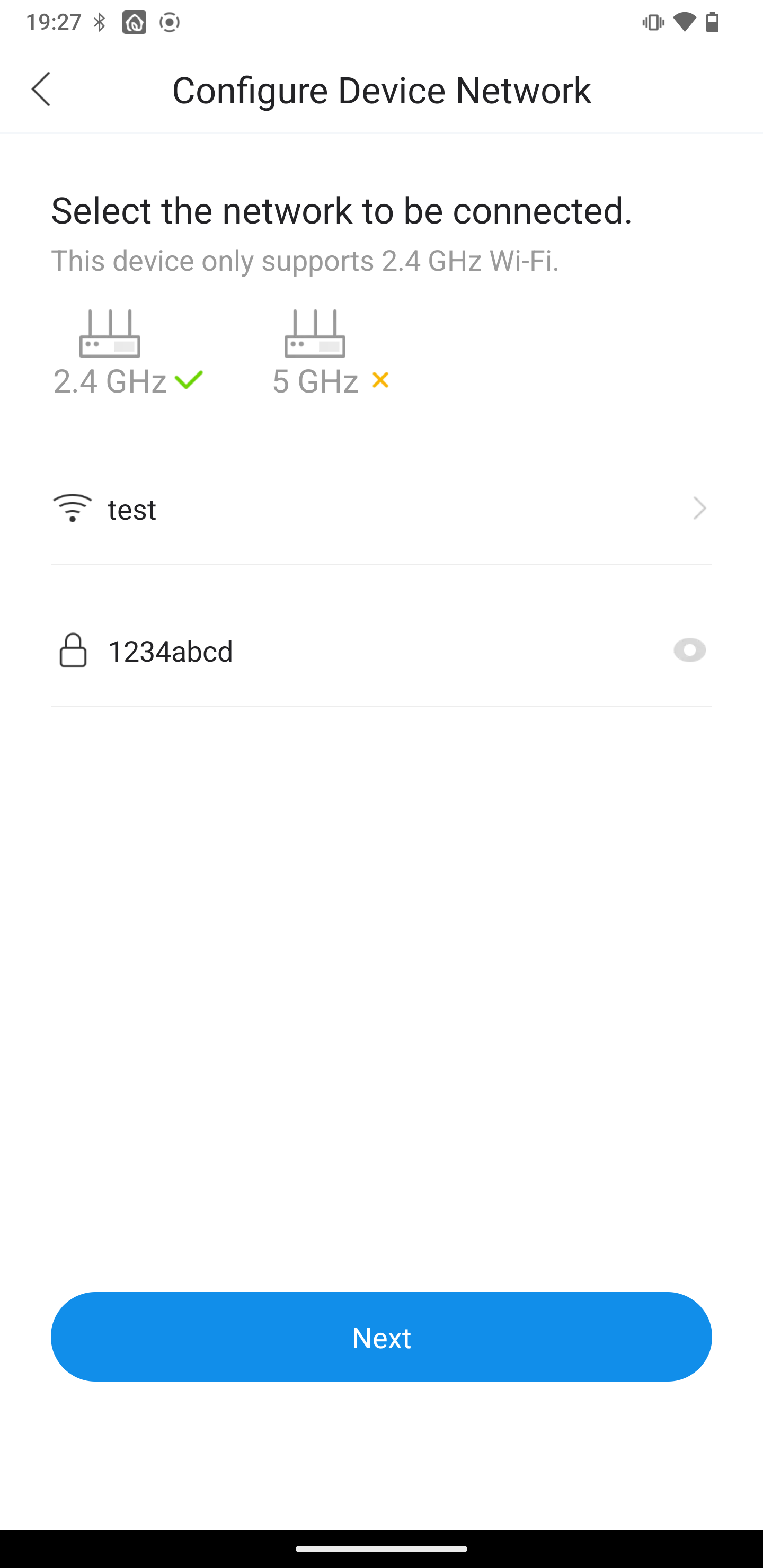

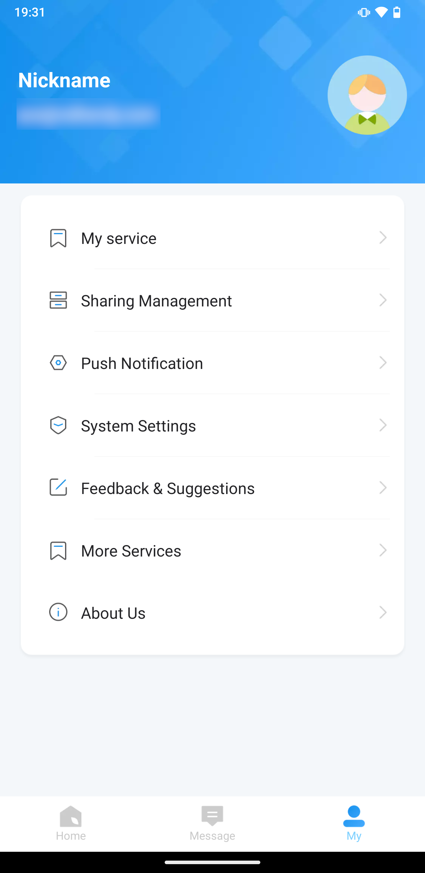

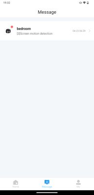

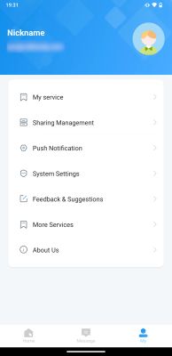

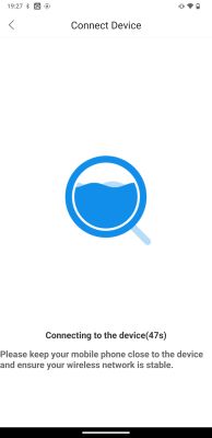

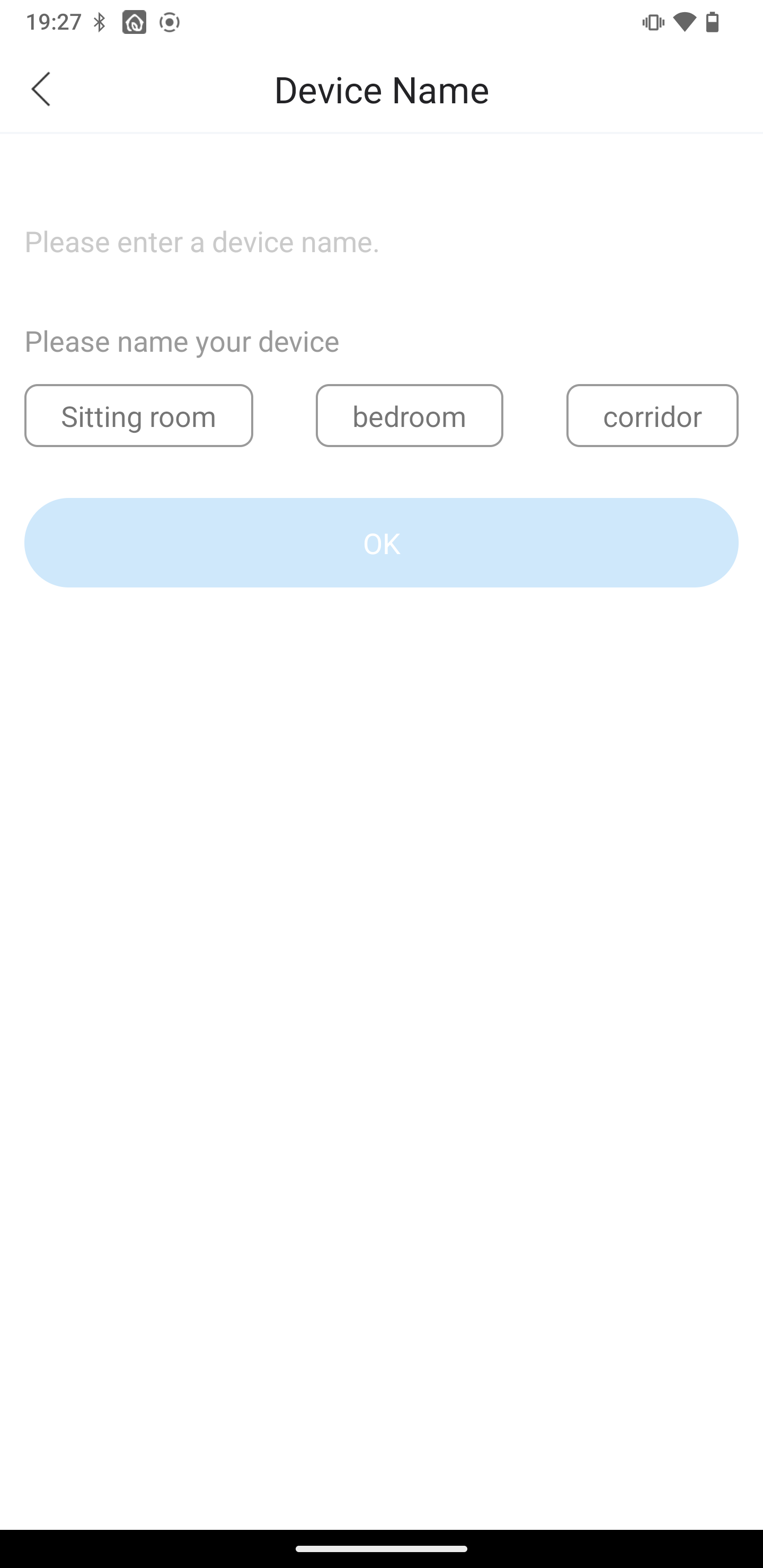

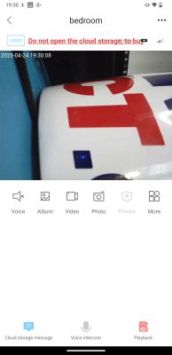

    And now pairing with the official "Linklemo" app https://play.google.com/store/apps/details?id=com.xcthings.fchan
    Screenshot of a smart home app showing one discovered device ready to be added. App screen for configuring a device's Wi-Fi; only 2.4 GHz is supported, test network selected, and password field visible. App screen with Connect Device message and magnifying glass icon filled with blue liquid. Screenshot of an app with the option to select a device name, featuring Sitting room, bedroom, and corridor buttons. App interface showing one security camera, which is currently turned off. Close-up of a white object with red and blue geometric symbols, viewed from a security camera app. Mobile app screen with a user menu for settings and service management options. Screenshot of an app with a motion detection alert from a bedroom camera. A mobile app screen showing Linklemo's about page with logo, contact info, and menu options. Screenshot of a device settings app with a message saying No firmware can be upgraded. Screenshot of an app showing device information for the INNO-A9, including model, firmware, and hardware details. Screenshot of the system settings screen in a mobile app showing various configuration options.

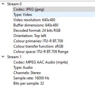

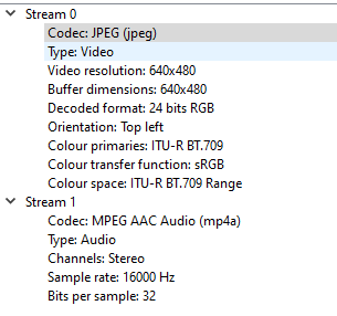

    video and image samples attached
    Screenshot showing codec and technical details for video and audio streams in a media file. Displayed image details such as dimensions, resolution, and bit depth.
    • PPH0A906615F0207B0_1745386441723.mp4 (811.44 KB) You must be logged in to download this attachment.

    Are you able to pair with this app without pairing with cloud? Via access point?
    Can you provide here the APK file of this app? Maybe we could analyze it.
  • #21 21530062
    Posts: 5234
    Help: 449
    Rate: 918
    haven't tried, but app requires registration and login and there are at least these IPs it wants to access, so...
    prod.glbs.xcthings.com - 47.240.1.244, 47.252.5.225, 8.209.77.49, 39.108.59.60
    https://reports.exodus-privacy.eu.org/en/reports/596710/
    • apktool_decode_com.xcthings.fchan.apk.zip (146.31 MB) You must be logged in to download this attachment.
    • Report for com.xcthings.fchan 1.18.34.129_250418 - εxodus.zip (357.99 KB) You must be logged in to download this attachment.
    • com.xcthings.fchan.zip (47.81 MB) You must be logged in to download this attachment.
  • #22 21530553
    Posts: 14792
    Rate: 12937
    There seems to be some packet parsing and writing in your disassembly, but I am not even sure if it's for communication with the camera or with the cloud. It seems to be using Google Protocol Buffers:
    https://protobuf.dev/
    More in-depth analysis is needed.
    It would help to know whether it's possible at to interface those cameras without cloud.
  • Cloud-free pairing times out on AP without internet
    #23 21532561
    Posts: 5234
    Help: 449
    Rate: 918
    not having much luck. with phone on AP with no internet the device pairing process just times out and:
    App screen showing device connection failure with Connection failed and troubleshooting steps.
    log out as it connects
  • AP mode preview works, but stream access remains blocked

    I noticed that you can have a preview in the Linklemo app when you are connected to the camera when it is AP mode. My phone has data off. Wifi connected to LLM_H0A9_07B75F. There is a preview. In Network info same zeros, only MAC address is given. Connection settings cannot be changed. Repairing does not work. Even disconnect does not work
    (this function is not supported in local mode). On github they wrote that no connection settings can be changed in local mode.
    I also failed to access stream:
    node bin.cjs http_server --config_file config.yml
    2025-05-05T21:40:45.023Z [info] Starting HTTP server on port 5000
    2025-05-05T21:40:45.029Z [info] Searching for devices on 192.168.9.252
    The port scanner detects the address 192.168.9.252, it appears as Beken Corporation.
    Is there any way to connect to the stream from Windows? Is it necessary to change the firmware?
  • #25 21540483
    Posts: 14792
    Rate: 12937
    The new firmware does not yet support the camera controller anyway, so it won't do much for now.
    And which camera do you have exactly? The one in the topic, on the BK7252N?

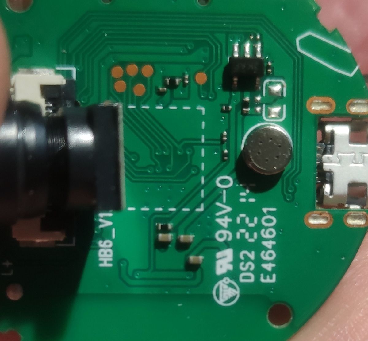

  • Early A9 round camera hardware identified
    #27 21564217
    austin007
    Posts: 768
    Help: 6
    Rate: 278
    My A9 round is an early version. Quite poor with a sub-lens without coatings. BK7252 UQN68, not sure what the matrix is. Battery faded. Cost $1 at mayfriend a few over a year ago.
    Close-up of a circuit board from an A9 webcam with visible lens and ribbon connector. .
    Close-up of a green circuit board showing a camera lens, microphone, and micro USB port. .
    Close-up of a round PCB with the BK7252 chip, micro USB connector, and other electronic components. .
    Close-up of a BK7252UQN68 integrated circuit on a green printed circuit board with electronic components and traces. .
  • #28 21564294
    Posts: 5234
    Help: 449
    Rate: 918
    interesting. thanks for posting! have you considered capturing the boot log from the TX pad and then maybe dumping firmware from RX/TX or, probably better, the unlabelled pads on the underside which are possibly usable with a CH341A? This approach was taken with this BK7252U https://www.elektroda.com/rtvforum/topic4123266.html
