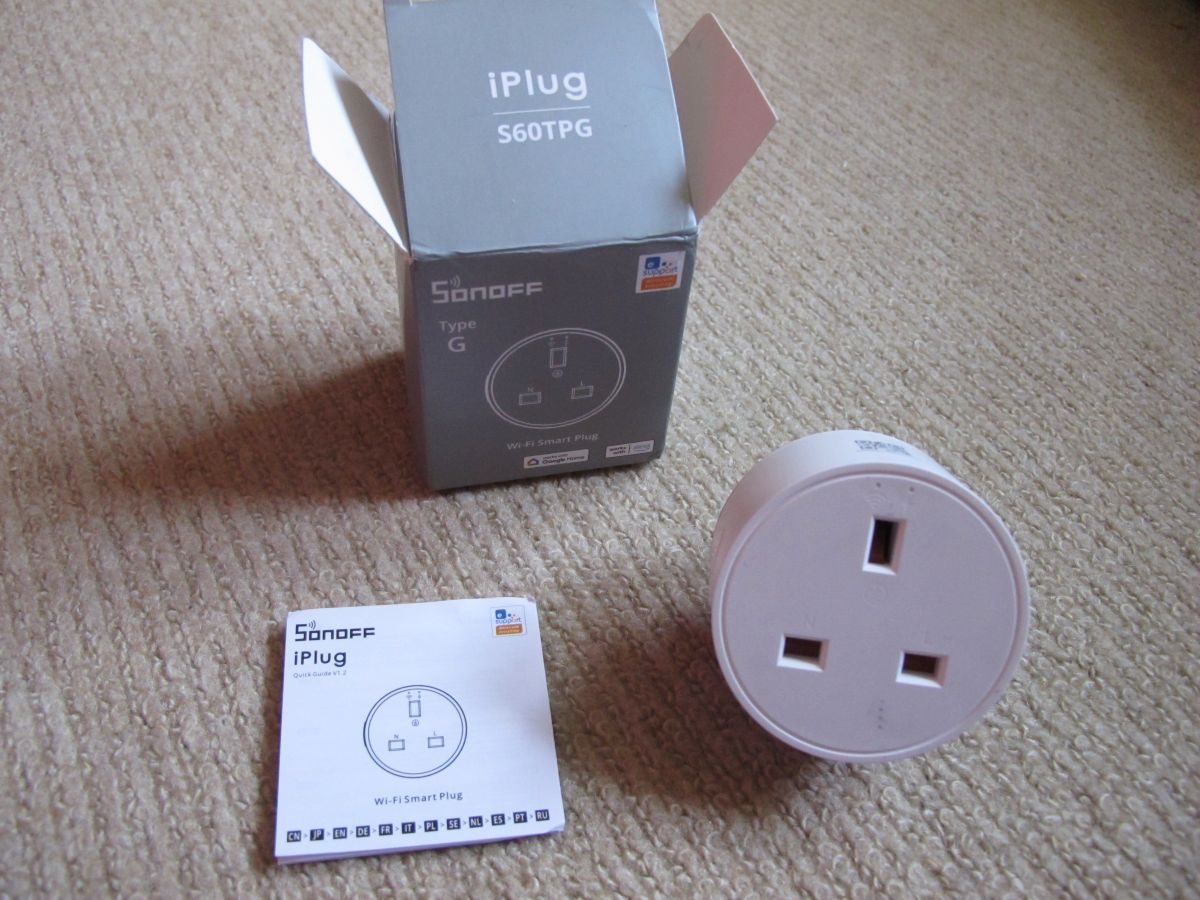

Here are my experiences with a Sonoff S60TPG iPlug UK smart plug, along with teardown, flashing information and OpenESP32 experiments (OBK port).
Gray box of Sonoff S60TPG iPlug Type G smart plug on a beige carpet. Box of Sonoff S60TPG iPlug UK smart plug with product label and barcode. Box of Sonoff Type G Wi-Fi Smart Plug on a beige carpet. Gray box of Sonoff iPlug S60TPG Type G placed on a beige carpet. Sonoff S60TPG iPlug smart plug, manual, and Type G box on a carpet. Close-up of the label on the Sonoff S60TPG smart plug with three UK metal prongs visible.
The plug was bought from Ali Express
https://nl.aliexpress.com/item/1005006764953793.html

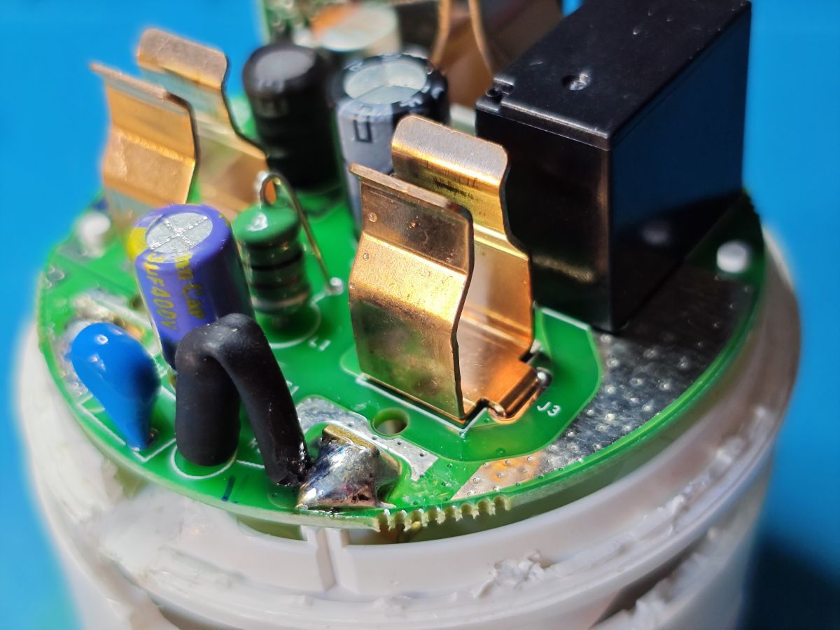

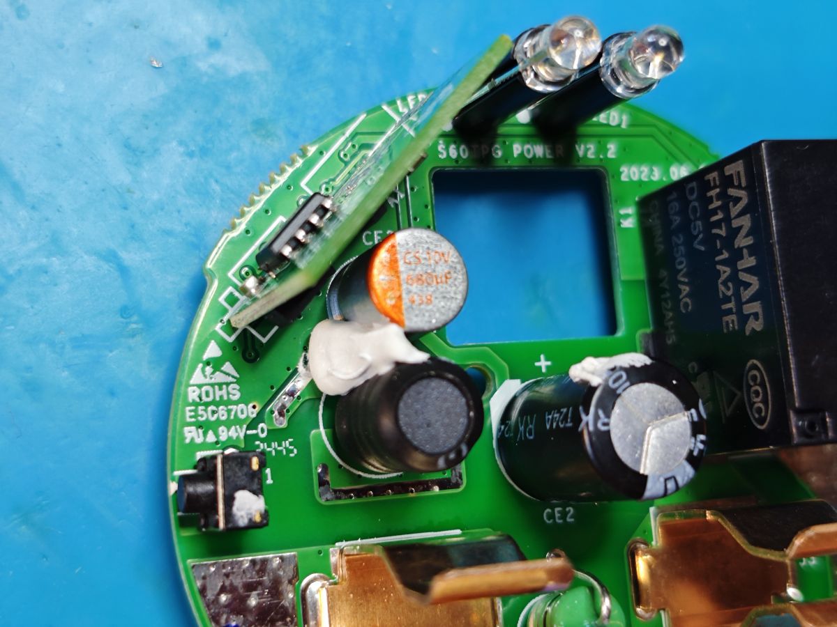

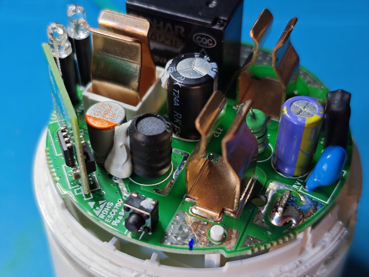

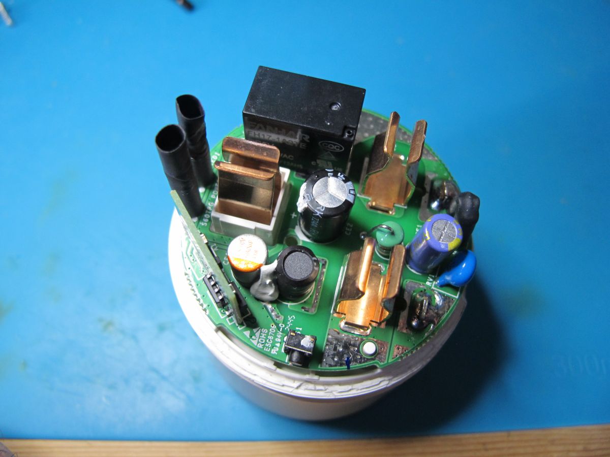

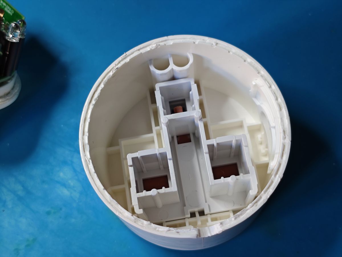

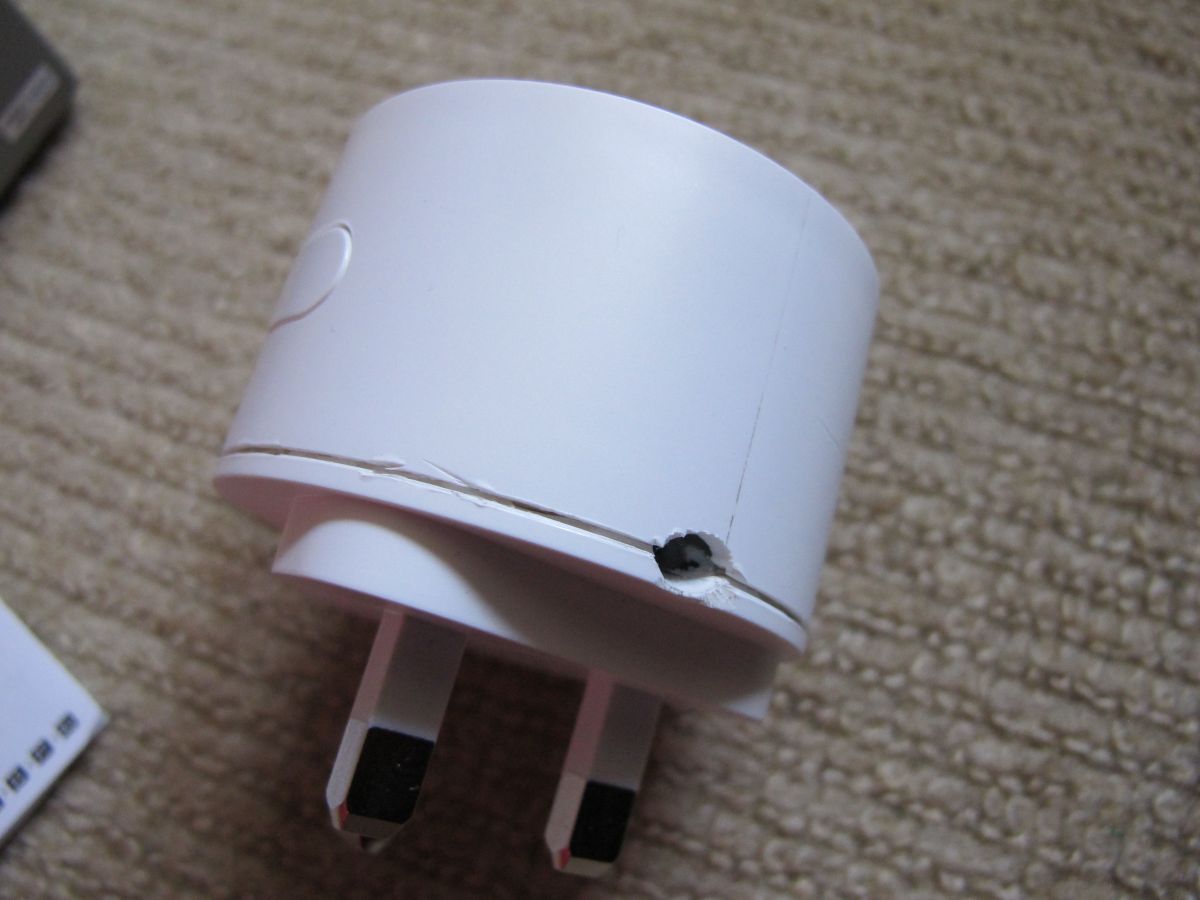

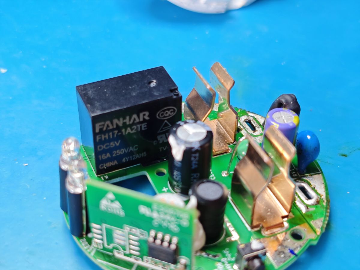

Glue seemed to be too strong and I didn't have the right width tools to contort it in a vice to crack it open. I resorted to drilling a hole at the chassis join from which it could be pried apart. Main PCB removed from power pins and then module de-soldered.

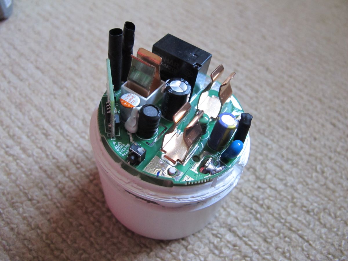

Close-up of a UK smart plug with a drilled hole at the seam and visible crack along the plastic enclosure. Disassembled Sonoff S60TPG UK smart plug with exposed PCB and electronic components. Top view of the inside of a Sonoff S60TPG iPlug UK smart plug, showing electronic components on the PCB. Close-up of the internal PCB of a Sonoff S60TPG plug, showing the SM-049 ESP32-C3 module and electronic components. Close-up of a FANHAR relay and electronic components on a smart plug’s PCB. Close-up of the interior of a Sonoff S60TPG iPlug UK smart plug showing electronic components and connectors. Close-up of the inside of a Sonoff S60TPG smart plug, showing the PCB, power contacts, and electronic components. The inside of an empty Sonoff S60TPG iPlug UK plug case with visible partitions, no electronics inside. Close-up of a smart plug interior showing a PCB, two LEDs, and a Chipsea CSE7759B chip. Close-up of the Sonoff S60TPG smart plug PCB with visible electronic components, capacitors, and a relay. Close-up of a smart plug PCB with a FANHAR FH17-1A2TE relay and visible electronic components.

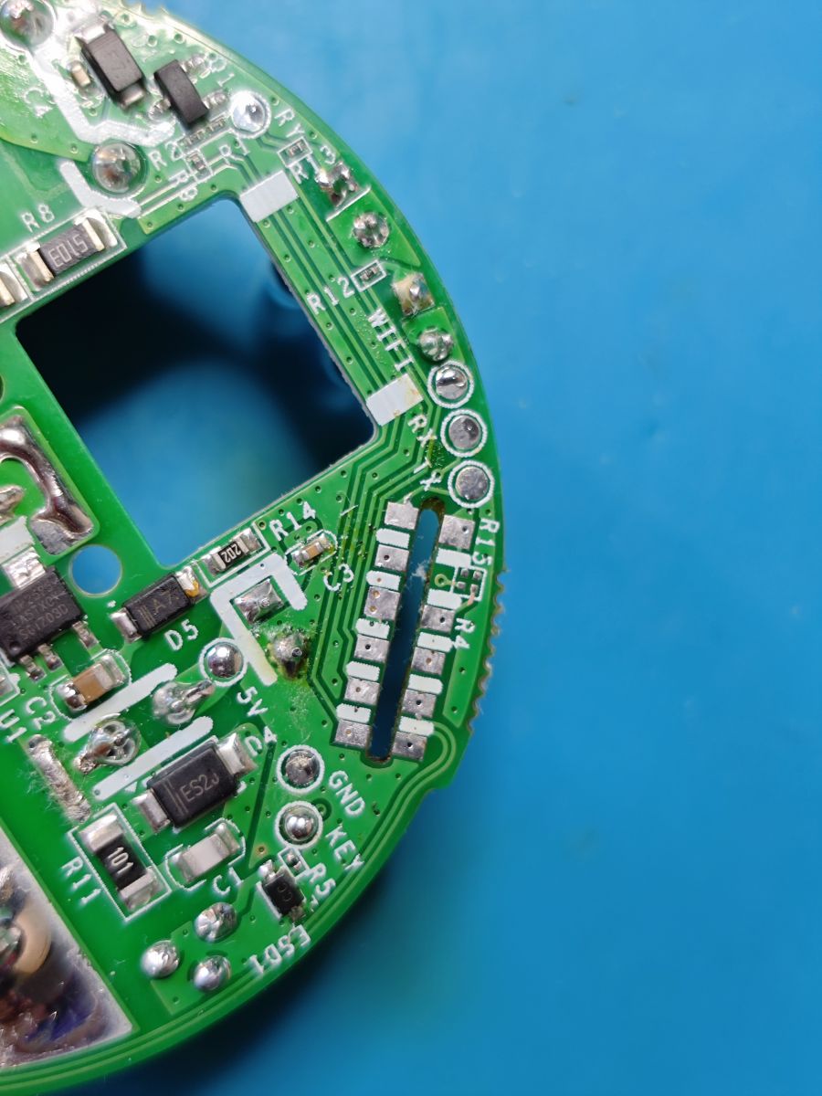

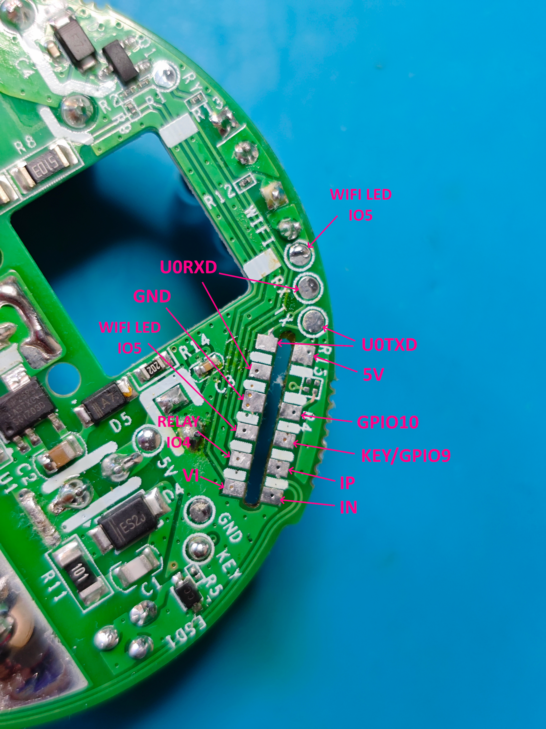

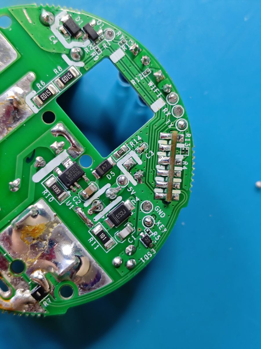

Fragment of a round PCB from Sonoff S60TPG plug, with labeled pins and electronic components visible. A fragment of the Sonoff S60TPG PCB showing pin labels, electronic components, and solder pads. A PCB module with a black CSE7759B chip and markings ROHS and E506706. Top view of the SM-049 ESP32-C3 V1.3 PCB module, showing component layout and pin labels. ESP32-C3 SM-049 V1.3 module on a green PCB with pin labels, top view. Electronic module with CHIPSEA CSE7759B chip mounted on a green PCB with ROHS marking and several connectors.

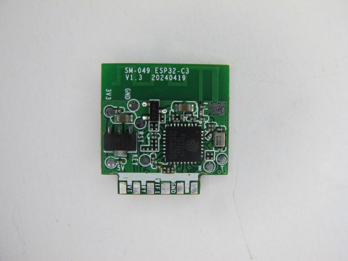

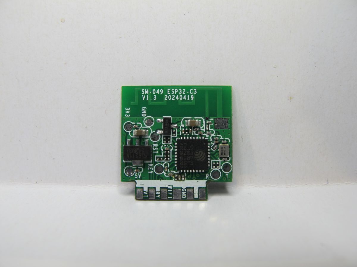

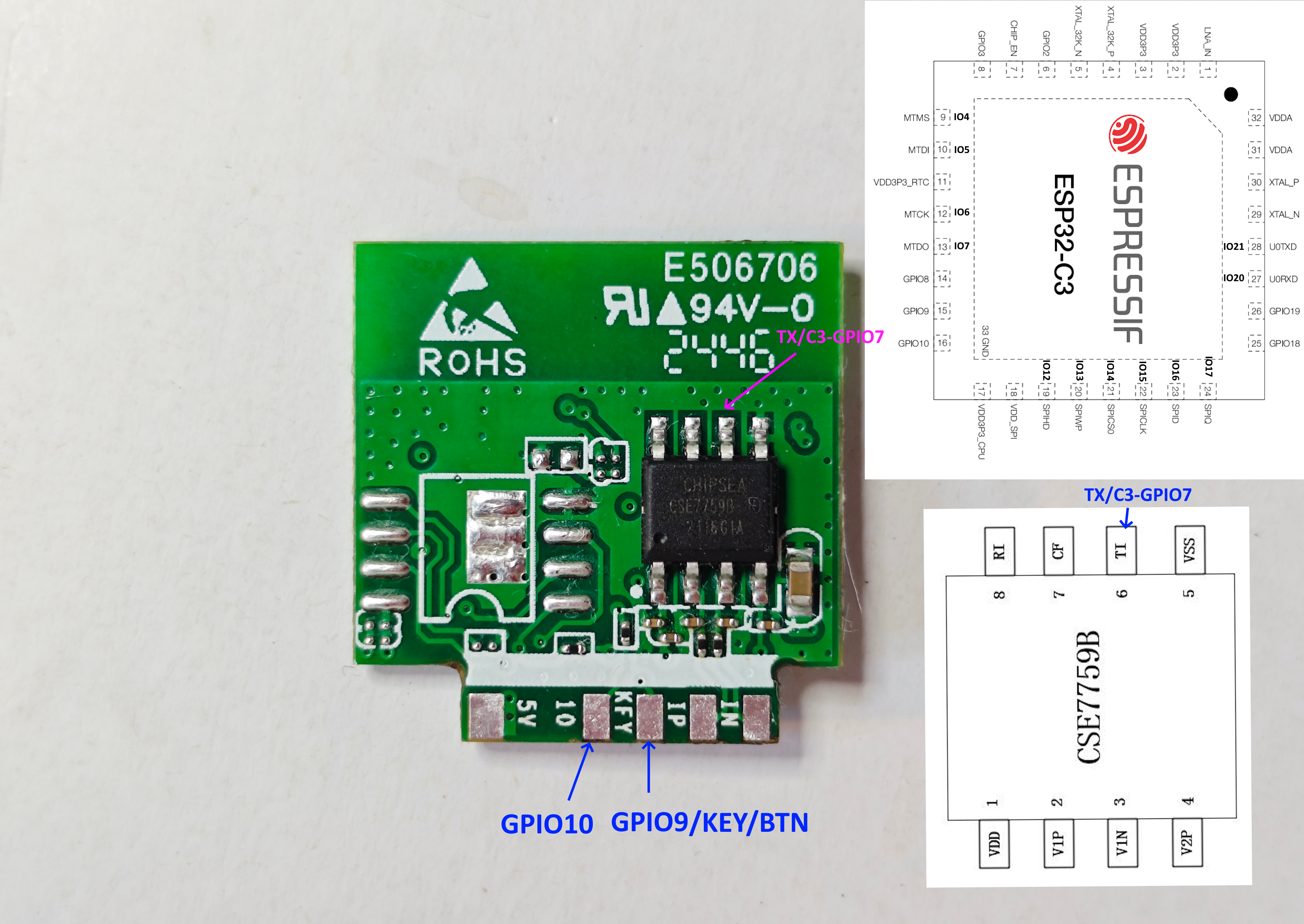

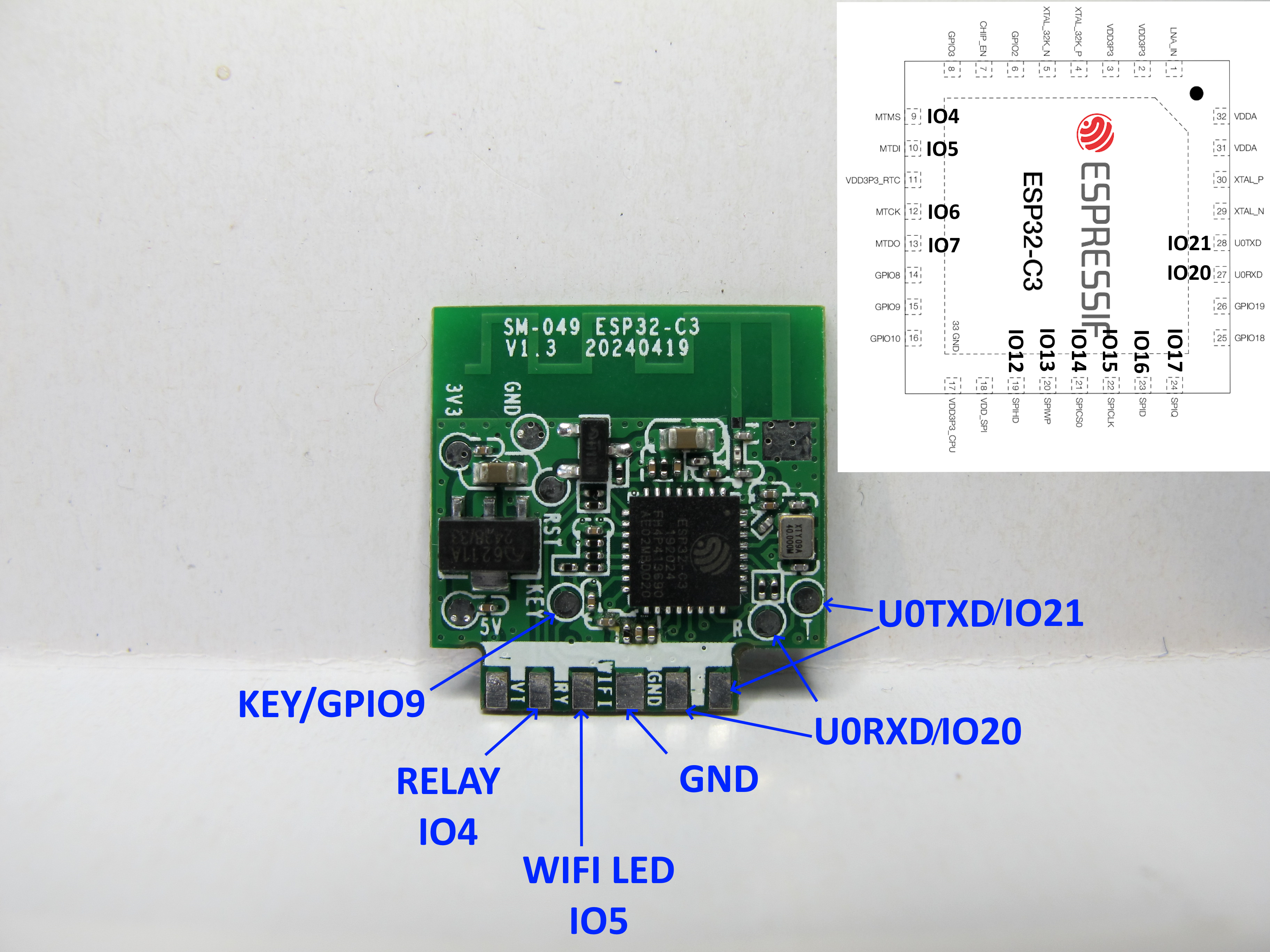

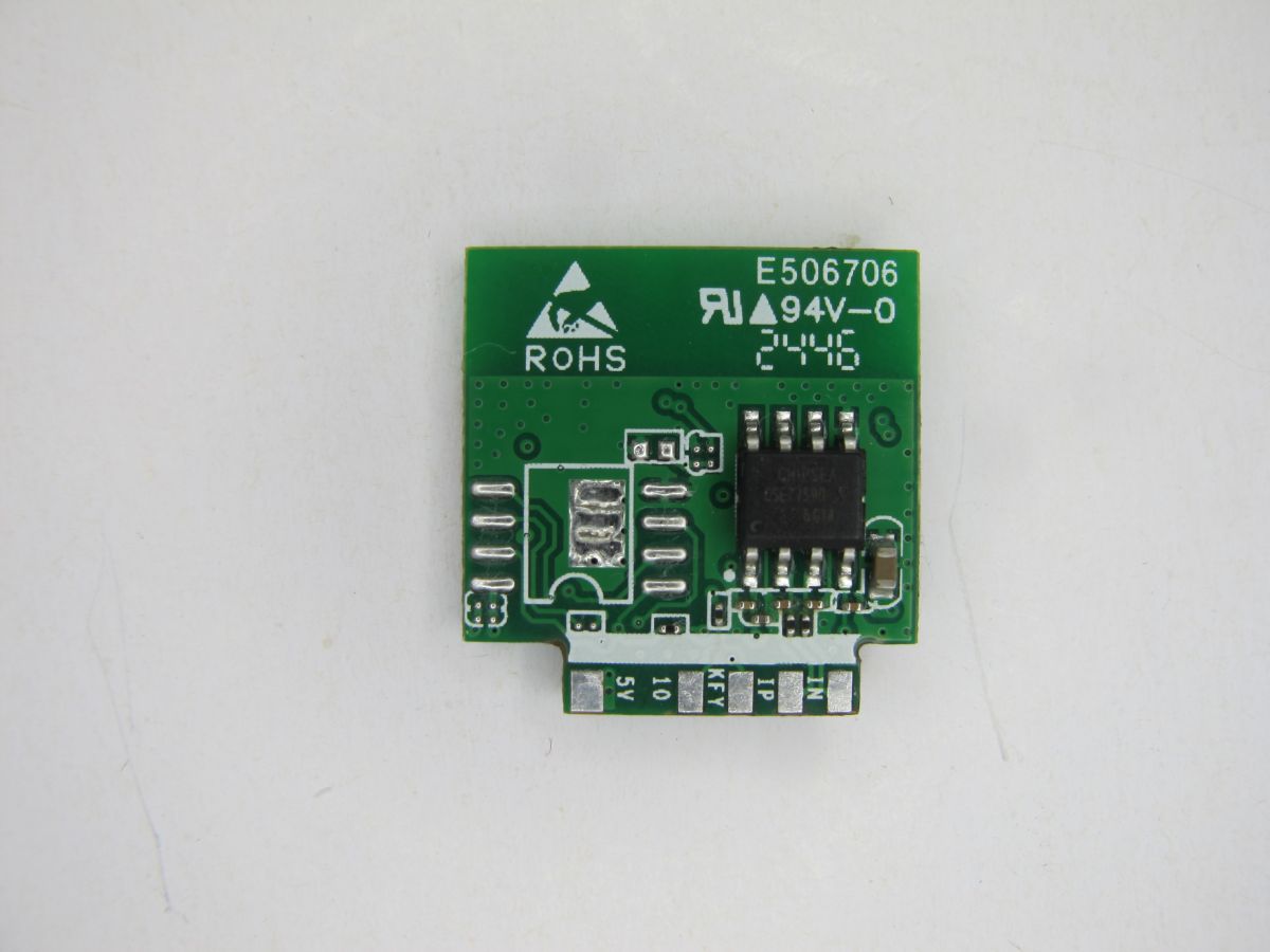

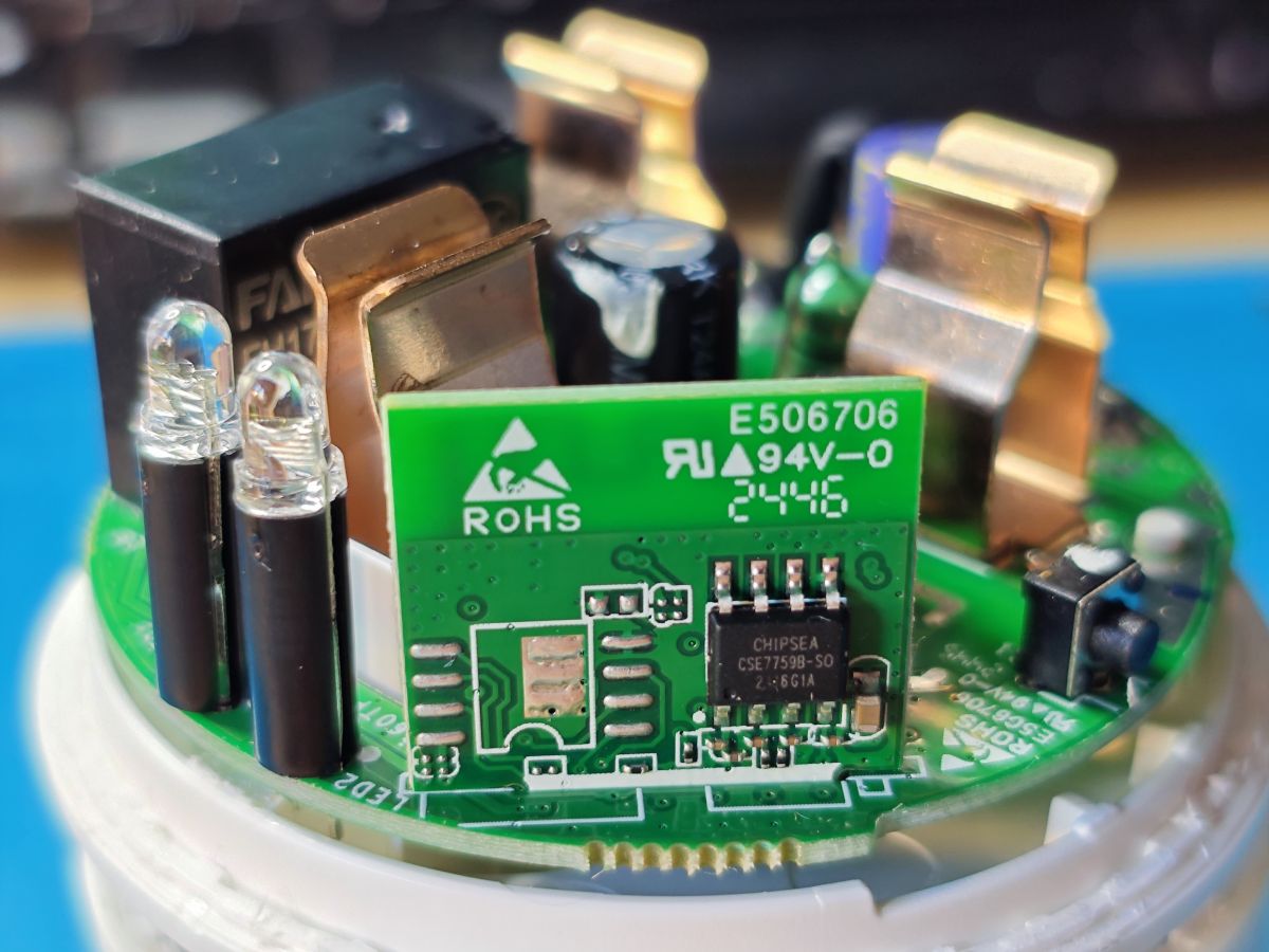

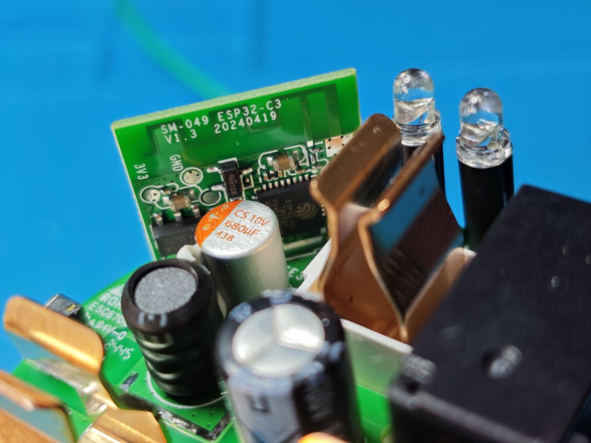

A module I've not seen before. A Coolkit SM-049 V1.3 - an ESP32-C3 with 4mb flash integrated. On the reverse of the module is a Chipsea Technologies CSE7759B energy metering chip. Module takes 5V from main PCB but then 3.3v supplied to ESP32 thanks to a MicrOne (Nanjing Micro One Elec) ME6211A33PG-N 6211A 2438/33 LDO.

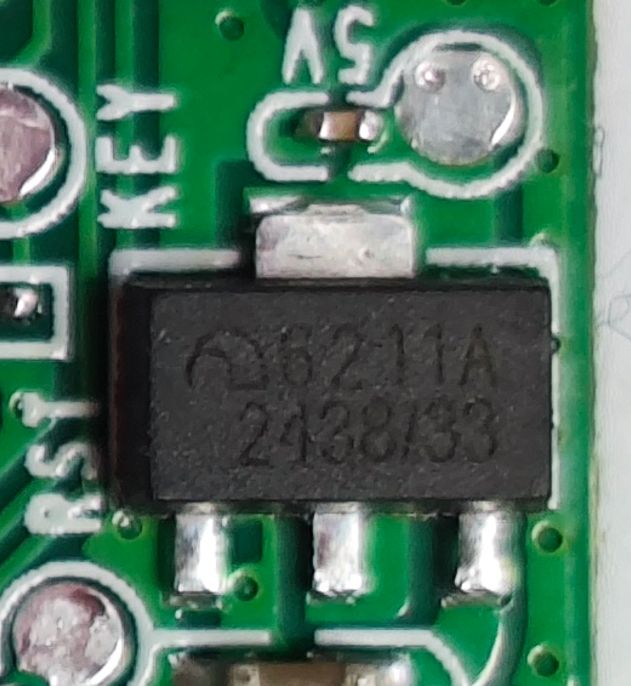

Close-up of ME6211A33PG-N 6211A voltage regulator IC on a green PCB, with visible 5V, KEY, and RST labels.
from IO21/TX at 115200 baud, factory boot log

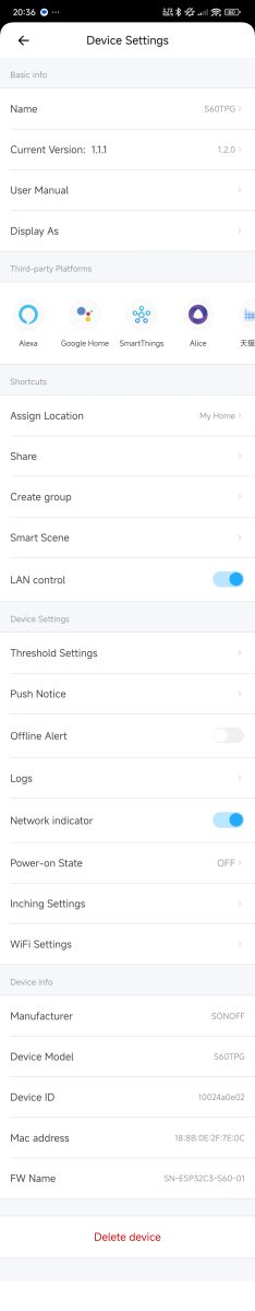

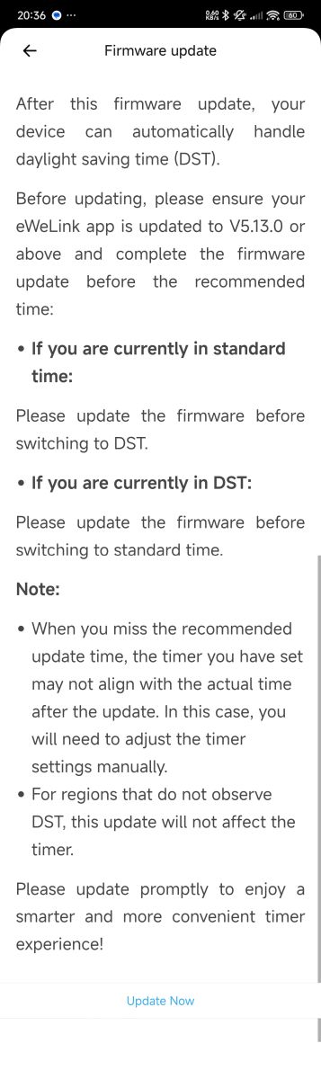

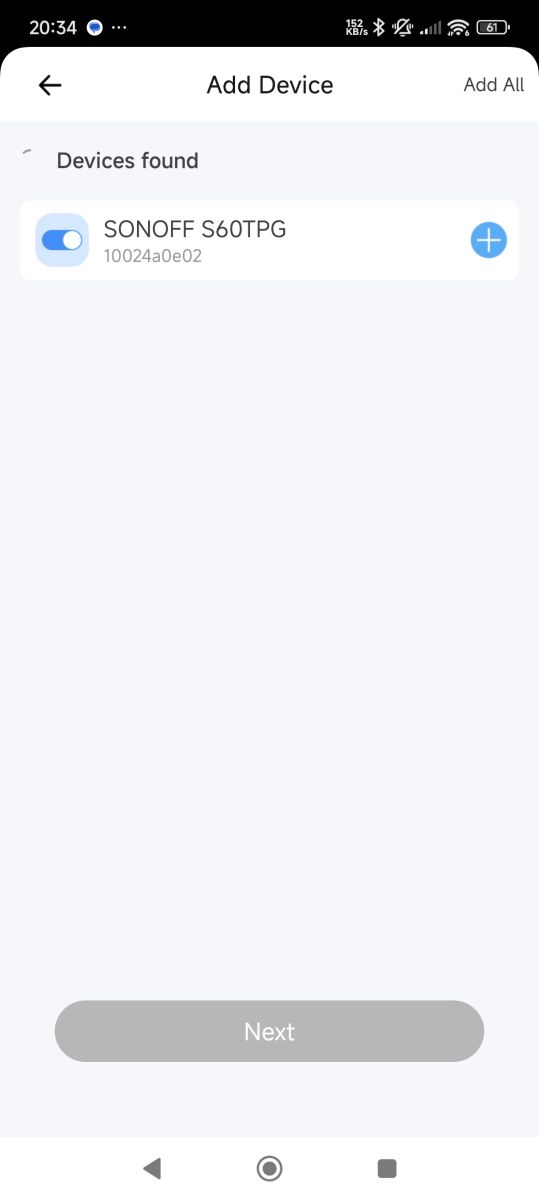

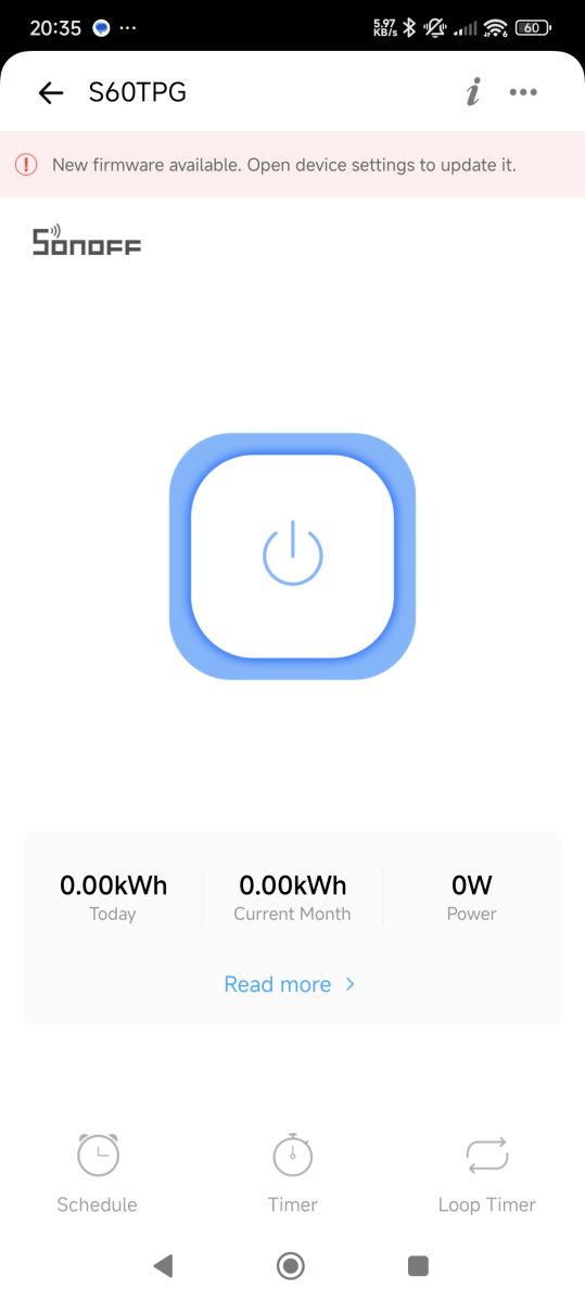

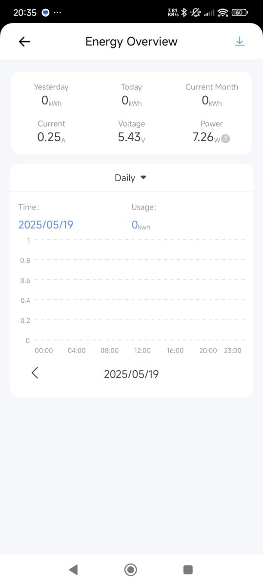

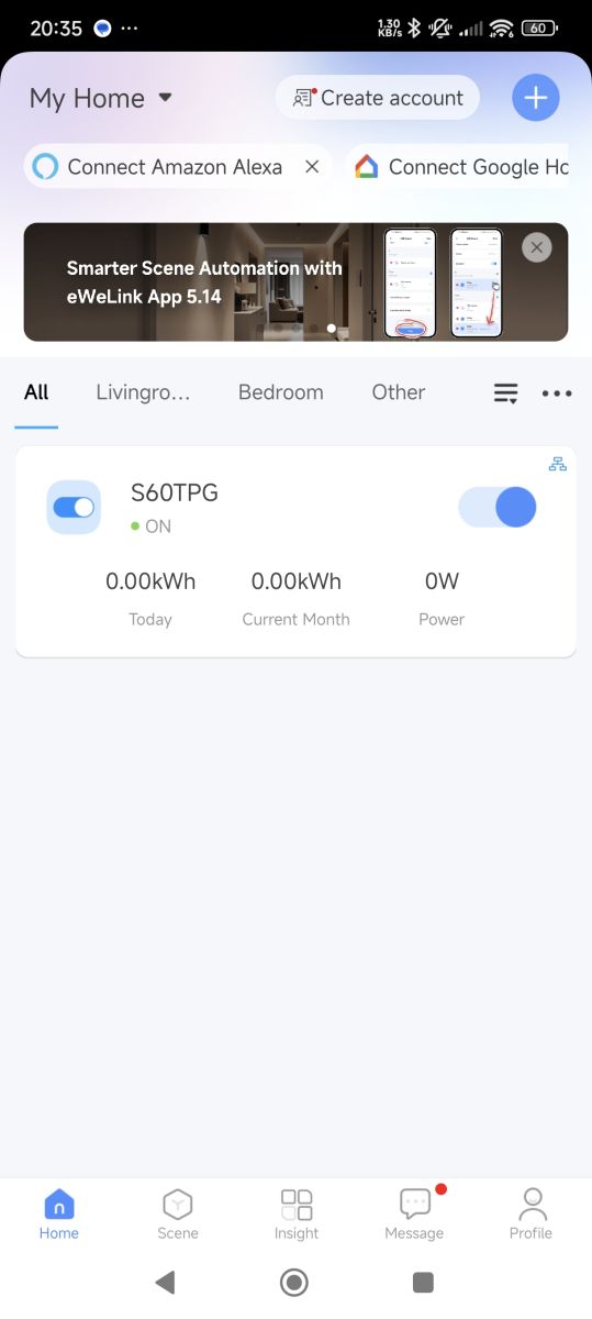

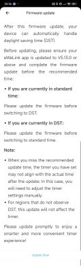

eWeLink app experience. fw ver 1.1.1 with update to 1.2.0 offered
Screenshot of a mobile app showing the SONOFF S60TPG device detected during the add device process.Screenshot of eWeLink app with S60TPG smart plug turned on, showing zero power usage. Mobile app screen for the Sonoff S60TPG smart plug in eWeLink, showing firmware update notification and device stats. Mobile app screen showing energy summary with current 0.25 A, voltage 5.43 V, power 7.26 W, and 0 kWh energy usage today, yesterday, and this month. Screenshot of Sonoff S60TPG device settings in a mobile app, showing current firmware version and various configuration options. Firmware update notification explaining daylight saving time handling and update steps for the eWeLink app.

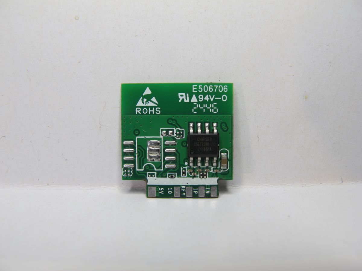

Module contact tracing and labels
ESP32-C3 SM-049 V1.3 board with labeled pins and a pinout diagram in the corner.
Photo of an electronic module with a CHIPEA CSE7759B chip, labeled pins GPIO10, GPIO9 (KEY/BTN), and TX/C3-GPIO7, plus ESP32-C3 and CSE7759B diagrams.
Fragment of a Sonoff smart plug PCB with labeled pins and signal names visible.
Meaning the assignments are

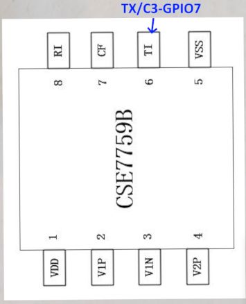

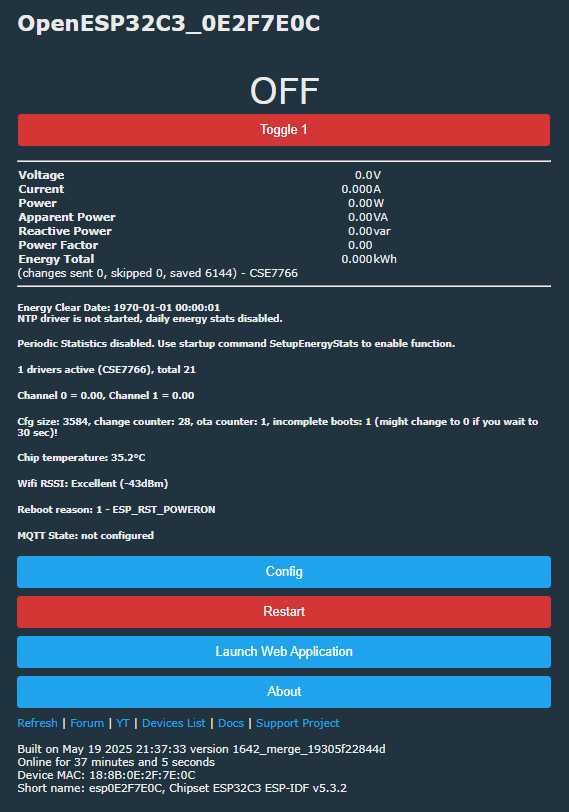

The blue wifi LED is controllable but the second red LED is linked to the relay. On=relay closed, Off=relay open.
ESP builds are missing the CSE7766 driver (compatible with CSE7759B), so I enabled it with this PR https://github.com/openshwprojects/OpenBK7231T_App/pull/1642 but @insmod warned me in the comments that it may not work. This is my first CSE7759B - from what I've seen in other posts it seems only the driver needs starting and perhaps flag 26 ([UART] Use alternate UART for BL0942, CSE, TuyaMCU, etc) needs enabling in some situations. Unfortunately no readings on ESP32 with or without flag. IO7 is connected to TX on the CSE7759B.
Diagram of the CSE7759B chip with the TI pin highlighted and labeled TX/C3-GPIO7.
Screenshot of OpenESP32C3 web interface showing relay switched off and all sensor readings at zero.
and that's the current state of play.
